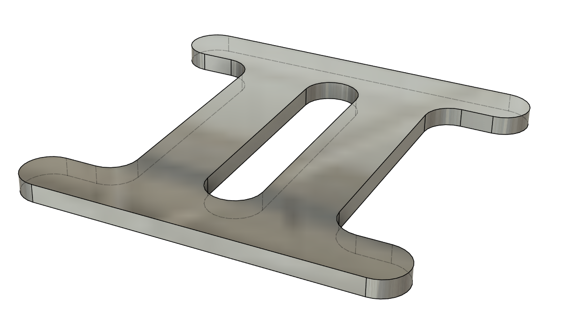

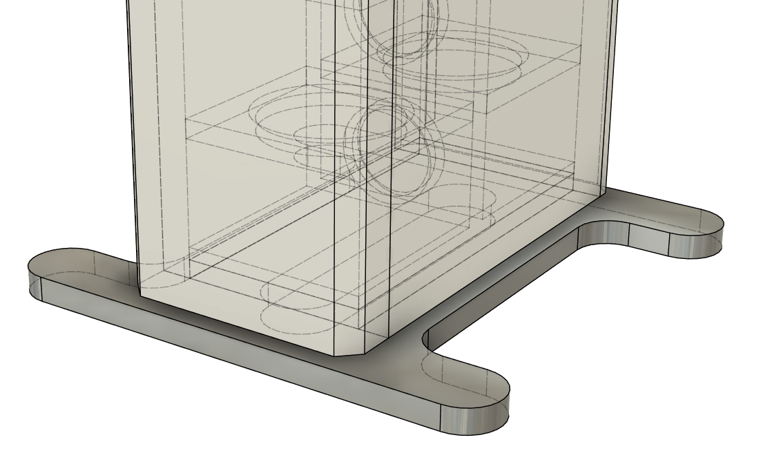

    Current base model with no through holes for bolts and such.
    And with the speaker on it. This provides a 1/2" lip around all sides, with 1.5" radius on all curves. Projected weight at 1" thick is 65 pounds, though I'm wondering if 3/4" would look better with the 3/4" gap that will be present between the base on the speaker. It'll probably depend on the selected feet.

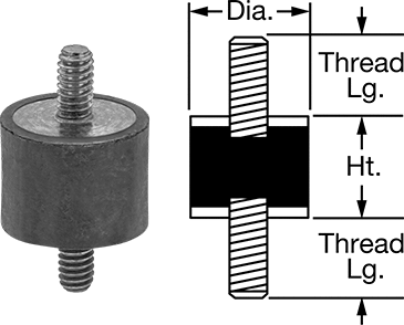

      Interesting, Danny! Got a link?
        technodanvan commented
        Editing a comment

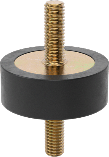

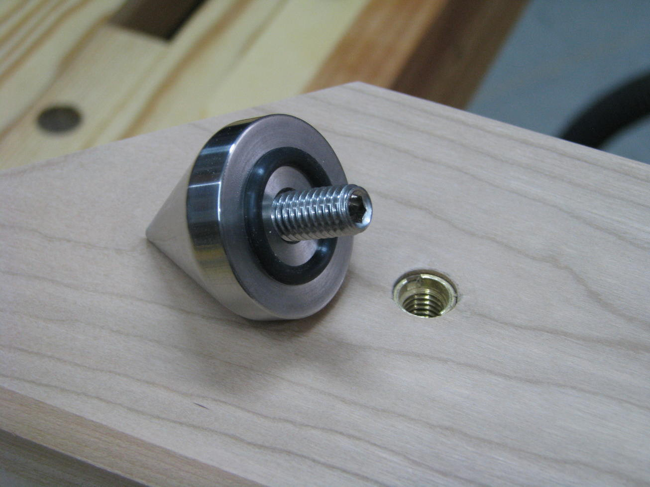

        This is the one I selected, but they have many others. https://www.mcmaster.com/9213K34/
        Edit: I'm also thinking that if I countersink the dampers I could get the gap to around 1/4".

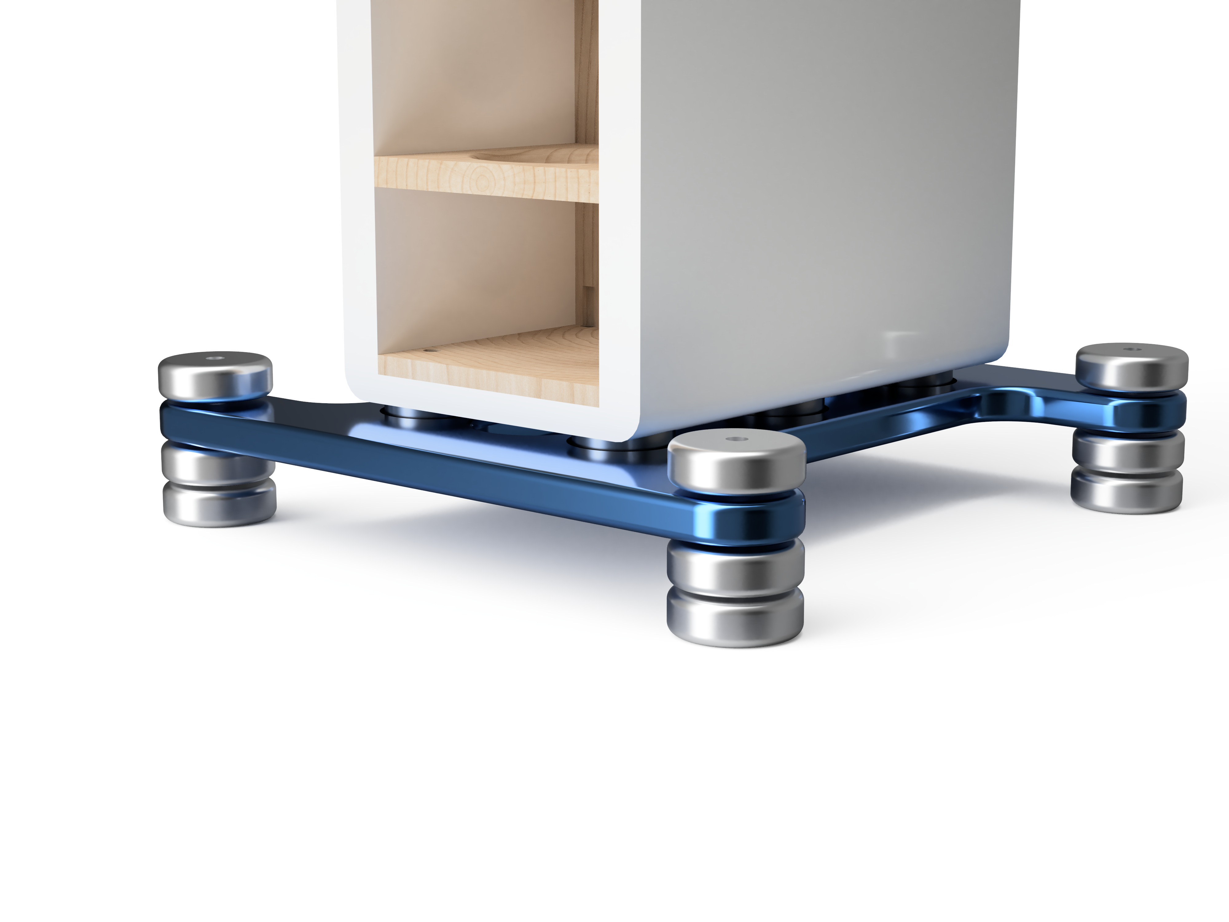

      • 1554

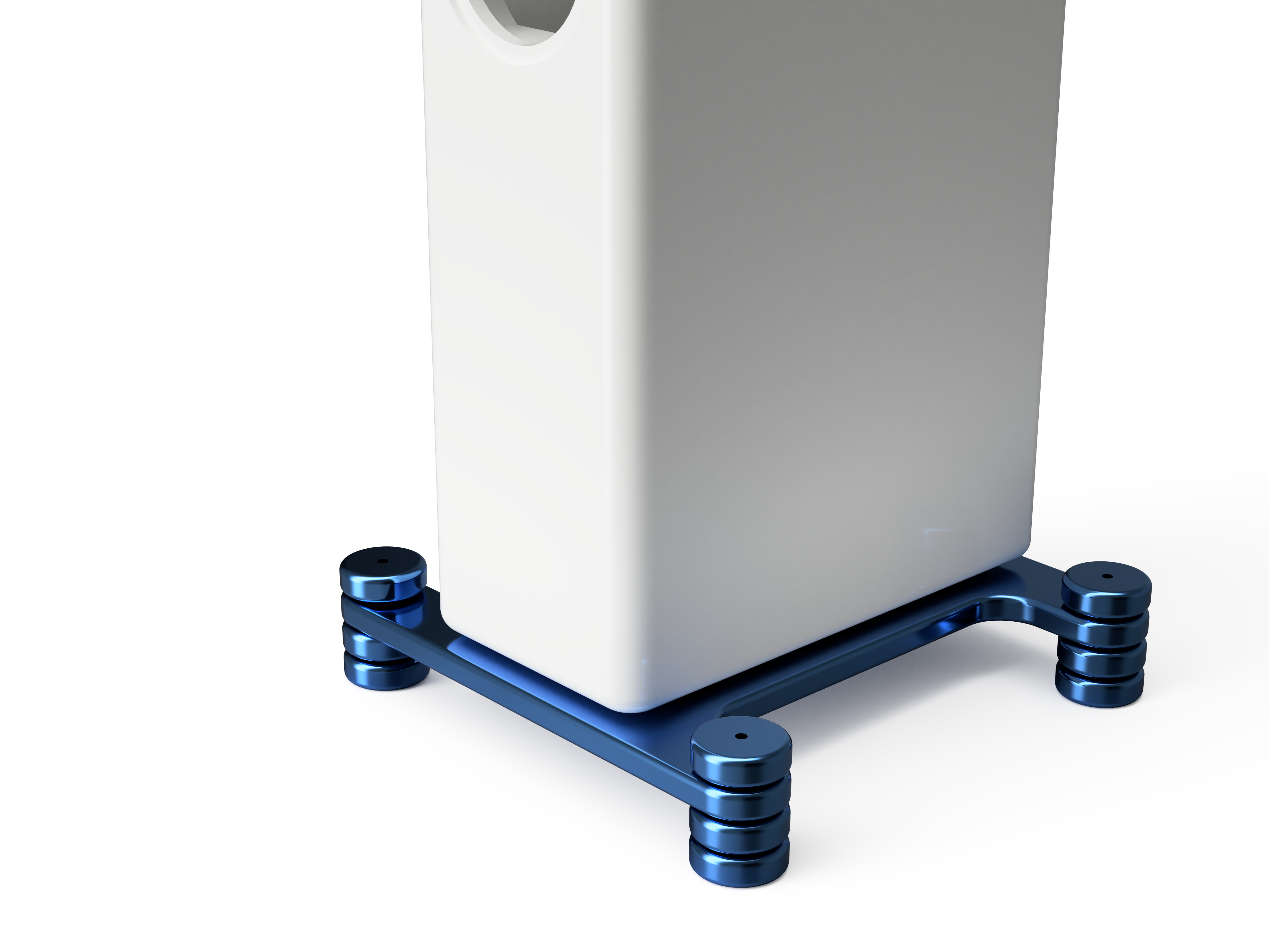

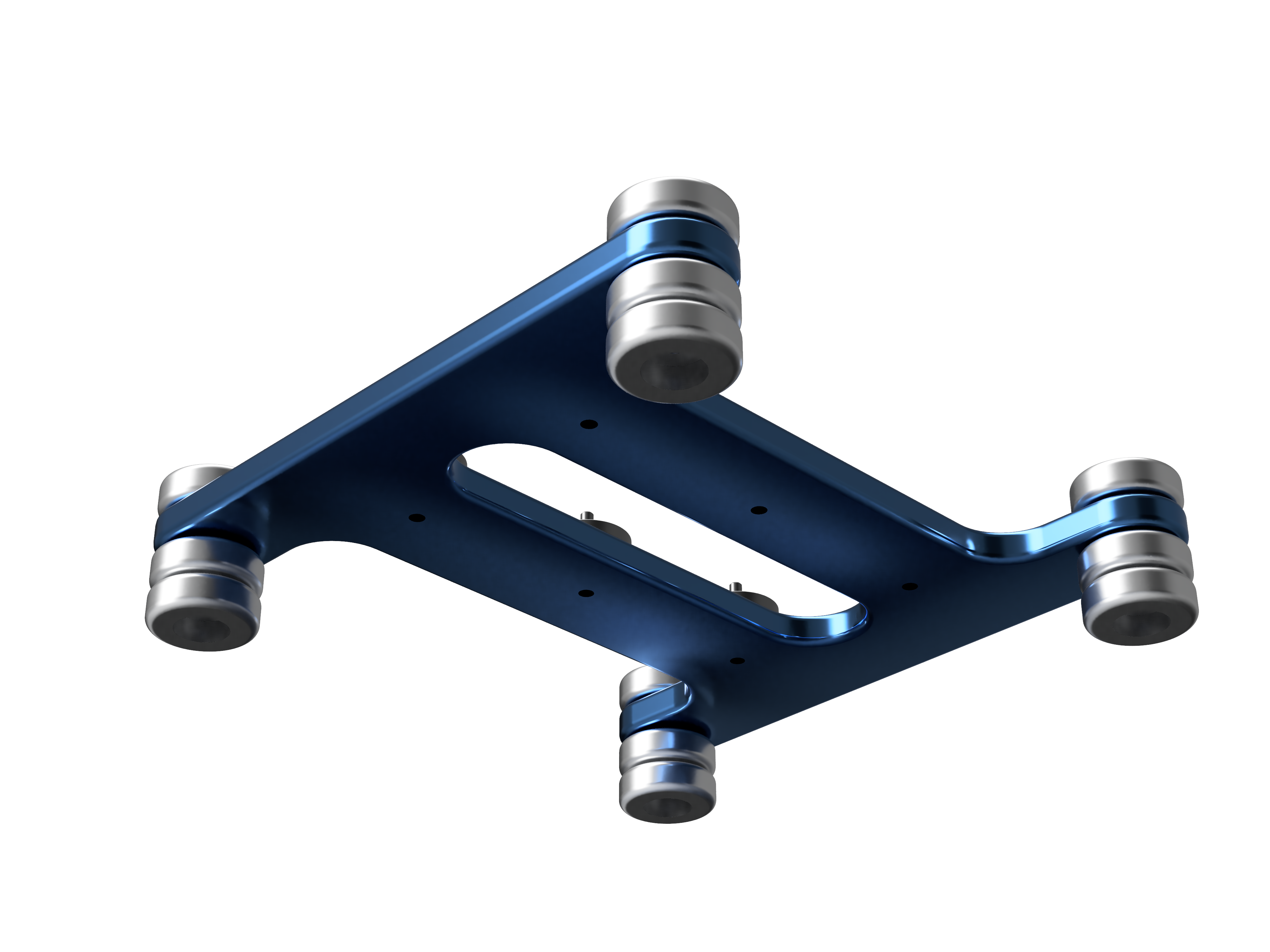

      A bit closer. The intent here is to partially countersink the vibration dampers into the steel, with a corresponding countersink in the wood at the bottom of the speaker as well. This should minimize the gain in height from using the dampers. I may add a small countersink at the bottom of these holes to hide the washer that will be used with a vibration-resistant acorn nut. I still don't know what the feet will look like...I still like the idea of having the option to descend a spike from the inside of the foot, but I just don't have the skill in CAD to make that happen.
      Click image for larger version  Name:	image.png Views:	2 Size:	226.8 KB ID:	953264
      Edit: This is starting to look like something that would fit in my living room.

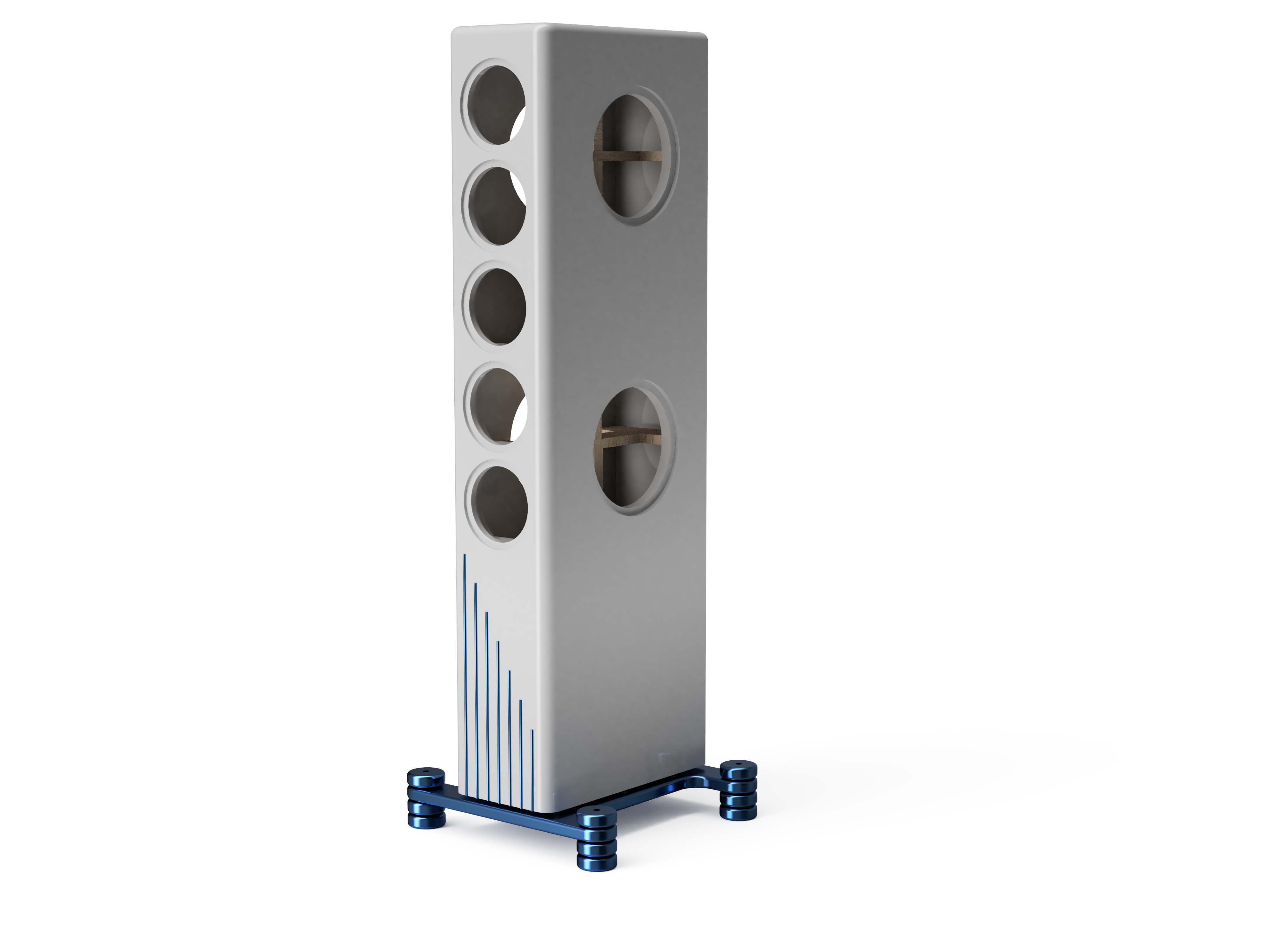

        • 1554
        Man, I've had a rough week. Besides personal and work issues, I have discovered steel is, unfortunately, cost prohibitive (at least from the first local vendor to respond to me). I'm not quite giving up on it yet, but I am now looking at 6061 Aluminum too as it's about 2/5ths the price - and still not cheap, of course. But things are moving forward nonetheless, and I think I may have a solution for the feet that sort of follows Steve's methodology for speaker cabinets. Stacked disks of the same material as the base with neoprene between all metal parts, plus hard rubber on the bottom. I'm not a fan of the latter - rubber with adhesive is bound to fail eventually - so I'm trying to determine if solid rubber can be inserted in a hollow disk.
        Click image for larger version  Name:	Baffle_Final_2024-May-16_12-33-20AM-000_CustomizedView4508422907.png Views:	3 Size:	2.31 MB ID:	953286
        Edit: Perhaps I should add some color to the mix like KEF did...

        • 16120
        Cool concept! As one can see, not a trivial effort at all, but very interesting! What sort of floor base will these speakers be installed at?
          • 1554
          These will, at least initially, be resting on a tile floor. I have been trying to plan for other surfaces as well so it may be that I have the machine shop make some matching spikes for future use. At least in the case of the blue variant, I would use chromed hardware (nuts and bolts) throughout the rest of the design so I could just opt to use the chrome Dayton spikes, potentially.
          The blue is growing on me, and my wife is supportive. I asked the CNC guy to provide some pictures of his blue though as these renders are probably too pretty to be real.
          Edit: I have also been thinking about hiding a second set of dampers within the feet. I am uncertain if that would provide any value.

              Sure thing, I asked for both blue and gold, but they can also do red and black (and clear) at this location.

                  He actually had photo of 'swatches', of sorts. I think these are showing a bit of grain - I'd have everything bead blasted first then anodized for a smoother look.
                  Click image for larger version  Name:	image (1).png Views:	0 Size:	850.3 KB ID:	953303

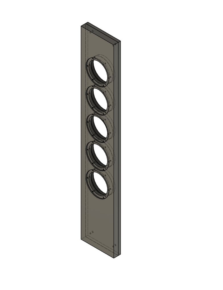

                      • 1554

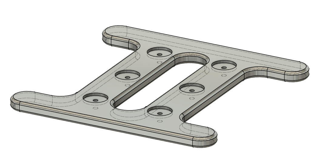

                      I think I'm almost done with the design for the aluminum parts. Despite what is shown below, everything would be anodized blue. I really wanted to make decorative rings for each drivers and PR as well, but unless I figured out how to hide magnets and/or use adhesive to attach them I'm not sure it'd be possible. Running a bolt through the ring and the speaker could work for the Anarchy but not for the King Coax or PR. I'm open to ideas!
                      This is the first idea shown for the terminal plate. I wanted enough room that I could have something etched there. Unsure what that will be at the moment. Terminal spacing is exactly that from the Dayton Audio aluminum plates. Again, I'm open to ideas!
                      Edit: The plan is to no use these as dampers between the speaker and base: https://www.mcmaster.com/93945K132/
                      The threaded parts will be screwed into brass inserts at the bottom of the speaker, which will also be countersunk some 0.35" to help hide the damper. Then I'll run a bolt through the bottom of the base into the bottom of the damper.
                      Click image for larger version  Name:	Baffle_Final_2024-May-18_03-40-58PM-000_CustomizedView198761835.png Views:	0 Size:	2.80 MB ID:	953332
                      Click image for larger version  Name:	Baffle_Final_2024-May-18_04-14-59PM-000_CustomizedView4736148295.png Views:	0 Size:	2.09 MB ID:	953333
                      Click image for larger version  Name:	Baffle_Final_2024-May-18_04-23-53PM-000_CustomizedView8506909036.png Views:	0 Size:	1.99 MB ID:	953334

                            • 1554
                            Another day, another render (or two!). My wife suggested that we need something on the front to break up the vast open spaces of white, and she okayed my solution below. Also shown in gray, as she seemed hesitant about the white itself. These would, of course, be mirrored on the other speaker.
                            Edit: My wife likes the gray "100% better" than the white. Guess I'm making more changes...except that the coax is also white, so maybe in the end that would look odd.
                            Edit 2: Updated the second pic with a better one. Note that the accents would be made from 1/4" aluminum rod.
                            Click image for larger version  Name:	Baffle_Final_2024-May-20_07-14-04PM-000_CustomizedView1834327639.png Views:	0 Size:	1.49 MB ID:	953375

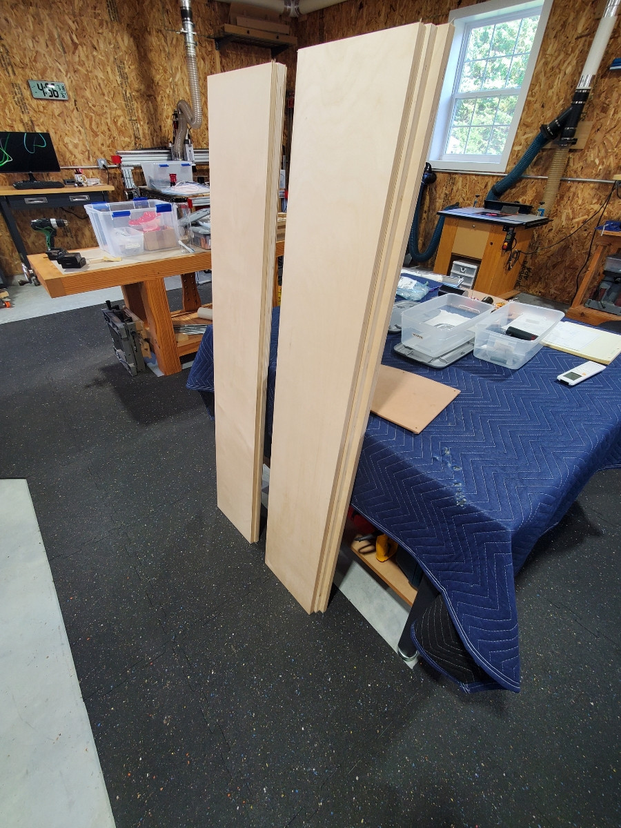

                                          • 2135

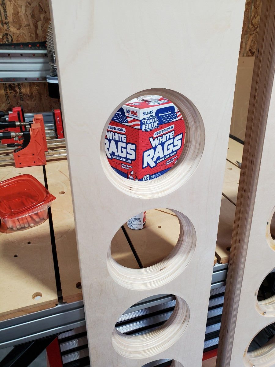

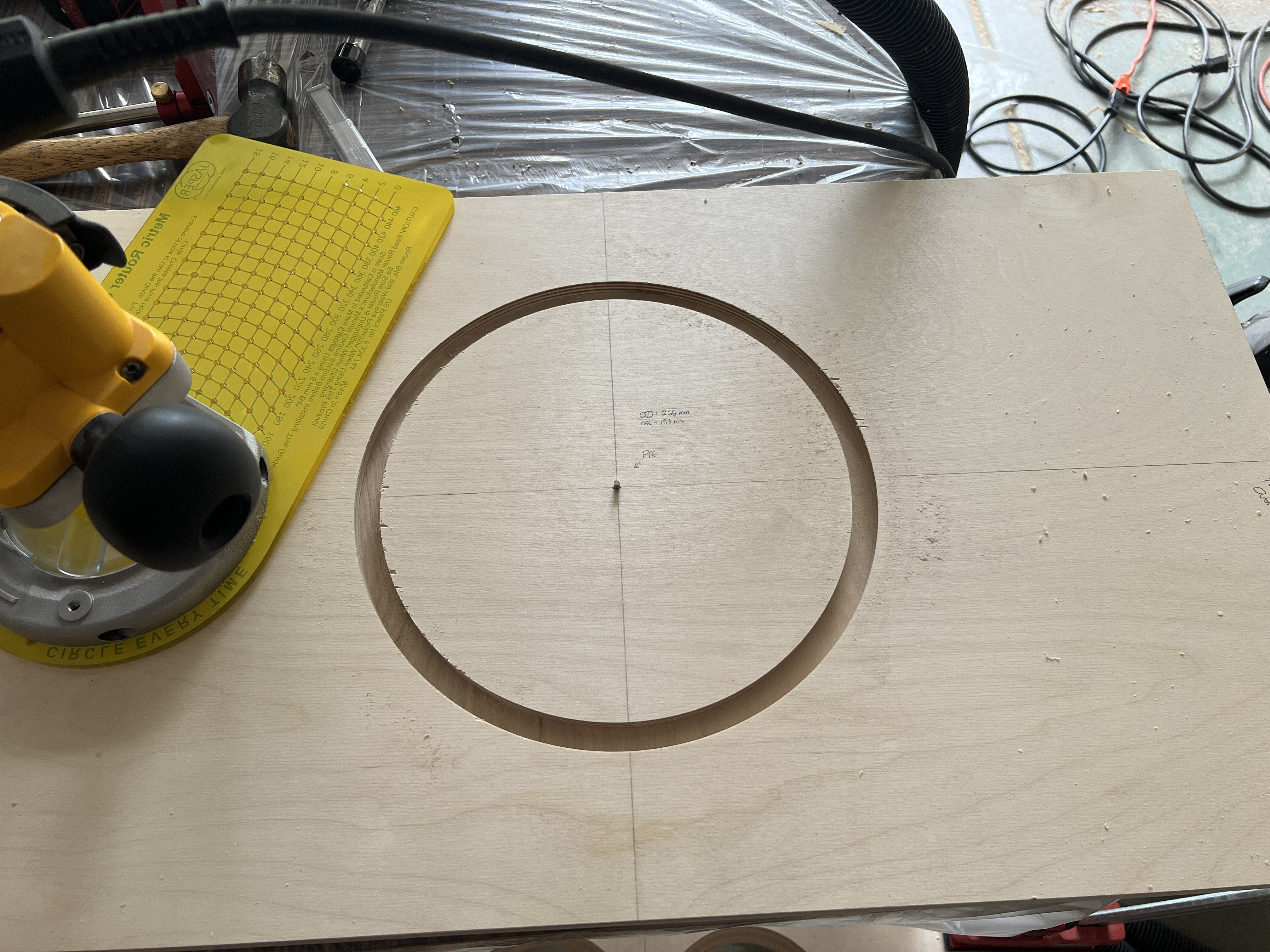

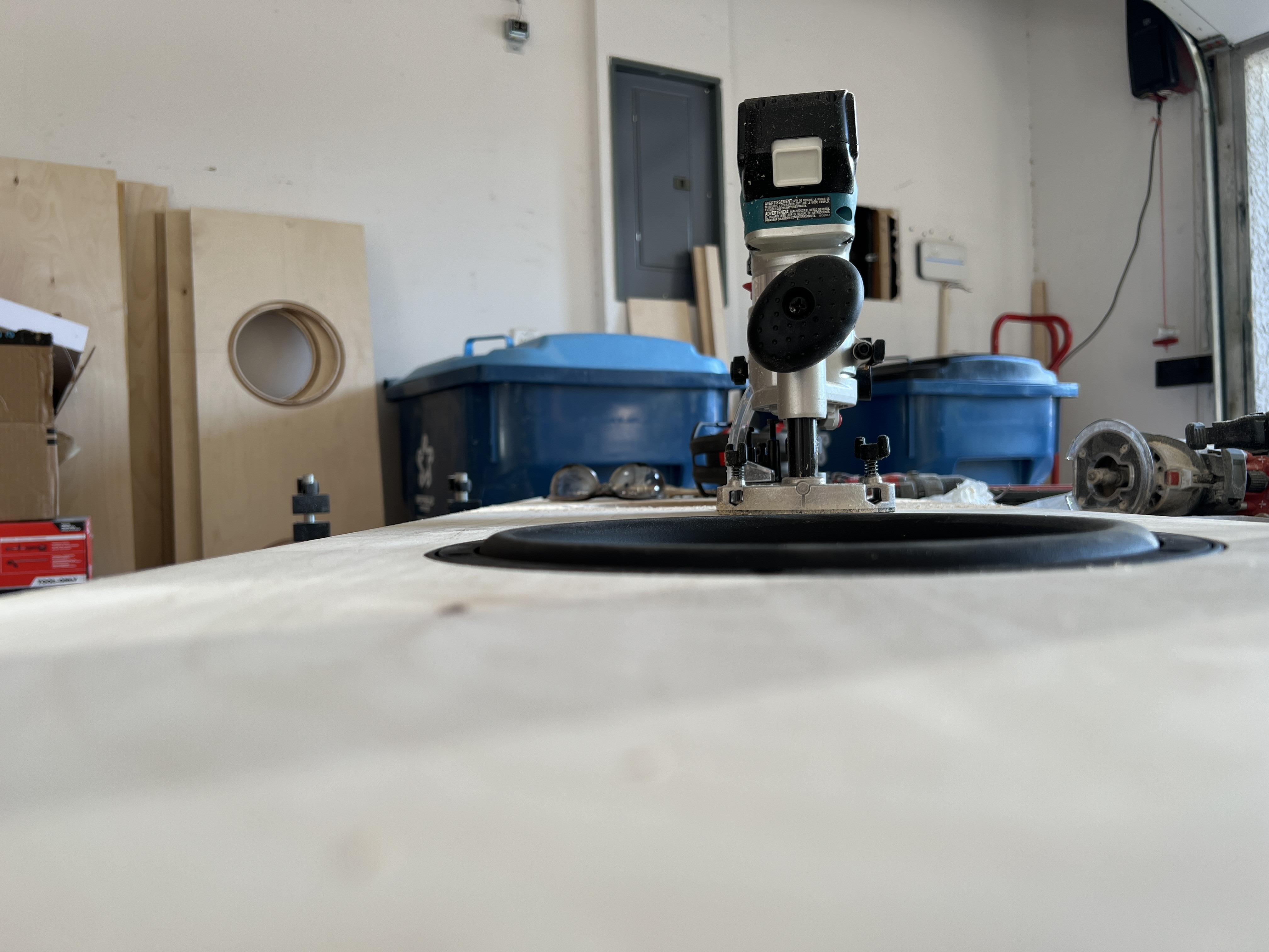

                                          Here ya go Danny .... some sawdust has been made! Getting the blank pieces cut to rough size for the baffles.
                                            • 1554

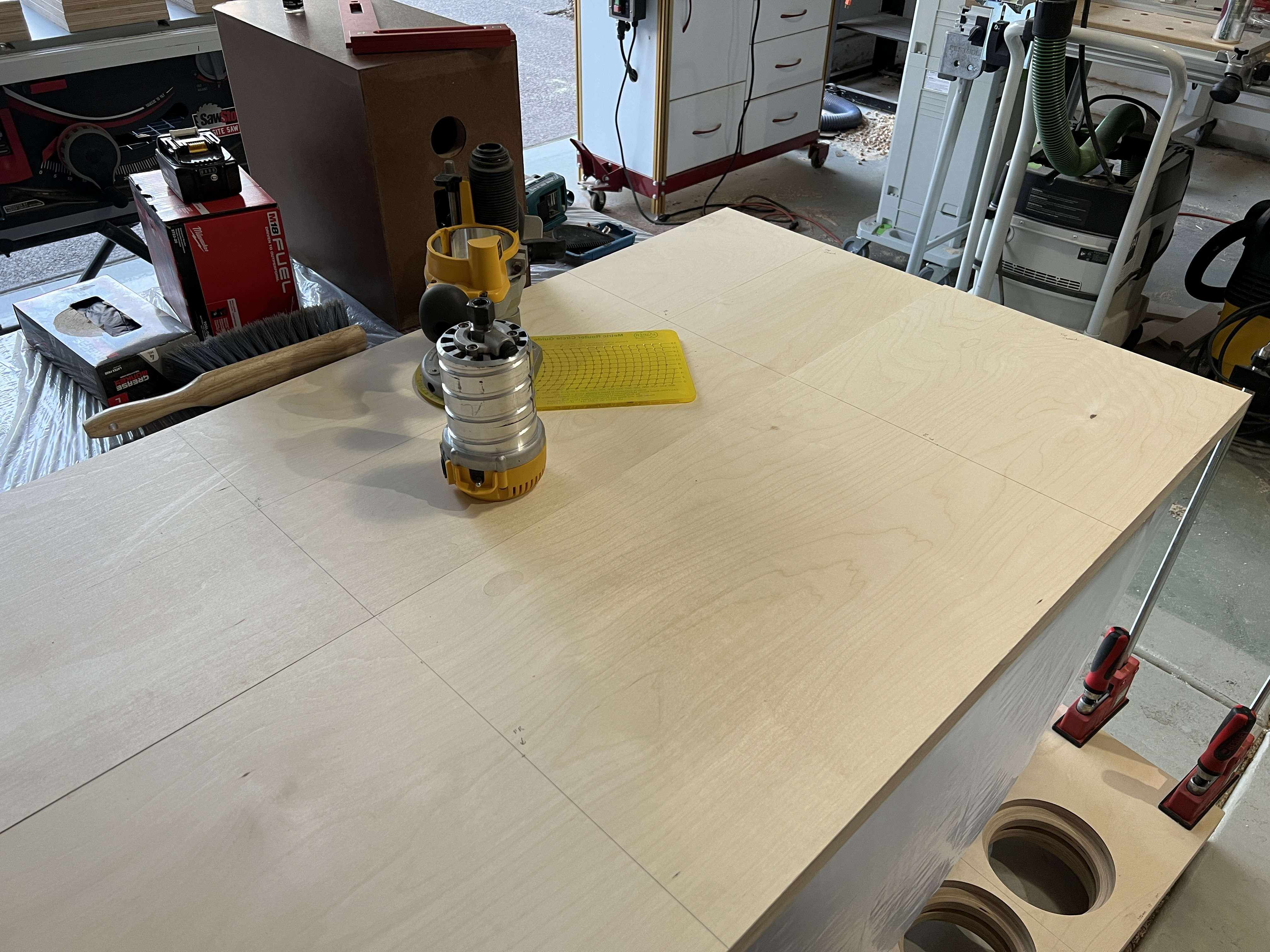

                                            Glad to see some progress! I'm sitting with the rest of the pieces cut down and glued up but not shaped to size yet. I'm starting to have my doubts I can get this done by October...cabinets shouldn't be too much of a problem (though they may go 'naked' without paint) but the crossover will be an issue unless I get this turned around quickly. Also, the bases may take longer than I thought, I'm having a few communication issues with the vendor.
                                              • 2135
                                              I have the first set in clamps while the glue dries now. I'm bouncing back and forth while epoxy dries on Sven's crossovers and these baffles. I'm hoping to get them through the CNC by the end of the weekend ..... assuming Mr Murphy stays away!
                                                • 2135

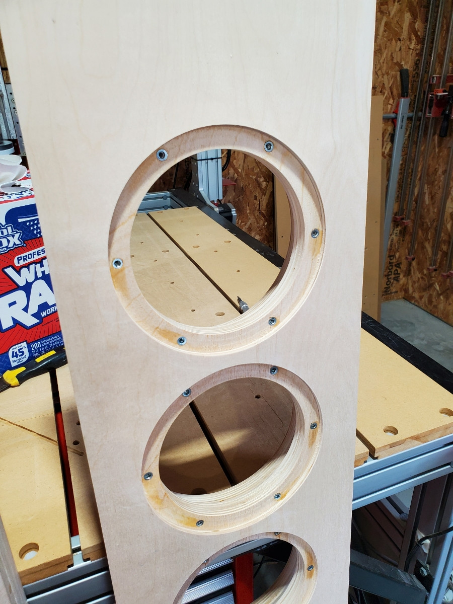

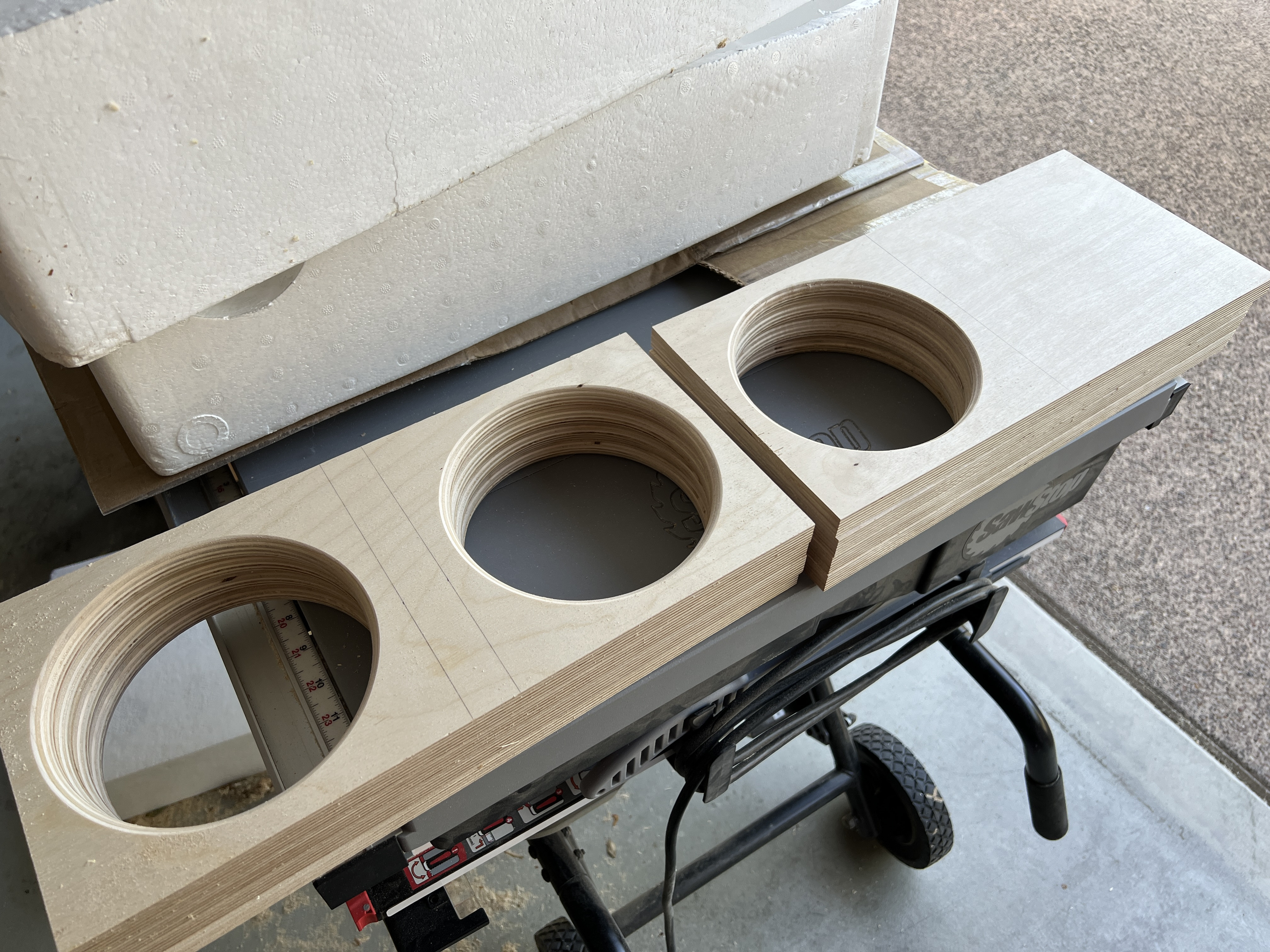

                                                Despite the heat some progress has been made. Fabrication, glue up's are done and threaded inserts installed. Shipping boxes have arrived so hopefully these will get picked up by UPS This week.

                                                  NICE work on the baffles Steve Manning!

                                                    LoL, posted that with the admin account 😂. But yes the baffles look great. How heavy are they? They look 1.5" thick, or is it more?
                                                    Painter in training
                                                      • 2135
                                                      There are actually 3 layers of 18mm BB so just under 2.25". I'll let you know on the weight .... I bought an inexpensive set of scales for shipping, I just haven't weighed them yet.

                                                              Thanks gents ..... and to answer the question, they weigh 22.5 lbs each.

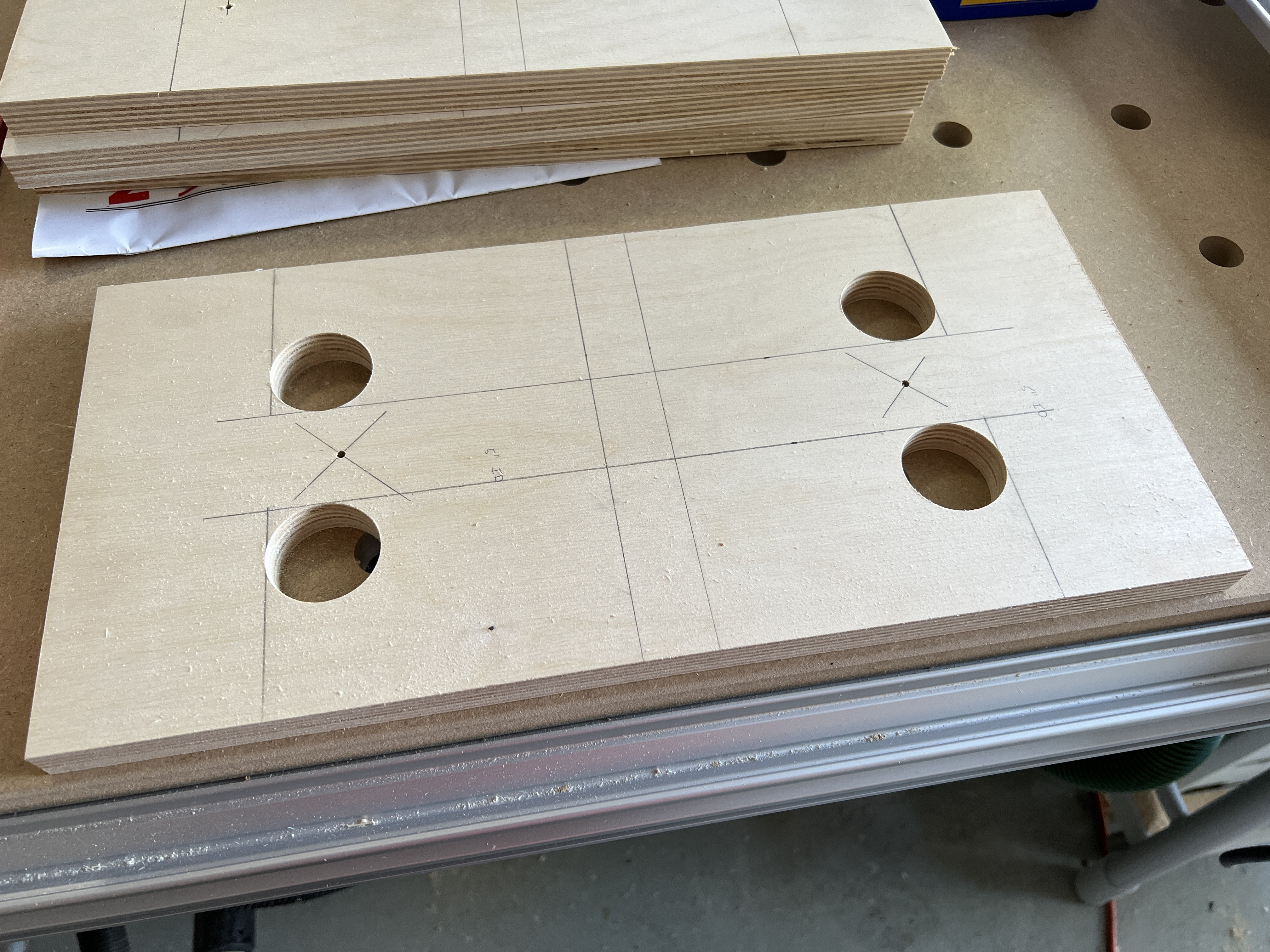

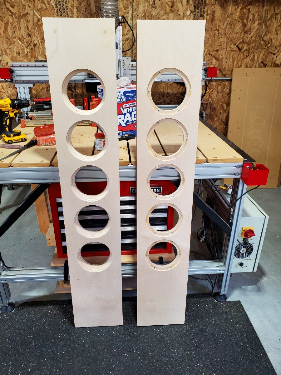

                                                                    Minor progress! Just providing pics since there isn't all that much to show...just some braces getting cut down.

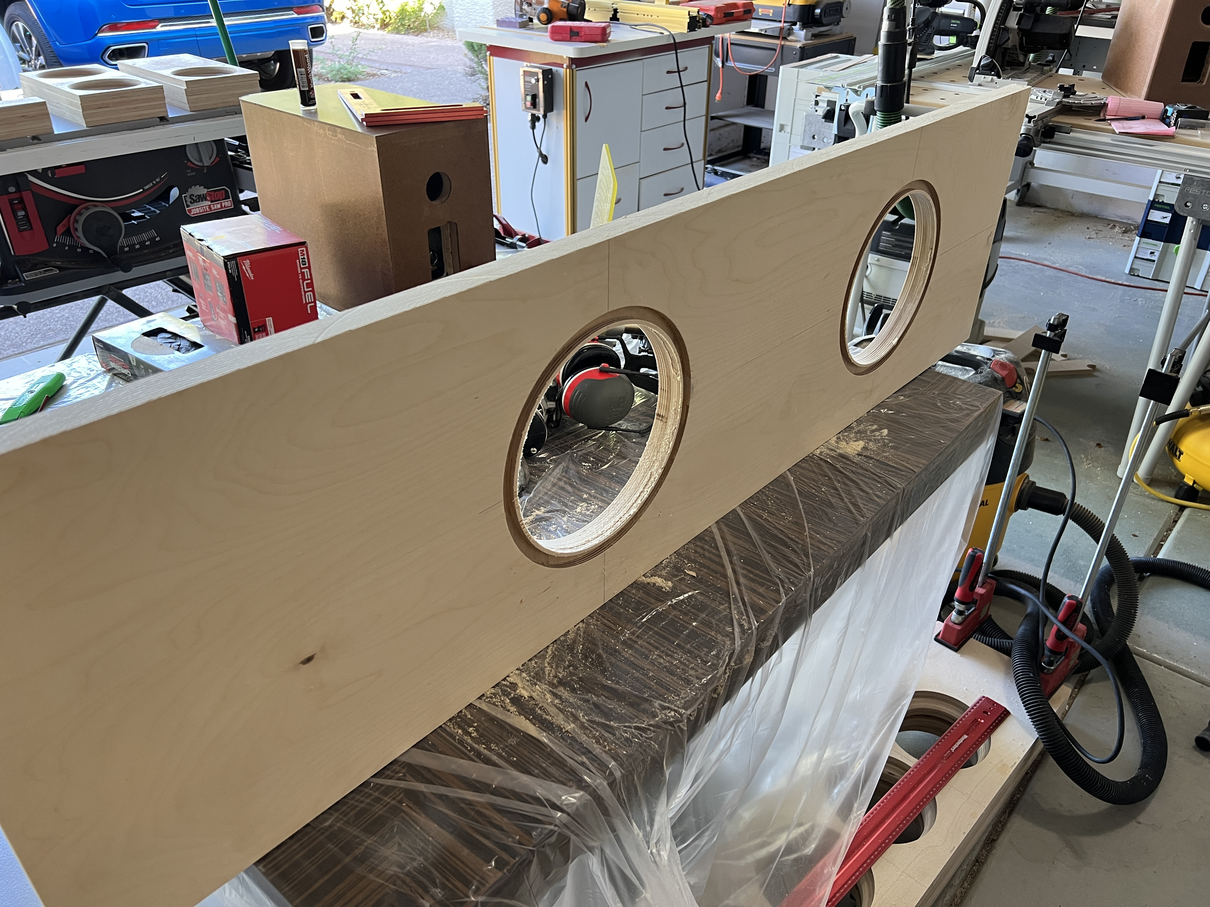

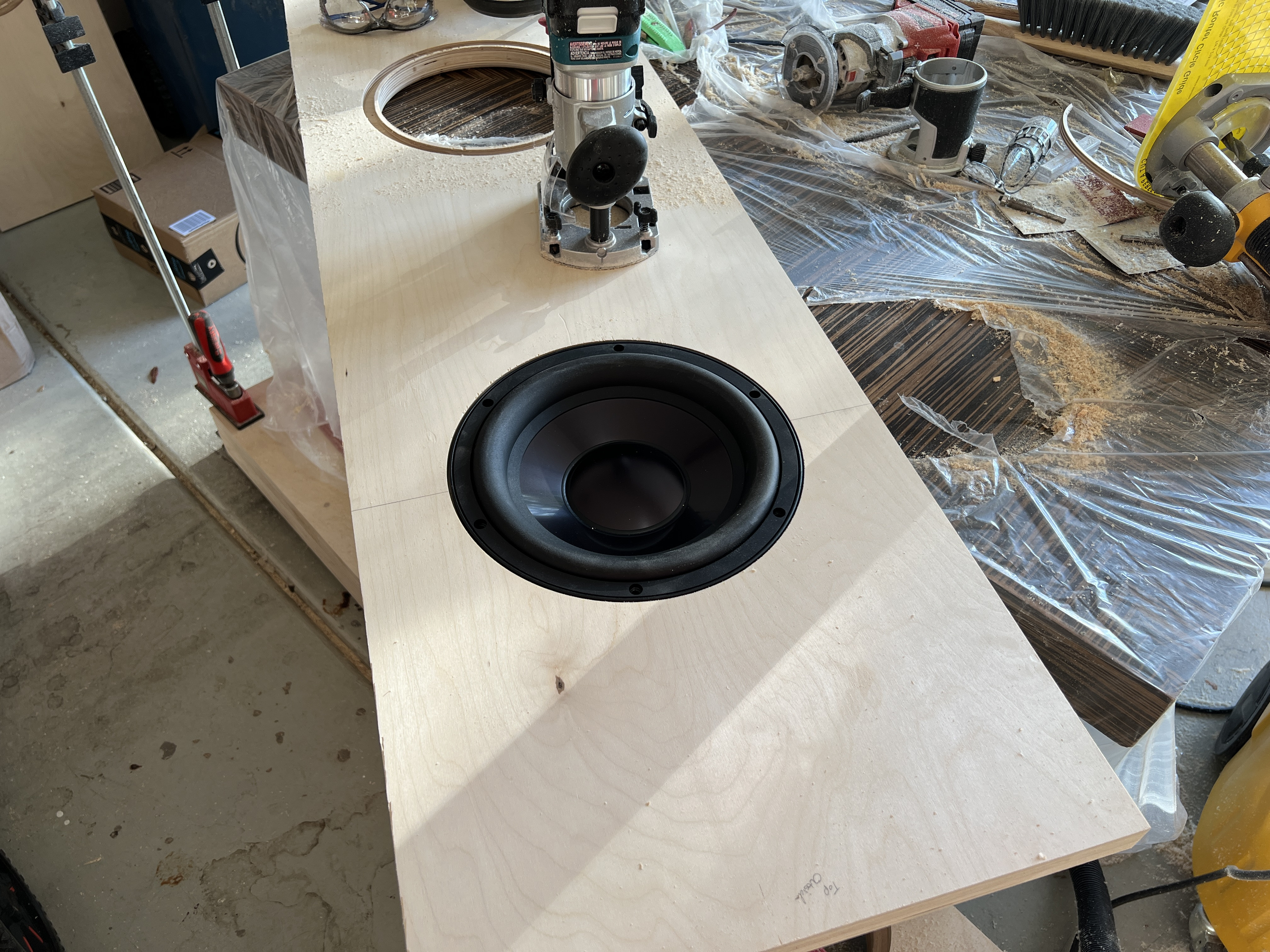

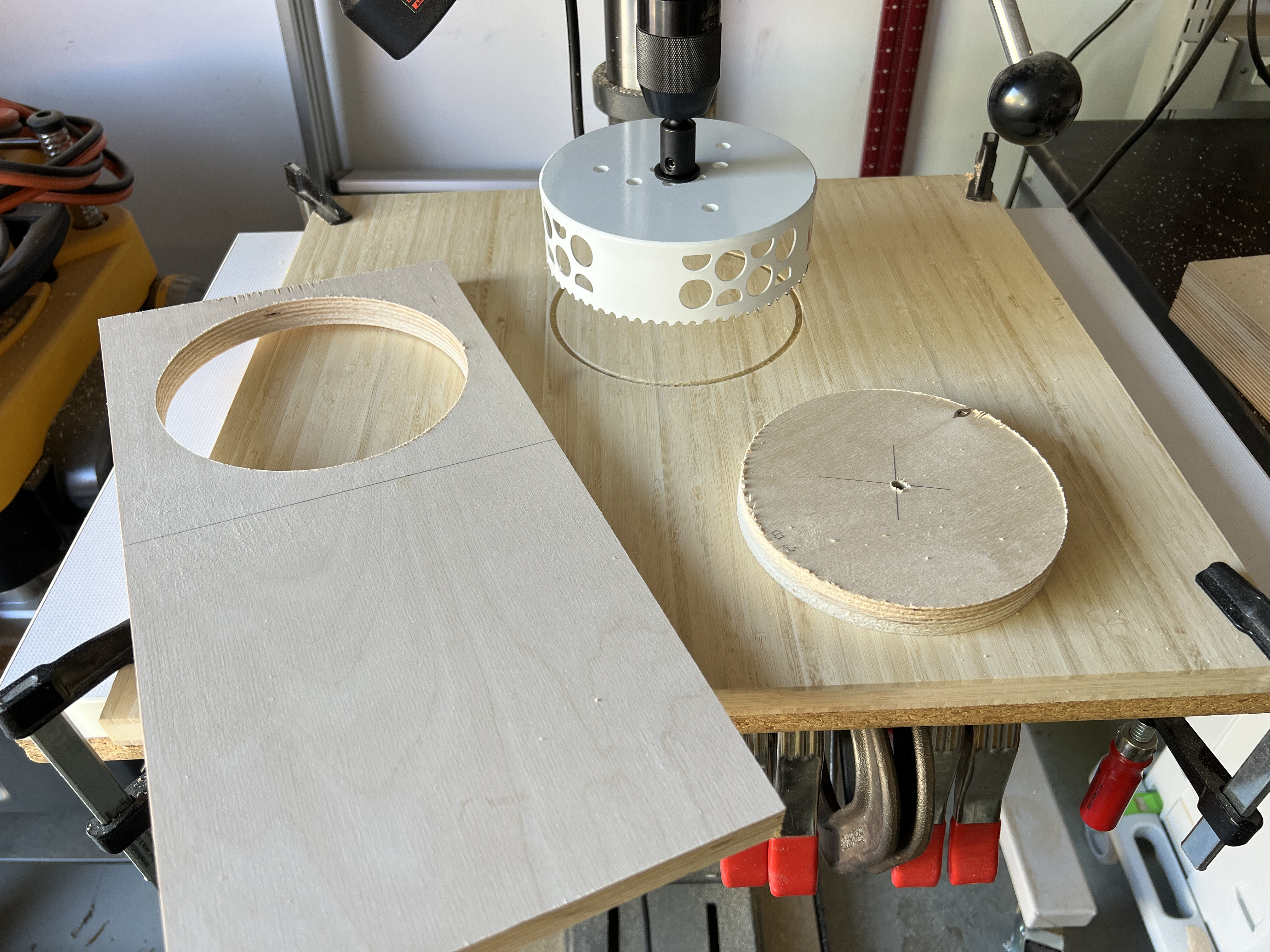

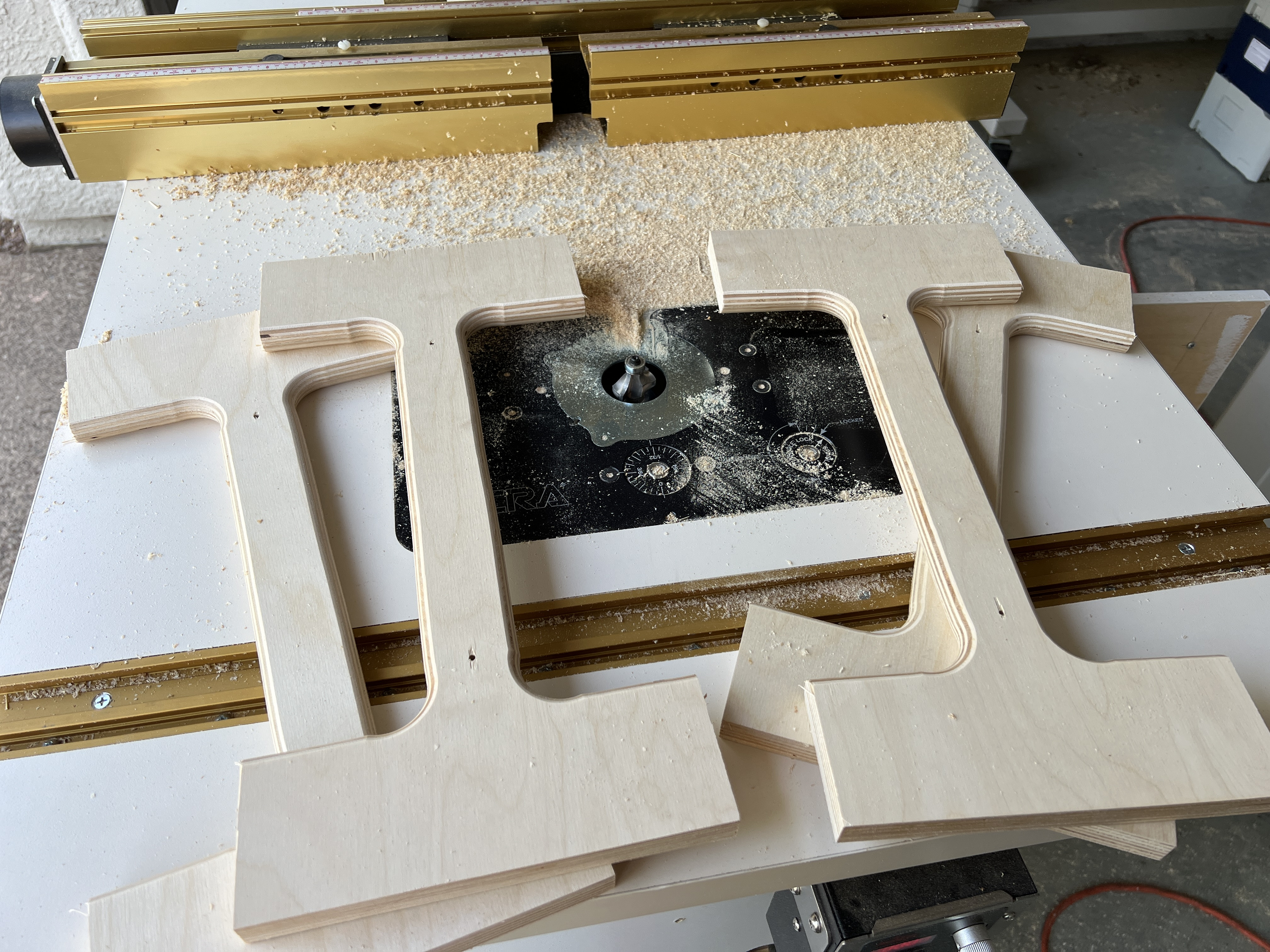

                                                                        More progress!
                                                                        Laying things out...
                                                                        Click image for larger version  Name:	IMG_1145.jpg Views:	0 Size:	2.96 MB ID:	954458

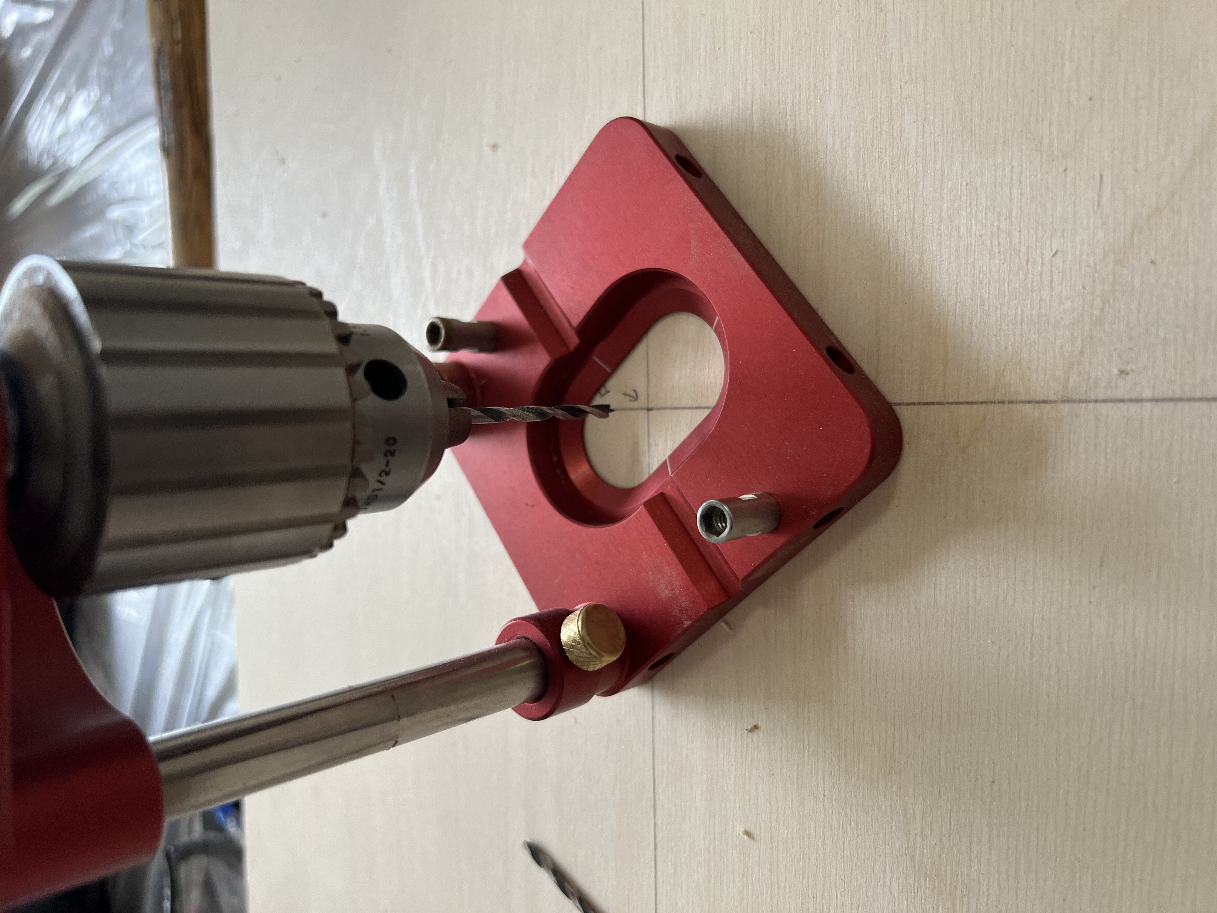

                                                                        Drilling a 1/8" hole...
                                                                        Click image for larger version  Name:	IMG_1155.jpg Views:	0 Size:	2.45 MB ID:	954459
                                                                        Getting everything ready...measuring once, cut twice, right? That's how it goes?
                                                                        Click image for larger version  Name:	IMG_1146.jpg Views:	0 Size:	3.52 MB ID:	954460

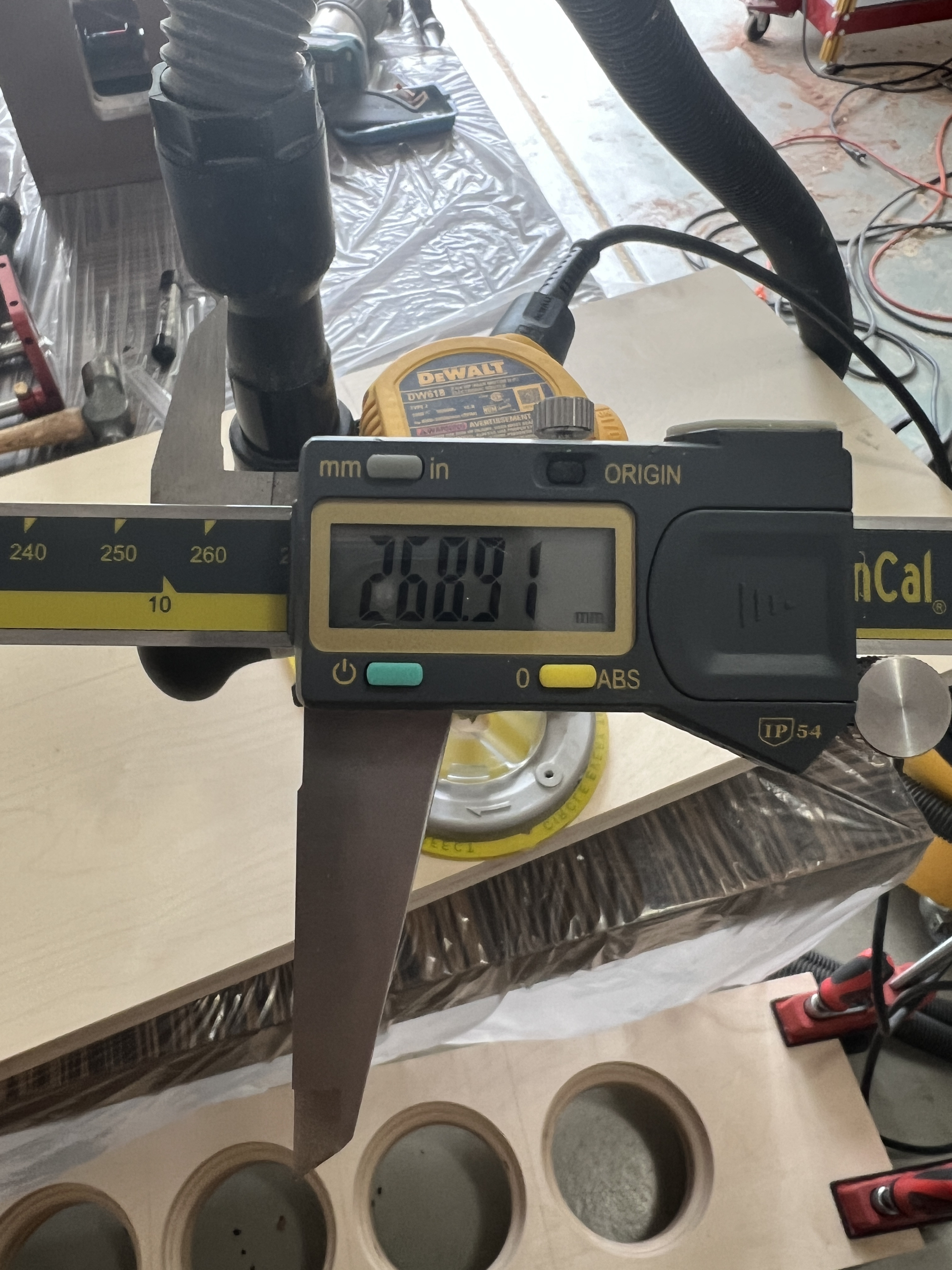

                                                                        PR measure about 266mm, but I need a hair more than that since these will be painted. Looking good...
                                                                        Click image for larger version  Name:	IMG_1150.jpg Views:	0 Size:	1.83 MB ID:	954461

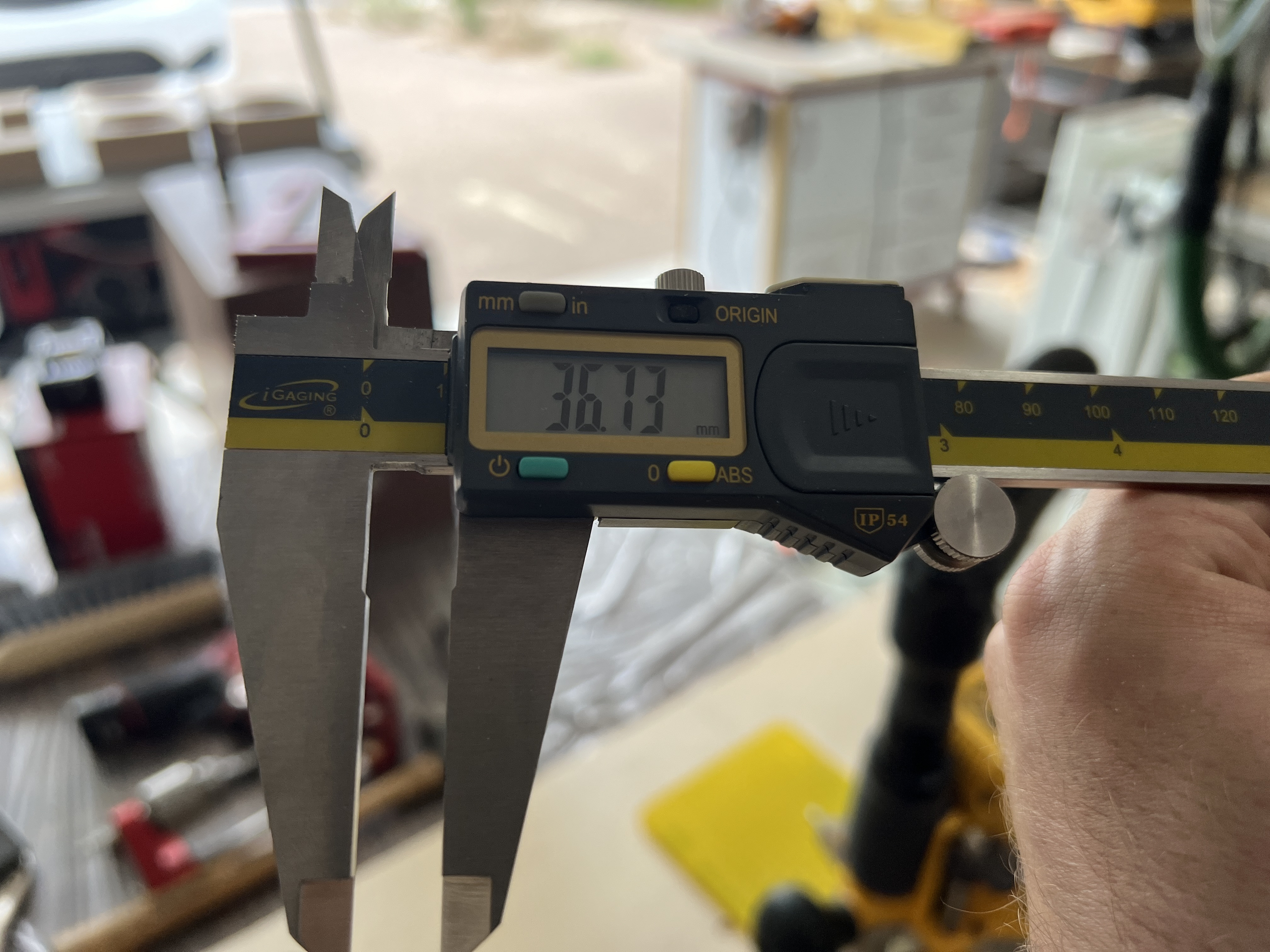

                                                                        PR measure about 36mm thick (according to a busted caliper - otherwise it's around 9), so I needed a full depth hole at my stop point. Going a little deeper...
                                                                        Click image for larger version  Name:	IMG_1151.jpg Views:	0 Size:	3.30 MB ID:	954462
                                                                          • 1554

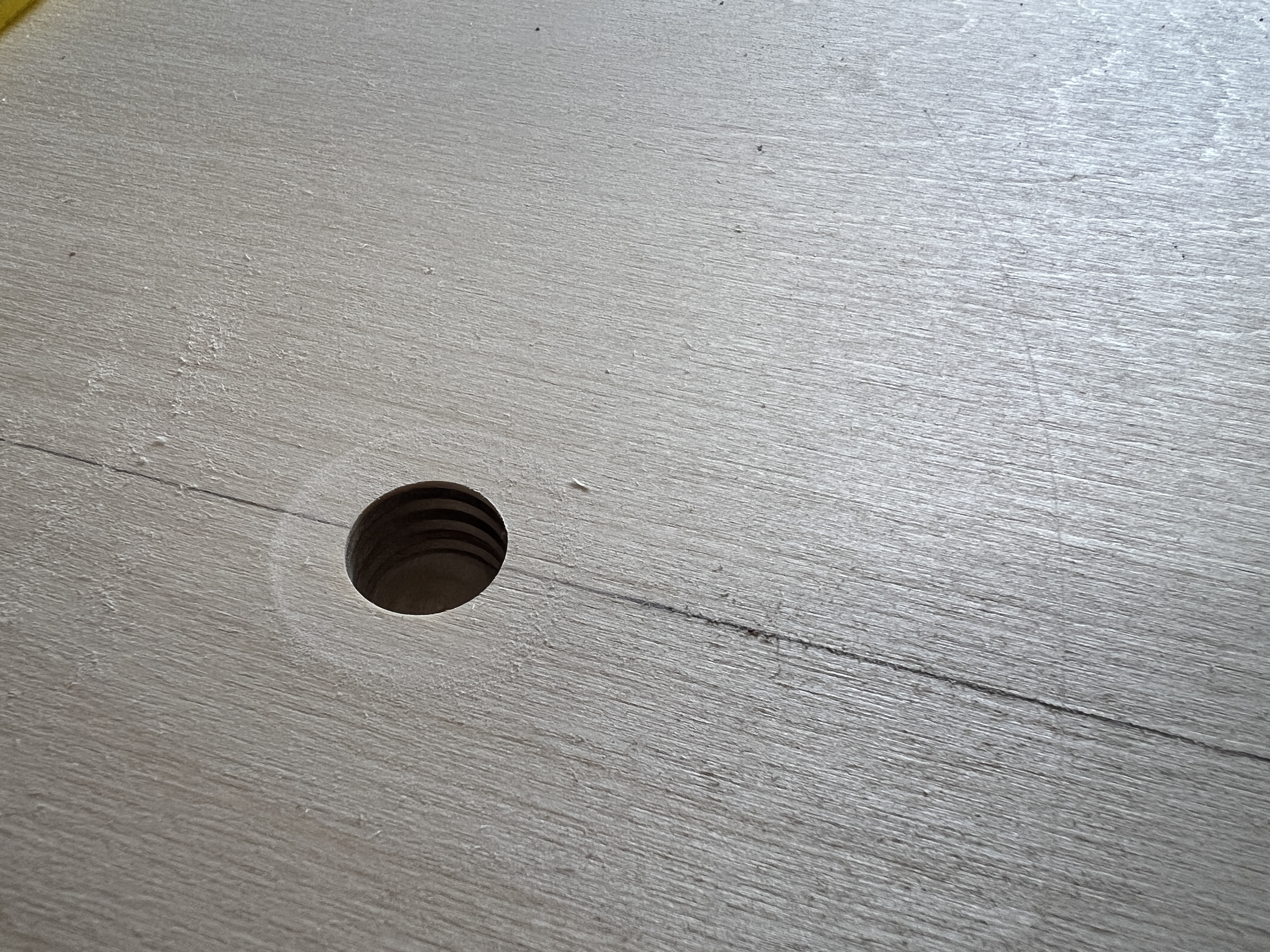

                                                                          Checking hole depth....looking good. Dunno why this thing is reading wrong, but here we are.
                                                                          Click image for larger version  Name:	IMG_1152.jpg Views:	0 Size:	2.48 MB ID:	954464
                                                                          And we have the beginnings of a hole! I probably shouldn't have gone full depth in one pass, got a little tearout here and in others before I started doing a two pass thing. No matter.
                                                                          Click image for larger version  Name:	IMG_1154.jpg Views:	0 Size:	3.19 MB ID:	954465
                                                                            • 16120
                                                                            Hey Danny,
                                                                            How do you like your Digital calipers? I bought one, but then found my original decimal and fractional dial calipers, and I find the latter so much easier to use (color me old school, I suppose!
                                                                              • 1554
                                                                              Hey Danny,
                                                                              I like them enough I suppose, though this is certainly not top of the line. It is, however, large enough to use on larger drivers which is nice. I really like being able to swap between metric and imperial as it can make life easier.
                                                                              Mine must have dust or something in it though, leading to the odd measurements. It only happens at that one spot though - longer measurements are dead on as far as I can tell.
                                                                                • 2135
                                                                                Danny, spray and wipe the body of the calipers down with a good coat of WD40. I had mine (same brand) do the same thing. Fired off an email to manufacturer and that's what they told me to do. Works like a charm, no idea why?
                                                                                  • 16120
                                                                                  Trust the machinist mate.
                                                                                    • 1554
                                                                                    Interesting, that seems to have worked. Thanks Steve!

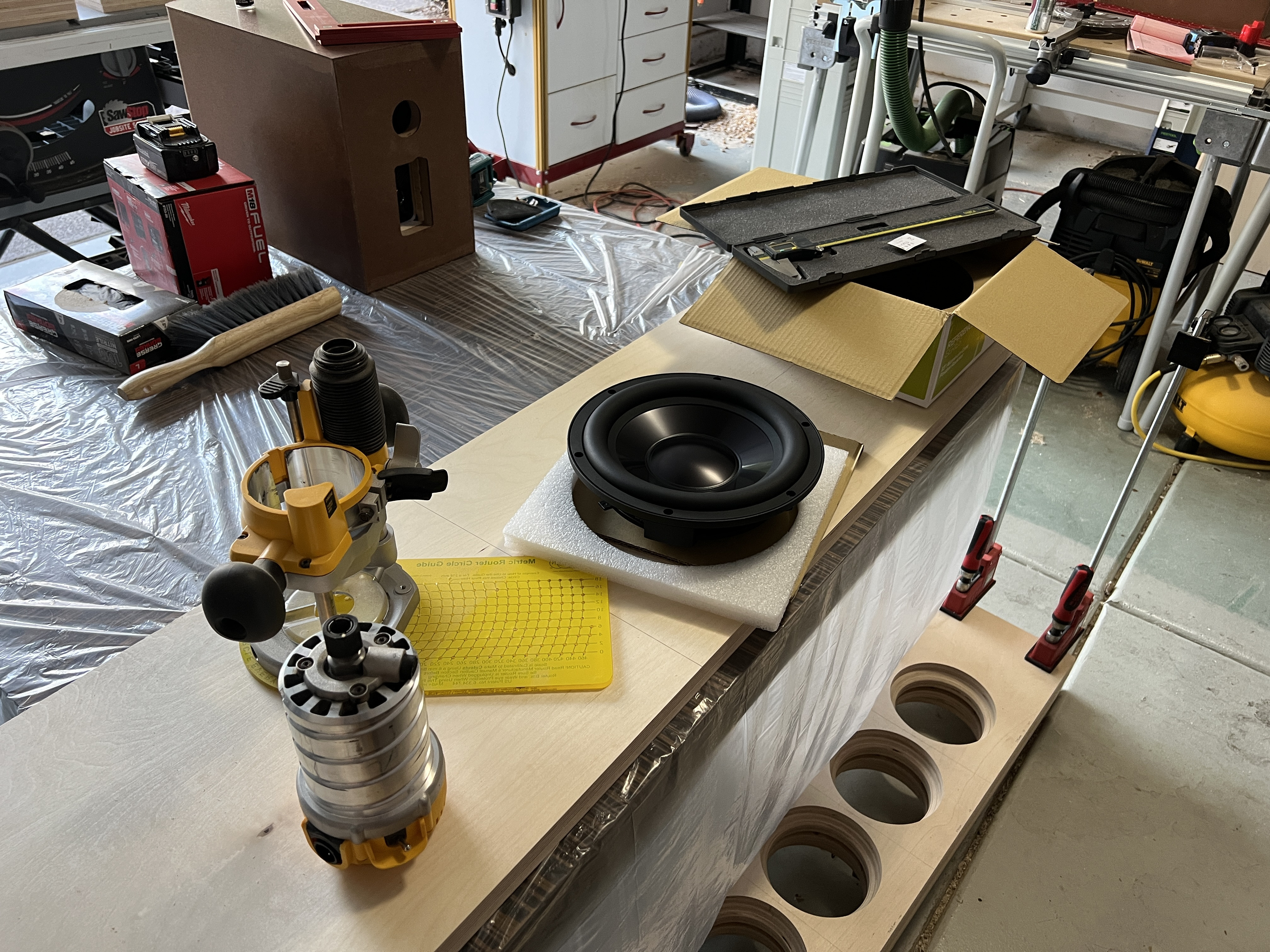

                                                                                      • 1554

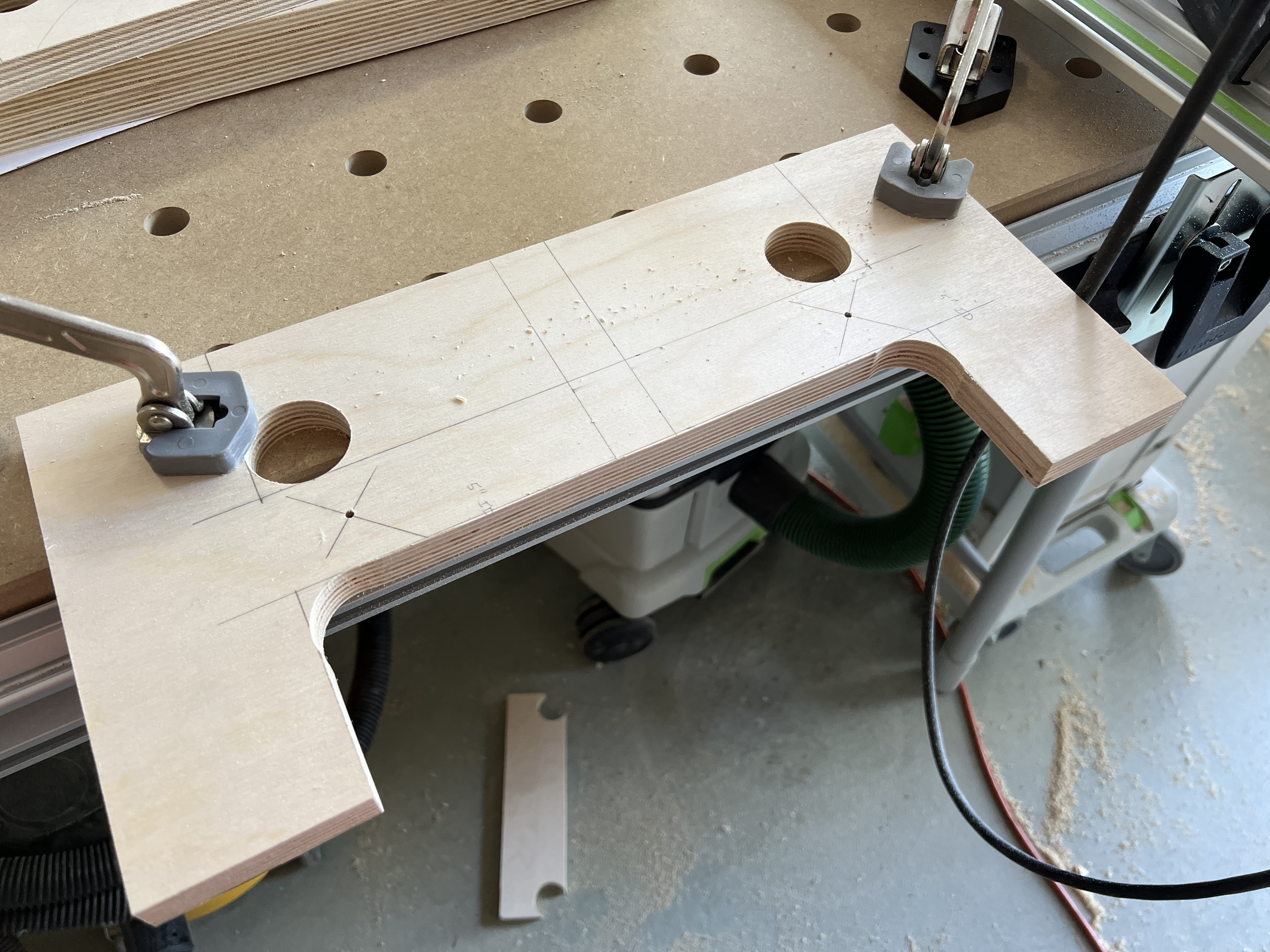

                                                                                      We're starting to get somewhere. I really don't like making holes. I don't know why...maybe just too many times busting a cheap router bit while doing it or something. Either way, it takes me a bit to do this part as I only do 1-2 holes per 'session', though there may be several such sessions per day. This is a big reason I like having Steve help out with multi-element baffles.
                                                                                      Edit: I also tend to do each step "all at once", meaning once I choose the step (in this case, cutting the PR holes) I pretty much stick to doing that until it's done. What I should do is start gluing up braces on the completed sides, but then I have to manage multiple paths simultaneously. While that is technically my day job...I prefer simple and less stress here. Too many times I just wing things and find out that maybe I should have done something else first.
                                                                                      Click image for larger version  Name:	IMG_1163.jpg Views:	0 Size:	3.09 MB ID:	954503
                                                                                        • 1554
                                                                                        First rabbet was complete, so I had to do a test fit....looks pretty good! I see some room for improvement in my workflow but I can't really argue with the end result. Too hot to continue tonight, have to do a few more in the morning.
