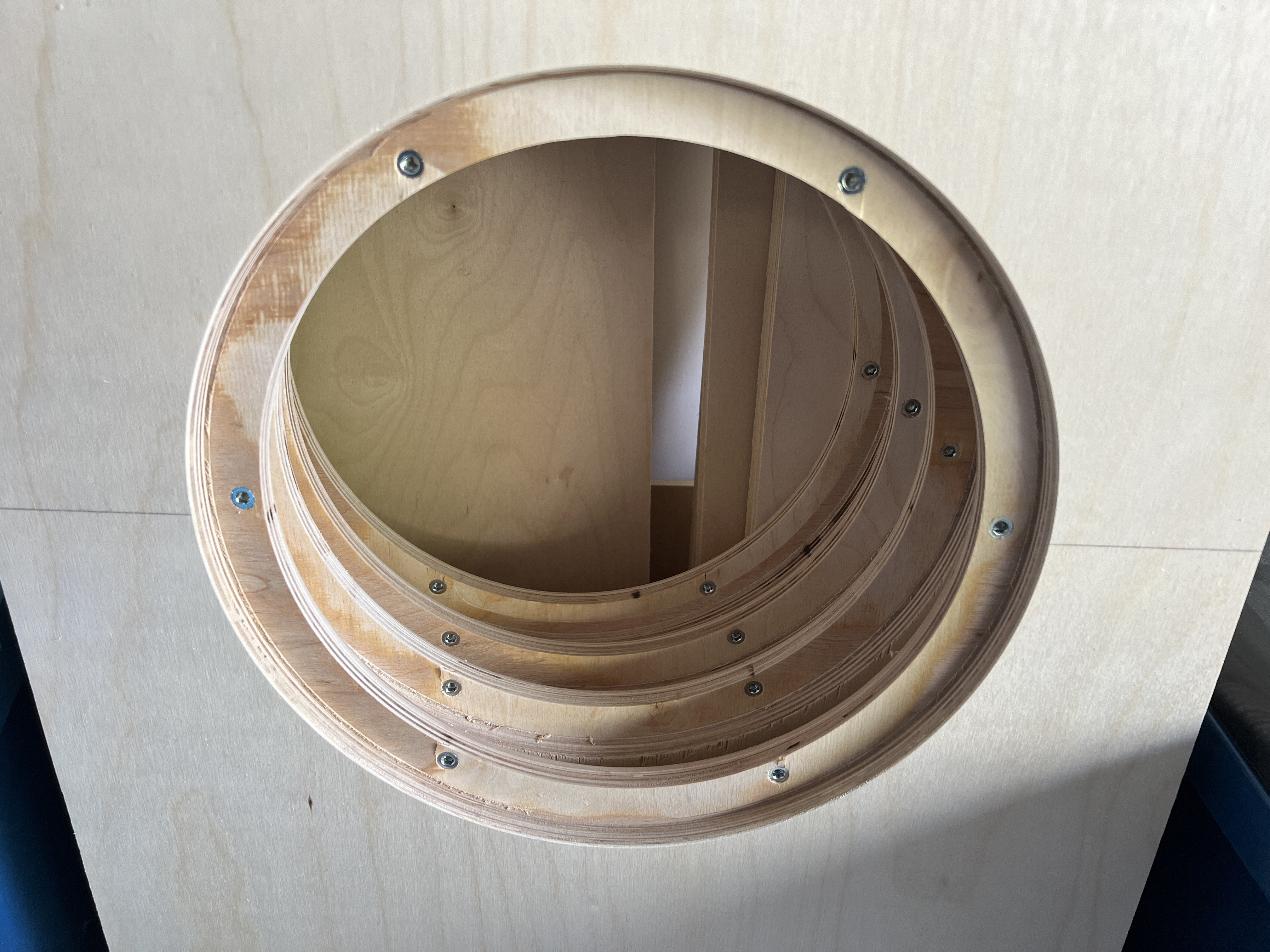

        Sorry about your COVID surprise- there's been quite a resurgence in many states, and that happened to me August last year when Liubov's older son-in-law thought he had a summer cold that wasn't a cold, and his son caught it too and was quite sick in bed for a week. The son-in-law only experienced what he thought was a summer cold because he and his wife had adopted the Pauling Protocol for cardiac care at my reference, and the high levels of vitamin C boost the immune system. I had a very mild case from them, over in 3 days from when symptoms started. Much milder than what my friends report this summer with their summer colds- but then I do not get summer colds, or any kind of colds, and I've been on the Pauling Protocol about 20 years.

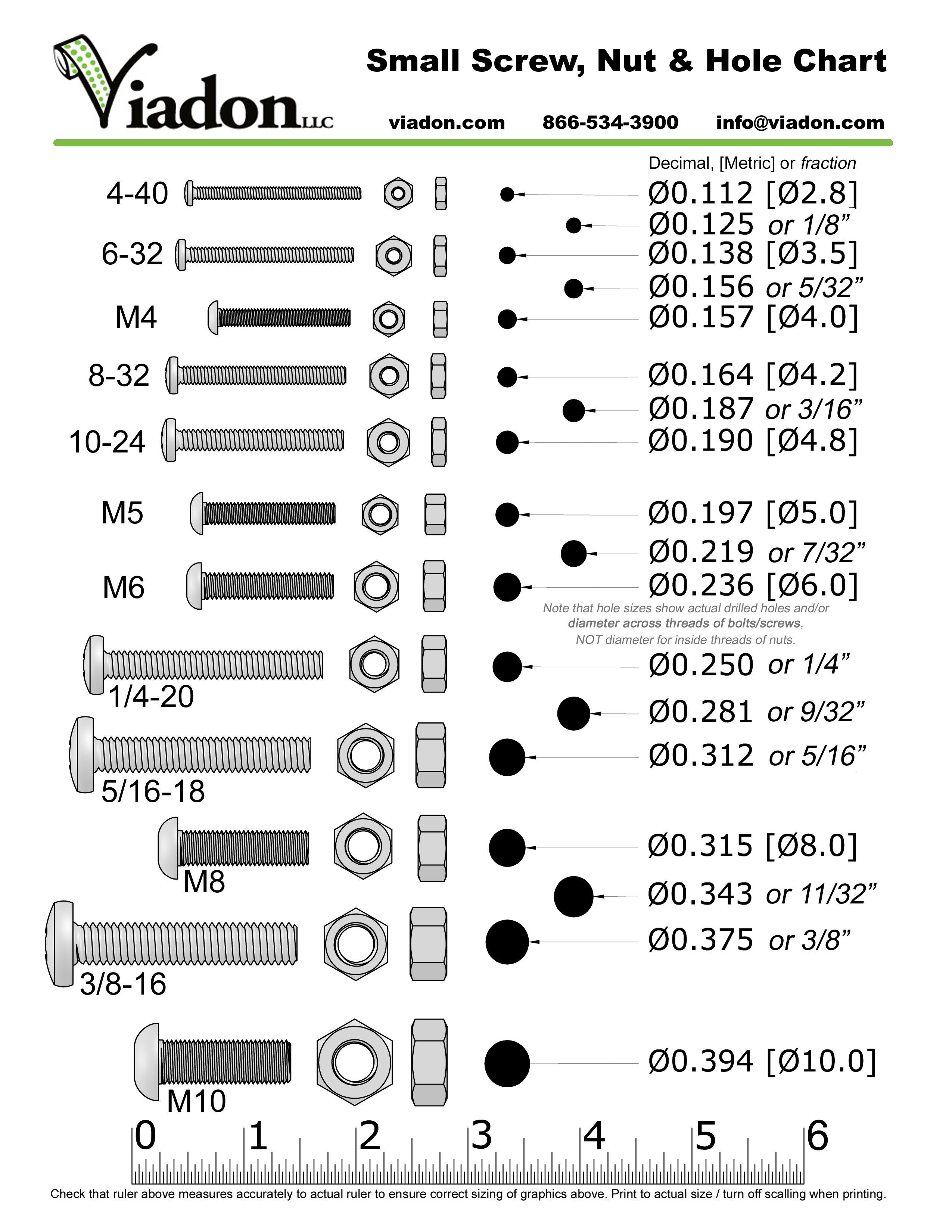

        One of the "drawbacks" in my opinion about the EZ-Lok inserts is their relatively large diameter and drill hole. This is specifically why I selected Rampa, especially for the RSS210HF woofers, as they have a relatively narrow mounting flange, and this would result in breakout with an 8-32 insert. I like this guide for working out the issues.
Name:	Viadon Guide.jpg

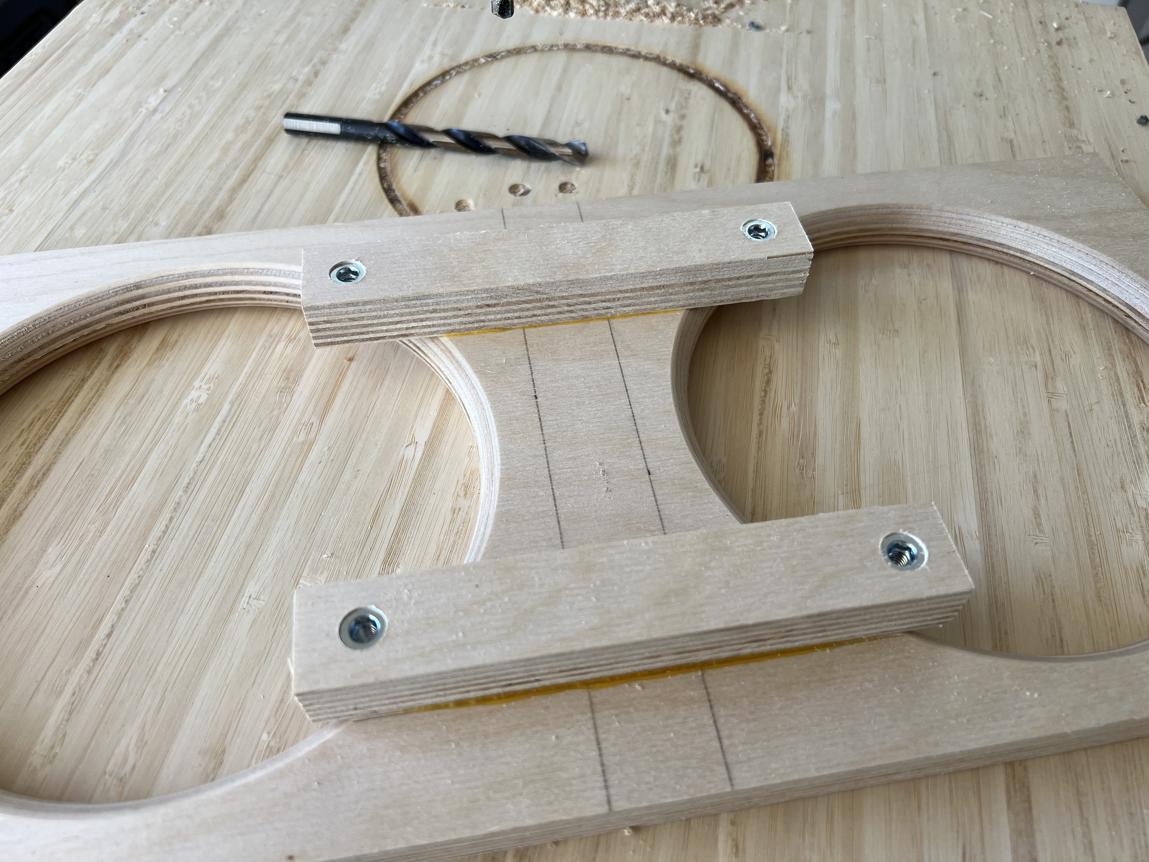

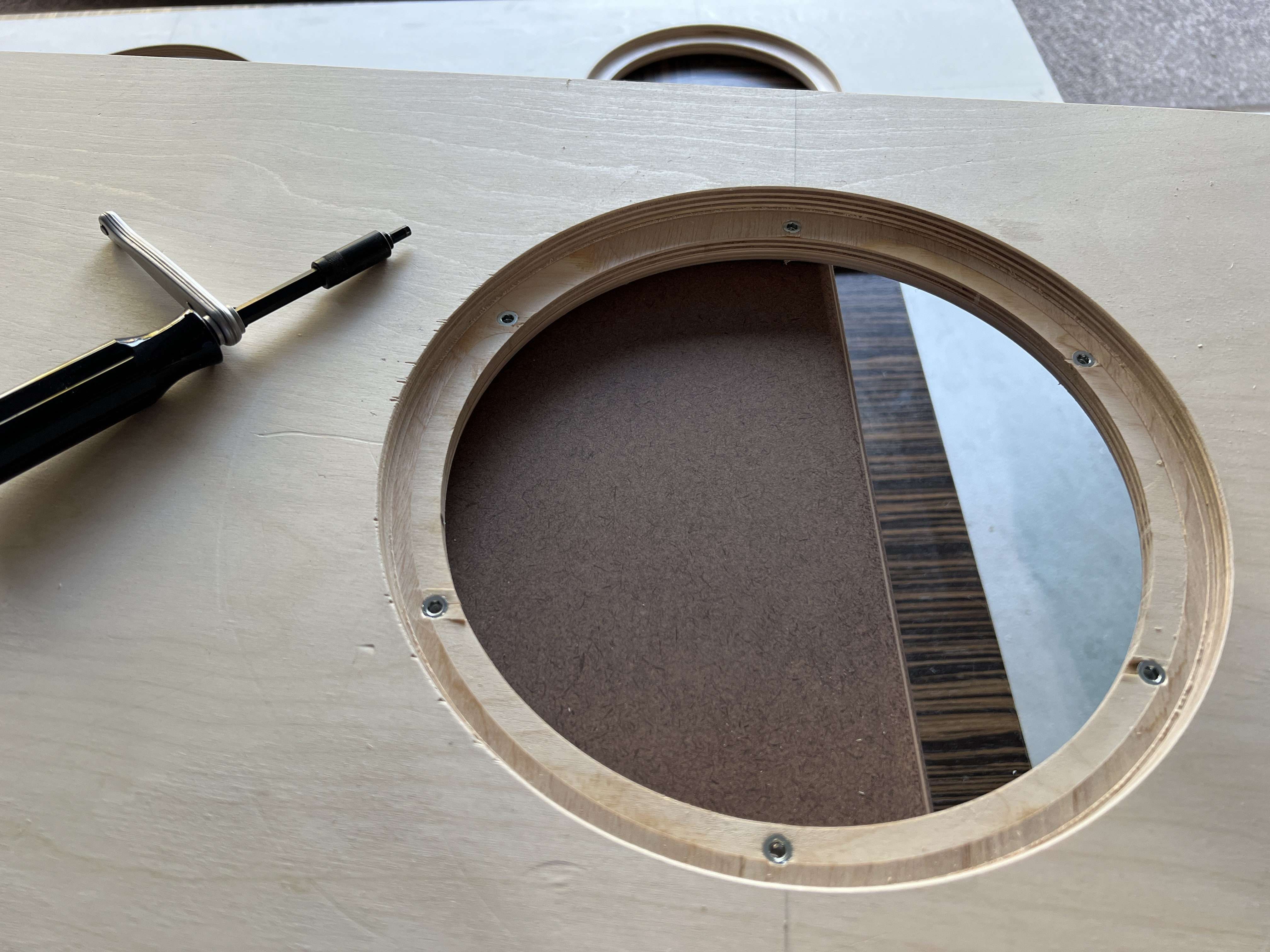

            Minor progress this morning. Rampa inserts came late yesterday. I tested a few out and elected to go with a 1/4" bit for installation (8-32 inserts). Still got a little tearout but nothing too bad. Only did the one PR cutout so far...still not feeling quite right, I think I might have rushed back to work a little too quickly. Will do it piecemeal, which is probably best for my hands since I'm not using a drill to install these.
            Found a use for my Chapman master set though, the ratchet makes things a bit easier once the inserts are started.

                Inserts. I might be wrong, but I think the threads might be sharper on the EZ-Lok inserts. I'm not sure it'd matter with baltic birch though, that top layer just likes to rise up when threaded into.
                It'll all be hidden though, so it won't matter. This particular cutout was also done slightly differently than all the others - I tried a few things before settling on how to do it cleanly, so things weren't going to be quite as flush as they will be on the others. I do like the flange helping to hide the hole on the Rampa inserts.
                I also did not use CA glue on any of these six. I don't think it's necessary actually, they're pretty darn snug.

                  Danny something that helps with the tear is to chamfer the hole after drilling. Doesn't have to be very deep and the flange on the inserts sits nicely below the surface of the wood.

                    Thanks Steve, I was considering that as a possibility.

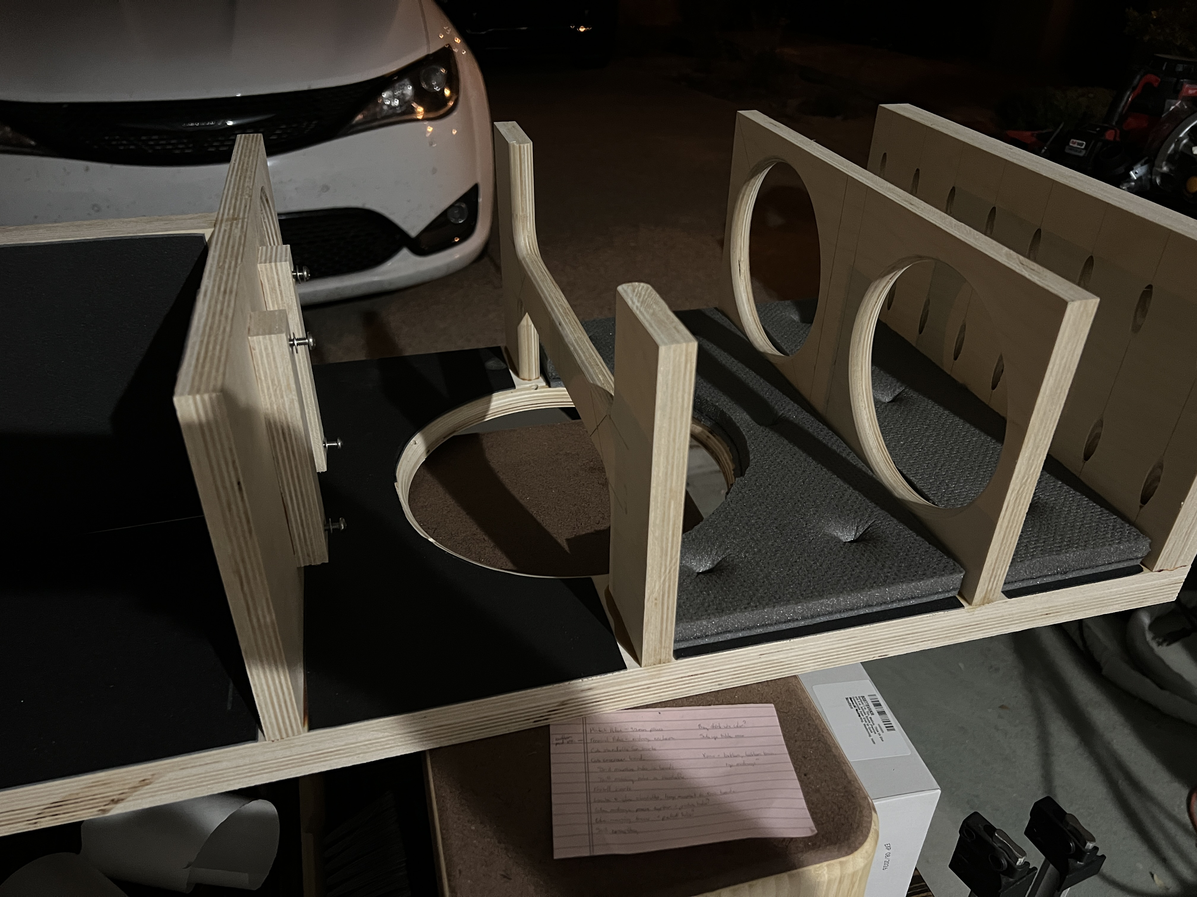

                        Lots of clamps and screws/dominos might do it. You need alignment and some holding power.
                        this is also why I like using the tongue and groove bits. They align and add a bit of strength because of the surface area.

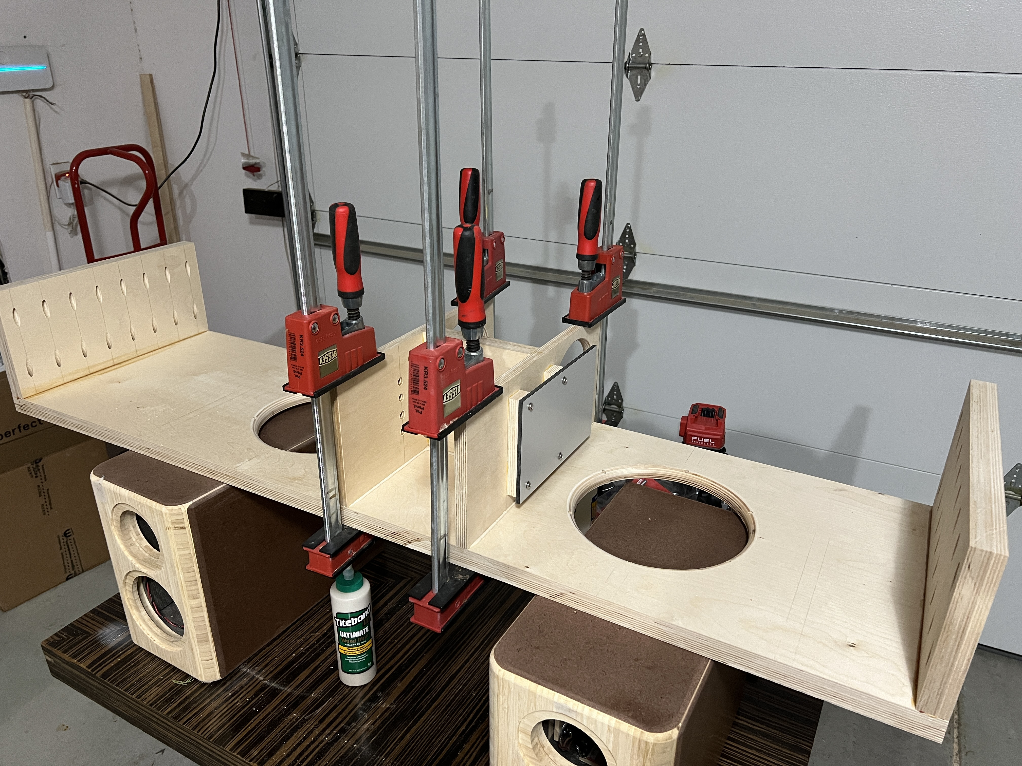

                          So I thought about your comment for a while and elected to go with screws to keep everything somewhat aligned and, more importantly, pull it all together. I do have a Domino that sees way too little use, but I'm not sure it would help much with my issue right now. My tentative plan here is to use pocket holes/screws for all braces that I think I can reach with a right angle drill once the second side goes on, especially for the top, bottom, and rear of the mid enclosure as these are thicker pieces of wood (~30mm). I'll add wood glue to each hole to keep the screws from shifting later. Wood glue (Titebond III, in this case) will also be used for each joint, of course.

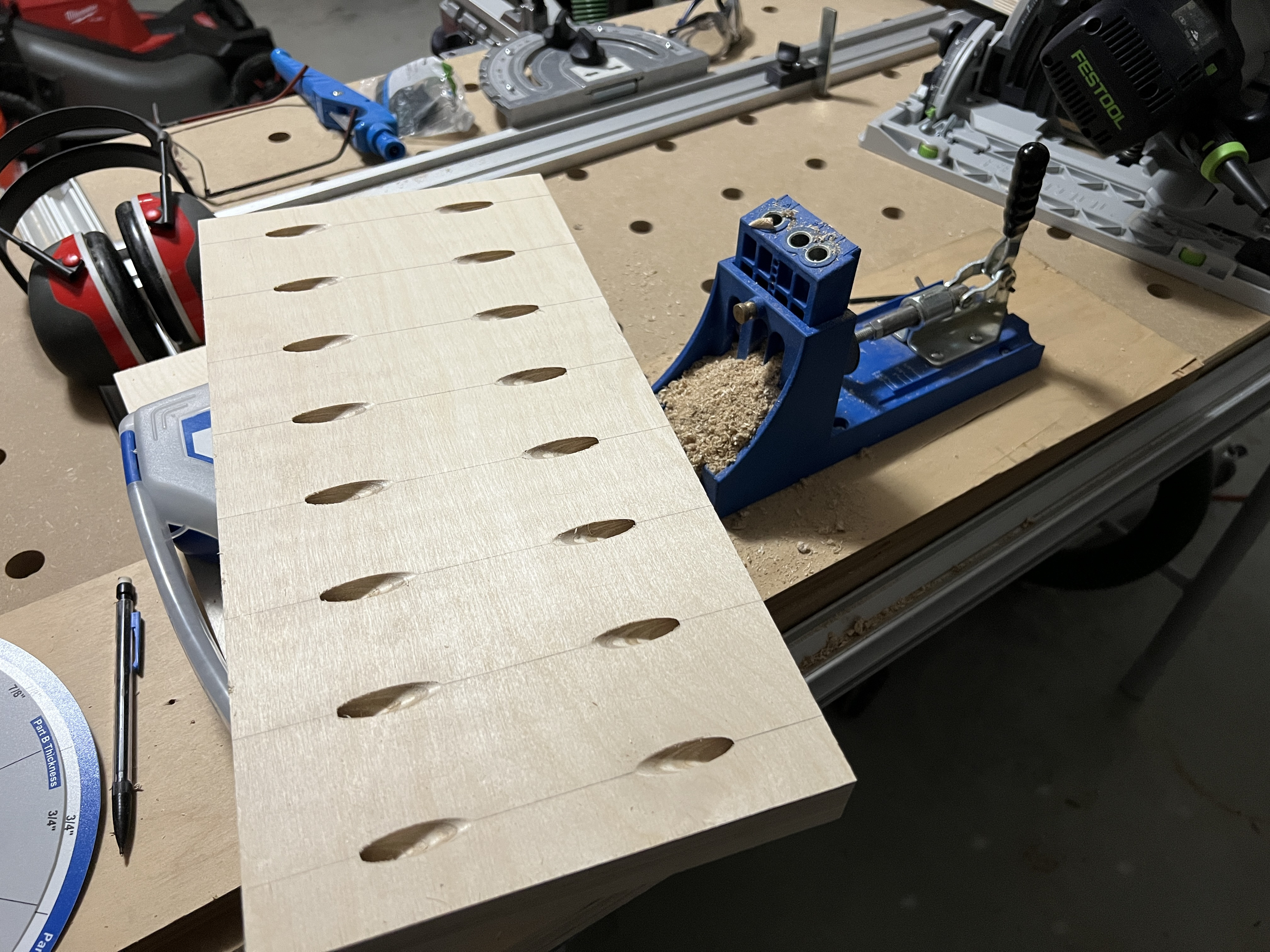

                          Something that would have been helpful would be to avoid straight butt joints for these areas, but it's too late now unless I wanted to make new braces and rabbets in the sides....which I don't.

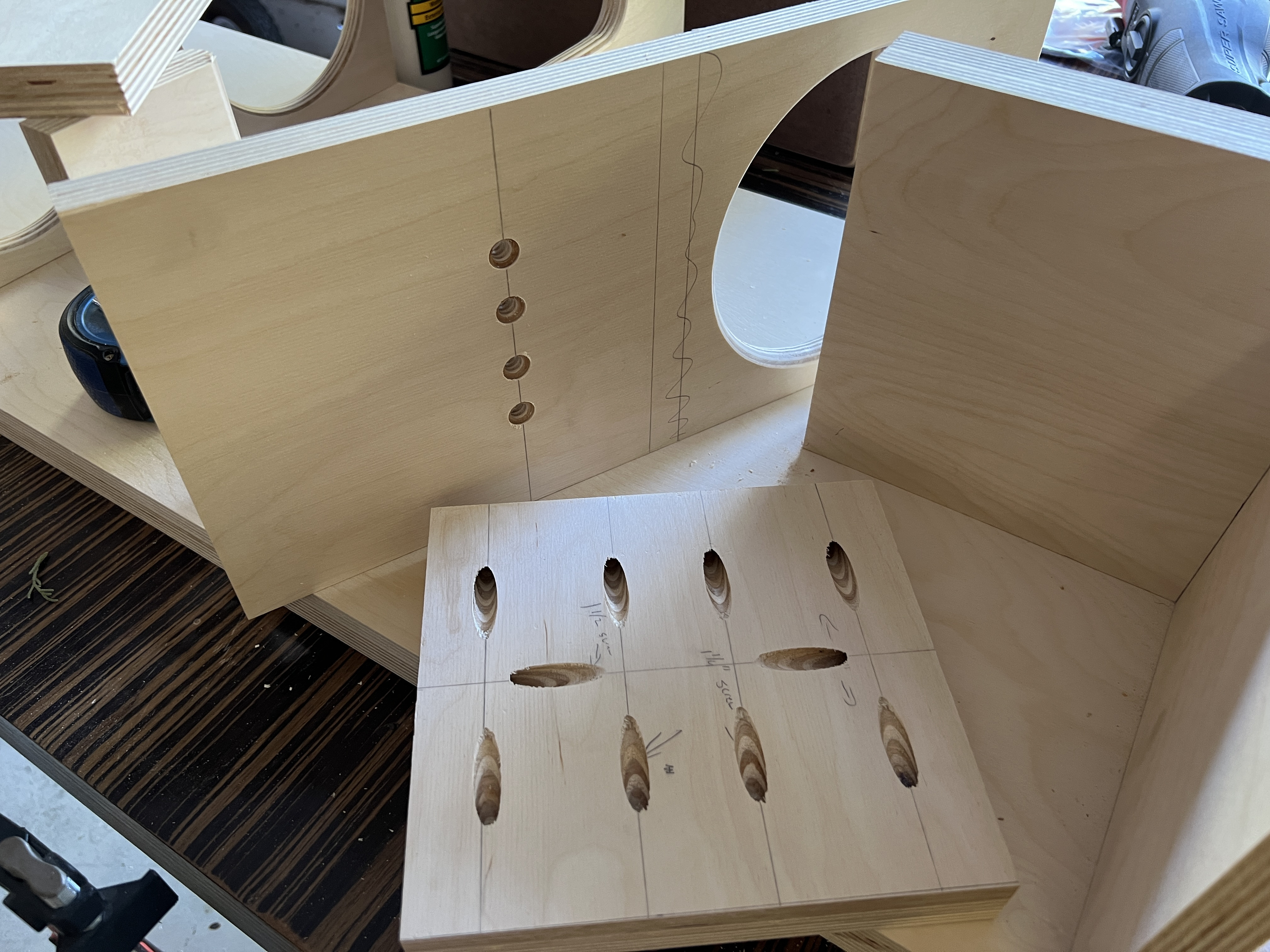

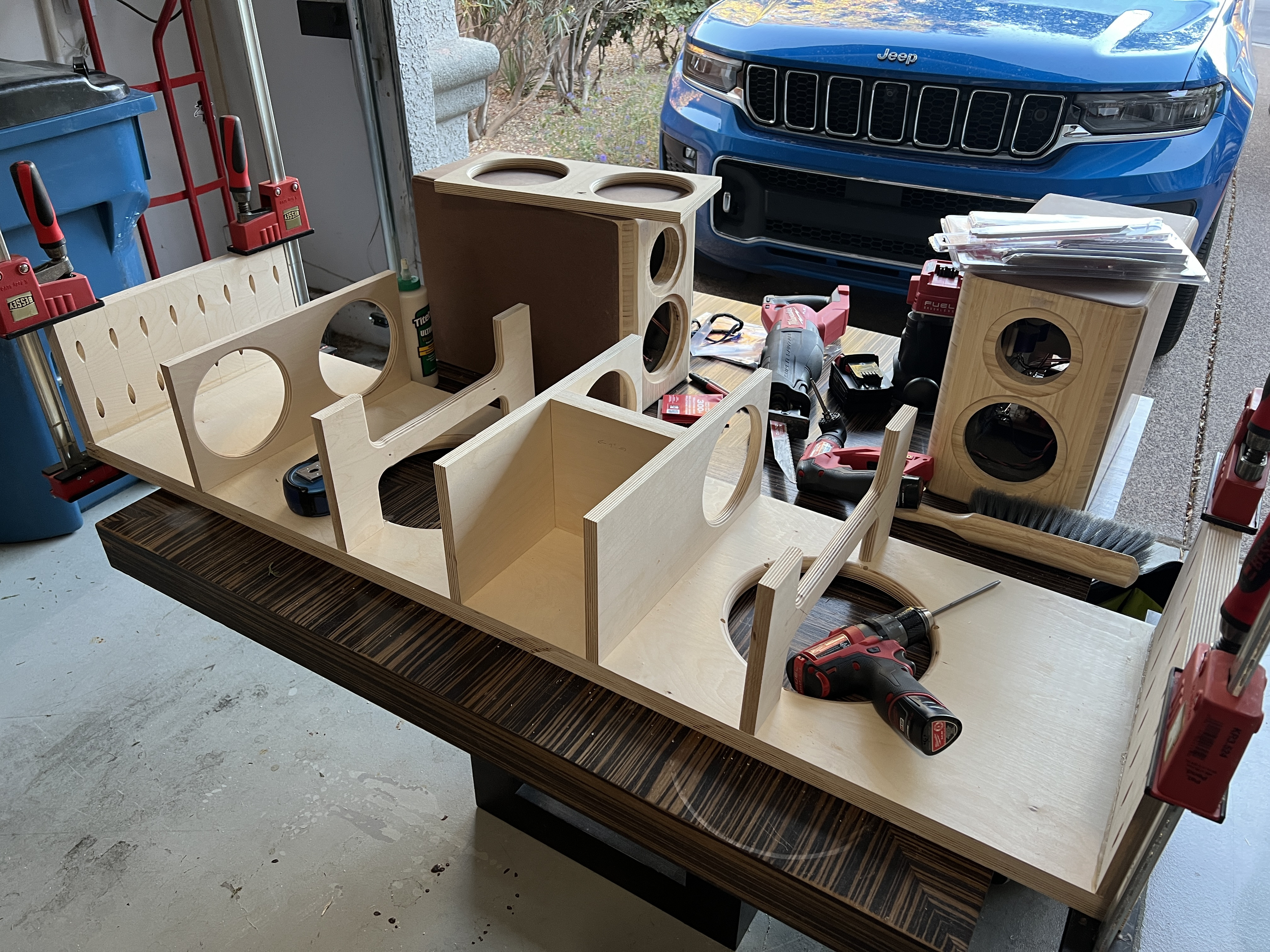

                          Jotting down order of operations here for myself as I'm paranoid I'll forget something until after the glue sets.
                          1. Locate and drill out pocket holes in all braces top to bottom. Note that two different setups will be needed depending on the thickness of the material (30mm vs 18mm), which means a different length screw may be required for each.
                          2. Consider locating and drilling out a few pocket screw locations for adhering the baffles as well since they are also a bit out of square. Test to see if a drill could even reach these locations prior to drilling.

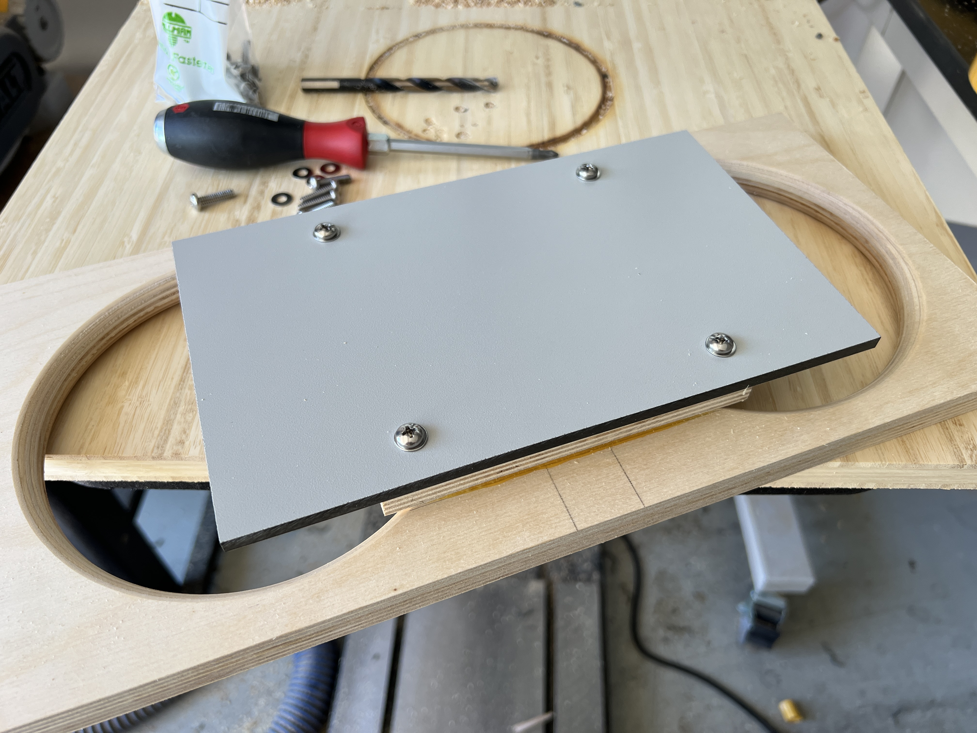

                          3. Locate and place standoffs and inserts for crossover locations. Best guess as to size of crossovers? Big.
                          4. Locate and drill out/countersink holes for mid enclosure terminals.
                          5. Consider placement of phenolic plates in key locations. Leaning towards 'none' for this project, but perhaps for the mid enclosure. Remember to leave room for crossover inserts/standoffs and drivers if necessary.
                          6. Glue braces to one side, be sure to add glue to screw holes.
                          7. Place denim filling on one side, leave room near drivers to breathe.
                          8. Glue other side to braces.
                          9. Add denim filling to other side.
                          • Scareurpasenger

                            Be careful with the pocket holes, they like to pull out of alignment. You need to clamp the really good and then screw them. The Dominos are great at helping with this.
                            i had 2 sheets of plywood that was bowed. Lots of fun trying to make it usable for projects!
                              • 1554
                              #104
                              Yeah, the plan is to clamp in place without glue and get a few started, then unscrew and glue for real. Always with clamps!

                                        There is glue! Lots of work I'm hoping to get done this weekend, but time is at a premium. We shall see how it goes.
                                        Click image for larger version  Name:	IMG_1192.jpg Views:	0 Size:	3.39 MB ID:	954797

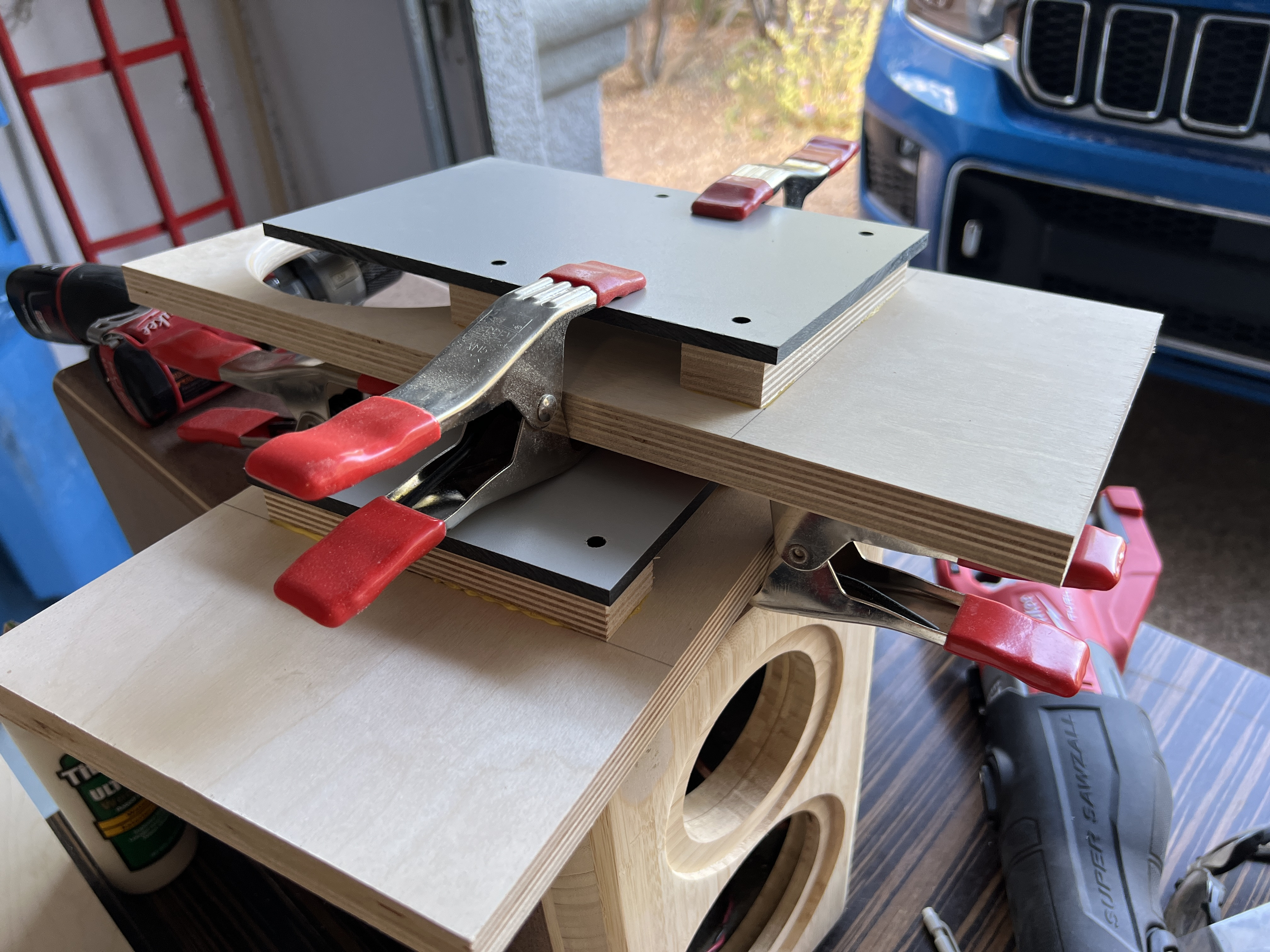

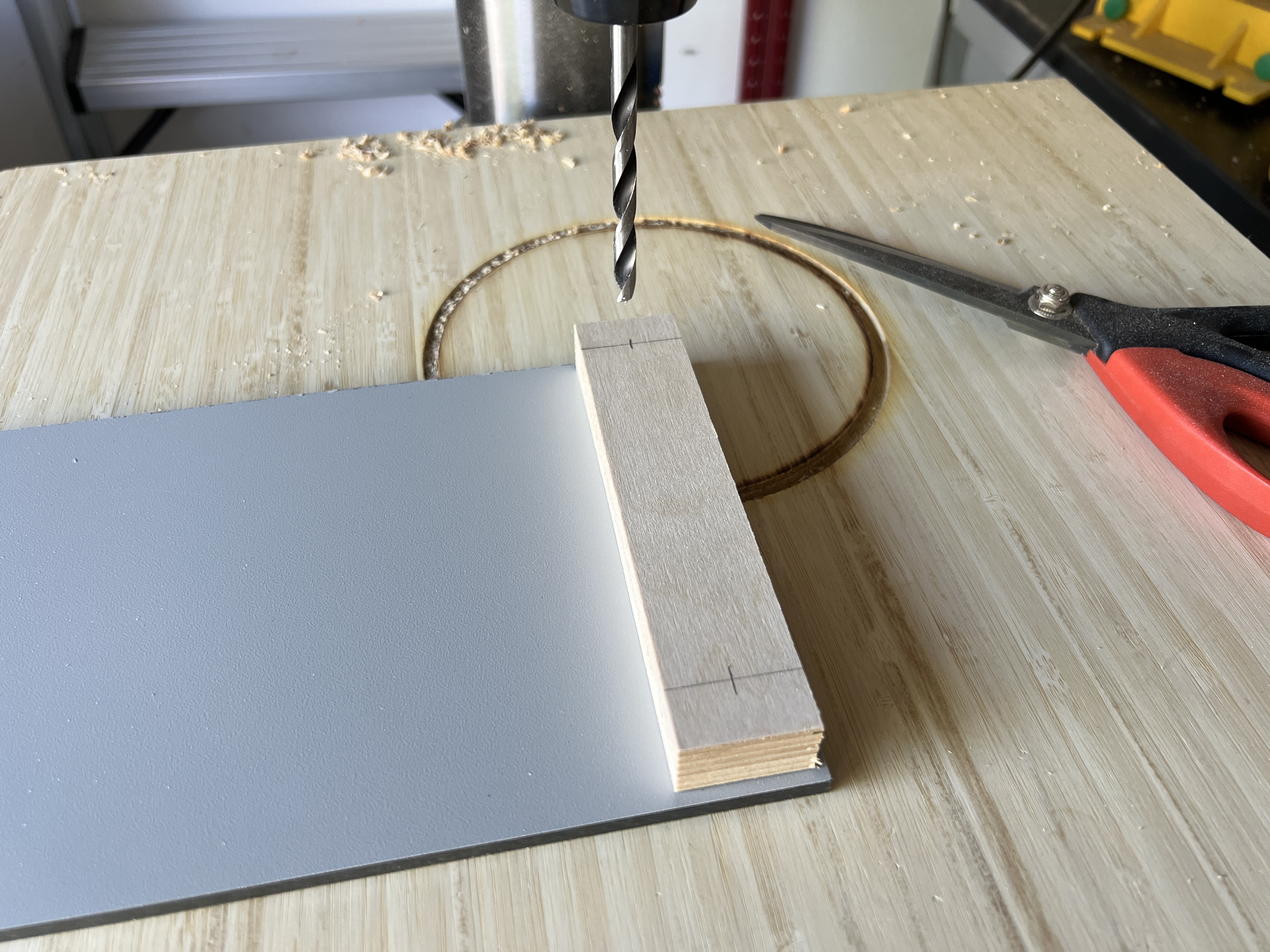

                                        More progress, but no glue today. Maybe later. Terminal cut outs for the coax enclosure have been made, as have crossover boards and standoffs for them. Still have two sets of standoffs to drill out once I make a decision on the placement of the third panel (should I need it). Double sided carpenter's tape worked great here - I'm leaving them stuck on to ensure they match when I drill out the wood and install inserts later. Need to hit Ace and grab some bolts and washers for this as well.

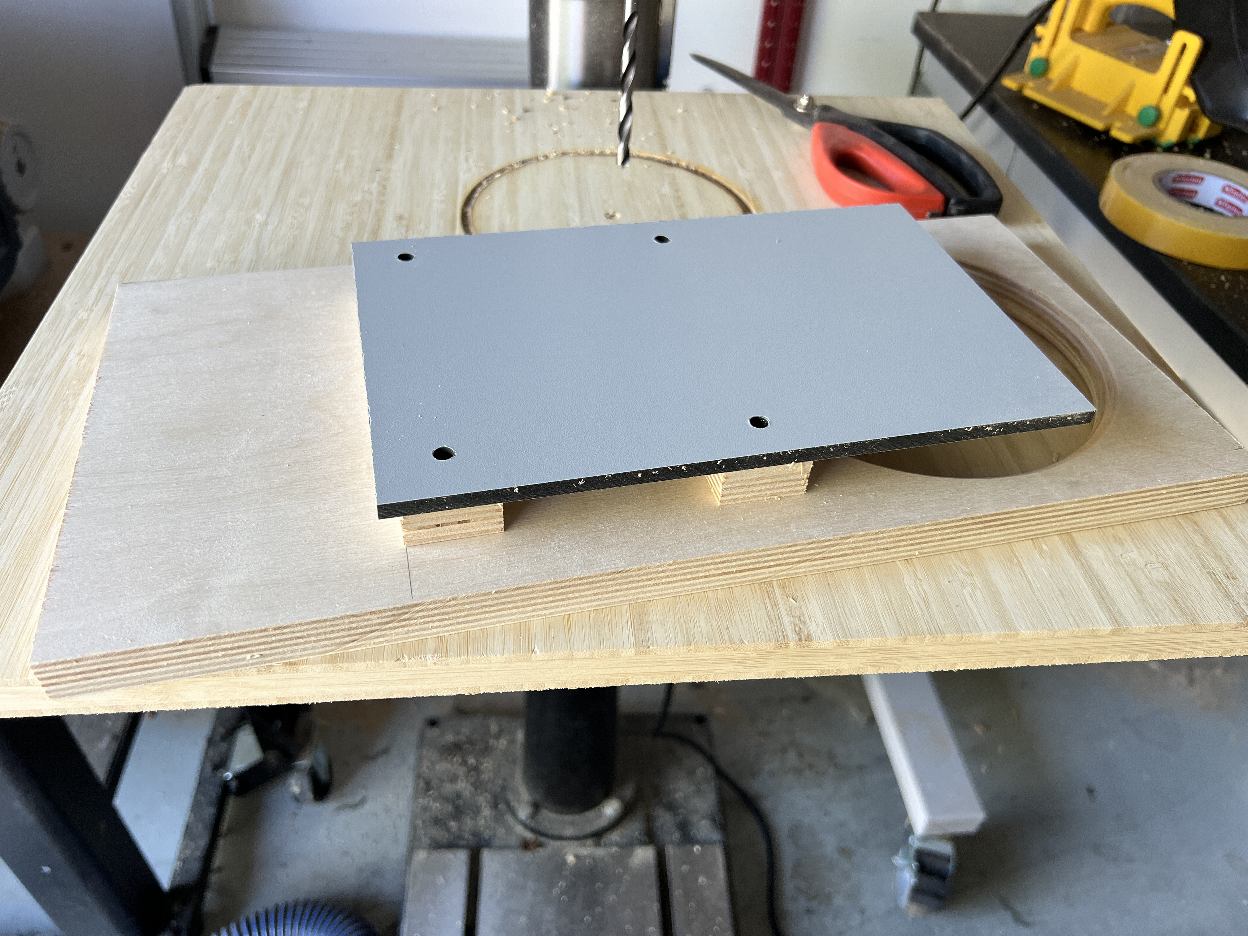

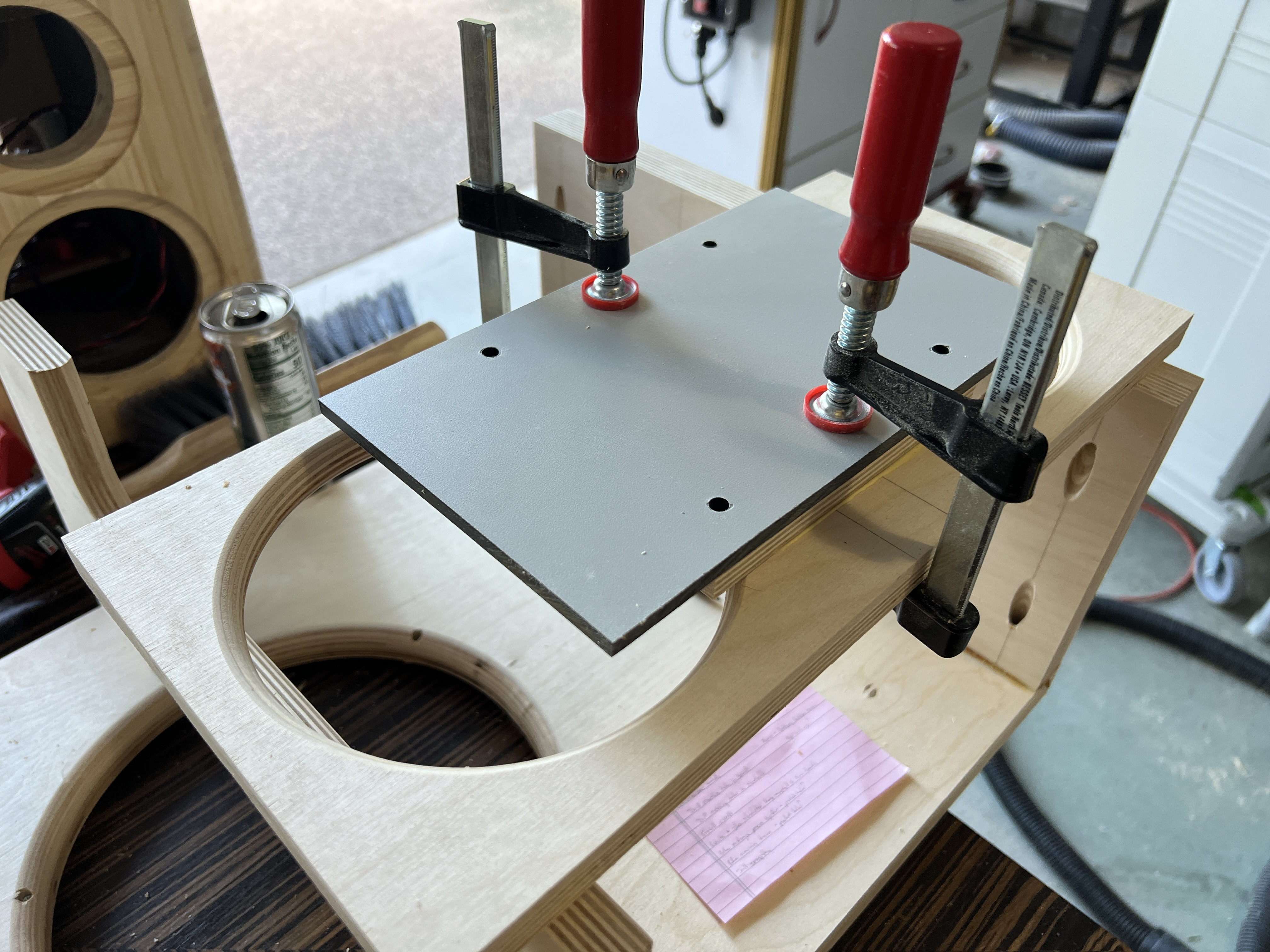

                                        I completed the crossover boards and standoffs, just need to add the inserts for the other speaker at some point. I'm moving forward with speaker #1 though as it is the priority. Coax enclosure is currently being glued to the one side right now. Should be able to knock out a few more braces later today. I'm running low on appropriate clamps so I'm a bit limited - four of my eight 24" parallel clamps are being used to control movement of the baffles right now, and the other parallel clamps I have are 50" long and a bit unwieldy for small jobs.
                                        Regarding the inserts - I was a bit nervous about placing these in such small boards, so I made several attempts in a scrap piece to get them right. As usual, Steve was correct. I ended up using a totally inappropriate bit to widen the top of each hole and it prevented the ply from separating.

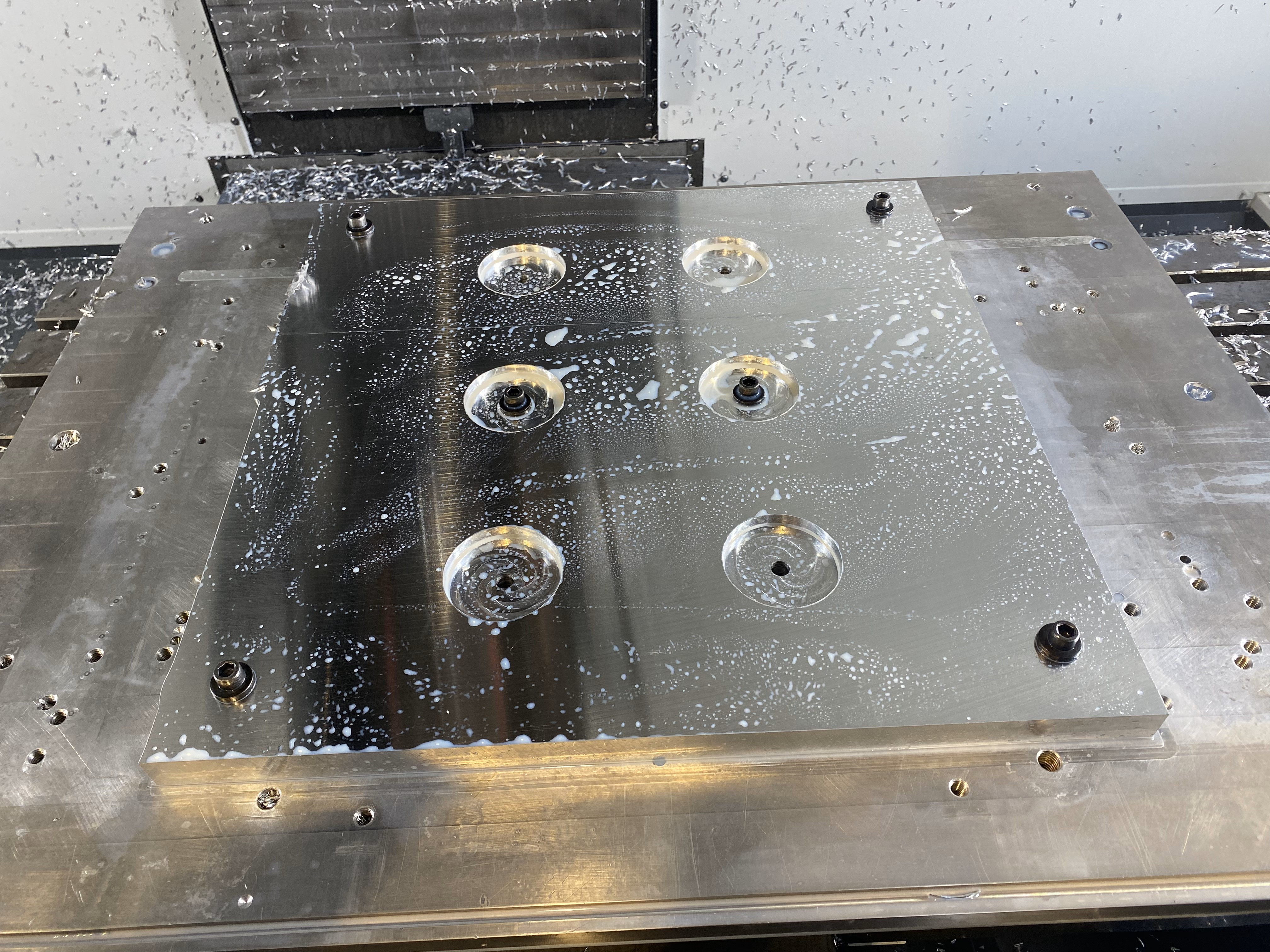

                                        Received the final quote for the CNC parts, much better than the first ballpark I received though does not include anodization or finishing of any kind. I'll have to get that done locally. That's fine. This will be done at a CNC shop in Iowa - my mother is the accountant for a small-ish CNC firm there and got me in touch with her boss. No shipping since I'll be going there anyway in a few weeks time!
                                          • 1554

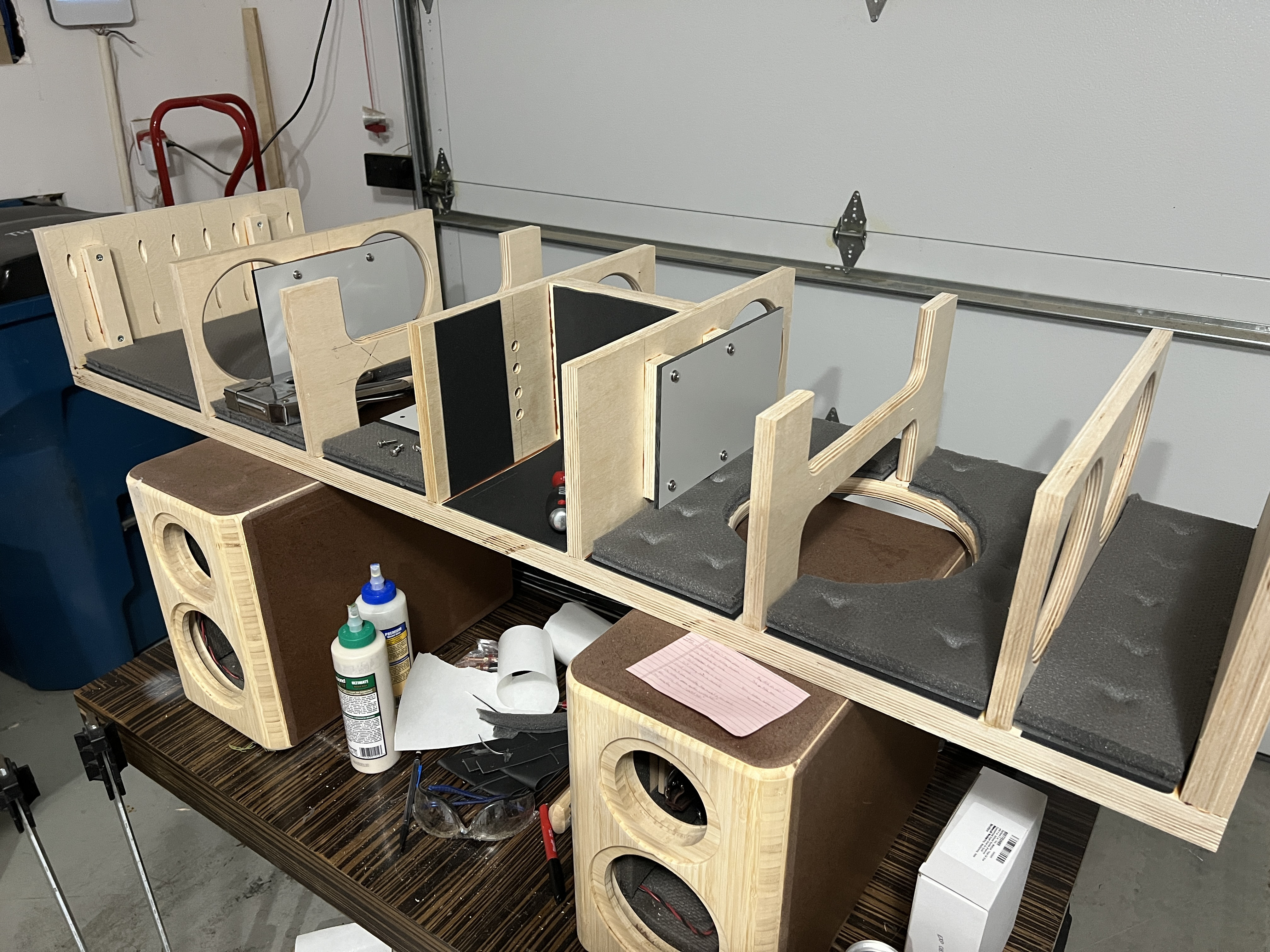

                                          Things are accelerating a bit now that I have the crossover mounts figured out. That took me a bit to reconcile.
                                          I ordered a bunch of foam and vinyl from Parts Express yesterday, should be here Thursday. I was wanting to use the denim I already have but its thickness is prohibitive for the side walls due to the placement of the crossovers - it would just intrude too much. Sonic Barrier has been acceptable in the past so I'll use that for the sides then the denim for the rear (and maybe the coax enclosure).
                                          Click image for larger version  Name:	IMG_1202.jpg Views:	1 Size:	3.14 MB ID:	954832

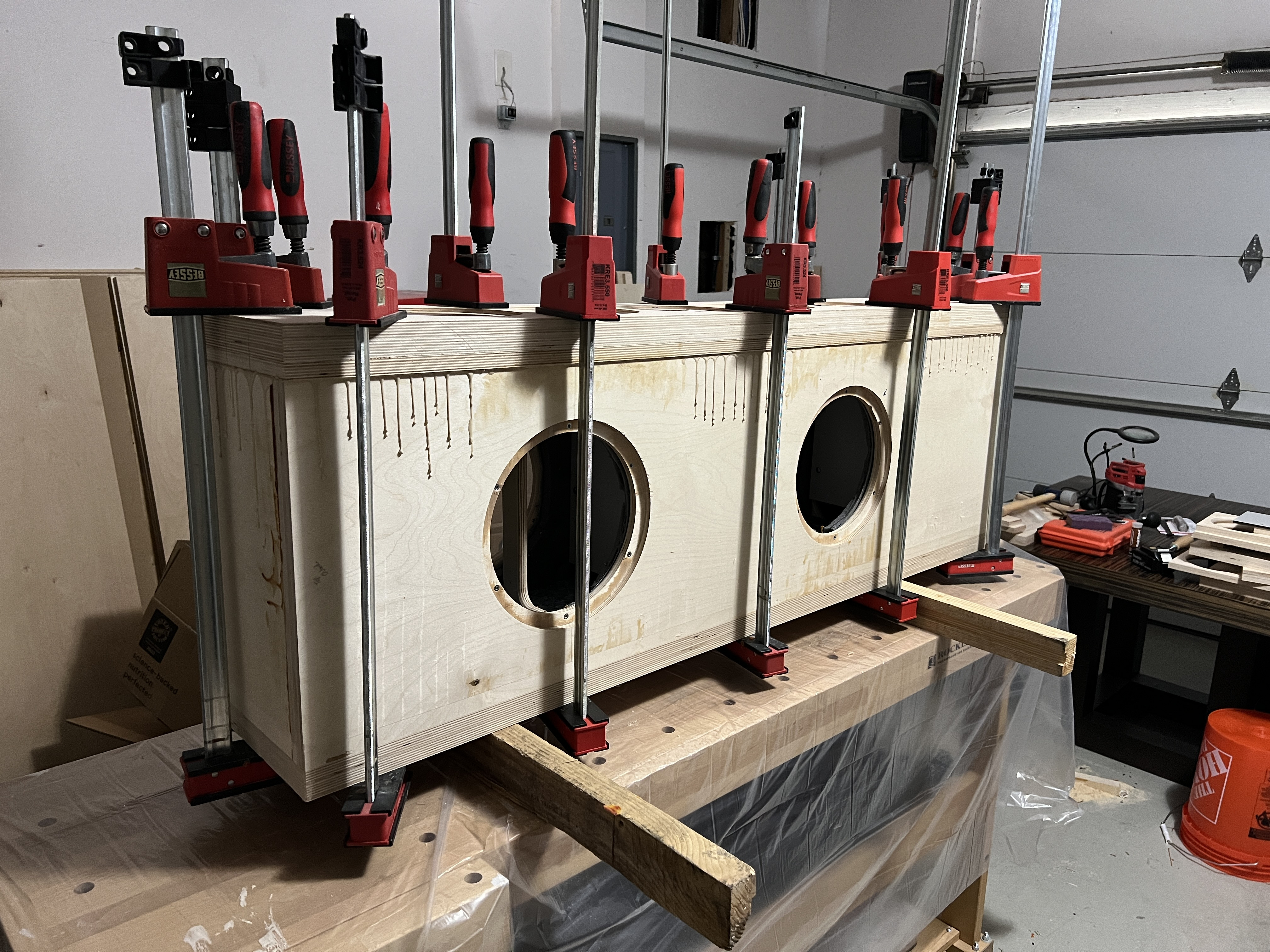

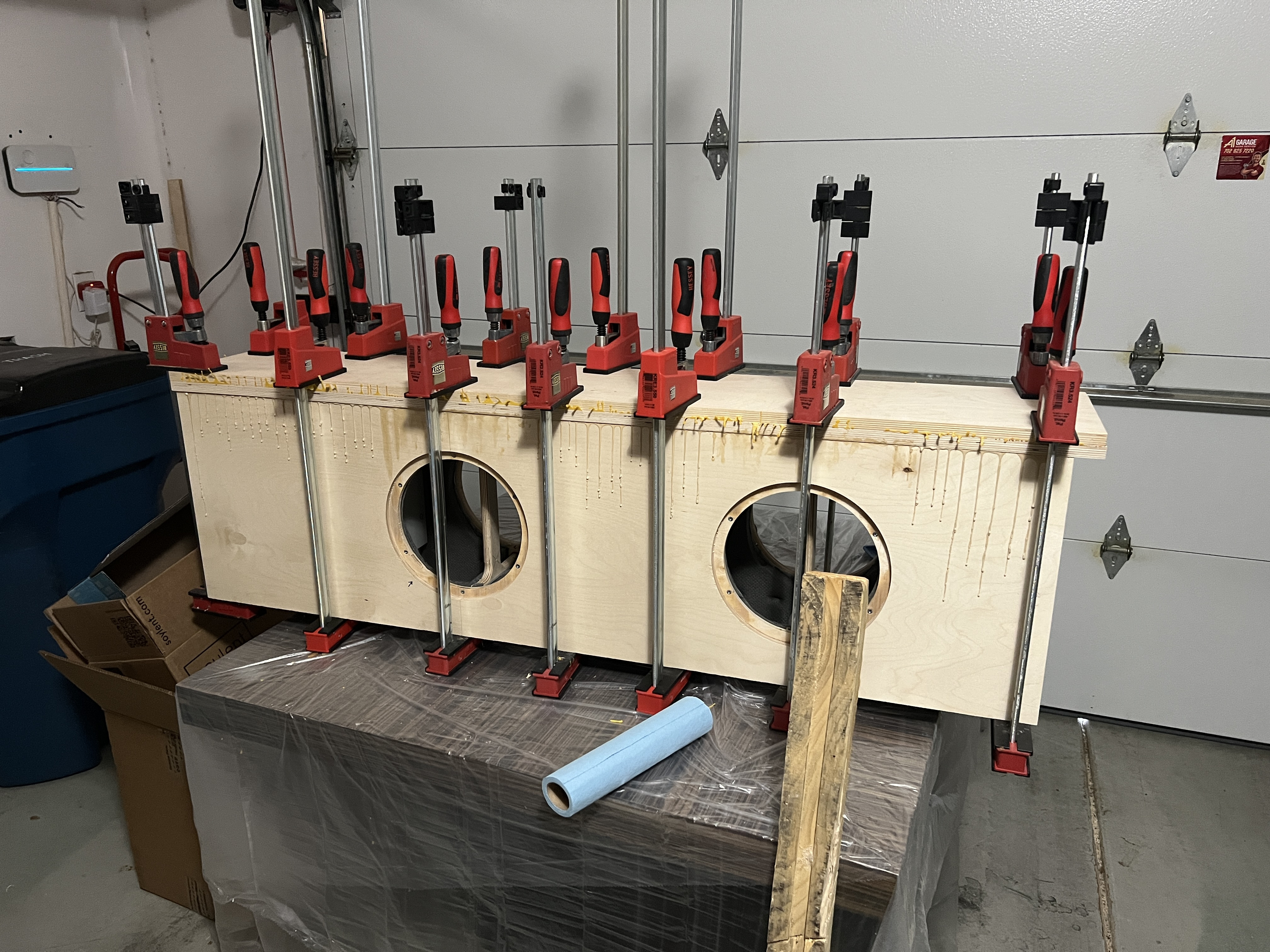

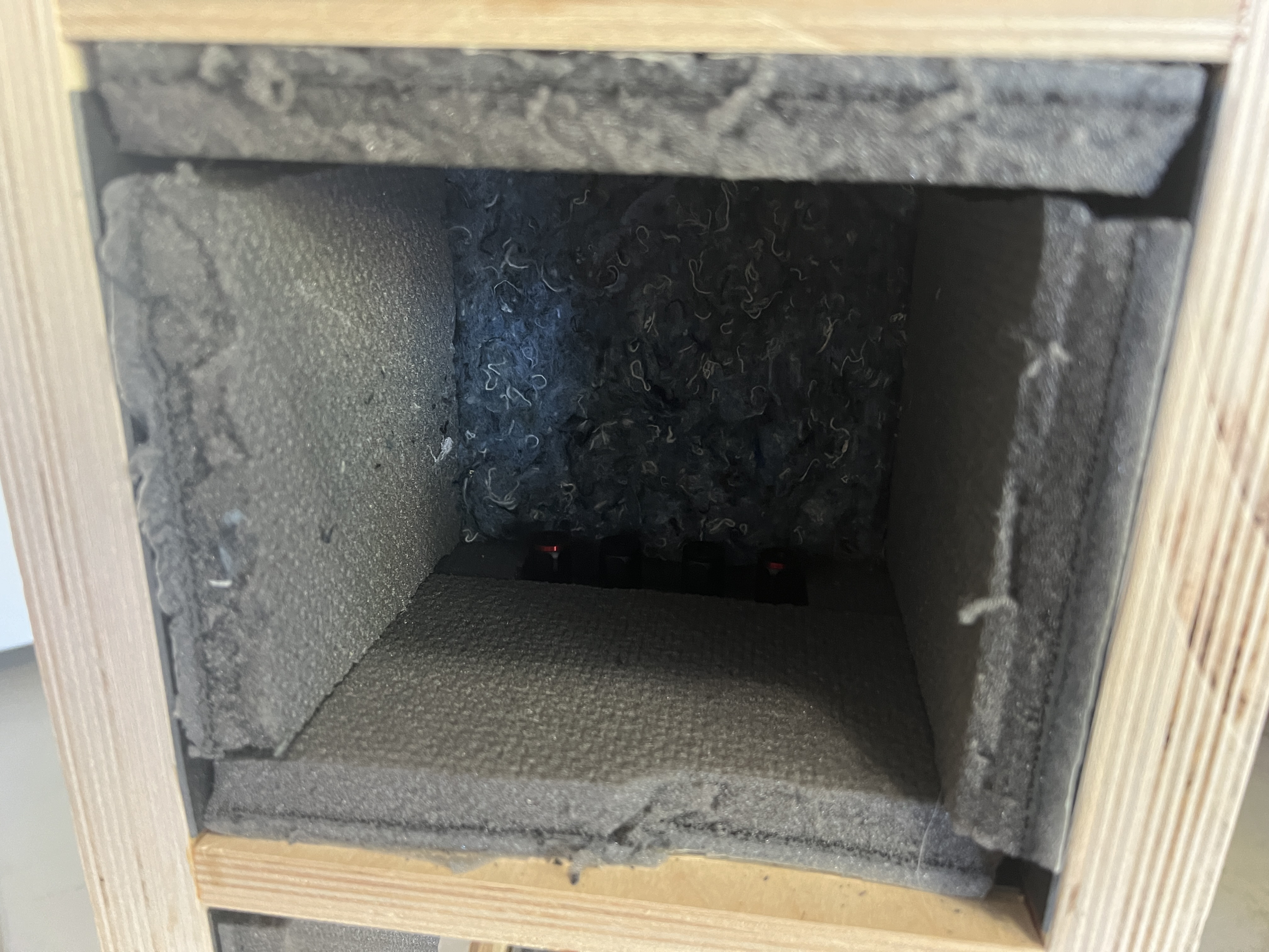

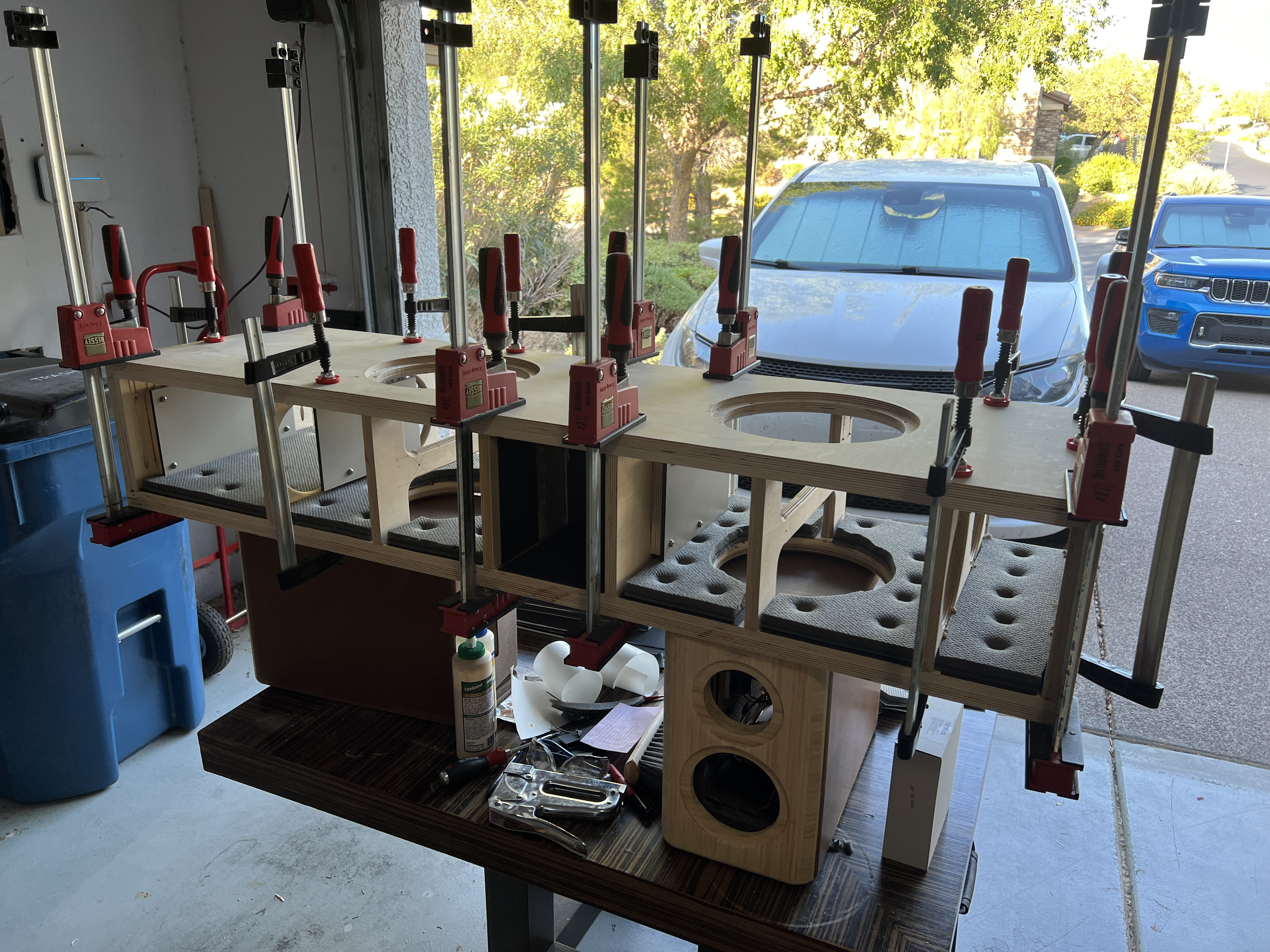

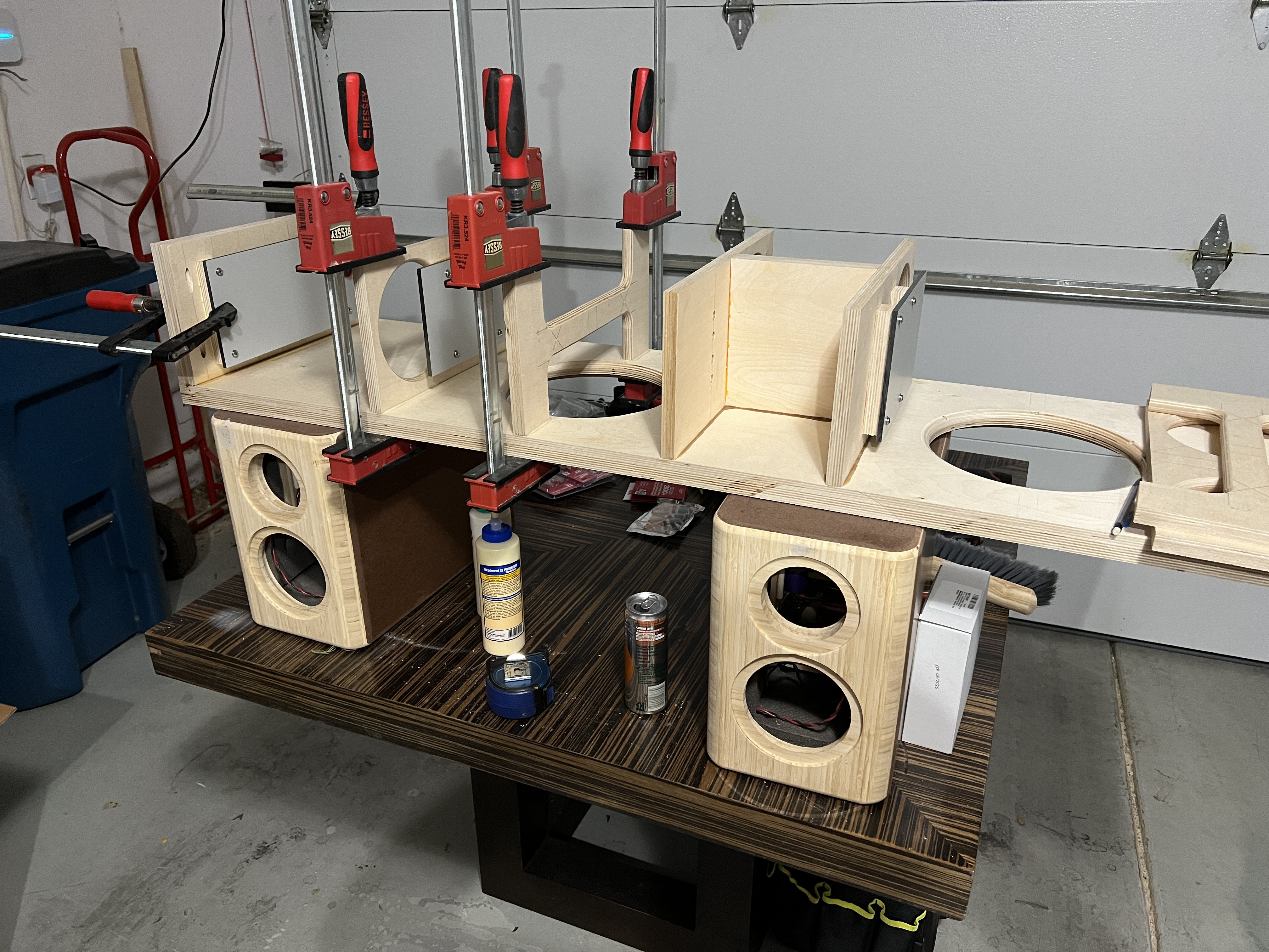

                                                Sonic Barrier was delivered yesterday so I installed it last night and this morning. I used both the 3/4" PSA foam and, what I think is a relatively new product, their vinyl damping sheets. Individually they were relatively inexpensive, but I calculated I'd need four large sheets of vinyl and eight sheets of foam so it added up pretty fast. Just waiting for my wife to wake up so I can staple it down to ensure it doesn't move over time, then I should be ready to adhere the other side to this assembly (hopefully this morning).

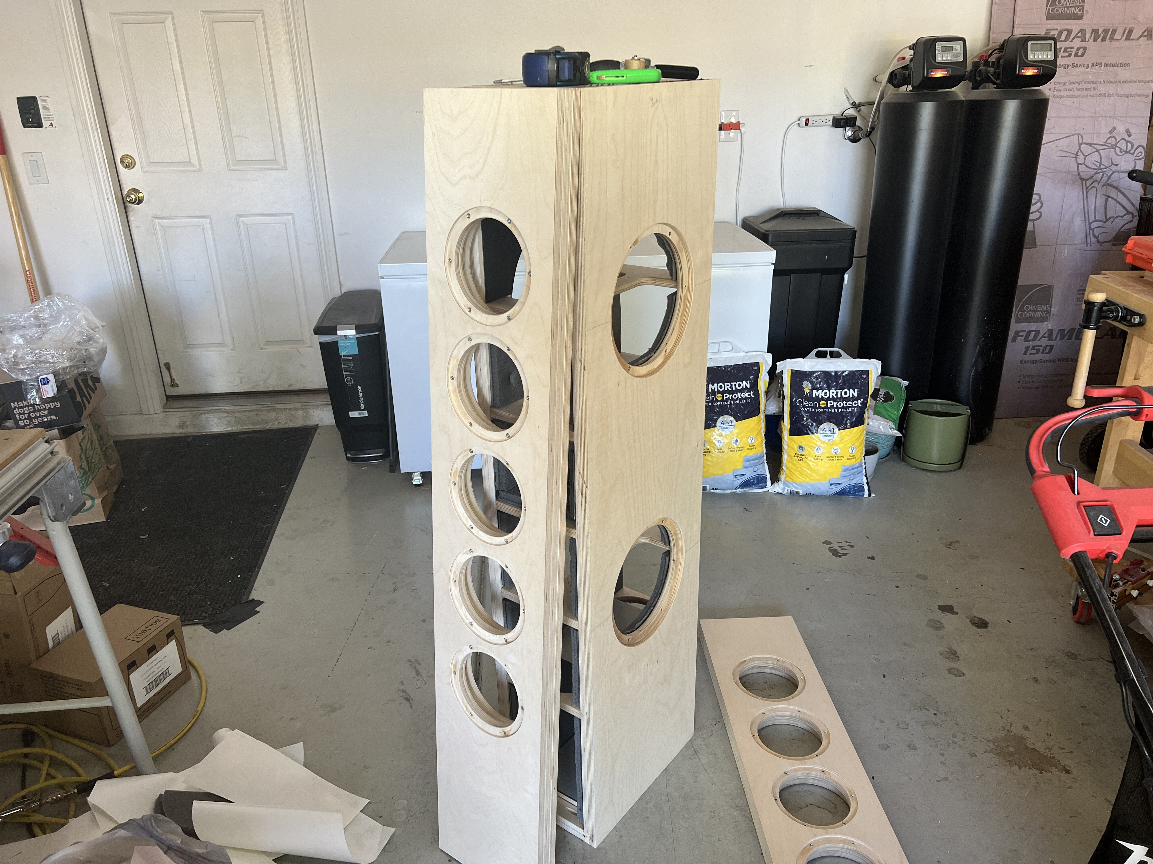

                                                This weekend the plan is to get the back pieces laminated together then glued to the main assembly as well. Once that's done I can wrap up the stuffing of the cabinet and get wires placed. On that note: JonMarsh, what would be the best wiring for the Anarchies for testing? These are the 708 model. I'm guessing it's the below, but I guess I don't really know if it matters since the impedance should be the same regardless. Unless you think doing a 3.5 way is better maybe?
                                                Proposed wiring of Anarchies: Top/Bottom drivers connected in parallel, inside top/inside bottom drivers connected in parallel, then the two pairs of two connected in series.
                                                Click image for larger version  Name:	IMG_1204.jpg Views:	0 Size:	2.02 MB ID:	954840
                                                Click image for larger version  Name:	IMG_1206.jpg Views:	10 Size:	3.05 MB ID:	954841
                                                Edit: Success! Though I was a bit short on clamps again...I would have used the 50" parallels but on that table on those speakers they would impact my garage door. So we made do.

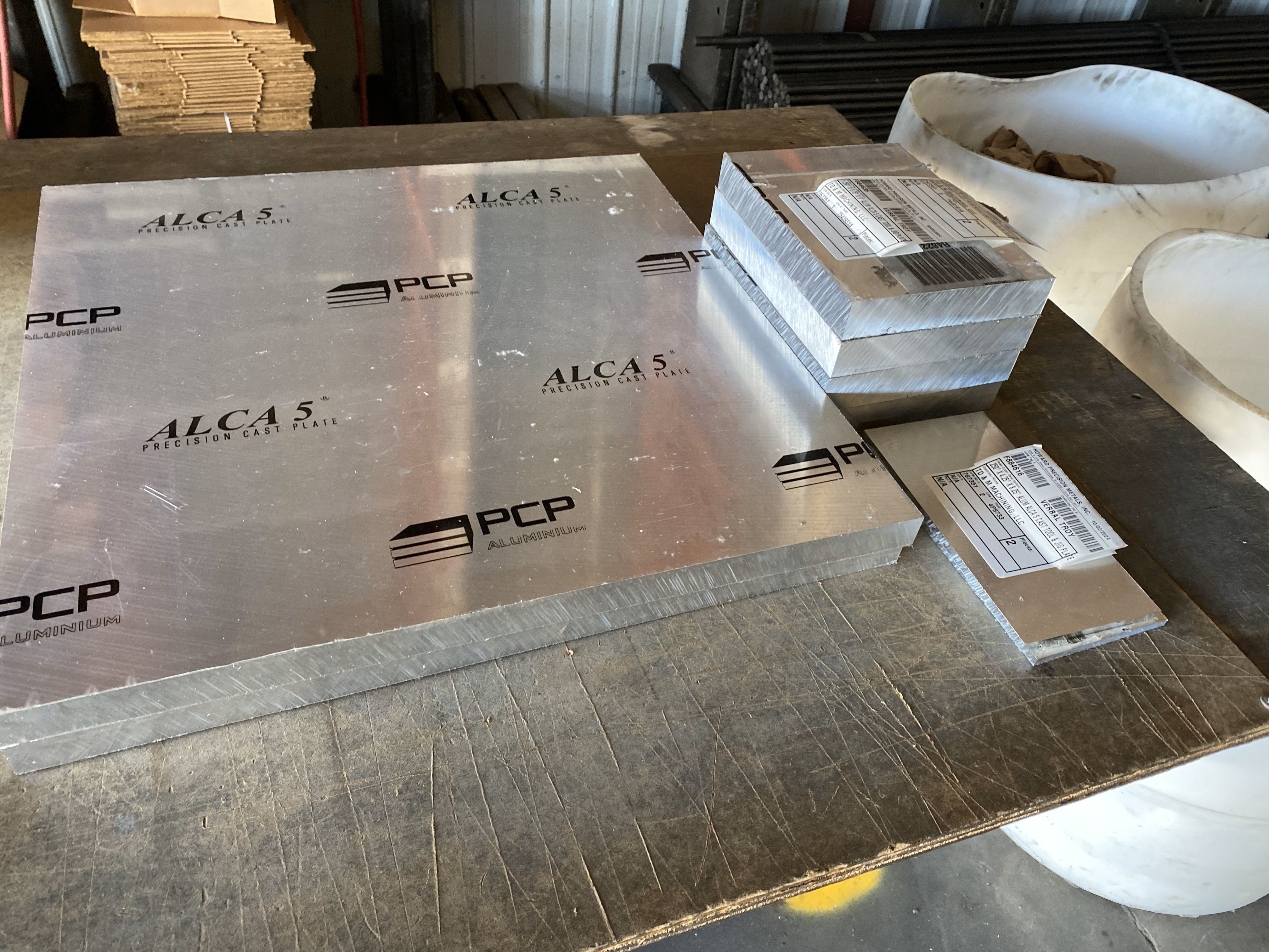

                                                  CNC guy sent me a pic today. The raw materials have arrived!

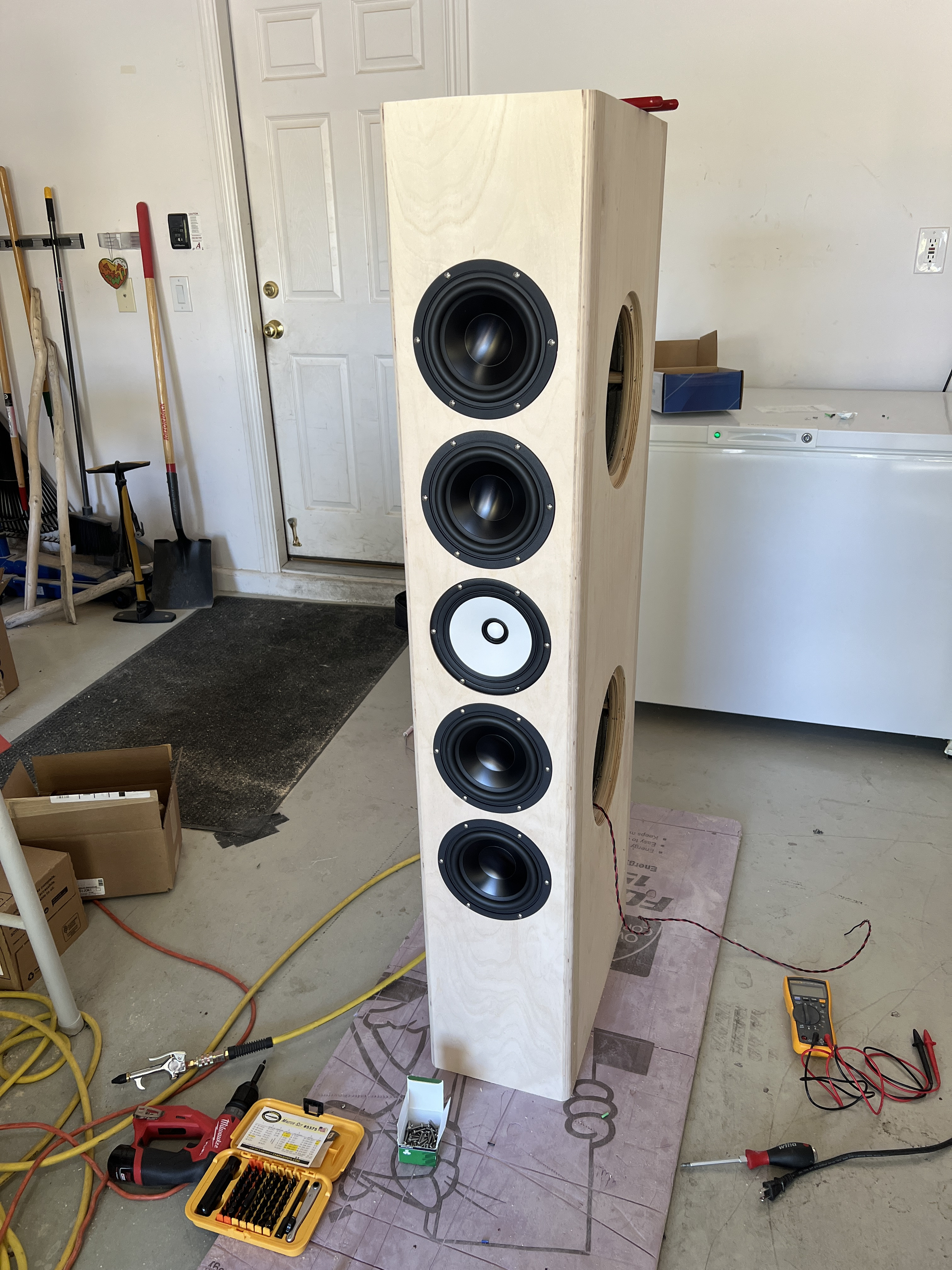

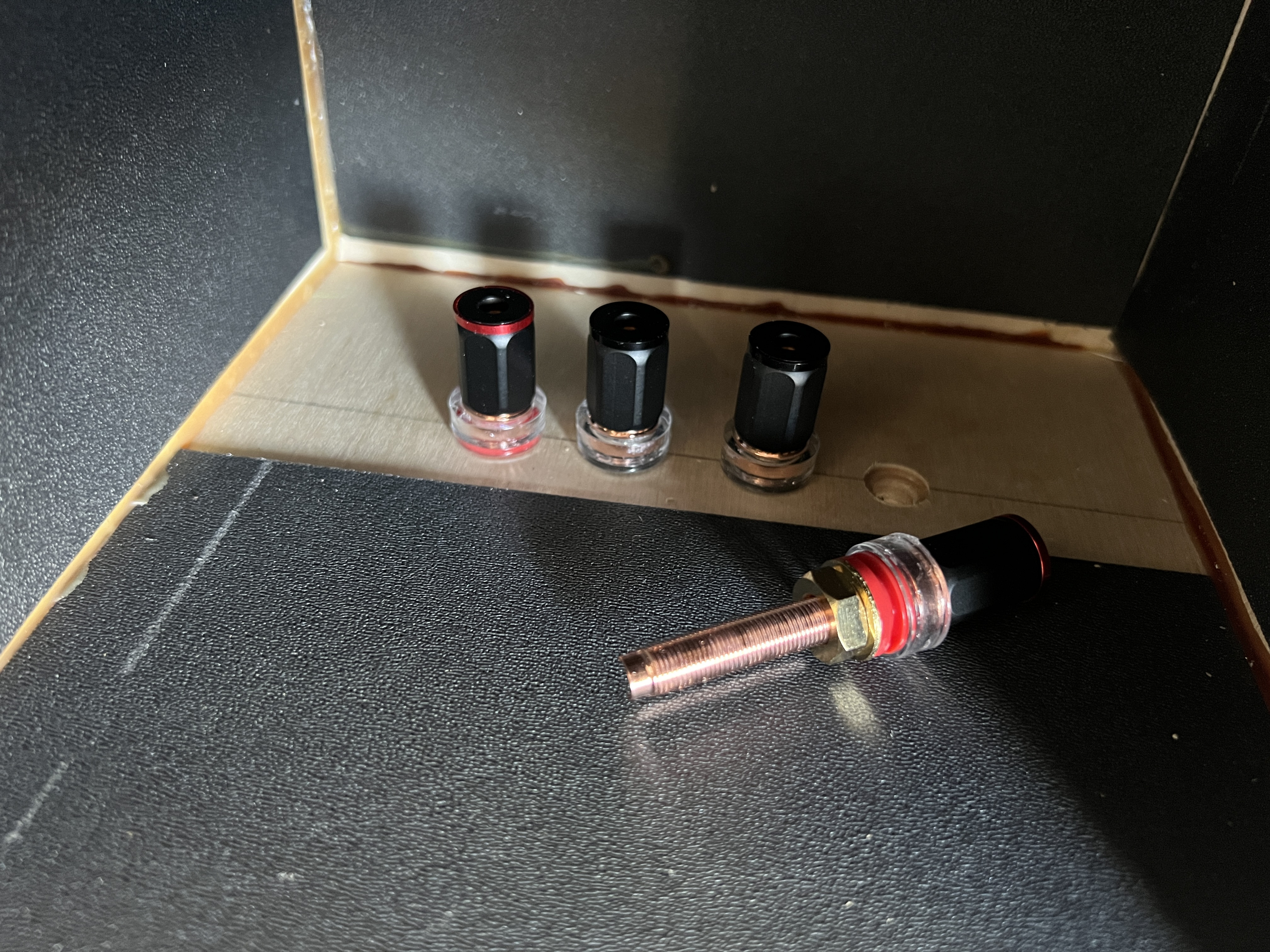

                                                    And new happenings. I decided to install the binding posts now, then apply foam around them to ensure correct fitment. I ended up using Viborg posts as they're really reasonably priced and seem nicer than Daytons. Why I'm using them on the internals is beyond me, but whatever.
                                                    After I was done with all the foam I had to take a look at baffle fitment - it looked really good! Everything seems to line up well. Pic below gets an idea of the size, these are about a half inch shorter than my wife as they stand, they'll be a few inches taller when all said and done.

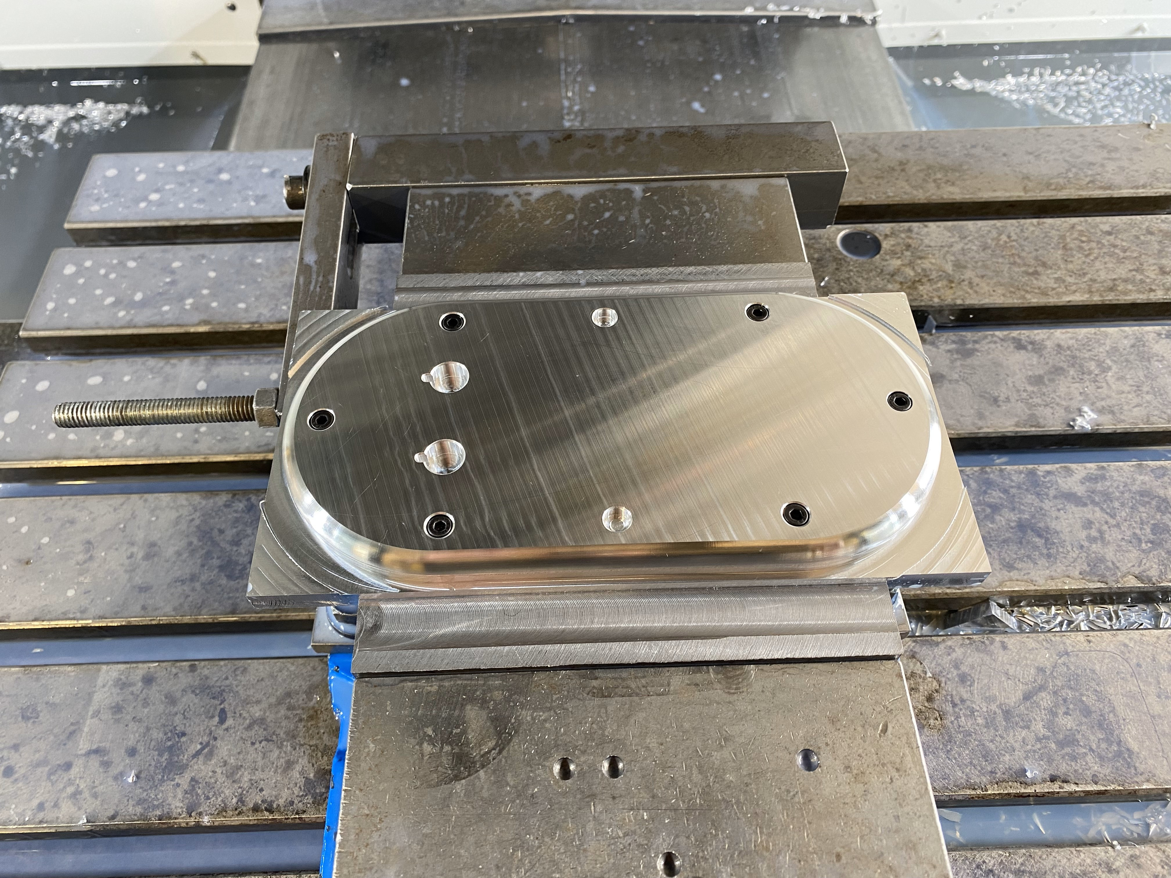

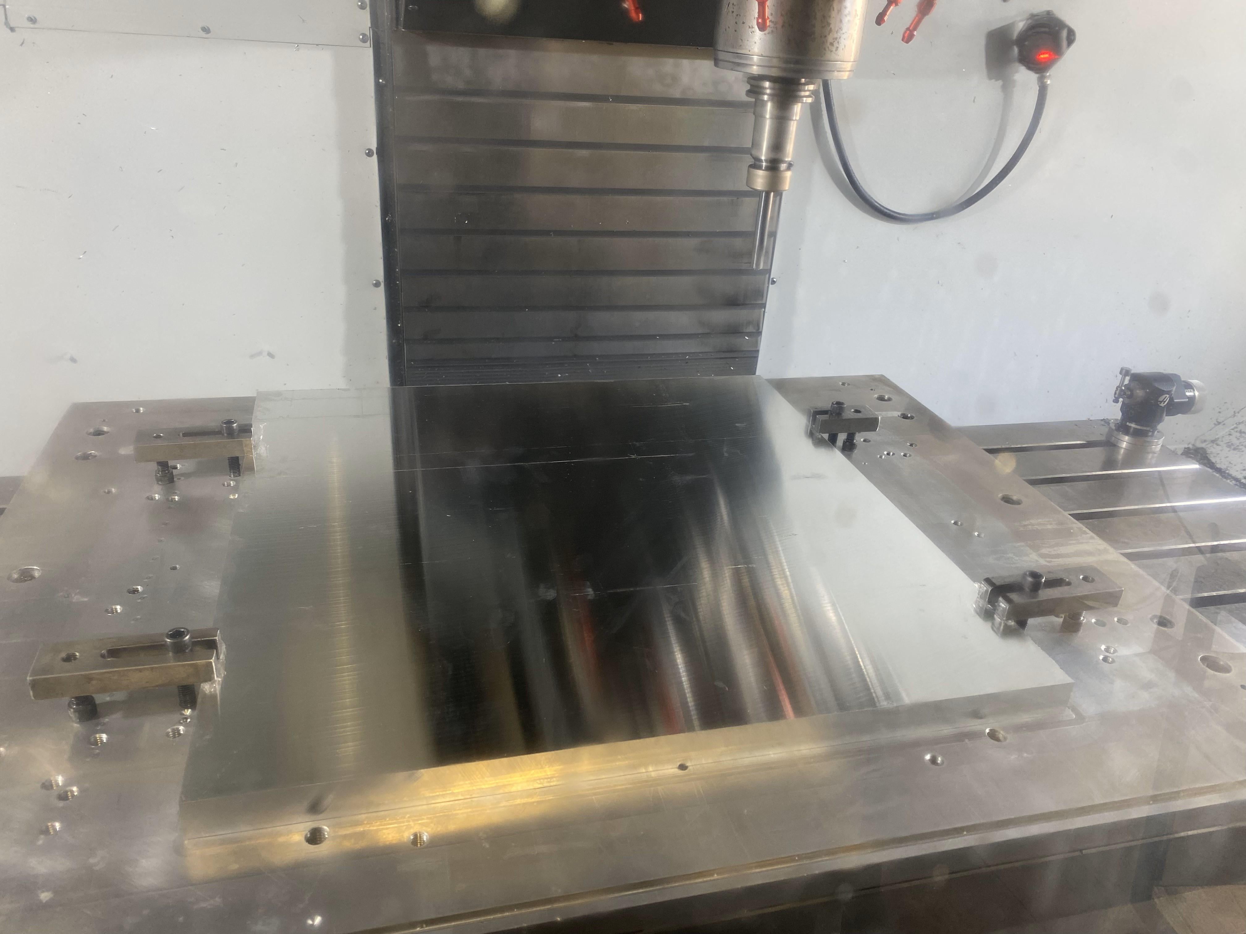

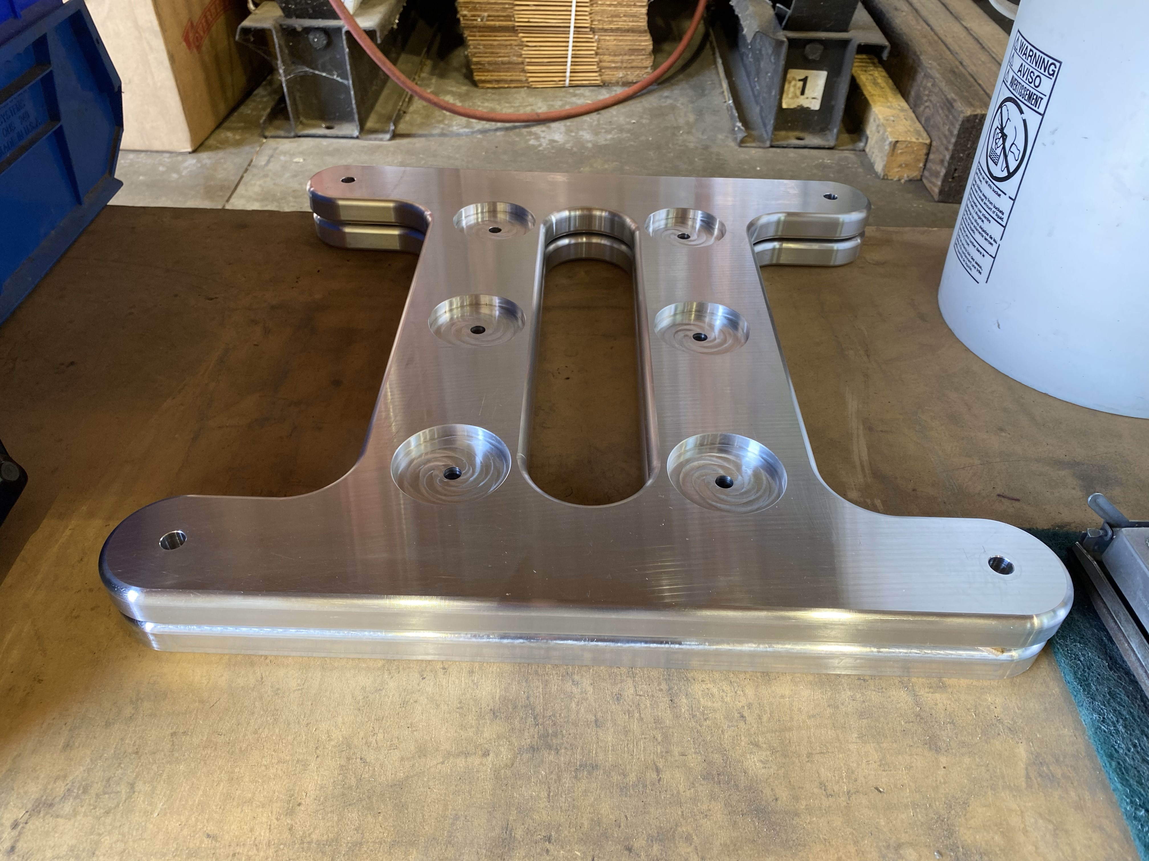

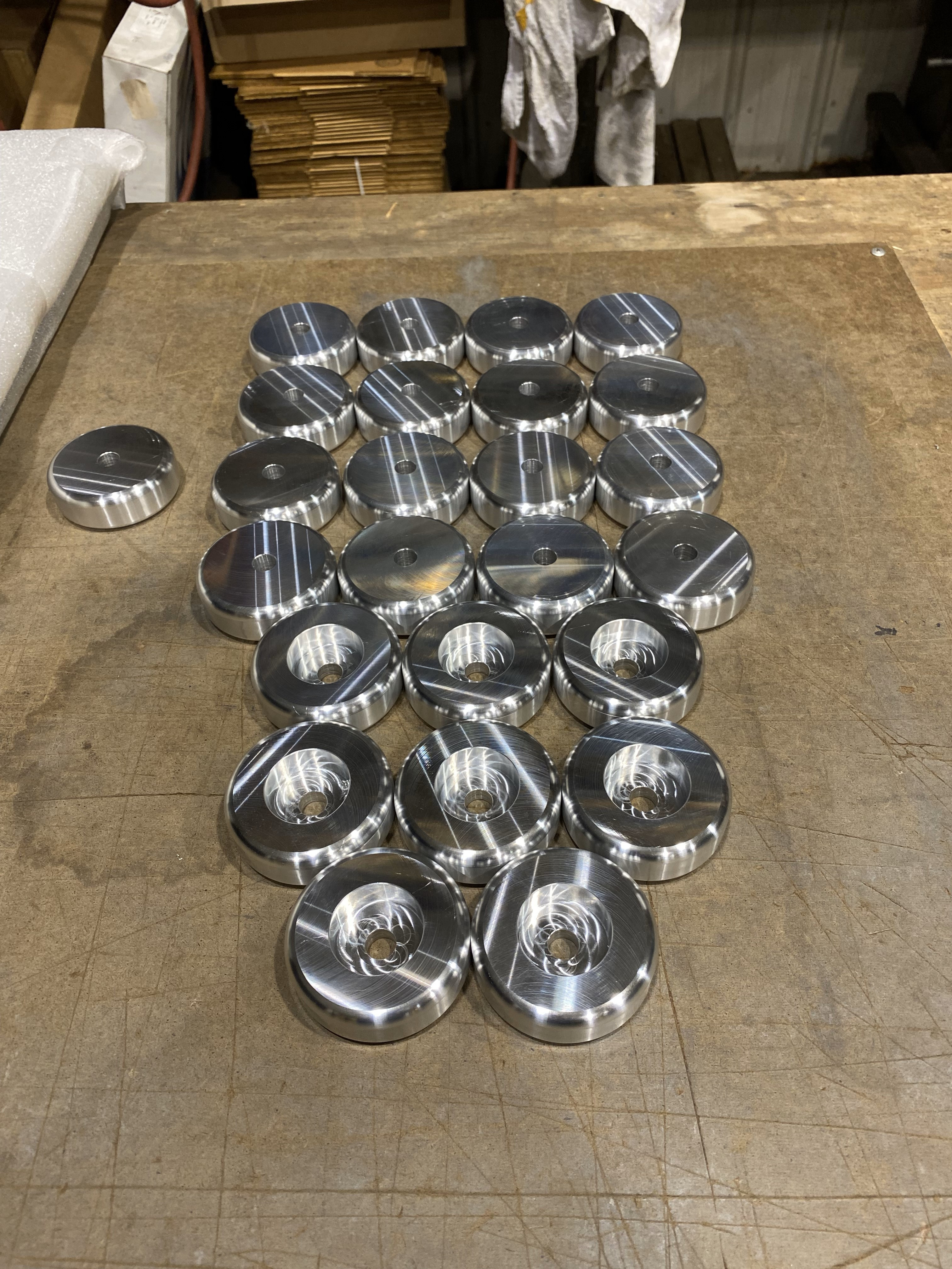

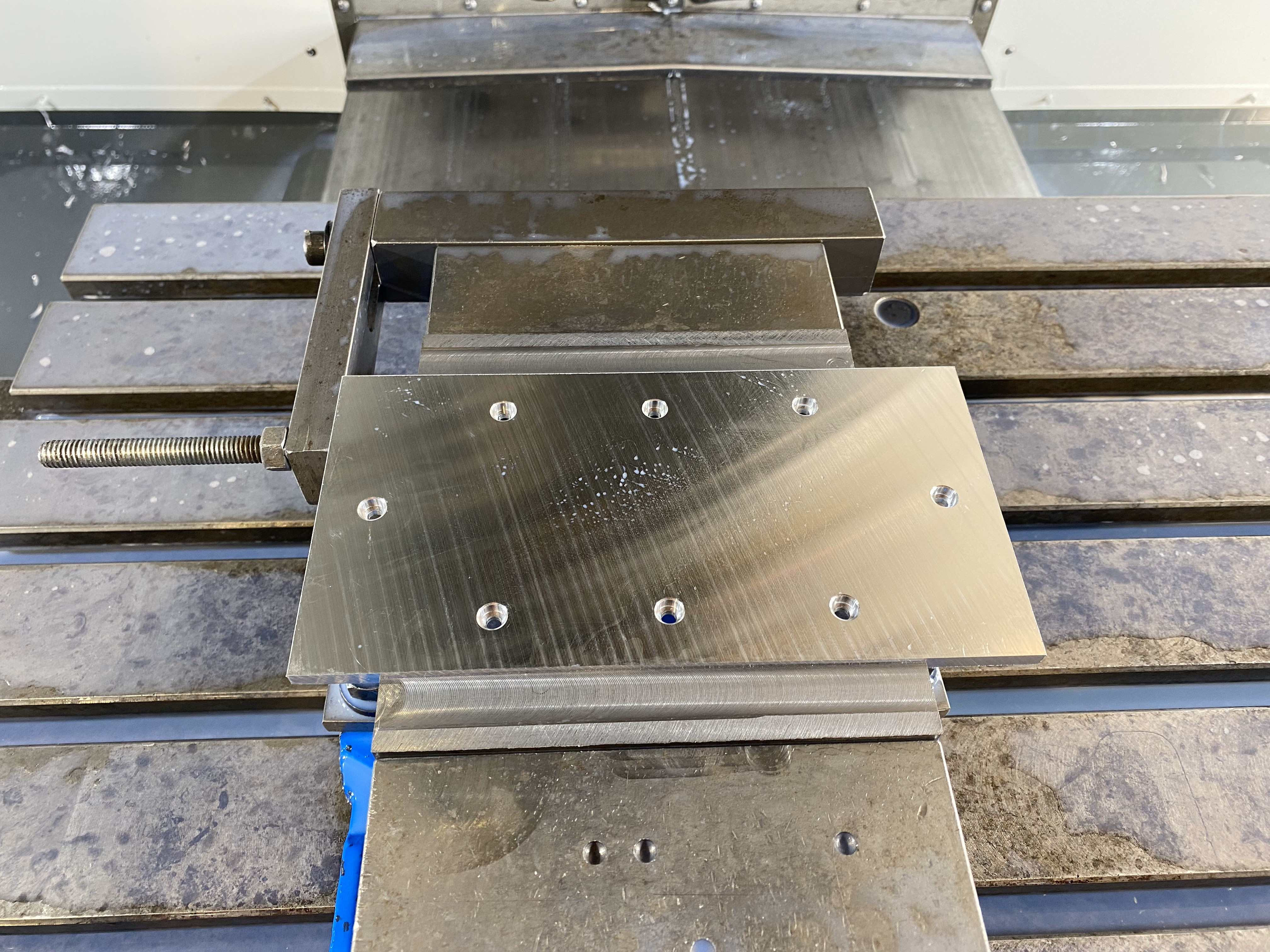

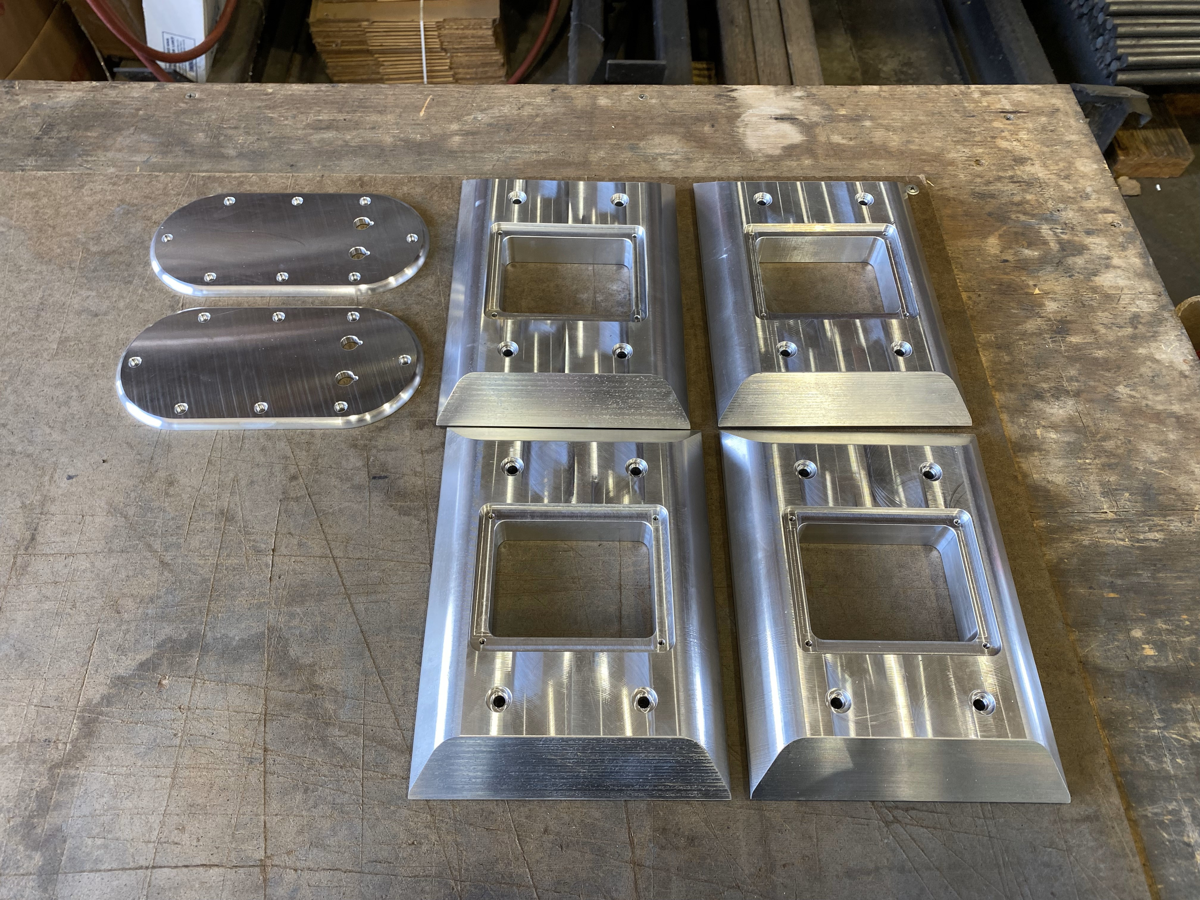

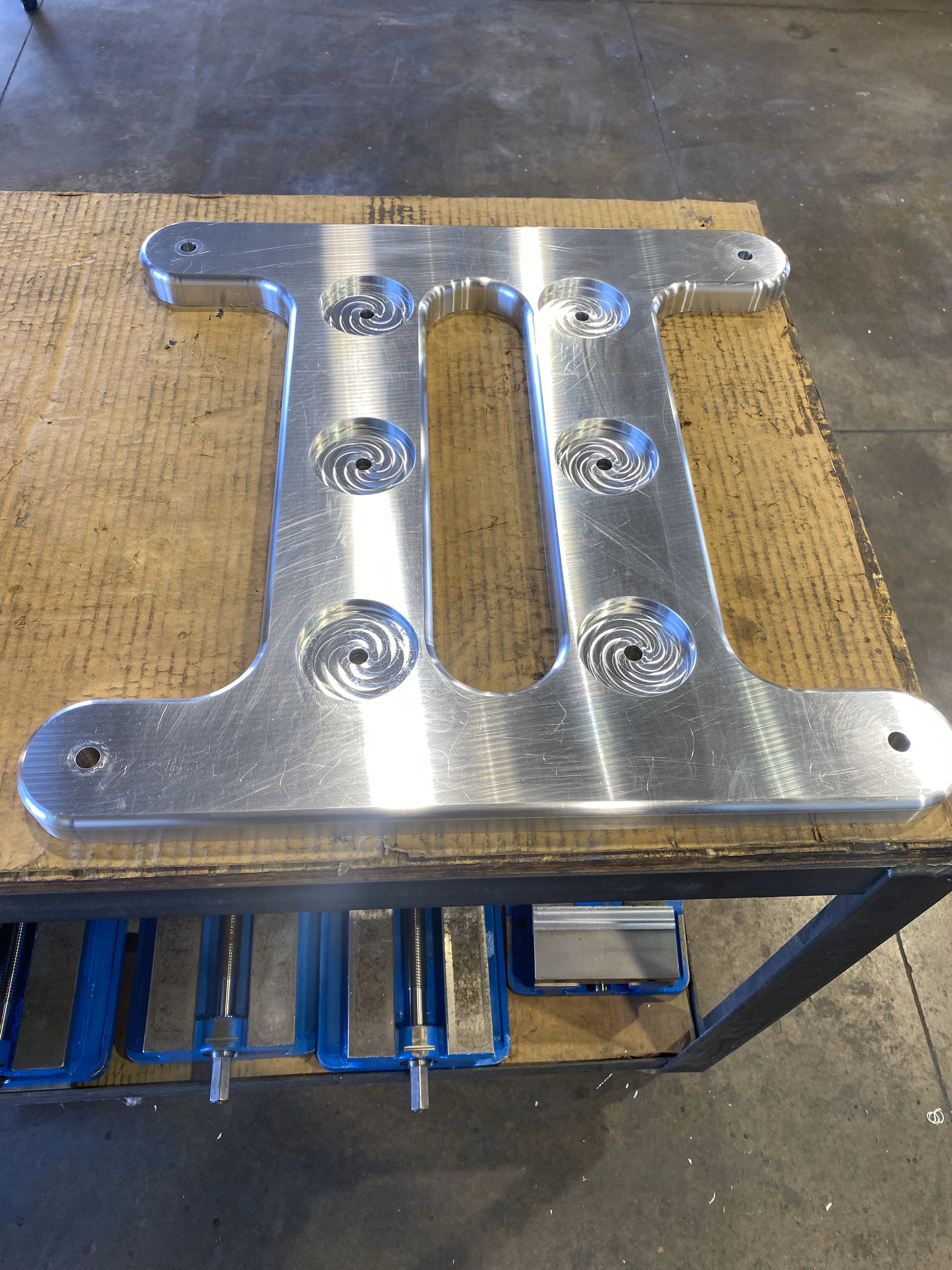

                                                            Aluminum work is all done as of tonight.

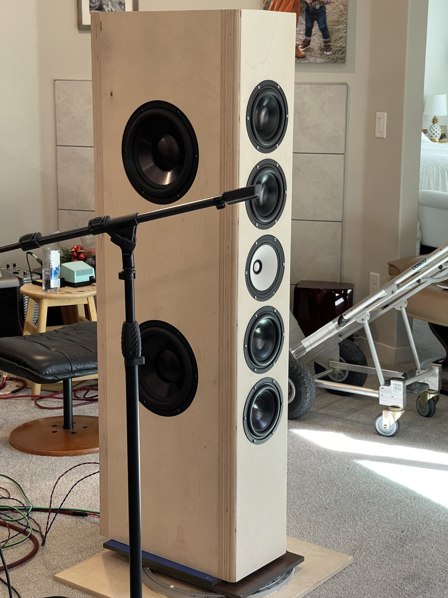

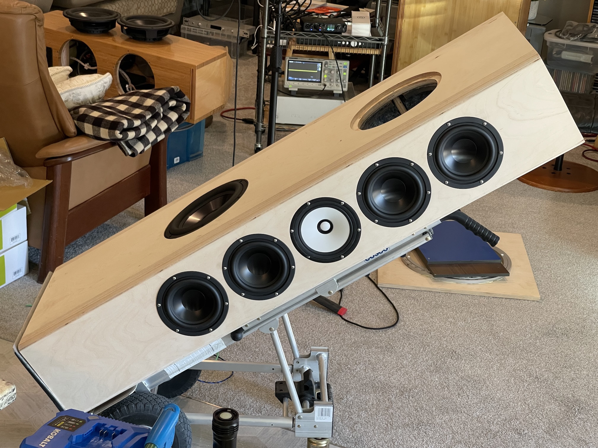

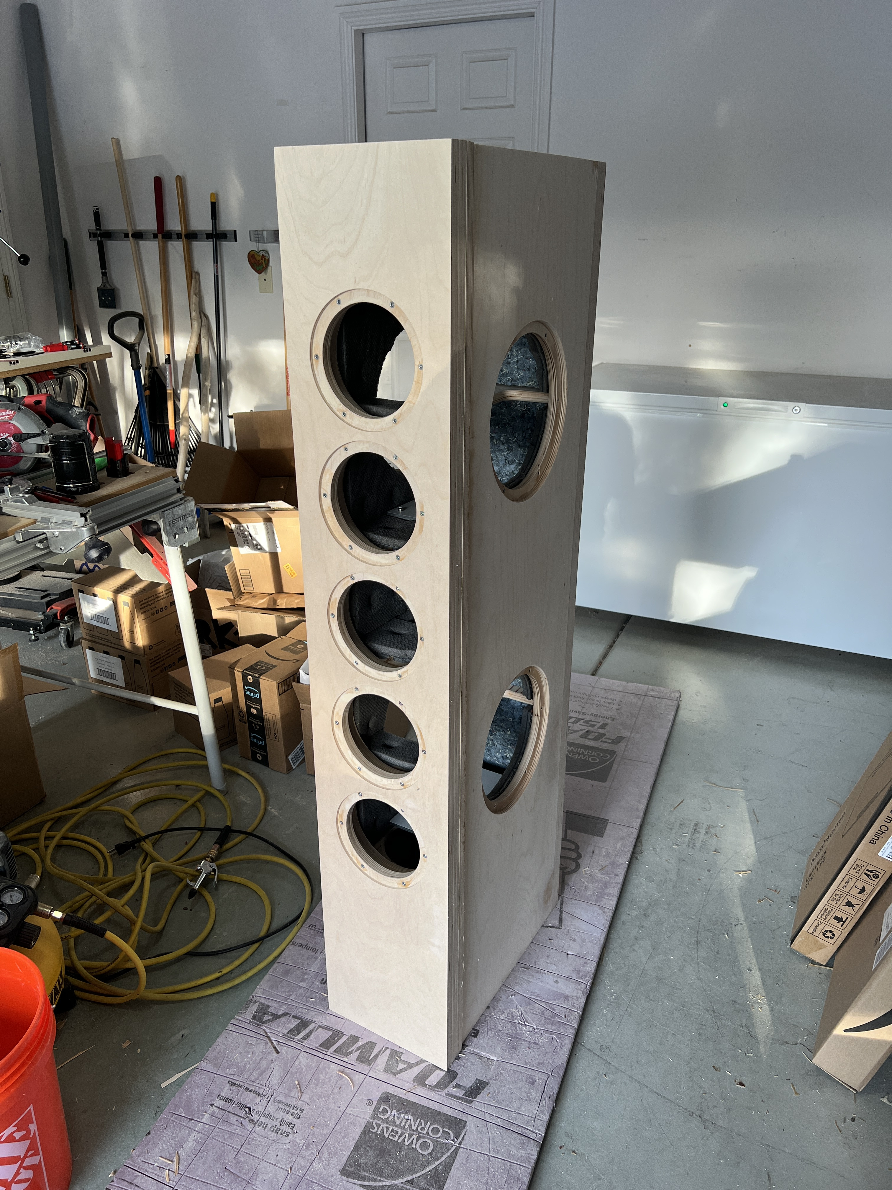

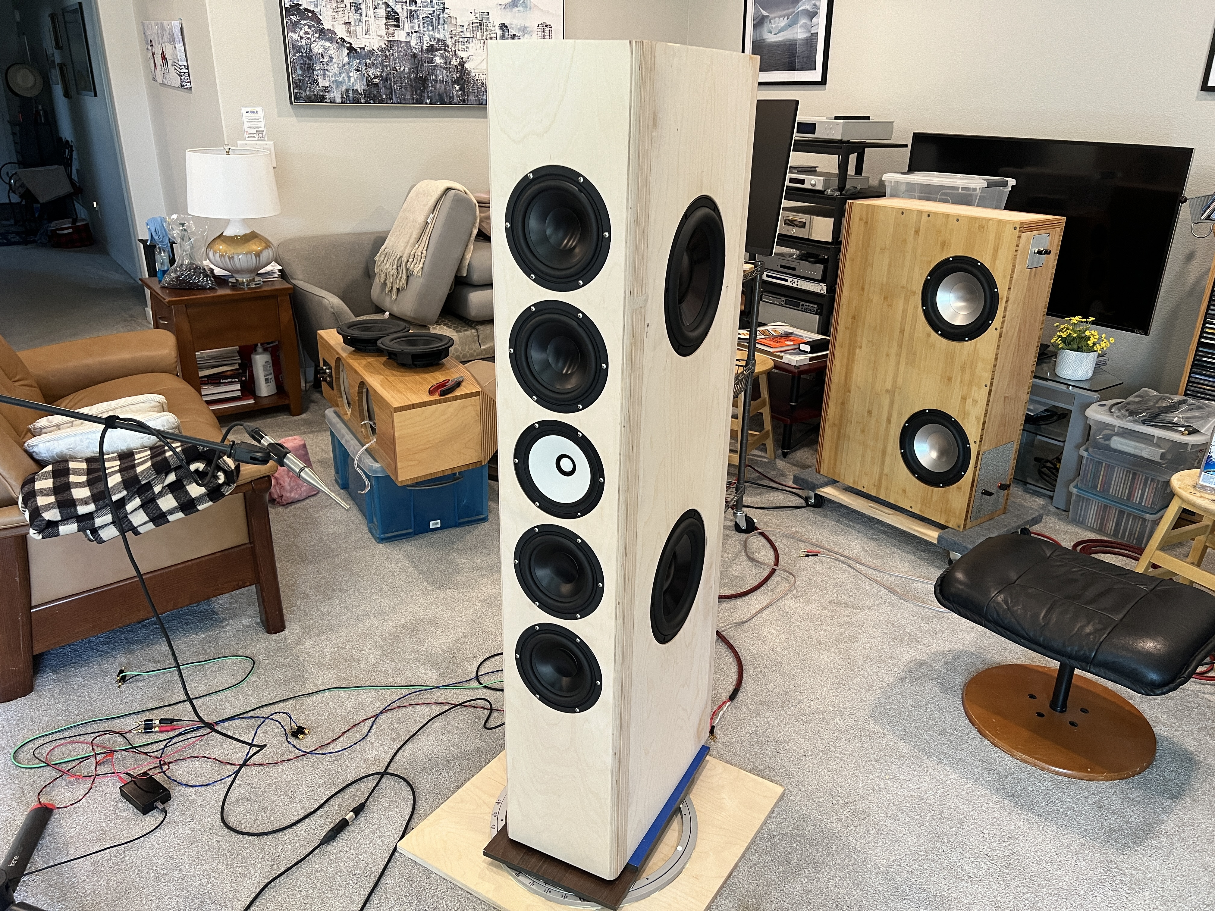

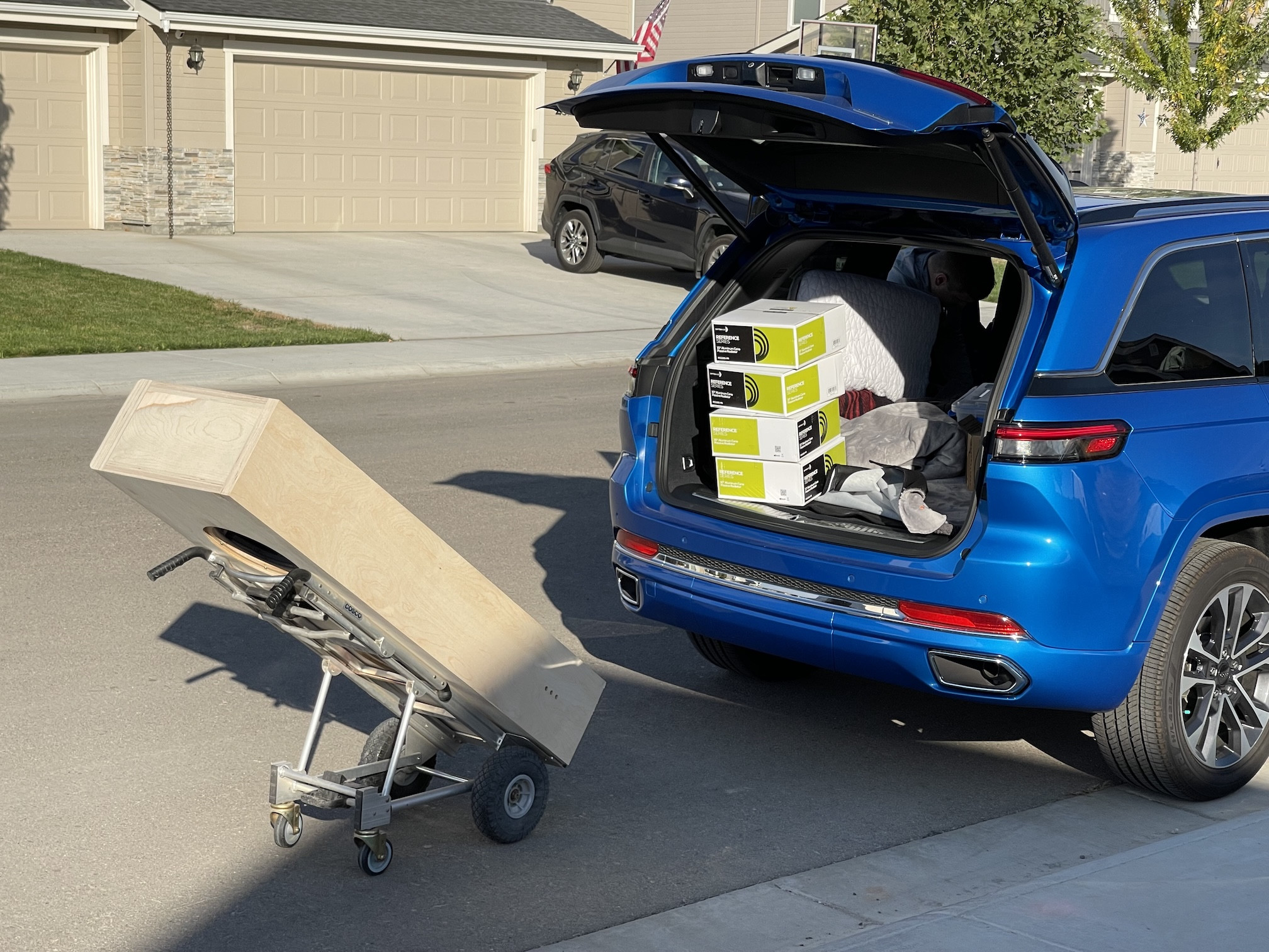

                                                                There were some bumps and hiccups, but she's ready for a road trip. There is something weird about the coax, one bolt was always tight, and it was always the same hole. Ended up snapping the head off a screw - just manually this time, I'm not using power tools on that driver. I'm wondering if that one hole is just off filter a bit but I really don't know. Already had to extract and replace one Rampa insert because it was so tight, and now I'll almost certainly have to do another one. I decided to leave it as is for the time being. The other five bolts worked perfectly, as did all the bolts for the Anarchies.

                                                                  This is turning out very nice! I really like the aluminum base that you designed, and I could see myself really loving that aluminum in blue...
                                                                  Sounds like those threaded inserts are hit and miss with, that must be a pain to remove and re-install when they aren't working properly.
                                                                  Looking forward to get a trip out to Vegas to come hear these in the future!

                                                                    #128

                                                                    Hey Danny, Jon and I were having a conversation the other day on this. I'm finding some drivers need to have their mounting holes re-drilled. I'm finding that if the holes are on the small side or just partial blocked and if the inserts are not perfectly installed and since they are done by hand they usually off a smidge, it doesn't take much to cross thread those inserts.
                                                                    As an FYI, I run a screw into every insert to make sure the threads are clear before I call it good and send the parts out.
                                                                    I need to look into how to get those inserts installed perfectly perpendicular.
                                                                      • 1554
                                                                      #129
                                                                      I don't think it was the inserts or the location they were placed, so I'm thinking your first comment regarding drilling out a mounting hole may be most appropriate in this situation.It wasn't far off so I think it's fixable, one way or another!
                                                                      Edit: For smallish parts I've used a drill press to install inserts, just by turning it manually while applying pressure to the lever. Perfectly perpendicular every time! That's a bit unwieldy for large baffles though.

                                                                        The Rampas are much easier to thread straight. They have the initial section that is unthreaded to help align vs the ezlok which tilt easily. I also found that running the drill in reverse sets the base of the Rampa when the hole is just a tad small. From there they almost self align.
                                                                        For aligning ezlok I use a longer bolt with two nuts tightened to each other. This gets chucked into a portable drill press from rockler. The ezlok is threaded onto the bolt till it stops to the nuts. This keeps it straight as it is threaded into the hole by turning the chuck by hand. Once enough depth is established, I move to the ezlok bit.

                                                                          • 1554
                                                                          #132
                                                                          The first of the Ensemble lineup hit the road yesterday and arrived at a familiar setting today for some nice discussion and measurements. You might recognize a few of the background elements!
                                                                            theSven commented
                                                                            Editing a comment
                                                                            That's awesome, and yes I do recognize some of the elements there... I hope you have some great measurement experience to share.

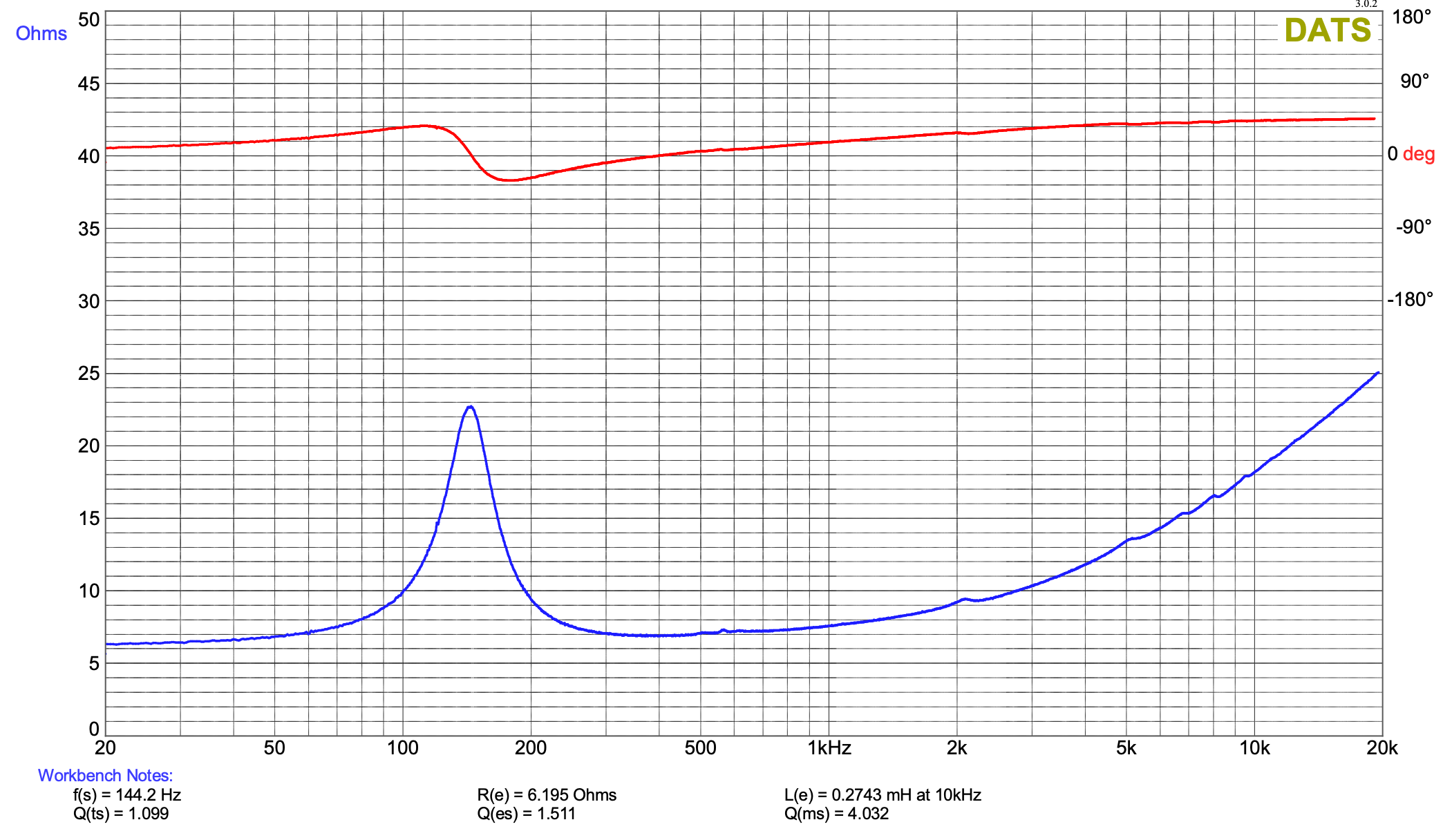

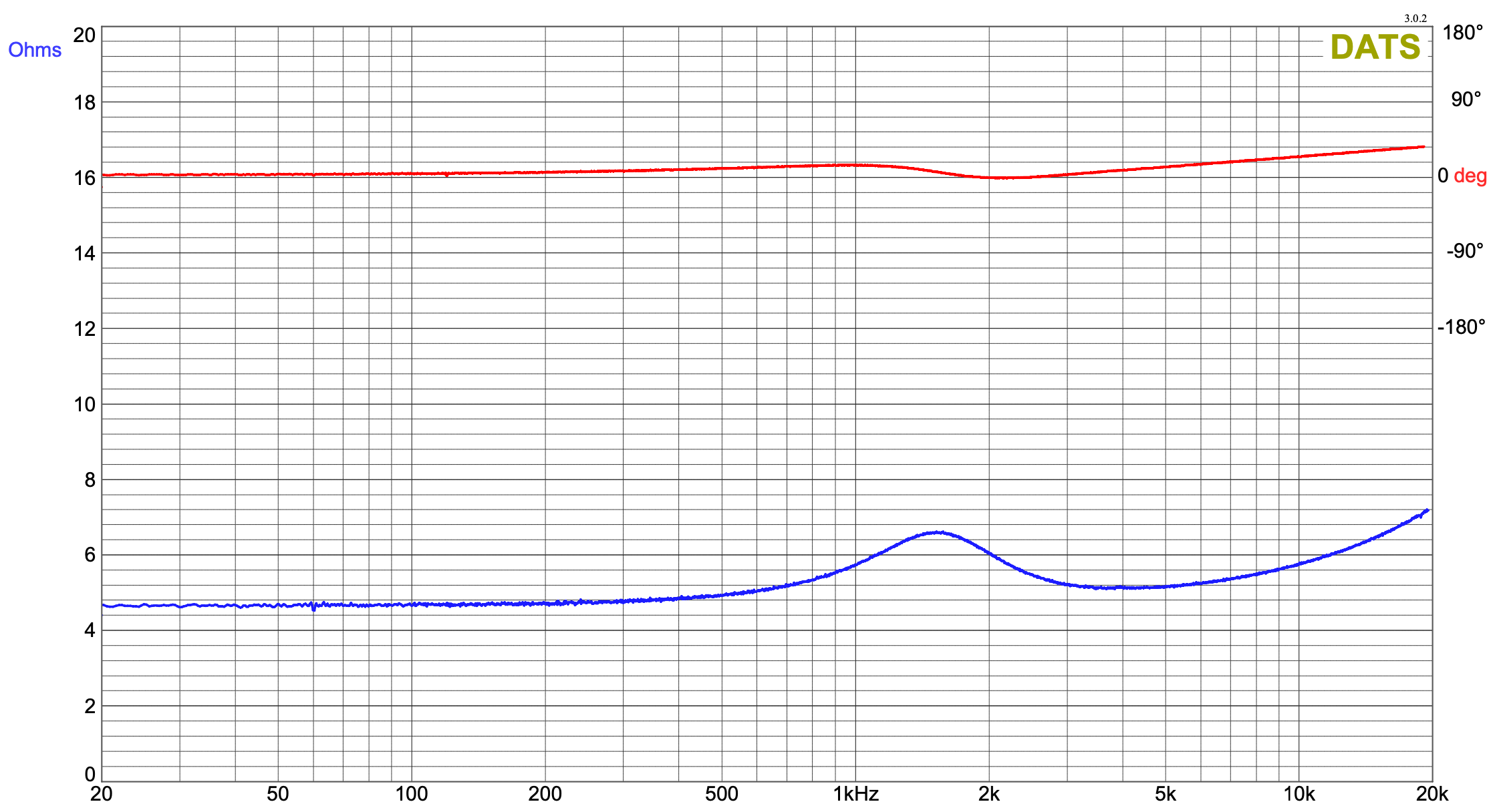

                                                                            It was a quite interesting day yesterday, and we enjoyed hosting Danny for the measurement experience! Of course, we had to enlist Jon Hancock & Sons Moving and Storage team to get this monster into the living room... no sons available to help (there aren't any!)
                                                                            Click image for larger version  Name:	Unloading Car.jpg Views:	21 Size:	822.2 KB ID:	955061
                                                                            Danny was at least slightly impressed with my collection of hand carts and moving dollies...
                                                                            Click image for larger version  Name:	On cart.jpg Views:	20 Size:	857.4 KB ID:	955062
                                                                            Danny re-loaded the PR's into the cabinet (PR holes make a very good carrying and maneuvering control handles) and it was off to the races!
                                                                            Click image for larger version  Name:	Ready to test.jpg Views:	20 Size:	646.9 KB ID:	955063
                                                                            First thing was some impedance testing- results for the "King Coax" midrange and tweeter are shown below.
                                                                            Click image for larger version  Name:	DT Coax Mid Impedance.png Views:	0 Size:	305.7 KB ID:	955067
                                                                            The bobbles at around 500-600 Hz and 2kHz raised some questions in my mind, but it seems the 2kHz one is the only one manifest in the SPL response, and it's effect is relatively minor.
                                                                            Click image for larger version  Name:	DT Coax Tweeter Impedance.png Views:	0 Size:	356.4 KB ID:	955068
                                                                            As is common in many Coax drivers, the tweeter seems to have a very small rear chamber, and a relatively high Fs- this requires some care in the HF filter network and determining the best crossover frequency.
                                                                            Next up will be Fuzzmeasure testing, and fortunately, with something a little more sophisticated and analytical than Seas's own technique and data sheets, (put it in a box, measure in the box at 1/2 meter; baffle step, diffraction issues, and what not be damned) you can see the driver's real potential.
