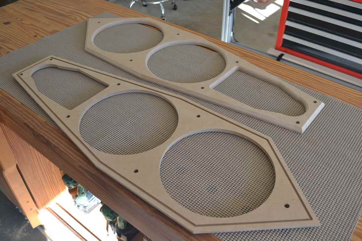

            Thanks Ron ..... Your right about the precision one of these can offer, as well as being repeatable. Your also not far off on the nickel thing either, at least conceptually. Most folks think having one of these lets you feed it wood and out come the parts. Wrong ...... there is a lot of work involved in getting the drawings done, correctly I might add. The machine is very stupid, it goes where you tell it ..... if that's the wrong direction, you now have fire wood. Doing the drawings you also have to keep in mind how the part needs to be machined, it's a lot of planing ahead. It's been interesting though and I'm always up for a good challenge.
            It certainly gives the option of being more creative in certain areas.

                    Some nice progress Greg ..... looking good.
                      #235
                      your cabinets look amazing, Greg
                      and Steve, what a great job on the grills!!!
                      really great of you to help out like that!!!!

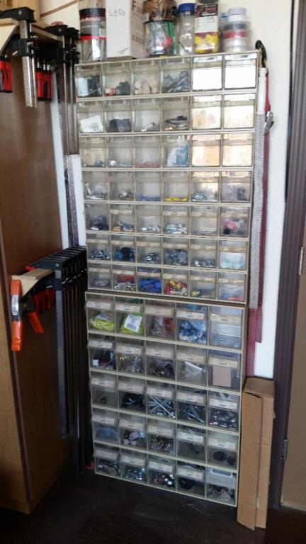

                                            You'd think I'd be drooling over the cabinets (and they are sweet), but really that pic. of the drill press hooked me: really nice. 8) (..I've got a little piece of crap that was as cheap as possible and probably was made with slave labor.) ops:
                                            The other thing that really stood-out for me was the "bins" in the background, I spent the better part of today (Sunday) working on a wall with bin's in the garage (sorting just a lot of odds-and-end's hardware for my top (bin) row that is composed of smaller integrated units (6 of them) like your black one on the shelf above your bins - absolutely mind-numbing work.) :P
