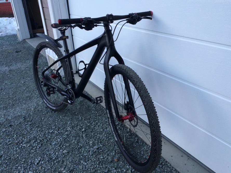

                                    In the meantime I have built a bike to my oldest one ;-)
                                      Teach your children the joy of bicycles (or speaker building) and the will never have money for drugs.

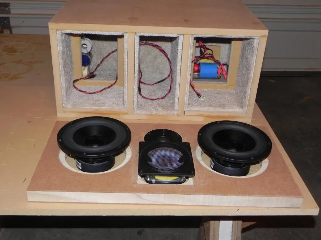

                                                Ben and I stuffed 0.75 lbs of loose Dacron per speaker for the base sections (stuff sealed / line ported). The mid section was 1/2" of yellow ridged isolation on the back wall and then everything covered with broad loom carpet. I have settled on this approach and it seams to produce consistent results. You want to damp the back wave of that expensive mid driver. Not sure on Jon's lead and felt approach. I have tried foams but they seam to sound different every time, not consistent. If you have access to some of those nice natural wools it could be a way to go.

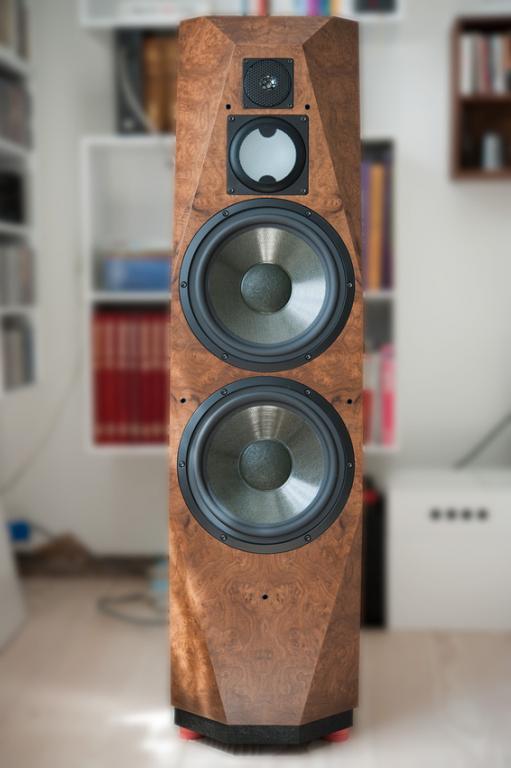

                                                                          I'm starting to think about finish for these.
                                                                          They are going to be in the home theater - so I think that I will go for something dark. I veneered the sub's in white ash that was colored black. I do not think that look will do the Wavecor Ardent's justice - so I'm thinking about something that stands more out.
                                                                          I think that the most relevant right now is something like this:
                                                                          Is this maple burl?

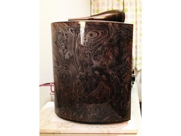

                                                                          Another option is to go more against black, like some of the B&W signature speakers:
                                                                          I think that B&W calls this gray tigers eye, but I have no idea if that's a veneer that's easy to get hold on - or how it is treated to get that color.
                                                                          In other aspects, speakers like Jons with birdseye looks wonderful as well - but for my usage and placement I think those are to light - and I'm guite sure I will aim towards something darker.
                                                                          Sourcing of the veneer is also going to be a issue, especially as I would like both paper backed with PSA option and non-paper backed (for the facets).
                                                                          I think that there might be one place locally here that work with veneering. Might pay them a visit to see if they have something that seems interesting.
                                                                          Right now I'm leaning towards the first one shown above, the one I think is maple burl.

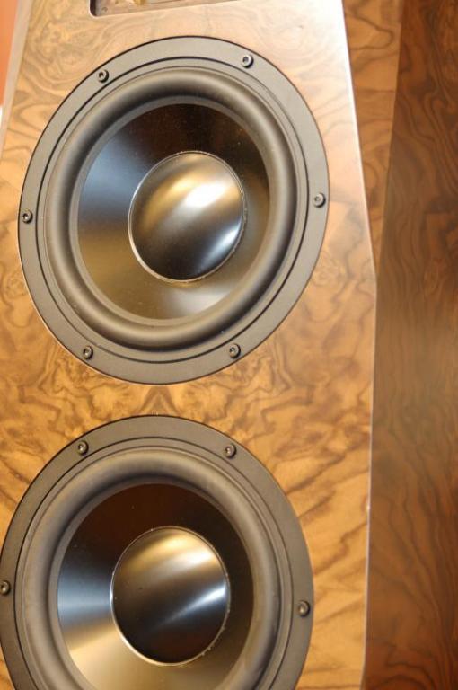

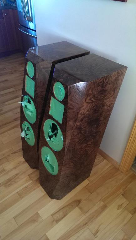

                                                                              If I'm not mistaking this is yours:
                                                                              They looks stunning!
                                                                              I'm quite sure that I will go the same router as you, and use Walnut Burl and source it from veneersupplies.
                                                                              From what I recall Jon used clear gloss and then a few layer of satin gloss at the end.

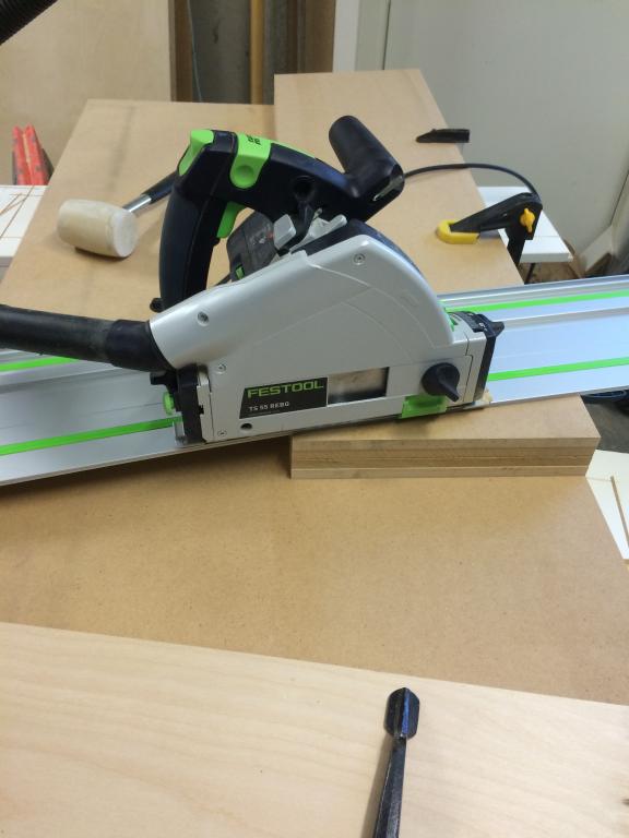

                                                                                I cut the 18mm BB sides first. Those were very overcut (meaning I did not cut the hight at all, just the width). Two side in each cut - as my circular saw only takes 50mm deep cuts.
                                                                                This is the cutting of the inside MDF for the side panels. All 4 in one cut. Was a bit of a challenge to find a 10 degree angel, but I figured it out.
                                                                                More MDF side panel cutting.
                                                                                The festool guide rail have the possibility to be clamped fast to the item beeing cut. Just figured this out, and for now I'm using a regular clamp that I have abused so that it works this way. Two new festool clamps on order :T

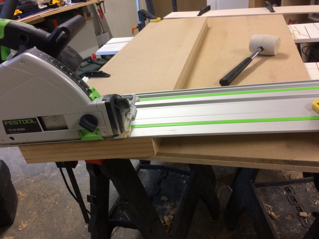

                                                                                Measuring where to cut the BB side walls. Using the MDF inside as a guide and making room for the top (1/2" MDF + 18mm BB), if you look closely you will se that there is a tiny bit of overshoot there.
                                                                                Distant picture, still measuring where to cut the BB side walls. Cutting two sides at the same time.
                                                                                In this picture I'm about to draw the line on the BB by following the left side of the MDF. That's where the next cut will be.
                                                                                Next it's time to laminate the 1/2" MDF and the 18mm BB together.
                                                                                  Setting up to make the final cut for the BB sides.
                                                                                  "Help, help what are you doing - why are you cutting our heads off? :E"

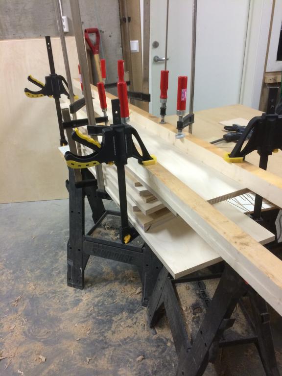

                                                                                  From earlier attempt to glue sheets of MDF/Ply together I have experienced that the sheets have a tendency to glide and those shift position when pressure is being added.
                                                                                  To avoid that this time I made guide holes from the inside, trough the MDF and into the BB sheets. But the plugs I had were to long so I had to shorten them a little. 3 plugs in each side, total 12 plugs.
                                                                                  But I forgot to take pictures of the sides before gluing them together...
                                                                                  After I applied glue I just put the plates on top of each other and the plugs+guide holes ensured that the sheets did not shift position at all. It worked as a dream :-)
                                                                                  Clamping up the side walls - now it will dry until tomorrow :T

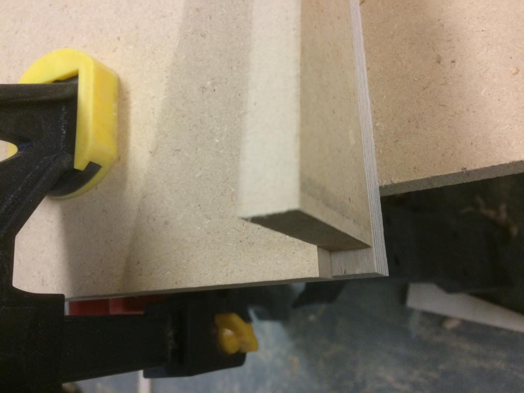

                                                                                    I have just cutted BB and MDF for the back plate. 11 1/4" for the BB and 10 1/4" for the MDF, leaving exactly 1/2" for each MDF plate.
                                                                                    I'm just position the BB and MDF before gluing them togheter, using some scrap pieces of MDF to verify the width of the joint edge. Have to say that I'm quite happy with the cuts made. I actually can't feel any edges between the BB and the MDF test pices. Almost so that I wonder if I should start to plan room for glue when cutting this sheets
                                                                                    (PS: it shows that in Norway the MDF is sold as 12mm MDF, but actually is exactly 1/2")
                                                                                    Overview
                                                                                    Closeup left edge
                                                                                    Closeup right edge
