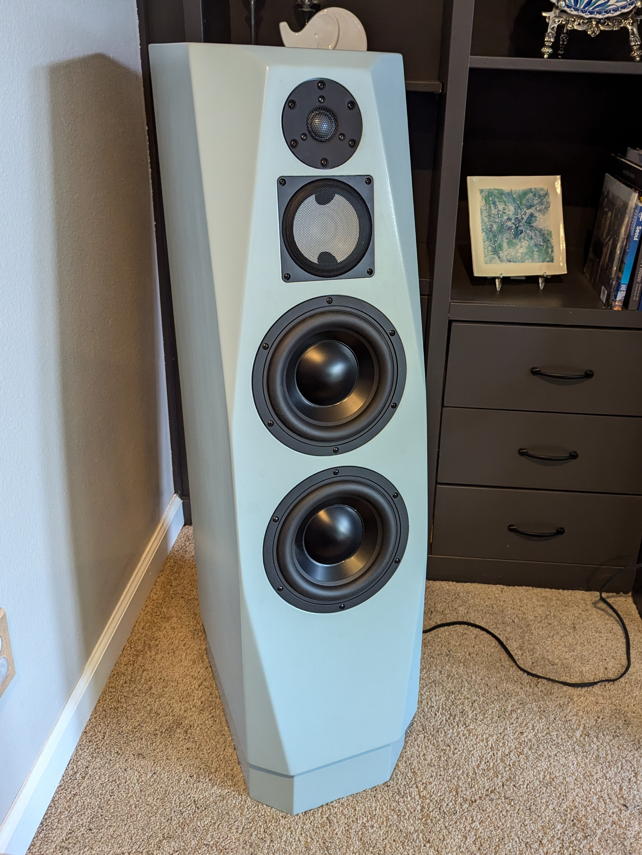

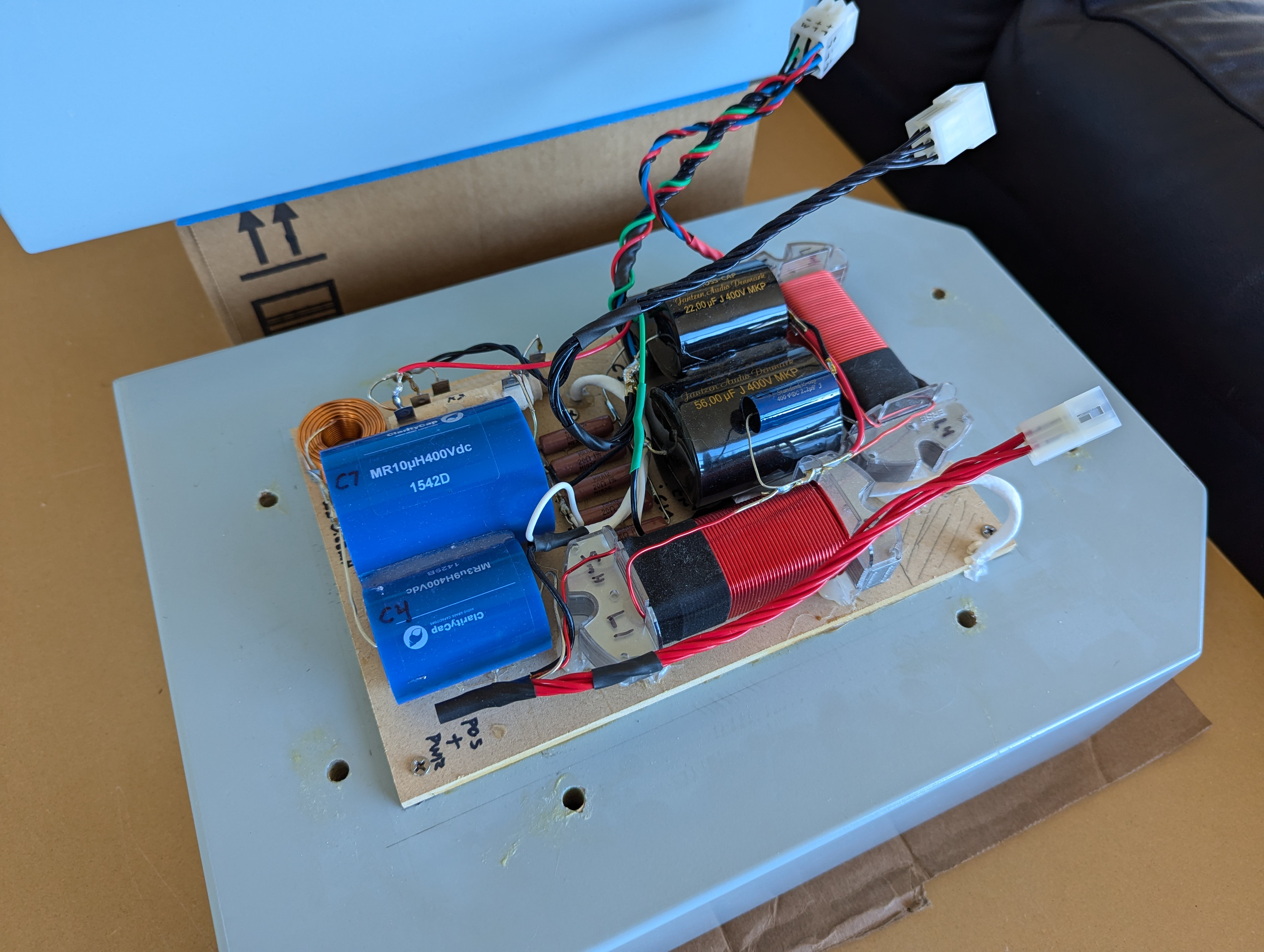

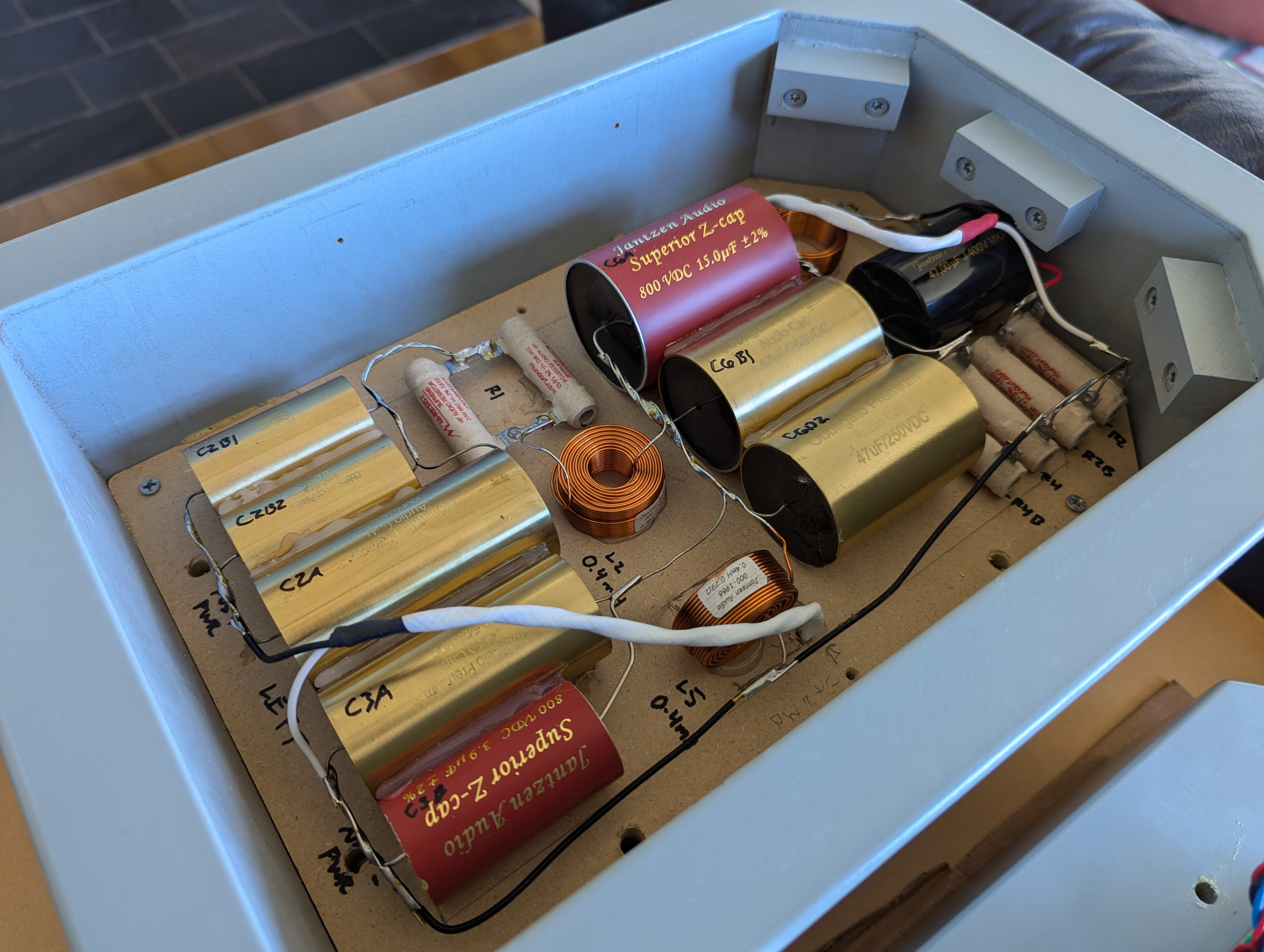

                  So after a long hiatus, thanks to work and some other things, I finally got around the final assembly of my Wavecor Ardents. I definitely take the record for longest build, but they and up and running and first impressions are great!
                  A couple of crossover photos:
                  Click image for larger version  Name:	Crossover-07.jpg Views:	5 Size:	1.88 MB ID:	953813
                  Click image for larger version  Name:	Crossover-08.jpg Views:	0 Size:	1.94 MB ID:	953815
                  Click image for larger version  Name:	Crossover-10.jpg Views:	0 Size:	1.78 MB ID:	953816
                  And the Final Product (yes, I will be better positioning these out of the corners in their final home):
                  Click image for larger version  Name:	Wavecor_Final-02.jpg Views:	0 Size:	1.79 MB ID:	953817

                  Very nice job on how you put together your crossovers! Let's be real, folks, sometimes slow work takes time pays off!

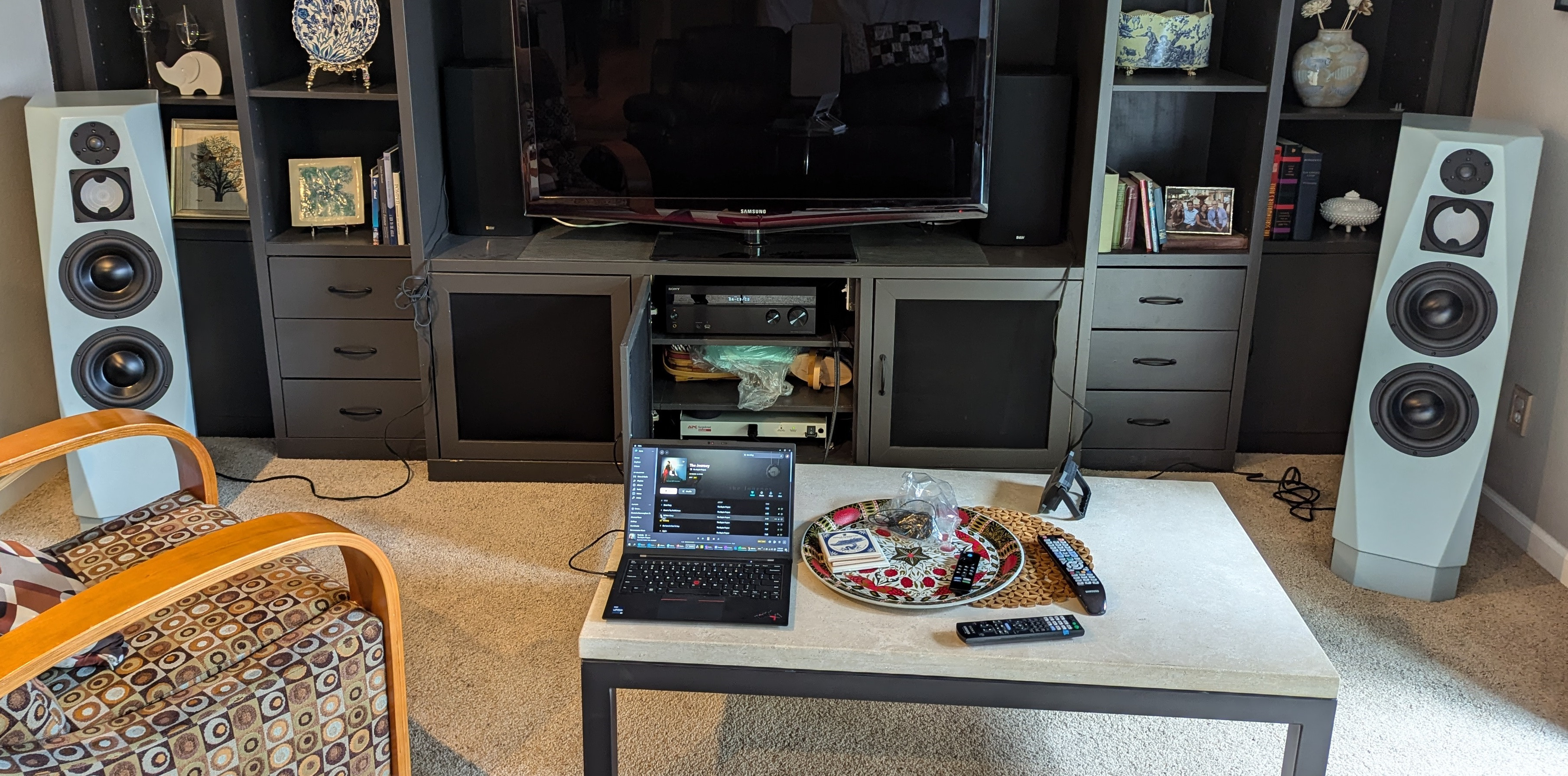

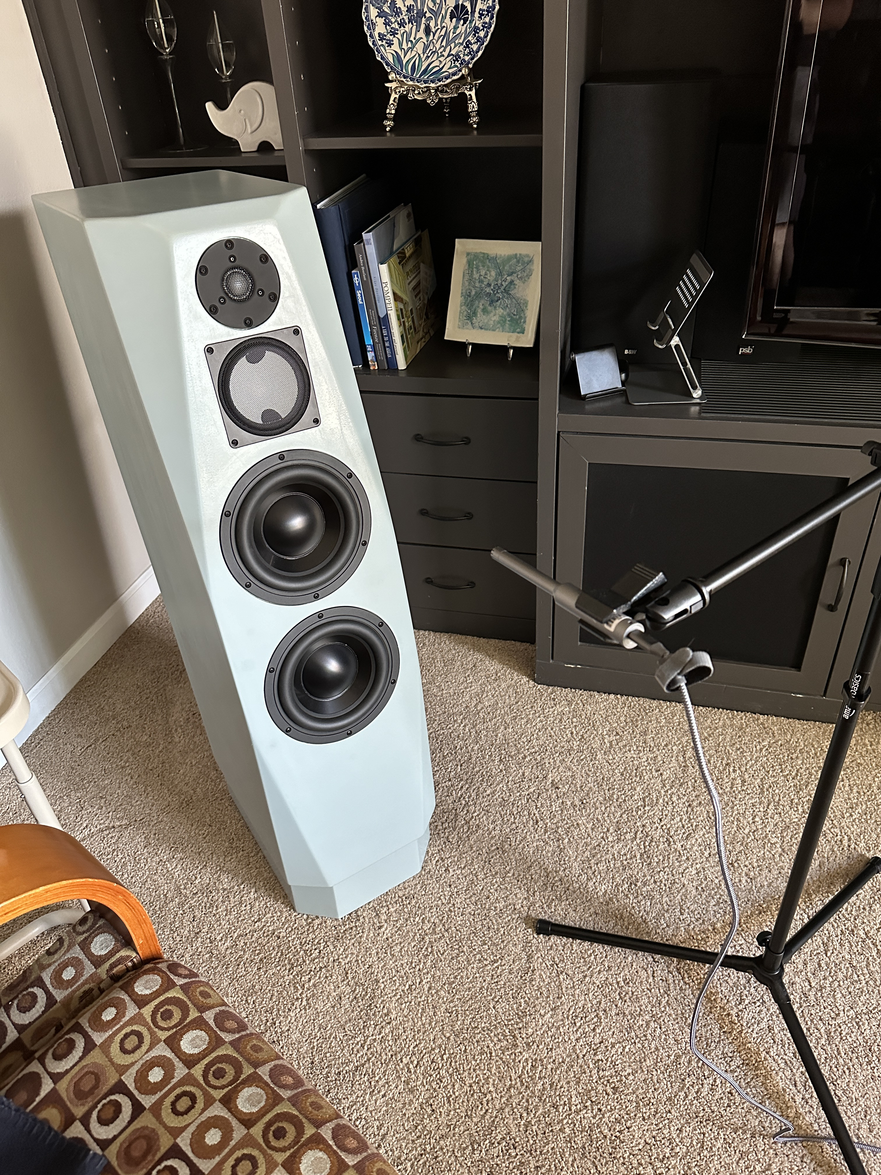

                        So I am very much a novice at measurements, but thought I'd post the first round. These were taken (by my dad) with no real care in speaker placement (still near the corners of the room). Measurements were taken with REW with mic placed about 1 meter away from each speaker (left and right measured separately), with the height of the mic between the midrange and tweeter. SPL was around 80 dB. Speakers were being driven by an inexpensive Sony receiver. Next time I'm down at my parents, we'll take some better measurements with the speakers more in the middle of the room away from walls and other furniture.
                        Definitely seeing some lulls in the response near the crossover points, and likely some room interaction.
