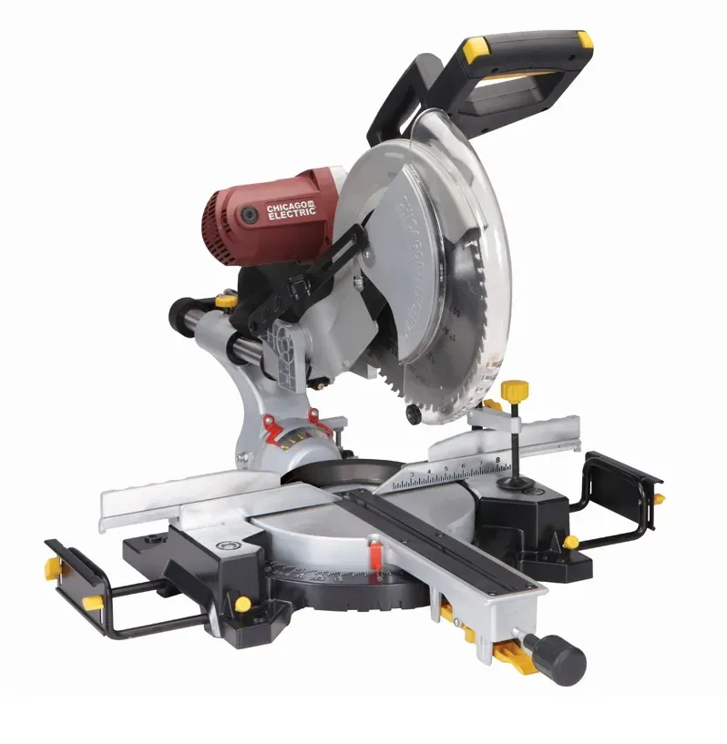

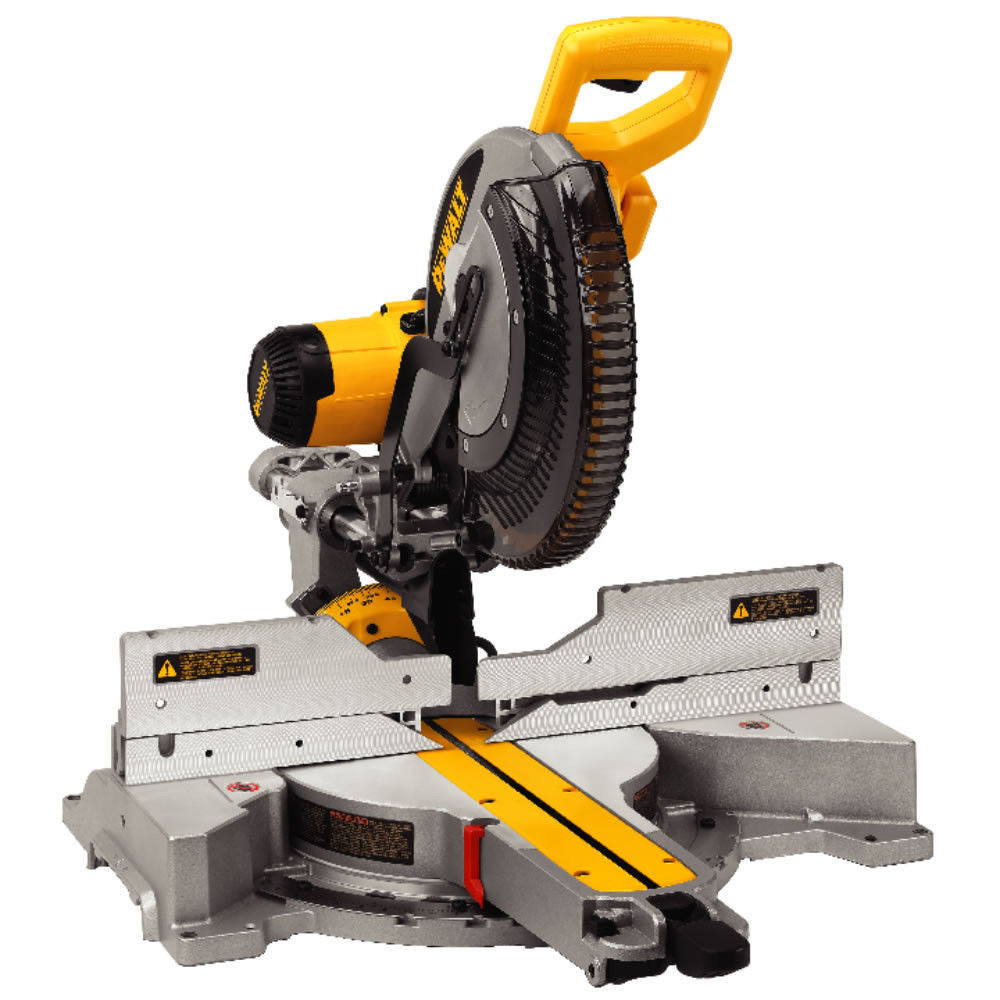

                              FWIW I went the 'middle ground' route and got the DW782 SCMS. As far as I can tell, it's basically the same as Jon's DW780 but comes with a cheaper blade and omits the fancy LED cut line illumination - for this you save about $200. I justified it by getting it to build a shed rather than paying the ~$1k labor for someone else to do it. Good trade, aside from getting too ambitious on the shed design and having it take WAY more time than originally planned.

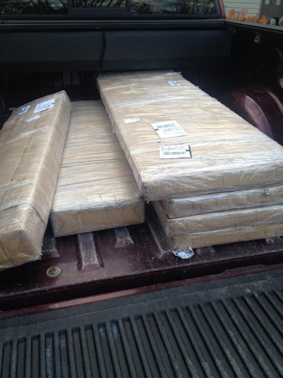

                                                    Starting to run out of excuses. LBL boards and Baltic birch ply arrived yesterday in good shape. Rough guess is the empty cabinets will weigh in a bit over 150 pounds for the LBL baffle build. The first draft build will be a bit lighter, only single walls on the sides, although the baffle will be close to the same weight.

                                                      Ah... wood.... high grade wood! I just ordered a few more panels from them to cover some prototyping. And the CatherineZ build.
