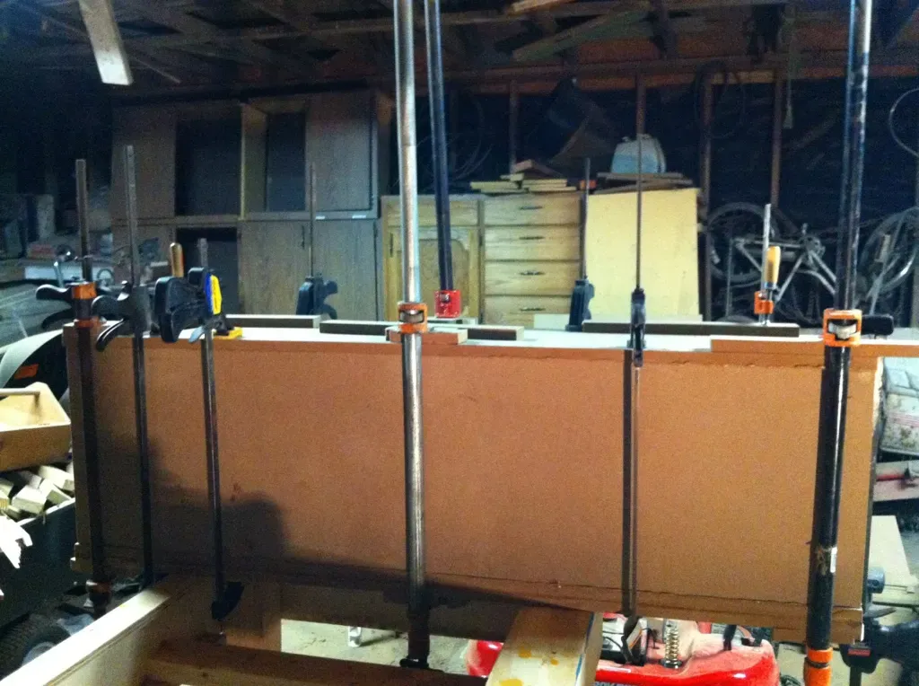

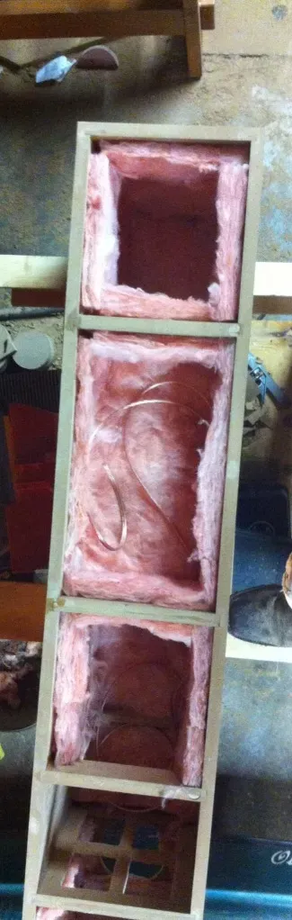

                        #101

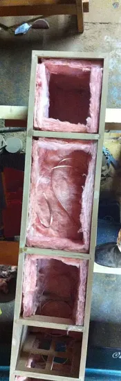

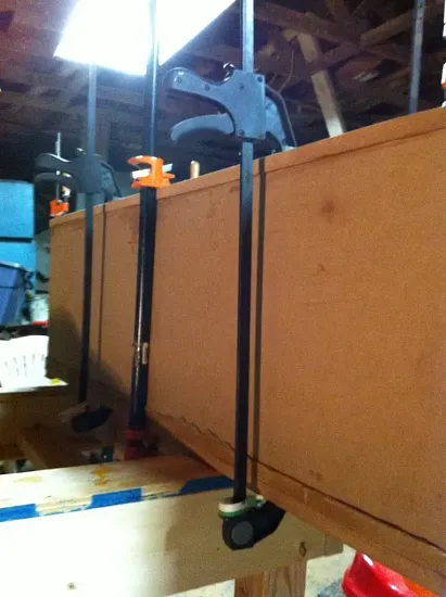

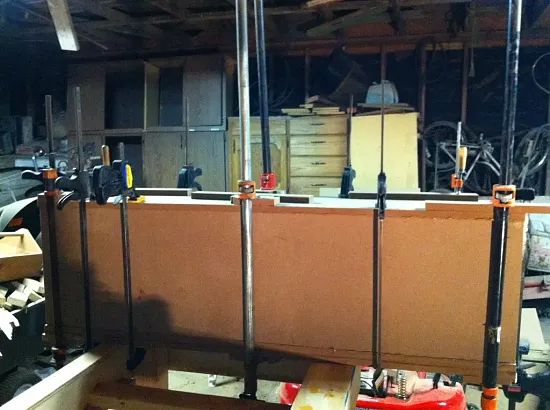

                        I put the fiberglass in one of the enclosures tonight. Just used a big pair of scissors to cut the fiberglass down to size. I used a hot glue gun to attach it to the sides of the mdf. (Yes the hot glue is still hot even through the gloves I was wearing... and yes my hands did look like cotton candy with the fiberglass stuck to the gloves ) 2" thick on the back, and approximately 1" on the sides. I ripped and cut the fiberglass in half to get the 1" (which is why its bigger and smaller in some places)
                        Went ahead and glued the front baffle on this box as well. Got a nice squeeze out all around, only a little more in some places.

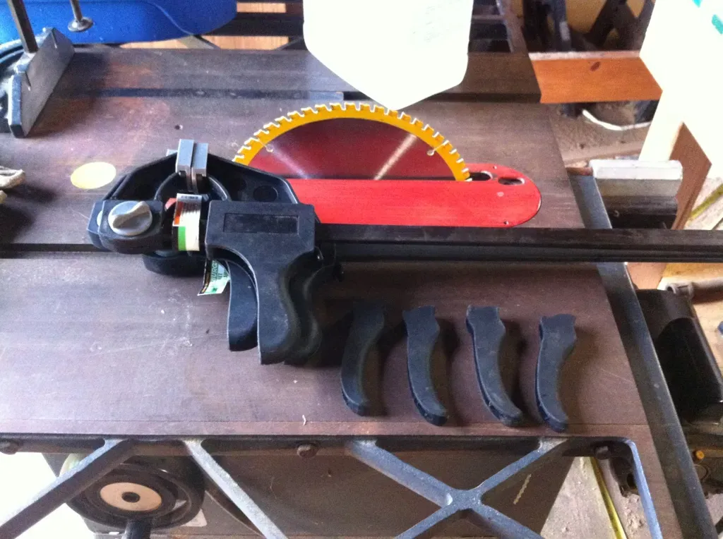

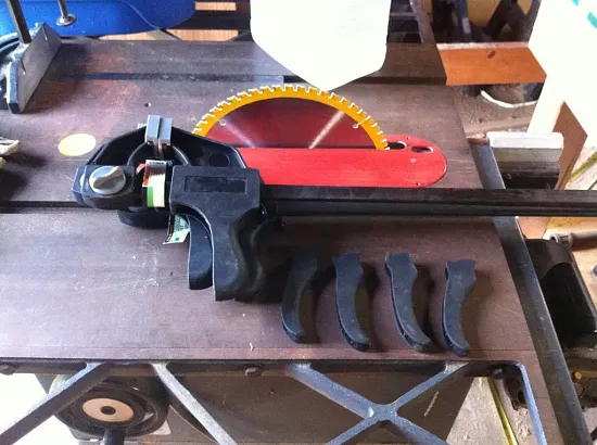

                        And, I thought I had a fool proof plan for not breaking the harbor freight clamps and still getting good pressure out of them. Clamping it down tight with a good clamp, then clamp the harbor freight one right next to it, then release the good clamp. It was going well, but I still broke another one
                        Last edited by theSven; 12 August 2023, 11:16 Saturday. Reason: Update image location
                          #102
                          Looking good. :T My harbor freight pipe clamps have served me well. But, I can imagine those trigger clamps being prone to breakage. Good tools are expensive. I've seen Woodcraft have the pipe clamps on-sale from time to time and picked up a couple.
                          • CADman_ks
                            • Jan 2012
                            • 497

                            What beaks on those HF clamps? The actual clamping mech?

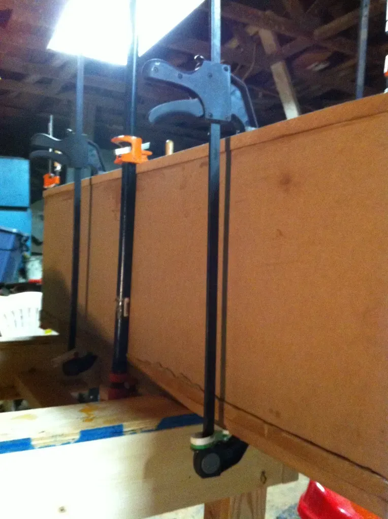

                              #104
                              The trigger is the part that breaks off. It seems to be at random pressures too, sometimes I'll get half a squeeze out of it, sometimes I'll get two squeezes out of it.
                              I think I'm gonna try and get some pipe clamps to replace them today.
                              Last edited by theSven; 12 August 2023, 11:17 Saturday. Reason: Update image location
                              • AdelaaR
                                • Dec 2010
                                • 480
                                #105
                                I don't think the problem is in the design but in the materials.
                                Those trigger clamps do look like they're poor quality so I'm not surprised they break.
                                I've got a decent trigger clamp here that can take 200 kilo's of pressure without any problem.
                                Since making my defusers though, I started to not like my trigger clamp since the arms of it are very thick ... kind of like yours have ... and it makes it unhandy to insert it into small cavities while applying pressure.
                                I use simple cheap deep throat bar clamps now and they are more versatile.
                                  If you're getting pipe clamps from HF, one would have to assume that they couldn't screw those up as easily, since they are cast iron, but hey, this is HF, so all bets are off there.
                                  I have both Irwin style clamps like you broke, and pipe clamps. One bad thing about pipe clamps is that you have to adjust them on both ends. You have to grab the "moving" end to take out most of the slop, and then you have to go to the other end to do the tightening. That's OK, and it works, but generally speaking, I personally think that pipe clamps are a little more clumsy than the squeeze clamps. Pipe clamps are also heavier.
                                  With that being said, pipe clamps are bullet proof, and they can crank the pressure down if you really need to...

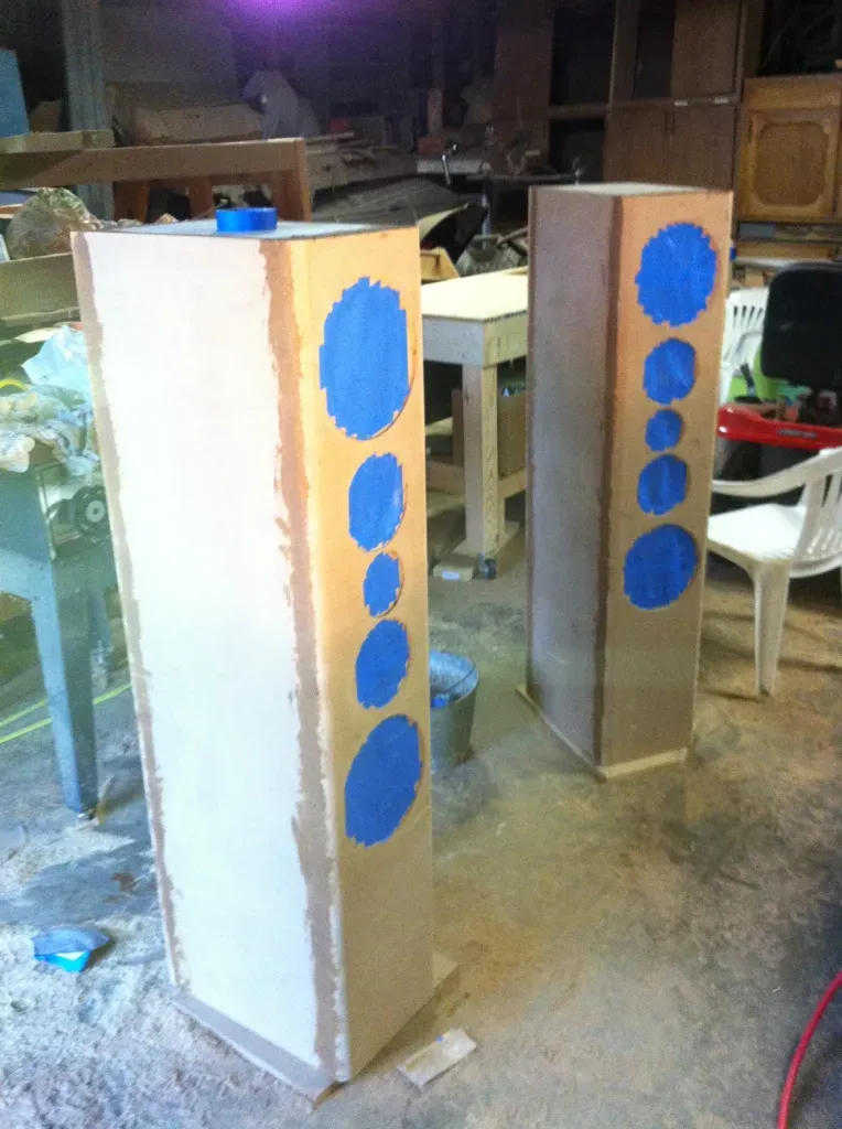

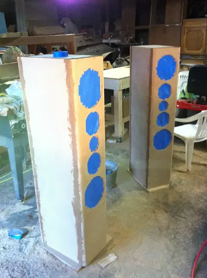

                                    #107

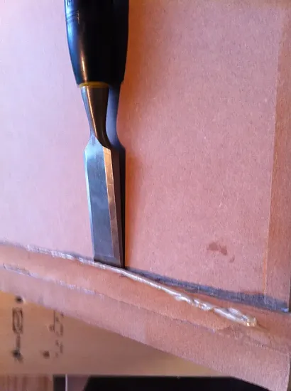

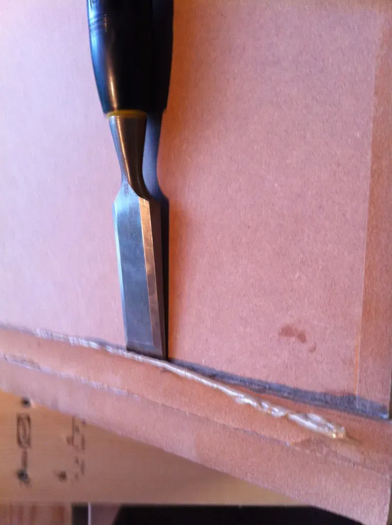

                                    So I went back to harbor freight today and they actually exchanged the broken ones for new ones, Ill try hard not to break these! I had a spare 3/4 pipe I didn't have a clamp on so I picked up a clamp kit for it as well, so there's one more clamp

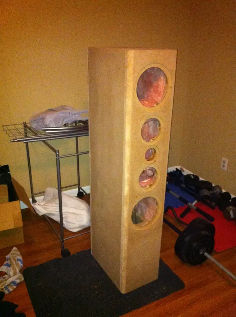

                                    Took care of the squeezed out glue today, the chisel worked great and the glue only tore off the face of the MDF on the hangover that was going to be routed off.

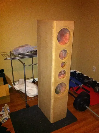

                                    Got the back baffle flush trimmed and the front rounded over tonight on one cabinet, and I'm very happy with how it turned out.
                                    The second cabinet has the back glued and clamped right now.
                                    I really want to put the veneer on this one already, but I think I'm gonna wait and get everything hooked up to make sure I don't have any leaks first.
                                    Before I veneer these, do I need to fill in the tiny cracks with wood filler, or will it be fine?
                                    Last edited by theSven; 12 August 2023, 11:18 Saturday. Reason: Update image location

                                      I see you have already started working out to be ready for when you'll have to move these speakers around.
                                      No seriously: nice going there ... looks great
                                        #109
                                        You want a smooth surface to veneer and should fill cracks, dings, etc. They will telegraph through otherwise.
                                        Looking good!
                                          So I went back to harbor freight today and they actually exchanged the broken ones for new ones ...
                                          Most of their hand tools do have a lifetime warranty on them, and I have heard others say that they replace things that are broken. It's good to know that they do at least honor the warranty.
                                          Took care of the squeezed out glue today, the chisel worked great and the glue only tore off the face of the mdf on the hangover that was going to be routed off. ...
                                          That's GREAT! After telling you to wait, I was a little bit concerned that the face of the MDF might peel off of there as well when you chiseled it off.
                                          Click image for larger version  Name:	ecb94ab7.webp Views:	0 Size:	77.6 KB ID:	947470
                                          They are looking GREAT!!!

                                                #113
                                                Mix sawdust with pva (yellow or white) glue. Nice filler.

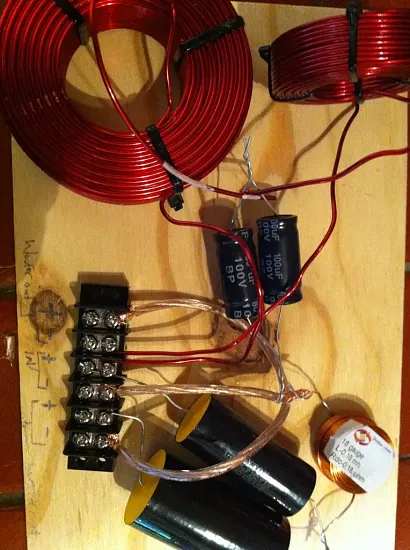

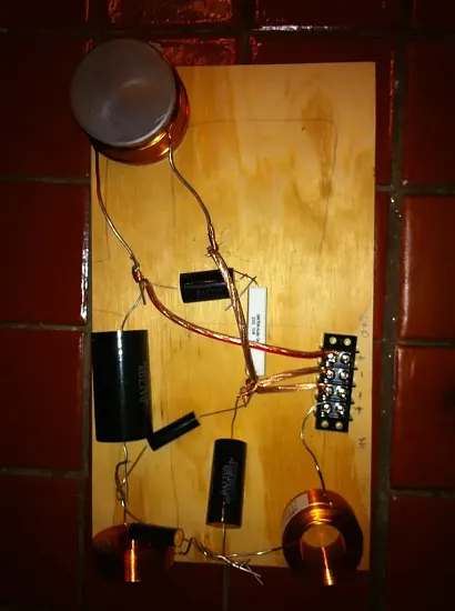

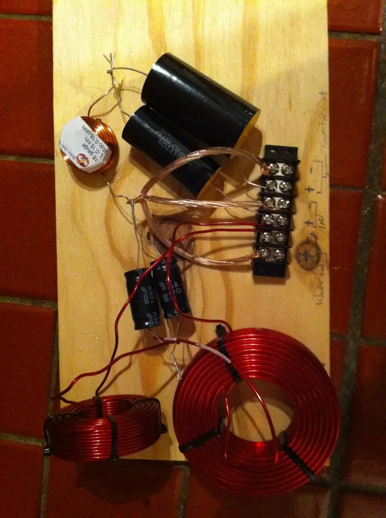

                                                        I think the most frustrating part with finishing for me is the amount of work I put into it, and then I still know about all the flaws!

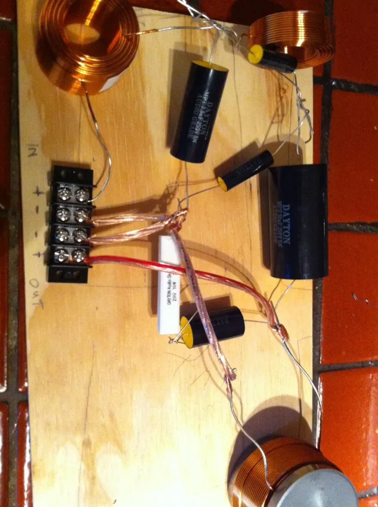

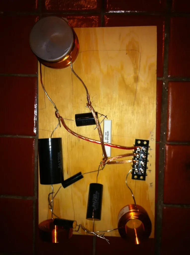

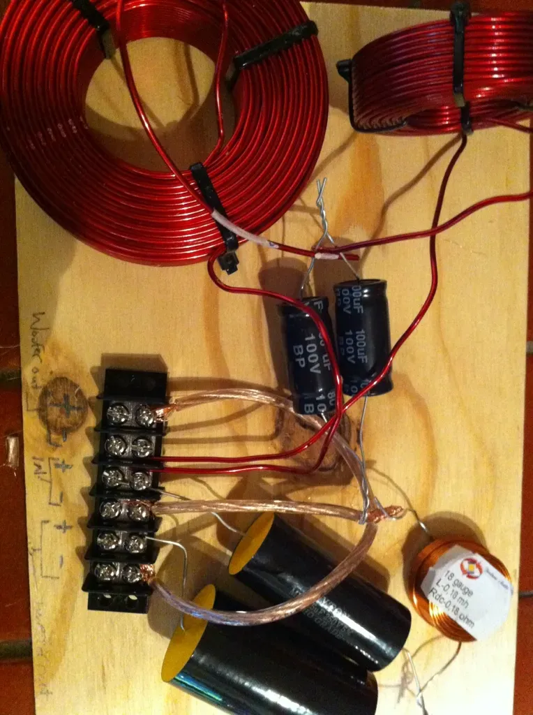

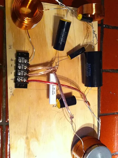

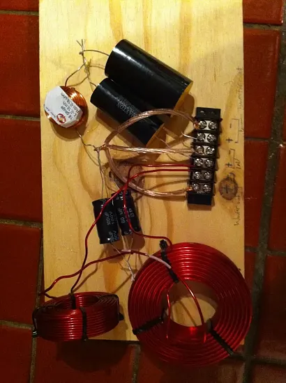

                                                        OK so crossover work time I know you guys probably hate this question (and even more so because of my sloppy work and bad camera) but I would love it if someone would evaluate my crossover
                                                        Mid:
                                                        Tweeter and woofer:
                                                        Last edited by theSven; 12 August 2023, 11:23 Saturday. Reason: Update image location

                                                            #119
                                                            Evaluation of the crossover: it would be better to actually solder it together

                                                              Do the best that you can, and be happy with it.
                                                              I couldn't agree more.
                                                              The finishing isn't important for the sound ... it's only aesthetic.
                                                              The finishing on my F4's isn't all that ... but it looks fine from a normal viewing distance and they sound just great
                                                                • 16170
                                                                #121
                                                                +1. Also, I'm a bit OCD about putting things together, neat and orderly. But then I'm not familiar with the recommended Khanspire Xover layout, either.
                                                                In the end, it's not how nicely the crossover components are laid out, or how top notch the finishing job is, but how much pleasure they bring to you when you press the play button or drop the needle, and lean back and close your eyes to listen....
                                                                  #122
                                                                  Recommended layout? My only recommendation, which looks like it's done well, is paying attention to inductor relationships. There are always ways to tighten stuff up, but if the space is there, why?
                                                                  And I *always* twist and test, then solder. Solder holds it together, but the connections are wire-to-wire that way.
                                                                    #123
                                                                    You guys just have too high of expectations when it comes to finishing!
                                                                    Blahhh. Mine traveled to DIY Iowa with my crossovers just twisted together and were very well received. I think it was two or three months before I took them out and soldered them. Solder smoger.
                                                                      For my speakers, I don't mind taking a look. But I really need a straight top down photo that gets everything in. It's a tough crossover to check over the internet, but I'll give it my best shot.
                                                                      • Blink
                                                                        • Feb 2012
                                                                        • 58
                                                                        #125
                                                                        Thanks so much! I'm slightly embarrassed I don't have a more clear picture or layout but please feel free to give up on it if you can't make out what is what.
                                                                        Mids:
                                                                        Tweeter and woofer:
                                                                        Last edited by theSven; 12 August 2023, 11:24 Saturday. Reason: Update image location
                                                                          #126
                                                                          I spent about 10 minutes looking at your photos. They generally look right to me. I'm not seeing a connection between the two woofer inductors and the 180 uH cap, but they all cross there, so I'm guessing it is just the photo. Make sure all three of those components are twisted together.
                                                                          I like the ground wire approach to laying these things out, because it makes it a little easier to check. One check I always make is to count the number of connections to the ground on the schematic and then count them on your ground wire.
                                                                          Curt Campbell has an article about laying out crossovers here, if you haven't seen it.
                                                                          But, it looks right. So make sure you get the woofers in parallel and the mids in series. Make sure you get the phases right, and you should be good.

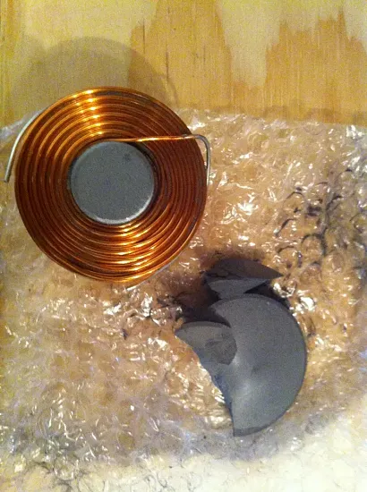

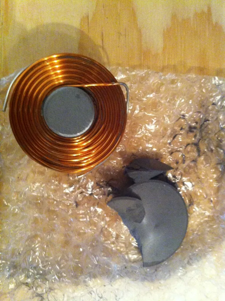

                                                                              #128
                                                                              So I pulled my other P-core inductor out of the packaging...
                                                                              :cry: :cry:
                                                                              I'm so close to finishing this...can I still use it or do I have to send this one back?? Is this a sign I should have gone with the upgraded one?
                                                                              Last edited by theSven; 12 August 2023, 11:25 Saturday. Reason: Update image location
                                                                                #129
                                                                                Call PE. I bet they'll ship you a new one without having to ship that one back.
                                                                                Yes sandpaper the inductor wire. Burning with a small torch also works.

                                                                                  #130
                                                                                  Well you were right, they are shipping another one tomorrow and I don't have to ship the broken one back. I suppose this means I'll go ahead and start finishing the cabinets now, which is probably a good thing since I keep reading people don't want to take the drivers out and finish them after hearing them

                                                                                    #131
                                                                                    Aren't these ends usually tinned? It's obvious that his are not.
                                                                                    I've bought inductors from PE and Erse both, and all of the ones that I have ever received have already been tinned...

                                                                                      So I filled all the seams with a sawdust and glue mixture (about equal parts of each). Using the PL glue I had a slightly larger than normal gap to fill. Worked pretty well initially, but it is a pain to sand. I thought it would sand off easily like wood filler, but it takes significantly more time even with 60 grit paper.
                                                                                      Last edited by theSven; 12 August 2023, 11:26 Saturday. Reason: Update image location
                                                                                      • CADman_ks
                                                                                        • Jan 2012
                                                                                        • 497
                                                                                        #133
                                                                                        ... I thought it would sand off easily like wood filler, but it takes significantly more time even with 60 grit paper. ...
                                                                                        Yeah, glue gets hard when it's dry. Not easy to sand...

                                                                                          #134
                                                                                          Might have needed more sawdust. I've only found it marginally difficult to sand.
                                                                                          Oh well. You'll get there. Sorry for suggesting something that's miserable.
