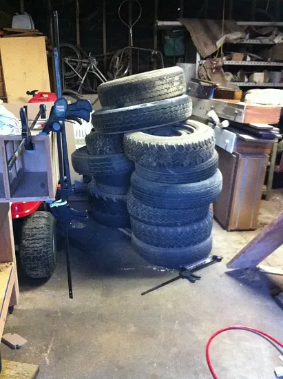

    So here some more fun gluing pictures!! I got a little carried away with the glue in the mid enclosure... but I don't think its going anywhere now

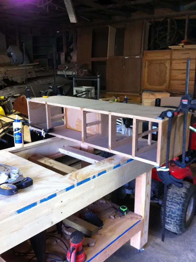

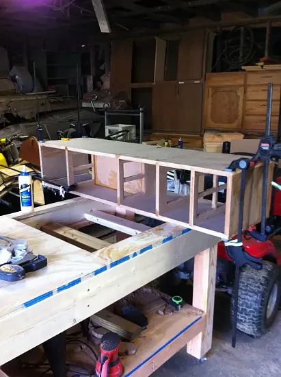

    I didn't have enough clamps to laminate the front baffle pieces, so here's my improvisation
    I think I put too much glue in there on that one... We'll see how it turns out. That wouldn't be a huge problem would it?

        I didn't have enough clamps to laminate the front baffle pieces, so heres my improvisation
        Water softener salt bags. :B (...but you have to have a need for them, or why else would you have them sitting around?)
          Better too much than too little. The excess should squeeze out, you'll just have more clean up to do.

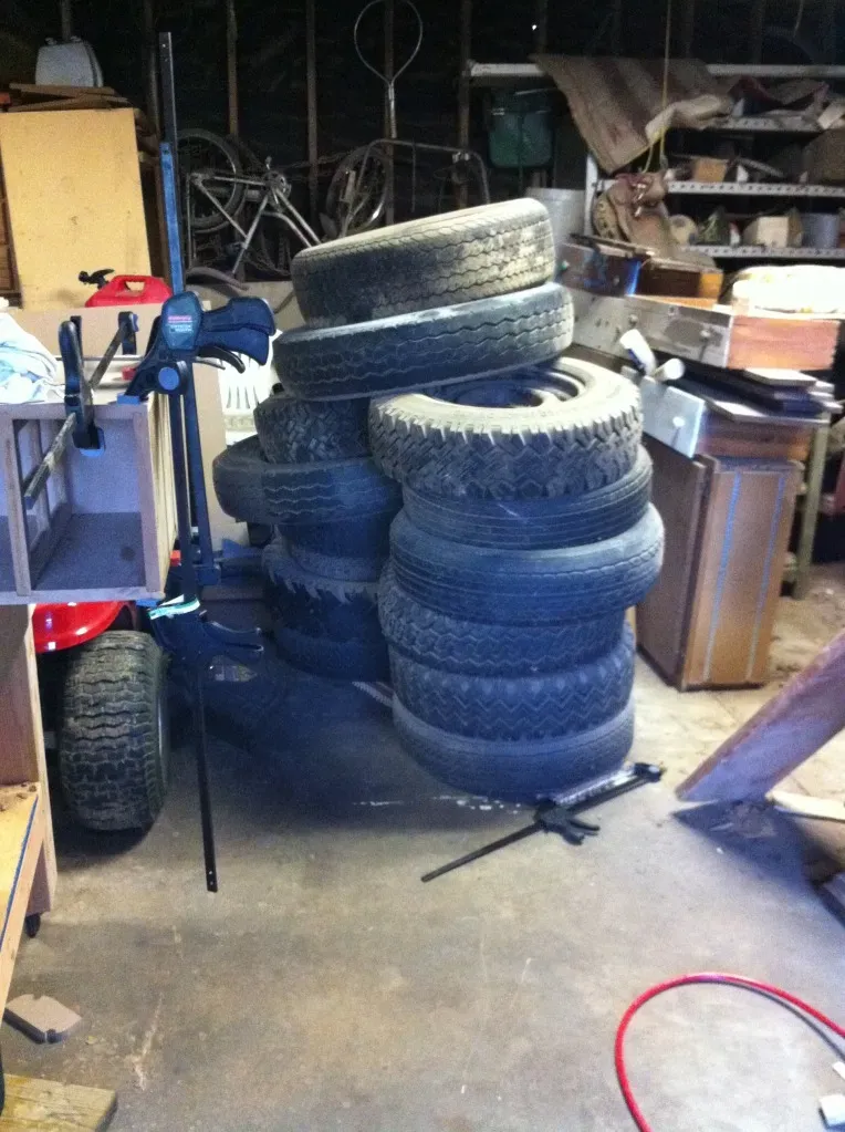

            I hope its not stuck to the floor!
            • CADman_ks
              • Jan 2012
              • 497
              Now that could be an issue!!! :rofl:
              If you cut that front baffle bigger than the cabinets, and you plan to flush trim it later, then the excess glue shouldn't be a huge deal. You'll just need to make sure that you get as much of it off of the sides as possible before trimming...

                There's nothing wrong with excess glue. Wax paper will aid in cleanup during the gluing process.
                Statements' Build
                  Tires.... that is funny.
                  I don't see an issue with too much glue, unless your relying on it to fill gaps. But I don't see that here.
                  I am wondering how Wax Paper helps clean up. I've never used wax paper. Please share.

                    Good news, they weren't attached to the floor. But I'm thinking the first baffle (the one with more glue) might not be attached very well. I can't pull the boards apart, but there is a hairline gap between the boards in some spots, but they seem to be stuck together well otherwise. Should I be worried?
                    And yes I cut the fronts and backs oversized about 3/16 on every side to be flush trimmed.

                      I would imagine that the vast majority of the interior is well-filled with glue. As long as you know you put a lot of glue on the inside I wouldn't worry much about the outside edges. Once you trim them down you will probably see less of a gap.
                      There is no way you could pull those boards apart unless you did something really, really odd! :

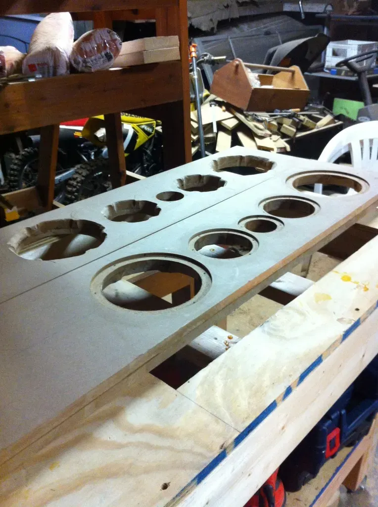

                                  Got a little bit of progress done tonight, holes for the ports cut out of the back baffles.

                                  My test cut with the jasper jig fit perfectly snug with the port tube... but the second and third holes were both uniformly slightly bigger (not enough to make a huge fuss over)... Did I do something wrong, or do other people notice this after using the pivot hole a couple times? For the driver holes, should I cut them smaller and then sand them bigger?
                                      Not sure how your holes got bigger. You sure you used the right setting? Maybe the pin moved? You are using that MDF crap. If you used good plywood you definitely wouldn't have that problem. :P
                                      Sanding is a pain in the behind. I've been forced down this road on several projects and don't recommend it.
                                      Another thing, if you're making them tight, your going to have another pain in the butt on your hands trying to remove the drivers from the holes later on down the road - especially if you paint the baffles and add a little thickness to the holes. A nice thin uniform gap around is good.
                                            Check the screws holding the router base to the jasper jig. Most likely what happened was the screws were not tight enough and router base shifted on the Jasper jig as you put pressure on it. Also, make sure the 1/4" bit is centered in the hole of the Jasper jig. If I remember correctly, they provide a centering pin with the jig to make this easy.
                                            I have cut at least 20 holes with my jasper jig and never had a problem with the size changing from hole to hole.
                                                      The 1/4" bit lines up perfectly, its on the 1/2" bit I'm using for the lip that is having the issues. But thats a good idea, I will definitely check the screws this time around!
                                                          Well you were right, it was the screws. I apparently had got in a hurry putting it on, and tightened one down before it was squarely in the hole on the jig. (now if I can only remember this "trick" when I need to make the hole slightly larger than the given measurements)
                                                          Got some test cuts done for the drivers and they are back to snug.

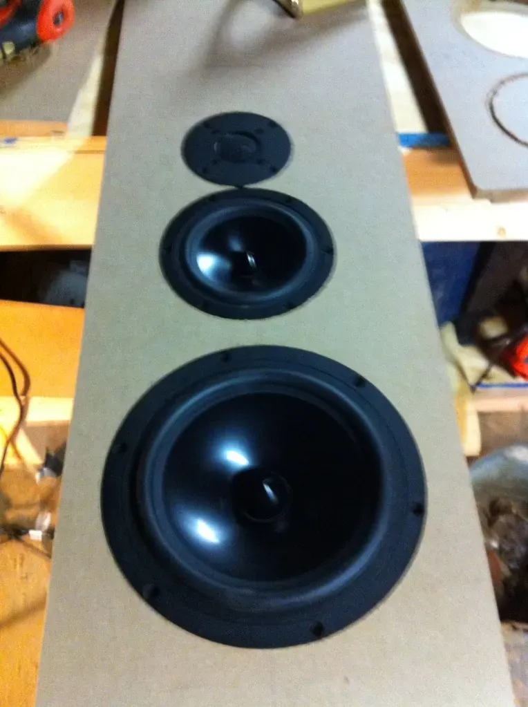

                                                          I plan on veneering these when I'm done, do you think I would have a problem with the veneer between the mid and the tweeter?
                                                          Last edited by theSven; 12 August 2023, 11:14 Saturday. Reason: Update image location
                                                            I'm currently square in the middle of my first veneering project, so take my guidance with a grain of salt.
                                                            Are you going to use paper backed veneer? I've noticed that the paper doesn't always cut off of the veneer cleanly, and you'll end up with a little bit of paper that you have to clean up.
                                                            With that being said, tiny veneer pieces are really hard to make hold together anyway. You're really at the mercy of the wood to hold it together, and there isn't really much "structure" there to make that all hold together.
                                                            I would think that you're going to have issues there.
                                                            One thing that you might do is deliberately NOT put any veneer across that gap, but make all of the gaps look the same. Then paint that region black under there...

                                                              I've never veneered, so I'm no help here. It probably all depends on how perfect do you want them to look. My less than ambitiousness nature would lead me to do as suggested above - Get the veneer close and trim even on both sides and stain the gap black. I'm not saying that you have to redo your bafffles, but if you do, don't hesitate to move the mids out 1/8" - 1/4" to avoid that problem. Theoretically the closer you get them the better, but that small of a change isn't going to change the crossover and likely won't be audible.
                                                                    Click image for larger version  Name:	photo-7.webp Views:	0 Size:	46.9 KB ID:	947464
                                                                    I looked at your picture again, and it's kind of hard to tell, but it appears that you have a missing piece between the two drivers, where the MDF might have broken off or been consumed in one of the cuts.
                                                                    If there is indeed a missing piece there, you will not get veneer to bridge that gap and stay there. You would have to build that area back up with Bondo or wood filler, and then re-shape it.
                                                                    There's just not much left there, even with that being said...

                                                                        These are the clamping guidelines from TiteBonds web site:
                                                                        Clamping Guidelines
                                                                        • Appropriate clamp pressure is essential for a successful bond. We recommend the following guidelines:
                                                                          • For softwoods (pine, poplar): 100-150 psi
                                                                          • For medium density woods (cherry, soft maple): 150-200 psi
                                                                          • For hardwoods (oak, birch): 200-300 psi
                                                                        • Clamp time is dependent on wood species, moisture content and environmental conditions. For most of our wood glues, we recommend clamping an unstressed joint for 30 minutes to one hour. Stressed joints, such as bent laminations, need to be clamped for 24 hours. Do not stress the new joint until totally cured - at least 24 hours. For Titebond Polyurethane Glue, we recommend clamping for at least 45 minutes. The glue is completely cured within 6 hours.
                                                                        • Clamps should be positioned a minimum of 1 1/2" - 2" in from the sides and evenly spaced at 8" - 12" throughout the piece.
                                                                        Even one hour seems a little low to me. I agree with Joey that overnite is probably what the doctor ordered. But, I would think that if you wanted to do a couple of clamps on a Saturday, it would be OK to take the clamps off after 4 hours or so. That would let you do some in the morning, and some in the afternoon, and possibly later in the evening as well...
                                                                          This is pretty much what I follow......Well put.
                                                                            It all depends on how rough you are with your boxes. If you clamp for 4 - 6 hours (depending on weather, etc) you can probably release the clamps. BUT, you can's then go picking the box up and tossing it around in such a manor as to stress those joints. You also can't go clamping in the opposite direction such that the clamps would put stress on those joints. If you're taking the clamps off before full cure, I think you need to let it rest.
                                                                            Me, I like to toss my boxes around. I leave them clamped for 24 hours or I use a brad nailer. I really like my brad nailer since I got it.
                                                                            • yzracer14
                                                                              • Apr 2011
                                                                              • 51
                                                                              Since when is anything in DIY home theater considered overkill?
                                                                              I'm with ---k---
                                                                              When I unclamp any assembly, I don't wan't be limited on what I can do with it. That includes, grabbing it by the woofer holes and tossing it around in any position I need. That's actually what i have to do right now with my current build. I'd be afraid to touch it, unclamped, after only 4 hours.
                                                                              IMHO, play it safe.

                                                                                  Luckily those cuts were on the test board, so all options are still on the table.
                                                                                  About the clamping times, I suppose I was mainly wondering about releasing the clamps, because like CADman_ks probably knew what I was thinking, I'm planning on working on these all day tomorrow
                                                                                  Broke 3 of my 6 harbor freight clamps so far... I suppose I will slowly replace them with quality clamps, but for 5 bucks a clamp, I think I got some use out of them.

                                                                                          Test boards? What are these "test" boards you speak of? :rofl:
                                                                                          Hey its my first time cutting accurate circles (read not free handed with a crappy jig saw) and first time using my new router!

                                                                                            Got the baffles almost finished
                                                                                            Probably should have asked for an easier method to open up the woofers and mids, but ended up using a dremel sanding drum... took much longer than I expected and I sucked at it! At least only I will be troubled by it, no one else will ever see it.
                                                                                            Right now the back panel of one of them is glued and clamped. I have a feeling I'm going to have some leaks How do people deal with these? Can wood filler or bondo work in this situation??
                                                                                            Last edited by theSven; 12 August 2023, 11:16 Saturday. Reason: Update image location
