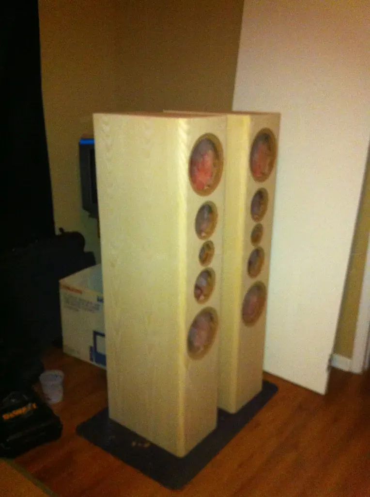

        #138
        lol no worries, I think it'll work swimmingly! Plus it didnt cost me anything! Everything is completely flat now and I've started veneering.

        Also the replacement inductor got here today so hopefully I have things completed soon!
            Click image for larger version  Name:	bf6fda73.webp Views:	0 Size:	42.7 KB ID:	947478
            Is that oak veneer?
            Do you know if it's rotary, flat, or rift cut?
            LOOKING GOOD!!!

                    #144
                    Is that oak veneer?
                    LOOKING GOOD!!!
                    Thanks! It's flat cut ash. Really cheap stuff, but I think im gonna go with a black dye for the finish.

                      #145
                      ...Really cheap stuff, but I think im gonna go with a black dye for the finish.
                      That should really look nice dyed black...

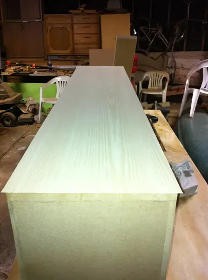

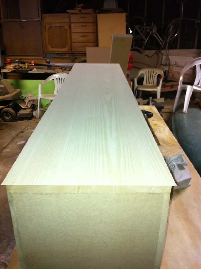

                        #146
                        I need to find a proper camera... But spent all day veneering, and getting closer to finishing.

                          #147
                          DUDE! You're flying!!!
                          Those are going to look really nice...

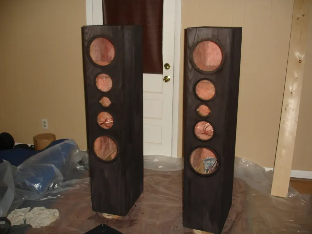

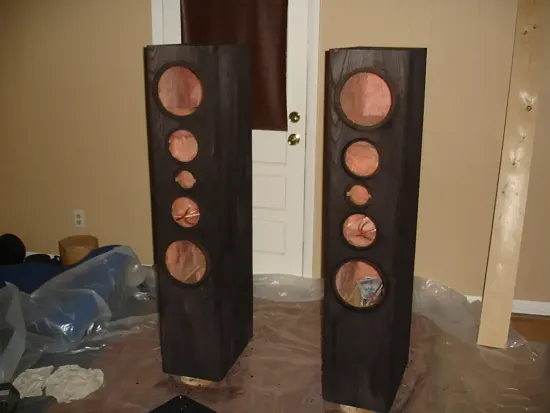

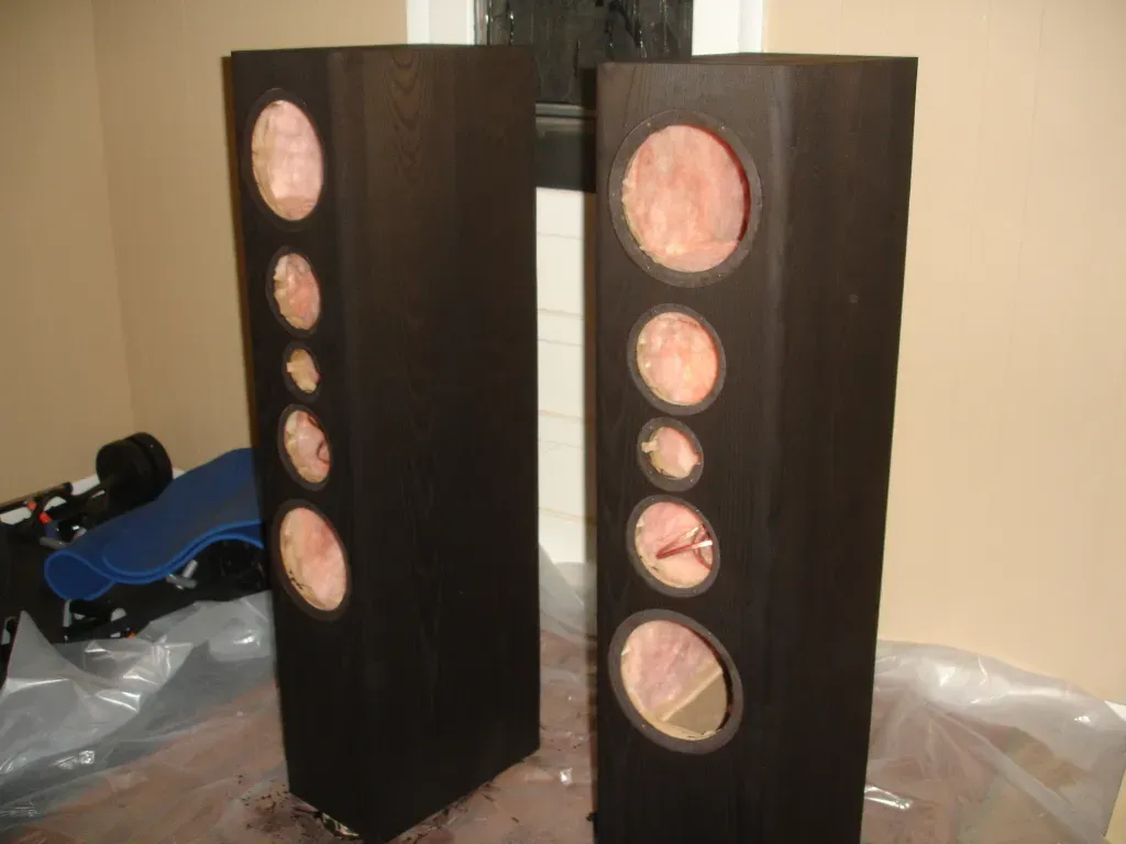

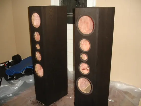

                                              #157

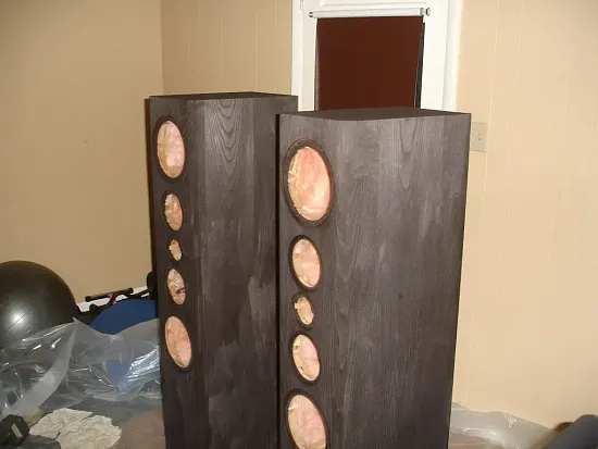

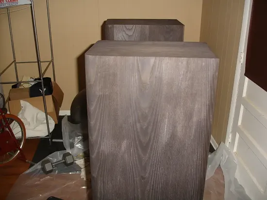

                                              Started dyeing tonight (not dying ) I'm using HOMESTEAD TransFast Dye
                                              Here's after one coat (still drying):
                                              Last edited by theSven; 12 August 2023, 11:30 Saturday. Reason: Update image location

                                                • Feb 2012
                                                • 58

                                                Also, I almost forgot, thank you everyone for the compliments again!!
                                                • CADman_ks
                                                  Started dyeing tonight (not dying ) I'm using HOMESTEAD TransFast Dye ...
                                                  Just reading on that dye stuff, and it appears to be a neat process.

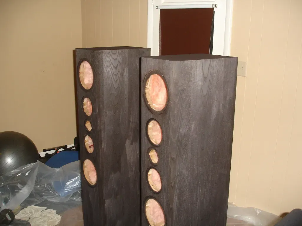

                                                  It appears that you have some lighter spots, which is what always happens with darker stains, and you're as dark as you can go with black, but this is dye, not stain.
                                                  How many coats of that dye do you think you'll need to put on?
                                                  Did you spray it on, or wipe it on?
                                                  Alcohol or water?

                                                    Going to be DAMN SEXAY when you are done. Lovin' it.
                                                      #161
                                                      Those look fantastic! They'll look even better once you get the glossy finish on them.
                                                      I'm no where near an expert here, and this may be horrible advice, but I seem to remember remember when I did my small little D4, after I stained them, I wiped them with water to make the grain swell and pop, then I hit it very lightly with fine sandpaper to take some of the stain off the top of the grain. Then, optional, to go back with a diluted stain. Something like that. I was working with some birch ply that didn't have near the definition and prominent grain as what you have. But might be something to experiment on some scrap and see if you like.

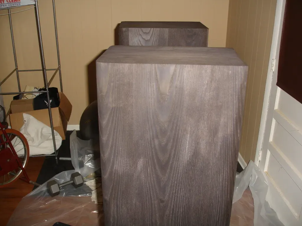

                                                                                  So the flash on a camera is a double edged sword... makes it look alot lighter than it is in normal lighting, but it also makes it much easier to see where I've messed up!
                                                                                  Did I just buy really cheap veneer, or is that normal with the alternating lighter then darker sections where its joined? (its barely visible now in normal lighting though)

                                                                                    #176
                                                                                    Shhh ... don't stare at the details ... they look great

                                                                                        #178
                                                                                        ... Did I just buy really cheap veneer, or is that normal with the alternating lighter then darker sections where its joined? (its barely visible now in normal lighting though)
                                                                                        Do you know for sure what grade of veneer you bought?
                                                                                        Even if your veneer is "B", I think that it's normal variation in the way that veneer, and wood in general looks.
                                                                                        It might be easier to see these differences, though, when you're going black...
                                                                                          What did you use to glue the dampening material?
                                                                                          I'm gluing my dampening in my Statements atm with spray glue ... but I'm going through bottles way fast
                                                                                          Thanks! I just used a hot glue gun, and I think it worked pretty well.
                                                                                          Originally posted by slusho
                                                                                          I do have one question - am I the only one that uses the old-style bar clamps from HF? Not the knock-off plastic ones, and not the pipe clamps, just regular bar clamps? I have a bunch, and they are even less expensive than the quick release ones, and seem to hold up really well.
                                                                                          I have a couple bar clamps, and the problem I have with them is the bar bends way too much if lots of pressure is needed.
                                                                                          I'm not unhappy with the veneer at all! I think it looks good, I was just merely curious. Here's the veneer I used Ash, White, Flatcut

                                                                                            #180
                                                                                            Hi. Pretty normal for veneer.
                                                                                            We'd call that "Picket Fence" at work. I believe it comes from the way veneer is sliced, which means that the woodgrain on each side of the veneer leaf is affected differently as one side is being lifted when the blade cuts the leaf from the log. Then every second leaf is turned over, if you are bookmatching, which it appears you have, so you get a subtle difference in how the grain reflects light and how it will take a stain.
                                                                                            Have never done it but I'm told by guys with a lot more experience than me that you can overcome the effect by roughing the surface of the veneer (like a good hit with 80 grit) which will break up the surface so both sides of the leaf are even. and then stain. Then seal coat, sand to de-nib and then move on to finish.
                                                                                            Like I said, I'm not an expert in finishing, so would pay to do furthre research if you want to overcome. I may be able to find you some links to industry papers on it if you wanted.
                                                                                            Cheers
