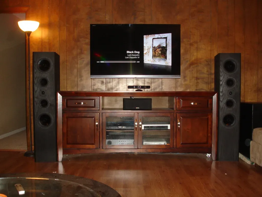

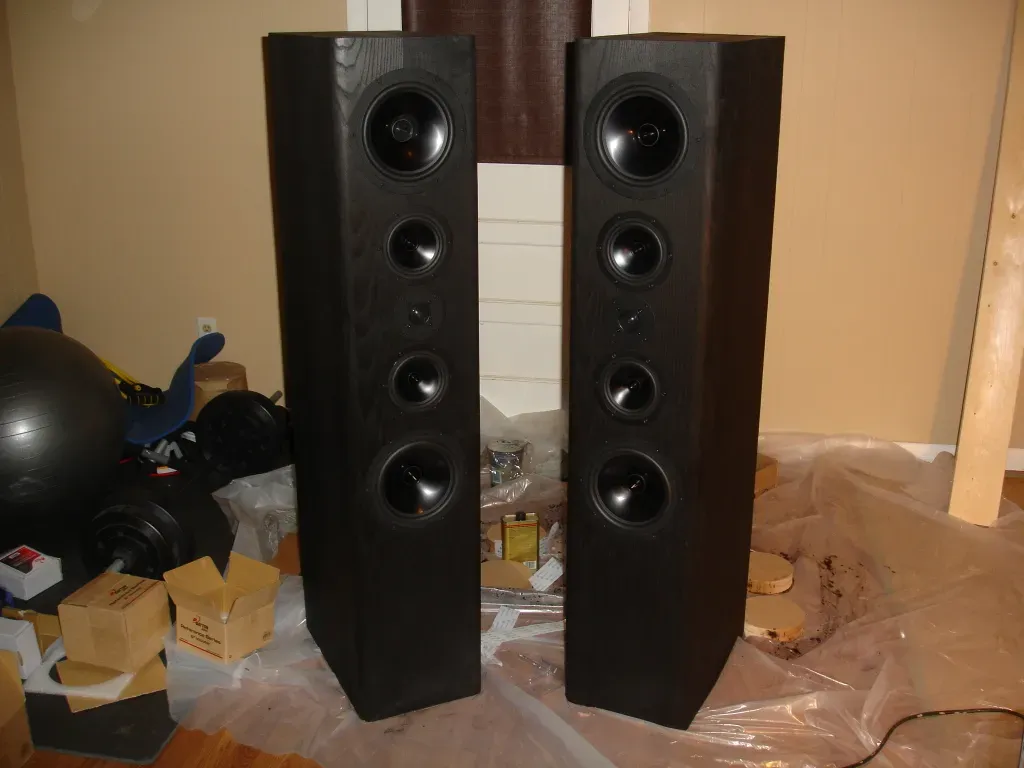

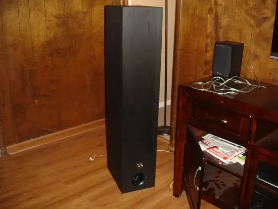

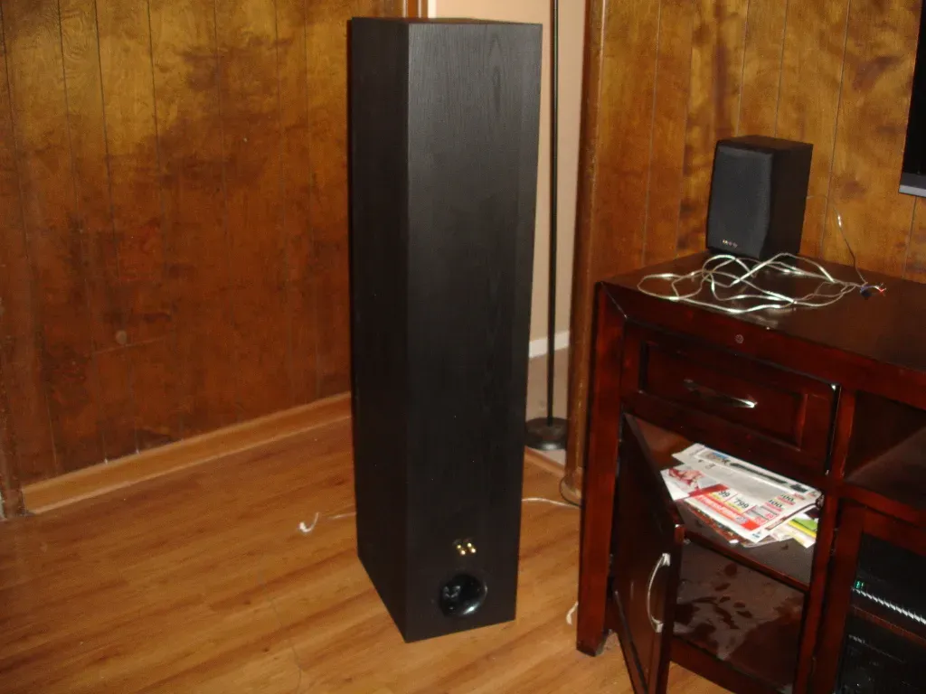

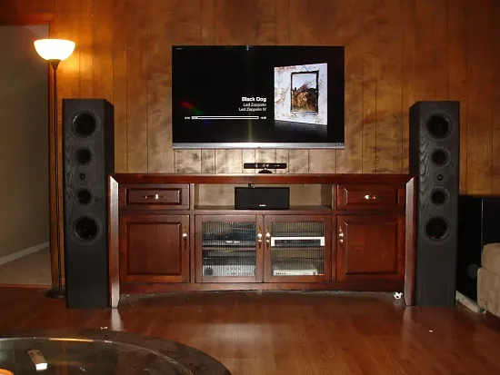

      So I plugged them in tonight...I'm not sure if I've done something wrong, but I'm not getting much output out of the RS225's yet They seem to have gotten a little louder, but I'm not getting anywhere near what I would expect from them. Is this just because they arent broken in yet, or should I check for problems?
      While I try to work things out... here are some pretty pictures (pretend like it hasn't been awhile since I dusted ):

        Love the black on dark brown! That dye turned out really nicely. Probably even better in person I imagine.
        Did you build your entertainment center as well? I'm looking for a good design myself. Yours looks about like what I would want.
          I'd check for problems. With the 225's, you have the adantage of being able to just wire them straight, no crossover, to see if something changes. However, my guess is that you have one of them wired in reverse, so they're out of phase; Should be + to +, - to -, and to crossover the same (except reversed if I recall correctly, so wire + from crossover to -- of woofers). Probably phase issue per cabinet, but possibly side-to-side. Also be sure again the RS150's are in series IN--(+ -)----(+ -)--OUT as they'll be way too loud and weird if not.
          When I re-wired after building a new equipment rack I managed to wire one side reversed. It has probably happened to all of us, more than once.
          At least they look really nice!

                  OK so I double checked the wiring, and everything was correctly hooked up. However after playing music through them for about 4 hours, the difference in the low end is night and day from when I first connected them! At first they sounded way too bright with no volume in the lower end, now they sound amazing! Even being ported, the bass is still accurate and not boomy. I've always been used to speakers that were very forward, and these are amazingly laid back! The one thing that sticks out when I listen to them is the imaging. The extensive depth and even the width of the soundstage sounds amazing in my room! I can hear different instruments in different parts of the room and it doesn't sound like they are coming directly from the speakers. I haven't listened to alot of high end speakers, but I have never heard accuracy like this either! Hearing a cymbal crash, or even just a wood block or a shaker sounding so crisp makes the music so much better! It is definitely true, you will hear instruments and sounds you've never heard before with these, so I'll be listening to alot of music in the coming days.
                  K and cjd, you guys did an amazing job on the design!
                  Everyone, I am extremely grateful for all the help along the way, even if it was just a quick "looking good!" I without question could not have done it without some of the tips and advice provided.
                  And joeybutts just so you feel better, I played some dubstep on them too and it sounds great!!
                  I've got my subwoofer crossed over at 40hz, but I've been loving the sound with it turned off right now (It just seems to shake things )
                  I have not added any stuffing at all yet, I'm not sure I would want to change how they sound just yet, plus adding it to the woofers would mess with the tuning frequency right? And since the mid box is already oversized I really wouldnt want to add any in there either?
                    No, I did not build it, my roommate bought it for $600 or so. I'm not a big fan of it, it kinda dwarfs the TV (its a 55") But then again these speakers kinda make everything else look small too

                      Did you put anything in to kill backwave reflections? It will make a slight difference in quality of sound (for the better). It should effect tuning negligibly and will probably help your low end a touch.
                      Glad to hear you found these worthwhile to build! I thought my D8's were the cat's pajamas, but now. Psh.
                        I do have the 2" of fiberglass insulation on all of the back walls, and 1" on the sides.
