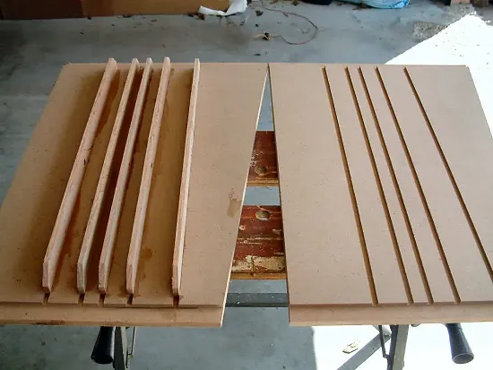

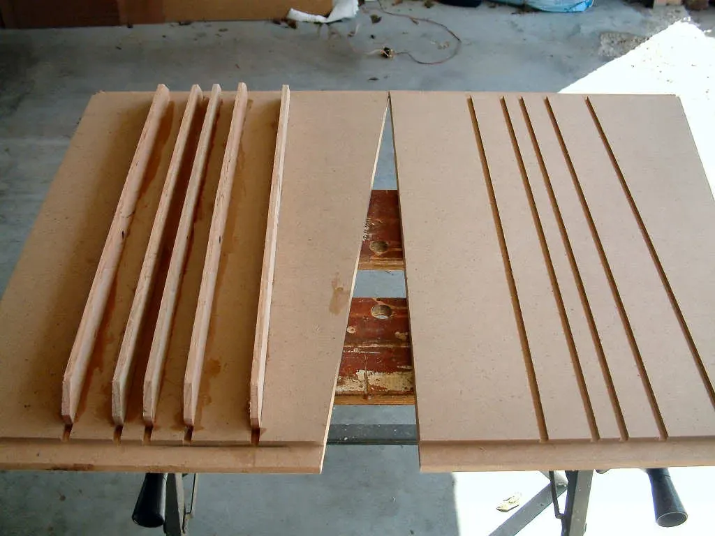

                                How about an inside-out ribbed/finned design? Take 1/4" or 1/2" thick strips of real wood, (red oak?) say about 1.5" long. Run them vertically up the sides, spaced at 2" - 3" on-center. - Like DanN did on his Bassline, but on the outside of the box. Stain these with a nice wood stain, have the base wood black. I think it would look pretty sweet, and you would have one stiff box. and it would be unique as hell. :T
                                Probably have to play with these dimension a little, and maybe play with the box width to maintain the tall, slender appearance, but I think it would still look good.

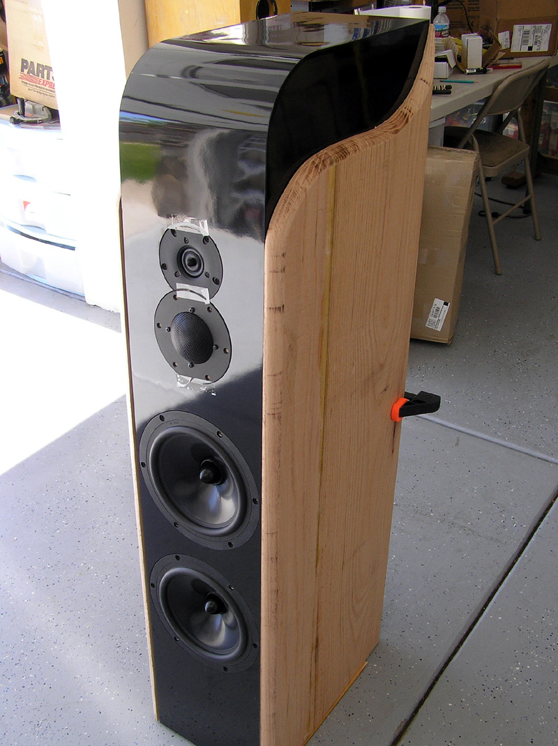

                                    Found a good example of what I am looking to do.....
                                    Something similar to this....

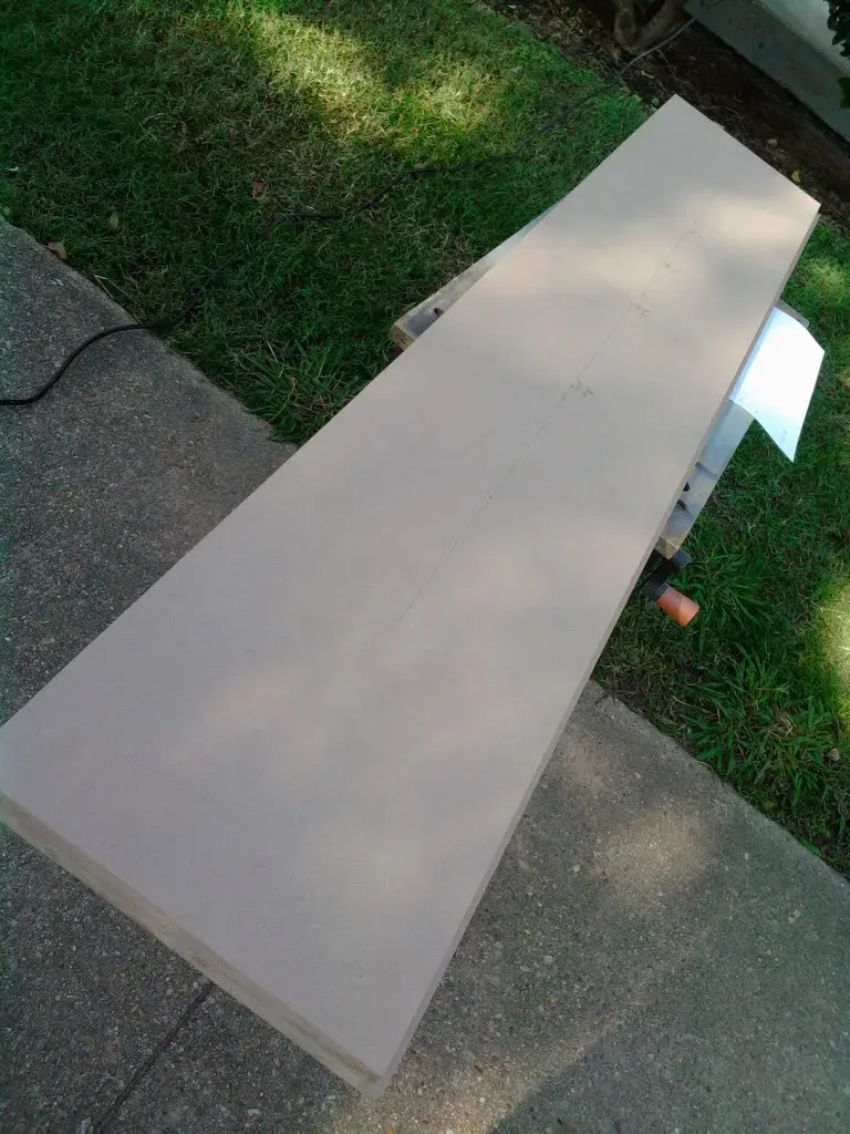

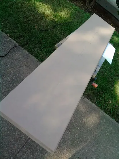

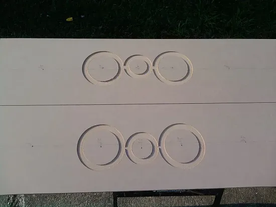

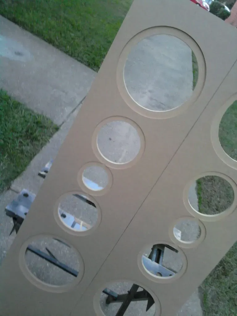

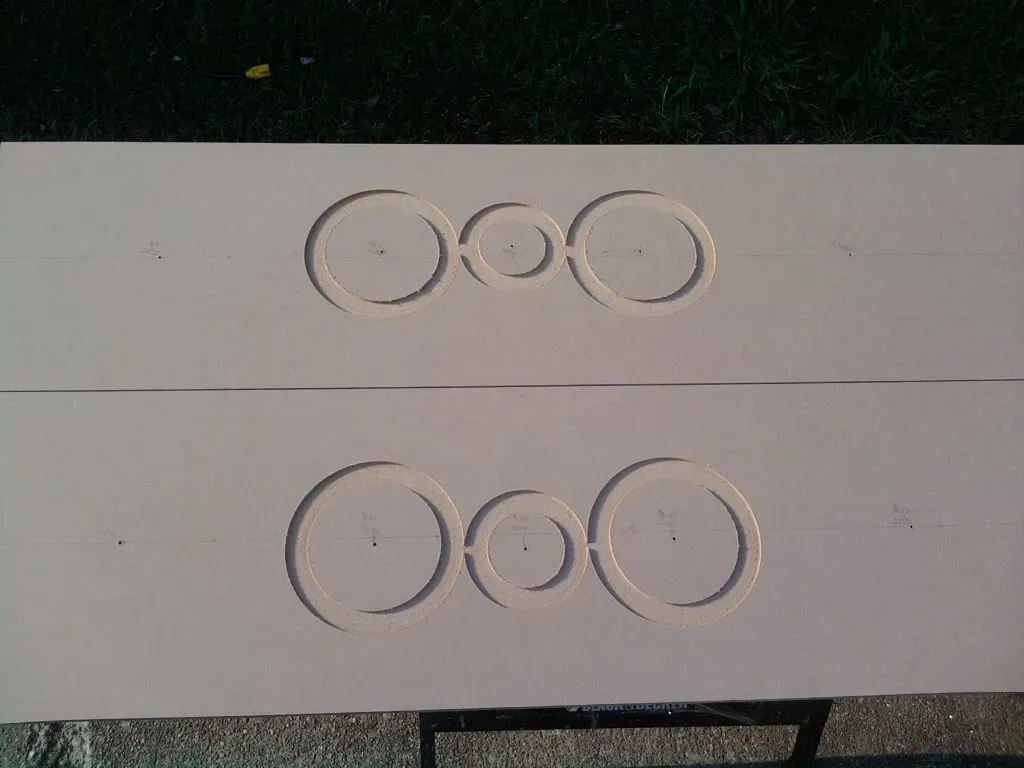

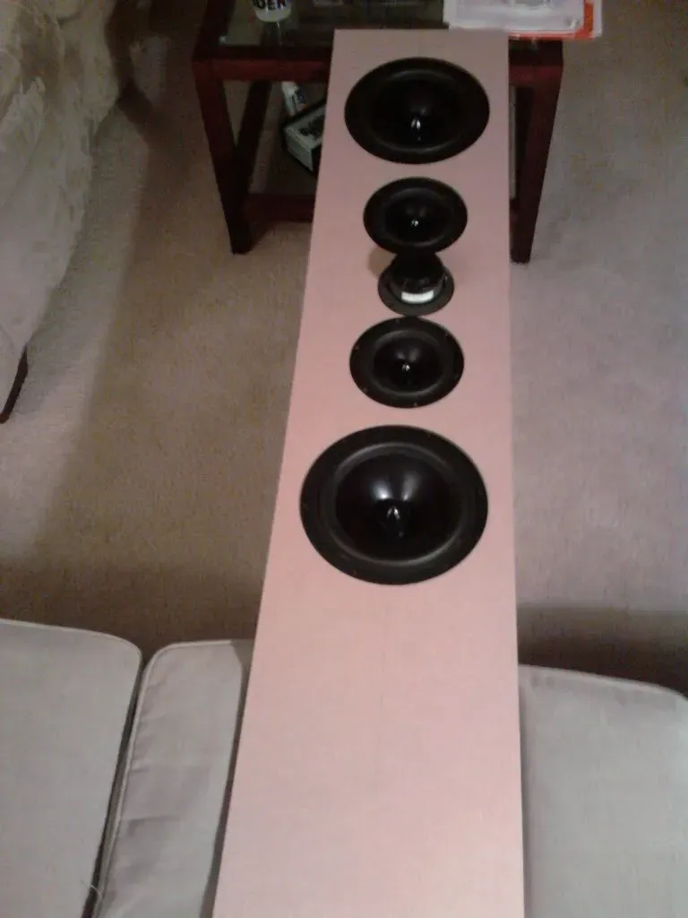

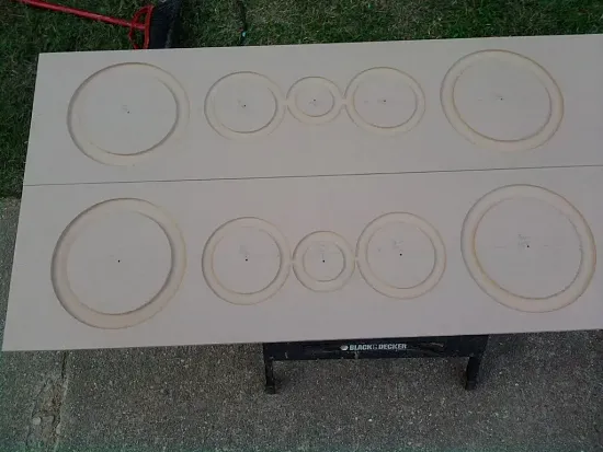

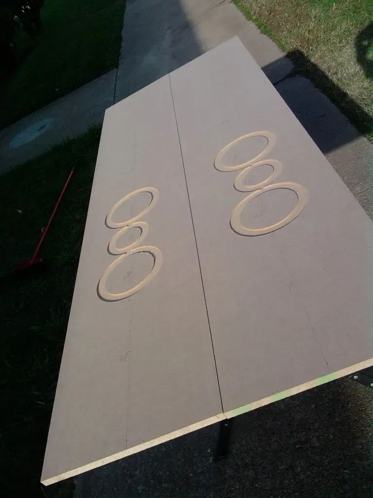

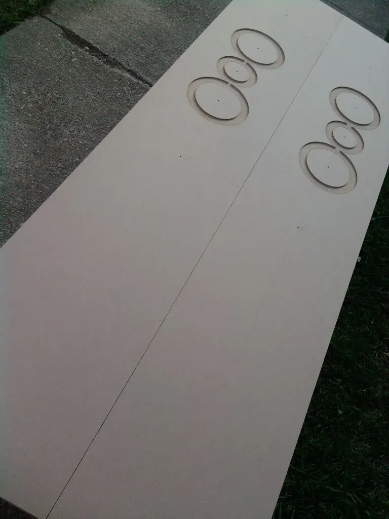

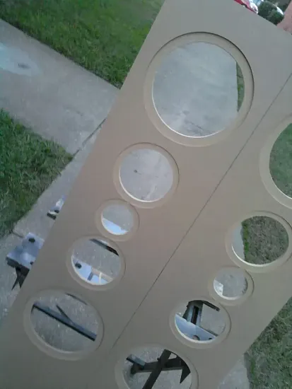

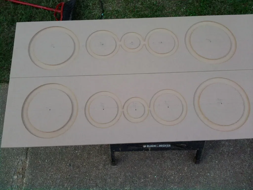

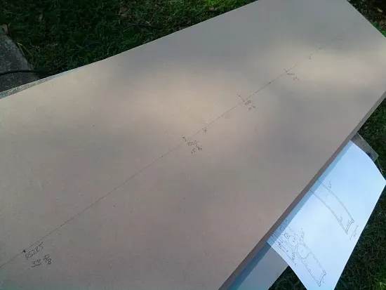

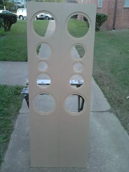

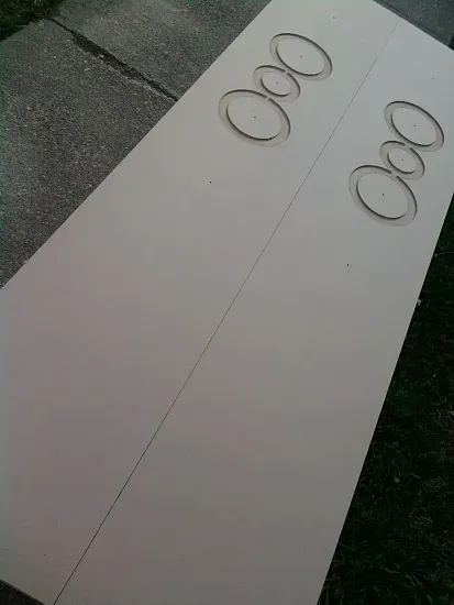

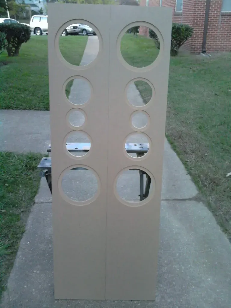

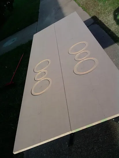

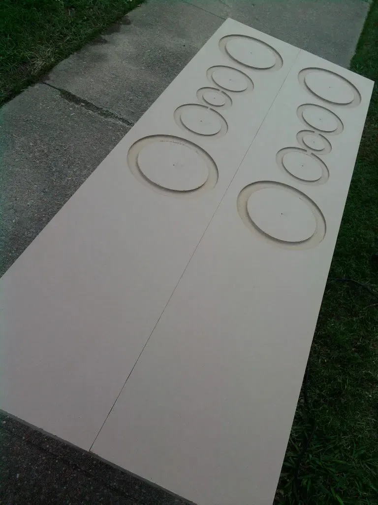

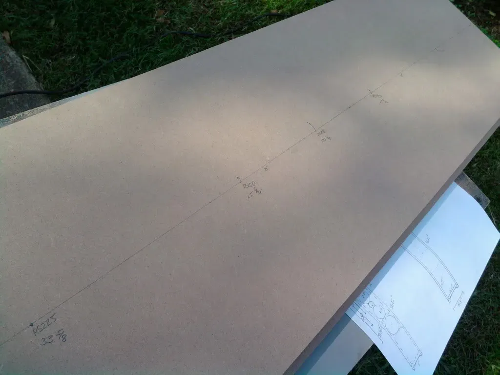

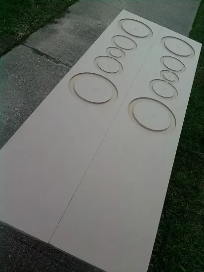

                                                                          Began production today! Baffle work has started, and I opted to do laminated 1/2" MDF for the enclosure instead of working with 1". It's gonna cost a touch more but be a lot easier to work with. Plus I already had a bit of it around.
                                                                          Pics to come.

                                                                            Notice the tweeter is inverted since I haven't done the notch out's for the terminals yet.....but man is it a tight fit amongst the mid section! I think there is about a 1/16" between the RS150's and RS28A. And that 1/2" MDF is screaming for dear life being spanned like that with all the weight of those shielded drivers.....

                                                                            I can't tell you how excited I am to bring this together......
                                                                              The cut layout is perfect. That looks just like mine! :T
                                                                              But, 1/2" MDF? I used double 3/4" and recommend at minimum 3/4". I assume you're going to double up at some point.
                                                                              • mikey15
                                                                                • Jun 2008
                                                                                • 23
                                                                                Hey Joey did you find the the old RS drivers or are those the new ones. Is there a change in the crossovers if those are the new drivers. If there isn't I will also be a go on the Khans
                                                                                • joeybutts
                                                                                  • 476
                                                                                  Ryan, the panels will be doubled 1/2", no worries there. Definitely not going to use 1/2" . And glad to know I am matching up to the master's!
                                                                                  I had bought all my RS drivers from people right before they were discontinued, so I have the planned drivers. Shielded RS225 and RS150 and unshielded RS28.
                                                                                    We're working on figuring out how the new drivers match up. Or I should say, I am.
                                                                                      I should point out, CJD helped me cut those baffles out. I was still scared of the router at that point. ops:
