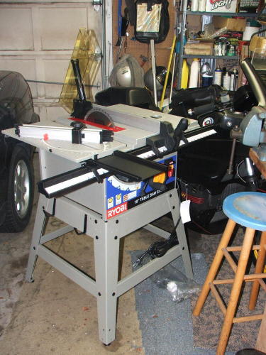

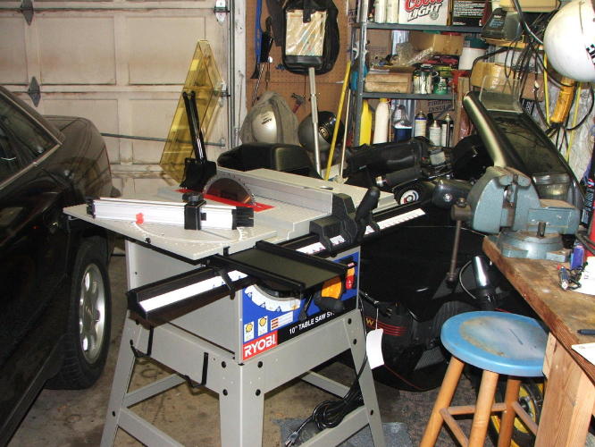

        Step one: Put your new saw together
        Step two: Explain to the wife that you can make stuff for her too.

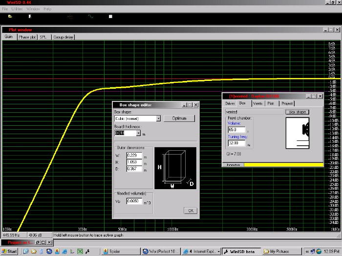

                                                OK, This is where I ask for the ‘big’ favor.
                                                I just finished my calculations using WinISD for the very first time, and as normal male, I spent very little time reading the instruction.
                                                These were the parameters I used:
                                                Number of drivers : 2 RS180 woofers
                                                Box type : Vented
                                                Box size : 65.0 l
                                                Tuning frequency : 32.00 Hz
                                                Vent : 1 vent(s)
                                                0.174 m length for each
                                                0.082 m round
                                                Box dimensions:
                                                65 liter internal volume
                                                Outside dimensions based on 3/4 material
                                                9 (.229) x 41.5 (1.054) x 15.5 (.374)
                                                Tuned for 32 Hz looks good to me, but what would I know? I’ve never done this before!
                                                Edit: Two parameters I could not find for the RS180 woofers were BL (force factor B*L) and SD (effective piston area).
                                                32 Hz may be pushing it a little especially for a 7" driver. 35 Hz is much flatter from 100 Hz down. Maybe that would be more realistic, but I'm not sure at what Fq room effect comes in, either.

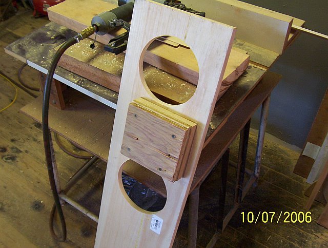

                                                  I noticed that bmowis enclosed his tweeter. This is the first time I have seen this on a Nat P. I thought the RS28 tweeter was already considered enclosed, and did not need isolated in such a fashion. Is this the better way construct the cabinet?
                                                  • derekbannatyne
                                                    • 196
                                                    Box type : Vented
                                                    Box size : 65.0 l
                                                    Vent : 1 vent(s)
                                                    0.082 m round
                                                    Box dimensions:
                                                    You'd be surprised how much bass the RS180s alone put out, I have Modula MTs with a single RS180 (tuned to 34hz) and they put out pretty satisfying bass on their own.
                                                      My current ‘store bought’ are 2 way ported, yet very respectable in low end performance, but they are a little light and muddy down low. The reason I decided to go with the Nat P was for improved mid and low end performance in my first DIY project. I have upgraded my system for improved performance in 2ch music use, so your feedback reinforces my decision is a good place to start based on my expectations.
                                                      This place reminds me of an old time Hollywood movie studio, nothing but ‘Happy Endings’.
                                                      All thanks to our Dynamic Duo, of course!
                                                          We routinely close off the backs of the tweeters. That way it's not necessary to have the tweeter airtight.
                                                          Is there a 'better' way? Probably not, but there maybe ways that are more visually appealing.

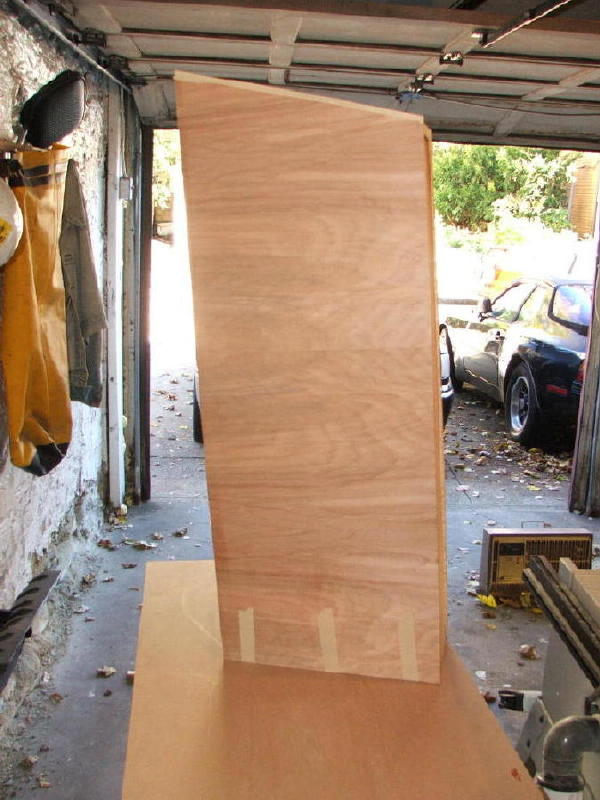

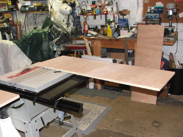

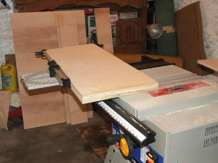

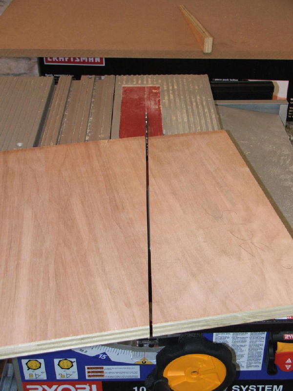

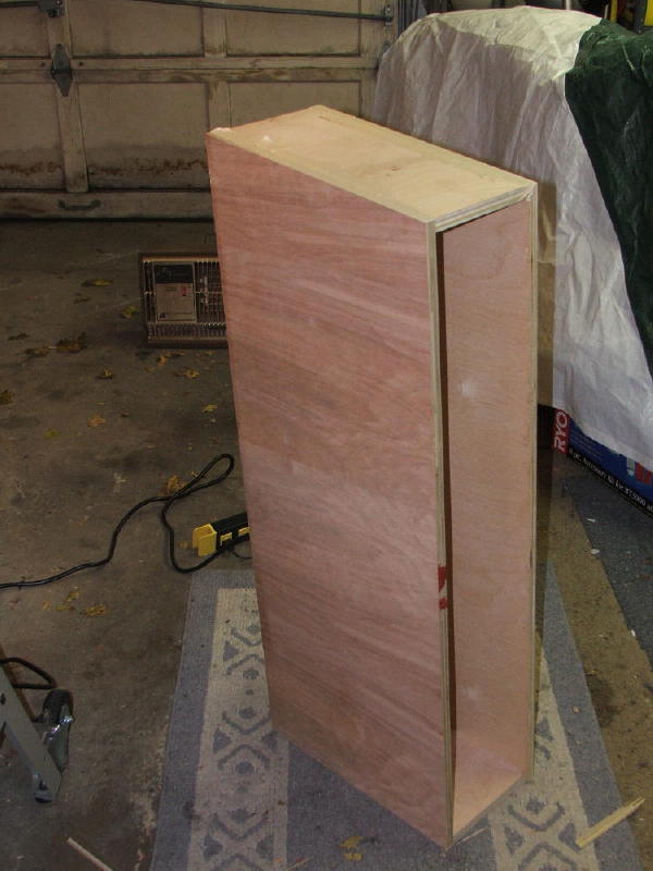

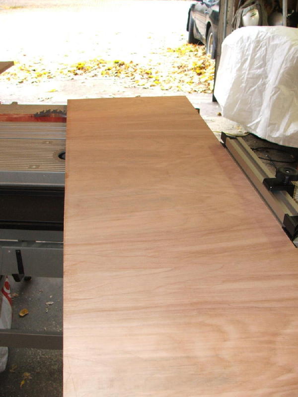

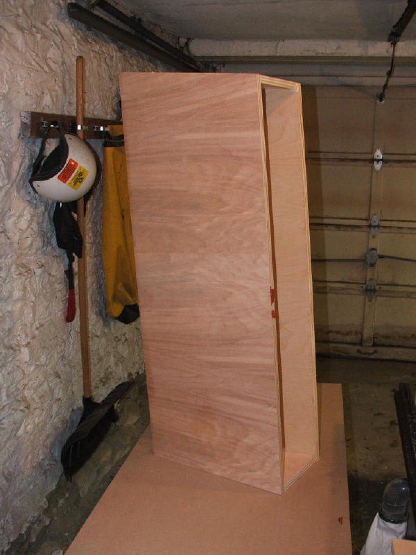

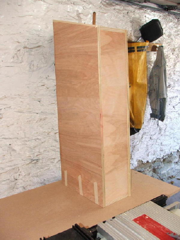

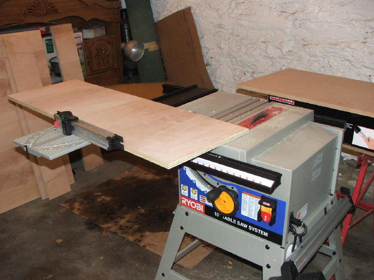

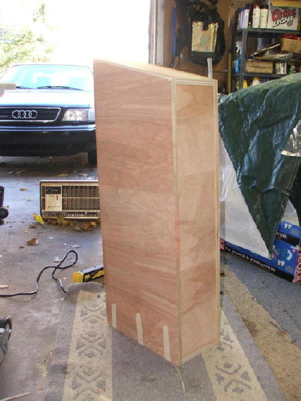

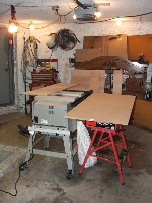

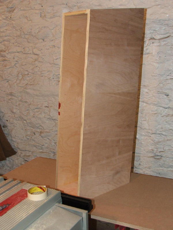

                                                                Started cuts on one cabinet today. I’m using birch ply, and it is cutting like butter. I took the time to put a coat of carnauba wax on the table, too. I have lots of angles in my design, and despite my best efforts aligning the fence, there are some slight mismatches to the panels. Nothing a flush trim won’t fix, though.
                                                                I discovered the best way to cut the side panels was to clamp both together and assure however the cut angles turn out, they will match. The side panels are angled at 5 deg back from bottom to top, and the top is sloped 10 deg down from back to front. I have calculated my tweeter position so that at 11 feet away with a 5 deg rise, it will be on axis to ear level at my listening position. In an attempt to minimize changing the baffle top/driver position from the original design, I added the 10 deg slope to the top of the cabinet profile.
                                                                I have the front baffle and back cut, too. I decided to cut panels for one cabinet only first, in order to test fit and verify my plans. So far, so good. And as you can see, I am trying hard to keep my bike as dust free as possible. I have a BIG fan hung on the back wall of the garage, and open the door when making cuts (it’s cold here today!). Overall, though, dust isn’t as bad as I had feared.

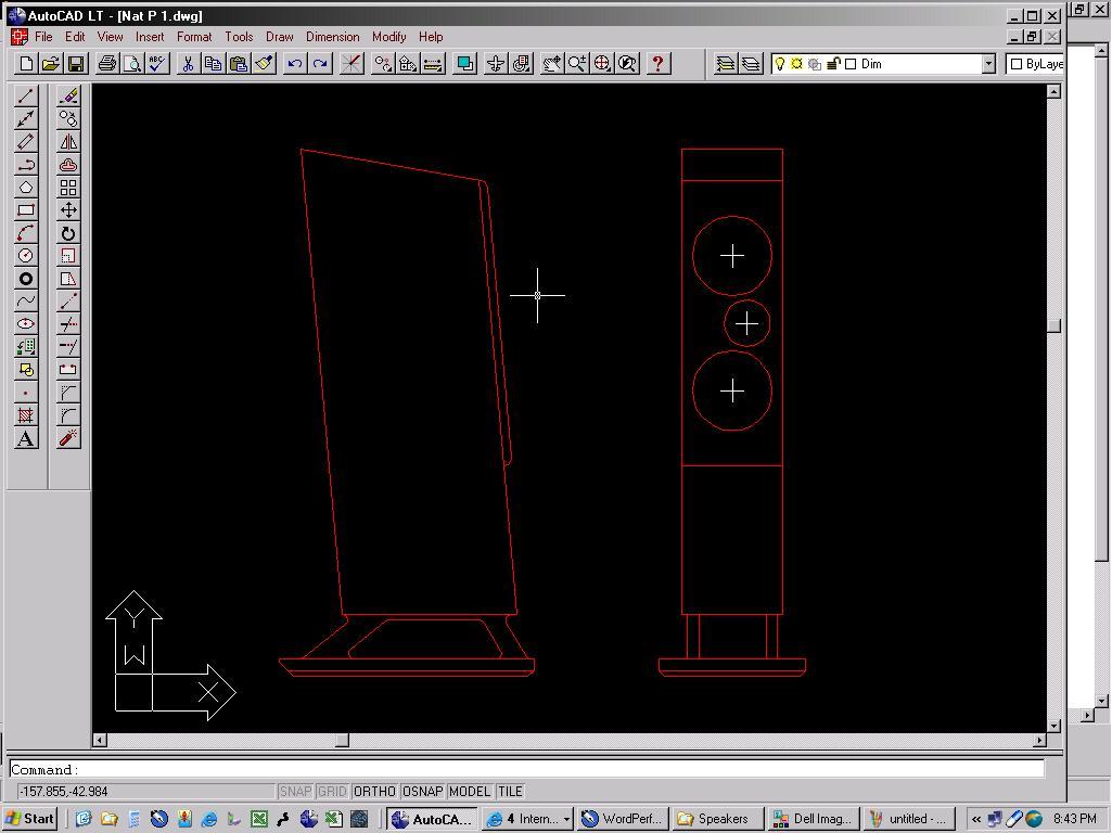

Name:	Nat P DWG.JPG

                                                                      Got some more done today....Made some minor adjustments. Overall, I am satisfied, and have my cut pattern finalized for the second box. I am glad I did a test run first, it gave me practice on my new saw and helped catch some errors in my plans. It has been a very long time since I have done anything like this, but I am having a ball.
                                                                      The wife, however, has taken to calling herself a “woodworker’s widow”!
                                                                      Next are the internal braces. I am considering a 3/16" rabbit on the interior panels for a total of 3 braces per cabinet.
                                                                      I have some MDF......Does anybody think it would work better for bracing? I am thinking it may be stronger and dimensionally more stable over the long term.
                                                                      After that, I will be using a solid piece of hard wood for a 2/3 high exterior baffle.

                                                                      • jdybnis
                                                                        • 399
                                                                        Negative on both of those. Plywood is stronger and more dimensionally stable than MDF. MDF sucks up and releases moisture. Plywood is prevented from changing size by the crisscrossing pattern of the layers.
                                                                        -Josh
                                                                        • dynamowhum
                                                                          • 260
                                                                          MDF can be used. Plywood would probably be optimal. If you were worried about humidity and mdf you could always seal the braces before installing. Cheers
                                                                            My thanks to both of you, gentlemen.
                                                                            I will use the ply for the braces.
                                                                            I found that the old trick of applying some masking tape to the ply along the cut line helps greatly when making cuts on the table saw.
                                                                            Can someone give advice on using a router with birch ply?
                                                                            Will an up-cut bit tend to splinter the birch veneer?
                                                                            Should I use a bit with angled flutes?
                                                                            • Martyn
                                                                              • 380
                                                                              You can do the same for your router - either a zero-clearance fence for your router table if you have one, or a zero-clearance fence that attaches to the baseplate of your router. This is worth considering if either your router needs extra stability or you are experiencing blow-out.
                                                                              It should go without saying that there is no substitute for a sharp cutter. It's worth buying a diamond hone (it looks like a large nail-file) for touching up your router cutters. It won't work miracles, but it can help to keep an edge a little keener.

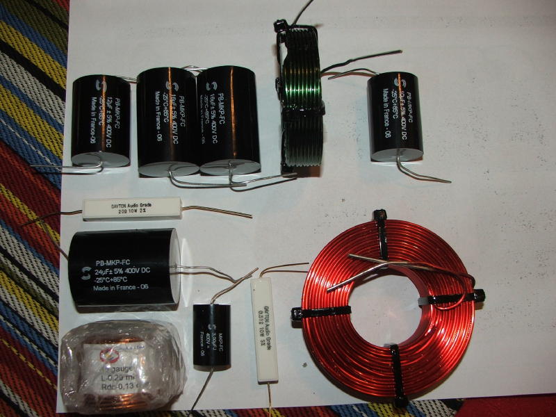

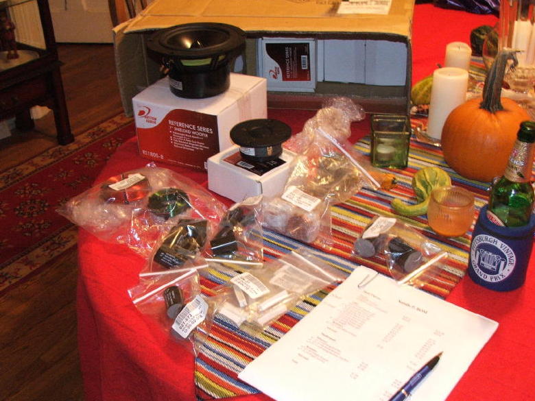

                                                                                I got my components yesterday. I bought them from Mazeroth as he has decided on a different project. Thanks very much Maz! Everything looks perfect, and the tweeters are matched!
                                                                                I still need to order a few things; 3" ports, terminals, etc.
                                                                                Should I get the 4% silver solder (saw it on the PE site) or is standard 40/60 OK?
                                                                                What is the best wire to use for XO construction?
                                                                                I assume a good quality speaker wire equal to what I run from my amp to my speakers is in order to run from the cabinet terminals to the XO, and from the XO to the speaker terminals?

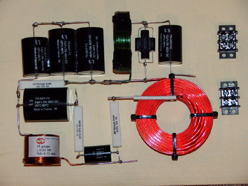

                                                                                  This is my potential layout for my XO; I am missing C11 (1.2 micro farad) and R4 (6 Ohm).
                                                                                  I will get these ordered form PE.
                                                                                  Does anyone see any problems with the orientation of the components?
                                                                                    Overall layout and inductor orientation looks fine... :T

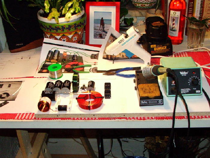

                                                                                      Well, I have had few interruptions in my build like having a kid run a SS and total my car and subsequent latent injuries among others. But I finally have 95% of the parts excluding the stuffing and some hardware. I am heading over Harbor Freight tomorrow to buy some (lots) of clamps.
                                                                                      I have nearly finished the first x-over. I got some scrap wire from work that we use in making the ‘third rail’ conductor for mass-transit/subway cars. It is high purity Cu with Ag coating, and as you can see, is made to handle copious amounts of current. I’m using strands of it for hook-up wire.
                                                                                      I also went with the DeWalt DW621 router, found a factory refurbished unit for a good price. I still need to order my bits, but did get the smaller Jasper Jig from PE on sale. Remember to use the link at HT Forum for your PE orders!
