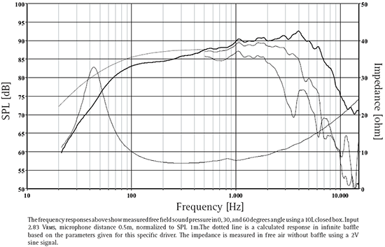

                I do not in fact believe that the Seas you mention would be an "upgrade"-
                The woven polypropylene damps the high frequency resonance, outside the desired passband, making crossover development easier for the unskilled. But I discarded using polypropylene cones in the 90's after detailed investigations highlighted resonances and non-pistonic cone behavior which contribute to audible coloration in the midband- evidence of this is seen in the H1571's impedance plot.
