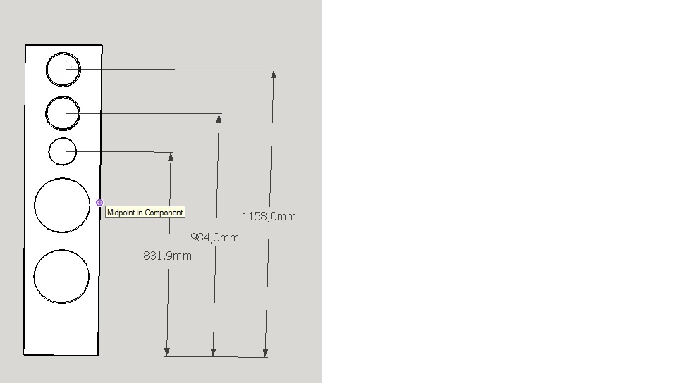

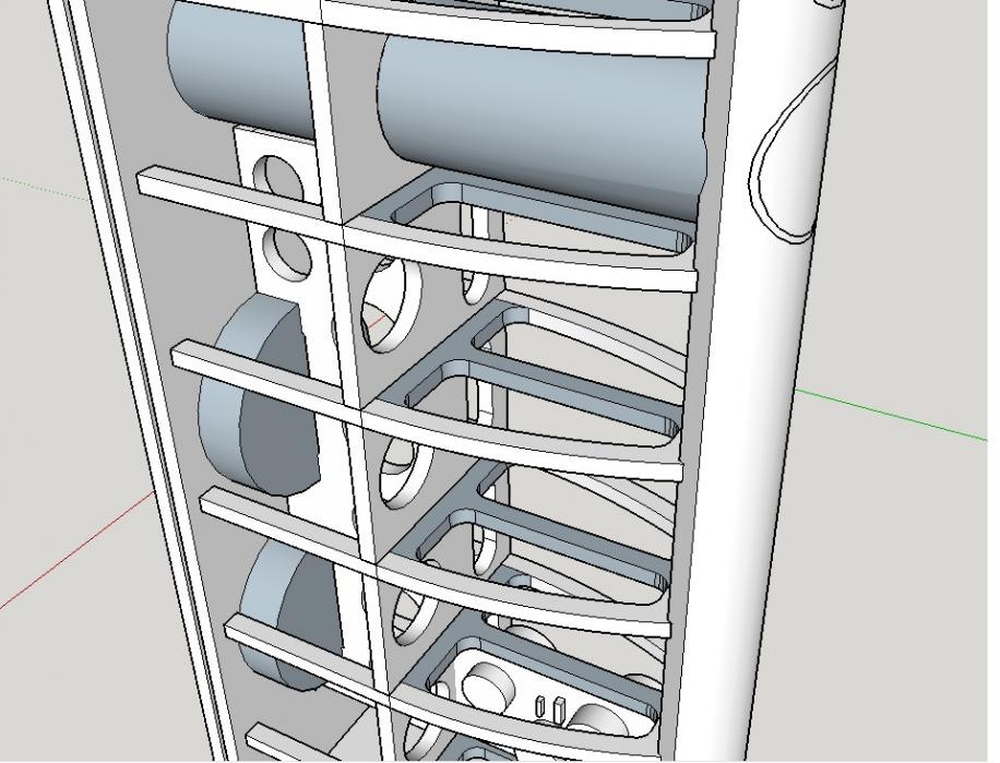

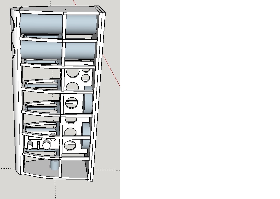

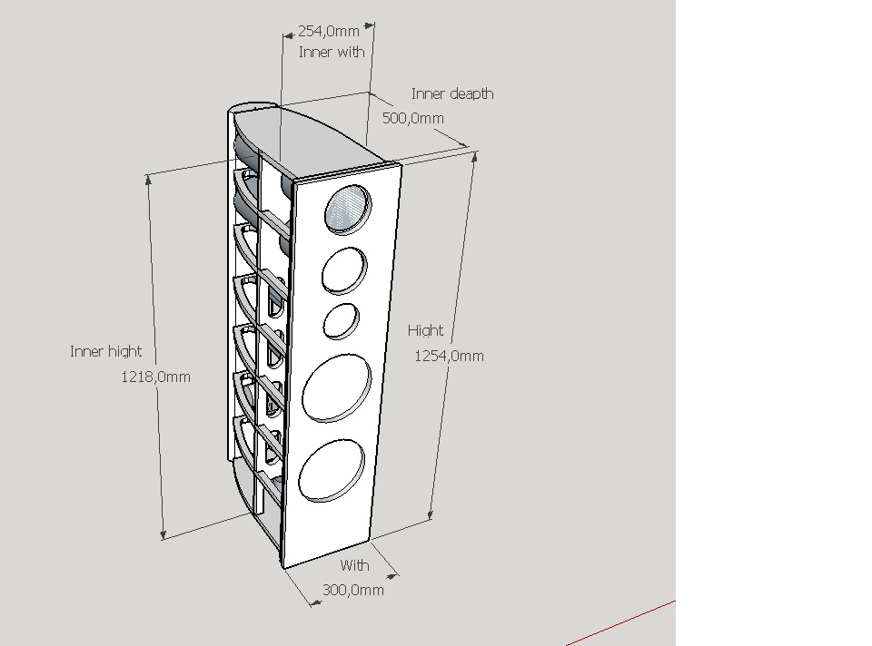

    Ante,
    Excellent drawing, very professional to look at. I'll give you some ideas to help you out when it comes time to build (Whatever you choose to build)
    1: You don't need as many holes as you have shown on the plans. Forget the small holes. Offset / stagger the large holes leave at least 5cm between them for strength.
    2: If you build a curved speaker make the "Ribs" a solid piece so the seam won't show later. (it makes a difference) (everything makes a difference) I used 1/4" Italian bendy ply. Many layers glued in place and router trimmed later.
    3: Don't use solid wood, I did and it twisted as it aged. I had to relief cut the twist. Pain in the A$S. Use Baltic Birch plywood.

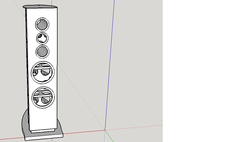

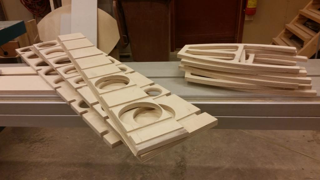

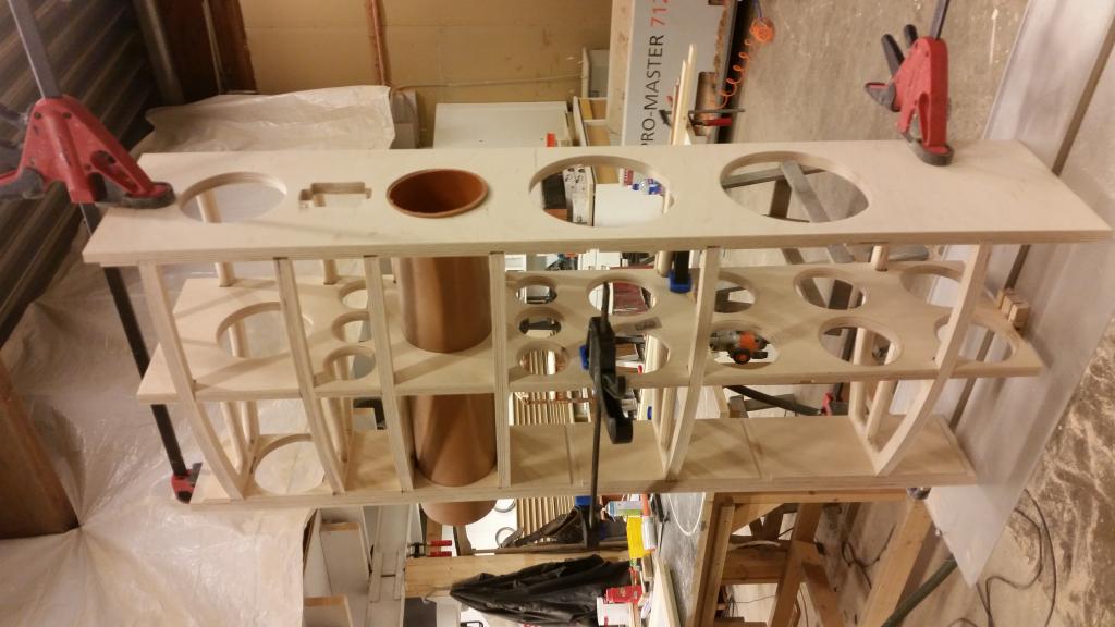

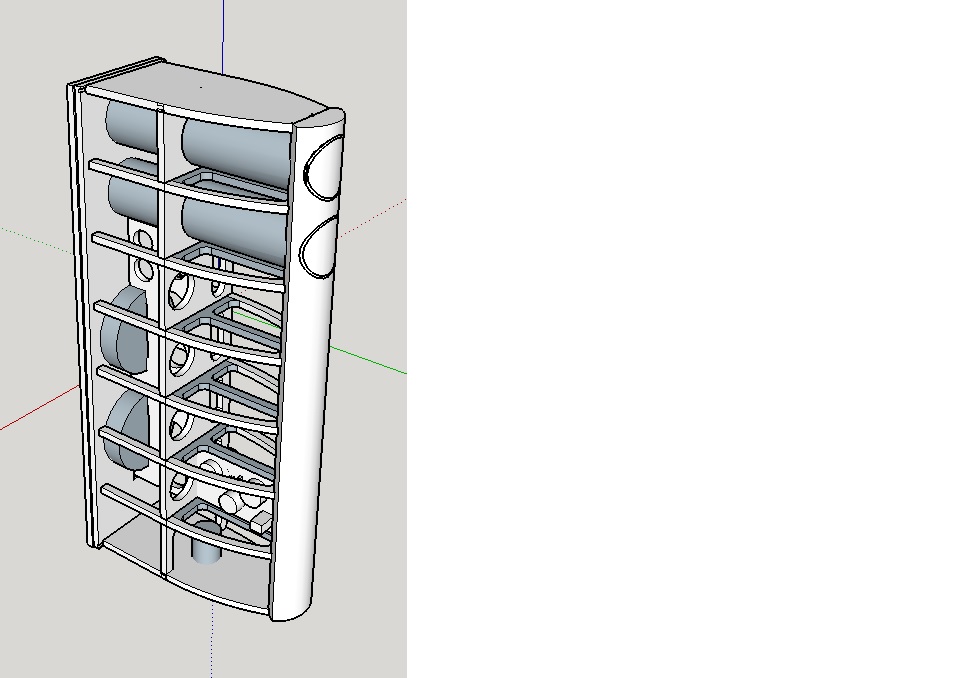

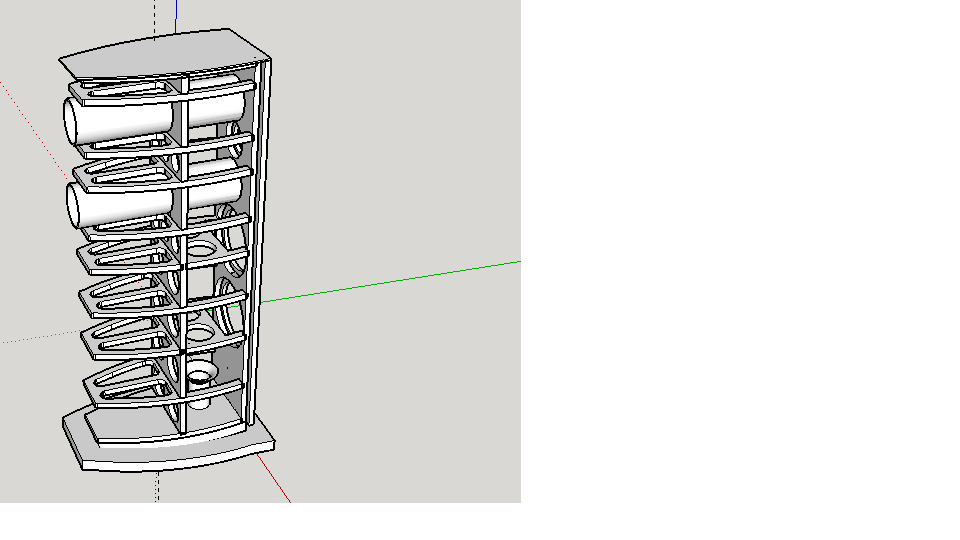

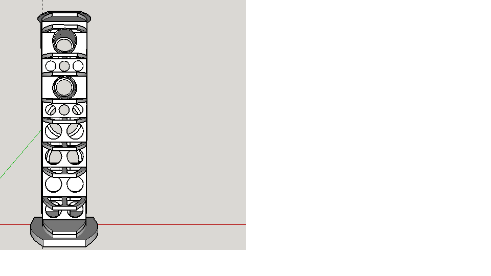

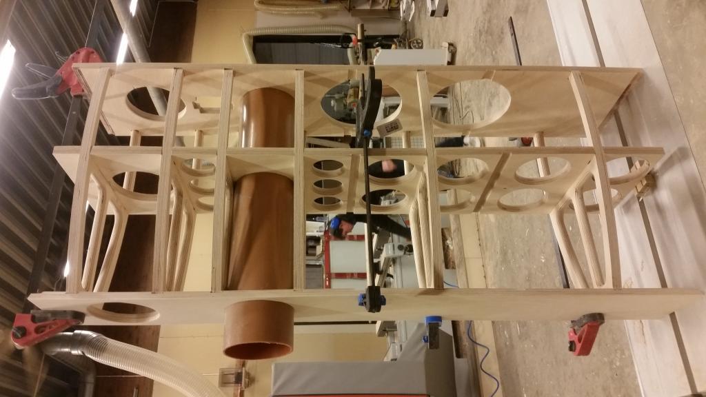

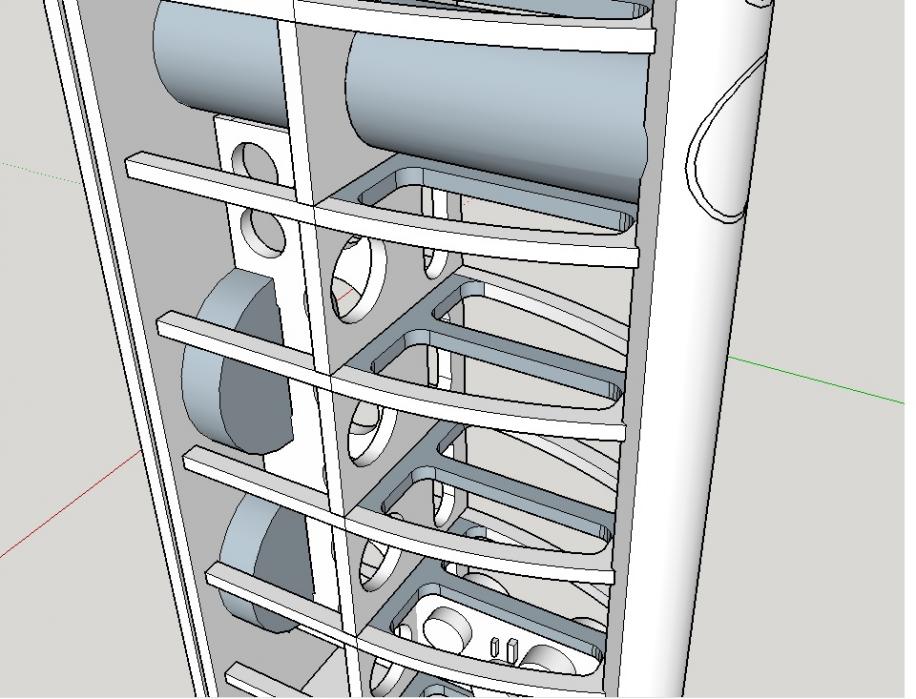

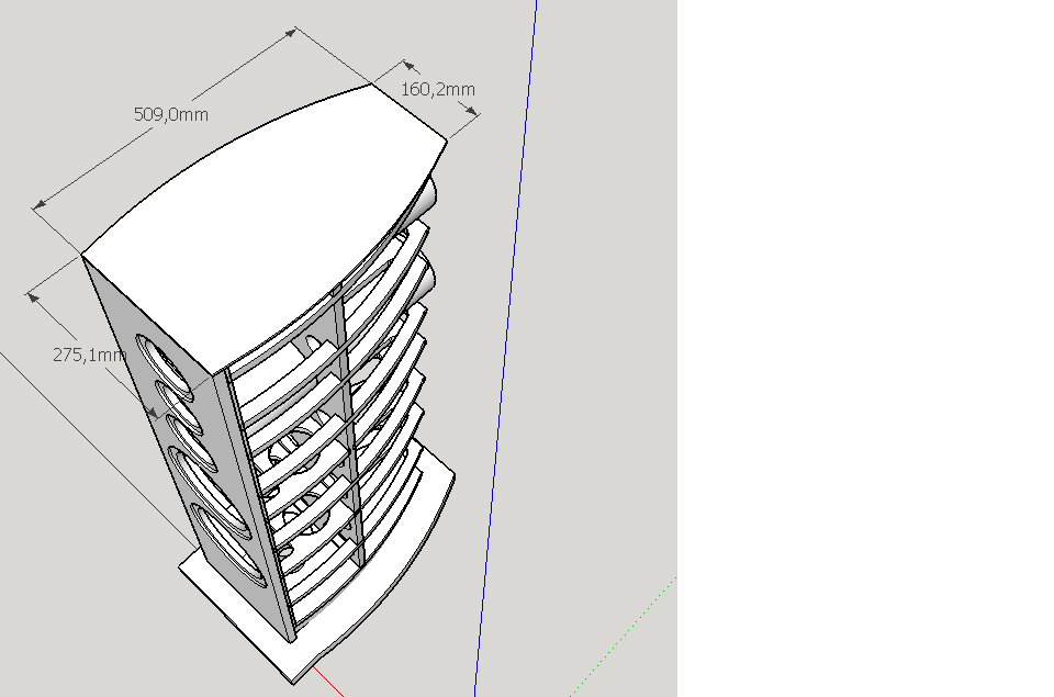

                        Thank you all for great input. Ive been looking at the remix built Ron and I like it a lot. Ive been working on a drawing fore the statement II. You might be able to give me some feedback.

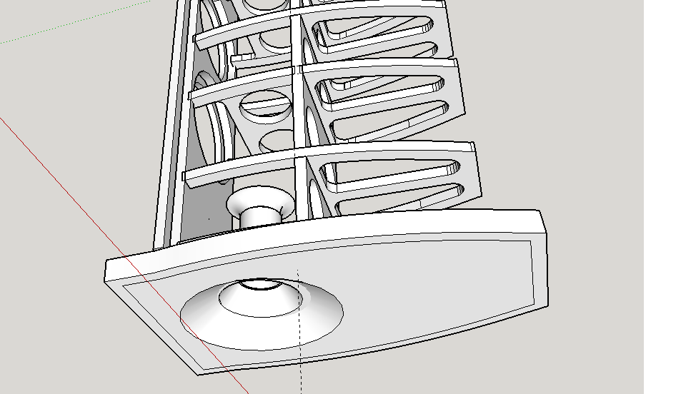

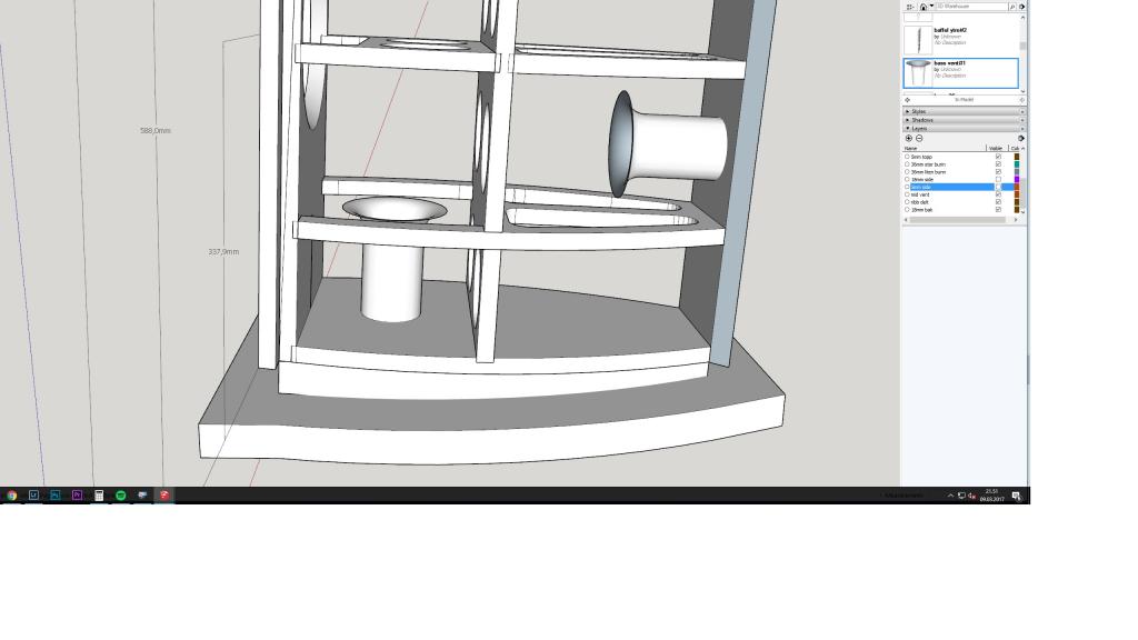

                        I'm planing on giving it a base of about 4" with the vent firing down. If it is possible I really want it in the front. Ive read that it is better if the speaker are up against the wall. I see the mix has it in the back.
                        I went to a hifi shop today and listen to Bowers & Wilkins, the CM9 S2 in the 2500$ price range and the 803 D3 in the 150.000$ range. I really liked the sound in the 803. they both had Kevlar cone. some thing to aim fore
                        I start out at scratch and have nothing. I thought I start by building a great set of speakers and try them out with different amps and see what I like best.
                        I am very thankful fore everyone that help me reach my goals. I promise a lot af pictures during the process
                        With this cast the total internal volume is 141l the tubes fore the mids steal about 14l. I would guess the woofers will have about 100l to play in. Sounds good?
                        If I'm able to get the vent in the front I can keep the height as it is and move the tweeter to the middle of the mids. Ive put it on the lower end now do to my listening position
                        I'm planning the XO in a tray in the back. then I'm able to tweak it if it is necessary.

                          venting out the front will be fine
                          I am more curious about your two
                          upper midrange tube vents
                          • Ante
                            • Dec 2016
                            • 67
                            thinking about the length? I tryed to find some information on this but did not find it. How does the length affect the sound. how would it be afected if it vas cloased?
                            There is no opening in the back on my drawing, but there is ment to be, I could not figure out how to get it done in sketchup with curved surfice. If anyone is interested I can provide the skethup file.
                            • deewan
                              • Feb 2009
                              • 290
                              You cannot close the midrange tunnels without a crossover change. The crossover is designed for the midrange to have a transmission line or open back. Also, you will need to line the midrange tunnels with foam, which means the cylindrical design you have shown would be a little more difficult to line with foam.

                                  Your CAD drawings are very good. But arbitrarily (just cause you want to) moving the tweeter and the two mid-ranges will effect how the speaker performs and the crossover design too.
                                  I know you want to design YOUR own speakers, but it is extremely complicated and takes years of practice and design theory. Just build DeeWans remix speaker.

                                                    Hi everyone
                                                    Now the Statements II are ordered and are heading my way, Ive alsow bought the Hegel H360 to power them. I hope its a god match
                                                    I did however upgraded the XO. Does anyone have any expiriense regarding this uppgrade?
                                                    Ive attached the latest version of the box. I think its an mix of the statement mix, the original and mabe some more.
                                                    I tryed to get inn all the god feedback you given me, and I hope Ive been Abel to get something that might work.
                                                    Total hight is 1187mm and including the base it is 1260mm
                                                    What du you think?

                                                    Originally posted by Renron
                                                    That's a nice looking cabinet.
                                                    What do you mean when you say upgraded the XO? Did you buy different brand capacitors or resistors?

                                                          Ante, I'm excited for you, those are beautiful. Excellent job with those plans. I really like the way they look, you did an excellent job. Congratulations!
                                                          One thing I noticed is the down firing port (which is nice) , you don't need the extra flare on the bottom. A simple 45* bevel or 3/4" roundover will work fine. You'll also need feet or outriggers at least 30mm - 40mm tall depending on the type of floor. Carpet or tile or wood.
                                                          You're going to be SO happy. Please tell us what your XO (crossover) upgrades are.
                                                          If you can work with wood 1/2 as well as your drawings look, they'll be fantastic speakers.

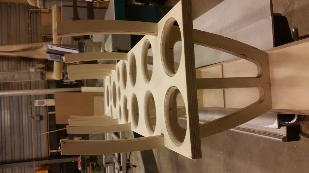

                                                                          Ive got the parts now and Im going to start the build.

                                                                          Do I Put the bass port in the back ore as it is drawn in the botton? The flooring is tials where Im planing on having the speakers.
                                                                            One more question before I start.
                                                                            It depends on what kind of base (feet) you're building on the bottom of the cabinet. The simplest way is to port out the back near the bottom of the speaker. There's no performance difference between rear or down ported. Tile flooring shouldn't make a difference to the ports but an area rug in front of the speakers will probably help eliminate bass bounce and sound reflections.
                                                                            If you do port out the bottom , be sure to create a channel (5"-6") exiting the rear of the base to allow for ample air flow.
                                                                            HTH

                                                                              Pictures please, even just the parts. We like pictures!

                                                                              • Ante
                                                                                • Dec 2016
                                                                                • 67

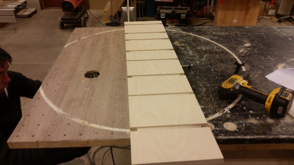

                                                                                now the fun begun. hope you like it
                                                                                Thank you Jim, Im not sure how to do the porting yet, Im planning on having them in the bottom, I not sure how a rear vent would funktion With te bracing Ive got..
                                                                                Im alsow planning on having the XO in the bottom base, this might influence the Space left fore the bottom vent to breath freely?
                                                                                Where would you put the sub vent if you see the Box in the Picture?
                                                                                And where is the best Place to put the stuffing? bottom, top, side??
                                                                                Thank you
                                                                                This was more fun than I expekted
                                                                                Last edited by wkhanna; 09 March 2017, 08:49 Thursday. Reason: added space between pics for clarity
                                                                                  that is what we call, "rocking & rolling", Ante!
                                                                                  Nice!
                                                                                  • scottvalentin
                                                                                    • May 2015
                                                                                    • 175
                                                                                    Wow looking awesome! Very well done. Your craftsmanship is impressive!
                                                                                    • Browncoat
                                                                                      • Oct 2016
                                                                                      • 131
                                                                                      Agreed, your work looks fantastic. And that shop!
                                                                                        • 2142
                                                                                        Looking good .... that's a nice sized shop from what I can see.

                                                                                          thank you everybody I'm so excited this is so much fun !!
                                                                                          I buddy of mine owns a shop that makes interior, kitchen and a whole lot of other stuff so hes got more tools than I need
                                                                                          Does it matter witch place I put the vent of these two shown in the picture?
                                                                                          I have no idea where to put the XO... In the back or in the inside of the speaker. Any ideas?
