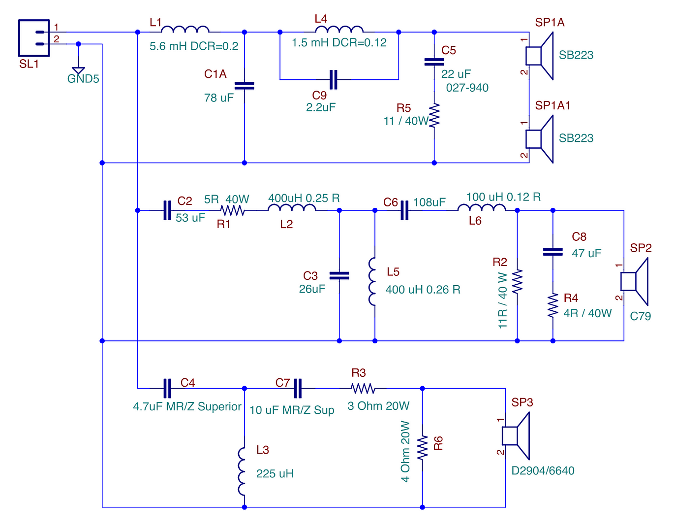

                                      Ref. the crossover section in the large build thread, where dar47 have some great overview photos of the crossovers.
                                      So in terms of laminating different materials I came up with this: (filedata/fetch?id=933726&d=1682894249) Blue is hardboard, green is bamboo, red is birch, and MDF color is 3/4" MDF, pink is 1/2". Some of the 3/4" MDF can be swapped with birch I guess. Any thoughts? Let me know If I should start a new
                                      As I actually dont know how to read drawings I'm probably wrong - but then I would appricate it if someone could explain where I'm misreading the drawing.
                                      I'm working on the tweeter crossover.
                                      When I look at the schematics and then on the picture dar47 have added - I dont get it to match up. Meaning either I'm misreading the schematics (very likely:roll or dar47 have not build the tweeter crossover according to the schematics (not so likely...)
                                      If you follow line 2 (I assume that is +) from the signal source and down to the tweeter, as far as I can tell - you should find the first cap, C4 - that has a value of 4.7uF.
                                      When looking at the picture of the crossover I expected C4 to be the cap to the left in the picture, the cap connected directly to the + terminal.
                                      However, that cap is not a 4.7uF cap, it is a 10uF cap (C7). It's a bit hard to see on the picture here, but if you view the crossover at photo-bucket and zoom in you will see it quite clearly.
                                      So, I'm I reading the schematic wrong? Or have C4 and C7 switched place in the photo from dar47?

                                        #109
                                        Ha ha, your right I caught that after I took the pick and forgot to take another. For some reason I grabbed the big one first and started soldering. The green 4 ohm resister R6 is placed before R3 but it is wired correct.
                                          #110

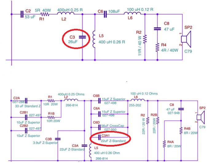

                                                I think that there is a naming convention error in the crossover schematic's as well.
                                                I soldered wrong connections on my mid crossover, and I'm quite sure that was the reason. Other should be aware of that - and if there is some spare time maybe it would be an idea to update the drawing.
                                                C3 is splitted into C3A and C3B.
                                                But C6 is actually splitted into C6A, C6B, C6D and C3A1... That C3A1 trough me off as I was mainly looking at the top level schematics (found that easier to read).
                                                Luckily dar47 spotted my mistake so I can get it fixed before anything is connected.

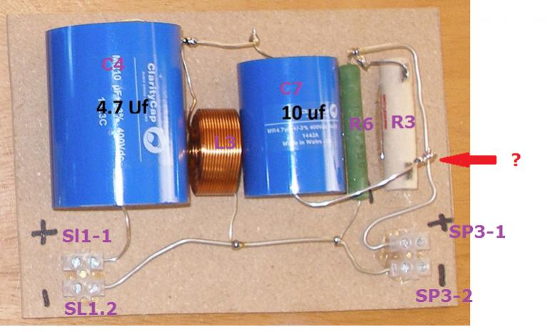

                                                                        Hi folks
                                                                        Sorry to nag on about this, but there is still something that I'm not able to match up between the actual tweeter crossover picture and the schematics for the crossover.
                                                                        I have included the crossover as well as the schematics below.
                                                                        As I read the schematics (and I don't know if I'm reading it correctly) my understanding is that you should have one connection from C7 and into R3. On that side of R3 you should have nothing else.
                                                                        Going out of R3 you should have a connection to R6 and to SP3-1.
                                                                        But from the picture of the crossover there seems as if the input to R3 is connected to SP3-1. Or is it the way the picture is taken that is fooling me? It might be that they just looks connected but actually aren't, but they sure looks connected...

                                                                        So the actual question is if my understanding of how this should be is correct, and if my version of the tweeter crossover looks OK.
                                                                          #126
                                                                          Looks like you have it correct. In the picture there is no connection at your red arrow to the vertical lead. Just an unfortunate optical illusion.
                                                                            #127
                                                                            Just the picture, the C7 to R3 joint is well above the positive buss wire and is not connected.
                                                                              #128
                                                                              Thanks a lot, good to have that confirmed - you are the greatest :T
                                                                                #129
