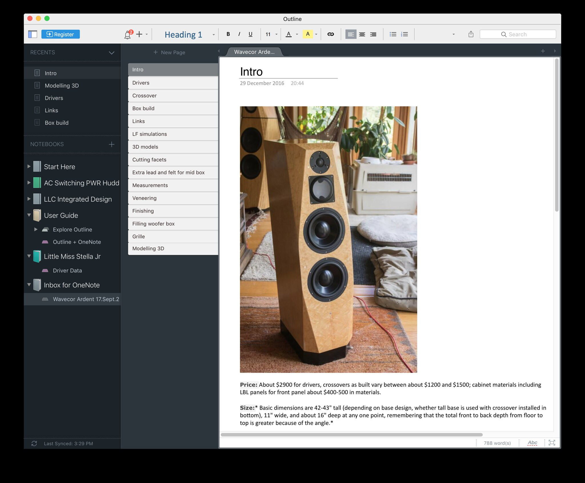

                                                      #566
                                                      If anyone download all the images and maybe collects it in a pdf, maybe it would be a nice return to the community to make it available as a package to the rest of the forum?
                                                      BTW: what is the current status? Is there a complete parts list and crossover schema for a version using the newer wavecore drivers?
                                                      This thread is getting very long so I just wonder if it is easy for new potential builders to find
                                                      the info they need. Maybe a good idea to add a note and a short link to key info about the Wavecore2 edition in the
                                                      initial post?

                                                        #567
                                                        Tek,
                                                        There is a modified crossover design for the newer wavecor drives (02's), which is what I will be using for my build. I've got a full set of drivers and half of the crossover parts sitting at home, but I've been lacking the time to get started. I'm considering having Steve help me get started.
                                                          • 698

                                                          Try this
                                                          Ergo's Wavecor Ardent Onenote
                                                          I have not started my build yet as summertime went to all sort of jobs related to the house renovation and improving the workshop, but I did some pre-work in winter/spring time to gather what I tough was most useful info about this build from the thread. Hope it open in browser version of OneNote.
                                                          Ergo
                                                          PS. I could create a write access link if someone is willing to contribute in improving this document further.

                                                            Originally posted by ergo
                                                            Try this
                                                            Ergo
                                                            Very nice document Ergo!

                                                                  Jon, maybe you could add a link to Ergos notes in the start of the thread? It will be hard to find down here with all the other stuff going on.

                                                                        I've added the box plans download links into the OneNote 'Box build' section. Both the PDF and PNG variation.
                                                                        Steve - you can download the OneNote *.onepkg file from here
                                                                        This is a current state 'drop' ... the OneNote Online version will update on fly as I do changes, but for off-line version like this I would of course need to export every now and then to keep it current.
                                                                        I've started to draw the plans also into Fusion360 with parametric modelling, so that all material thickness's could be adjusted and model updates accordingly. I have front panel ready, but rest of it is on todo list still. Once I have that I will share that too.

                                                                            Hmm, I've uploaded the same as a *.one file to same link. That one shows OneNote 2010-2016 when saving. The *.onepkg does not offer any version options.... I have the OneNote 2016.

                                                                              I way behind you, I have 2007. Now the document opens up in my browser fine, I just can't save it. I'll keep looking and see what I can come up with. Thanks Ergo.
                                                                                • 698
                                                                                #579
                                                                                https://www.onenote.com/download --> Windows Desktop
                                                                                You might wanna try if the version offered there works for you. OneNote is not part of paid Office packages so should be free to use.

                                                                                  Outline, my favorite Mac One-Note clone (reads One Note files just fine) opens your files perfectly. I downloaded the 1st one.

                                                                                  Steve and I both have Fusion 360, and I've been able to do some stuff with it OK, but I have to admit I think my reptile hind brain is wired for Shark FX still.... I can use that in my sleep or drunk or whatever, I haven't gotten comfortable enough with 360 yet, and haven't had time really in the last year.
