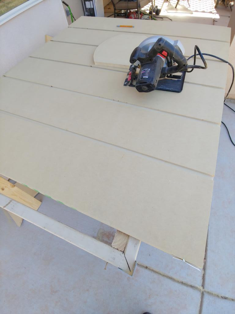

    I recently completed my Statement 2's and posted the results on here. I wanted to try to create a build thread with the few photos I took while building them for anyone that might be interested. A lot of the ideas for the build came from previous build threads on here. I don't know if I have anything new to add, but I will try.
    Click image for larger version  Name:	0218211236.jpg Views:	0 Size:	92.2 KB ID:	932911

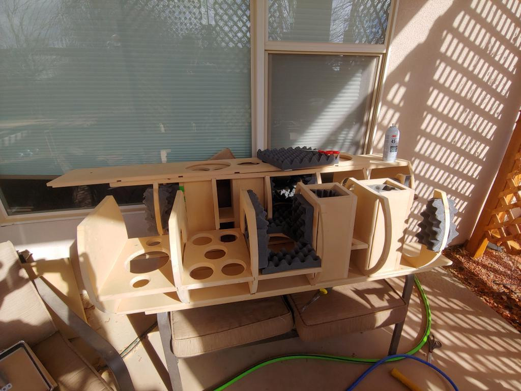

    Not much to show, but this was the start. I used a router to dado the wood for the front and backs. The template for the base and 5 braces for each speaker is behind the saw. A little planning had to go into the initial template because it would dictate a lot of the finished dimensions.
    Click image for larger version  Name:	0305211605a_HDR.jpg Views:	0 Size:	205.4 KB ID:	932912
    Click image for larger version  Name:	0305211605_HDR.jpg Views:	0 Size:	205.7 KB ID:	932913

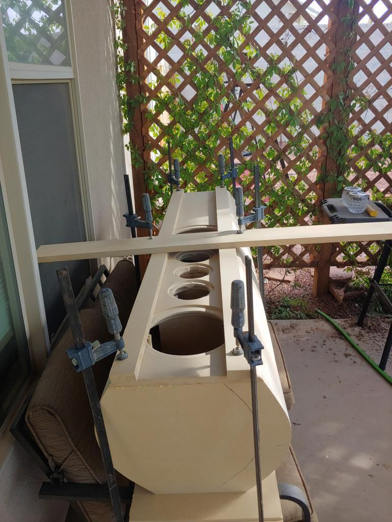

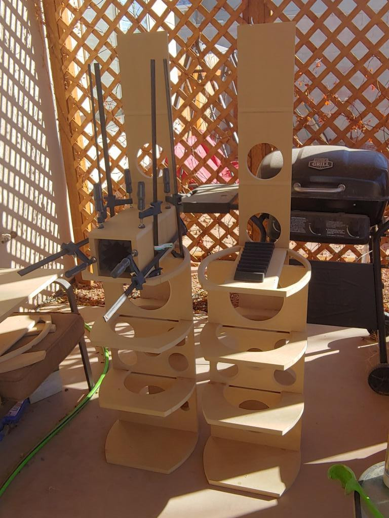

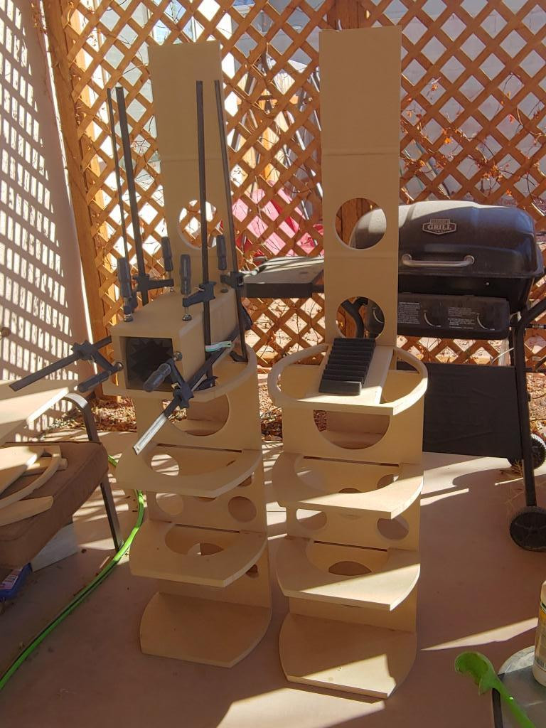

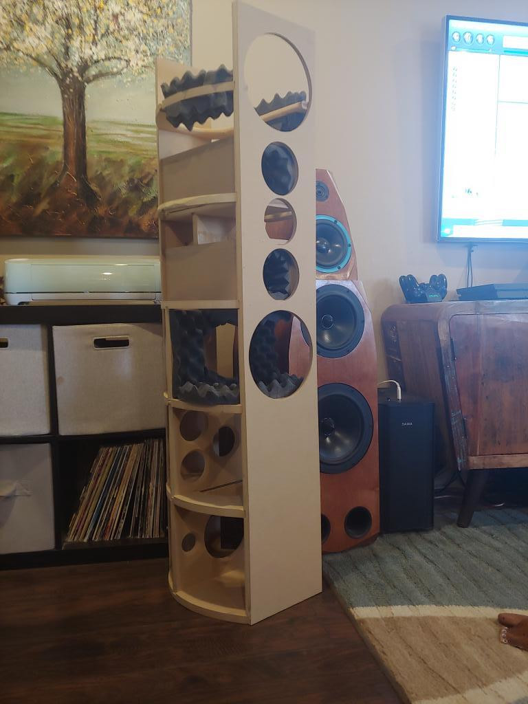

    I rough cut and routered the rest of the bracing and started the build for the internal framework from the ground up. I don't know if the photo conveys this, but this was a lot of cutting and routering and a whole lot of dust. A good dust mask is a must.
    Bracing is done and ready for the inner front baffle. I am new to this site. I don't seem to be able to upload the photos in their correct orientation. If anyone has advice on how to upload photos so their not upside down, I would appreciate it.
    Click image for larger version  Name:	0312211545_HDR.jpg Views:	0 Size:	182.5 KB ID:	932914
    Inner baffle attached.

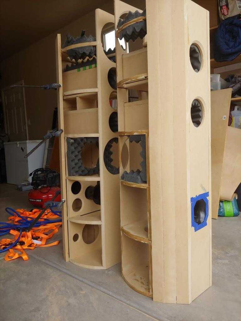

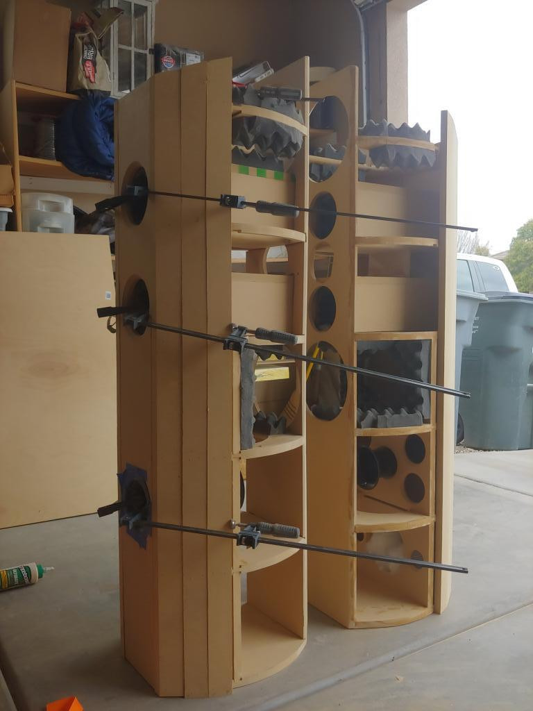

    Statement 2 build sides
    I decided that I wanted a slated top, so i cut down the back 3" before starting the sides. originally I planned on using layers of 1/8" hardboard for the sides in layers, clamped and glued to form the curve. I've seen it done this way in other threads. For me, it wasn't working very well. Between gluing, getting ratchet straps set up, and the amount of pressure it needed, working with this large of an area it just wasn't working for me.
    I decided to do the sides in 2" slats of 3/4" mdf that were mitered to follow the curve. This way added some extra cutting and sanding but I felt it was worth a try.
    One thing I would like to mention. If you are making the tunnels for the midranges like I did, they need about an 1" wide 1/2" deep slot cut out of the middle a few inches back for the top and bottom heat sinks of the tweeter to fit. It would have been easier before installing the baffle.

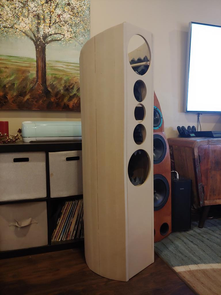

      Statement 2 build top and front baffle

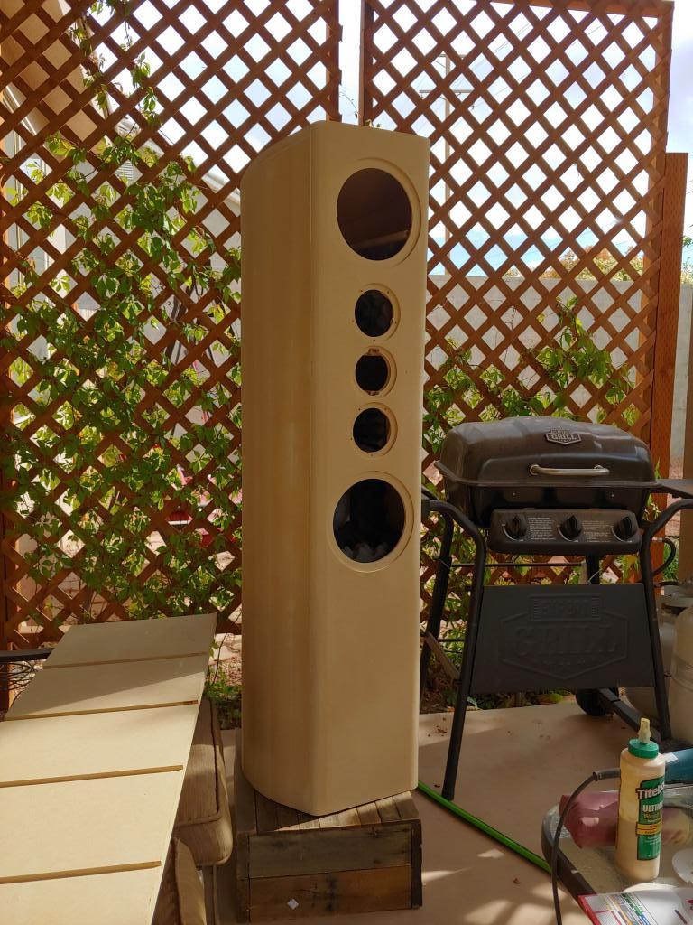

      When trying to cut the compound miters were the curved sides would meet the top, I was having a hard time figuring out the cut. The reason is the angle was almost constantly changing. In the end I had to try to hold a belt sander at close to the right angle and sand them down.

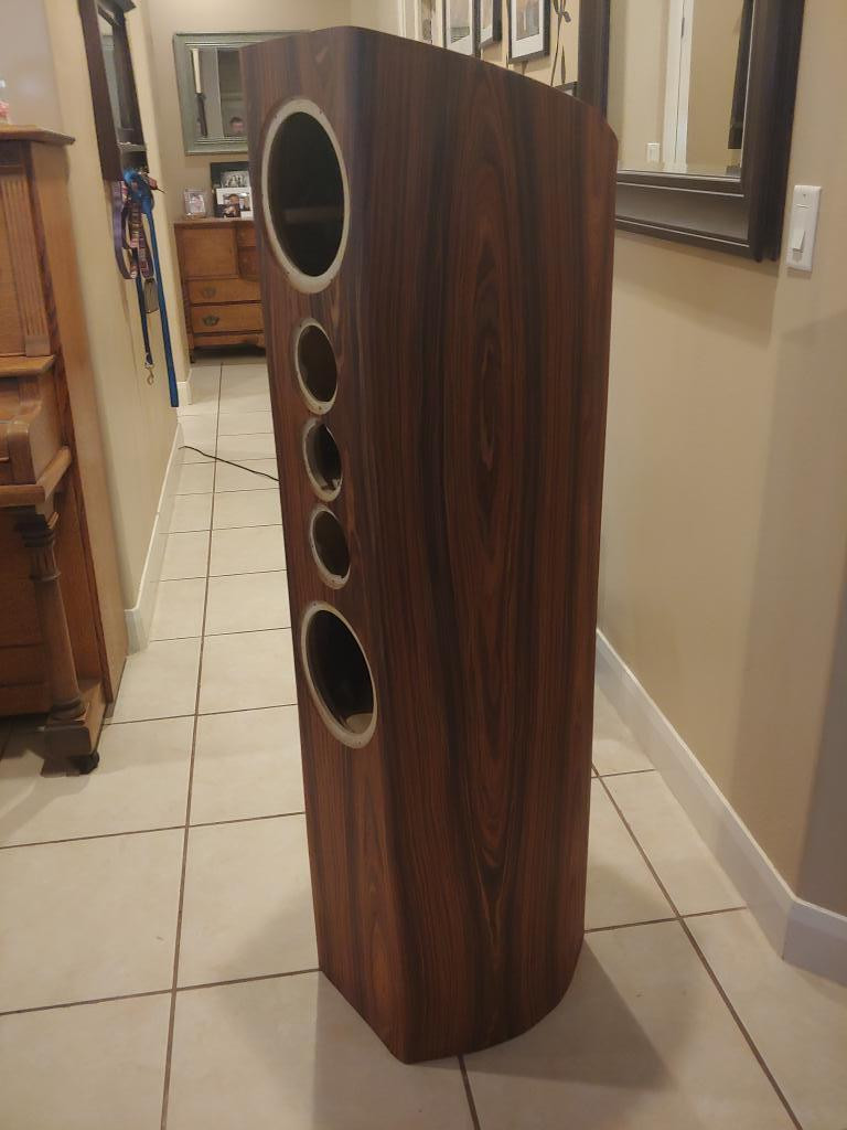

      I wanted the front baffle to curve nicely into the sides. I didn't have an appropriate router bit for the job, so I mitered 3 cuts on each side with the table saw and smoothed it out with a palm sander.

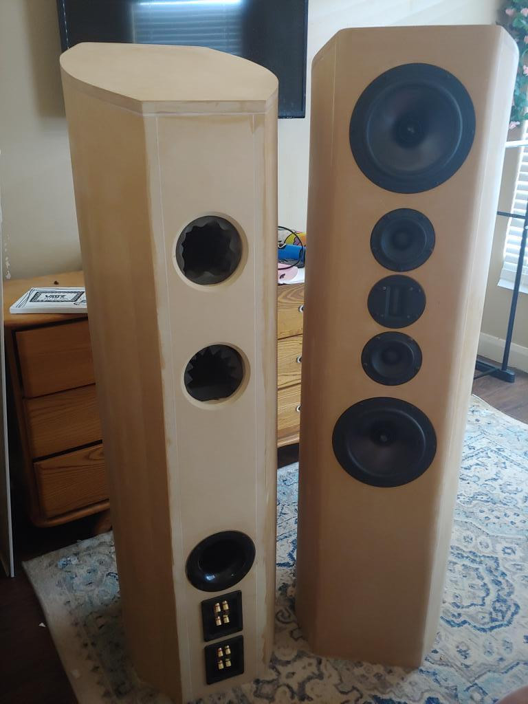

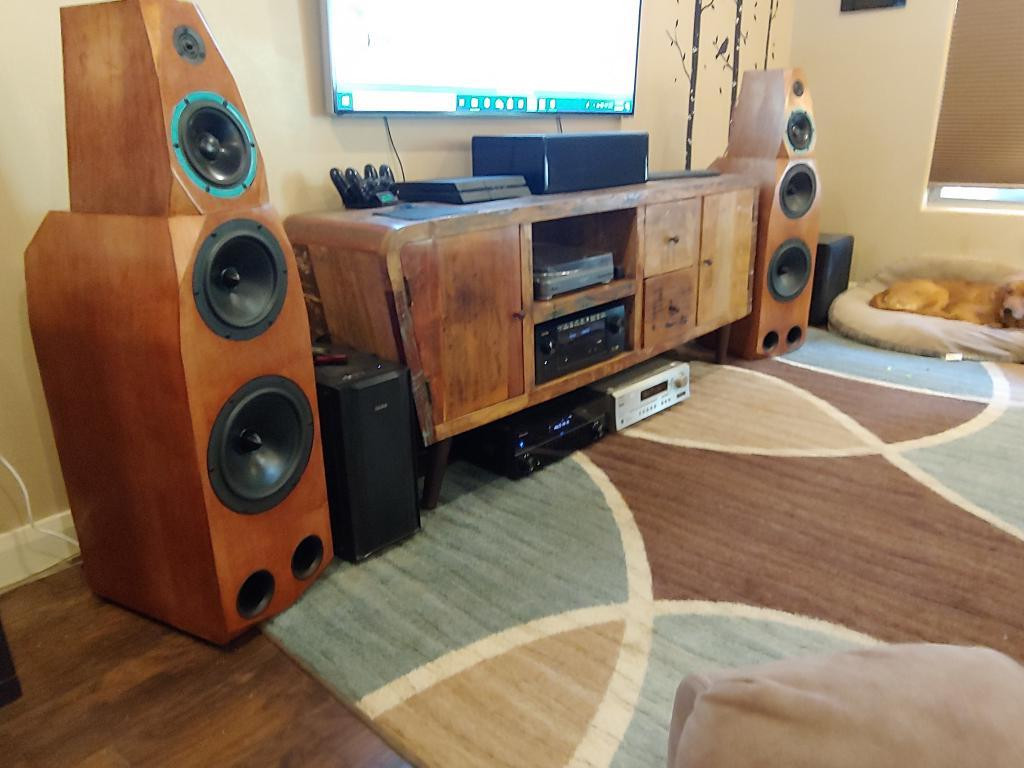

      With the baffles on I added the drivers and hardware for fit(excuse the messy room). My 1st build was an active 4-way build. For me, the quickest way to get these up and running was to make them active also, hence the extra binding post. Their are 4 sets in the picture, only 3 are wired for use.
      I currently am running them active with the DSP's used for just the basic crossover. To me they sound fantastic. I do have the crossover components coming from Meniscus. Although they sound great, I want to hear the sound that Jim and Curt created for them.

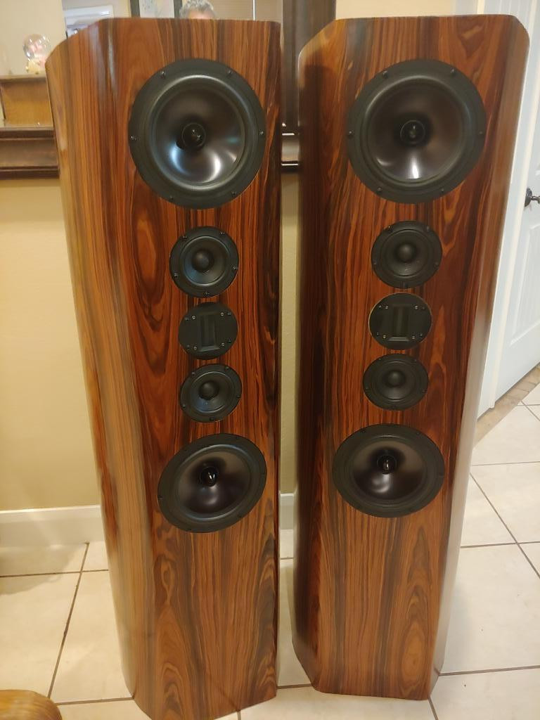

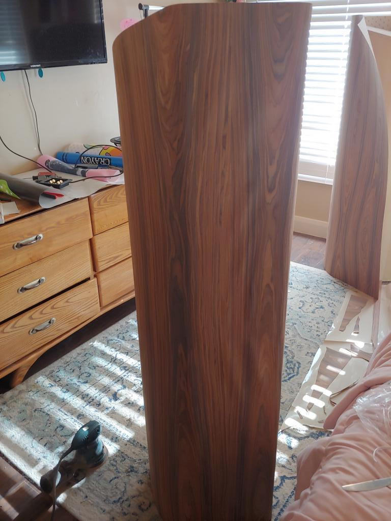

        Veneering

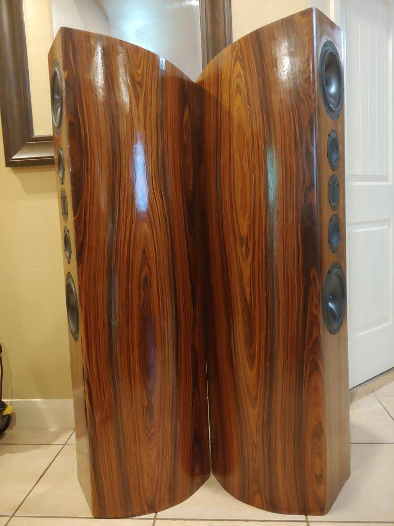

        The last step after adding some stuffing, was the veneering. The veneering went pretty easy. I used a rosewood veneer with a PSA backer. I veneered the tops first and trimmed down. The sides and front were done with one continuous wrap. I removed about a third of the paper backing from the preinstalled adhesive. Pressed it down with a roller and removed another third until it was wrapped. It did use almost all of the 4' width.
        I had bought a really shallow guided trim bit from Amazon for my 1st build. It made easy work to trim out the drivers.

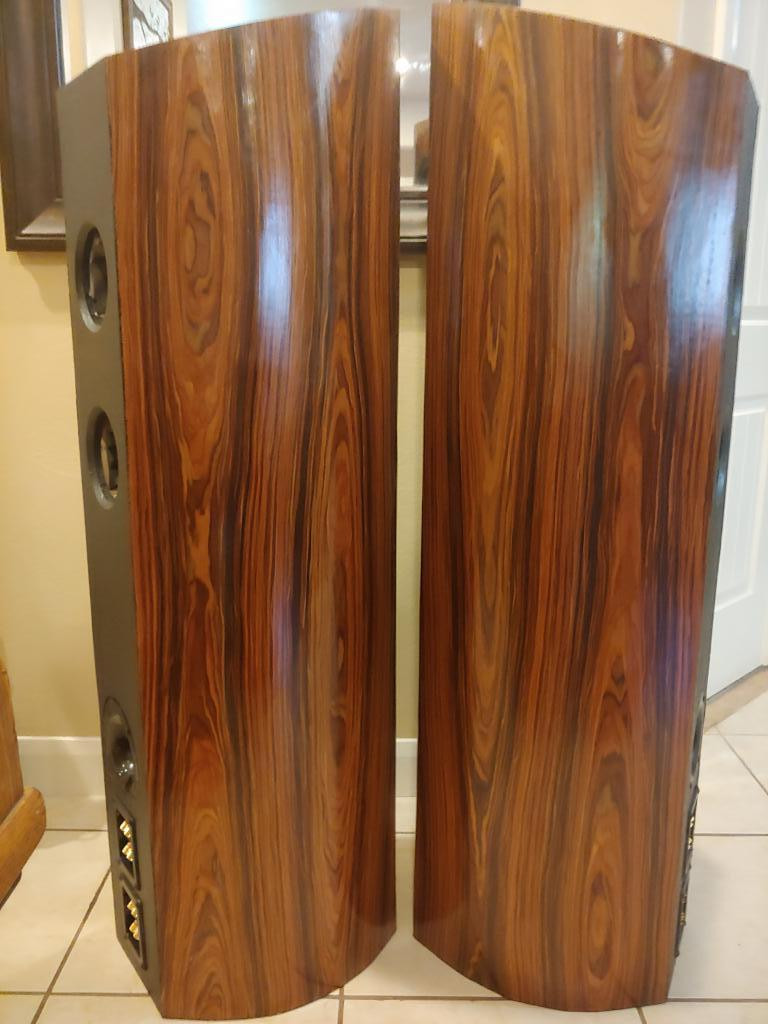

        I used 5 coats of wipe on lacquer sanding in between with steel wool. The back and bottom I painted with Exohyde.
        Well that's about all I have for now until I build the passive crossovers. I again want to say thanks to Curt Campbell and Jim Holtz and all the other designer who share their designs, time and experience so freely.
        P.S. They sound amazing.

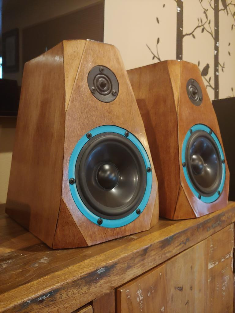

              1st build
              If anyone is curious about the speakers in the background, they are my 1st build. They are a fully active 4-way build.
              2-way bookshelves

                Those look neat. What drivers did you use in them? A custom design for your first speaker. That must have bene a big learning curve!
                • mjack
                  • May 2021
                  • 20
                  I don't remember the exact model #'s for the driver. The tweeter is a Peerless ring radiator, the mid a Scanspeak driver that was made for Theil. A great deal at $25 per. The bass driver are an 8" and 10" Dayton reference paper driver. I'll admit I was pretty naive, but I did learn so much during the build and learned how little I know. That is the reason my 2nd build was a tried and true design.
                  Thanks, Mark

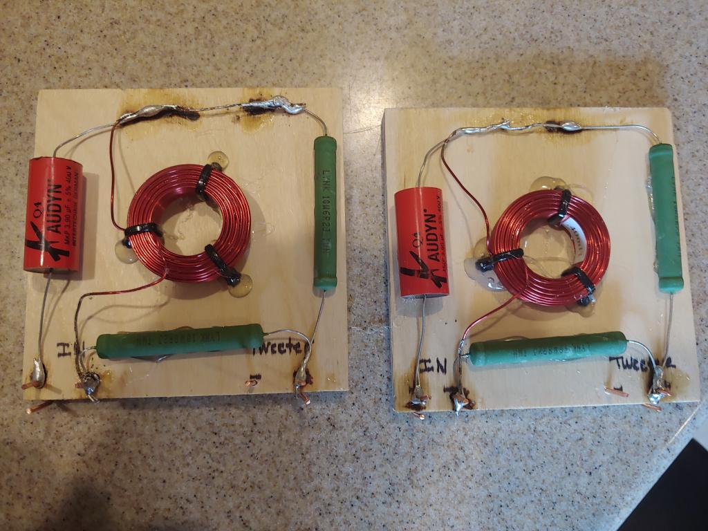

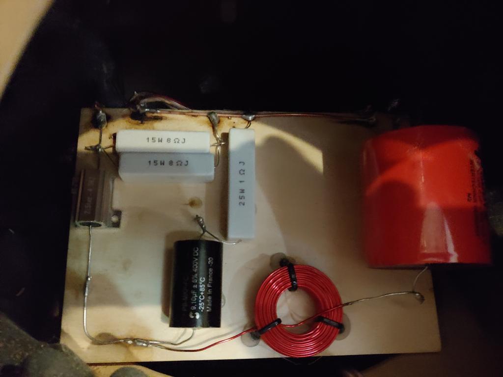

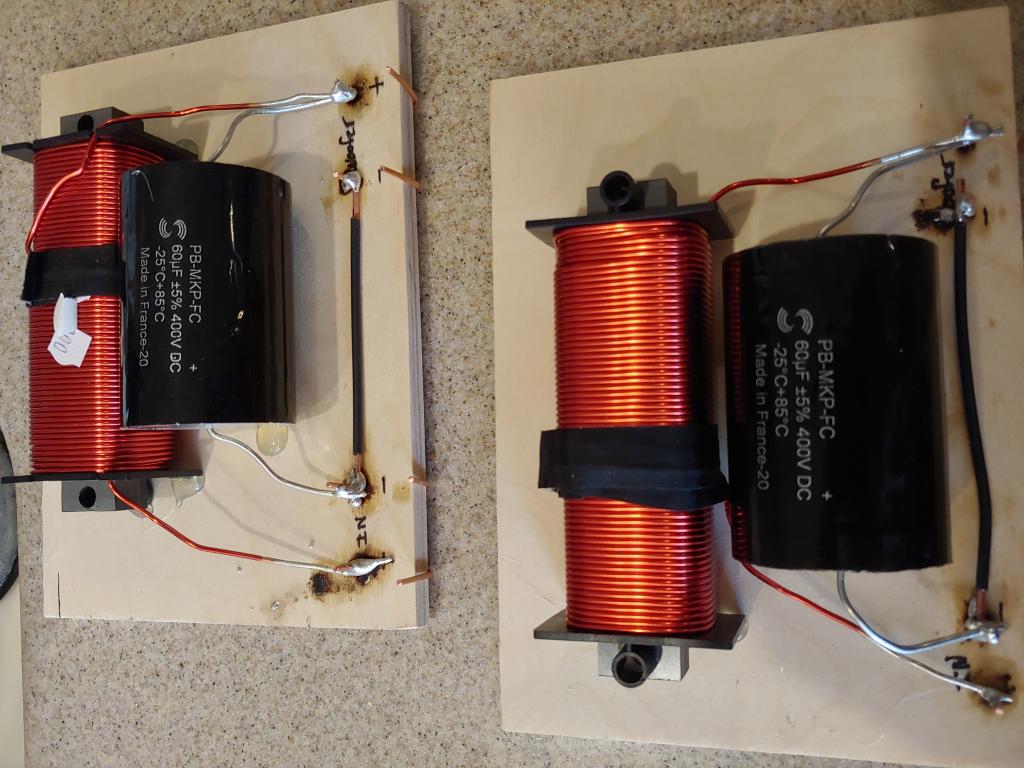

                          Crossover build
                          Now that I've made them fully active, I wanted to complete the build thread. These are the first cross-overs I've made hence the bad soldering.
                          Bass network
                          Tweeter
                          Mid
                          Listening Impressions.
                          The most noticeable change in the passive build is the reduced volume in the mids and highs. To get roughly the same volume in the vocals, I needed to increase about 7db. The payoff here is the bass has a much better balance with the other drivers. Before I was running my subs for music. With the improved bass, I no longer do. These drivers dig pretty low with enough power. They also seem to have a smoother sound transfer between the drivers. As Curt said, they have a relaxed and natural sound. Other than the increase in power to drive them, the only slight negative for me is the vocals had a little more of a breathy quality that I liked, a little more accent on the singers breath and the acoustics of the room they were in, if that makes sense.
                          With that said, they are wonderful sounding speakers. Possibly the best and deepest soundstage I've heard. Great imaging, still plenty of great detail and tight bass that digs surprisingly low. I enjoy listening to them every chance I can get.
