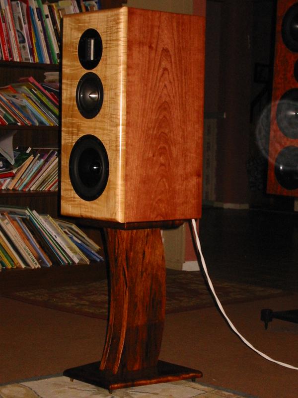

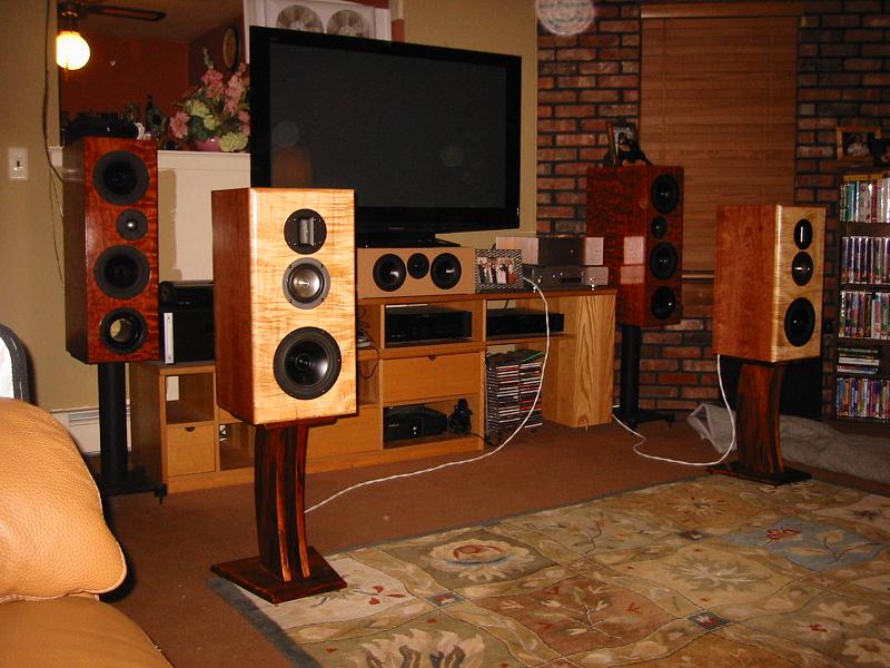

    Our last several month where kind of a roller coaster since we moved into our new house. It has been a three steps forward and then two steps backwards process, as things break and problems are discovered. So I needed something fun to work on (other then fixing termite damage, flood damage, etc, etc... :roll: ).
    So I decided to build the monitors for future use in my future HT setup.
    I wanted to try something new (for me), solid wood baffle.

    I posted this on FroDaddy's build thread:
    "All the drivers are brand new and where broken in for about 15 hours on a music CD. Then I listened to them, they sounded good, but I felt something was terribly off. I hooked up the Statements and I was amazed at the difference, they sound completly different. Much softer sound more detailed, to my ears a night and day difference, like they where a completely different design using different drivers. I then pushed on the W4's cones very gently and the new one where so much stiffer, to the point that it was very easily detected.
    Then I changed the W4 in the monitors to the ones in the Statements and the 'MAGIC' happened and they sound great. I changed the ribbons after that which did not make a big difference if any. I always knew that speakers need to be broken in, but I did not think the difference it makes was so big. My question is (for Curt, I guess), when designing a crossover how do you take into account those changes? and how do you break in the drivers?"

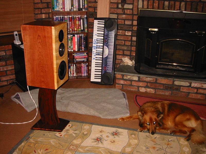

        What is the baffle wood, did you veneer? I love that look and would like to copy it!

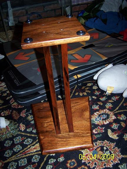

                  Any chance you could post a picture of the stands without the speakers on them? I would like to see how you designed it so the top of the stand and the bottom of the speaker align (so I can copy it, of course!).
                  I'll reserve comment on your feet until after you post pictures of the stands. :roll:

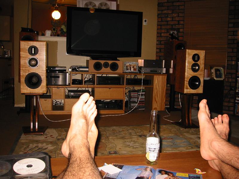

                      Hey... I thought that needs to be a traditional pic with the feet :

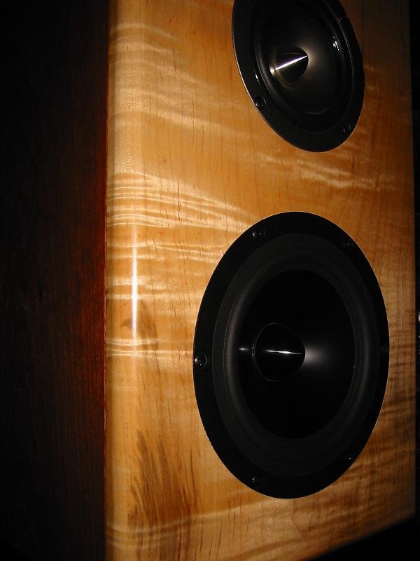

                      The veneer is flat cut cherry from tapease (the cheaper 10 mil paper back one), the baffle is solid wood, curly maple I purchased on Ebay backed with 1/4" MDF recessed. It was hard to find a wide enough piece that would be long enough for both speakers (I didn't want to join boards).
                      And I got to use my new (from craigslist, new in box) Delta Planer :B .
                      I copied the idea from Andy over at the PE board, his new Microbes are simply beautifull !!!
                      I wasn't planning on making those stands, I needed some temporary stands and planned to make them out of 2x4's and some plywood and they turned into these 8O the veneer is some scraps I had from an older project (D III's for my parents). They are just stands for general use, not just for the monitors. If I would have made them for the Monitors I would have used solid cherry. And I wouldn't recommend veneering those curves, just use solid wood.
                      I don't have any pictures of them. I will take some and post them when I get a chance.
                      Are you guys reading woman's clothing catalogs and listen to Statements barefoot? Must be a NY thing !
                      Ha, so you never tried that before? well you should :W
                        And I got to use my new (from craigslist, new in box) Delta Planer .
                        Definitely beautiful, I have lots of Cherry veneer! Its the front baffle that really stands out. I will search for solid curly maple...might be hard to find but you did an incredible job.
                        I will also check out PE, I need all the help I can get when doing finishes.
                            Feet with socks yes!
                            Feet naked. :E :E
                            LOL
                                  It was a near disaster, that curly maple is not easy to work with. I trimmed the two baffles within 1/8" or less using the table saw and then mounted them on the boxes for final trimming with a flush trim bit. Both chipped on the side :M .
                                  I was able to find one of the chips right after but couldn't find the other. Luckily I found it the next day while cleanning the shop and was able to glue both chips on and after sanding you could hardly find them :dancenana:
                                  Next time I will buy a high quality trim bit.

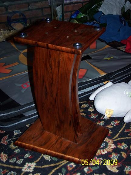

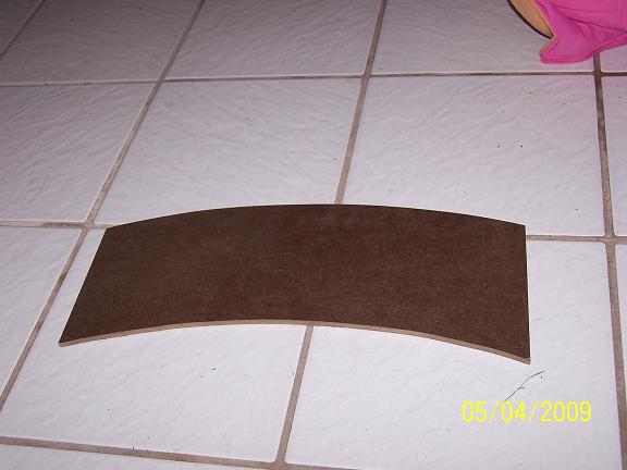

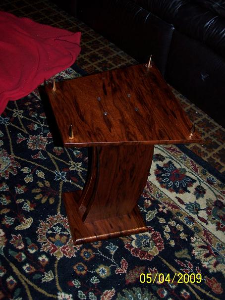

                                                Nice speakers, and nice stands as well.
                                                Not sure if still needed, I'm posting some close up pics I took last night and a pic of the template.
                                                To align them simply start with a rectangle piece and curve the sides.
                                                Asi.

                                                  Excellent - just what I was looking for. Thanks Asi!

                                                        Ok ok.... Is this better?

                                                          I like it! :rofl:
                                                          • jyqureshi
                                                            • 141
                                                            Looks like you took your human layer off of your feet :roflmao:

                                                              that's awesome, much better :yeah:

                                                                Your speakers are truly beautiful. What did you use for the outstanding finish?

                                                                  I appreciate it, but the finish is merely avarage in quaity. I put 3 layers of Danish oil and didn't like to contrast between the maple and the cherry, it's just hard to see it on small test pieces, so I put one coat of Old Dad's 'New Mahogany" stain and finished with several layers of his wipe on poly.
                                                                  I suggest you do some research on the finish since my way was more of an experiment, not sure if it's the right way.
