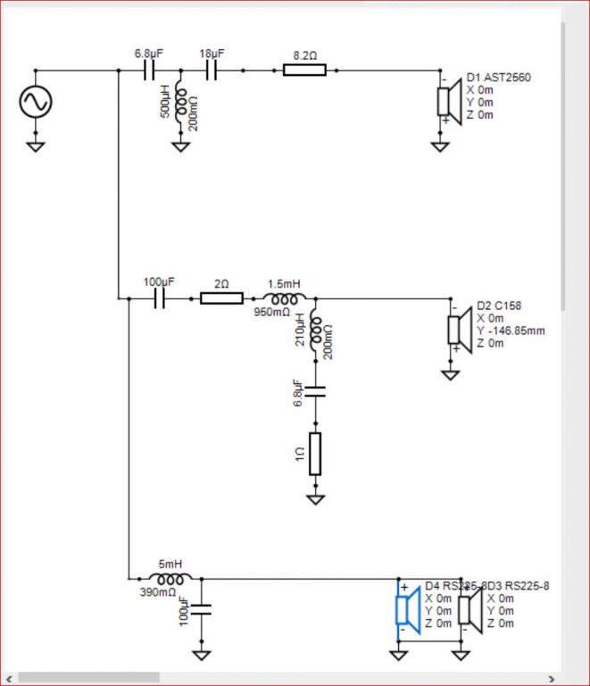

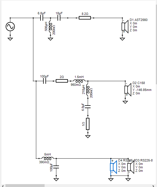

    Just a heads up that between Curt and Efalegalo they have come up with a modification to the original crossover that works better with the new production AST2560's currently shipping. Meniscus has also committed to testing every AST2560 driver ordered to assure the correct crossover parts are included with the parts kit.
    This should help existing and future Bordeaux builders hear them as designed.
    Enjoy the music!

            I’m not quite sure if this the right thread to revive, but I’m curious about what was actually done (electrically and acoustically) with the revised crossover.
            I ask because, whilst normally an active guy, I am currently fiddling with a passive crossover for my open baffles. As part of that I bought a pair of AST2560s to potentially replace my BG Neo3s.
            The issue was that the new tweeter rolled off too soon, creating the dip.
            Does the new crossover flatten the tweeter response above the crossover (presumably at the cost of sensitivity), boost the response around the crossover, or fiddle with the response of the Accuton?

              Hi Steve,
              Curt can certainly answer your question. Sorry, I can not.
