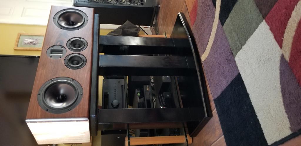

    I just recently finished building the Bordeaux speaker kit by Jim Holt and Curt Campbell. It is a great kit with a great set of plans. Very refined and thorough. Jim was available to answer questions and took the time to Email me information as well as pictures of his build process.
    They are incredibly detailed. I bought the kit from Leland at Speaker Hardware. He was great at getting the components out and being accommodating. I was the first to buy the kit from him so I was the guinea pig.

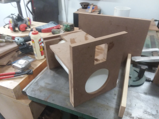

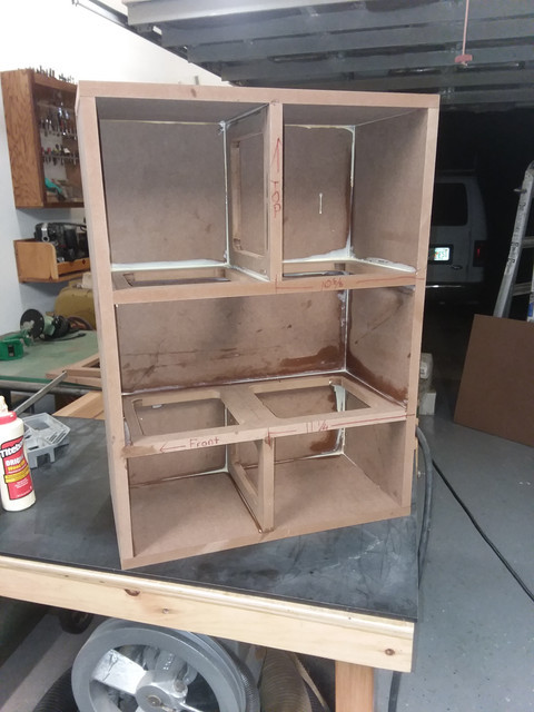

    This is me dry fitting one of the bass cabinets. I suggest doing this so you can see if any boards are wider than the others and for fitment. It is also practice for glueing them up.

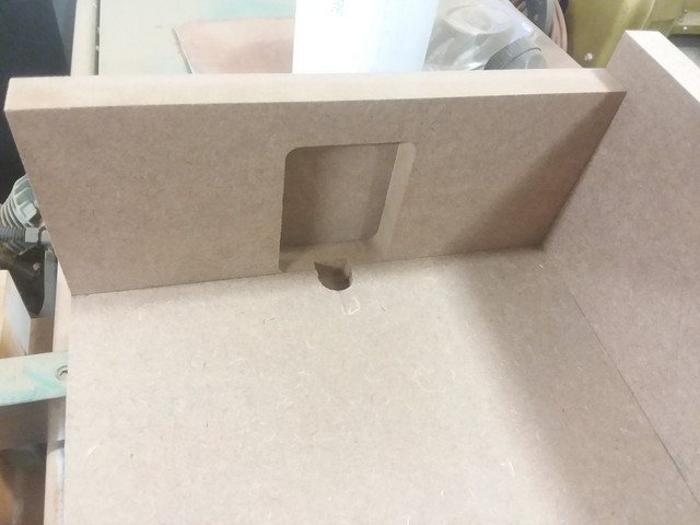

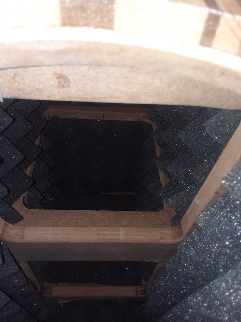

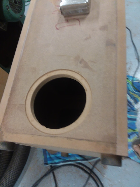

    This is after I had cut the openings in all of the brace pieces. I didn't notice in the notes that Jim had made them all different widths. I think I cut them all to 1 1/4". I wouldn't get to crazy about making them all pretty. I did a 1/4" round-over on all of them and did the corners with a forstner bit. Cutting the holes in them was more time consuming than I thought it was going to be. Also keep in mind that the vertical braces are offset. I believe the plans are marked for the wood on center. I measured 3/8" from the plans to mark the edge of the wood.

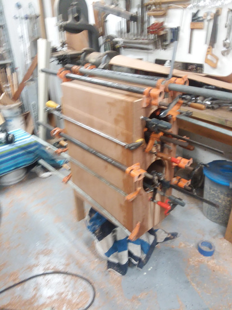

      Here they are all glued up with me trying the baffle piece on the front to make sure it was large enough

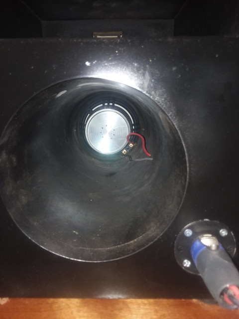

      Below are a bunch of pictures of the top cabinet's guts. I wanted to get different angles to help anyone in the future.

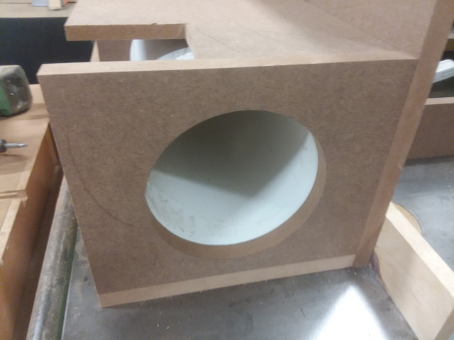

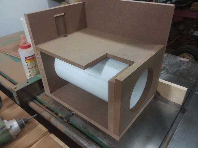

      The back baffle is flush with the PVC. I cut the hole slightly small and used a flush trim bit to flush it up

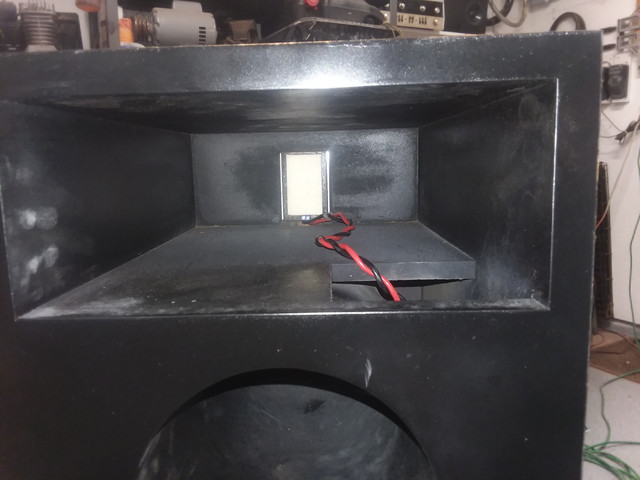

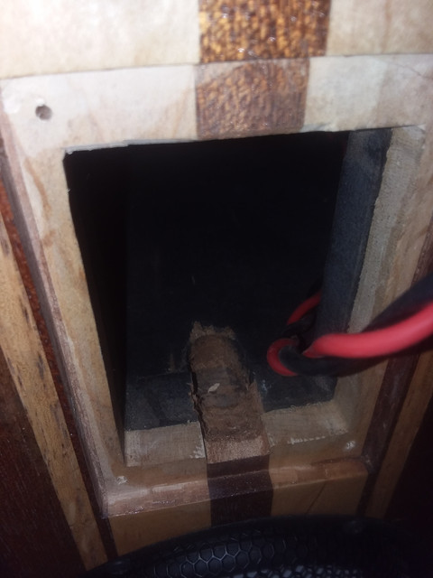

      This is the access cutout. This is for you to get your hand in the bottom part of the top cabinets to work. It is tight but functional.
      This is the knockout for the bottom of the tweeter where the connections are. I followed the plans and realized that has to be cut out further. Also, the corners for the tweeter hole in this picture are round. They need to be cut square. I used a file, wood saw and chisel to accomplish that.

        This is a profile shot of the top cabinet innards. I wanted to show this so you can see how to orient the boards.

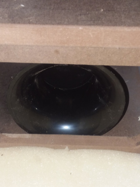

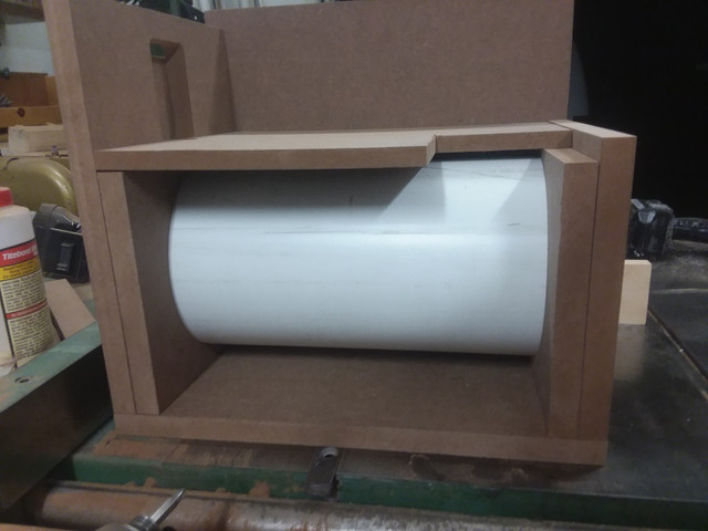

        This is the front inner baffle. The hole is cut smaller than the diameter of the PVC tube. It receives a roundover. Plans call for a 3/4. I noticed that there is a gap between the baffle and the pipe. I filled it with caulk to smooth it out.

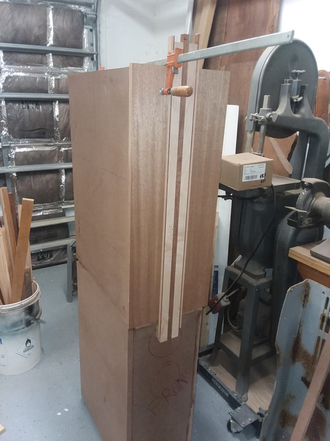

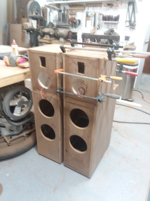

                This is a picture of me gluing the top cabinet together and putting it on the bottom to make sure it was going to match well dimensionally. I used a combination of 18 gauge nails and glue. I used a pneumatic nail gun.

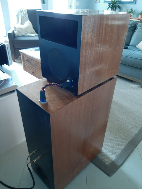

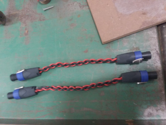

                Here are the cables I made to go from the top cabinet to the lower. They took a while to make as I have never done that braid with anything before. Here is the video I watched to figure it out:
                Here are the cables

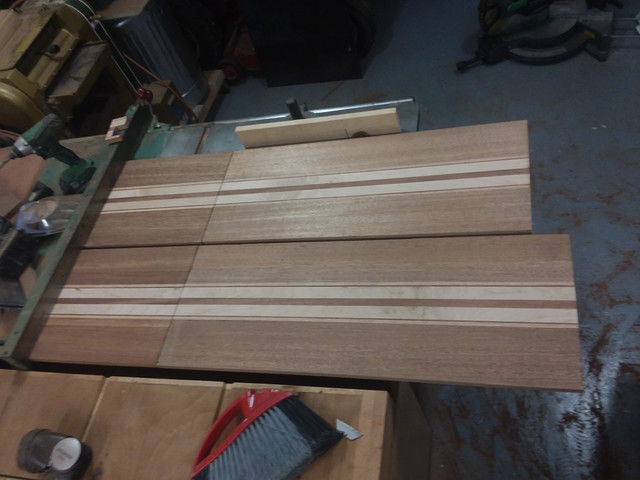

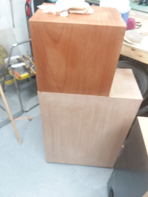

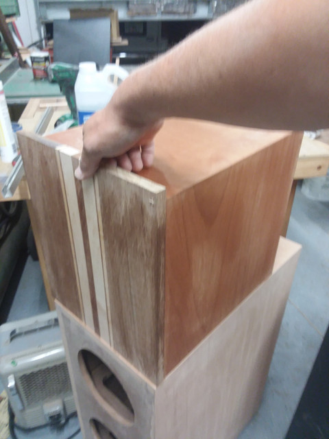

                  Here I am starting to veneer them, I bought the veneer from veneer supplies. It was relatively inexpensive. I think it was around $100 shipped for a 4'x10' piece of mahogany veneer. Good quality to. Very clean.

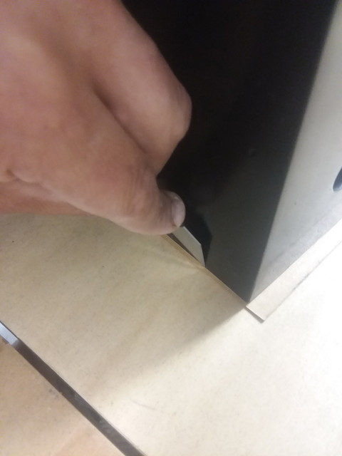

                  I had never veneered before so I learned a lot. I used solvent based contact cement. I was considering using other stuff that was recommended by different veneer websites but I had a decent amount of contact cement and had great luck using it in the past. This goes against the popular opinion.
                  A way to trim it is to set the recently veneered surface on a flat table and use a razor blade to cut the veneer off. Ultimately, you don't have to cut all of the way through. You can score it a couple of times with the blade and bend the veneer and it will pop off.

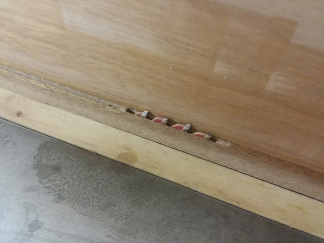

                  This is the amount that I let the veneer overhang. If you are doing a continuous run of veneer, you will want less overhang so the grain matches up better.

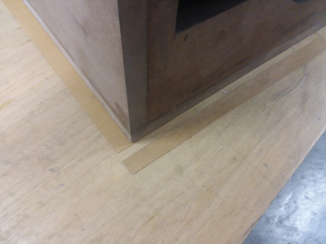

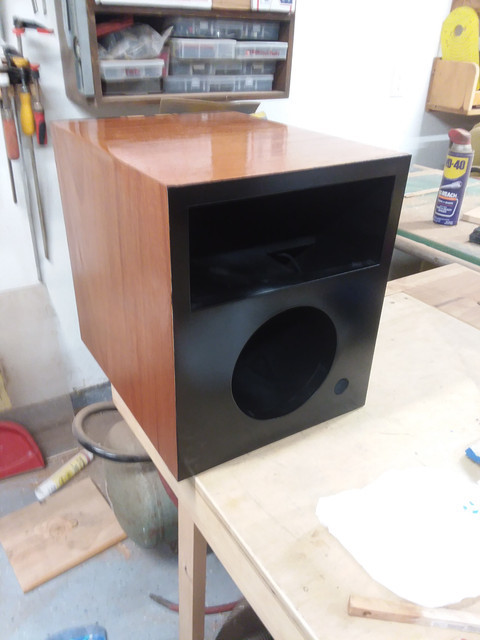

                    Checking that the front outer baffles will fit

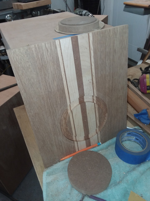

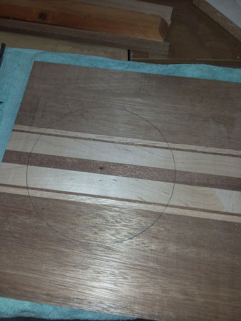

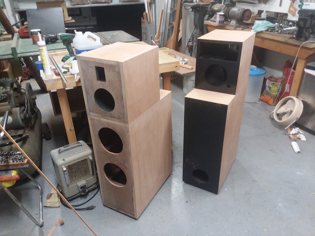

                    I spent a lot of time checking the positioning and accuracy of my setup with the circle jig as I knew I wasn't going to get another shot at it. If I screwed one cut up, I was going to have to figure out another solution for the baffles. It is good to check your cuts on scrap pieces and make sure fitment of the driver works well

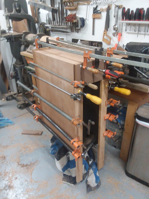

                    Here I am gluing the front baffles on. The boards that I used to distribute the force on the back screwed up the paint so I had to sand and repaint the backs. I used a primer then satin black which was the same as before. Cans of spray paint.

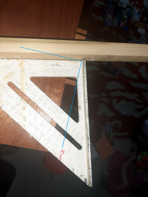

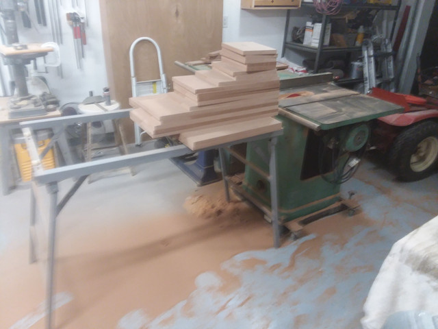

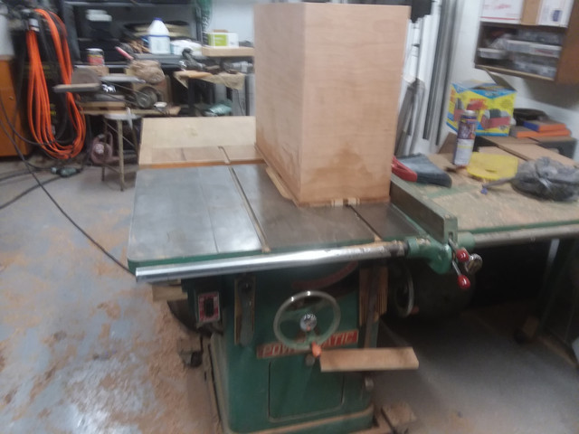

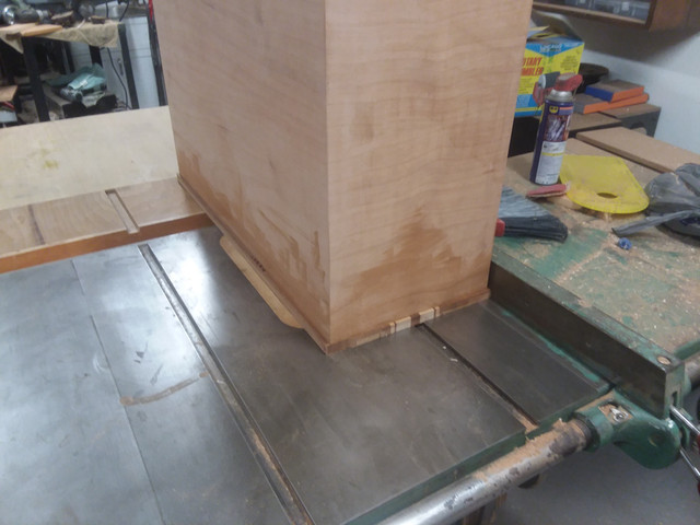

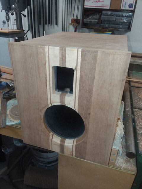

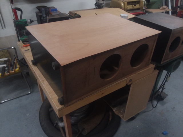

                      Here I am cutting the baffles close to flush. It is good to adjust the table saw a little at a time to get it as close as possible without risking cutting the cabinet. It is good to get the panels as close to flush as you can before taking a router with a flush trim bit to them,

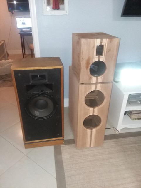

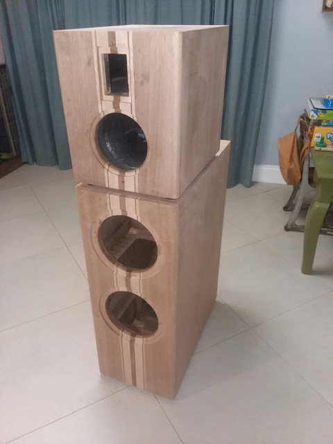

                      Here is one top and bottom cab after I had flush trimmed them and rounded the corners. The plans call for 3/4" roundovers on the bottom and 1/2" on top. I did 1/2" top to bottom as I wanted them to match
                      Next to my forte 1's I was using before. (great speakers btw)

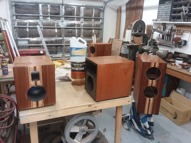

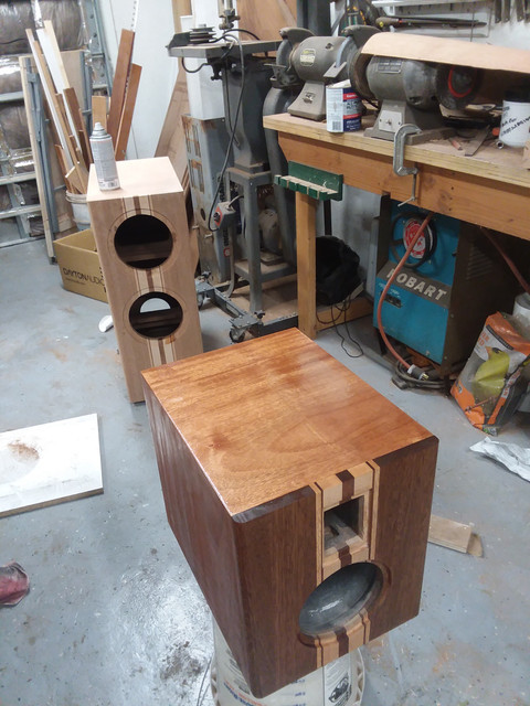

                      Starting to put finish on them. I did around 6 coats of wipe on poly (1/2 mineral spirits 1/2 semi-gloss polyurethane).

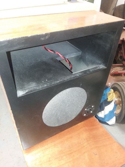

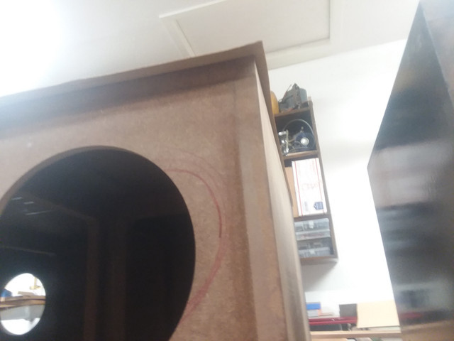

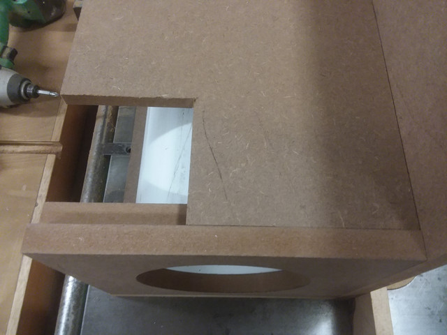

                        Here is a small issue that I ran into. The plans call for a notch out of the front inner baffle and the horizontal shelf brace in the top cabinet. The notch needs to be cut out into the outer baffle a ways otherwise the tweeter wires interfere with fitment. It is pretty straight forward when you try to fit it in. I used a chisel to knock it out further.
                        Click image for larger version  Name:	20200323-225845.jpg Views:	0 Size:	59.3 KB ID:	931243

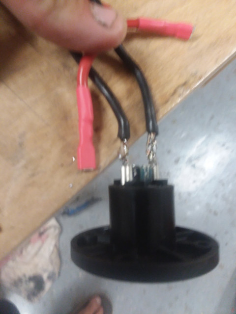

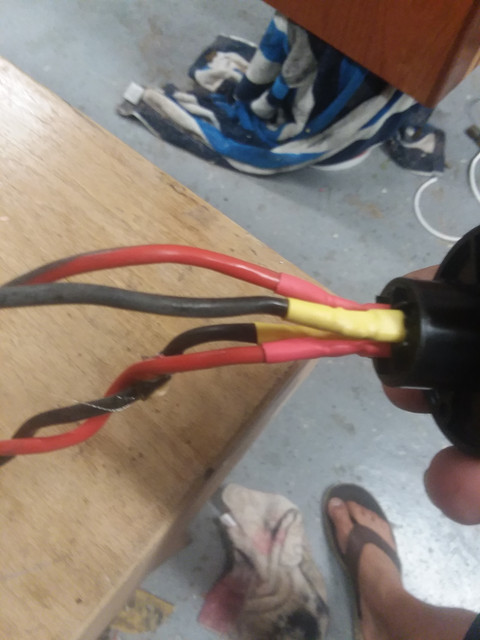

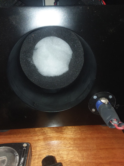

                        For the speakon connectors, I believe you need 1/4" spade connectors. They are the smaller than typical ones. Otherwise they can contact each other. Another thing to mention is to pay attention to the crossover schematic. On Efalegalo's schematic, the crossover's positive is connected to the negative of the tweeter and mid. I didn't realize that at first and the speakers sounded really thin and anemic. I was nervous the bordeaux's weren't all they were cracked up to be until I fixed realized it. Whew! Just for an extra measure of security I put shrink wrap on the connections.
                        Click image for larger version  Name:	20200324-213157.jpg Views:	0 Size:	57.7 KB ID:	931244
                        Click image for larger version  Name:	20200324-213410.jpg Views:	0 Size:	67.3 KB ID:	931245

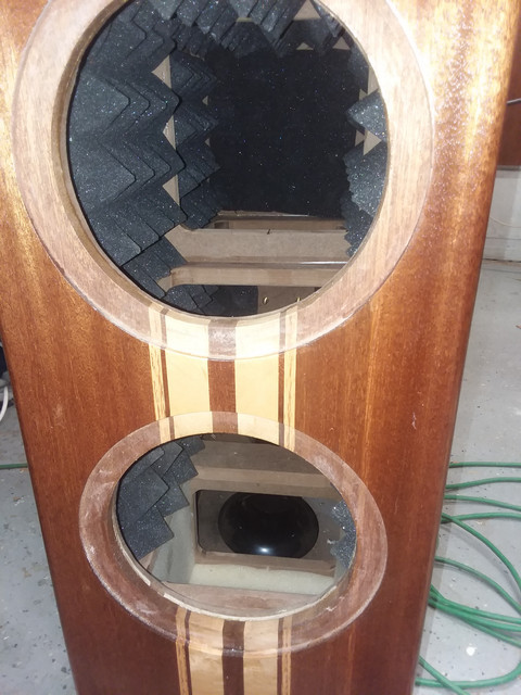

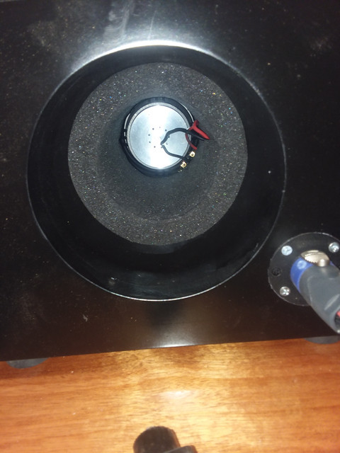

                          This is me putting the accoustic foam and other stuff in the mid tunnel. The kit I bought from Leland was a bare bones kit. He doesn't sell the foam so I ordered that from Meniscus. For the mid tunel you use the polyfill type stuff. It comes in a sheet. I pulled it apart to about a loose wad the size of the 6" tunnel and wrapped it in the 1" thick acoustic foam and put it all in the tunnel. Then I cut four pieces of the 1" foam to make the 4" plug that keeps all of the mids foam guts in place. I used a piece of scrap from the 6" pipe as a template to cut the foam circles against. I cut the three that go on the inside to the inside diameter and the one that faces the outside I cut to the outside diameter of the pipe so it had a nice friction fit. Sounds complicated but It really isn't that bad.
                          I used two layers of the flat 1" foam on the sides of the tweeter cavity. It seemed to be around the same amount as what Jim had in his. Unfortunately, I don't have a picture of it.

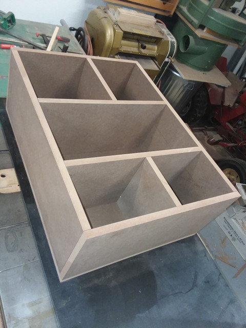

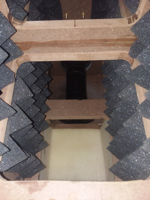

                            Here is the bass cabinet after I had stuffed it with the pyramid foam. Jim said to place the foam anywhere you can see looking through the driver cutouts. This includes some areas in the bottom third. I ran out of the 2" pyramid foam so I used some 1" flat foam that I found from a shipment. It seemed to dampen noise so I put it in there.

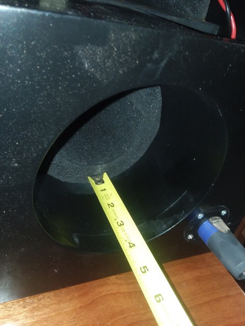

                            One thing to pay attention to is the dimensions of the bracing openings. I believe I made them all 1 1/4" which seems to have covered the port tube slightly. I don't know if this is an issue but the bass seems great on these speakers. If it should improve them to get rid of the extra material around the port tubes, I could do so with some effort.

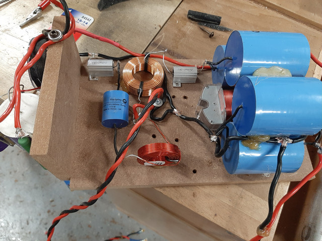

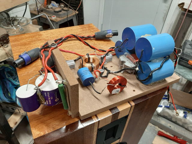

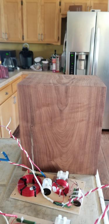

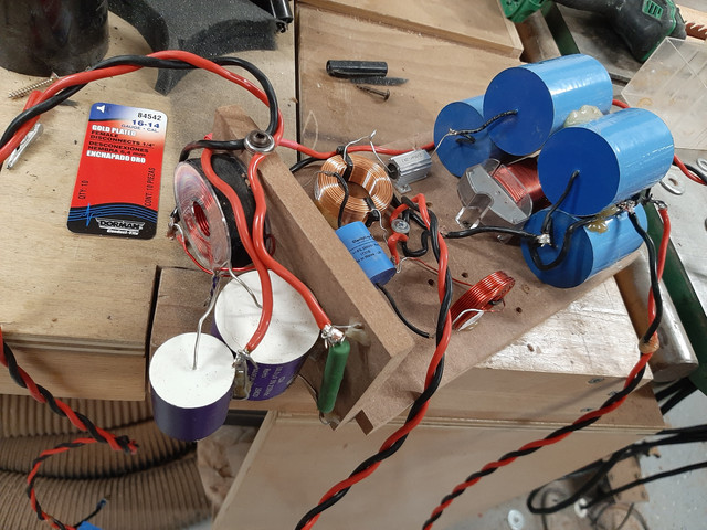

                              I am not a crossover guy (especially since this was my first speaker build) so I built these by taking some ideas from Jims. I made the board "L" shaped to pack it in the box more economically and have less board restricting airflow to the port tube. I put the tweeter circuit on the smaller board and the mid and woofer on the larger part. The speakers sound really good so I assume I got it right.
                              I liked Jims method of pinching the wire with the contact from the crossover components. makes a mechanical connection to hold it in place as you solder. I also used my wire strippers to cut the insulation of portions of the wires to solder to. From what I can gather, it doesn't matter where the grounds are connected. Just the positives. All of the grounds and speaker negatives are tied together.
                              I used hot snot to hold it all together. Not preferred by alot of people but I will check them after a while and see if anything has come apart. I didn't have zip ties on me and didn't feel like making a trip to the store as I only have so much free time.
                              If anyone see's any issues with the layout of the crossovers, let me know and I can find some time to change them.
                              Last edited by theSven; 01 April 2023, 20:13 Saturday. Reason: Update image location

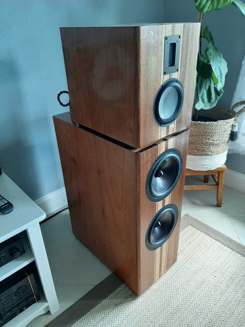

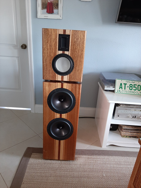

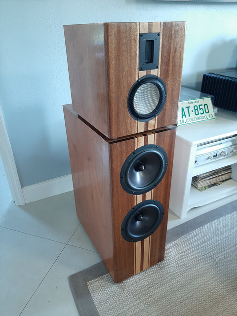

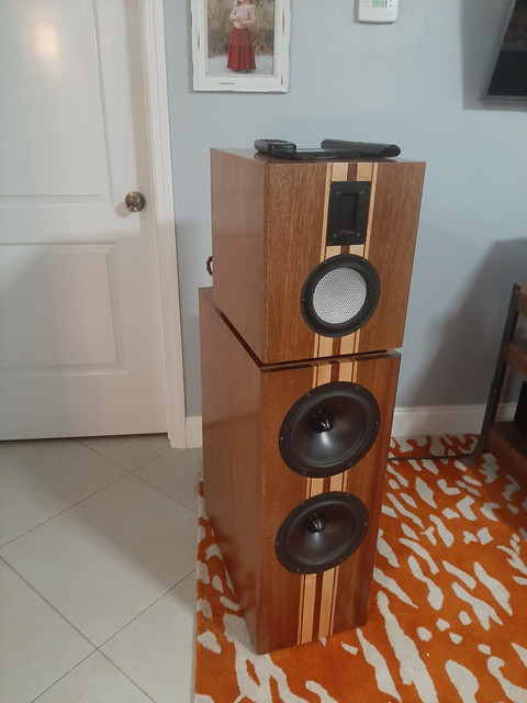

                                Lastly, here are some pictures of them complete
                                  Those are VERY VERY nice cabinets!!
                                  I must say that you are a lot more brave than I am! I would never attempt that trim with a tablesaw!! EEEKKK!!!
                                  That is the perfect candidate for a flush trim router bit. Use the tablesaw to get close, and then finish off the last 1/16" or so with the flush trim.
                                  Looks like the saw worked though!!!
                                  GREAT project!!

                                    Yes, I edited that post to include that I used a router with a flush trim bit. I used the table saw to get close. I am sure there will be more edits as I am not the best with details like that! Lol. Thanks!

                                          • Mikerodrig27
                                            • Feb 2015
                                            • 167
                                            Jim and CADman, yes. I have spent some time with them. I let them play yesterday for most of the day to help break them in which they needed. I went to a couple of stores and let them play while I was out of the house.
                                            They are crystal clear. Clearer than any other speaker I have heard. They also have the best mids and highs out of everything I have heard. The longer you sit with them, the more you start to realize how great these speakers are. The bass cabinet is also pretty powerful. I put a 23hz tone through it for a minute or two and it was surprisingly strong at that frequency. That is a good way to find leaks...
                                            There are a lot of songs that have details that these bring out. Soft songs with light percussion is nice to listen to. The tweeters are very accurate and detailed sounding which really helps bring out the tiny details. The Accuton is amazing as well. Some CD's I listened to:
                                            -Santana Supernatural
                                            -BB king and eric clapton's "Riding With The King"
                                            -Eric Clapton's Unplugged
                                            -Miles Davis Kind of Blue (A lot of things I didn't know were in this CD)
                                            -Soundtrack to The Mambo Kings (this is a great set of songs. amazing musicians. Lots of percussion and great voices)
                                            Listen to the trumpet player in this at around a minute in:
                                            The most important thing is like with any speaker, you need to spend a lot of time listening to them to really get the experience.
                                            Thanks for the design. I now have a really nice set of speakers!

                                                Awesome! I'm really pleased you're enjoying the Bordeaux. The Accuracy, detail and clarity are addictive. You rediscover your music collection!
                                                Again, beautiful cabinets!
                                                Enjoy the music!

                                                  Your build looks fantastic and the finish is very nice on the eye!
                                                  Painter in training
                                                  • CADman_ks
                                                    • Jan 2012
                                                    • 497
                                                    The finish looks really nice!
                                                    I've never used that wipe on poly for speakers, but I have for other projects, and is EASY, and the finish is very forgiving, unlike traditional poly, which looks GREAT, but is not always forgiving.
                                                    I should have used wipe on when I built my sub, but I decided that I wanted traditional in case someone set a drink on it without a coaster. I had several fights with traditional on there...
                                                          It works great. The process is to wipe it on give it a minute and then wipe the excess away. I didn't wipe the excess away so that the grain would fill just a little bit. I did sand between coats though.

                                                              I found some pictures of the bookshelf I scavenged the wood from for the front baffle and some pics of me making the front baffle. Maybe they'll give someone else some ideas.
                                                              The bookcase at Habitat for Humanity. was $10
                                                              I have these two pretty straight rails, sometimes I will glue things on them
                                                              I see all kinds of stuff at habitat. I scavenged the oak from a TV cabinet that was on the side of the road. The maple was given to me. The darker stripes in the center are the mahogany turned 90 degrees from the wide panels of mahogany.
                                                              It goes
                                                              Mahogany > Oak > Mahogany > Maple > Mahogany < maple < mahogany < oak < Mahogany
                                                              Last edited by theSven; 01 April 2023, 20:15 Saturday. Reason: Update image location

                                                                    It sounds like you're getting them dialed in nicely. They are designed to be pointed straight ahead rather than pointed at the listener. That is approximately 15 degrees off axis in most listening rooms and will provide the flattest frequency response. It also allows for a wide listening position with no head in the vice problems.
                                                                    OK, I don't think corner bass traps would be a problem but don't do absorption panels on the walls behind the speakers or in close proximity to the area where the rear sound waves will be muffled. Experiment to see what works the best for your room. Reflection points on the side walls should benefit from absorption material, however, again experiment to see what works best.
                                                                    Disclaimer; I don't have any wall treatments in my room so the above recommendations are creative thinking.
                                                                    Let us know how it turns out.
                                                                    The above quote is a response from a question I had asked Jim in the main Bordeaux thread. I wanted to post here so that I didn't take over that one.
                                                                    I tried setting them up at 15 degrees off axis today. I pretty much have my speakers setup as an equilateral triangle between them and my listening position. I never really checked into how far off axis I was from my listening position but it was pretty far off. I originally had them toed in slightly but it wasn't nearly enough.
                                                                    I tried taking a speed square and referencing the front center of the speaker adjusting the square to 15 degrees. I put a long piece of wood against the square and used it as a pointer. I turned the speakers until the pointer was pointed at my listening position. This made a positive difference in the sound.
                                                                    I also built a small rack for the sound equipment (to open the area up) and laid down a larger rug that I got for free to help with sound absorption. Those two things helped as well. I still need to make some acoustic treatments for the wall. I would like to have some nice art printed on fabric and stuff the panels with rockwool or something like that. The room is fairly dead but the first reflection points are still exposed and need to be taken care of at some point.
                                                                    The last thing that I did was I swapped out the Adcom GFP 565 for a Haffler DH-101 that I completely rebuilt with new power supply componants, new caps throughout and new gold RCA connections. It is a great preamp. Performs much better than I expected it to.
                                                                    I'll upgrade my progress once I get around to doing some more stuff but am enjoying these little tweaks in the mean time.

                                                                      Great build. Do you recall (or have written anywhere), the cutout and rebate dimensions for the tweeter?
                                                                      I'm seeing different numbers each source I check.
                                                                      Steve's OB Journey
                                                                      • Mikerodrig27
                                                                        • Feb 2015
                                                                        • 167
                                                                        It has been so long that I don't remember exact details.
                                                                        I used the actual tweeter to set up a template on the front baffle.
                                                                        I took the tweeter, measured based off of the plans to set it in the right spot on the front baffle and set pieces of wood against it with a couple of pieces of paper between them and the tweeter (to make a gap). I nailed those pieces of wood in place with my pin nailer (23 gauge) and used my router with a follower bit to cut the recess for the tweeter. You have to go in with a chisel to the corners. I did cut the hole for the tweeter ahead of time. For the depth, I used the tweeter and checked the recess with my calipers (the depth gauge part).
                                                                        The one difference I saw that should be noted is that the notch for the wire pass through needs to be a lot deeper. It needs to go into the front baffle a bit.
                                                                        Let me know if this doesn't make much sense and I will try to reiterate it all.

                                                                              The X-LS Encores went into my analog setup in my home office. Regar Plane 1 TT, Monoprice hybrid 50W amp (next item to be upgraded) and the Encores. Small room, 14 feet by 12 feet. Only finished a few days ago so still breaking in. So far very impressed. I enjoyed the build; the videos on GR's website were a big help particularly with the cross overs. The sound is a million miles from the ~$100 Sony book shelfs they replaced. I do have a bit of a hum coming from the turntable that I need to look into but I am very pleased with the speakers for the price. When they have some time on them I will try them in my main system (Cambridge 851N streamer and Cambridge 851W amp) just for grins. I currently have a 25 year old set of Mission 753 in the main system (with will be replaced by the Bordeauxs.) I would not be surprised if the Encores put the Missions to shame.
                                                                              Here's a picture of the cross over and the unfinished cabinet in the background, also a picture of the Statements II Center.
Name:	X-LS Encore.jpg
ID:	865995Click image for larger version
