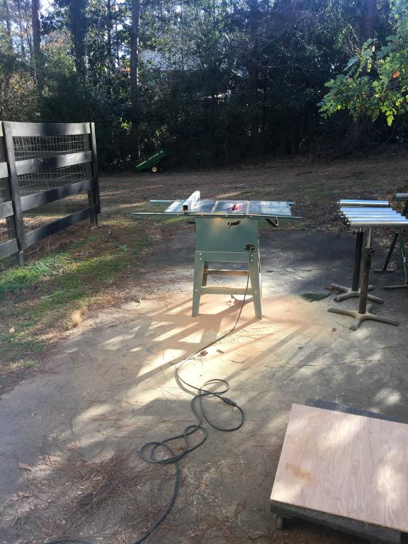

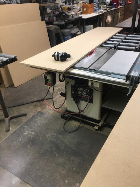

    This afternoon was spent using the cut sheet to make lots of MDF dust. I hate MDF dust. All of the cuts I could make using my little Jet saw were done outdoors. (It was a beautiful day in Atlanta for cutting outside) The other cuts were indoors on the Unisaw. Trying to manhandle a 4 by 8 sheet of MDF gets harder every year older I get. These are going to be heavy speakers. Nice that there are going to be two enclosures each.
    The enclosures are going to be the fun part. I hope ya'll will help me through the crossover build.
    (Jim, there were a couple of dimensions on the cut sheet that were left off, but otherwise well laid out very easy to follow)

      Yes the weather today was a blessing. If the lows get in the teens we are frigid, we even had two snows this year. With highs in the 50s I was in a t shirt.
      Yes Jim, the dimensions are clearly shown on the detail drawings! So easy to fill in.

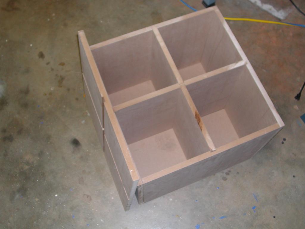

      In previous subwoofer builds, I had cut rebates in the panels to get them to line up during gluing and clamping. To keep everything aligned this time without that, is it best to pre drill holes and use finishing nails to keep all of the large panels in place when clamping? There are a few braces inside that during pre fit I am not sure how to keep square. I suspect you have a way you do this to keep everything aligned and square.

        Hi Mark,
        I'm a fan of brad nailing for placement of the panels as I glue them up. I tack them into position and then clamp them solid with corner clamps to hold them square. I'm guessing there are others with much greater cabinet building skills on the forum that may have better ideas than I. A master cabinet builder, I am not. 8O They are solid, however.

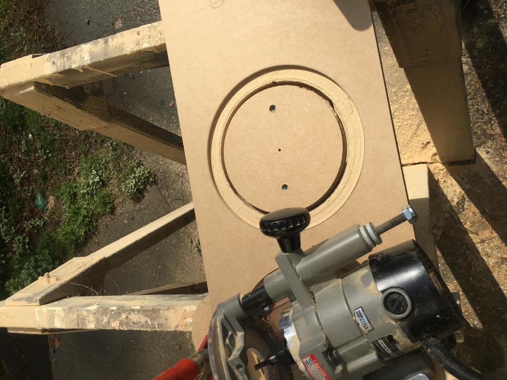

                        The only thing worse than cutting MDF is routing MDF. Got the Jasper jig out and made more MDF dust today. I hate it when you break the "hole" loose and the router hits the side, and yes Jim I did round over the woofer hole as you suggested in your notes. Also outside, routers make lots of dust.

                          Jim, a couple of questions.
                          1. How did you cut out the upper and lower shelf pieces. Did you use a router, a scroll saw or something else. Trying to make these from pieces would have been hard to make square.
                          2. Would it be OK to leave radii in the corners?
                          Mark
                            After too many of those nips freeing the center I've settled on routing a groove deep enough to guide a flush trim bit on, cutting the waste out with a sabre saw then use a flush trim or pattern bit to finish the hole. I've never been totally successful with double stick tape. You could also use a chamfer/roundover bit to finish the hole if the circle guide passes are cut deep enough.

                              Hi Mark,
                              Excellent progress!
                              I simply cut the shelf braces on the table saw and then sketch out the areas I'm going to remove for the window pane and then punch a couple holes in the take out area with a hole saw bit. Finally, I use a sabre saw to cut the panes out. Mine are not pretty but very functional. I figure no one sees inside the cabinet so I'll spend my time and energy making the outside pretty. A lot of guys like to use a router to cut them out and make them pretty. Your choice. :-) I use my table saw where ever I can. The pieces are always square and fit perfect that way if I do my part....
                              BTW, if you're asking about routing the complete brace out of the MDF sheet, you can, but I wouldn't. That sounds like a LOT of work. These are just braces to make the cabinet solid and eliminate any ringing from sound waves.
                              HTH
                                Hmm, yes for bracing drill a holes in 4 corners, cut close to the line you have marked with the sabre saw and round over half the thickness on 1 side half and half on the other, little sanding in the middle. If you have real thick bracing I do what Bob does but do 1 pass with router not all the way through, then drill 2 small holes in the groove on either side of groove large enough for sabre saw bit to get all the way through. Finish with Sabre and Flush.
                                Circle cutting with the Jasper should be,
                                sacrificial piece on bottom, then your piece you want the whole in on top, clamped the good and sacrificial to your table.
                                drill for the Jasper pin into the sac piece as well as good piece, make sure the pin is through both pieces.
                                Use a couple of passes to get through your good piece and the router won't move after you finish the cut as the pin is in the sac piece holding it from skipping into your good piece.
                                Go slow when you know your finishing the cut on the last pass.

                                  +1 on the the Jasper stuff and I also use double sided tape between the boards. Use double sided carpet tape from Lowes seems works very well.

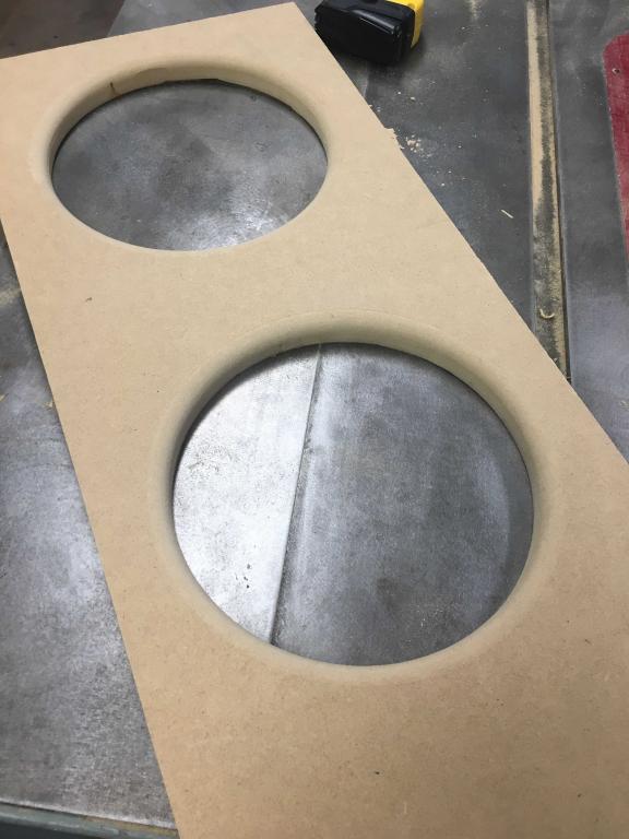

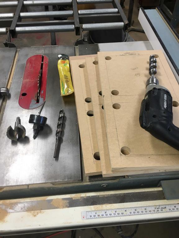

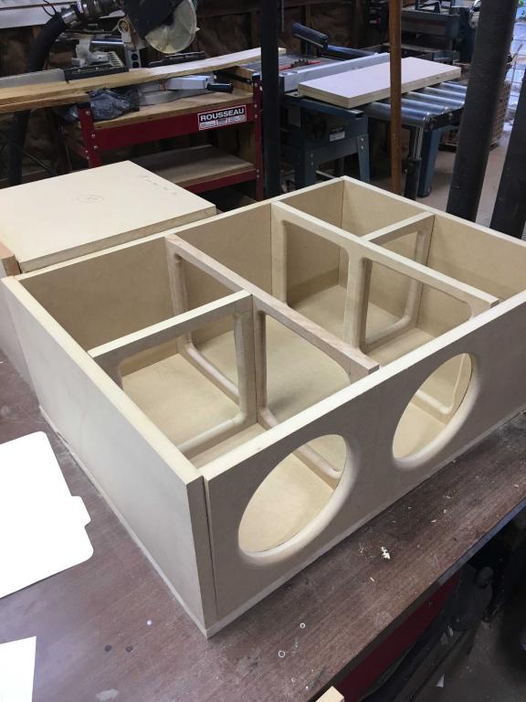

                                    A little more progress today. Experimented a bit on how to cut the centers out of the braces.
                                    Using a router is not the way to go. Way too hard to find a methodology to do cut the enters out.
                                    Tried a big Forstner bit, a hole saw and finally a bit I have used to cut holes for running Romex in houses. Romex holes win! Ended up drilling the corners and finishing with a scroll saw. Not pretty but much faster. I cleaned it all up with a round over which makes it look a bit cleaner, but Like Jim told us, it is on the inside and no one will see. For vanity sake only. Dry fit looks pretty good. A couple of spots will need a bit of sanding to be perfectly flush.
                                    I spoke with Mark at Meniscus, he is putting together a kit for the Bordeaux, so if anyone is interested in building these, he is an excellent contact.

                                      For you next build I would recommend using a hole saw (do a google search for hole saw or holesaw)!
                                      For just cutting some braces this will probably do:

                                        TEK, I did try a hole saw, but they are a pain, and not as fast as the big bit. With a hole saw, I ended up getting the "hole" stuck in the center and getting it out took too much effort. It also tore up the back side of the MDF.
                                        Look at the picture above, the bit in the drill on the right worked much better. The hole saw I tried is on the left next to the Forstner bit.

                                          Another idea for keeping you center pieces in place while routing. I had been meaning to give this a try for a while but finally got around to it today. Since the center is pretty much scrap, if you have a brad nailer, pop a couple of 1 1/4" brads (assuming your cutting 3/4" material ) inside the bit diameter into the spoil board underneath. Your also going to have to clamp the outside of the baffle in place as well. This certainly won't work for small pieces, but baffle sized stuff it seems to work very well.

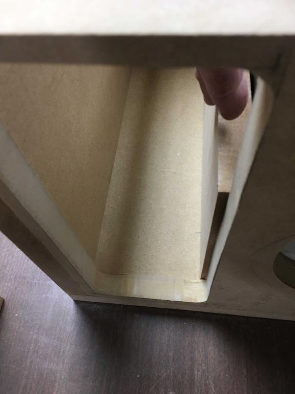

                                            I have been dry fitting the boxes together and the only real discrepancy I have found is on the top box rear baffle. The shelf does not line up with the cut out of the rear piece. I think either the height of the hole needs to be smaller by 1/4 of an inch or the tube holders shorter by 1/4. See pic below. Did not look like this in Jim's photo. Not sure where I messed up. The picture is looking forward towards the tweeter hole.
                                            For those that follow, the rectangular hole in the rear baffle has thin sides. Be careful when you cut these. I was using a vintage Craftsman scroll saw which vibrates like crazy. I was careful to keep the thin portion supported. MDF is not the strongest material.

                                              Hi Mark,
                                              I double checked the dimensions in the plans and they are correct. The cutout edges should be 1/4" which isn't real strong but it's strong enough to provide support for the top baffle. Once everything is glued up, it becomes a very solid cabinet. The shelf brace is 1/2" MDF and it looks like you might have used 3/4" instead? Also, the outer front baffle on the top cabinet is created from 1/2" MDF rather than 3/4". The outer on the bass cabinet is 3/4".
                                              Sorry for any confusion the combination of 3/4" and 1/2" in different locations may have caused. I selected materials based on space and strength requirements that I thought would end up with a very stiff and dead cabinet. I just updated the build tips document I include with build info.

                                                You are correct, I have the shelf at 3/4 inch. Good catch and thanks for correcting me. I will remake the shelf using 1/2 inch.
                                                The 1/4 inch width seems fine, I was just commenting on something during the build process and my vintage scroll saw.

                                                  Remade the shelves out of 1/2 in and they fit perfectly.

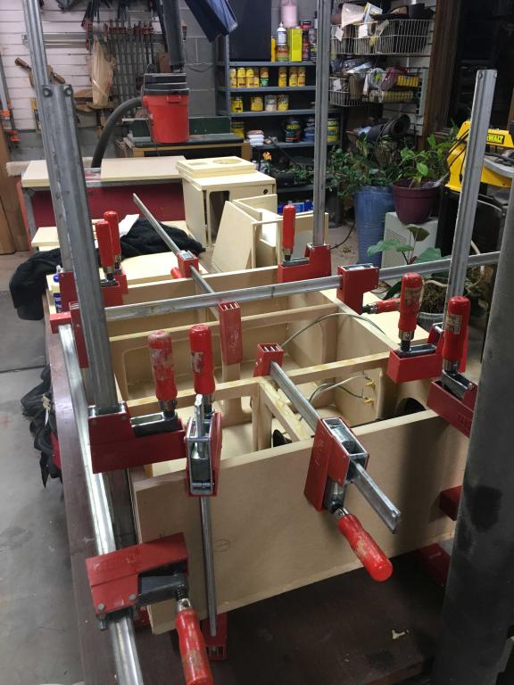

                                                    I am including the required, "I don't have enough clamps" photo.

                                                      And as far as router technique. What I found works for me is to use progressive plunge depths. In opposite orientations. Say the first is clockwise, the second is counter clockwise. Then the final is where you can see the bit. Stop as you finish the final rotation with a gentle pressure towards the center. It leaves a small amount of material, but no marks on the outer wall of the cut. It also helps from getting the cord tangled.
                                                      This is probably better for me because my ole bit is not the best.

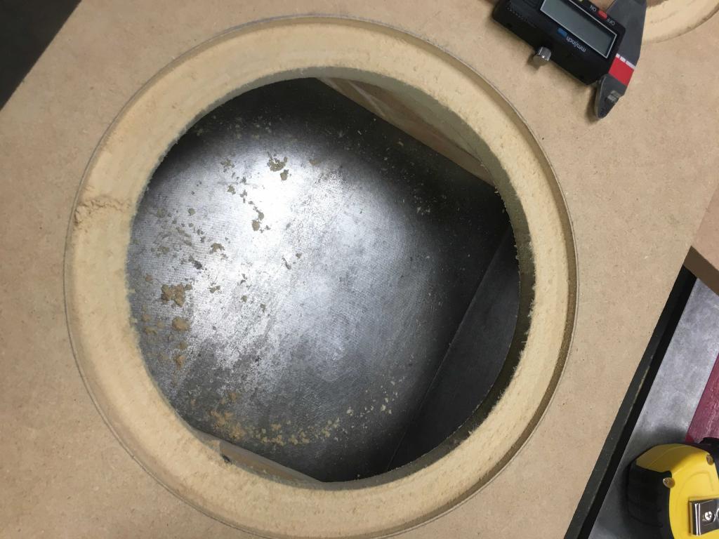

                                                              Made some progress over the weekend.
                                                              The kit from Meniscus includes all the drawings and instructions. Components laid out on the diagrams. Will finish this week.

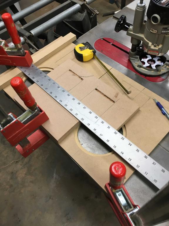

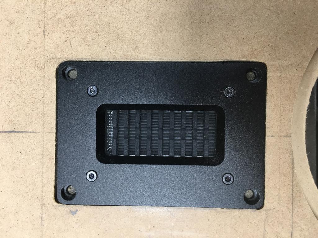

                                                              The tweeter cutout is taking some ciphering on my part. The experimenting I have done has me at setting up a fence to guide the router. Trying to do all 4 sides with one set up got way too complicated. So I think I am going to do something like the picture below. Cut one side at a time.
                                                              On a test piece I was able to control the cut pretty well. The straight edge is the fence and the router base moves smoothly along it. Will do both baffles at the same time. Cut one side. Rotate, cut the next side, repeat. Then clean up any rough edges. I will report on how this goes.
                                                              If someone has a great way to cut these, please report. My previous attempt at cutting rebates for hinges using a jig did not go well and I am searching for options.

                                                                Thanks to the many that contributed to my thread about about how to recess irregular drivers, (check it out) this looks like the simplest way to do perfect recesses. https://www.htguide.com/forum/showth...l=1#post627869 You'll also need one of these or similar; Whiteside Router Bits 3001 Template Bit with Ball Bearing
                                                                The actual cutout for the driver can be handled by a saber saw if you like since it won't show or with the router and straight edges if you prefer. It was suggested that after tracing the square driver frame use a drill (1/4" maybe) to create the rounded corner and then use Jon's method of a simple square template with the template bit to cut the recess.

                                                                  I spent some time this week working the "square hole" exercise. As Jim suggested I traced out the pattern by removing the front face of the driver. I also ordered a router bit, but could not wait. I just used a straight edge. Which actually worked great. I had a couple of perfect holes. Except one dimension was a bit too short. The rework was not nearly as perfect. Hole ended up a bit tall. A great exercise none the less.
                                                                  This may be the first woodworking project I have used the calipers to measure...

                                                                    • 4158
                                                                    A dab of epoxy and a light spring in the bit?
                                                                      Looks very good! :T

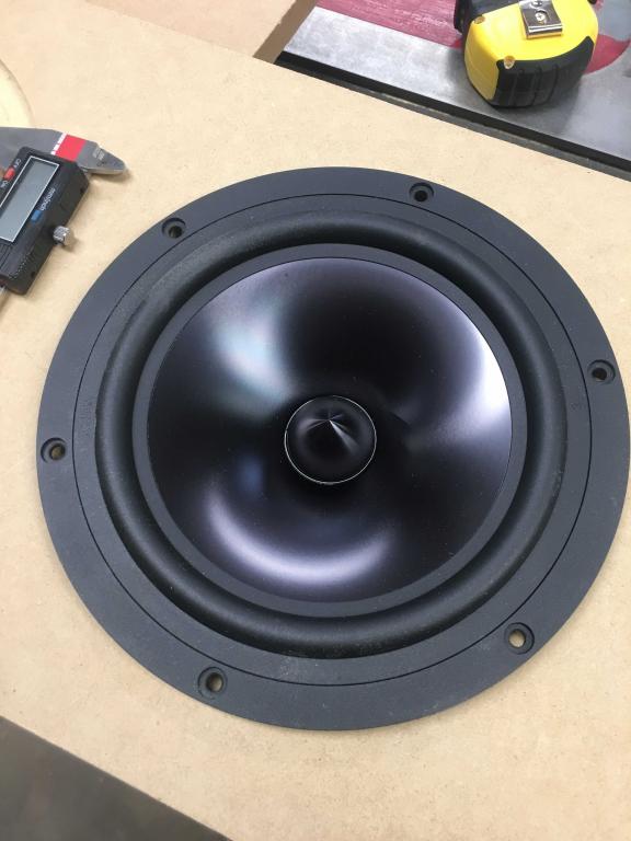

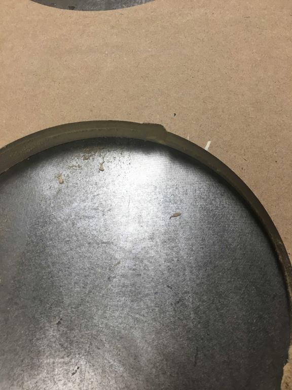

                                                                                  Back to the build process. I wanted to pass along some of the mistakes I made so anyone with a later build might not have the same problems.
                                                                                  In routing the recesses in the bass front baffle, I routed to 8 3/4 inch diameter. The driver is also 8 3/4 diameter. At lest measuring with a tape they are. I do not have calipers big enough to measure exactly. The problem I had was the driver did not fit in the hole. See first picture.
                                                                                  The second picture shows a pencil line I traced around the driver. The last shows my cobbled up fixture to hold the router while I cut a larger diameter hole. I went with 8 7/8, but 8 13/16 would also work I think.
                                                                                  Not sure if tolerances got me or what, just passing my experience along.

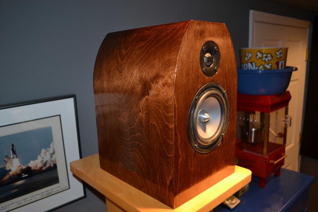

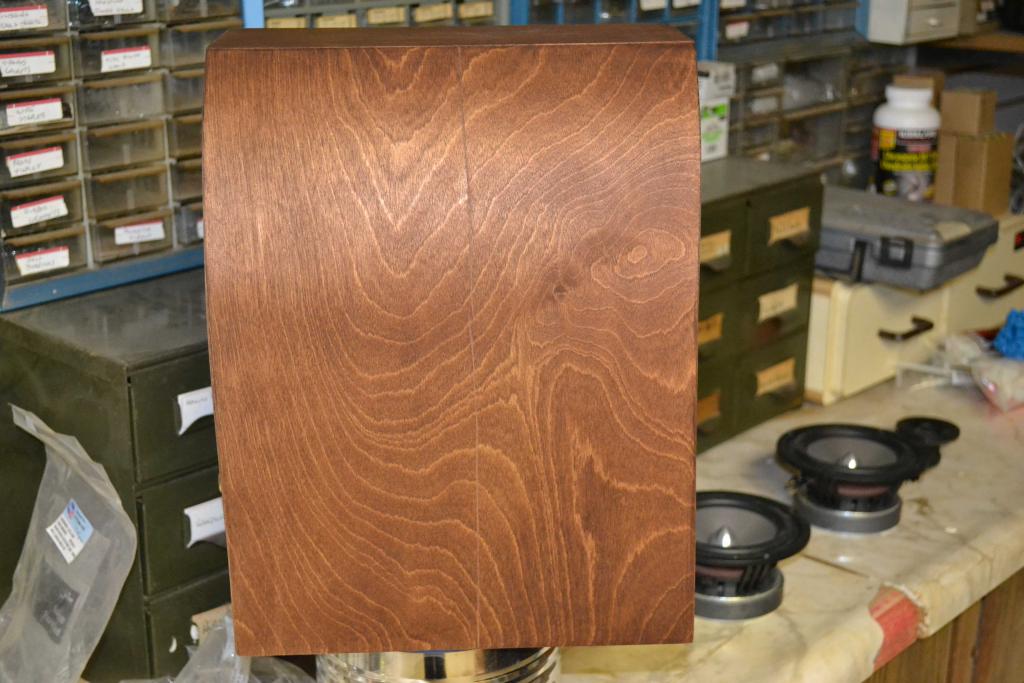

                                                                                        I have had some experience using hardwood on the outer baffle. Over the years I have made about 12 pairs of speaker with hardwood baffles and have not had one baffle failure yet, even though I live in a dry cold winter, high humid hot summer environment.
                                                                                        I had seen a David Ellis 1801 speaker (a Dennis Murphy design in 2002/3?) and became interested in using a hardwood baffle on some Dennis Murphy's MBOW speakers that I was building. Jim Salk had built a couple of those 1801s and I paid him a visit in 2005. By then Jim was starting to build his own speaker design with hardwood baffles. If you want to see his work go to salksound.com and take a look at his Veracity Series, which is his oldest line. You will see some of the best cabinet work on speakers anywhere. Jim showed me his hardwood baffle. My baffles are not removable however. I use a simple method of gluing the outer baffle to the inner baffle with NoMoreNails or other flexible adhesives which will also form a seal. However, I don't see why insert nuts or Hurricane nuts could not be imbedded in the back of the outer baffle and attached to the speaker with bolts from the inside of the cabinet. Of course some rubber gasket would have to be trapped like the Magico one pictured to seal the cabinet. Precision in the fit would be necessary to get the two baffles solidly together to get the benefit of a solid thicker front baffle. The advantage of a removable baffle would also allow a changeout if the hardwood did fail. I have seen an image of one of David Ellis' baffles with a split. Be warned that hardwood baffles are not failsafe.
                                                                                        To see a previous thread where the use of hardwood baffles was used and discussed, see this Finalist thread Finalist Build with a Couple of Wrinkles. Read post Home and then skip to page 3 and resume at https://www.htguide.com/forum/showth...light=finalistpost #80. This may give you a few ideas to explore.
                                                                                        Last edited by theSven; 11 April 2023, 15:39 Tuesday. Reason: Update image location

                                                                                          Thanks for the info. I really like the finish on the speakers in your avatar. I assume those are hardwood too. I agree with you on what I have seen with the Salk speakers. And quite frankly, in seeing pictures of his creations over the years, are what got me wanting to do something similar. His use of exotic woods and a spectacular finish. More like fine furniture than just speakers.
                                                                                          Your post got me thinking that a RTV or other .010 or .030 gasket material would work as a seal. But not an o ring gasket like the Magico. I could not imagine getting a solid seal between MDF and hardwood.
                                                                                          I understand all to well about the difference in MDF and wood. I built a pair of Zaph speakers and had the veneer split after I finished them. I was quite disappointed. It was my attempt at a curved cabinet.
