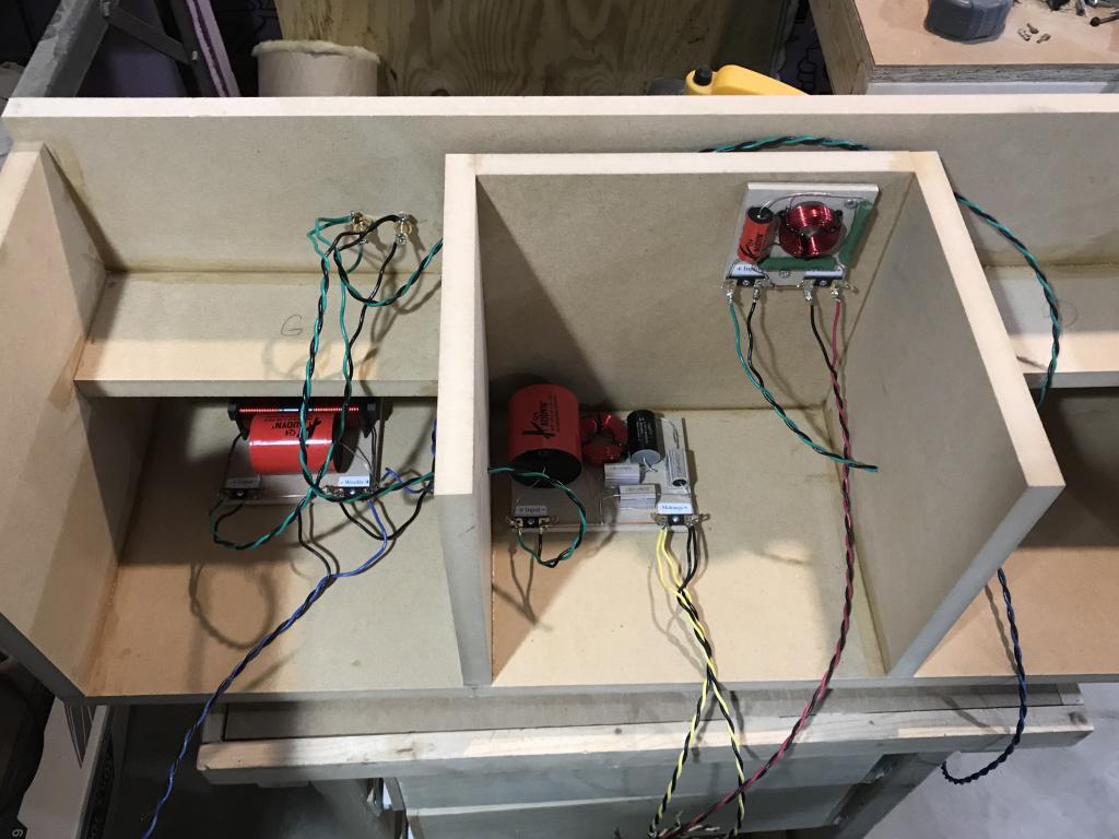

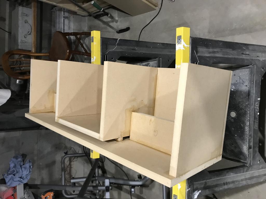

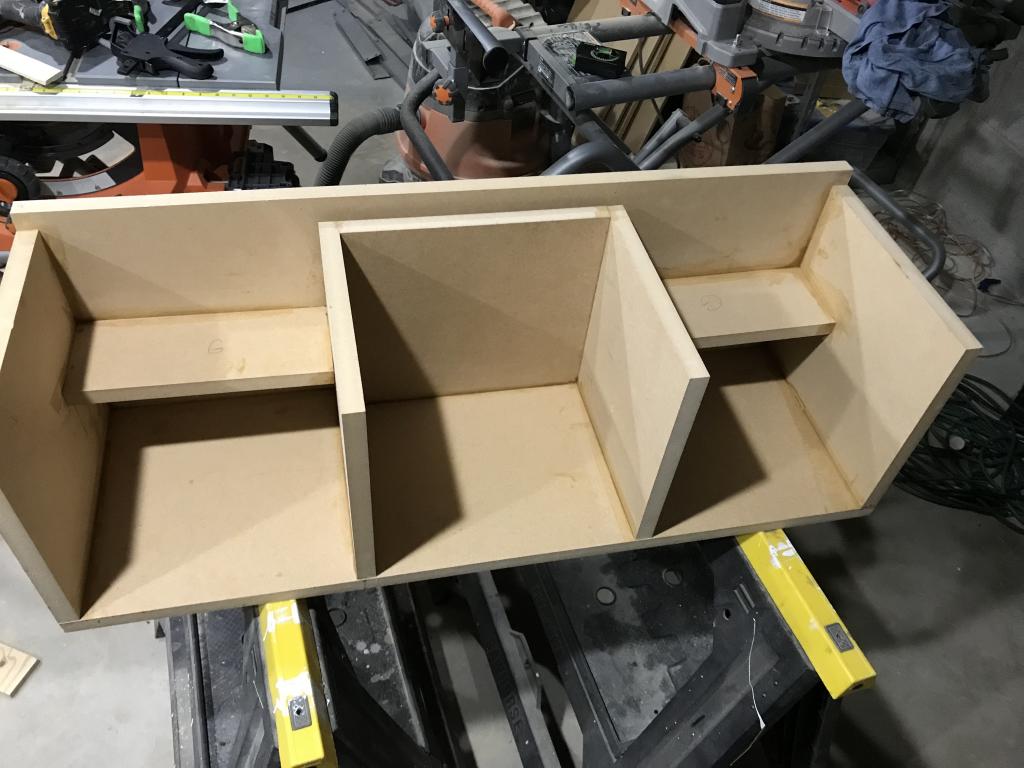

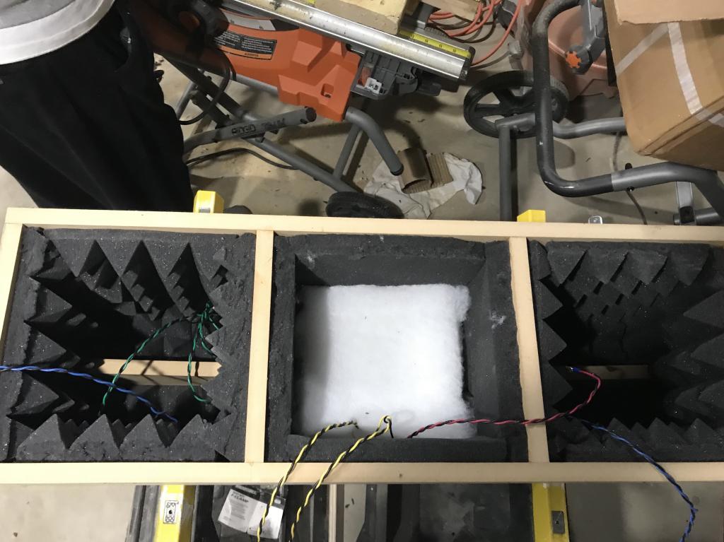

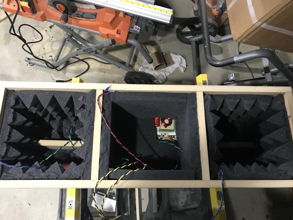

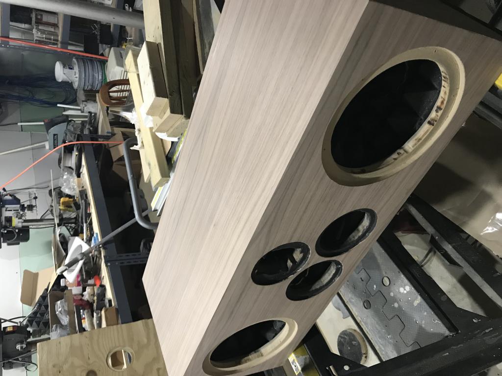

    Anyway, I decided to start with the Statement 2 center for cost reasons. Ill post photos and try to keep them in chronological order. Since the center is finished ill list the key points or any stuff i "learned":
    -Courtesy of some other center builds, the box went together pretty easily. The biggest frustration is that I didn't have enough clamps. I have made a point to buy a clamp or two now each time I go to Menards, Home Depot etc.
    -The kit from Meniscus really made things fun and relatively simple. Everything was just as it was described on the delivery sheets and I opted for the pre-assembled crossovers and they arrived beautifully done. Soldering the provided wires was easy thanks to the labelled crossovers

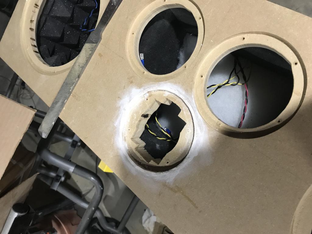

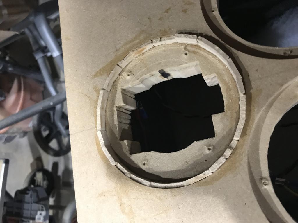

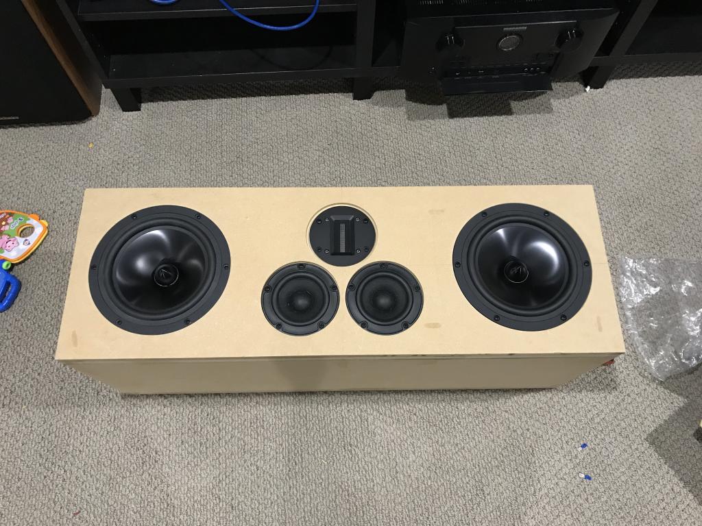

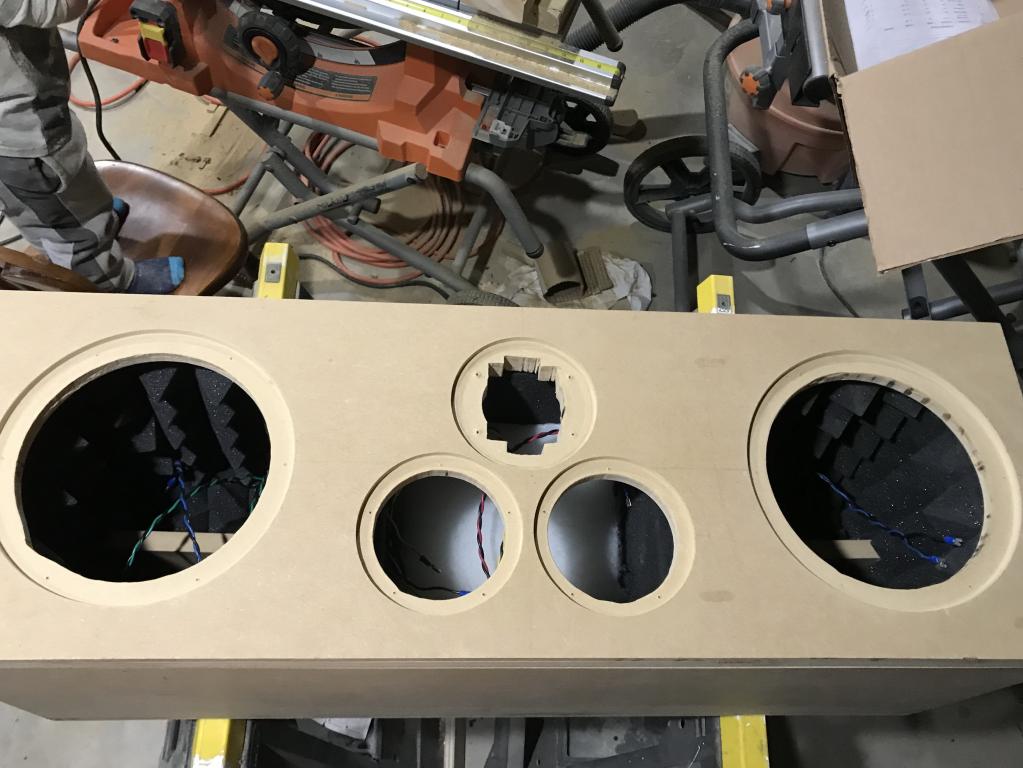

    -I purchased the Jasper cutting guide which made things surprisingly pain free on the routing. I did have to stop and do some math and check my depth for the recesses a few times. I have to say, I probably rushed just a bit and made my recesses too deep. I plan on adding some gasket tape behind the drivers later to make it perfectly flush with veneer. I also have to mention that my last speaker cutout was for the tweeter and I forgot to subtract the difference in bit size since the Jasper jig references a 1/4" bit as has been well documented on this forum. This left a gap around my tweeter which I painfully filled with small leftover MDF and then sanded down and used wood filler to make smooth. Additionally I was just a hair small on my woofer cutouts so they were very tight. I used a file to gradually open these up.

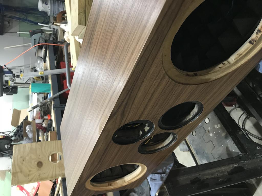

    -Lastly, I finished the cabinet with Walnut veneer sourced on Amazon. It had 3M adhesive but I augmented with wood glue. I used Tung Oil Finish (5 coats) and sanded the last 2 coats with 600 grit. I also used 2x Flat Black paint for the back baffle with tung oil finish on that as well.

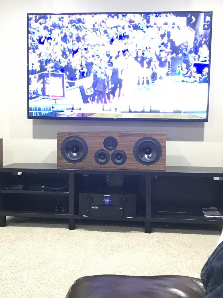

    Overall I am extremely pleased with how it came out. There are some imperfections but not glaring and I learned what to do for the next build. Most importantly, the sound is fantastic. I know almost anything would be better than what I had as a center but I am floored by the detail I am hearing and can't wait to round out the system.

    Trying to fix my errors...

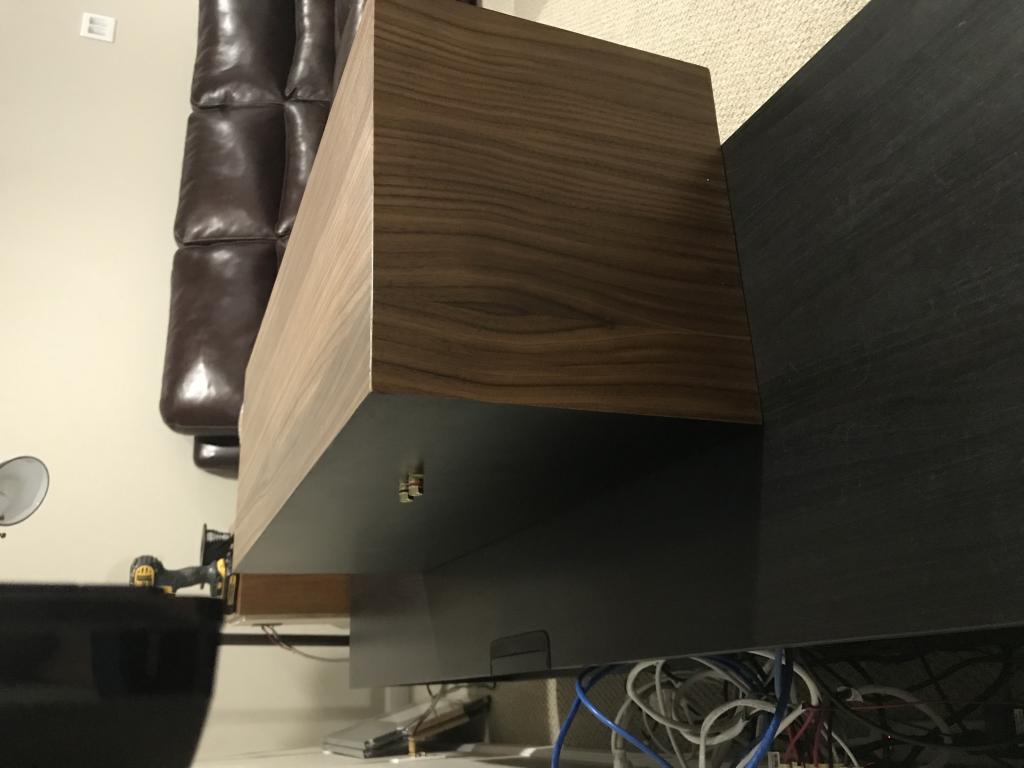

      The Finished Product...By the way, I have no idea why some of these images are rotated if I am missing something when uploading please advise...

        Thanks for sharing. That's a very nice build!
        As you now have experienced, there is truth in the old saying "you can never have to many clamps"
        Nice job correcting the cutout problems. A good woodworker is not recognized by the mistakes he does not make, but how he corrects the one he does make!
        The next time you may want to try to cut some really thin stripes (1-2 mm) of MDF and just glue it I onto the cutout in several layers until the hole has the right diameter.
        You may also use strips of veneer.
        • jesteele79
          • Mar 2018
          • 5
          TEK, Great Idea!! I tried bendind the MDF I had and it snapped into smaller pieces so I just used it and sanded, but cutting the smaller strips or veneer would be great. Hopefully I won't make the same mistake but Ill know what to try next time.

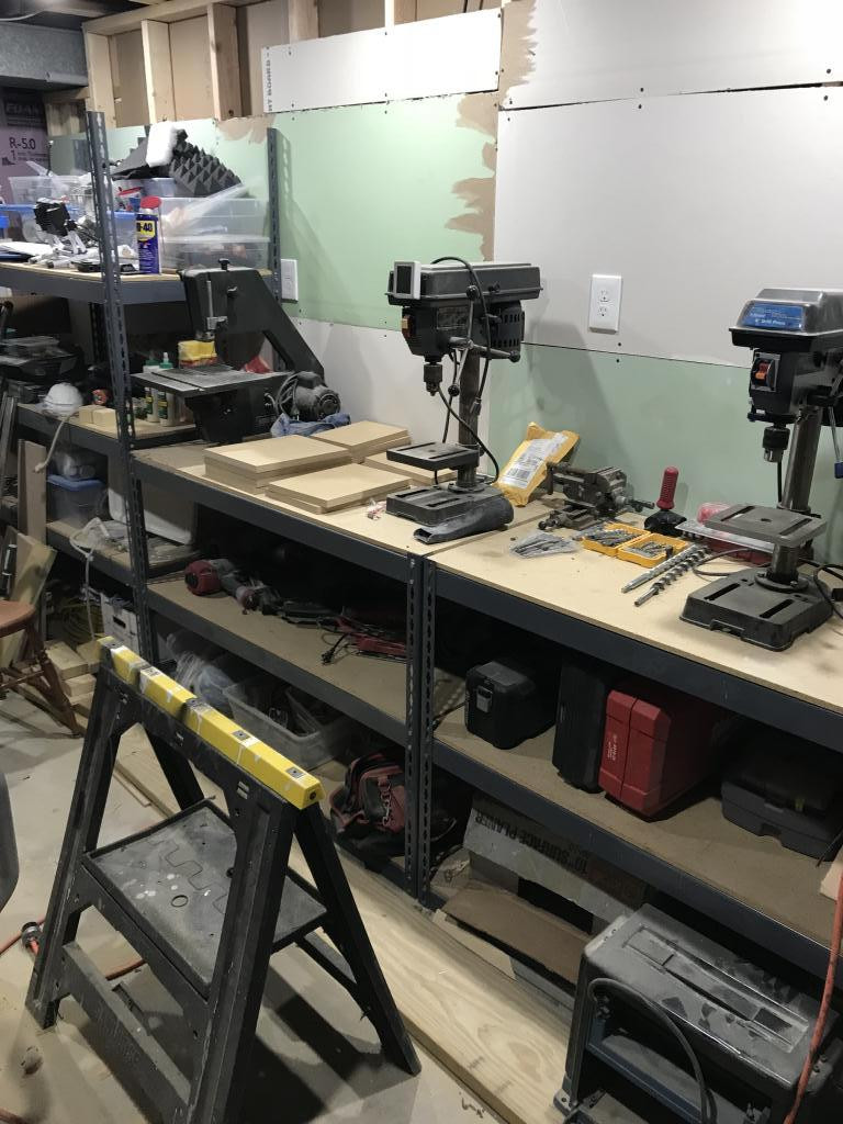

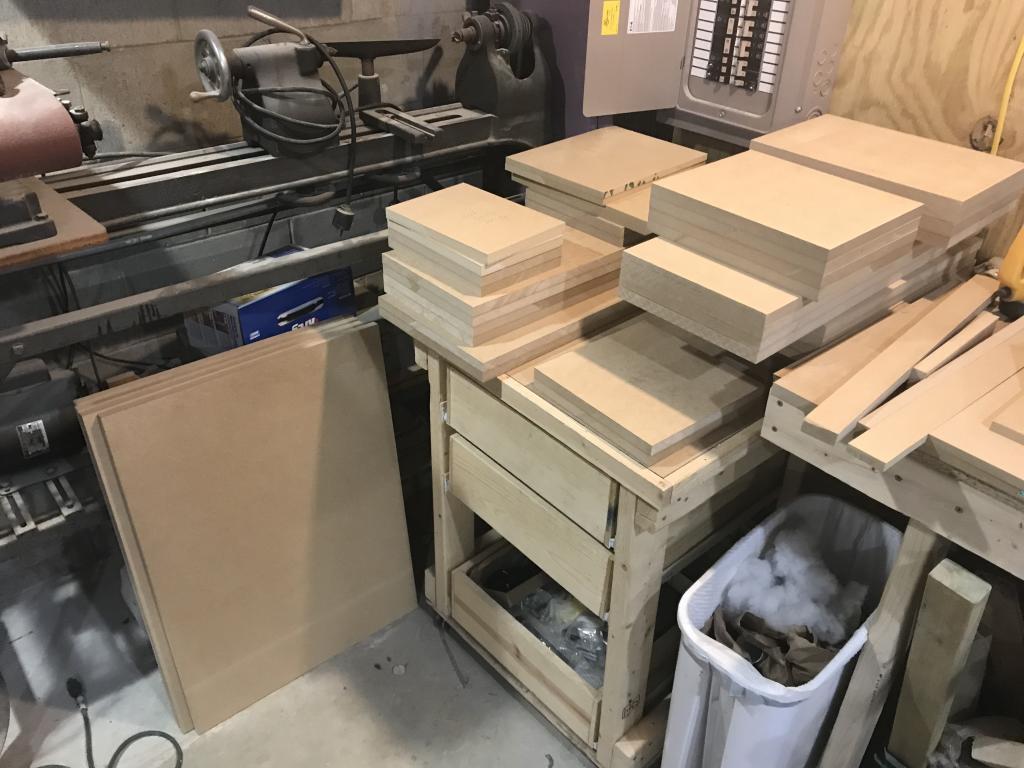

            Cuts made for Micro Statements and Bordeaux
            FYI still don't know why images rotate but you can see the cutout boards. Good table saw and mitre saw are invaluable!
