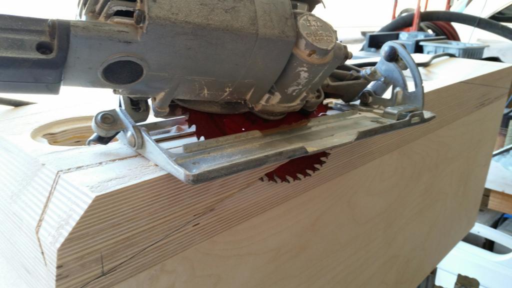

I probably should have made it more obvious that I didn’t use plywood. My baffles are 4 layers of strip laminated “boards” so took to planing pretty well. I could see how the cross grain parts of ply would require a super shallow cut to plane smoothly. Your saw looks a lot more stable than my cheapo. My baffles weigh nearly as much as my saw.- Bottom
Thanks Bob, but now you tell me, :W no wonder your method works so well, Actually Bob, the power planer does a pretty good job on the lbl, it was more of the hand planes with the final cleanup that I had an issue, which is not the time for that to happen. Now planning the ends of the baffles I had no problem it left a very smooth finish.Nice work, Steve.
I probably should have made it more obvious that I didnāt use plywood. My baffles are 4 layers of strip laminated āboardsā so took to planing pretty well. I could see how the cross grain parts of ply would require a super shallow cut to plane smoothly. Your saw looks a lot more stable than my cheapo. My baffles weigh nearly as much as my saw.
As for the saw, it's heavily modified ..... I'm dreaming of a nice cabinet saw one of these days.- Bottom

Steve (troublemaker) nice try with the hand planes pictured, wanting us to think you did all the bevels by hand. (jk) Bob's method is much safer and faster than by hand.
Although there is more than one way to skin a cat.

Trouble maker ..... what's that saying about a black pot? Anyway, if it had been actually hardwood I might have given it a try. :W So is that one of those first generation portable table saws? That thing is a beast!Late to your Party Horio, Apologizes.

Can't say I've ever seen anything quite like that saw! But then I don't get out all that much...
