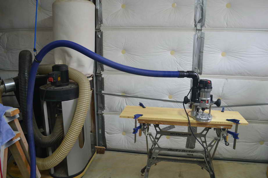

        I really do like the boom arm. It's a bit expensive for what it is, but it really does keep the hose and cord out of the way. I was always getting caught on things before I bought the boom arm.
          • 2141

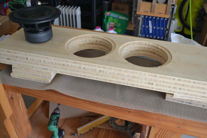

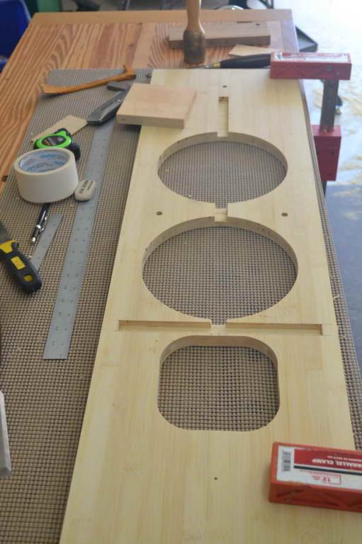

          Making some progress on the many holes that need to be cut ......
          My cheap version of Horio's boom arm ... made a big difference not having to pull chips and sawdust out of the cuts.

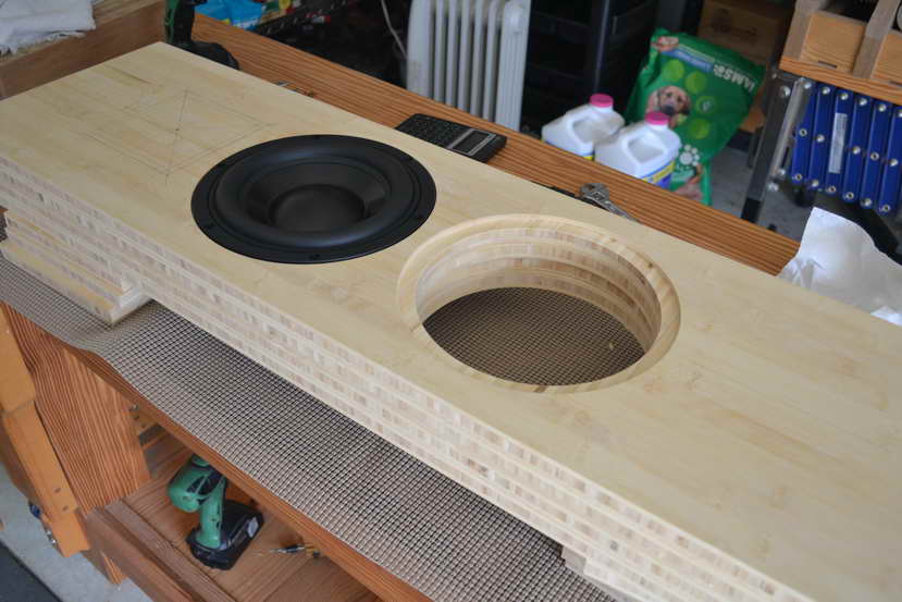

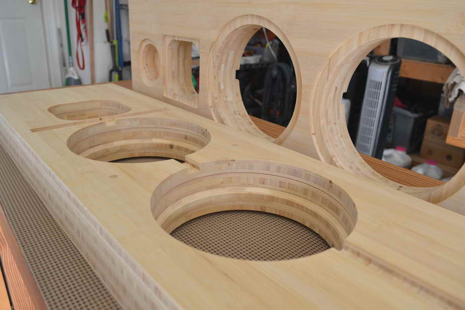

          Test fit looks good .....
          Woofer holes done.

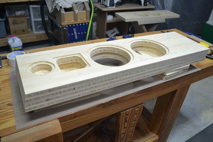

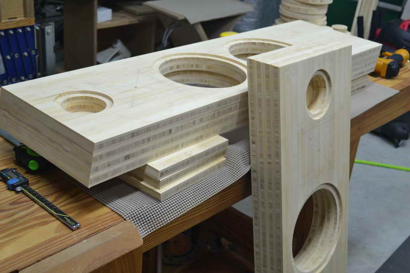

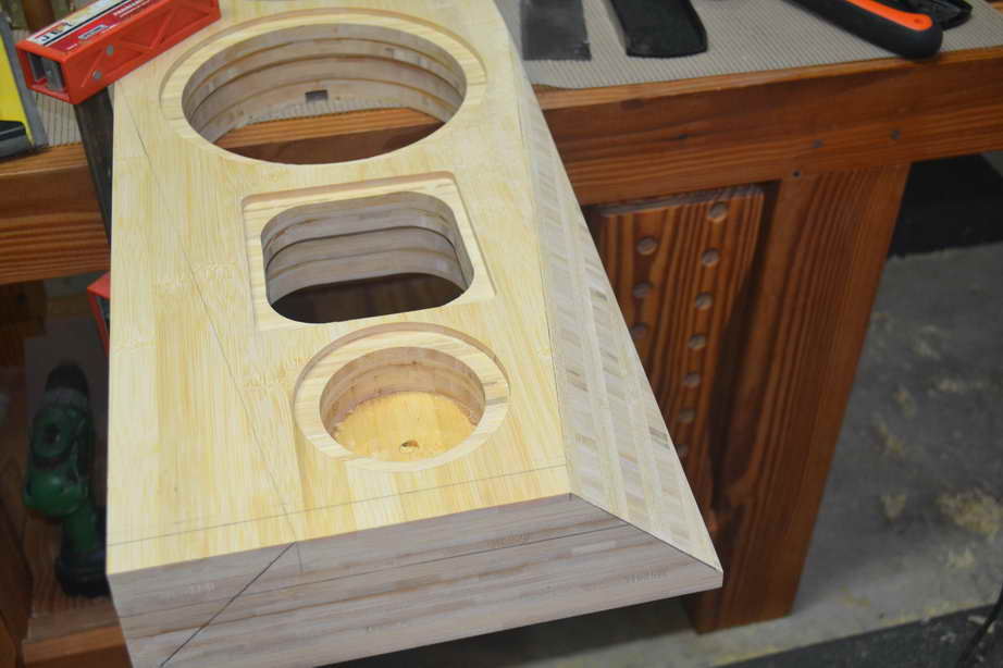

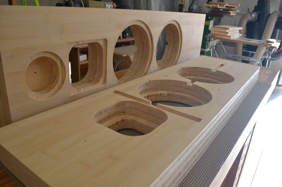

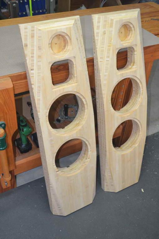

                  So many layers .....
                  So many layers, so many holes. Only a few more to go though.
                    Very nice Steve! You made it through that tough mid cut!
                    Take lots of pics on your facet cuts please.8O

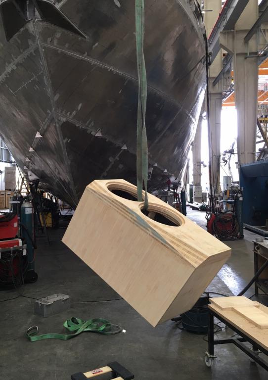

                      Having "dabbled" in a bit of bamboo ply, I'm guessing lifting that baffle stack is hernia-inducing. 8O
                      • meb46
                        • Jul 2010
                        • 398
                        Ha... now thats a true statement "hernia-inducing"... Bamboo is heavy stuff, but its seriously good on Speaker Cabinets and pretty good to work with. No substiture for over head crane though...

                        • meb46
                          • Jul 2010
                          • 398
                          And just in case anyone asks... yep, 36m Ferry/Yacht behind it. Now proudly finished and delivered to a Client in New Caledonia...

                            Thanks Darrell .... I had to make three router templates just for the mid range cutout. I have a driver flange coming from Madisound just to make sure everything fits as it should. Amazing that a square hole is so much more work than a round one. 8O
                              • 2141
                              The one good thing though .... the more holes I cut the lighter it gets. :W

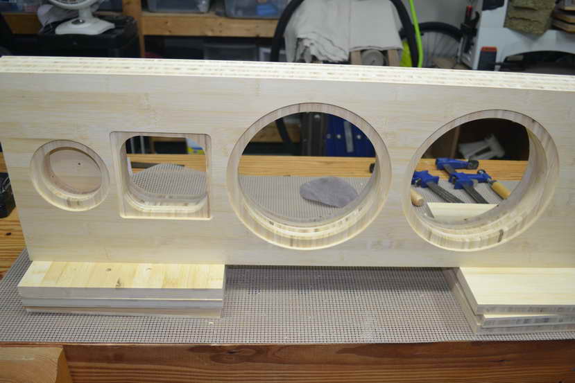

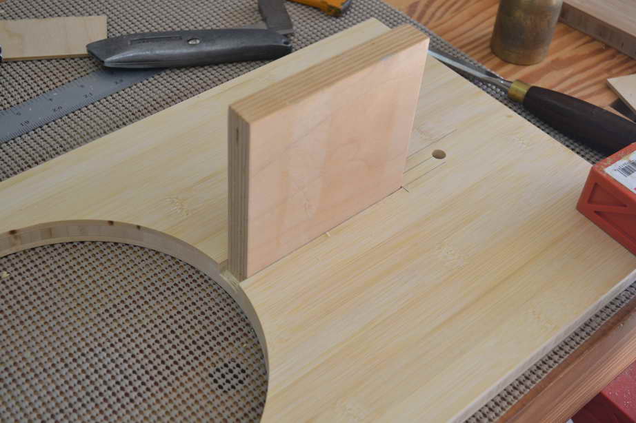

                                          Fun with dados was on today's agenda ....
                                          Test fit with some BB ...

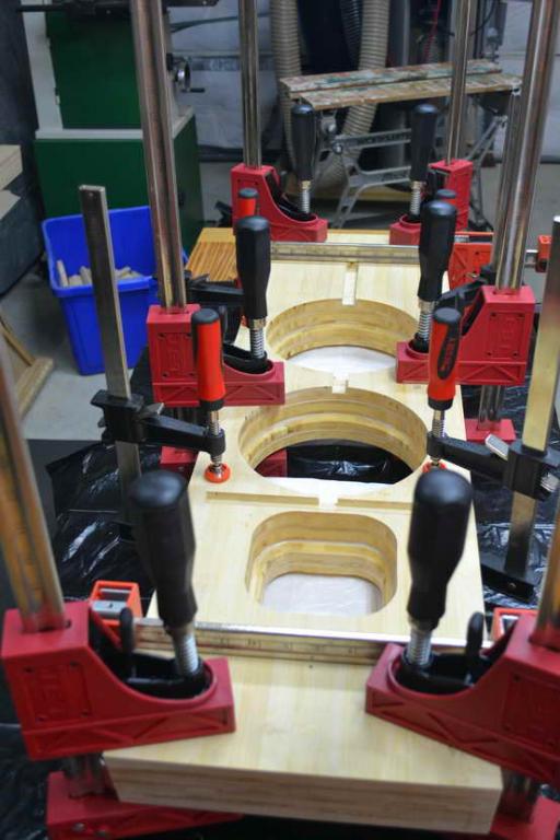

                                          All the routing finally done and getting ready for glue up.
                                            Nice, who needs CNC when you have a Steve.:W
                                            Although I was quite proud of how we tweaked that dado in between the mid and woof on the model, :B
                                            I got to build something again this summer, I'm getting the itch again but this is fun watching you two have at it.

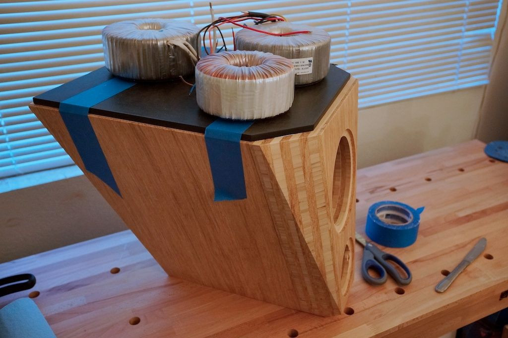

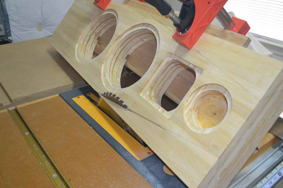

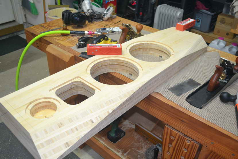

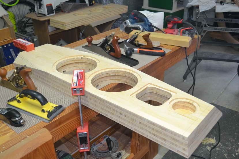

                                                              Decided to give Bob's method a whirl for cutting the facets. Not the fastest method but it gets the job done.
                                                                You forgot to mention, patience and care! A thing of beauty your not going to want to give them up Steve.

                                                                  Looking sweet! How does the bamboo hold up with the hand planes? Any tearout issues?
                                                                    • 2141

                                                                      • 2141
                                                                      Not too bad initially, though the lbl takes the edge off pretty quickly so some tear out starts popping up, it's a fine line to walk when you get close to the end because the last thing you need is tear out on the last pass. I'm going to do some sharpening tomorrow morning and see how that does. The bulk of it is done with a power planer though .... I'd be there all day if not. 8O
                                                                        Yeah, love seeing those facets popping up.
                                                                        I did mine with a track saw, finishing the last bit with a japaneese saw. I did however miscalculate so thar I made them 55 degrees instead of 45. Thus, mine are a bit more «dramatic» then the original design.
                                                                          Bob's method is to use a power plane - goes MUCH faster.

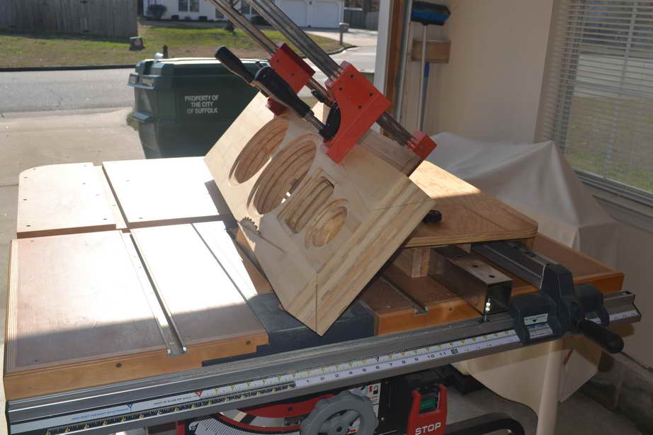

                                                                                          • 2141

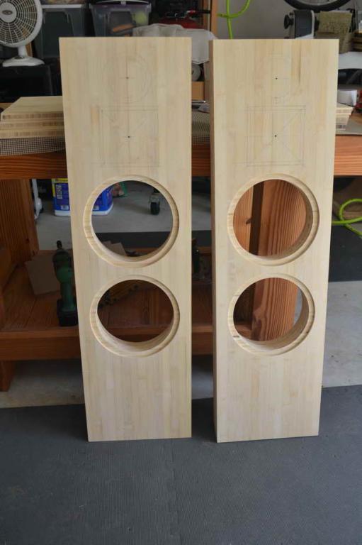

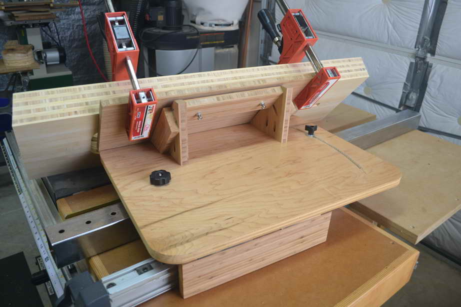

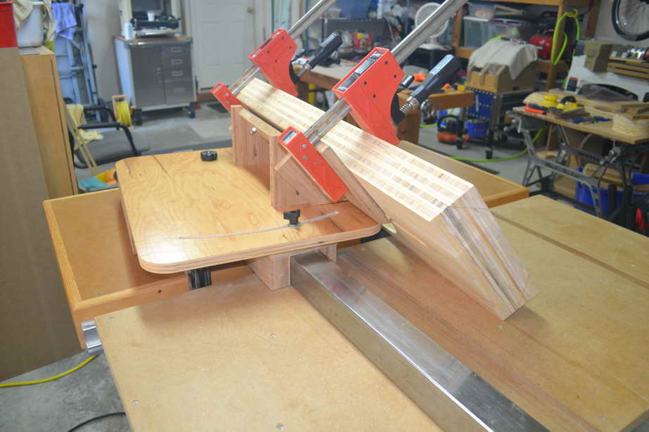

                                                                                          Well sharpening the tools helped some with the tear out issues, though not completely, plywood does not do well being planed. Now since these are going to be painted that's not a big deal, the tear out can be filled, if you want to leave them natural that's another story.
                                                                                          So I went ahead and made a sled for the table saw to accommodate that exercise. Darrell, I can see where that 14" sliding saw worked out so nicely for you and Ben! None the less things worked pretty well for my old 10" Craftsman. It took me a couple of revisions to get it to work as I wanted, but it gives me 3 axis to adjust the setup which came in handy.
                                                                                          And we now have two finished baffles ....
