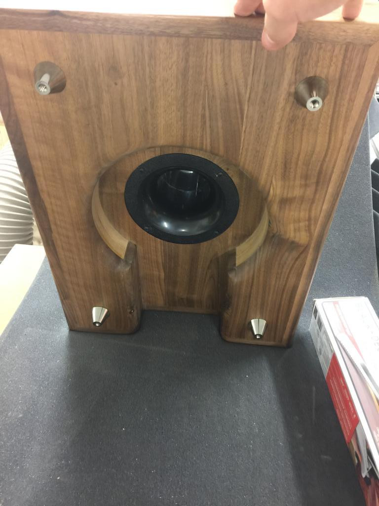

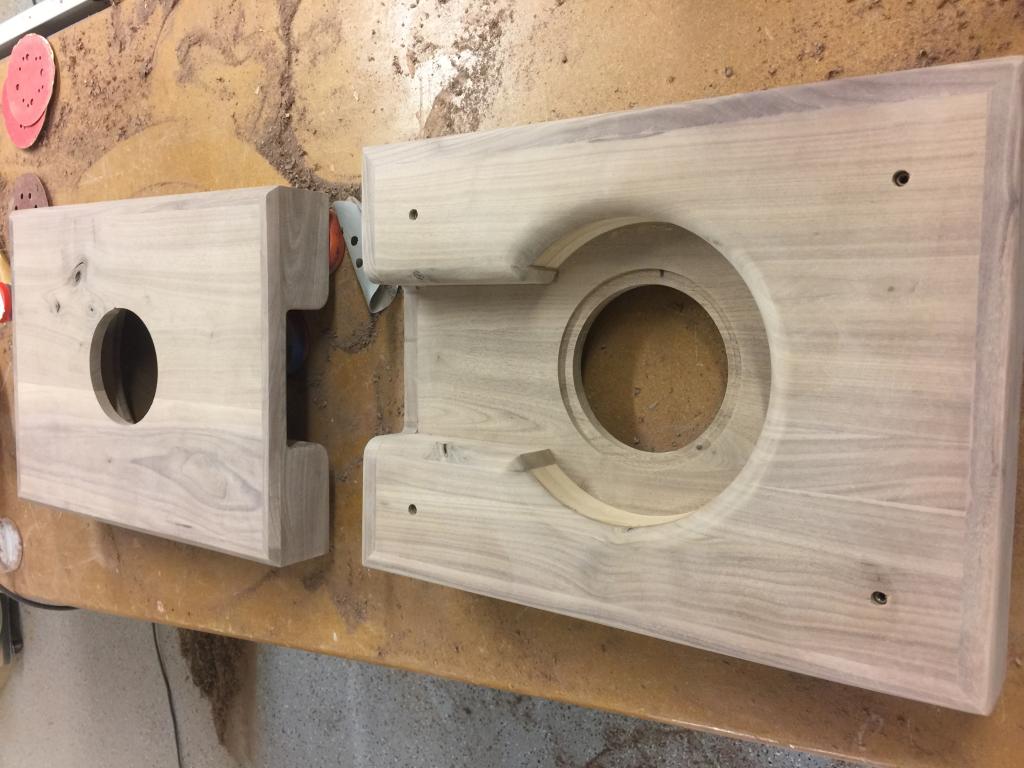

      I was wondering I've seen very few pictures of the stands from others builds so the plans have the bottom 3 boards with a 9 inch circle cutout I've seen a couple that have the back portion of the stand cutout to allow more airflow is that necassary or just a good idea?
        Originally posted by sleeper0404
        Thank you Jim
        The cutout in the back of the base was something we added just to be certain there was adequate air flow to the port. I'd recommend it.
        They can also be rear ported too if you prefer.

              Check out my thread, I just posted some shots of the bases. With 2" speaker spikes, the bases are less than 1/4" off the carpet, so the opening in the back definitely helps!

                  Thanks for the pics Pknaz. I was following youre thread you did some good detail. the pics of the bases was exactly what I was looking for.

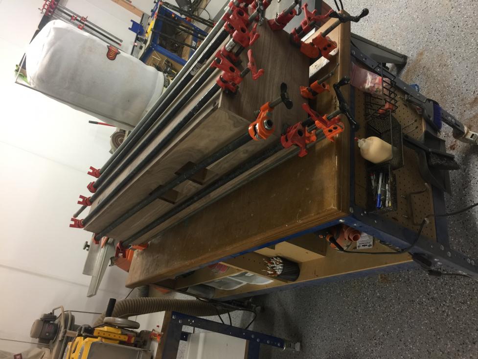

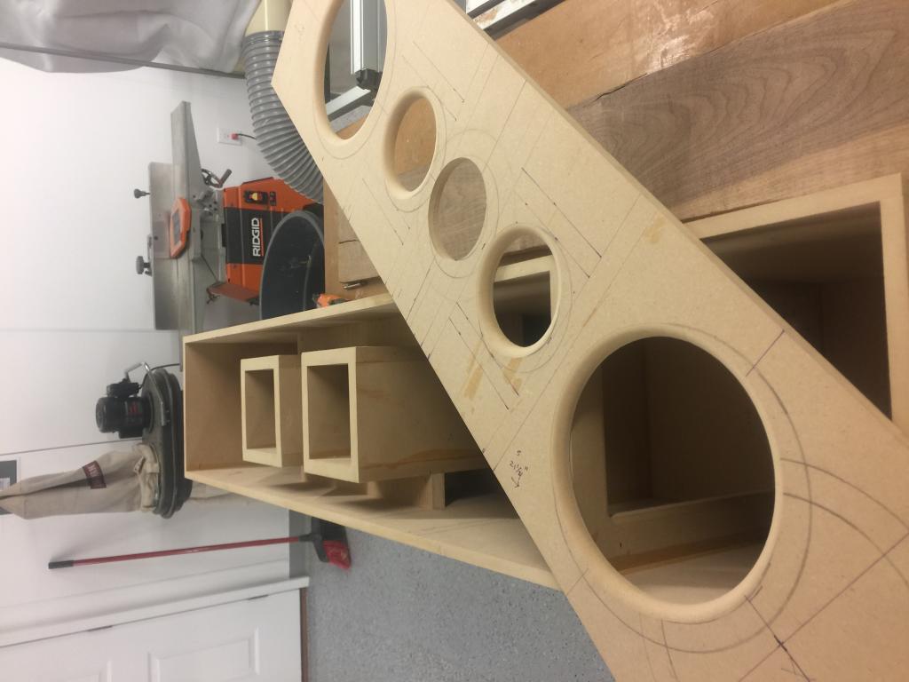

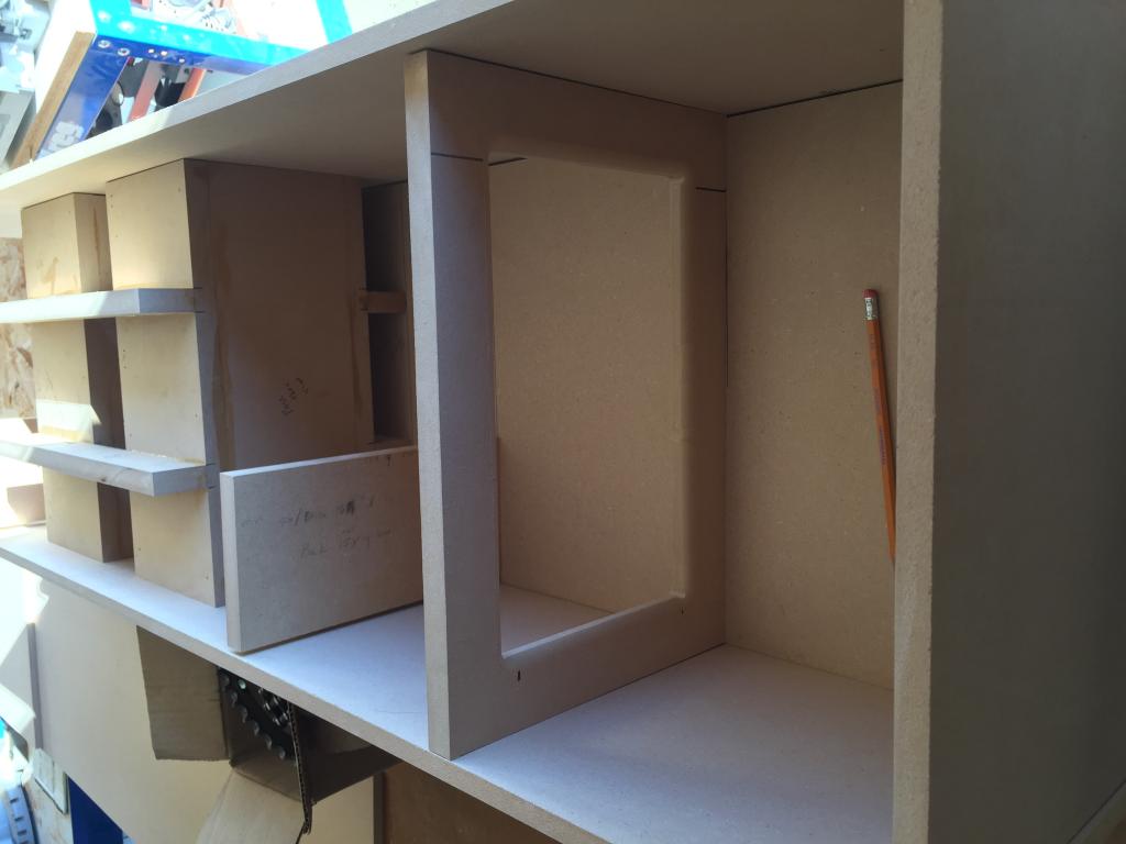

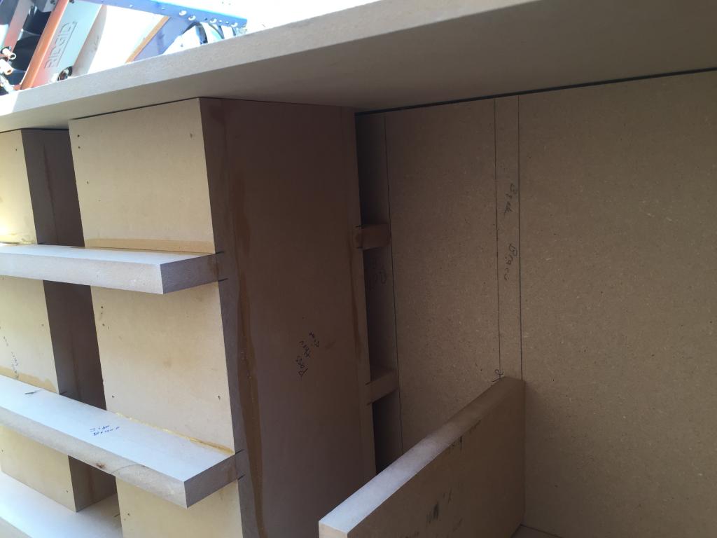

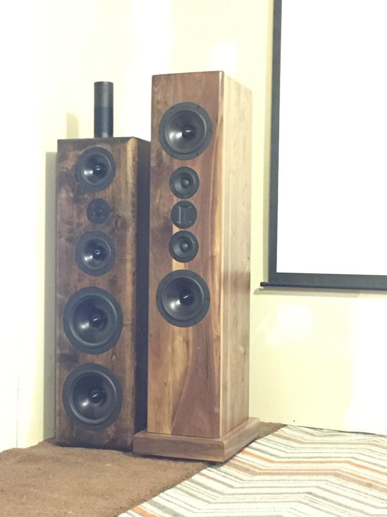

                    Pictures of statements
                    here are some pictures of the project. hopefully I've attached these properly... my build is a little differently assembled then most I made the box 1/2 inch MDF all around with 1/2 planed walnut outside of the MDF the internal dimensions are still the same.
                    Click image for larger versionName:	IMG_2891.jpgViews:	1Size:	52.4 KBID:	862489
                    Click image for larger version  Name:	IMG_2892.jpg Views:	1 Size:	50.8 KB ID:	862490Click image for larger version  Name:	IMG_2942.jpg Views:	1 Size:	68.5 KB ID:	862491Click image for larger version  Name:	IMG_2944.jpg Views:	1 Size:	81.7 KB ID:	862492Click image for larger version  Name:	IMG_3018.jpg Views:	1 Size:	102.6 KB ID:	862493

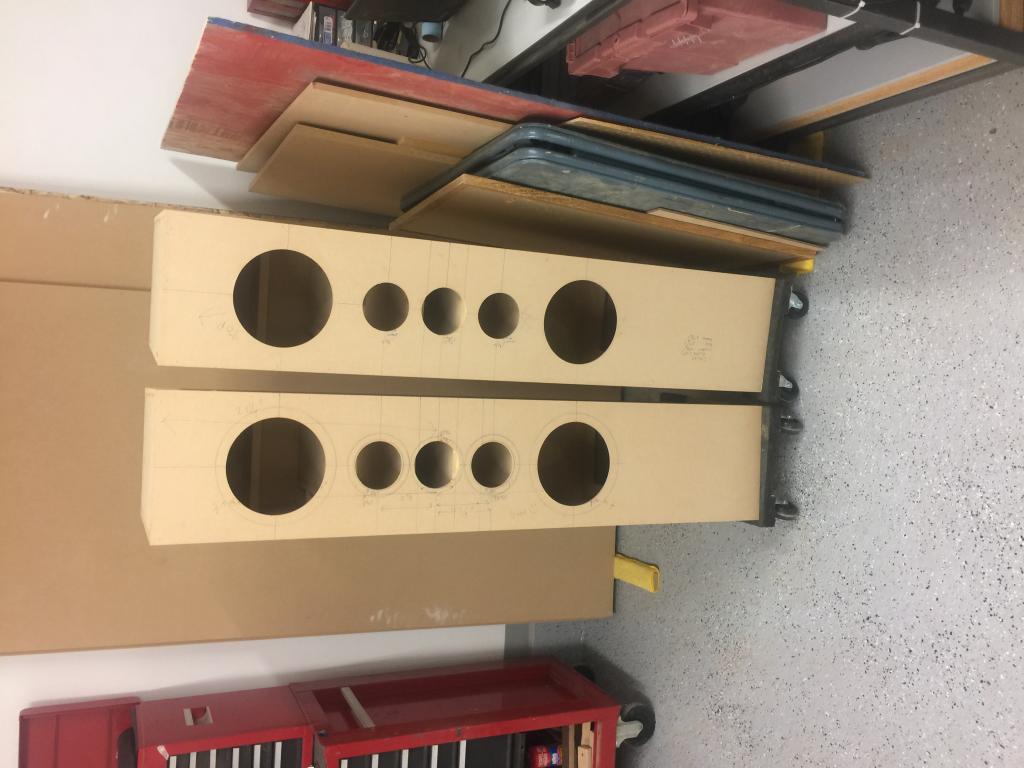

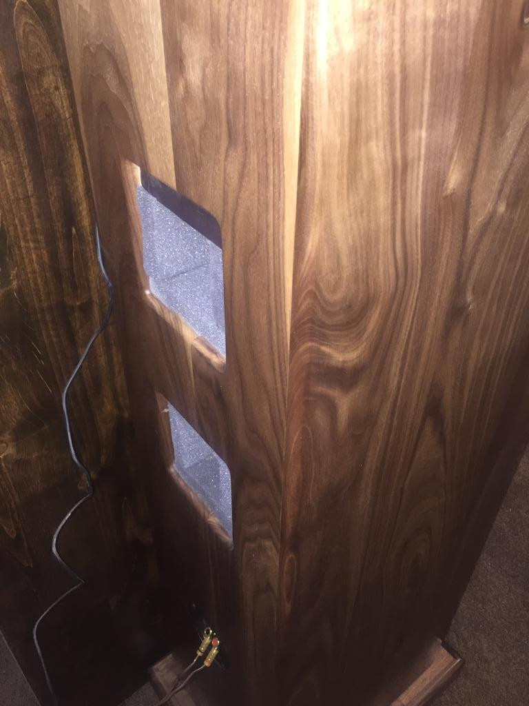

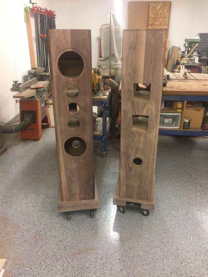

                      here are a couple more:
                      Click image for larger versionName:	IMG_3025.jpgViews:	1Size:	92.1 KBID:	862494
                      Last edited by theSven; 30 April 2023, 15:30 Sunday. Reason: Update image size and rotation

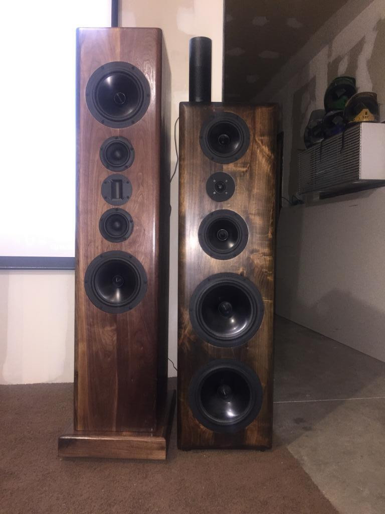

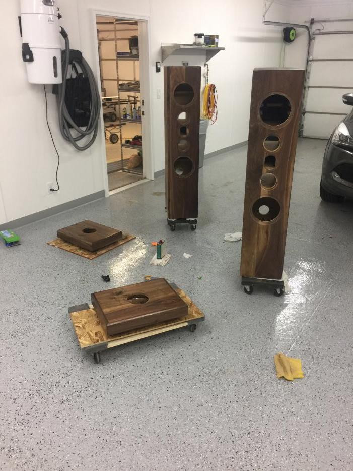

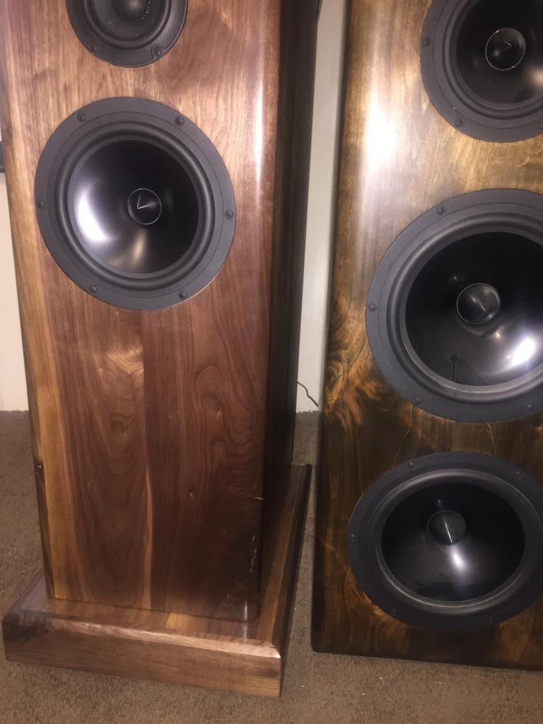

                        Additional images to share.
                        Last edited by theSven; 30 April 2023, 15:31 Sunday. Reason: Update image size and rotation
                          Very, very pretty! Great job! :T
                          Are they making music yet?

                            Thanks Jim. I failed at trying to upload pictures during the process. They sure are making music they sound great I am very happy with them. Thanks for all you're Help on mine and everyone elses build threads. everyone is very helpful on this site.
                              Excellent! I'm really pleased you're enjoying them.

                                Wow, they look great! Love the walnut. Congrats!
                                  Holy grap, those are cool!
                                  In my neck of the woods actual walnut is very expensive wood. I would love to do something like what you have done.
                                  I can only think about how it feels running your hands over those.
                                  I know that walnut is not the same cost everywhere.
                                  Saw one who build a wokbench out of it because it was cheepmand easy to get hold of...
                                  A have to say that I'm a bit consern for you regarding wood movements and cracks.
                                  Really hope that will not be an issue for you.

                                    Wow, those are awesome, love the walnut!

                                      thanks TEK and Pknaz!
                                      I have been concerned about the issues with the wood as well. I've changed my process through out different projects I've had good luck with the way I made the statements and the previous 2 projects. I have had issues with some aviatrix speakers I made a few years ago out of cherry. the baffle has cracked a bit.... what a shame. but anyway I'll keep my fingers crossed..

                                        They look really great!!!
