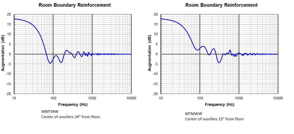

            My curiosity got to me, so I tried to quickly modeled it. And I'm not sure if I modeled the dual woofers entirely correct... I used my Khanspire since I have those dimensions. First model is the boundry gain with the assumed center of at the tweeter, which is midpoint. The second is the center of the driver between the woofers in a WWMTM configuration. (I used 15" which is directly below the woofer in my Khans, but it looks like Deewan might have pushed it up a little higher). The model - if I did the dual woofers correctly, shows some big differences around 80 - 100 hz. But again, with as much as the room effect is at these frequencies, can you really hear it? or would it be enjoyable? (Deewan was waxing on and on about the bass. Maybe now we know why. ) Other notes, if you want to try and reproduce, I used 3' from the back wall and 5' from the side wall.
                                          [ATTACH=CONFIG]26814[/ATTACH]

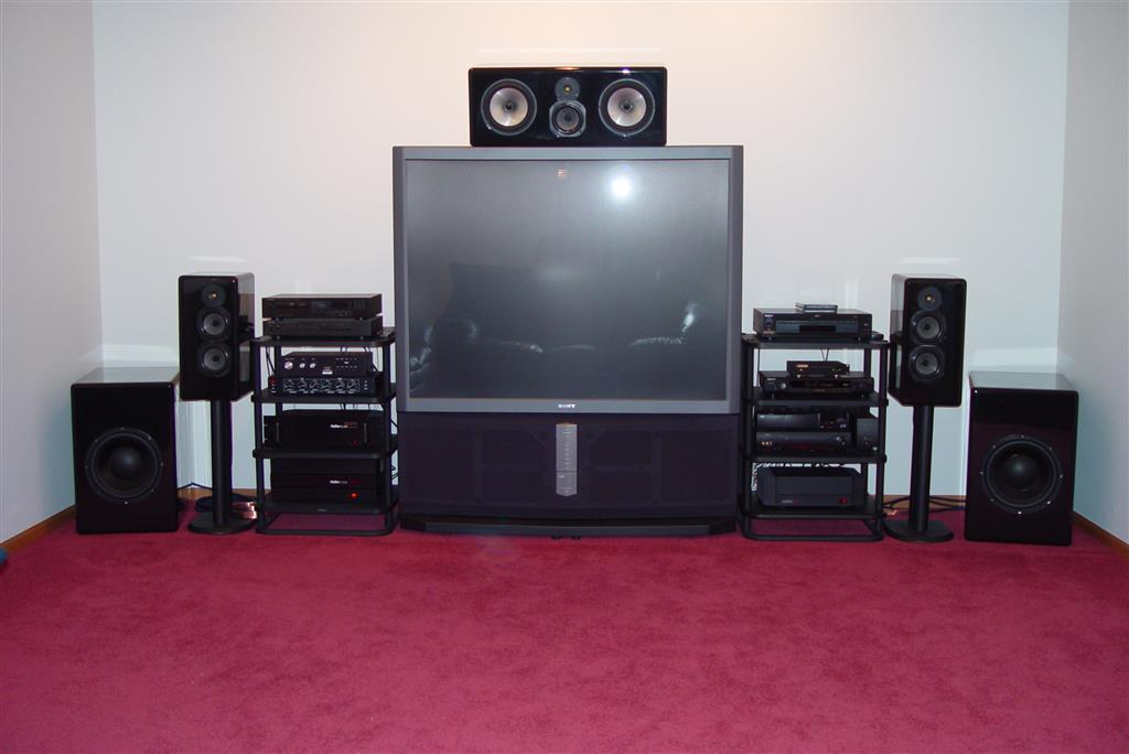

                                          What type of veneer (I guess it's a sub) in the center of your picture finished with? I have two large subs I've yet to finish. I don't think I'm going to go the automotive route with those so I'm always looking for options.
                                            Originally posted by Jblack1
                                            Hey Jim, just curious. Do you happen to have a picture available of the speakers you finished with automotive paint?
                                            Wow! This was from many years ago. One of my son's was a bodyman at that point in his life and he painted the subs, monitors and center for me in automotive gloss black.
                                            I think I burned him out. He moved to California and switched careers. :E He did beautiful work! They were flawless.

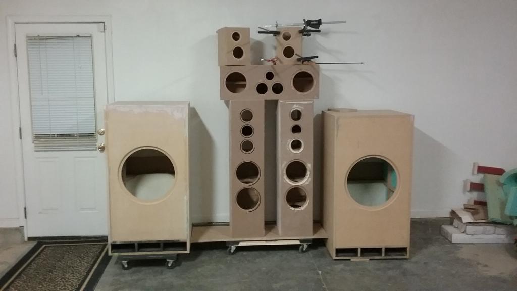

                                                                                    After 3 months of on and off work on my build I thought I would drop by with some observations of a first time builder along with some additional questions I have.
                                                                                    1) The dust. Holy sh!t the dust. This is not my first time cutting wood but is my first time with MDF. I severely underestimated the mess that this would create in my garage. If I had to do it all over again I would either use Baltic Birch or most likely have the cuts CNC'd and I would perform the final assembly myself.
                                                                                    2) The dust. See above. I planned on taking pictures of my entire build but on day 3 I tossed my blue jeans into the washing machine without realizing my phone was still in my pocket. Womp womp ops: Speakers 1, Jblack1 0. That was the last time I took my phone out while cutting the wood.
                                                                                    3) Router - probably my favorite tool I've used during the build. However, somehow I got way off while cutting the recess for my baffle in my second tower (right tower in the picture). The depth seems OK but there is a fairly large gap on the sides when I put the speaker in place. Does anyone have any insight on how to correct this? Re-cutting is not an option as my better half has deemed it's time for the project to come to an end. It is what it is but I would like the speaker to fit a bit more snug if the is anything I could do. Gasket tape perhaps?
                                                                                    4) Micro Statements - I went ahead and built the micro Statements for surrounds but probably won't get around to getting the parts until later this year. A couple things I noticed:
                                                                                    A) I seem to have much more space between my speakers than Curt's picture show on his website. My box also appears to be bigger. Not sure why.
                                                                                    B) Does anyone know if the walls need to be lined with foam?
                                                                                    C) Both of my tweeters are offset to the left. Should one of them be offset to the right>?
                                                                                    5) Subs - These things are beasts. To give extra stability we used a brad nailer with about 75 - 100 nails in each enclosure. I still plan on finishing the 5 speakers with automotive paint, and I would like to do the same with the subs, but I don't know how realistic it will be to sand these bad boys down to the smoothness that will be required for auto paint.
                                                                                    All in all I very much enjoyed myself. Now that the weather is turning its time to wrap up. I would say I probably have at least one weekend left of sanding and priming before these are ready to be painted. Multiple weekends if I try to include the subs. I very much appreciate all of the help that has been thrown my way. Now that the dust has been removed from the garage I should be able to start taking additional pictures to share as I move forward.
                                                                                    Thanks for all of the help!

                                                                                          1) "The dust. Holy sh!t the dust. This is not my first time cutting wood but is my first time with MDF. I severly underestimated the mess that this would create in my garage. If I had to do it all over again I would either use Baltic Birch or most likey have the cuts CNC'd and I would perform the final assembly myself."
                                                                                          Yep. MDF = MicroFine Dust Fkingeverywhere! Most of us prefer to use Baltic Birch, dust is one of the many reasons why. MDF used to contain formaldehyde not sure if it does anymore. Always wear a dust mask, preferably a N95 with a purge valve.
                                                                                          2) It was time for a new phone anyway right?
                                                                                          3) Router, always test the hole first on scrap wood. Hindsight I know, but now you do too. Next time will be better. I promise. Buy new baffles, bribe the wife, do it correctly this time, you'll be glad you did. If you don't you'll kick yourself later, after all your hard work and effort only to see your mistake EVERYTIME you look at the speakers. It's not worth the risk. You want to be proud of what you've built and show your friends. Bribe the Wife!
                                                                                          Take the time to set up the vacuum near the router to catch most of the dust, wear a mask.

                                                                                          B: Can't hurt to dampen internal reflections
                                                                                          C: Yes, should be mirror images (see #3)
