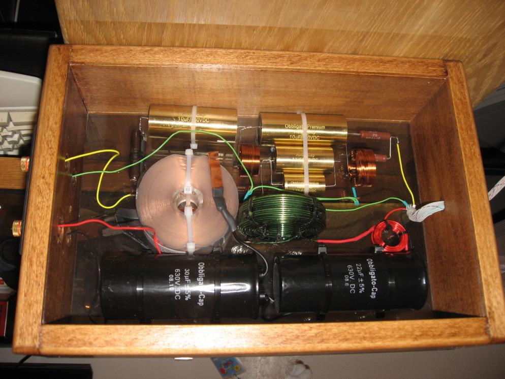

                                                                      Jon you might be able to comment on this idea ....... This is something I did for my Jensen build ...... I used Obbligato caps for the mid-range, saved me ~$700 as I recall over the superior Z caps which needed 110 uF per side. This was suggested by Troels and the reviews I read from Tony Gee with his reviews on those caps. Stayed with the superior Z caps for the tweeter. I have not done a comparison between the two, so I don't know what differences one might hear. Not sure if any one else has used the Obbligatos on here?
                                                                        • 16175
                                                                        I'd never heard of them until your post today, but I can tell it's been a while since I've been on Tony's site, though I have found in the past I pretty much agree with his assessments- OTOH, for a lot of DIY'ers, the whole cap sound thing is just a bridge too far. Unfortunately, beleiving that doesn't make it so...
                                                                        the best news out of checking his site and going back to my Canadian supplier, Parts Connexion, is that they have the new Duelund RS speaker caps- half the price of their old top of the line series, and nearly all the goodness! Who's up for $132 for 2.2uF caps for their Minerva's? Sounds weird, until you think of the fact that this is a $500 midrange-tweeter driver.
                                                                        Now, where does this leave me for the Osiris update?
                                                                        BTW, where did you get the Obligattos?

                                                                            Here you go this is what I used ...... http://www.partsconnexion.com/capaci...igato_oil.html ...... They have a few different flavors http://www.partsconnexion.com/capaci..._obb_main.html

                                                                              Just for a size reference this is from the Jensen post ....... http://www.htguide.com/forum/showthr...ht=jensen+1071
                                                                                • 16175
                                                                                Just for a size reference this is from the Jensen post ....... https://www.htguide.com/forum/showth...ht=jensen+1071
                                                                                Yeah, some of those ultra compact film and oil capacitors! We considered those for the next Macbook... Nahhhh!

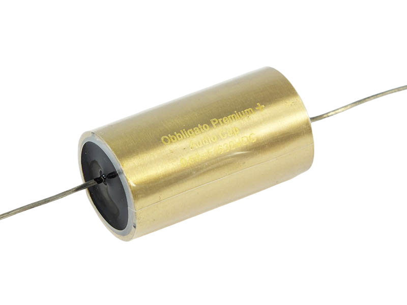

                                                                                      The ones I used were the 22 uF - OBLIG-74480. Looks like they have gone up a few bucks since I got them and even if you went with the Gold version, that's about a third of what a z-cap will run you. Don't know if it's worth looking at or not ..... money wise, I'd say yes, sound wise ........
                                                                                        • 16175
                                                                                        Well, something rated a 10 or 10- is definitely better than a 6! It really comes down to figuring out the values and what not- might be a solid backup recommendation, too. Thanks for bringing this to our attention.
                                                                                          • 2140
                                                                                          Your welcome ..... might be worth picking up a few for evaluation next time you order from them?

                                                                                            Back to caps. I've used Obbligatos for a LOOOOONG time, back when no one heard of them and the only place to buy them was Hong Kong.
                                                                                            My take on the ones I've used;
                                                                                            The Gold ones, film and foil are excellent, a tad rolled off on the top but it keeps the shouty ear bite on poor recordings to almost zero. Great for voices and wooden instruments. Pianos are not excellent, but sound good, the note "Hang time" is less robust. Overall they are 8+ out of 10. Value wise easy 9 out of 10.
                                                                                            Note here, a 10 would be the ClarityCap MR.
                                                                                            The copper ones are the next best, not as quick or as clear and true to the tonal resonance of violins or female voices. Their Meh, just OK. 7- out of 10
                                                                                            Big jumbo soda can size black oil capacitors are for Large size capacitance and should only be used in woofer circuits. For the uF per $$$ you can't beat them.
                                                                                            They sound lifeless and flat for mids and treble, for woofers they perform well and a cello sounds like a cello, base drums sound full. You can buy better caps, but the price is good and they sound fine.
                                                                                            I really like the old Russian caps, some of them sound excellent and can be made to sound even better. But that is another story.
