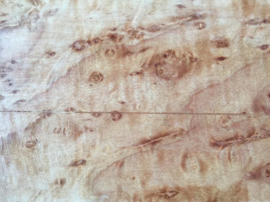

      I will find out shortly how differently the veneer takes the finish. I need some Goo Gone to try to remove the adhesive, sand the sample a bit and then I will brush on a bit of GF gloss. If it's an issue, I will apply another very thin coat of epoxy to seal. Easier and safer than trying to sand it off without going through the veneer, especially since it seems to be inconsistent bleed through.
      It's surprising how much redder the wood is than the photograph.
      EDIT: Here's the result with a single brushed coat of GF Gloss, light sanding with 100 grit that was on the sander to level the epoxy bleed through and I can't tell where the epoxy dry spots were. As the surface dries the blue tape residue becomes visible.
      Why do some pictures taken in portrait get rotated to landscape?
      RE-EDIT: OK, now the epoxy dry spots are visible. Guess it requires a skim coat of epoxy.

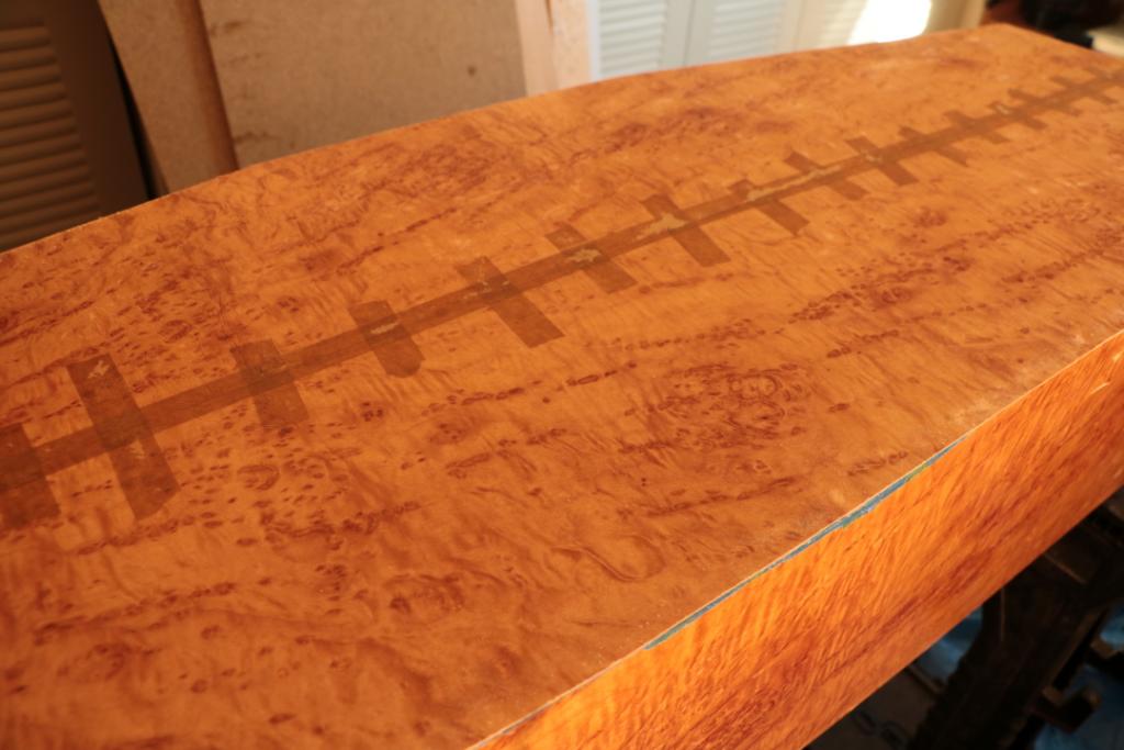

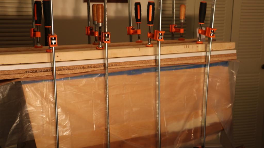

                            A couple of weeks delay due to a wedding, visiting Dad and a cold making me fuzzy, but finally some progress today. I'm pretty sure of my process, but still find I'm second guessing myself. I could have done this yesterday but didn't. I ensured that the veneer was completely dry before layup, although it still had some waviness. My big idea born of wondering how to avoid sanding through previous veneers: I added plastic around the sides not being glued to avoid having to sand the squeeze out.
                            I probably overdid the epoxy, but I don't want to have dry spots again. I placed the veneer on the back after applying epoxy to it and the back. Laid the plastic sheet over the veneer and used my veneer glue roller to spread out the epoxy before applying the cauls. Three layers of 5/8" particle board and a couple of 2x4s clamped with 8 Jorgenson HD bar clamps. I tightened from the center to the top and bottm and they've all got a decent bend. Should be a decent amount of fairly well distributed clamping pressure. I'm getting a fair amount of squeeze out rather evenly distributed. Hopefully that means the veneer is sitting flat against the cabinet. We'll see tomorrow morning. Room temperature is 78°F thanks to 1,000 W of halogen shop light. Another week delay coming up, as I'm heading to see my granddaughter to celebrate her first birthday.
                            Proof of progress.

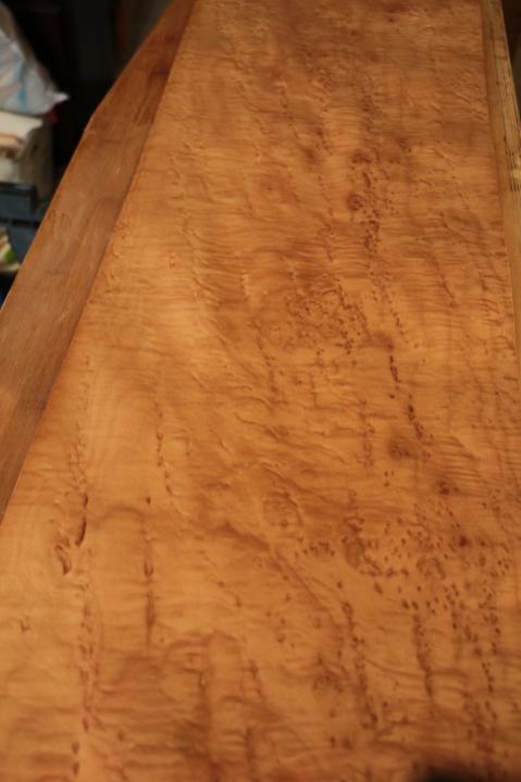

                                    Success! Now I can relax while visiting my granddaughter. Enough epoxy bled through the veneer that I won't need to spray the finish until the weather gets warmer again. Although that could mean they never get sprayed...

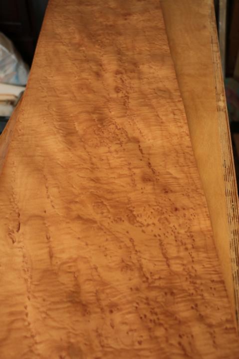

                                                      Style question as I approach the sides. Should I do the bookmatch vertically or parallel to the edges of the cabinets? The veneer has some tiger striping in the short direction. Thoughts?
                                                      Laid out on the cabinet parallel and vertically

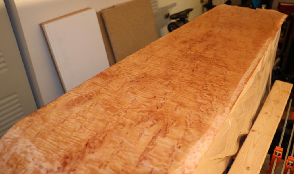

                                                                        My first ever attempt at bookmatching is in the clamps. Although there were a couple spots that wanted to overlap, I think I got them flat before the caul went on. We'll see tomorrow.
                                                                          #126
                                                                          The bookmatch joint feels smooth, is tight for almost it's entire length (I had to look from 6" to see a gap) and the pattern is pleasing. Somewhat expected, the veneer tape absorbed epoxy. So much for being able to leave them in epoxy until the weather warms up. I'm going to have to sand down to the veneer to remove the tape. A bit of color difference between back and side that may just be the lighting.
                                                                          Rough trimmed. Remnants of blue tape used to keep squeeze out from getting on the rest of the cabinet.

                                                                              Thanks, Ron. It's even better than the small picture shows. These are three sequential sheets, so the figure on the side is as good as the back. I'll light better for the mission accomplished pictures.
                                                                              Darned photo-bucket resizes the image, too. I thought I could link to a full resolution picture.
