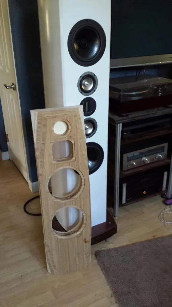

    After opening by big mouth sooner than I probably should have, and some prodding by Benthe8track and Renron this is my Wavecor Ardent build. My original plan was to slowly buy the parts over 2-3 years and then start my build, however that all changed when I got the chance to purchase the extra set of baffles from Benthe8track and Dar47 once I got these I started to accelerate my plans but life being life the completed speakers are probably a good year out, the cabinets though I want to have complete by the end of the year. I'll try and keep this updated as I go, but I'm not as good at taking pictures as I go as I would like.
    Baffles when the arrived:

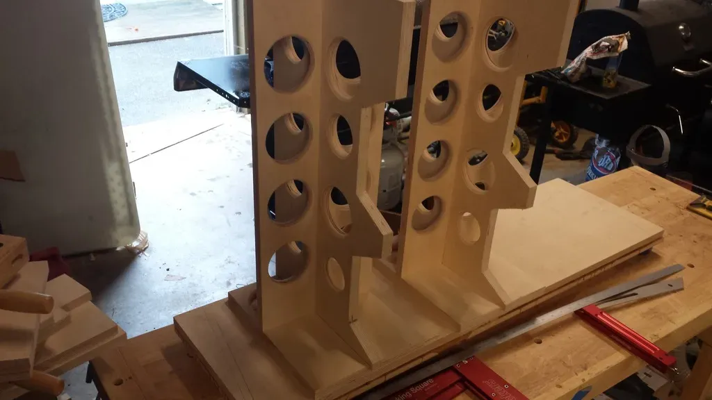

    One brace dry fit:

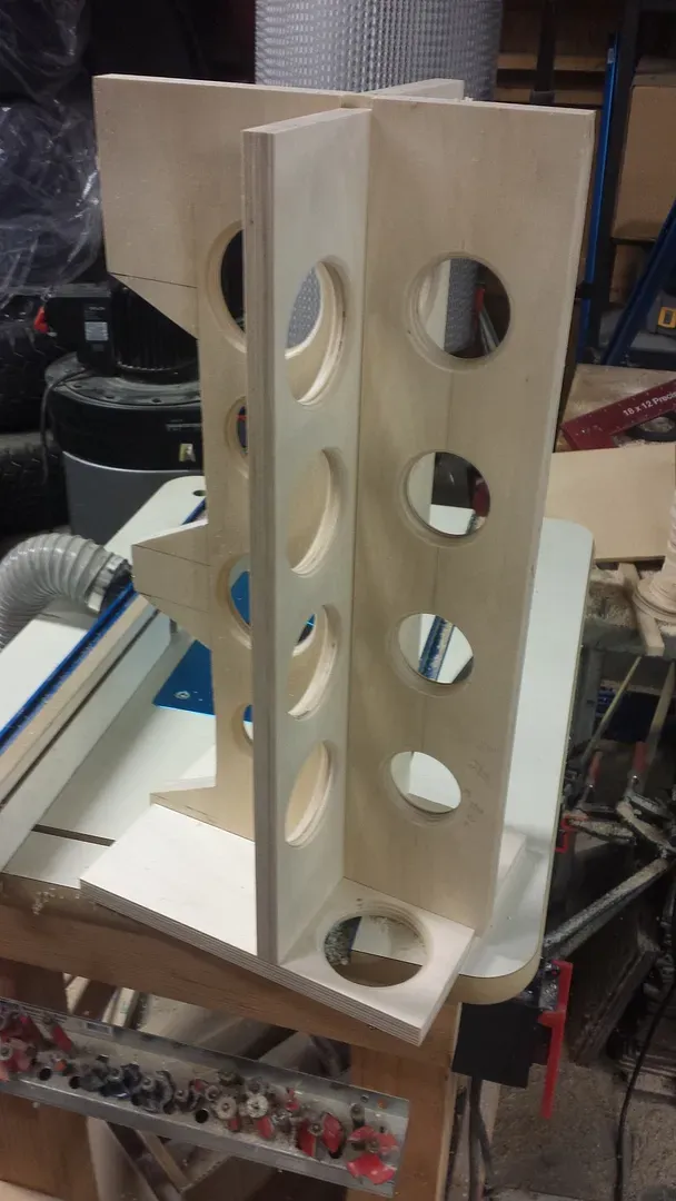

    Both Braces dry fit:

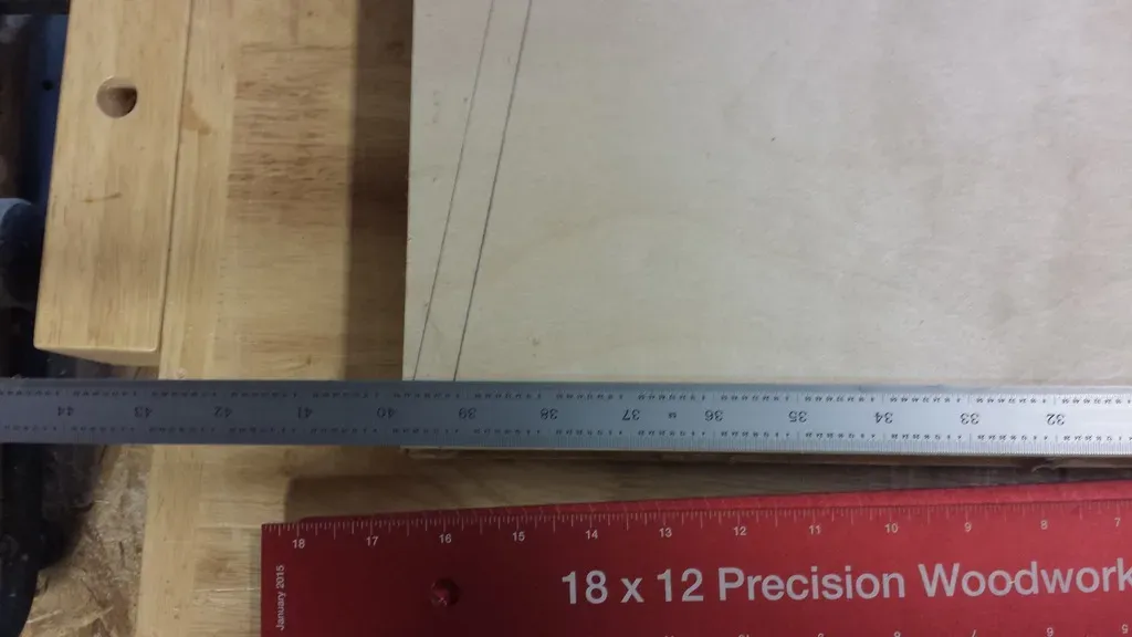

    Side panel, showing that I should have cut the boards at least 1/8 longer, now I have to change the top design to compensate:

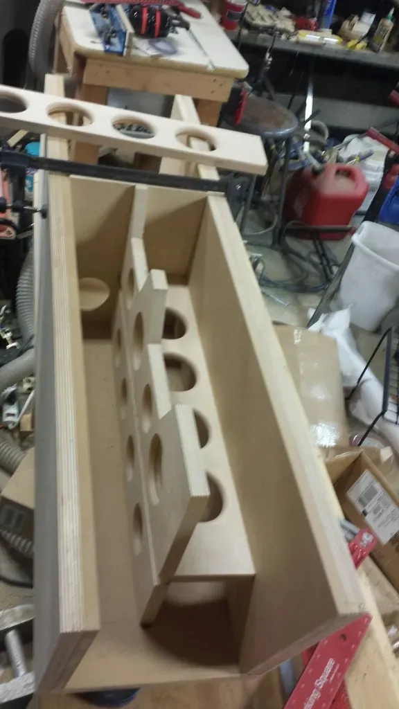

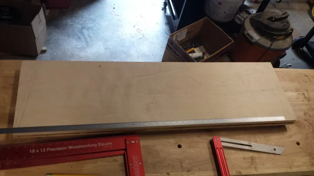

                            I pretty sure I buggered something up, but not sure how to fix it, I think I cut both the half laps per the drawing 3/4 wide, 1/2 deep but they don't see to join very well, can anyone tell me what I should have done?

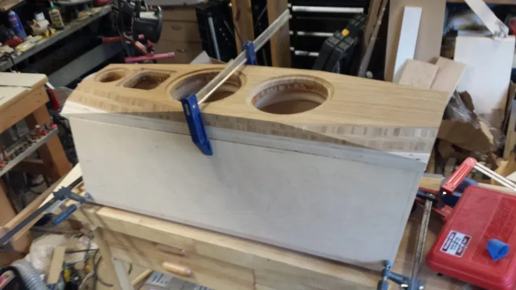

                            Other then that I've made some progress:

                              The half lap should be the thickness of your MDF, no biggy if the gap is consistent just rip a piece of MDF to fill the gap or taper a piece to glue in there. One of those no one will ever see.:W
                              • Renron
                                • 751
                                2 ways to move ahead as I see it. One is like Dar47 suggestion, but I would rip an extra 1/4" off of each side of the MDF and slip a 2" wide MDF on edge glued it in that slot.
                                Second way is to fill it with a construction adhesive like PL400 or Liquid nails then glue a small strip of MDF over the top of the construction adhesive.
                                Any of the 3 ways would be more than strong enough. Like Dar said " no one will ever see it".
                                Ron
                                I meant no offense by the comment on the organization of your shop. It really does look just like mine most of the time.
                                Ardent TS
                                  You could also fill the gap with thickened epoxy. Mix it up and add sawdust until it's putty like and you'll have a strong joint. Not cheap unless you already have the epoxy. though. :roll:
                                      Ah, thats where I messed up ops:, good thing I'm only building one at a time.
                                      Ron
                                      No offense at all, my response about the shop sounded much more tongue in cheek in my head that it does re-reading it.
                                      I appreciate all of the advice, thank you. While i do plan on getting some epoxy to coat the outside it's a little pricey for this, right now i think my plan is to do either the PL and a strip of wood or wood glue and sawdust and a strip wood, my plan is glue the boxes up it 2 stages, the first stage will leave off the top and the divider so I will have room to come in after and get the the gap fully filled.

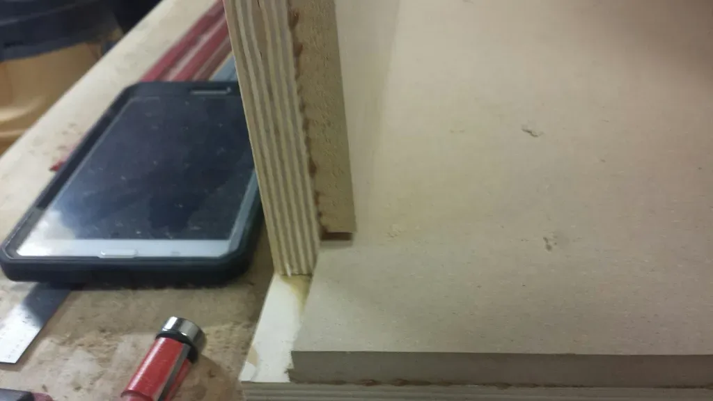

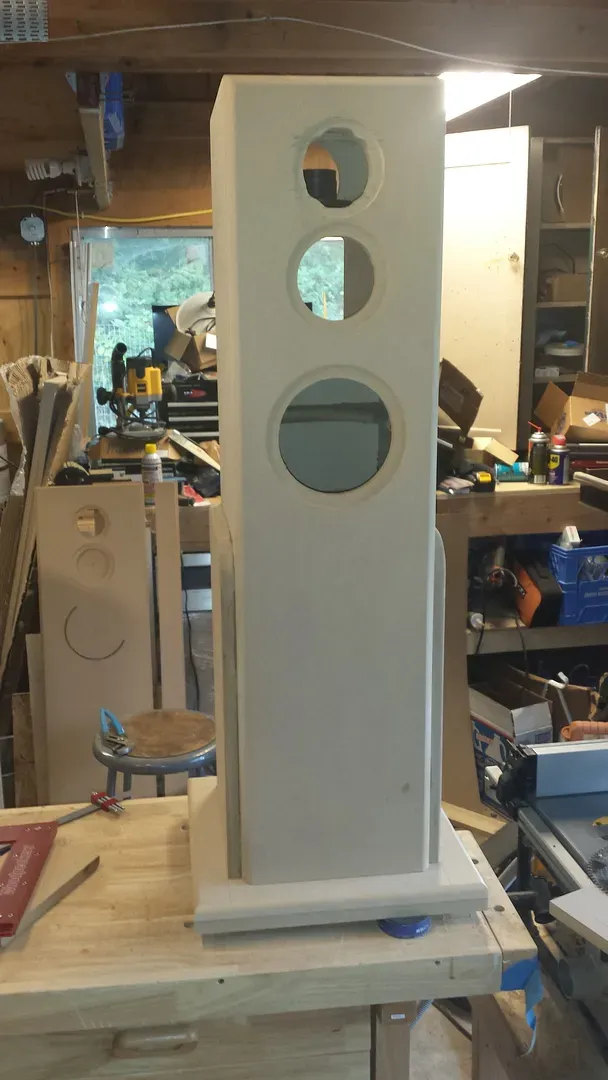

                                      My first dry fit with the baffle, looking good so far:
