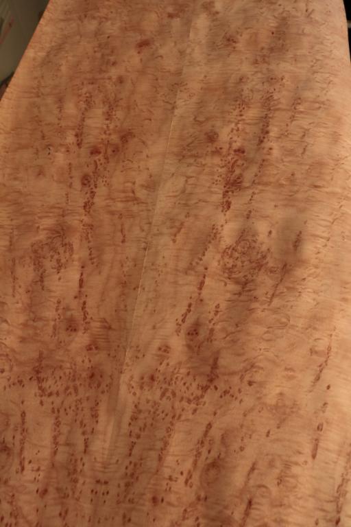

                  Here's a shot of the two bookmatched sheets held together with blue tape on the back. This is the best image of the figure I've been able to get so far.
                  The joint is better than yesterday because I used 2x4s on edge to clamp the straight edge down on the veneer. Note for future raw veneer projects. The first attempt wandered a bit when the straight edge flexed. I also paid more attention to keeping the saw vertical. Tough to do with the sizes of the saw and my hands. I guess I won't be able to use the whole blade, but that's OK.

                    Originally posted by BobEllis
                    I'm sure I'll be stroking it a lot.
                    ARCHER ! Phrasing!!!
                    Bob, that book match sure is beautiful. Excellent job.

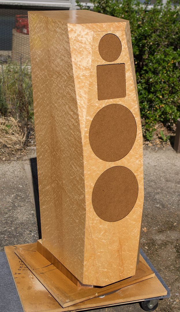

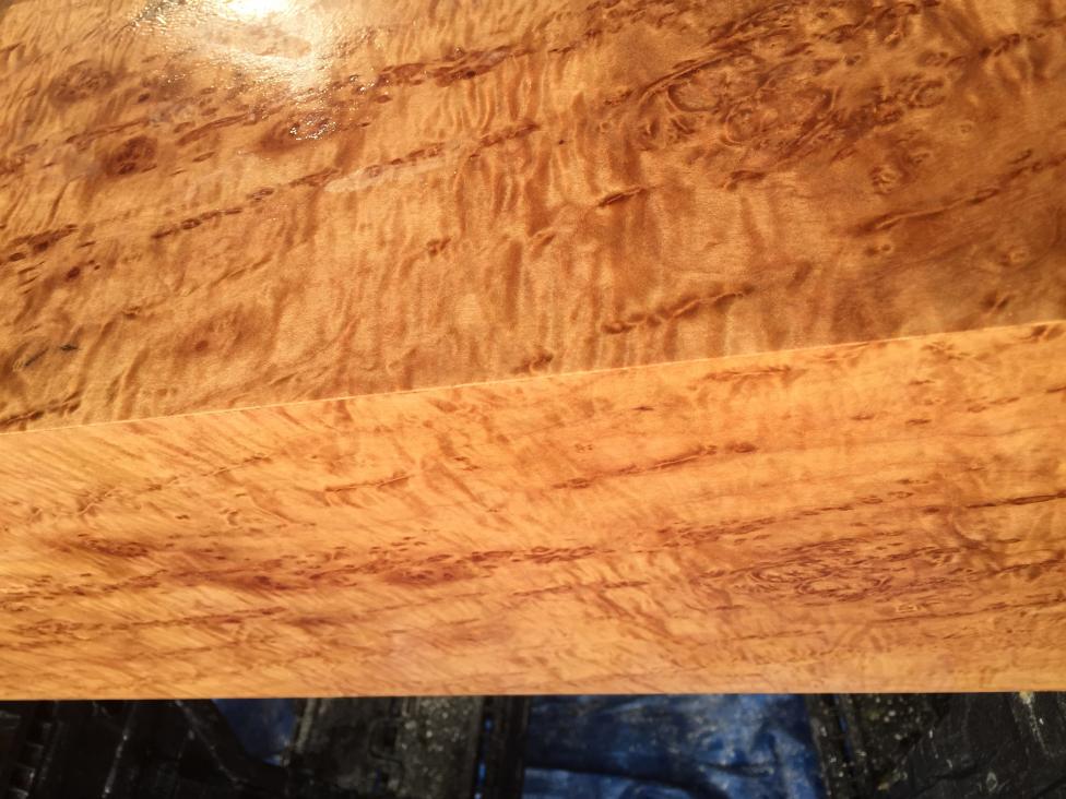

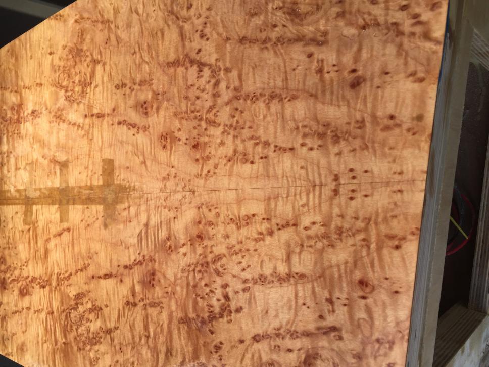

                                                Sanding the epoxy bleed through to remove the veneer tape is a dusty, but easy project. I'm happy with the result.
                                                The joint between back and side is pretty tight, too.
                                                Time to get the other cabinet to this point while I mull over how to do the facets. I'm thinking band clamps.

                                                  Looking good Bob ...... grain pattern matched up nicely at your joint.
                                                    #160
                                                    Thanks, Steve. Joe Woodworker's step by step directions made it seem easy.

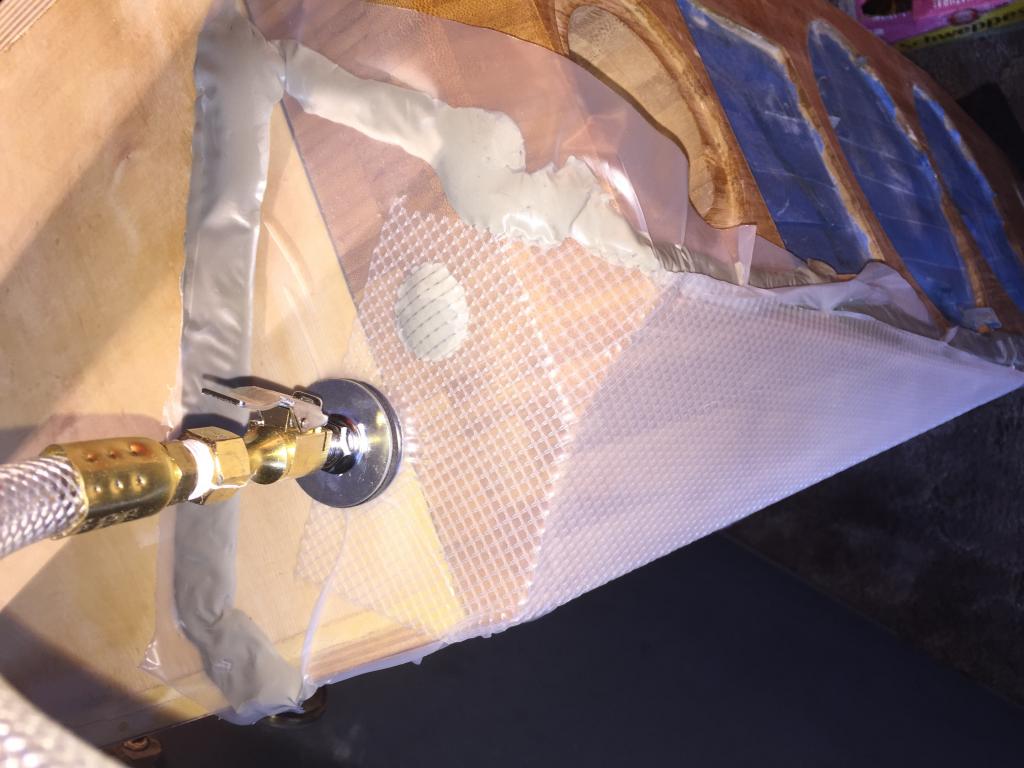

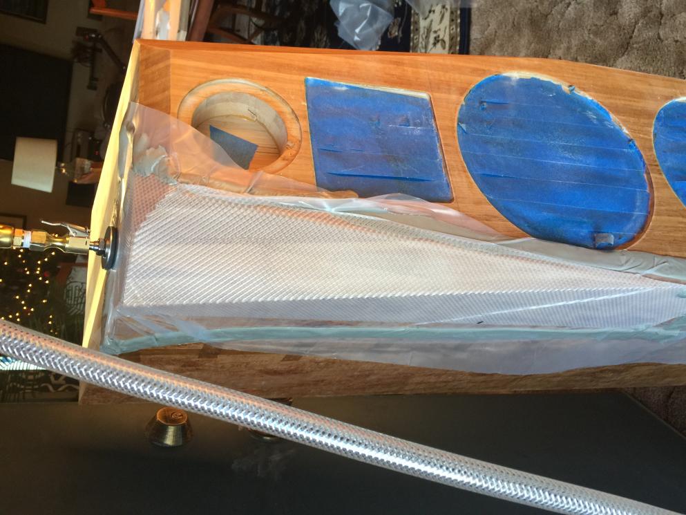

                                                                                          My vacuum press parts have arrived and I have been playing with it. Initially I was going to use a refrigerant compressor to provide the vacuum, but thinking I might have to bag the whole speaker I bought a rotary vane vacuum pump. As Joe Woodworker promised, assembly of the continuous run system was quick and easy. I needed a run to the hardware store to get an adapter, a short length of threaded pipe and an elbow to reduce my pump's 3/8" pipe thread inlet to 1/4". The JWW kit uses a pump with a horizontal inlet. Inexpensive and easy to source. I was also wondering if I'd be able to source a means of connecting my refrigerant compressor's tube to a pipe thread.
                                                                                          Although I bought vacuum bag material and breather mesh from JWW, my first project was to laminate one of the bases for my speakers using a clothes storage bag. I installed JWW's bag stem in that. That went very smoothly. Pulled a little vacuum and released it to realign the parts, pulled the vacuum and waited an hour. I will be using vacuum pressing to laminate panels from now on.
                                                                                          Now to test my idea for clamping the facets without bagging the whole speaker. I bought Colormetrics Gray Putty Tape / Butyl Tape 1/8" x 1" x 30' taking a cue from the Gougeon Brother use of "Mastic Tape" in their molding work. Sorry, Hank, 3M Mastic tape was too expensive, so I found this which is typically used to seal windows and skylights. Two step test - 1 can I get it to seal the bag, and 2 is it reusable? It turned out to be surprisingly easy to seal the bag (in this case a strip of 3.5 mil plastic sheet). I laid an outline around the facet with enough room to run the strip of breather mesh to the top and simply pressed the sheet into it. The vacuum pump is quiet enough that it was easy to hear leaks. A light press and the leak stopped. No clamping required. I was thinking I might need a strip of wood clamped on top of the sealant. The tape is gooey, and does not release from the plastic but it comes up from the epoxy surface for the most part. It remains sticky enough to put down again and seal at least one more time.
                                                                                          I need to investigate how to remove the residue. If normal household cleaners don't do it, I'll try Goo-Gone or other solvent.
                                                                                          A couple shots of the bagged facet. Now to test whether a small overhanging bit of veneer will break if it extends a hair over the corners. You can see that the breather mesh wraps itself tightly around corners. I may need to make cauls for the facets. Then cut the veneer to size and glue up the first facets. Darned forum punished me for using my iPhone camera and rotates the pictures.

                                                                                          If you go with a vacuum pump system, JWW recommends a diaphragm or piston pump. My wallet wouldn't tolerate that in the size needed, so I got a rotary vane. JWW notes that they are somewhat less reliable in continuous operation. I plan to upgrade to a cycling system to address that. The other down side of the vane pump is that it discharges a mist of oil while in operation. It needs to be outside while running. Plan on extra vacuum hose. I tried to add a hose on the outlet, but wasn't able to identify the thread on my exhaust port - not quite 3/4".
                                                                                            #180
                                                                                            Thanks a lot Bob.
                                                                                            Very interesting reading. I did not know that you would be able to use a vacuum press that way, buy just covering the covers.
