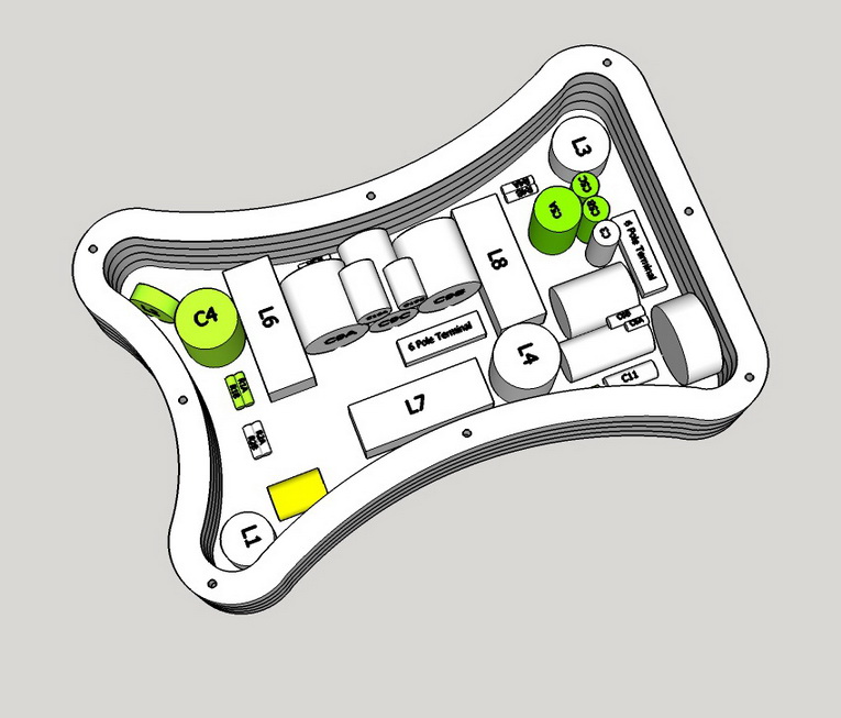

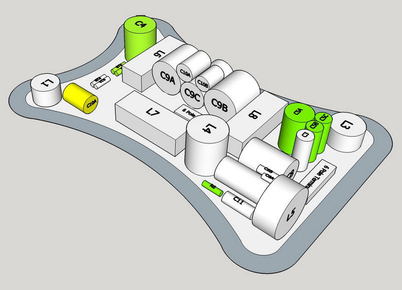

                              Bob, don't know if your a CAD man, but Sketchup worked well for Jon and I determining volume requirements for crossover parts for the Minerva project. Just got the sizes from spec sheets for the parts and started playing.
Name:	Crossover 2_resize.jpg
Name:	Crossover 2A_resize.jpg
                                #465
                                Doh! Stand some of the caps on end! Then it fits.
                                Every time I've tried to learn a CAD program it was with a project in mind. The learning curve has been steep enough that I've just sketched on paper and worked out dimensions.

                                        #469
                                        I will probably go that way, Ron, just to get a bit more space to work with. Nothing magical about getting it all in one space. I'm not buying more parts, unless my audiohobby.eu order doesn't arrive shortly. The mid and tweeter parts are in, except for the second shunt caps. I suppose I could add a 1 µF to the C6 stack of Obbligatos to get to the exact prescribed value. Only another $21 for Superior-Zs, but I can't imagine it would add too much flavor with 107 µF of Obbligato in parallel.
                                        I'll play with sketchup again once I don't have an active project.
                                        I think playing with the parts is much easier than looking at a 3D rendering on a screen, Ed.

                                            I completely agree Bob ...... for the Minerva and my Jensen builds I had to make sure I had enough room prior to building though. Of course the major restraint was to keep the crossover components out of the main cabinet. On the Minerva I got Jon to at least commit to what brands were to be used and went from there. I actually had to increase the size of the crossover section by ~20% from the first cut drawing. Now if Jon were to change his mind about what's going in there, which of course he would never do he's kind of on his own at that point.
                                            Thanks Ron ...... and I have a feeling Jon will make use of every bit of that extra space!
                                            As a general note though .... I've found the drawings to be a very useful "will it all fit" tool. I usually end up doing what you do and play with the parts to get the best fit before final assembly. Not that I've built that many systems, but it seems to work for me and I take notes from the rest of you guys on what works and what doesn't.
                                                [ATTACH=CONFIG]26332[/ATTACH]
                                                [ATTACH=CONFIG]26333[/ATTACH]
                                                Steve, that is attention to detail and planning. Nice Job!
                                                One thought..If L7 and L8 are cored bar inductors their flux path may travel through L4 causing interaction. Visualize a spraying water fountain out the ends...If centered on L4's height the flux lines would cancel and theoretically be ok....If possible you might try to move it.
                                                  Thanks Scott ...... as I recall they are and I will keep that in mind come build time for the crossovers. That would be interesting to see what that would look like ..... though at this point it was a "will the 10 lbs of dodo fit in the 5 lb bag. At this point I'm not sure what the final component choices are ...... I know Jon has a few minor changes over the earlier version of the crossover, but we have not discussed it recently .... he seems to have gotten a "little" side tracked with the Katana project. None the less we should have plenty of room to move stuff around.

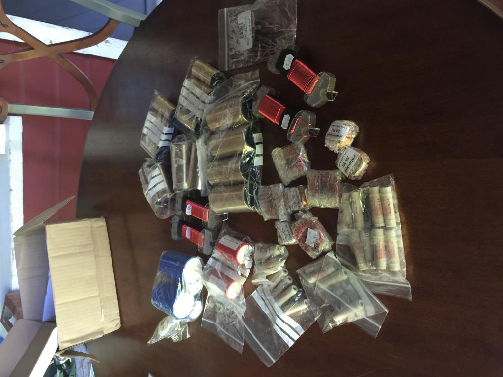

                                                    The parts from Fidelity Components Shop (audiohobby.eu) arrived today. Well packed, by registered mail. I was starting to assume that the package had been lost, but it's only been 10 days since it was shipped. Tracking stopped at the Estonian border. I'd asked them what is their typical transit time to the US, it's 5-10 working days. For whatever reason, the US Postal Service does not provide tracking information.
                                                    If you can live with roughly 10 working day delivery, there are good prices at audiohobby.eu
                                                    Funny how spoiled I am by Amazon Prime and Hi Fi Collective 2 day shipping. Parts Express is close enough that deliveries are in 2-3 days. Madisound and Meniscus only take 3-4. It wasn't that long ago that ordering something and having it within a week was amazingly fast.
                                                    Now to play with the puzzle pieces.

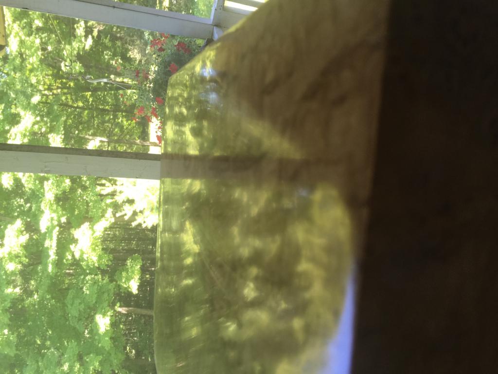

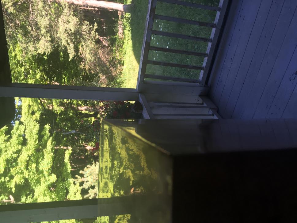

                                                      So I finally overcame my trepidation about knocking down the gloss and started polishing. The General Finishes High Performance Gloss self leveled after brushing better than rattle can spraying. Here is what the top looks like after completing the first round at 600 grit. Still a bit to go, but it's looking very promising.
                                                        [ATTACH=CONFIG]26343[/ATTACH]
                                                        Bob, are you dry sanding or wet ..... just curious.
                                                          #478

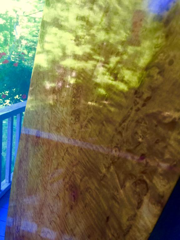

                                                          Wet sanding. I didn't go for the Mirka products just because I have a large supply of automotive sandpaper. Rinse frequently and at the first sign of dragging.
                                                          Here is post 1,000 grit. Wiped down and allowed to dry.

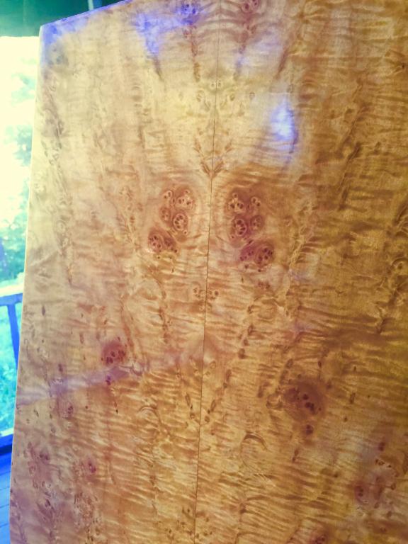

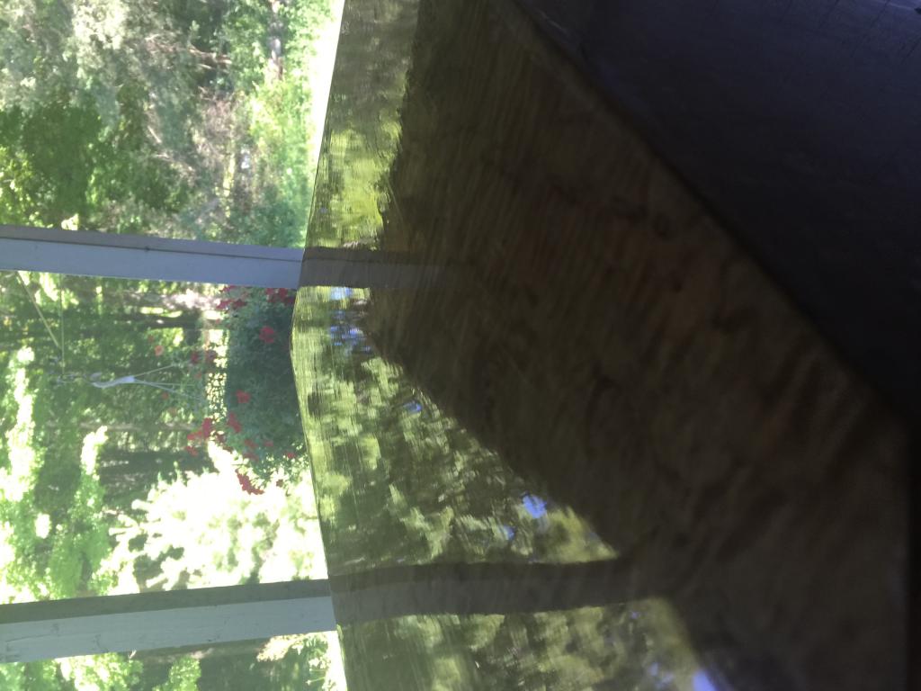

                                                            Now post 2,000 grit. Automotive polishing compound tomorrow and a coat of wax. At low angles there is a lot of gloss, straight on it looks satin.
                                                            The blue splashes are over saturated sky reflections. I had to really crank up the saturation to get the image to look like the real thing. Still Iphone pictures.

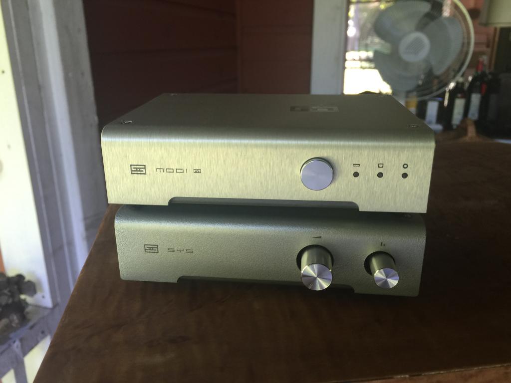

                                                            As a side note, my first pieces of Schiit arrived today. A Modi MB DAC and a Sys to allow me to control the volume. I don't have a USB cable to run it in that mode. I only have the computer's built in DAC and an M-Audio FW 410 to compare with. Comparison to the Oppo BDP-103 will have to wait until after we close the camp and I move back home.
                                                            Edit: The output of the Modi MB is higher than the FW410 output, so it makes direct comparison tough. Even with the crummy speakers and T-amp I'm using it seems like a significant improvement. Everything has more weight and sense of space around it, in comparison the instruments sound further away and in an anechoic chamber with the FW410. I used to think the FW410 sounded pretty good...
                                                            I'll have to make a pad to reduce the output of the Mimby to match the FW410 and do a real test later.

                                                              I can not pass up the opportunity, no offense intended, but that looks like Schitt. But the cabinet veneer is another matter...
                                                              The pictures hint at what you have achieved with your hard work on the cabinets, but the limited dynamic range of JPEG on the phone, and possibly mixed lighting sources make realistic color rendering out of the question.
                                                                #481
                                                                It's some engaging Schiit. I've been going through my music collection like I haven't in quite some time. Can't wait to hear the Ardents driven by a proper amp. Tomorrow I may pull out the A75 to give these speakers their best shot.

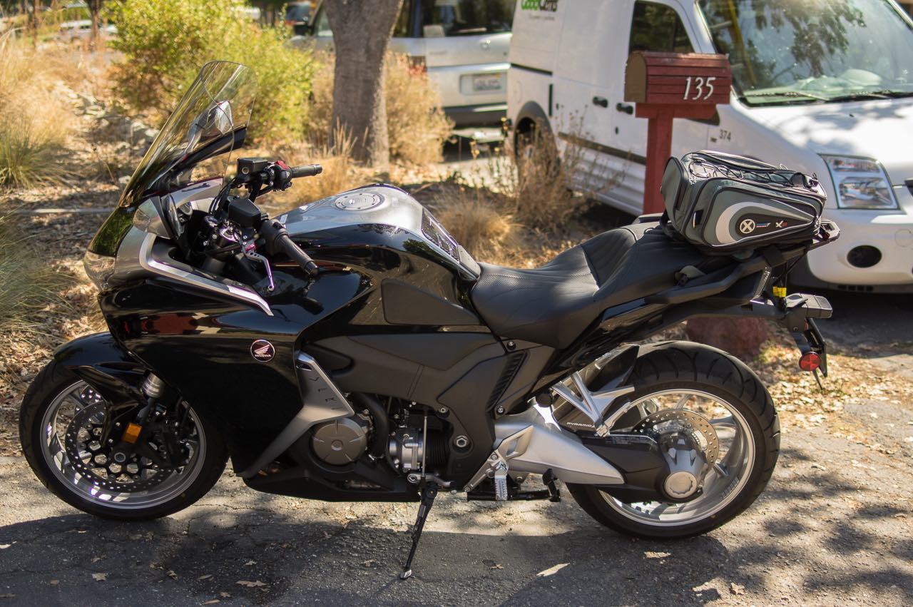

                                                                                        #493
                                                                                        Perhaps we can accommodate you- when the current build is complete, perhaps we can position it next to a black and silver VFR1200?
                                                                                        With the EFI modifications that have been made, I assure you it is the two wheeled equivalent of a Tie Fighter- roll on wheelies being only a twist of the wrist away (the factory restriction on torque below 6000 RPM in the first two gears has been removed).
