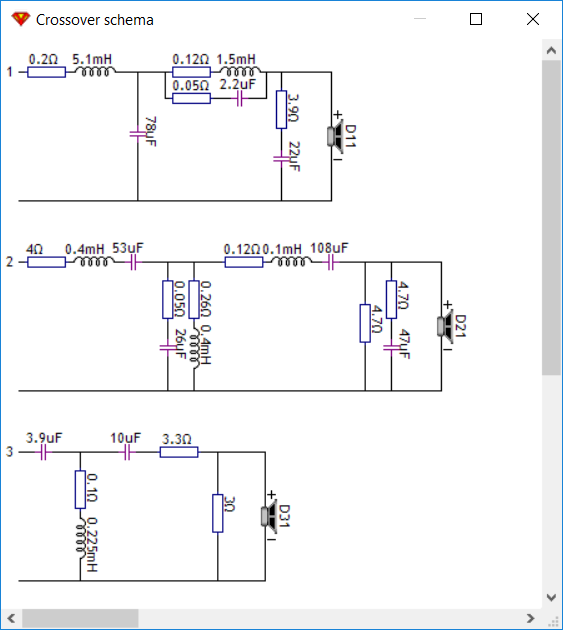

            For the SW223DD02 version
            Here's an update for using the SW223BD02
            First, just the schematic:

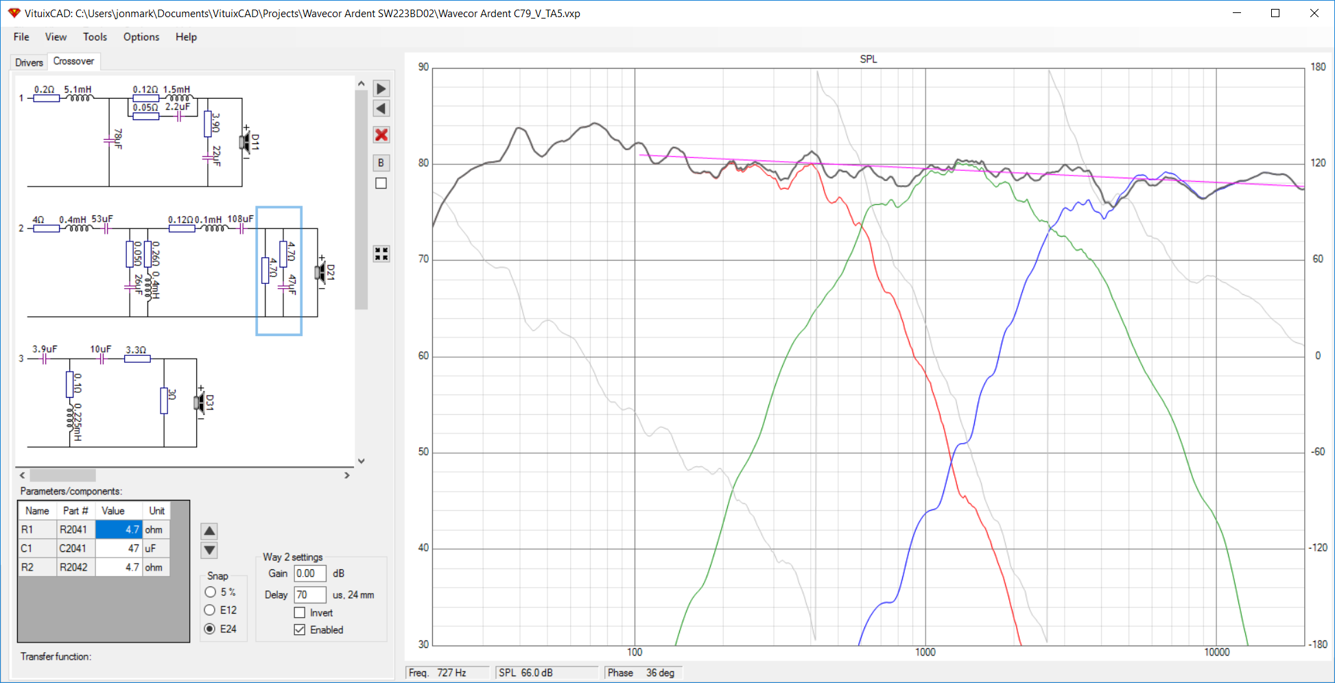

            And second, the SPL response
            This is basically the TA5 (test article 5) release with modified resistors (the RIGHT resistors modified the RIGHT way; they interact differently with the network as some of you have discovered)
            However, the value for L1/L1011 (as numbered by VituixCAD) is suggested to be changed from 5.6 mH to 5.1 or 5.0; if you already have a 5.6, use as is (just slightly flatter with the different value) OR if you have an LCR meter unwind your inductor to that value. seriously, just how you have them setup in your room will make more difference in the lower midrange than this.. but this would be the optimum for the BD02.
            With regards to the tweeter, two points:
            • Using the new values, and if you should want to raise or lower the overall trebel level, do it by adjusting the shunt resistor R6/R3051 or better yet, use the voicing filter (or use the Force, Luke!)
            • Second, the dip in the response around 4 kHz is due to a cabinet diffraction effect which goes away as you get slightly off axis - it's not something to fix in the crossover, the power response being radiated by the tweeter is quite steady. You'll also see less of this effect with the grilles and recommended felt diffraction contol in place, but these are from bare cabinet measurements.
            Last edited by theSven; 30 April 2023, 15:59 Sunday. Reason: Update image location and size

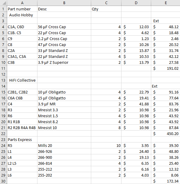

                          Here's my BOM for the XO. I already bought the Clarity MR 10µF caps. Would have saved $60 had I known about Hi Fi Collective...
                          Off to clear my head on my bicycle and review before pulling the trigger.
                          EDIT - Price listed for the 3.9 µF Z-Superior is actually for the 3.3 µF. Correct price is $15.73.
                          Continuing Jon's theme of not all standard values get manufactured, the Mills resistors are only available in 15 ohm, not 16. I will parallel 5 to get 4 ohms for the 3.9 target.

                              Thanks, Ron. Forgot to look there. That $34.35 is a nice savings, $15 pair over Hi Fi Collective price. Madisound wants $60 for 3.9 µF
                                #420
                                Crossover parts ordered. The savings Ron found for me on the Clarity Caps more than paid for expedited Hi Fi Collective shipping. Breaking the order up between four vendors made it hurt less than if I'd spent it all in one place.
