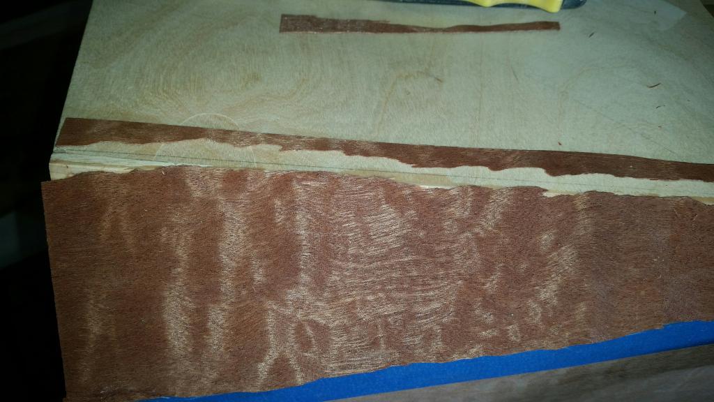

                                                                  When I purchased my veneer from Veneer Supplies dot com, / Joe Woodworker, I purchased two different grades of Veneer. one 5 star and one 3 star.
                                                                  This was because I needed different sizes for the sides and the front / back / top. I didn't want to book match the veneer on the sides, I wanted a single piece. I'm not sure it was easier in the end, but it's what I've got now and it's appearance matches my goal.
                                                                  The difference between veneer grades has become apparent to me, the 5 star is more figured and is an even cut. Meaning that the entire thickness is consistent, ~40 mils.
                                                                  The 3 star veneer has more straight grain (which is pretty too) but the thickness varies considerably. In some spots I can see light through the veneer when held up to a bright light source. The thickness of the veneer varies at the natural tree growth rings, which makes me sand down the high spots to the lower levels. It is also more prone to fractures and cracks when drying / gluing. This makes it much more difficult to work with in the long run.
                                                                  Being frugal to the point of self-detriment. That said, I purchase all of my veneer for ~$220 and I'll have 2.5 sheets of 18" x 98" left over for my next project.
                                                                  I'm happy with my purchase, just thought I'd share my experiences with the different grades of veneer.
                                                                  5 star only from now on though. (Photo is 3 star Veneer)
                                                                  Ron

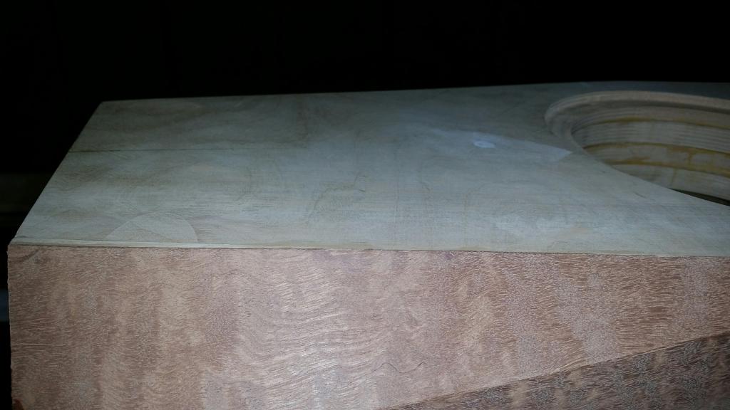

                                                                      Fixed
                                                                      Thanks for the vote of sympathy Steve, I know you have had similar setbacks. Your work is exemplary, I hope mine looks a good as yours.
                                                                      Patience, a good 10x jewelers loop, razor blade, sawdust and glue can work miracles.
                                                                      I've lost visuals on Bob over the horizon, but still have him on Radar.
                                                                      Ron

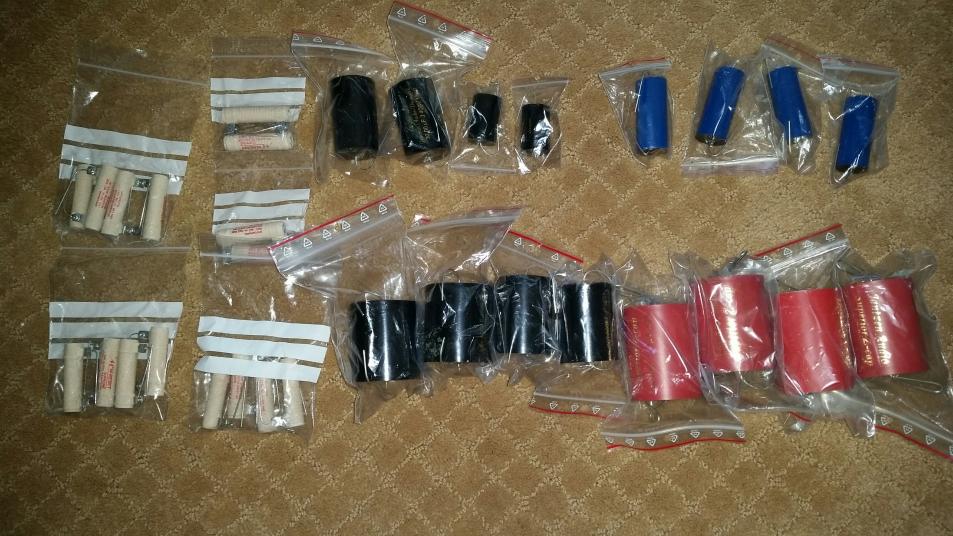

                                                                              Look what the Capacitor fairy brought today.
                                                                              Oh my, while I was helping my Son change out his rotors and pads on his Acura yesterday, 102* hot, I got a special package.
                                                                              Almost all of this is for the mid driver circuit.
                                                                              I really wanted to put ClarityCap MRs in the 10 Ohm position for the tweeter. I just could not justify the price difference at this time.
                                                                              I'll bypass the Superior Z with a Russian Teflon instead. From my experience with Russian caps, I'll bet it comes close in SQ.
                                                                              Fingers crossed, only time will tell.
                                                                              Ron

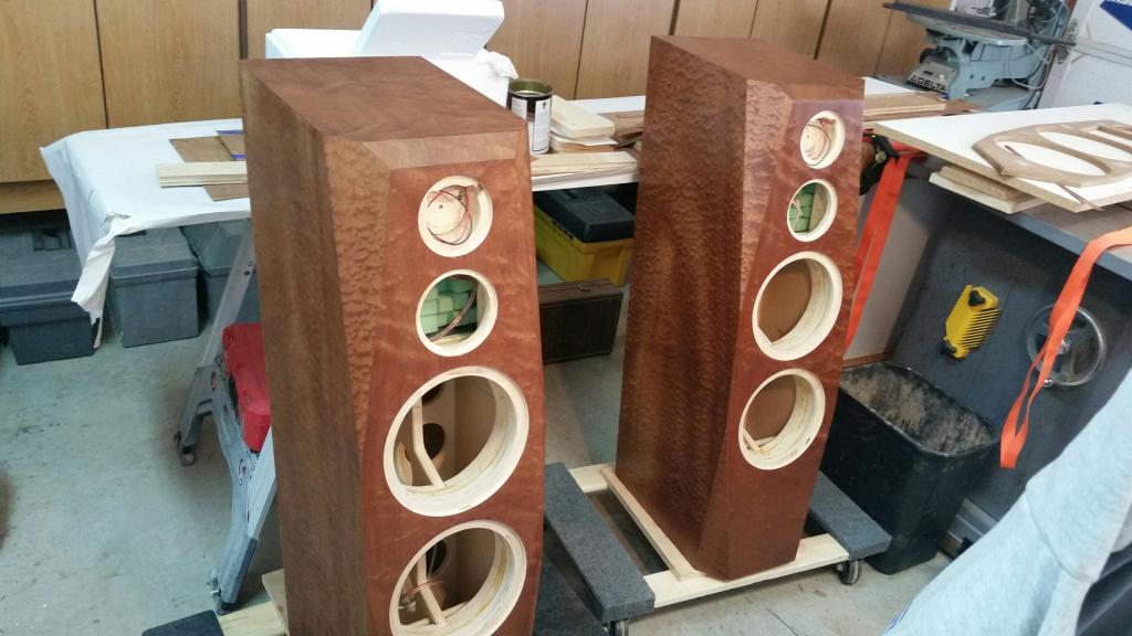

                                                                                  I've got a pair of finished sealed cabinets!!!
                                                                                  I have to thank Bob Ellis for sharing his (almost) sand through, while sanding the facets on the 2nd speaker I noticed it was getting thin. I stopped sanding and blew a huge sigh of relief. It was close.:^x
                                                                                  Those tiny little triangle corners on the small upper baffle facet broke off each corner about 3/8" from the tip. I used a single edged razor blade like an axe, and cut the broken edges off to 90*, then found a suitable grain pattern on some scrap. Glued in, re-cut, sanded and invisible repair. Not too happy about it, but, I'm getting good at dutchies.
                                                                                  I've ordered the last components for the XOs, 6 small inductors for the mid driver circuit. Just waiting on parts to start / complete the Crossovers.
                                                                                  I'll have to spray the Varnish on my speakers in the morning as it gets hot as the day progresses. >100F / 38C. At those temps it would never flow out smooth.
                                                                                  I'll post more photos as I continue. This Pommele Sapele is beautiful wood veneer. Such a pain to work with due to the wavy wavy grain, it WON'T cut straight when trimming.
                                                                                  Ron (One of my Sons said that TS Ardent sounds like a ship. LOL. Signature change to Ardent TS)
