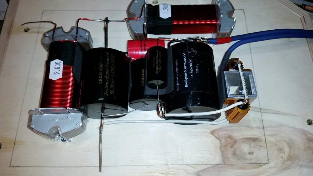

                Today's update,
                I finished (almost) one of the woofer crossovers. They will live inside the cavity below the woofers. Attached top of the base. All other XO parts will be installed underneath the base. I had some capacitors left over from previous builds and wanted to use them instead of buying new ones. At least as good quality as a Cross Cap. The // resistors are power resistors mounted on an aluminum heat sink, measured and paired.
                Ron

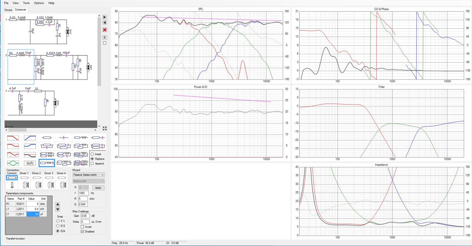

                                      Ron, we've got good news, and other news. :W The good news is I have all the files together in one nice cozy spot. The other news, is that this crossover redesign just became a bit of a learning project and guinea pig (not the same thing as a pig with lipstick) as I've come across a new crossover design program written by a guy in Finland, and you know what a sucker I am for northern European technology.
                                      Aren't those nice colors and graphs? I already have it downloaded for my new Dell XPS 4K laptop and my trusty 2010 Mac Pro (also running WIN10). The weird thing, is that in some ways, it's more like LSPCAD 5 on steroids than LspCAD6. that is, it doesn't have a free form schematic editor. But implements filter blocks you string together. However, it looks like doing the Wavecor Ardent is no problem.
                                      Now, here's the groovy part- it handles up to 5 ways, but it can use the extra driver and filter slots in clever ways. I.E., one can have two different versions of midrange, for example, with the same woofer and tweeter section, and with a click switch and compare.
                                      I think you see the utility to that for what we need to do here.... :W :B
                                      So we'll be able to easily compare the C79 and 12MU4731 implementations.

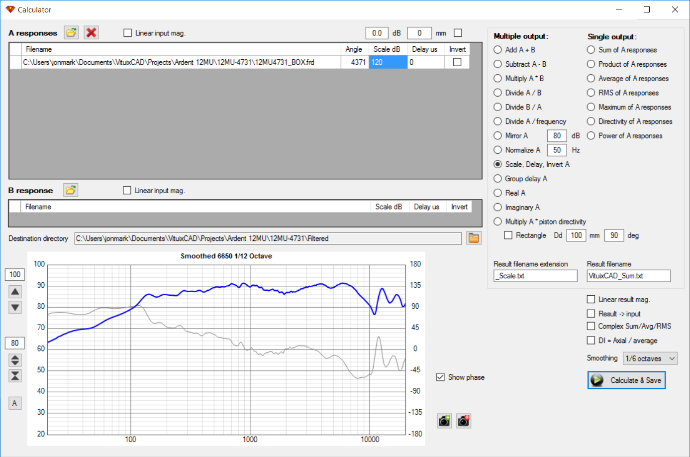

                                            Well, it's looking doable- a little more flexibility than I thought at first, too...
                                            This is just the "standard" Wavecor Ardent. First step, correlation.

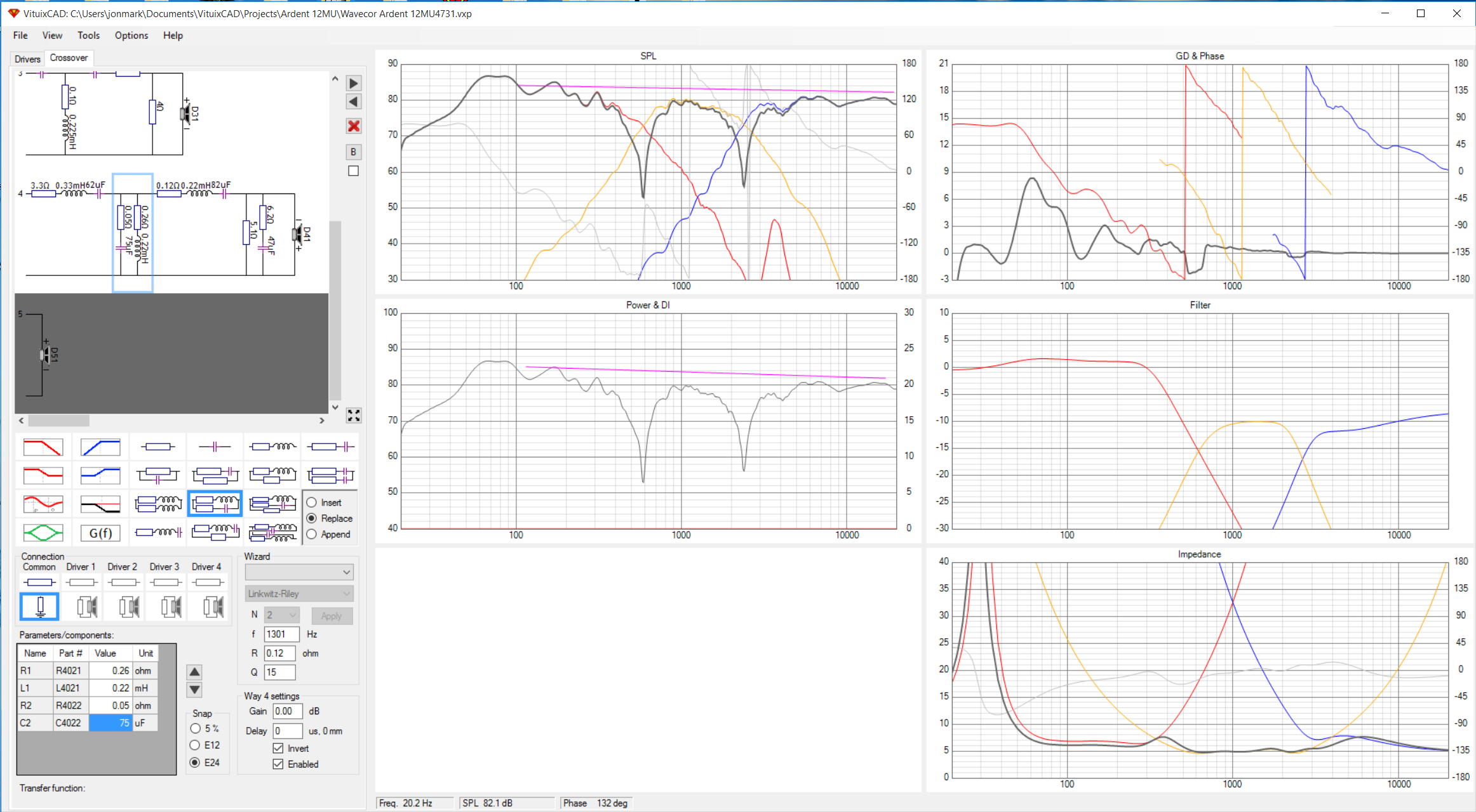

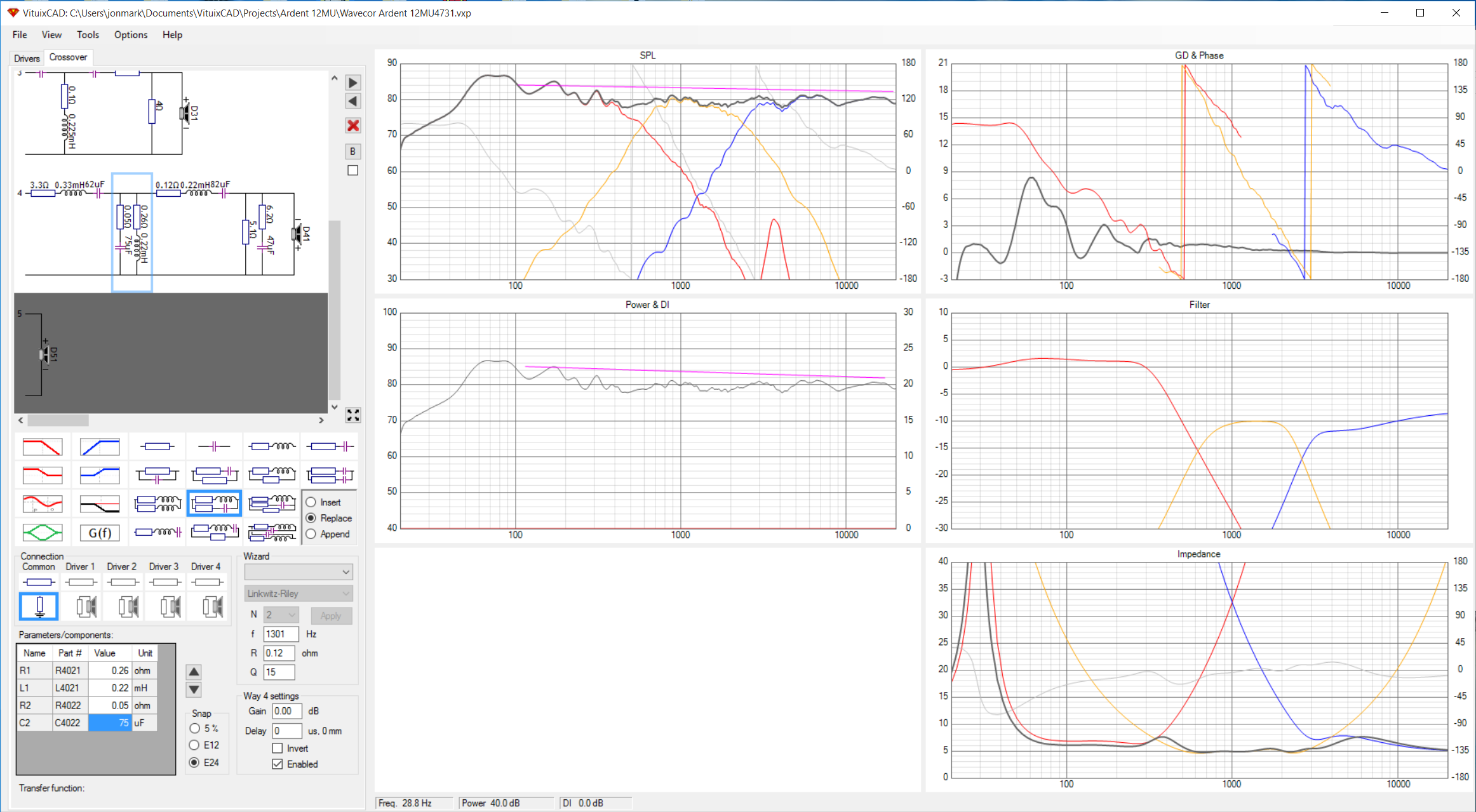

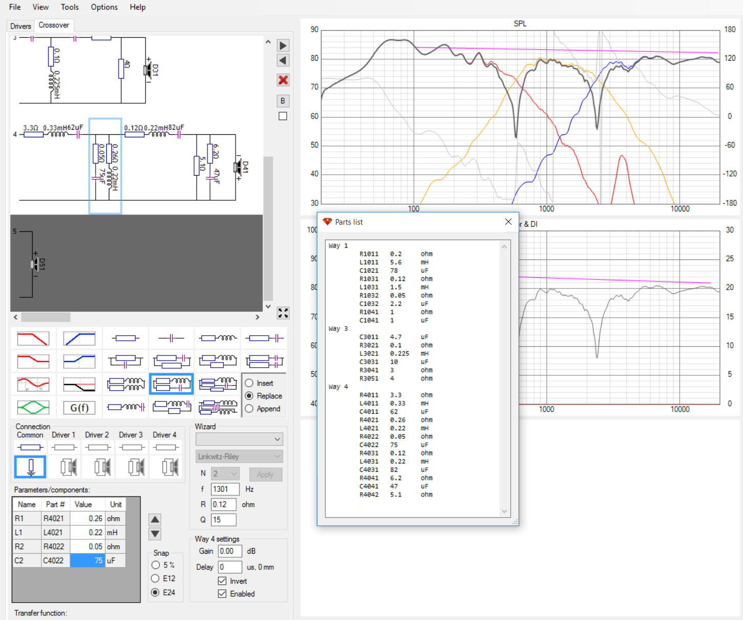

                                                    OK- back to Renron and the 12MU4731.
                                                    I think we have something workable here- one thing I was somewhat concerned about was handling a 4 ohm driver instead of nominally 6-8 ohm, and keeping the impedance reasonably high- but I think we've got that licked.
                                                    For reference, here's the scaled smoothed measured data for the 12MU/4731, as measured in a cabinet with the same width as we're working with in the Ardent, in Vituix.
                                                    Click image for larger version  Name:	25301391791_0894b4b704_o.png Views:	151 Size:	246.0 KB ID:	932816
                                                    I setup another way in the same project file, and just turned off the original midrange. But, I could also copy the original midrange network into the new way, so this saved time getting started.
                                                    I aimed for both good smoothness but also a mild mannered impedance curve, which imposes some limits...
                                                    Click image for larger version  Name:	25301391421_337bf5a7f5_o.png Views:	136 Size:	534.9 KB ID:	932817
                                                    note how the impedance is pretty much nailed at 5 ohms for most of the midrange band. I think I deserve at least a nice latte for achieving that! :W
                                                    Mid polarity inverted, and all looks as expected...
                                                    Click image for larger version  Name:	25026827959_018a3e482b_o.png Views:	137 Size:	553.1 KB ID:	932818
                                                    Part list-
                                                    Click image for larger version  Name:	25301390091_1eebf571ac_o.png Views:	142 Size:	356.8 KB ID:	932819
                                                    Note, the component numbers have NOTHING to do with the original Ardent component numbers- it uses a built in forced component designator numbering, just like LspCAD 5, and one can't alter it. (at least, not that I've discovered).
                                                    Woofer and tweeter networks are as per normal Ardent practice- only the midrange is changed.
                                                    Note, while one can export frequency response, impedance, directivity index, some other graphs, you can't export a text parts list. Think that could be improved a bit. No way to print it, either. In fact, this program doesn't have a print command- the only way to get data out besides writing it down is screen capture. Still, I'd say it works pretty well, and is well worth the modest price.
                                                    Note, these are fairly high resolution screen captures, if you click on the image, it should take you to flickr, where you can save the full resolution version, not what may be showing on your monitor (which may not look like what's showing on my 5K monitor...) Save and print.
                                                    Last edited by theSven; 21 April 2024, 01:39 Sunday. Reason: Remove URLs from images

                                                          Updated components breakdown crossover with suggestions, for 12MU4731
                                                          Click image for larger version  Name:	24790493234_99d79a6a46_h.jpg Views:	114 Size:	292.7 KB ID:	932815
                                                          Last edited by theSven; 21 April 2024, 01:40 Sunday. Reason: Remove URL from image
                                                          • Renron
                                                            • 751
                                                            #209
                                                            At least one latte. Jon, thank you for your hard work. I just can't say thank you enough for your time. It is the nicest gift you can give. AND you kept the parts list to only 18 components! (jk)
                                                            5 Ohms from a 4 ohm midrange? Next is water to wine! You are indeed a miracle worker with XOs. I'm so excited to start building this XO I can hardly wait for the parts to arrive. As soon as I get paid for the kidney, I'll order the parts. Naw, I've been acquiring some of the capacitors I thought I would need for a few months now. That's a lot of capacitance. Now that I know exactly what's needed I can get serious.

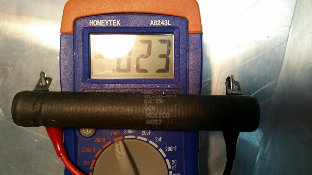

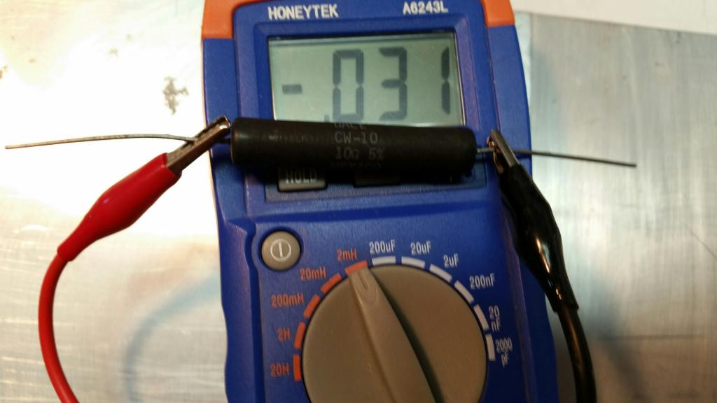

                                                                          Now we all know it's important to use non inductive resistors when building XO (crossover) circuits. It's a given. But, how much and what's the difference in resistors? How much inductance do they have?
                                                                          Well being frugal as I am, this thread proves it, I decided to check it out. Here's some of what I've learned.
                                                                          This is a 10 min video on resistors, inductive and non inductive types tested.
                                                                          The two pictures below are my photos, both are Dale brand which are very well respected in the 'Audio' community. One is a 10W and the other is a 50W.
                                                                          Please note that the reading is below a mH and is in uH territory. Just how much energy storage are we talking about? Does it REALLY effect anything at this level? I doubt I can hear it.
                                                                          Just food for thought and I welcome your comments.
                                                                          Ron

                                                                            • 16205
                                                                            #217
                                                                            Some of my crossover circuits are using 100 or 150 uH in a tweeter inductor circuit. A resistor with 31 uH is not all that cool, IMO. Just saying. For a zobel network in a woofer Low Pass, no problem. For a padding network in a tweeter crossover, not recommended.
                                                                            YMMV, it's your funeral, blah blah blah... :W
                                                                            Do what makes you happy... I won't burn crosses in your yard if you use these with a ScanSpeak tweeter, but I may wave my designer finger at you (the way my GF waves her "mommy finger" at me sometimes... )
                                                                              • 571
                                                                              #218
                                                                              Hey Ron,
                                                                              FWIW...I see you are reading a negative value. This likely indicates some offset in the meter. To get a more accurate reading it would be best to twist the measuring leads unless very short. This will minimize lead loop inductance and give more repeatable results. Then short the leads and take the difference from this value to the value of the device under test.
                                                                              -Scott

                                                                              • Renron
                                                                                • 751
                                                                                #219
                                                                                Always open to those with more experience than me. The leads are ~6" long. I have purchased new inductors from P.E. which have measured exactly as labeled. I'm not sure why it measures as a negative #.
                                                                                Jon, Have you ever measured Mundorf M-Resist resistors for Inductance? I'm not about to argue with the designer, (or play Russian Roulette), but I am curious how a resistor can have Zero inductance. They are the same design construction as the 50W Dale in the photo above.
                                                                                Hey, I'm trying to learn here! Don't shoot.
                                                                                Ron

                                                                                  • 16205
                                                                                  #220
                                                                                  Non-inductive resistors (if properly designed and manufactured) have coils arranged so that the inductance is distributed in two halves out of phase with each other so that the net effect cancels. They're not truly non inductive, but it should be possible to get the parasitic inductance below 1 uH. In fact, for power amps, we used to wind 1-2 uH inductors for output decoupling from capacitive loads back in the day. These days, we have class D amps with output inductors of 220nH. That's 0.22 uH.

                                                                                    • 751
                                                                                    #221
                                                                                    Thank you Jon,
                                                                                    As they say in Tennis; Point Marsh!
                                                                                    I did some more real and theoretical reading about bifilar resistors, Even Mundorf admits they're not really non inductive. They won't give any #s though on how much they do have. For a few $$$ more and to keep your blood pressure down and the burnt cross off my lawn I'll just do as instructed. Mundorf M Resist it is.

                                                                                      • 16205
                                                                                      #222
                                                                                      Cool, Ron!
                                                                                      Now, one more weekend factoid- those tricks for reducing the effective inductance are also applied to some high end speaker cables- and some midrange, like the braided construction of the Kimber tc series, like the 8tc and 12tc.
                                                                                      In the case of speaker cables like my Cardas Golden Reference, the loop back inductance per foot is under 0.02uH. That means a 3 meter cable length is, lets round up to 10ft, that's 0.2uH. I have verified that with an HP4192 network analyzer. That definitely isn't zip cord....

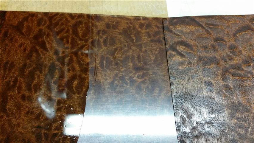

                                                                                          Solarez UV cure Grain Filler
                                                                                          Here's a photo of different coatings on Sapele Pomelle.
                                                                                          On the left is General Finishes Arm R Seal on top of Solarez UV cure Grain filler (2 coats of grain sealer flat sanded to 600 grit) Dust nibs my fault.
                                                                                          Middle of the picture is just the flat sanded Solarez UV grain filler. It's a polyester BTW.
                                                                                          On the Right is 3 light coats of General Finishes Arm R Seal hand rubbed. It's a rubbing finish. No grain filler just Arm R Seal.
                                                                                          The crosshatch test for adhesion with the Arm R Seal on top of the Polyester grain filler was a complete failure. Success! That's why I'm testing. Ripped off in a big sheet. I now know that won't work. :E
                                                                                          The Solarez UV grain filler is neat stuff thou. I applied two coats within 15 minutes it was completely cured. It doesn't dry, it cures. Wiped on a coat with an old T shirt rag, let stand 5 minutes to level out, then exposed it to the sun for 10 seconds. Brought it back into the shade for 3 minutes to
                                                                                          offgas and then took it outside for ~2 minutes. Completely dry cured. Whoa.
                                                                                          Second coat went exactly the same way. Sanded flat to 600 grit and that's what you see. It sanded very easily without corn nubs on the sandpaper, just powder.
                                                                                          Now I'm not sold on this technology, but it is interesting...... Future tests to come.
                                                                                          I found many posts about this product on Luthier forums.
                                                                                          Ron

                                                                                            • 16205
                                                                                            #225
                                                                                            That does sound pretty amazing- thanks for bringing that to our attention!
