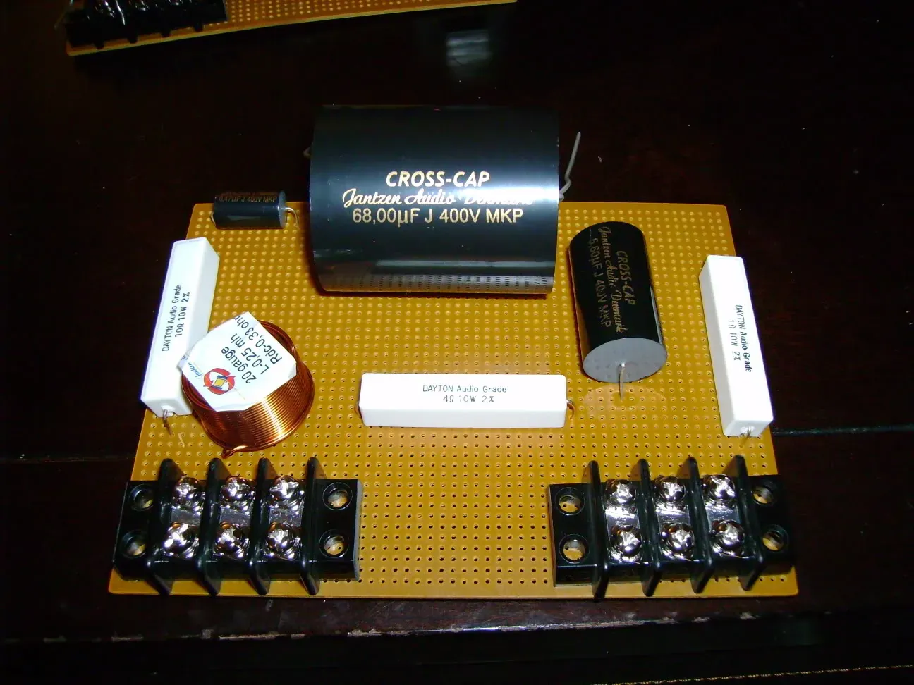

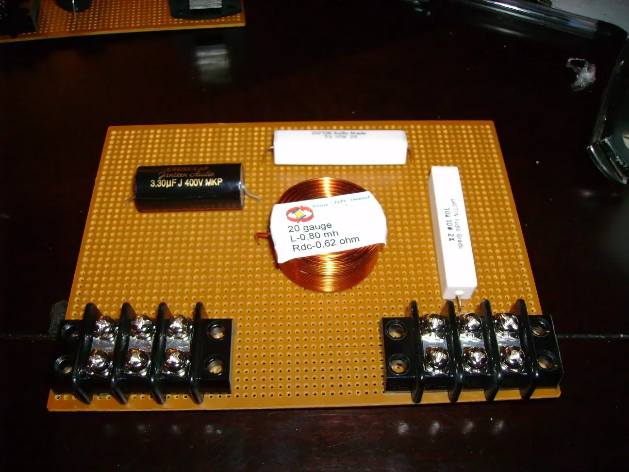

      Quick question: Anybody see anything wrong with this crossover layout for the woofers? I can't tell if the inductors are too close or not.
      The perf board is 4 1/2" by 6". The 3 barrier strip is input, the 5 strip will be for both woofers.
      Last edited by theSven; 24 June 2023, 14:03 Saturday. Reason: Update image location

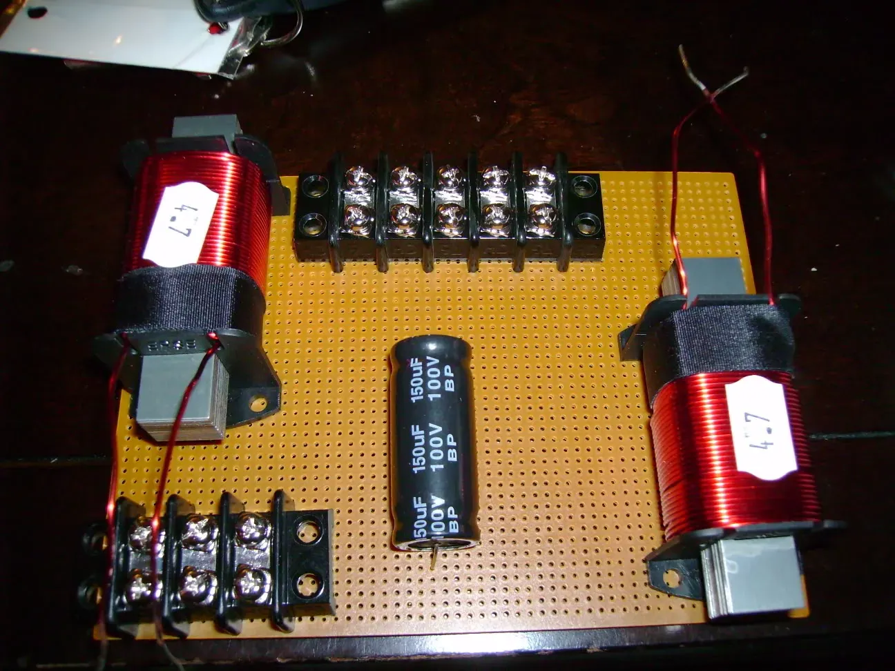

        And while I'm here:
        Midrange crossover:

        I miscalculated my barrier strips on my PE order. Luckily RadioShack has though for around the same cost and there are plenty of RadioShacks around me.
        I was worried the 4 1/2" x 6" perf board wasn't big enough to hold all the cap components but it seems like it can. And yes, I'm doing separate boards for the woofers, mids, and tweets in the minis and centers because well, I think it makes things easier.

          Your crossovers look very clean. We can't tell anything about the wiring but they look nice. Now to your questions:
          1. It doesn't make any difference if the ribbon terminals are on the top or bottom. Position them the way that works best for you. I usually position mine on top.
          2. All of the drivers should be flush mounted whether you position the 1/2" MDF on the inner or outer front baffle. Do not recess the drivers, just flush mount.

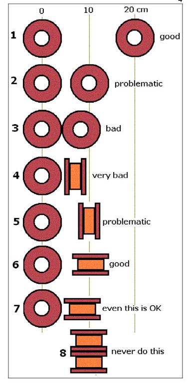

            Soldering is to be done this weekend. Nothing is currently connected. I was more wondering about the inductor spacing than whether it was connected properly. I'm an E.E. so if I screw up this, I just need to quit my job and go flip burgers or something. I've got to get more perf board tomorrow for the other 6 boards I have to do (3 for center, 3 for the other mini). This may seem like overkill but I just personally believe that if I'm going to do something, I'm going to do it right the first time.
            So no issues with the inductor spacing? It looks fine with about 3 or so inches between but you can't really change the mounting to effect field direction with those.
            And wow is the center channel Xover inductor for the woofer stage massive. PE also had to ship it to me in its own box with nothing else in it!
            Also, on Curt's page, the Xover network image shows C3021 to be 80 uF but the BOM only lists 68 uF caps and no 80 uF caps. I'm sure its been mentioned before but, the BOM is the most current right? Also, the statement center shows C2021 as the 68 uF and both C3021 and C2021 both have the same function so I'm assuming the network for the Mini Statements are just outdated. If it wasn't 2:15 AM I'd model the networks with a 68 uF and a 80 uF and see which most closely resembles the posted response curves.

              Inductor Placement
              -David
              As we try and consider
                Inductor spacing is always tough to get as much space as I like but you just do the best you can. I've attached a diagram that helps.
                Nope, the crossover networks and BOM's are correct and up to date. There's also a 12 uF cap listed in the BOM with no place to go. Parallel the 68 uF and the 12 uF for the correct value. Jantzen didn't have a 80 uF value so I paralleled them to create the correct one. Sorry I didn't indicate that in the notes on the BOM.
                Things are looking good!

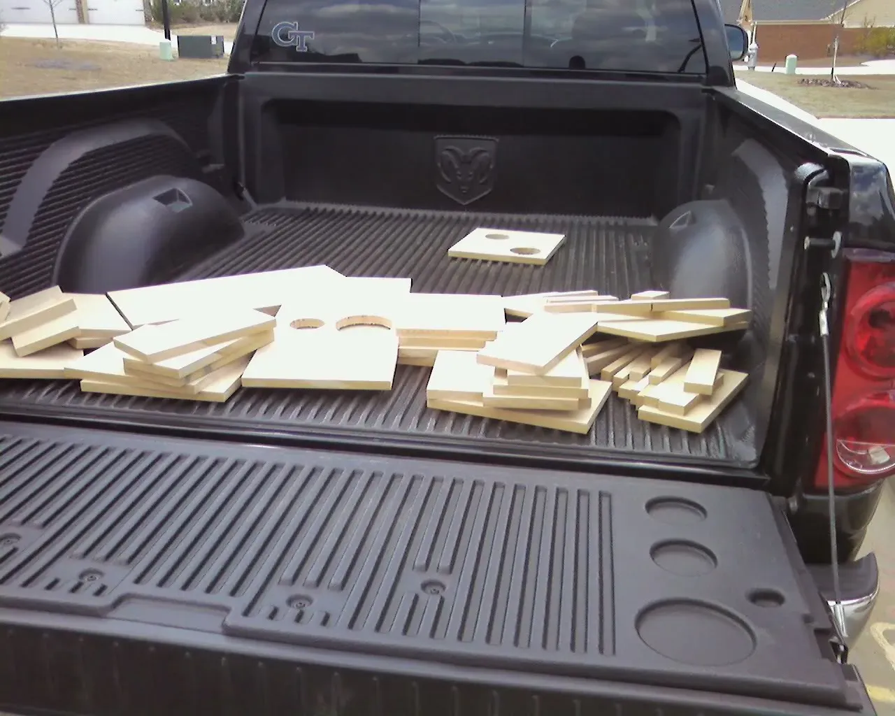

                                              All the big sheets are cut down into the pieces. I took a few pics with my phone I'll upload later. Going to get a circle cut guide now and then going to make the necessary cut-outs and then start assembly.
                                              That is a bunch of wood! I ended up getting a whole sheet of 1/2" MDF and only needed half a sheet for both the center and mini-statements (I had Lowes cut the sheet in half and didn't even touch half of it). Oh well!

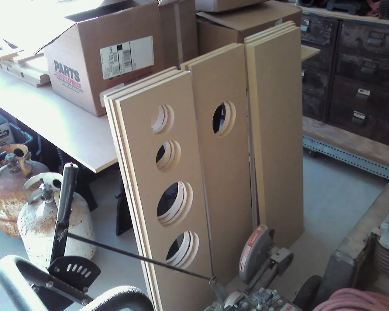

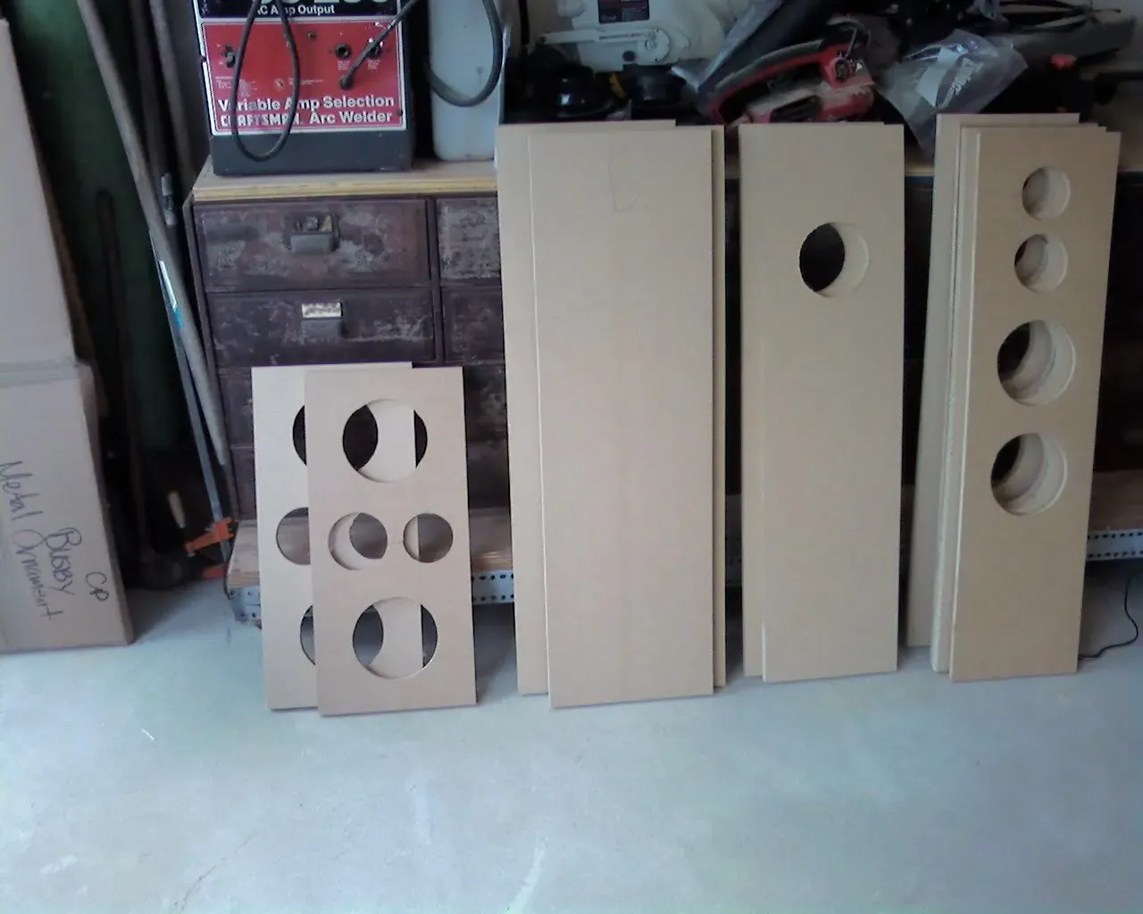

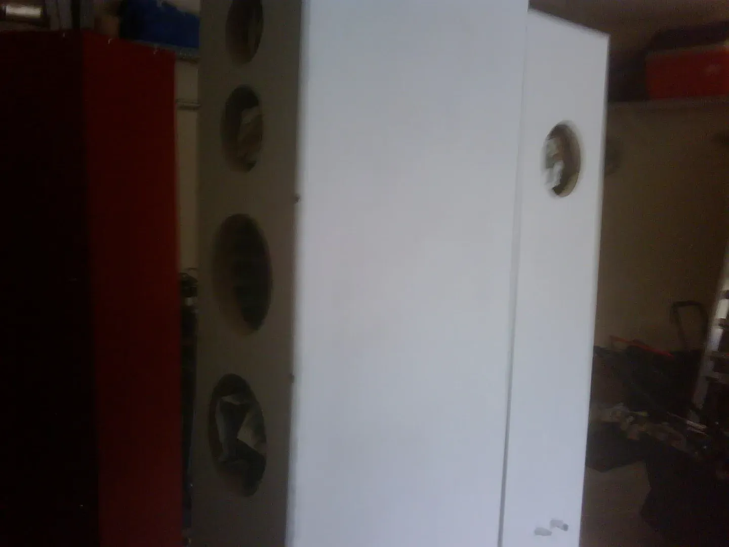

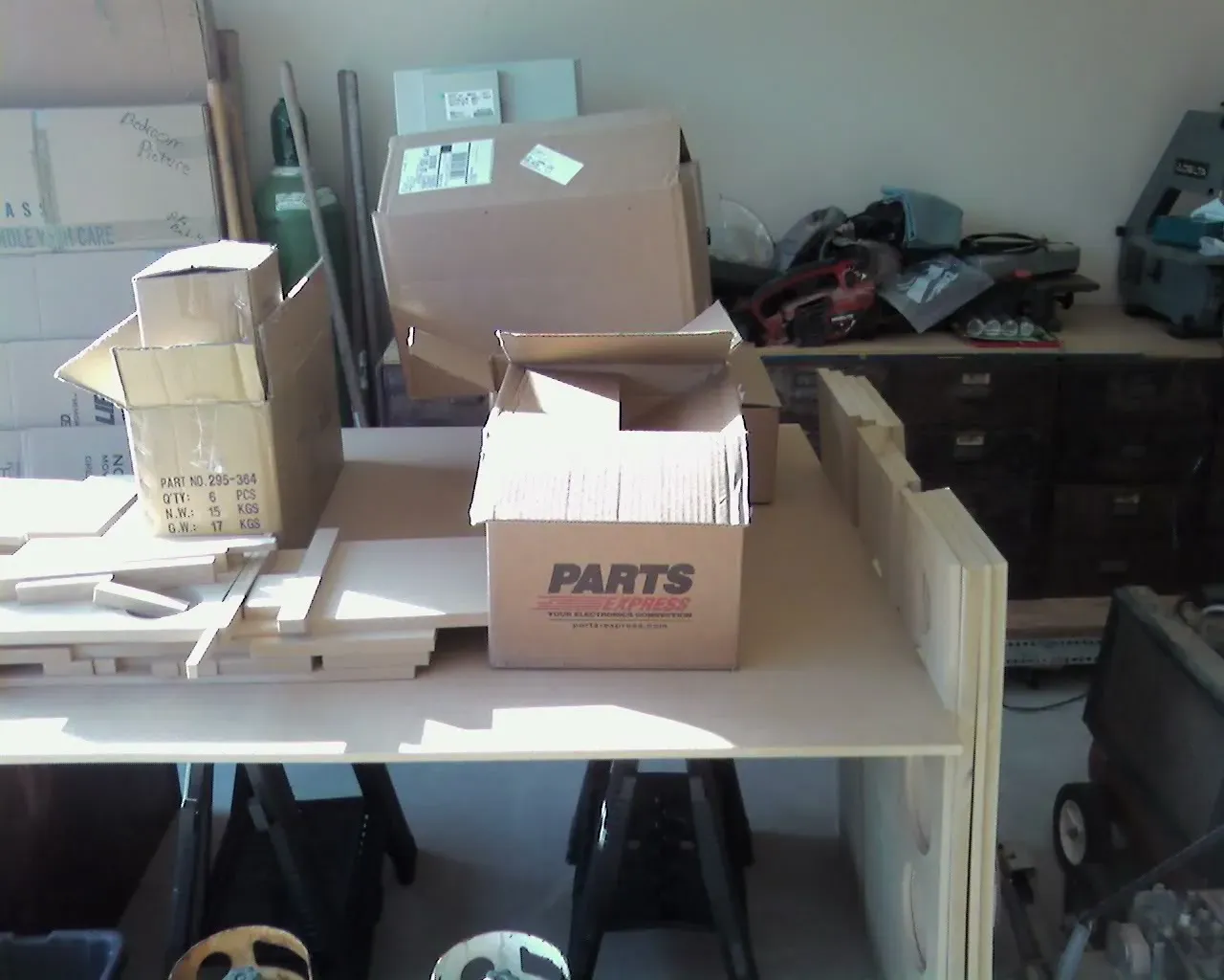

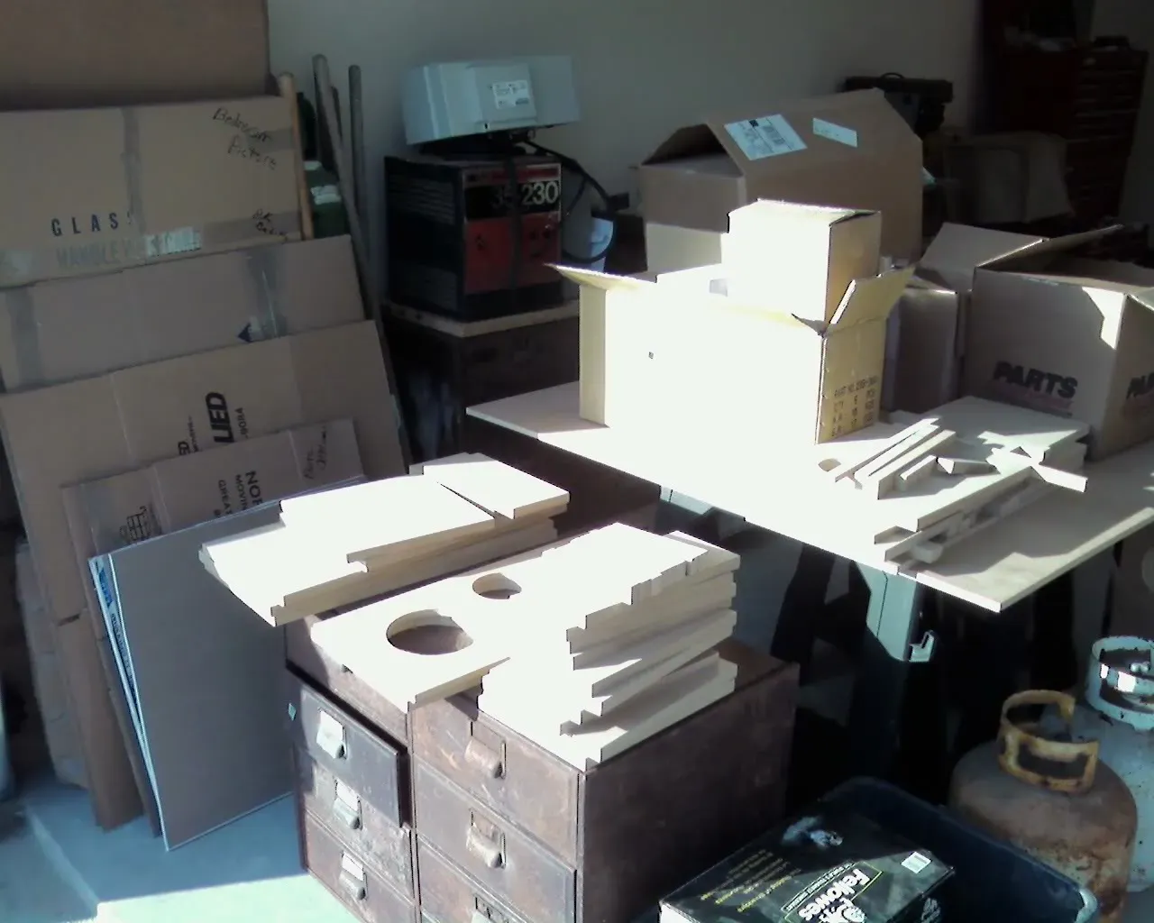

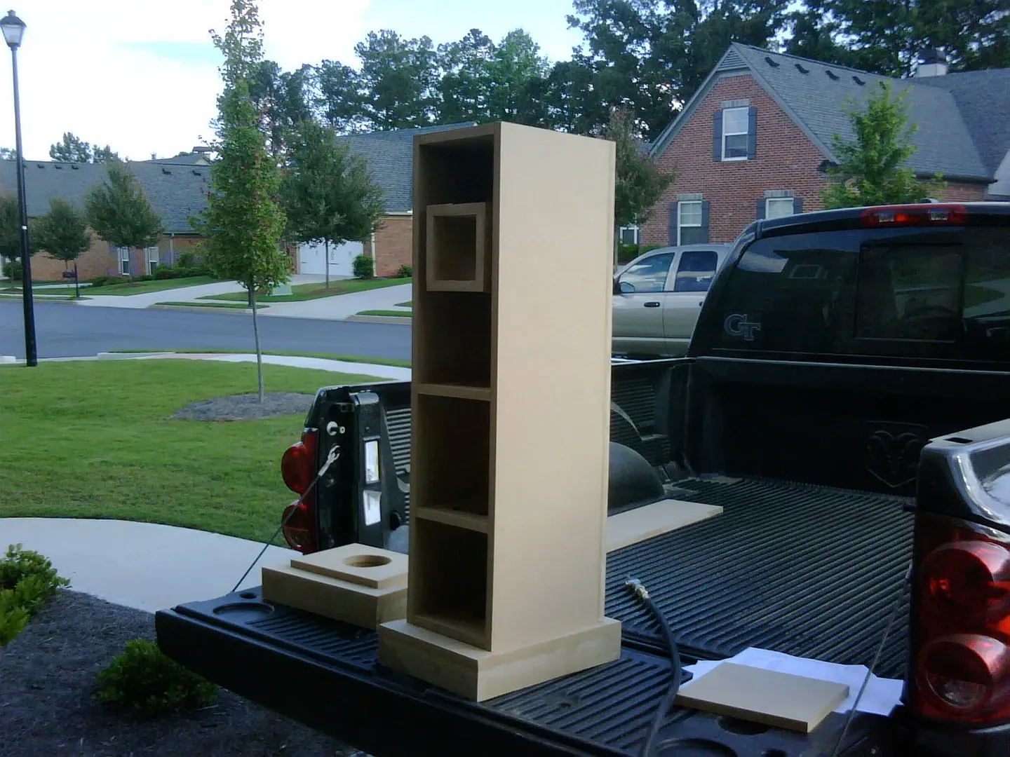

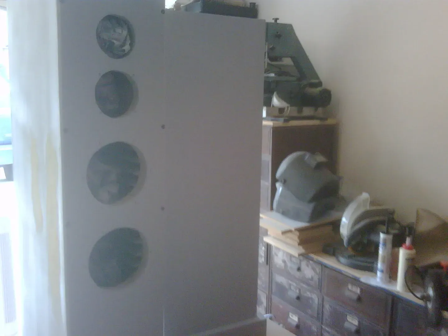

                                                        Day 2 is over and well, all the cuts, holes, etc. are cut in the wood and everything is labeled and ready for assembly next weekend. The holes that were left took longer than thought.
                                                        So now for the pictures (sorry for any quality issues....I used my phone to take them)

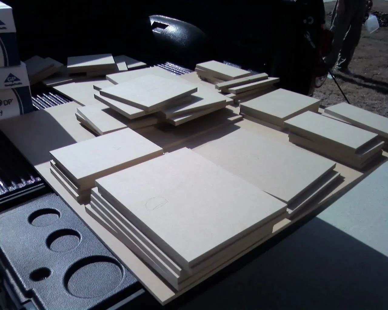

                                                        All cut up from the sheets:

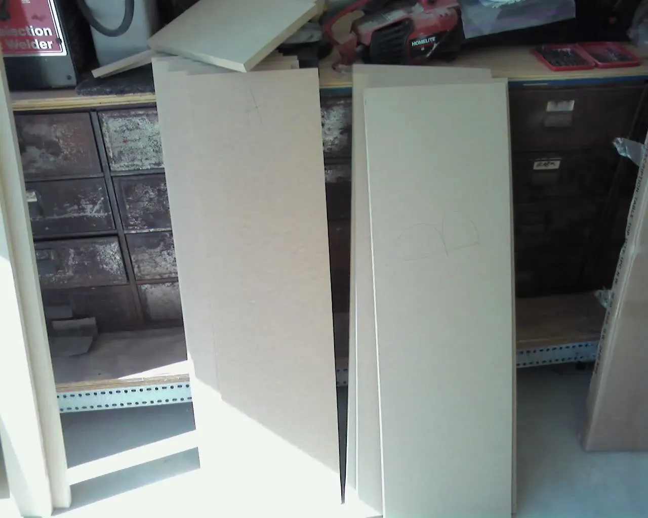

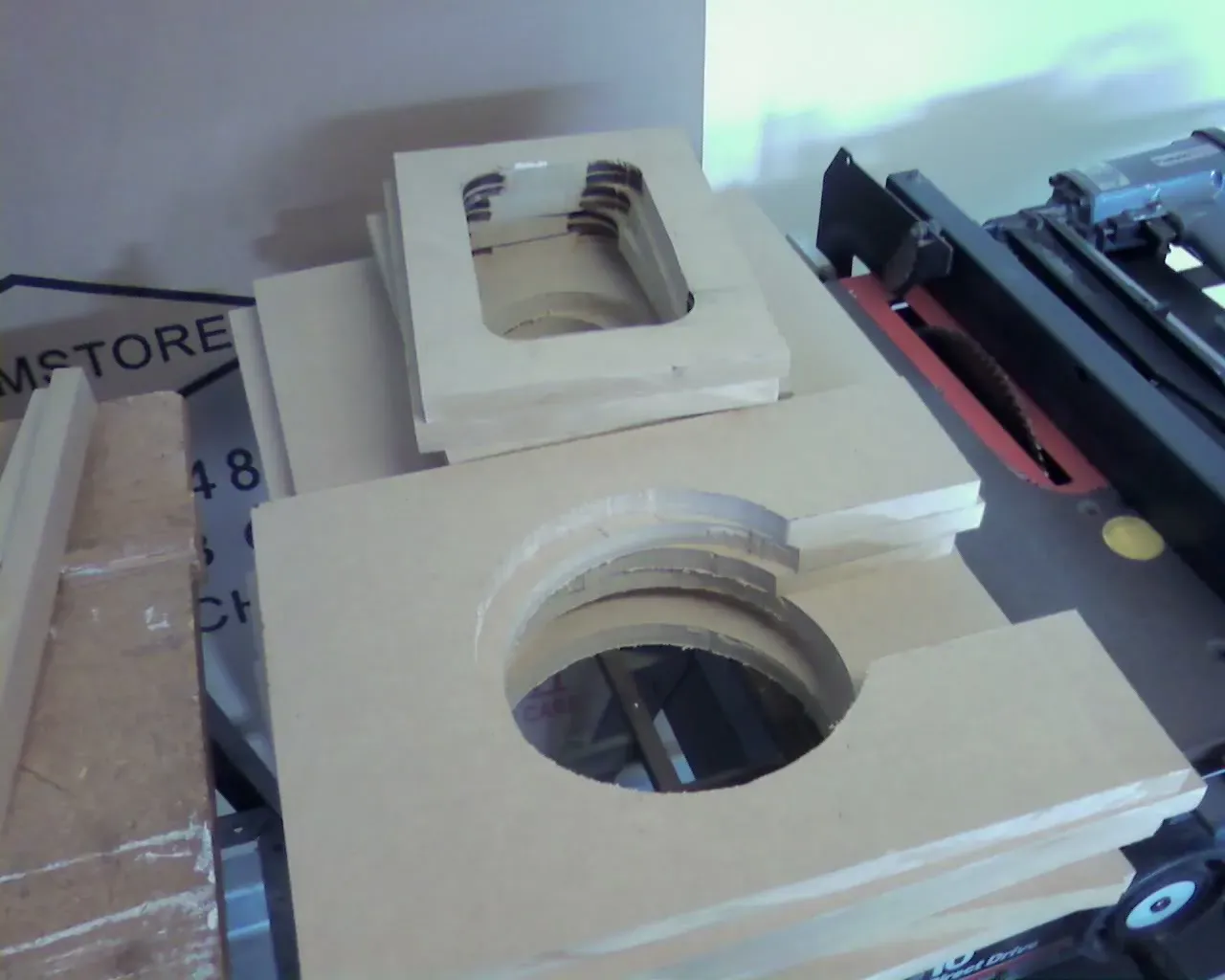

                                                        The bigger pieces leaning waiting for holes to be cut:

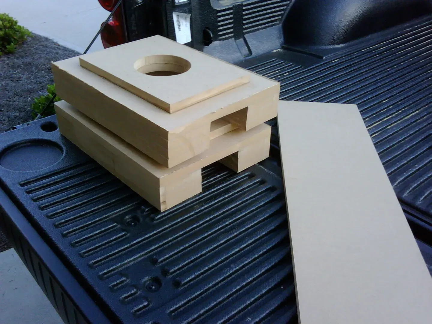

                                                        Baffles and sides and such after the holes were cut out today:

                                                        Stack of the base pieces and internal bracing. And yes, that is burnt MDF on the braces. Nothing like the smell of burnt MDF! The holesaw would cut so for long before burning it up. Was definitely interesting:
                                                        Back of my truck with all the pieces and some scrap there. Was before we relocated all the pieces into the garage for storage this week:
                                                        Stacked and stored for the week:
                                                        I'm making these up at my parents since I don't have the tools or space to do it so my dad is going to clean up some of the holes during the week this week and hopefully get them assembled next weekend. Still have to figure out the best way to do the flush mounting though.

                                                                    Assembled cabinet minus base:

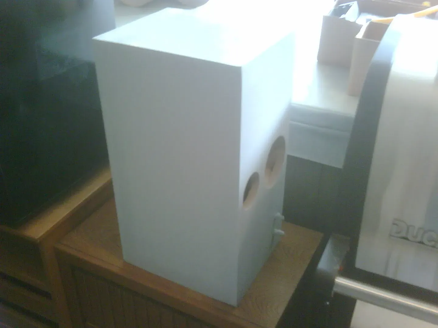

                                                                    Assembled, primed and ready for paint:

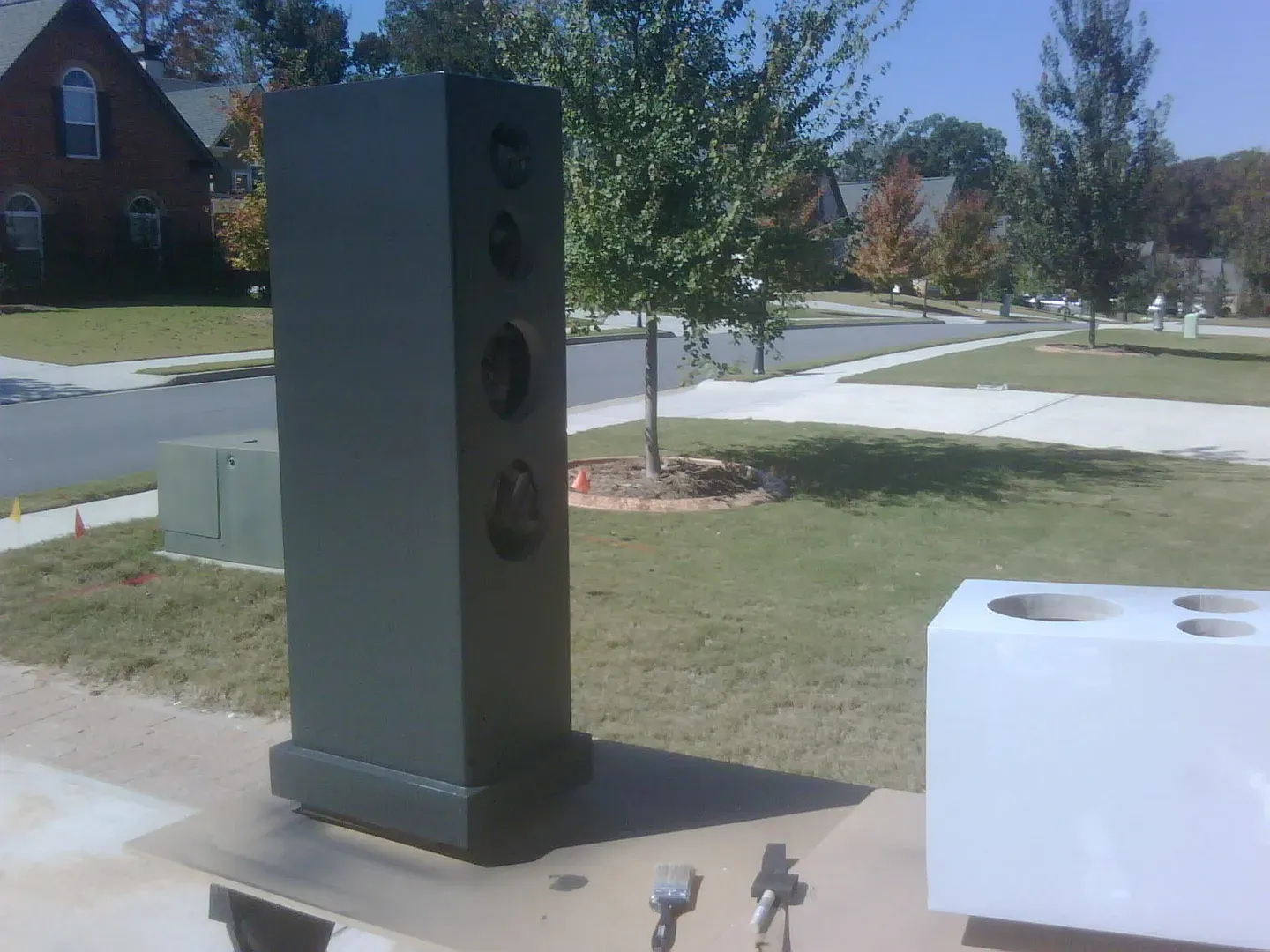

                                                                    Painting:

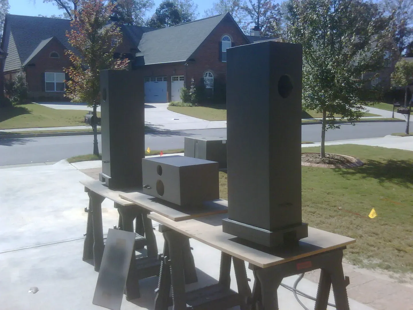

                                                                    That was coat Forum of 3:

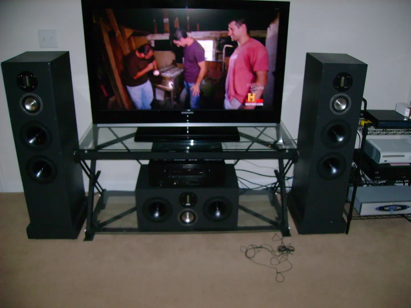

                                                                    In my apartment finally!
