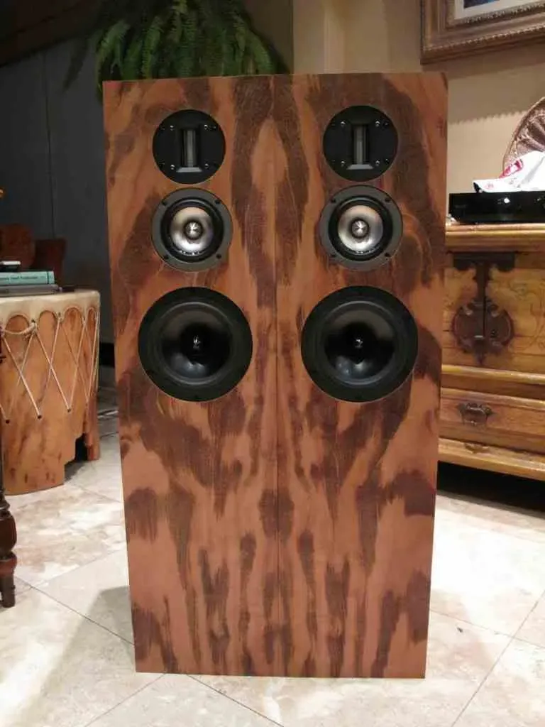

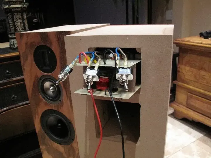

    Well I have found time over the last few weekends to complete the crossovers for the TL's, and with a day off this week, was able to throw together the whole center channel along with its crossover boards el quicko. I never got any response regarding different resistor or capacitor values for the TL version of the monitor XO, but went ahead and made the switchable version so I could have some room to play. Also since I went the diy PCB route, I can swap components quite easily if necessary in the future. I ended up having to create double-decker boards, and had to enlarge the opening so they would clear with a standing air coil inductor. I forgot to grab some photos before I popped them in to finish the speaker wiring, however I will take some when I pull them out to complete the veneer and finish.
    I stuffed the TL's with one bag of AcoustaFil each, however it required quite a bit of tufting to get a bag to stretch far enough to fill evenly, and I feel I could still use some additional directly behind the woofer.
    Overall, though I have only had a brief few minutes to hear the TL's last weekend, and then the CC this morning, I'm impressed. The sound is very omnipresent, yet detailed. There is of course of details I still need to finish before I can officially listen to them like foam sealing the woofers and mids, along with lining the mid tunnels. Then of course there is the real fun part, sanding and finishing. 8O
    TL Switchable XO (as far as I could pull it out w/ the speakers attached)

    TL's Built Out

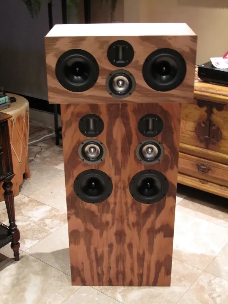

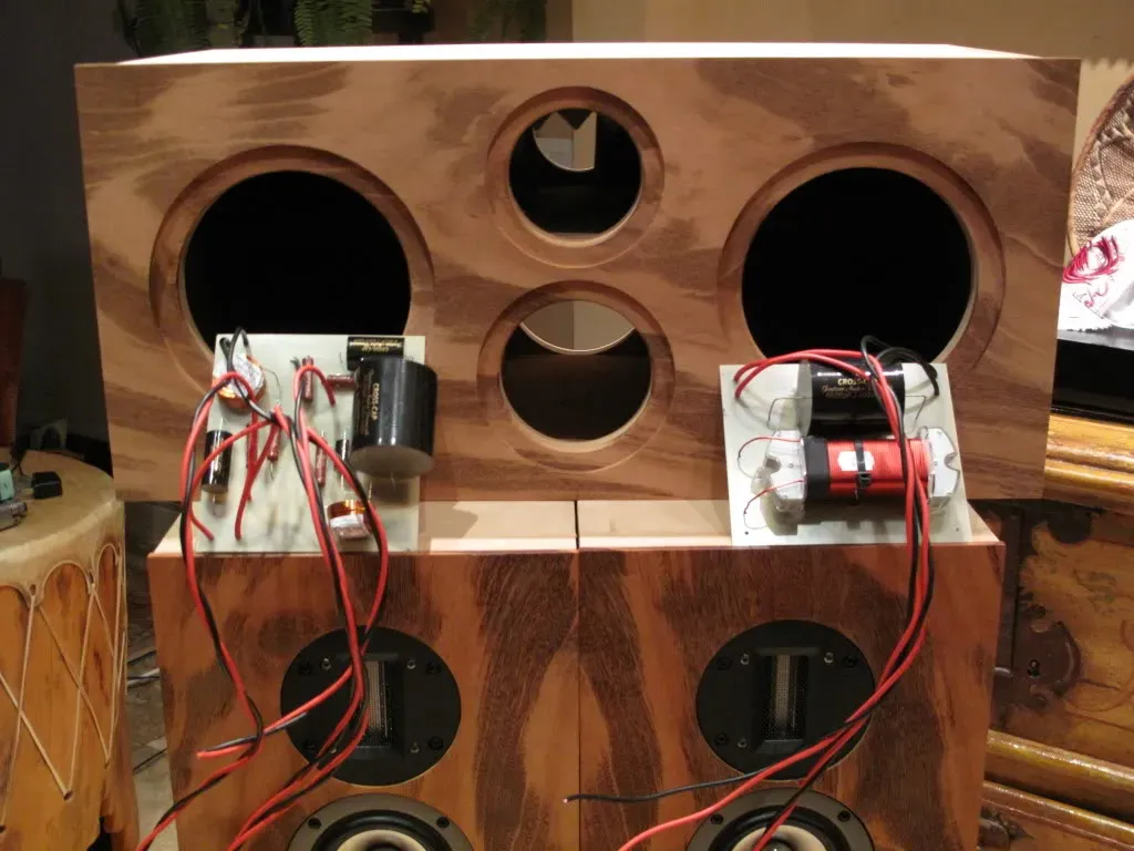

    Center Channel XO Boards and Box ready for final wiring.
    The Three Amigos. You can see the difference in coloring once the wood has oxidized as seen on the TL's.

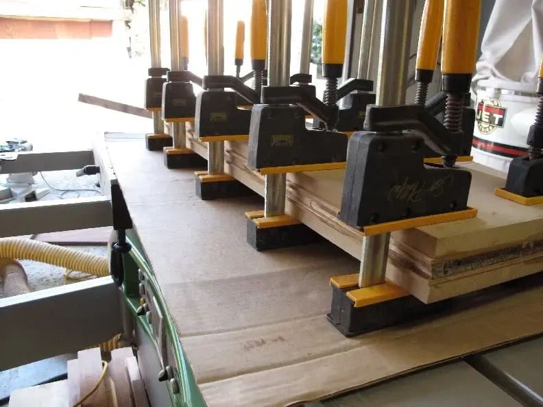

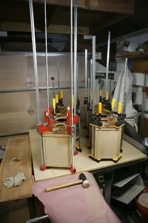

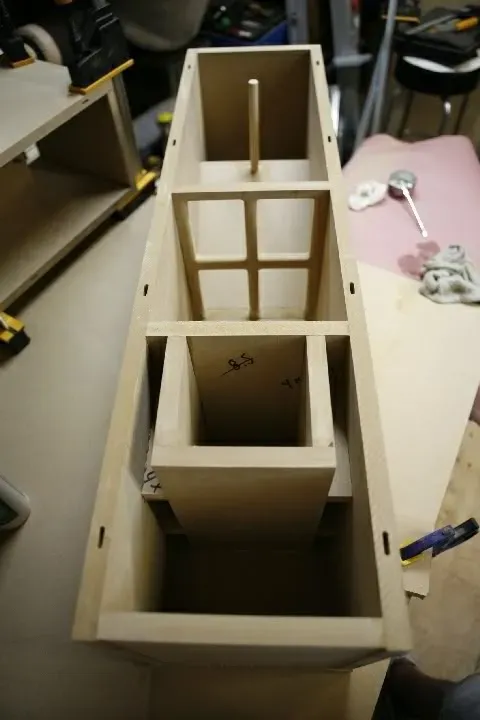

    Post 4 (9/24)

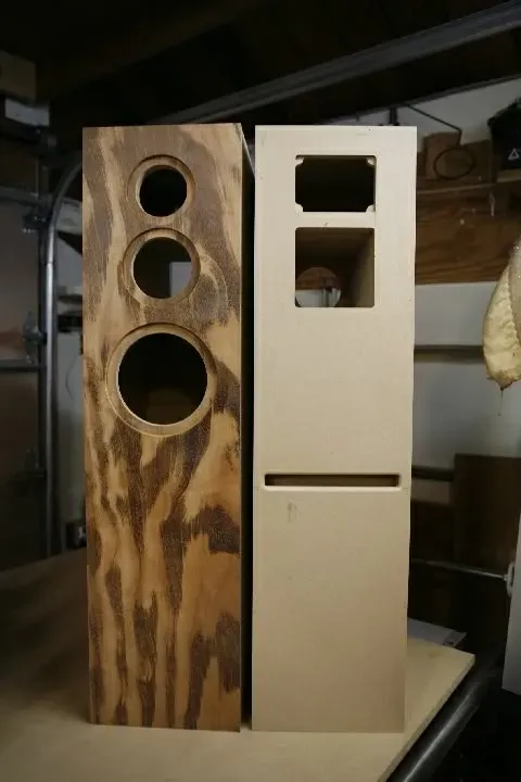

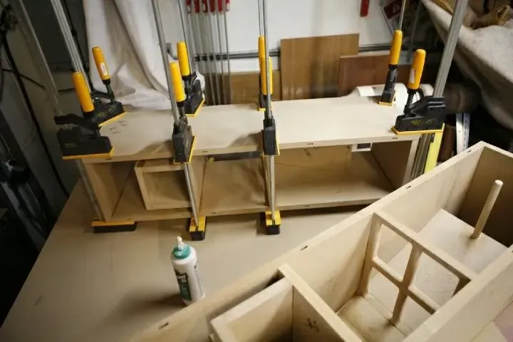

    Well I made time to route the baffle and make the window-brace, along with a jig for the boring dowel hole through the TL divider at 21deg.. I also decided to domino the front and back to the sides to make glue-up and alignment easier. Anyhow, with everything ready to assemble yesterday, I spent a late night gluing up, and luckily everything went together without issue.
    This afternoon I had time to un-clamp and flush trim the back and sides. I ended up using a rabbeting bit to flush the MDF portion of the front baffle to the sides leaving a 3/64" overhang on Goncalo so that if I decide to veneer the remainder it will hide the glue edge, and i can flush to the veneer. Next, I finished up by routing the tunnel openings, and I made a quick template on the mill for the crossover cover plate opening, and finished up by routing that opening.
    Parts Routed and Ready for Glue-Up
    Dominoe'd
    Glue-Up 1
    Glue-Up 2
    Glue-Up 3
    Results of Today

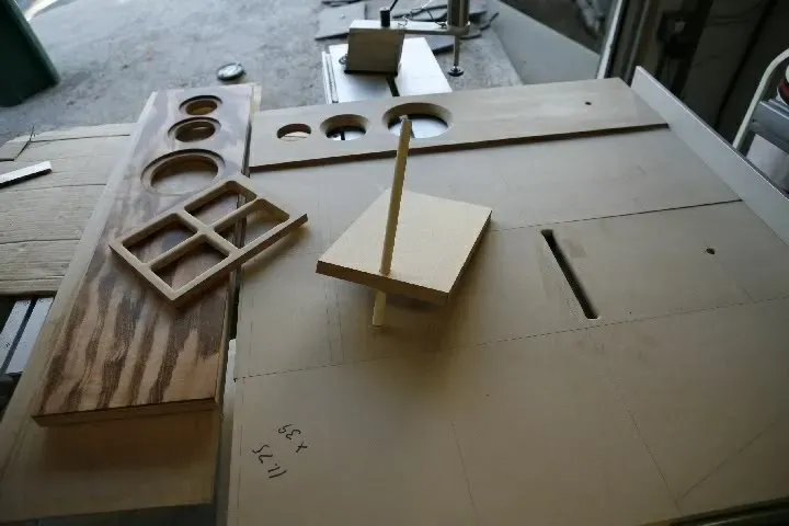

    Post 3 (9/19)

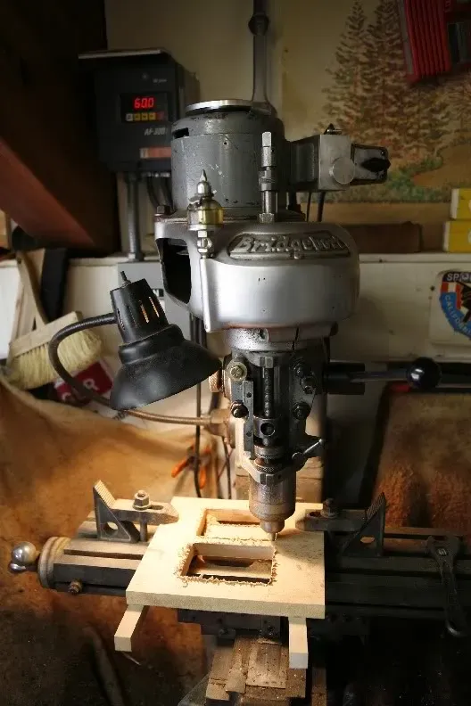

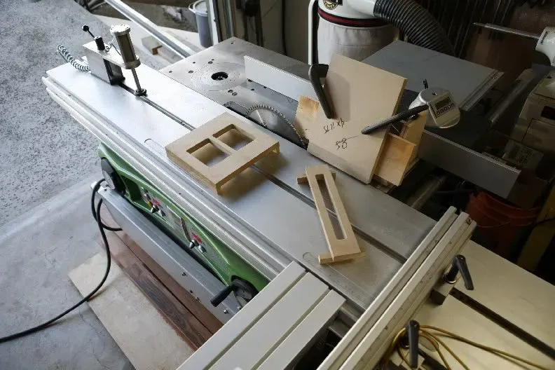

    I swear whenever I get free time to work on a project, something else comes up, and I get side-tracked. Anyhow I had offered to build an plasma stand/ A/V cabnet for a friend so that ended up taking my last weekends these last 2 weeks.
    However I had some time yesterday to build jigs and also resaw some Goncalo and MDF so I could glue up my front baffles. Here are some pictures of the progress.
    Machining the 1/2 template for the internal brace
    Finished preliminary cuts and jigs (3rd jig is for the terminus opening)

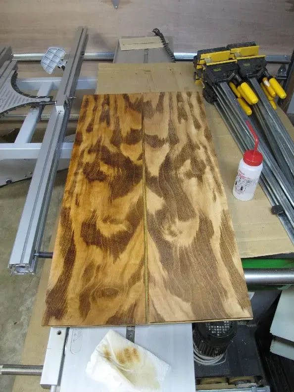

    Baffle glue-up, the finish planed thickness of the resawn Goncalo ended up being 5/16- so resawed and planed some mdf to meet final 1 1/4" baffle thickness
    Wiped some alcohol on one piece to show some of the coloring, however once the wood has oxidized the body will be a deeper orange-red, and the dark patches nearly black

            Well, finally some progress and I took some pictures since I see you guys like them.

                Update to show progress.
                2 Questions:
                1) I know foam goes inside the mid-tunnel, but is there a radius or bevel on theback edge of the tunnel?
                2) (Curt will probably have to answer this one) Is the crossover the same for the Statement Monitor or has it changed for this version? If so is there a diagram for this model ?
                Thanks guys.
                • Biermann
                  • Aug 2009
                  • 51
                  Getting there, though I have some more questions.
                  1) I was wondering if I should line the back or sides in the upper region around the TL woofer with wedge foam a la center channel, or is the fiber fill accomplishing the same thing?
                  2) Is there any issue with the speaker wire or interconnects proximity to large inductors?
                  3) How critical is the mass of base for the TL's since it is not part of the port system?
                  4) How much will the sound suffer if I only put a 5/16" roundover or bevel on the front baffle?
                  Thanks.
                  • Curt C
                    • 792
                    1) I think the stuffing is sufficient, but there is certainly no reason you can't line the walls as well. Certainly it has the potential to improve things.
                    2) No
                    3) It's not, although in some situations the additional mass will ameliorate energy from transmitting into the floor.
                    4) Likely any perceived difference will be minimal.
