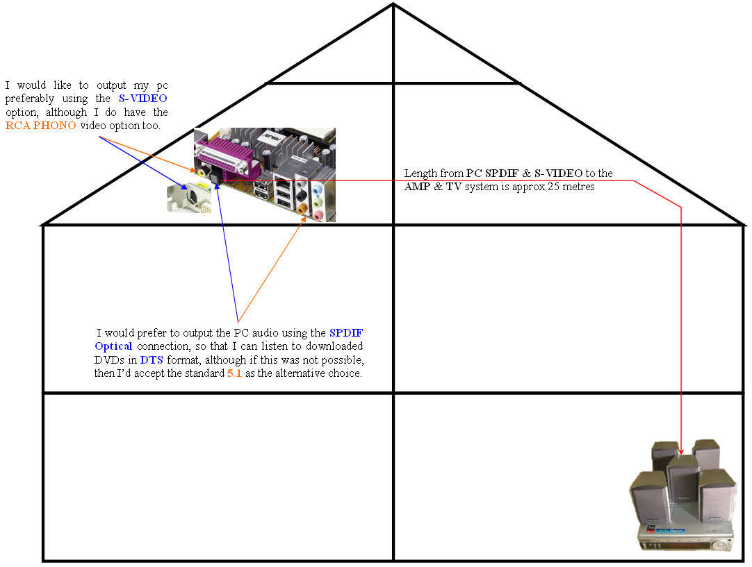

    Its a long and boring process and the time has come for me to connect my pc directly to the TV & Amp. The only problem is that my PC is in the LOFT, 3 floors up and my TV/Amp are located on the ground floor (approx 25 metres distance).
    I've attached a picture below to show you the layout.
    I would like to know if I moved the pc slightly closer, so that the distance is approx 50ft away, is it possible to using a 50 foot toslink cable and a 25m s-video cable to output the DTS sound to my amp and the S-VIDEO to my TV?
    If so, will the quality of the output be affected much? ie will the video be jerky or sound cutout in anyway?
    If you think that this is a bad idea, then what method would you recommend I use instead?

          1) I would utilize a Toslink Amplifier/Repeater for that particular distance.
          2) S-Video run should be fine.

                    Something you may want to consider is to get a toslink>spdif converter and a spdif>toslink converter.
                    Toslink cables are relatively expensive compared to coax. The cost of the shorter toslinks, two converters, and long coax may be cheaper than two long toslink cables and a booster/amplifier. Just something to consider...
                    If you are concerned about the S-video, there are breakout adapters available that come out from the gear in normal S-video connectors and then transition to connectors that allow you to span the long distance with full-sized coax, then adapt back down to the normal S-video connection at the other end.
