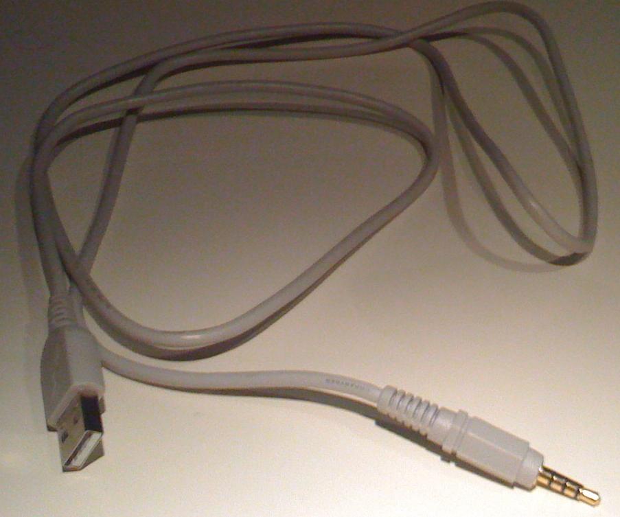

    Does anybody know where i can find the connection cable for remote control of the c2 parasound? Is an Rs232 cable to 3.5mm jack (with 2 or three rings?) My seller send me an USB to 3.5mm jack with three rings) on a box but my laptop does not recognize it at all. Maybe an Rs232 converter is missing? My cable its only a cable and does not seem to do any convertion. Is there any diagram to make a cable?
    I attach a photo from my cable
    Also i download the last software version for C2 v1.1 and i didint find that has the last changes such lipsync and dsp modes ( IIx ) or tone frequencies either. Is that missing or is that me i can not find it?
    Thx

    You need a 3.5mm stereo plug to 9-pin female D-sub. Note that this is not a standard off-the shelf cable. (I have a few of these special cables. PM me if you need one).
    If your computer does not have an RS-232 port, you will also need an USB to RS232 adapter.
    The cable in your picture will not work unless you snip off the USB connector and replace it with a D-sub connector...
