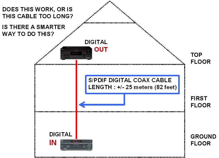

I've included a JPG file here that shows a sketch of what I want to do. As the graphic shows, I've got a Home Theater receiver on the top floor of a house, and another HT receiver on the ground floor. I want the ground floor receiver to "see" the top floor receiver as a digital input - in other words, I want to listen to the music output from the top floor receiver via the receiver on the ground floor. The distance from the digital output of the top floor receiver to the digital input of the ground floor receiver is approx 25 meters (82 feet). I believe a cable run of 25 meters is too long for digital optical cable (Toslink), so I'm thinking digital coax is the right way to go. Does anyone think that 25 meters is too long for S/PDIF digital coax cable? Is it necessary to amplify the digital signal along the way? (is a "repeater" necessary?) Many thanks for your opinions and advice, cable experts! -- ToussaintToussaint 1800- Bottom

Clearly the run length you are planning is at the outer limit of the SPDIF specifications - so some hardware will work with it and others not. Also you will not be able to use any specialist high quality cable (too expensive). I recommend that you get your cable intallation people to make a up a 25m length of reasonable quality 75 Ohm (Beldin etc) cable and try it with your recievers before you run it though the house (save money if it doesn't work) as I am not aware of any domestic extenders etc for SPDIF links...
As an alternative there are a number of products that broadcast the digital signal over an 802.11G Wireless network... and you can get recievers at the other end... However this technology can be a little complex to set-up...

Hi Geoff - thanks for that reply. I've been shopping around the web and I found a cable company based in Spokane, Washington that proposes custom length SPDF digital coax cable : (http://www.cobaltcable.com/product/index.htm). 100 feet of SPDIF digital coax costs $258. But it would be a shame to spend the money and later discover that it doesn't work. About that wireless configuration you mentioned -- would that transmit a digital signal point to point? Can you tell me who manufactures these products? I was thinking about avoiding a wireless solution because I'm afraid of line interference, but I could easily be wrong - I'm a newbie to this stuff!

Geoff - By the way, I forgot to mention that I've already tested the link between the two HT recievers with both SPDIF digital coax and SPDIF toslink cables. The cable length tested in both instances = 30ft (9.14m).
The two systems were in separate rooms, and the sound from both systems was crystal, really good quality (in my humble opinion). According to my (simple) reasoning, I'm just trying to multiply that cable length by 3. I'm thinking : Surely a digital audio signal should be able to travel that far, right? Wrong? Hmmmm ... not sure ...Toussaint 1800- Bottom

I've just checked the specs for three wireless digital transmitters and while they all have TOS Link and Coax SPDIF interfaces they only support MP3 and WAV style files (CDs) not DD or DTS - so this leaves the cable as the likely best choice...
I guess you are going to have to take a punt and order the cable - the fact that you have got 10M to work is a good start... I'd definely get Coax... Good luck!

That's fairly expensive. I would suggest you use 75 ohm quad shield RG-6 instead. A lot cheaper and very effective. It has a bandwidth that far exceeds SPDIF digital signals.100 feet of SPDIF digital coax costs $258
Radio Shack sells this in pre-made lengths of 100 feet terminated with F-Connectors - used generally for satellite instalations.
You can purchase very nice adapters to convert to RCA connectors. The adapters in gold are $4.29 and 100 feet of terminated RG-6 is between $35 and $45 dollars.

Bruce - Thanks very much for that. Interesting. So, if I understand correctly, you're saying that this "75 ohm quad shield RG-6" cable will carry the SPDIF signal a hundred feet or so, and I would just need those RCA plug adapters on each end to connect the cable to each receiver? Interesting. I wonder if anyone has actually tried that and got it to work? I'll have to try it.
