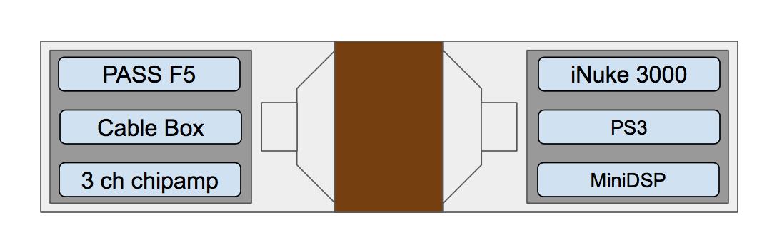

        I'll probably get the DSP version since it's not much more. Is the 3000 overkill? Seems like more than enough headroom and it's not that much more. I assume I'll run in bridged mode with the woofers wired in series for a 4 ohm load? Not sure how that works with the DVC.
        Also, here's a basic schematic of what I was thinking for the AV "rack" and how the subs would mount. Basically, the two subs would face each other with a grill covering the opening to the front. On the driver sides, they would be open to the rear obviously, probably will a grill as well since it goes into the garage which may be dusty.

          Looks like your having fun planning.
          Not sure if your Stereo Integrity 18's are the dual 2ohm voice coil drivers but bridging an IB just adds distortion which is kind of counter to IB's very low distortion concept. If your running the iNuke 3000 usually 1 side of the amp for each driver. If you want to add another manifold placed else where just get another 3000. Another thing to note is the DSP version is only filtering 20Hrz and up. If you want to eq below 20hrz you should look at other dsp and just get the amp version. That kind of brings up the other question are you interested in below 20Hrz performance as that takes more power and you will need measurement gear capable of measuring below 20hrz. Tuning that thing starts with readings in the manifold, then at near field then at seating position. Check in at the Cult, http://ibsubwoofers.proboards.com/ it will help with your planning and help you focus on the kind of performance target you want to hit. Since you have a space behind the rack you can locate the not so pretty pro gear back there and just trigger it when needed. You will find after your tuned you don't really change much on the eq side. If you go with the Inuke dsp it is usb to a notebook which is convenient when the amp is located in the back room.
          Have fun and keep showing us your progress!

            Yes, I have the dual voice coil 2 ohm drivers. I'm planning on miniDSP which only goes to 20Hz via PEQ but I think you can go lower with biquad programming from what I read. And I also plan on only using 5 surround channels so I *think* I can have a second sub output. Otherwise, I'll just Y the one sub channel to the two amp inputs and I suppose wire each channel to the voice coils in series for a 4 ohm load. I'll read more about the power requirements below 20Hz and see if I really want that in the first place and if so what power requirements to shop for. The room is only 12'Wx20'Lx8'H and I have neighbors on the other side of the wall so the 3000 may be a good place to start. Especially given my Pass F5 is only about 25W into 8 ohms. The line arrays are supposed to be pretty sensitive though so we'll see if that's ok or if I need to plug my Aleph X's into them!

              Sounds like you got it covered, I have 2 outputs off my pre-pro but Y cable should be fine as long as your source spit is enough for the pro amp. I have the same drivers with the 300 Inuke DSP in a 16'x8'x35' room and I could bust windows if I wanted too. I only have 1db of gain between 30 and 35 Hrz so I'm not boosting the bottom end at all. If you get a chance to measured or listened to a box sub placed in your proposed location, it could give an indication of how much eq you may require with the IB and show any large nulls at your seating position associated with your chosen manifold position. If you can't test and have to roll with that position it's at the center of the front stage and should be workable though.

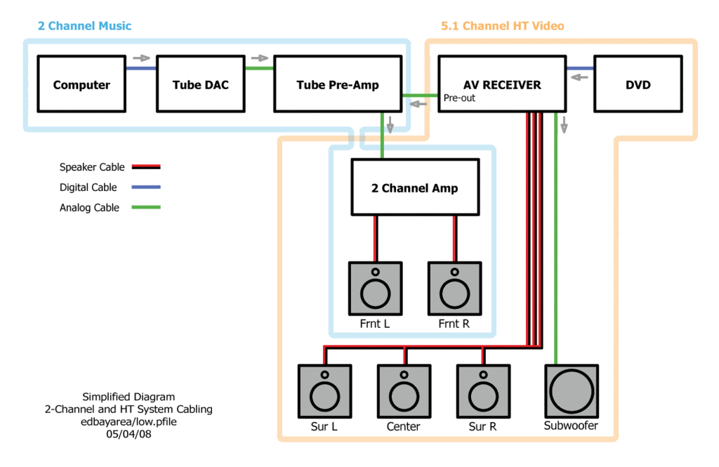

                            Dar47, I don't quite get the theater bit.
                            Say you are going to view a movie in 5.1 from Netflix on your HTPC. Could you explain what signals go out from the PC and where they go?
                            Edit: Hmm, did you write wrong here? "the pre-amp passes through the front mains signal to a Marantz AV7005 pre /pro"
                            From what I find that other does it seems as if they do the following:
                            1) For stereo playback they pass the signal from the source directly to the pre-amp. The pre-amp passes it to the amplifier.
                            2) For multi channel playback they pass the signal from the source to the AV processor. The processor does all signal processing and passes center, sub and back channels to an amp as in a regular HT setup. But the left and right channel are sent to the pre-amps HT-bypass. The pre-amp then just forward that signal unchanged to the amplifier connected to the pre-amp.
                            I assume as you have a sub out connected to the pre-amp that will just be deactivated and that the AV-processor also is connected to the sub(s).
                            I think this illustrates my understanding as this good. Are you setup the same (logical) or do you have a different solution?
                            Last edited by theSven; 01 April 2023, 16:34 Saturday. Reason: Update image location
                              Any source for theater goes through the pre-pro first then,
                              1. 5 channel amp for the center and surrounds.
                              2. for the front mains and sub out, it goes from the pre-pro to the XSP-1 then the xpa-2 and Inuke for base. When using these sources the bypass is engaged on the XPS-1 just passes the pre-pro signal through the XSP-1 to the XPA-2 and Inuke for base.
                              If you want just 2.1 through the dac from say the blue ray, I run an optical cable to the dac from the blueray as well as having a HDMI to the pre-pro,
                              1. set the blueray audio to 2 channel and put the XSP-1 in direct mode so the audio goes from the blueray to the dac, then XSP-1, then xpa2 and inuke. (no audio from the pre-pro). video goes HDMI through pre-pro to the TV.
                              2. Music I just go Mind 180 to the dac and through the XSP-1 to the xpa-2 and Inuke for base. xps-1 is in direct mode and the pre-pro isn't on.
                              So any source you want direct through the dac and not the pre-pro for audio (which is inferior to the dac) goes to the dac then the XSP-1 first and the XSP-1 is in direct mode.
                              Some pre-pros and receivers can pass through to but why pass through if you can go direct and just send video from the pre-pro. If you don't need video just go direct to dac and preamp. Pre-pro is off.

                                                                  I'm a bit curious about your plan for room treetment as well as speaker placement.
                                                                  Maybe you could update your drawing with that information?
                                                                    The front will be the corner loaded line arrays so literally in the corners on the left wall. The French doors will have heavy curtains which hopefully reduce the primary reflection on that wall. The opposite wall I'm planning some canvas photos wrapping DIY insulation panels. I may try a bass trap of some kind on the rear wall in the corner but haven't gotten that far yet. Initial thought is a DIY corner trap that looks like a corner table.

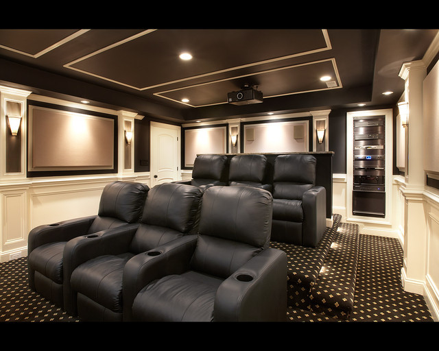

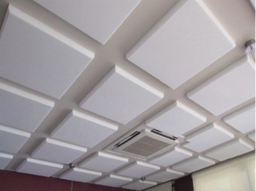

                                                                                Are you sure that you won't go 7 + atmos? If you think about the sorrund channel mostly as effect channels you do not have do go that high on quality. Also, as you probably will be using high quality external amps for your stereo, you will probably have some extra amp channels available in the receiver ;-)
                                                                                You might also consider adding one sub signal wites to each corner to have the option to install subs there at a later time...
                                                                                Regarding roof and ceeling you should consider first reflections. Huge rug on the floor will help. If possible I would have added some acoustics measurement to the first half of the room (or more).
                                                                                You have several options, some of them might even be approved by your wife ;-)

                                                                                For a home theater in a living room I think there are many solutions that might look good without making the room look "unatural", but it does take some effort to find something you like.
                                                                                When it comes to sound I think the roof is a huge area that can be used to improve the result a lot. You will also get a living room that is comfortable to be in as there will be little echo ressonanses in a room with good sound treatment.

                                                                                            nCpre signal wiring
                                                                                            This is a little bit of a tangent, but does anyone have a recommendation on how to wire the nCore signal cable? From the data sheet, it looks like the signal wires go to pin 2 and 3 and pin 1 goes to the chassis. Also, it has the shielding going to the chassis as well as the fourth wire in the cable assembly. Can I have the shield and pin 1 and the fourth wire all go to the same point on the chassis?
