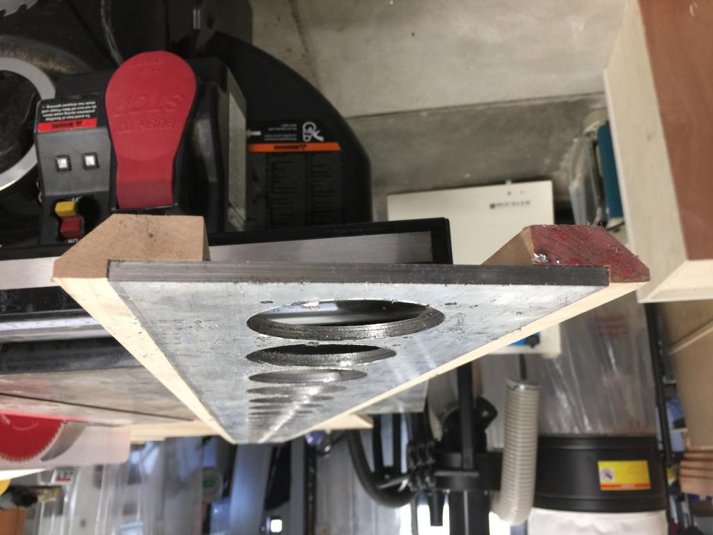

        #183
ID:	863228Got the other side driver holes cut out. Hole saw still going strong. Forearms are sore from deburring both sides of 56 holes.
        Also, got the side strips milled out. Need to drill the mounting holes to connect the baffles to the strips and also the holes that will accommodate the screws that go into the walls next and maybe mount and wire up the drivers!

            #185
            The hole saw is a Freud Diablo. Carbide teeth. I'm surprised it's lasted as long as it has as well. I took my time though. Used the lowest possible speed on my drill press. Paused twice or three times to apply cutting fluid. And actually, I found that once I got the hang of "hearing" when the tool was happy, there were a few cuts that went straight through without stopping. I didn't risk that until the last few holes though so I'm actually not sure if it was happy or not but the chips looks good, the saw seemed to cut with less effort, and there was less vibration. I also bought a DeWalt version thinking that I would need it after the Freud was used up but no need!
            I'm mounting the drivers with nuts/bolts. Trying to isolate them a little from the baffle with O-rings and washers as well. I'm hoping all the holes are accurate enough (or have enough play) that I don't have any problems mounting them up. Might get to that milestone this weekend!

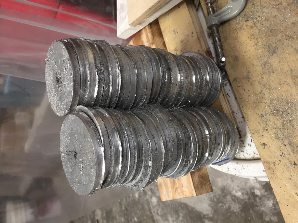

ID:	863229Any ideas as to what to do with 56 1/4ā€ thick 3ā€ diameter aluminum discs?

                    [ATTACH=CONFIG]27842[/ATTACH]Any ideas as to what to do with 56 1/4” thick 3” diameter aluminum discs?
                    Monitor stands?

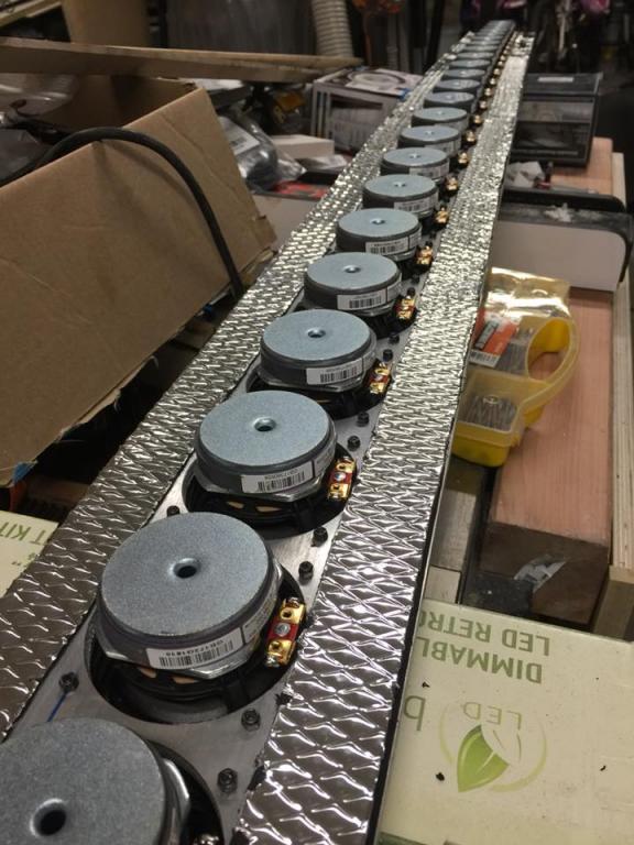

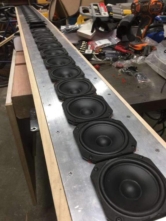

                      Drivers getting installed.

                        wow... that is intense
                        • chrisn
                          • 175
                          #192
                          That's a lot of screws 8O

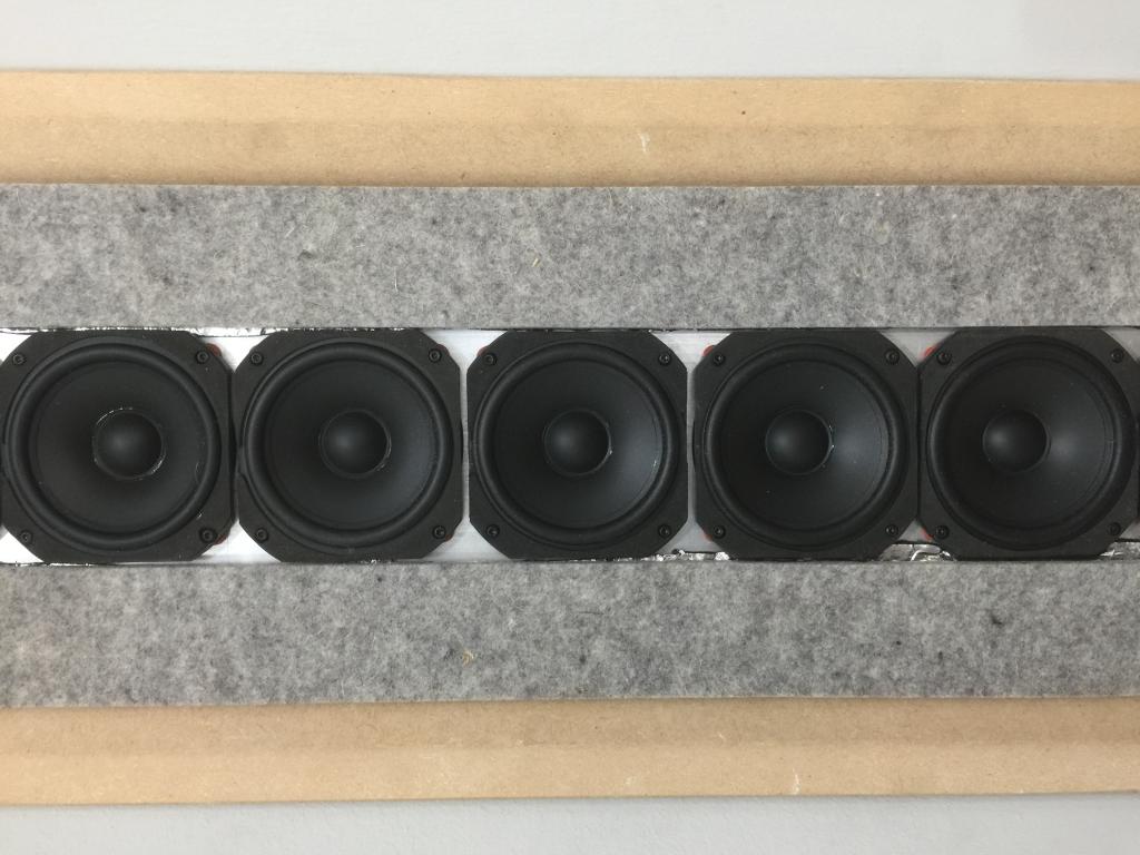

                            #193

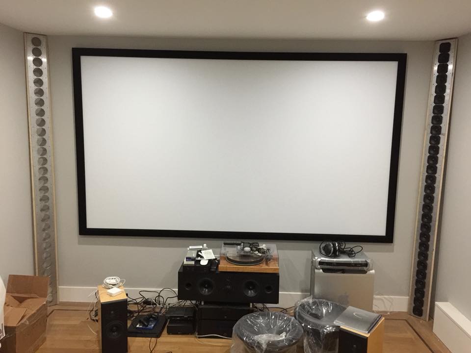

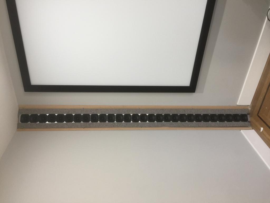

ID:	863243Click image for larger version
                            Mock up of how the speakers will look when in place. I will have gray grill cloth covering everything up so it won’t be as um... intimidating when complete. Second photo just show the back side of the speakers with the dynamat installed.

                              That will blend in very nice. What subwoofers are those on the floor if I may ask?
                              • oneplustwo
                                • Jan 2010
                                • 666
                                #195

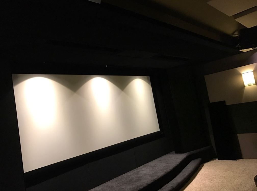

                                Those are stereo integrity 18" 600W. Can't remember the model specifically since I bought them a few years ago. I'm not sure they're even still available.
                                Got a lot done this last week.

                                Still have to figure out how to make the top of the grill cloth cleaner. And then the fun with convolution with JRiver begins. Right now, they're run through the Dirac Live of my Emotiva XMC-1 which is adequate but I think they can be much better.

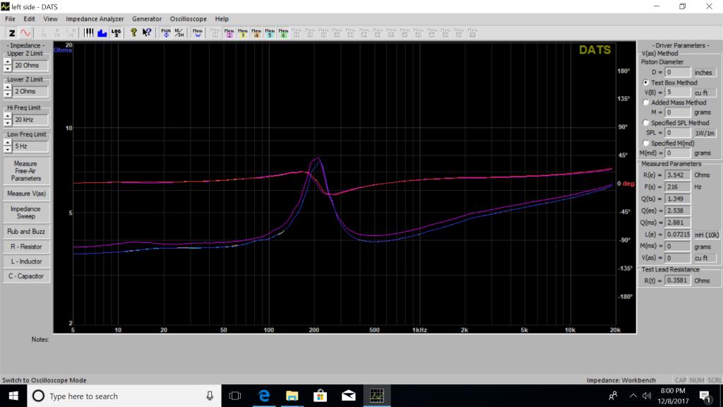

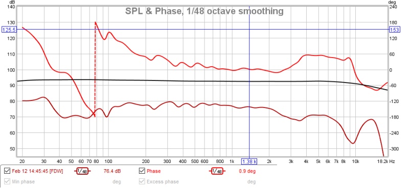

                                  #196
ID:	863296Click image for larger version
Name:	left side DATS.jpg

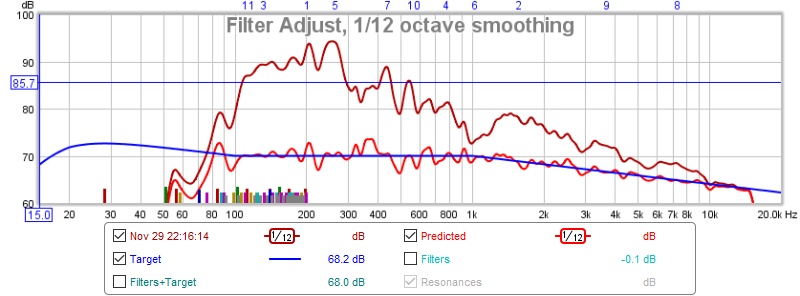

                                  Quick update... I got an Intel NUC on black friday, got REW fired up and ran some sweeps, applied some EQ, and got a reasonable looking FR. (This is at the listening position.)
                                  Also, I bought myself a DATS v2 to make impedance sweeps and that looks reasonable as well. A couple wiggles but nothing I'm terribly concerned about.
                                  Finally, I also have DRC Designer up and running and have convolution running on JRiver which sounds really great! There is definitely something to be said about FIR vs IIR and the flexibility with implementing via software is really cool.
                                  I'm still playing with the DRC options and will post something when it's stable. I'm also figuring out what room treatments I want to get in place. For now, I just have a bunch of Roxul lying around the first reflection points. That has made the soundstage imaging much better already. My wife won't let me keep it as is for much longer though so I need to get that fixed soon!

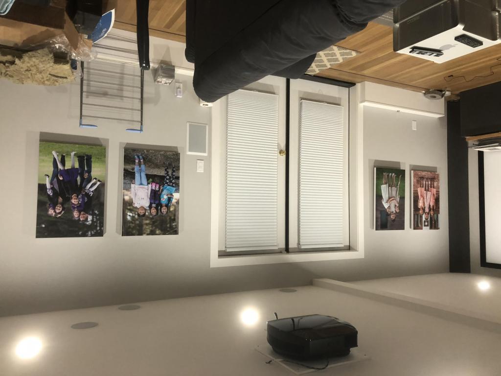

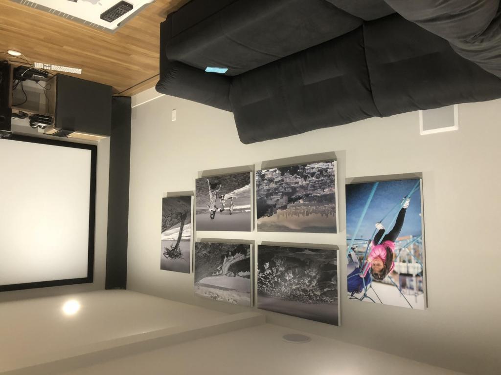

                                    Has anyone used Costco photo canvas for absorption panels? Wondering about price/quality for the application compared to other options out there.

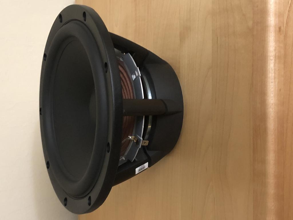

                                    Corner loaded line array
                                      • 16194
                                      #198
                                      These are going to be so much fun when you've got them finished up. I'm still thinking of doing something like this for the HT setup when I get moved to Idaho in a couple of years or so.
                                      • oneplustwo
                                        • Jan 2010
                                        • 666

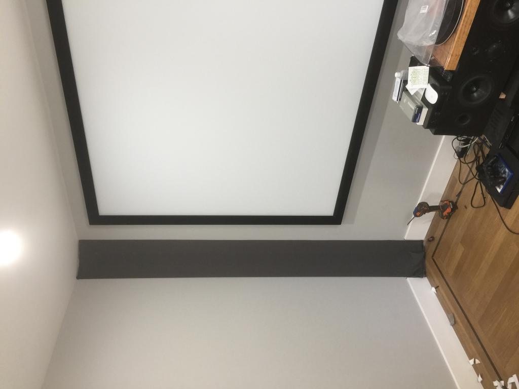

                                        #199

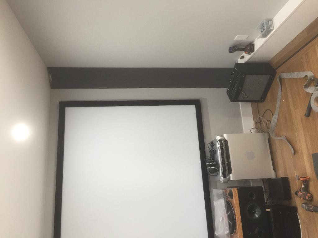

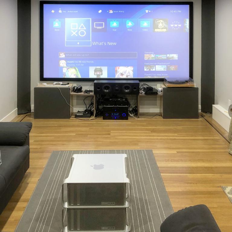

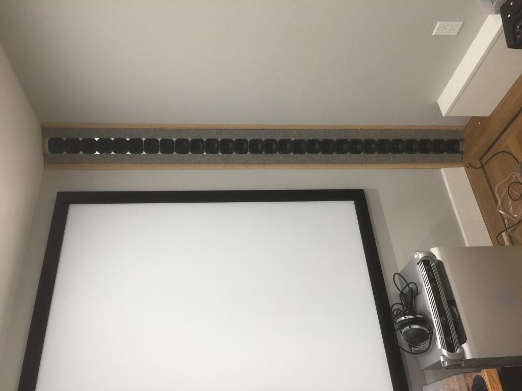

                                        Up and running! Man, movies are more fun with subs. The infinite baffle concept works well too from what I can tell in that they’re not boomy at all. Still need to re run the PEQ as well as the DRC designer stuff. But I’ll wait until our canvas photos with roxul are up. Sounds pretty good for now.
                                        And yes, those are two Mac pros acting as a coffee table!

                                          #200
                                          Wow! So THAT'S what I can do with my old Mac Pro's once I no longer need to run MathCAD or some other work related stuff on them! That's pretty Sierra Hotel!
                                          your setup there is an awful lot like what I'm thinking about for the future... possibly a bit wider room, and a bit smaller screen for now (what's your size? 120"?) And I have some ideas for an Ardent derived center channel using WO24's as woofers.
                                          And two STW-350F's are on the way... just for initial testing and T/S confirmation. No chance to build enclosures in the next year or so, unless I can farm it out to Steve....
                                          What's the amp you're using on your subs? Behringer iNuke? How do you think it sounds on the bottom end?

                                              Yes, 120" screen. Very easy to build kit from Amazon for reasonable money.
                                              Yes, I have an iNuke 3000 for the subs. It seems to sound fine to me. I have yet to dial them in though since I'm waiting on my canvas photos to wrap the roxul for some first reflection absorption. And eventually, I'm planning a wet bar for the rear of the room so I may need to redo them again along with just tweaking in general. But with the size of my room and the subs I'm using, the iNuke 3000 seems to do the trick.
                                              One thing I did do is mount it to the wall on the other side of the screen and then I routed the signal and speaker wire there too. And the I plugged the sub into one of these wifi enabled plugs so I can power it on and off from inside the room. I'd prefer a trigger, but this works well enough. Sometimes I forget to turn it off is all.

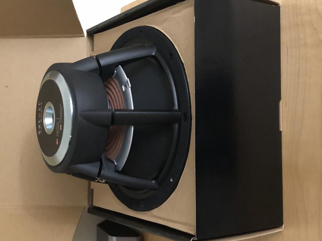

                                                  Wow, seems we have a hot button topic here!
                                                  There is no reason not to do a full fledged center with all WA components; then sensitivities and all will match up. But if I use line arrays in HT for sides, they are pretty high sensitivity, so for that I was pondering the WO24-P mainly for sensitivity reasons (higher efficiency for lower power HT amps- like 100W) and not really needing bass extension, but wanting a clean mid bass and lower mid.
                                                  This is all at the concept stage.. and if its mainly for HT and CC, then I was also pondering a TL ceramic tweeter to lower costs.
                                                  Things are very much in upheaval personally, with GF's passing this week last Monday- expected a long time, but now the kids and I have to shift into high gear for emptying out the house; I may keep the home office here for some weeks, so someone can be around for possible contractors or vendors if we have more work done.
                                                  But I'm thinking about speaker stuff again... well, starting to.
                                                  And since, on the Internet, nothing is real without pictures, then...
                                                  Just bought one for some evaluation... but getting an enclosure set for testing may be tricky. OTOH, can send a baffle to Steve to have cut out. New apartment doesn't have any space for woodworking...
                                                  To create a good CC with the existing Ardent configuration should require nothing more than a reconfigured cabinet in a traditional WMTW arrangement, and the existing crossover.

                                                            Had 13 20x30 canvas photos printed at Costco. Stuffed above 2ā€ of Roxul behind each one and here we are. Seems to be pretty good as far as the clap test goes. Probably could use some more at the French door so I may make a temporary one that I can move when as needed. Otherwise, it’s done for now until I get the wet bar behind the couch built.

                                                                    Back to the main topic , your personalized canvas photos really finish your home theatre, congratulations. Hope you continue to enjoy your work and room.

                                                                          #216
                                                                          SPL and phase with the subs. The whole house shook with the subs cranking at the low levels during the sweeps. Felt like an earthquake. No joke!
Name:	2018 02 12 spl and phase.jpg
