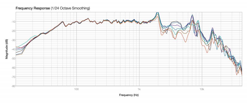

      To illustrate the difference in behavior of the cell drivers, here is an outdoor measurement of the AS190 on an optimally sized baffle - about 12" wide.
Name:	AS190 On Axis 15cm.jpg
      As you can see with this driver, and also with the AS168 and AS250, there is no apparent baffle step, because as a part of the driver design, that is engineered into the characteristic. The Force is strong with this series...

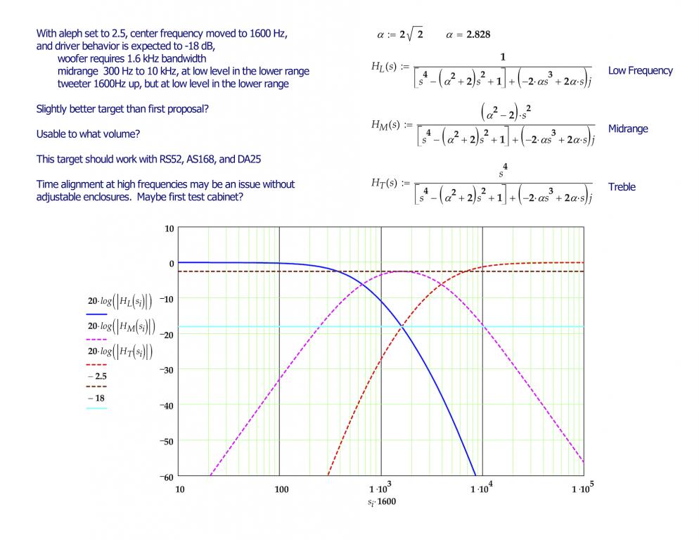

          To recap again, the planned system design target upon which work to date has been based:
          Click image for larger versionName:	Target concept.jpgViews:	1Size:	81.1 KBID:	865561
          For a practical Duelund type design, it has been my experience that managing the response profile accurately down to the -18 to -20 db level is both necessary, and for the most part, sufficient.
          The ultimate targets are a tower based on this cabinet design, and a center channel. They do not (at this time) use the same woofers, though they may both wind up with the same tweeter (T25A-6)
          Note that the final tweeter choice is based on both performance targets and minimizing CTC distance with the midrange. For this reason, the DA25 is not an optimal choice, but was deemed acceptable for the first POC design and build.
          For the first pass on the tower configuration, it was preferred to use a woofer that behaves as if acoustic origin in in the mounting plane. There are few choices, and the AS168 is the best candidate at this time.
          Distance measurements in room with long gating in a small test box show the expected response- as well as the superior off axis behavior of a "dome" woofer...

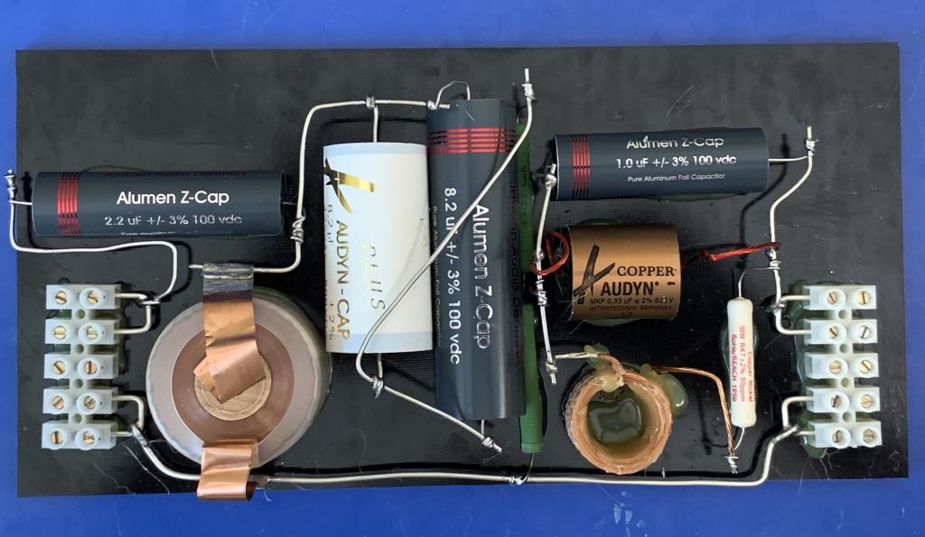

                Finally, to demonstrate that a modicum of productivity has resumed, an example of the 2nd generation Woofer crossover boards.
                As I described to Steve Manning, this is the Premium component "Mad Muntz" version... (take out parts until it stops working...)
                As you can readily see, "Black is back" is more than just a catchy slogan...

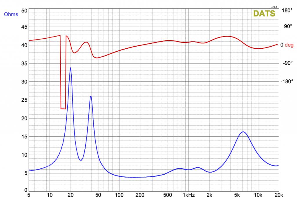

                  Interesting to see the small p-Core. Was that because of the DCR requirement, form factor or it was just on-hand?
                    #234
                    We had acquired a number of PCORE parts to test and evaluate- for this design study, due to the AS168 characteristics, a large inductance is not required, as a characteristic akin to baffle step compensation is engineered into the drivers.
                    Both inductors are the same part, but one is unwound to the specific needed value- DCR, as you surmise, is quite low with AWG13 wire- this was an experimental design target. The PCORE material is more linear than the CCORE Jantzen, and doesn't exhibit low level variations in hysteresis that show up as inductance variation and distortion. So far, I am favorably impressed with the PCORE parts, but more testing remains to be done.

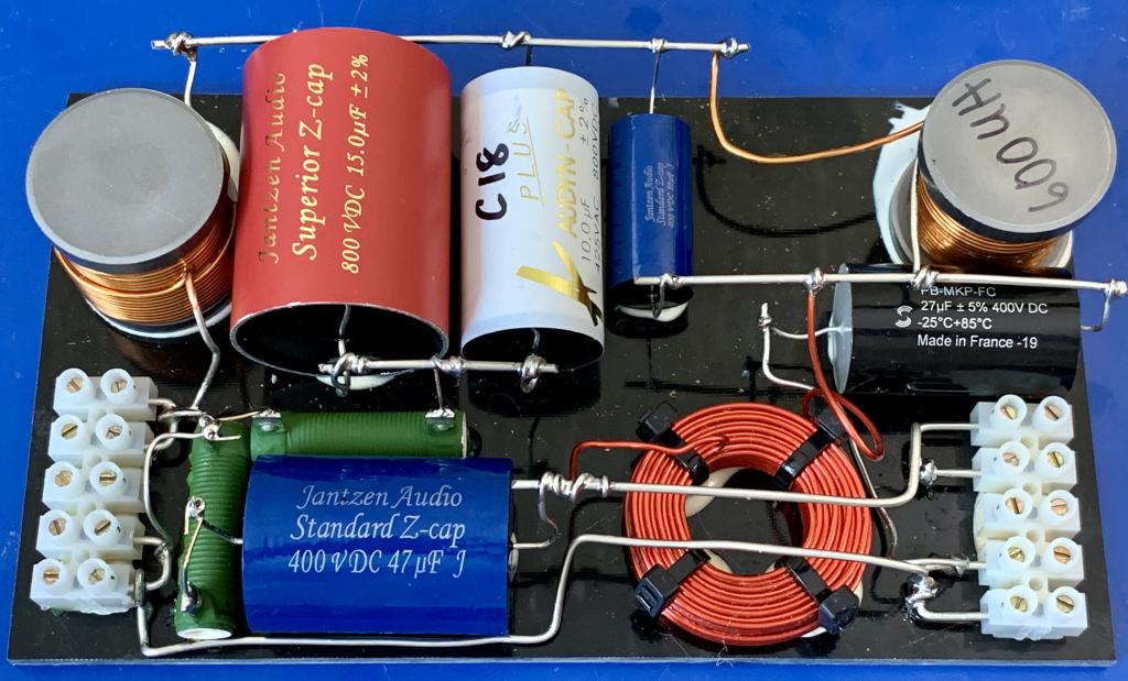

                      Test Article 2 DA25 Tweeter crossover
                      construction continues
Name:	TA2 Tweeter SS.jpg

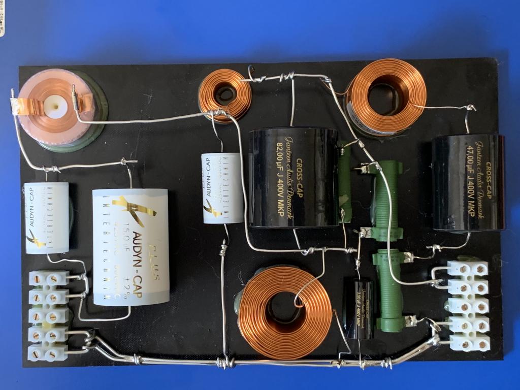

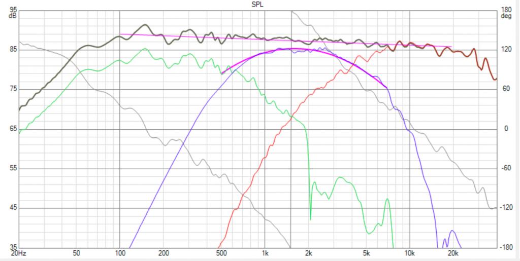

                          Initial testing of 5 samples of Morel EM1308 have proven encouraging, as reported elsewhere...
                          A new crossover update has been prepared, and is ready for testing on Saturday...
                          Click image for larger versionName:	EM1308 Crossover SS.jpgViews:	1Size:	97.8 KBID:	865632
                          If the results correlate well with the newest system design simulation in VituixCAD, then assembly of the Test Article 1 will be undertaken.
                          Click image for larger versionName:	NeoD AS168 EM1308 DA25 V7 SPL.jpgViews:	1Size:	68.9 KBID:	865633
                          Last edited by theSven; 12 August 2023, 19:35 Saturday. Reason: Update image style
                            There are some big values in there, but the overall part count is ... not bad for a mid, let alone a Duelund.
                              #239

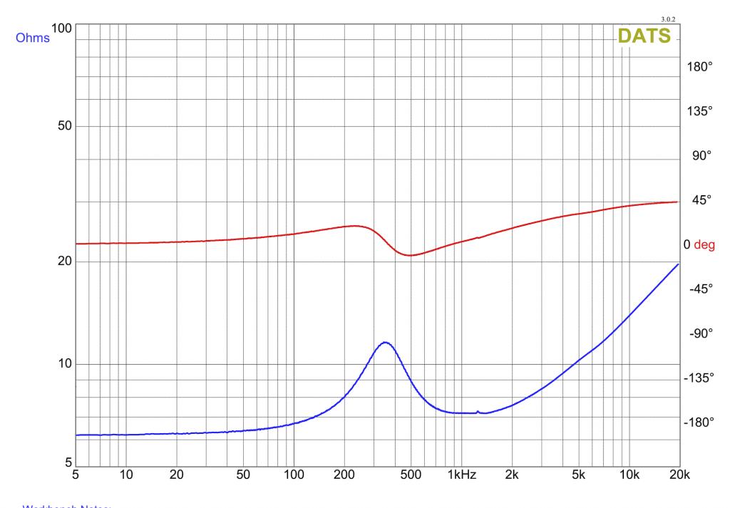

                              The two large capacitors are in "auxiliary functions". The largest is used in an RLC equalizer to flatten the small bump in the dome mid response between about 1250 and 1500Hz (this is the "perfectionist version of the crossover), and the next largest cap is part of the RLC impedance zobel for the Fs resonant rise of the EM1308.
Name:	EM1308 Z Graph.jpg
                                #240

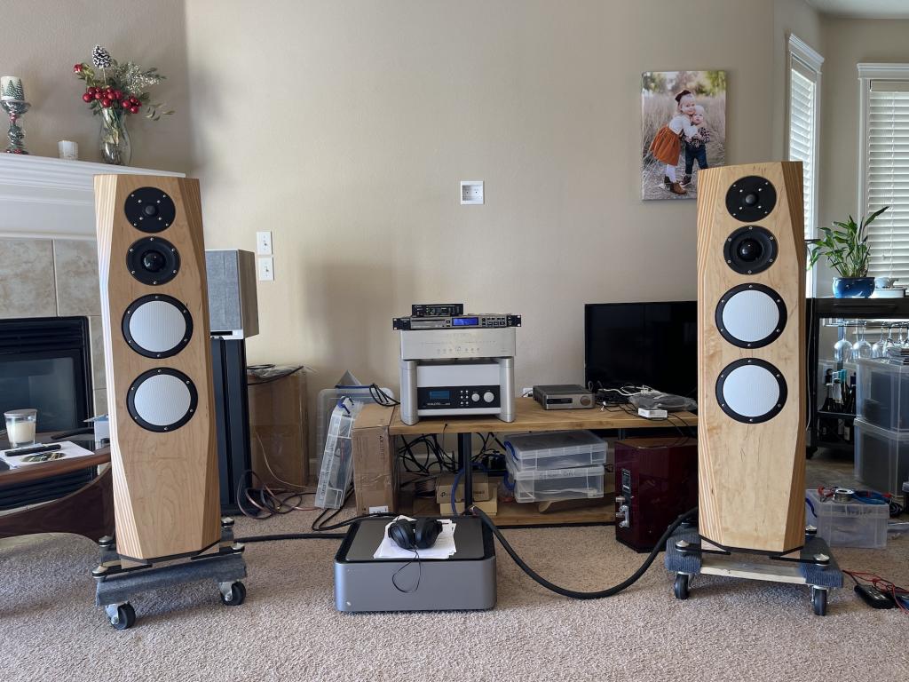

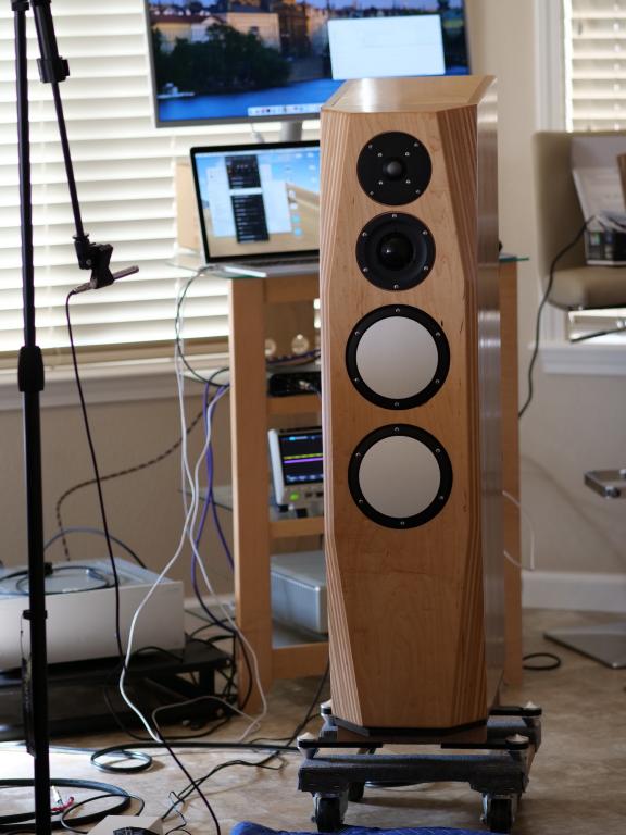

                                there is progress, but many other high priority tasks to attend to... there are many disturbances in the Force, and several cargo runs to the outer rim in advanced planning stages...
                                But perhaps this image will be interesting... as the first test article is now assembled.
                                And a view without the dolly...

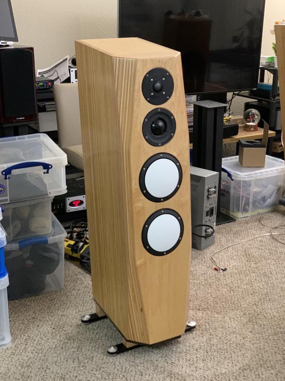

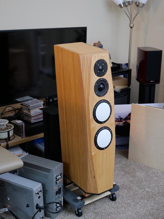

                                    Some small progress at last...
                                    It is appalling that so many weeks have gone by without posted progress...
                                    But the Bantha's share of effort has been devoted to developing new training materials for members of the New Empire, and locating and securing a temporary base of operations in the Outer Rim- all now completed successfully... which permits some time for other activities, though the regular logistic runs to the Outer Rim in my personal shuttle will continue.
                                    I can now say confidently, for the moment, that events are proceeding as I have foreseen...
                                    Turning to the acoustical issues, the cabinet and driver assembly tasks for the first test article were finally completed last week- no more delays will be permitted. Captain Needa shall fail me no longer...
                                    I had delegated the initial LF testing to him, in the non test article cabinets, but it seems he made some errors in calibrating the sensitivity measurements and calculations, and so the matching of the woofers and midrange/tweeter were not as planned, but out of synchronization by about 2dB.
                                    Drawing on the powers of the Force, I evaluated many possibilities, and arrived at a solution correlated with the current measurements that shows with the addition of one resistor to the midrange crossover, this should be the final results...
                                    Click image for larger versionName:	IMG_ModMidXover.jpgViews:	1Size:	107.9 KBID:	865748
                                    Should this not be the case, I will be at an impasse, as I have run out of lackies to terminate at will... however, I have taken exacting care with the calculations and simulations, and believe I can place a high level of confidence on this result.
                                    However, voicing compensation then be required with an inline filter between preamp and power amplifier, as previously proposed by Jonmarsh elsewhere on the forum.
                                    Last edited by theSven; 12 August 2023, 19:36 Saturday. Reason: Update image lcoation

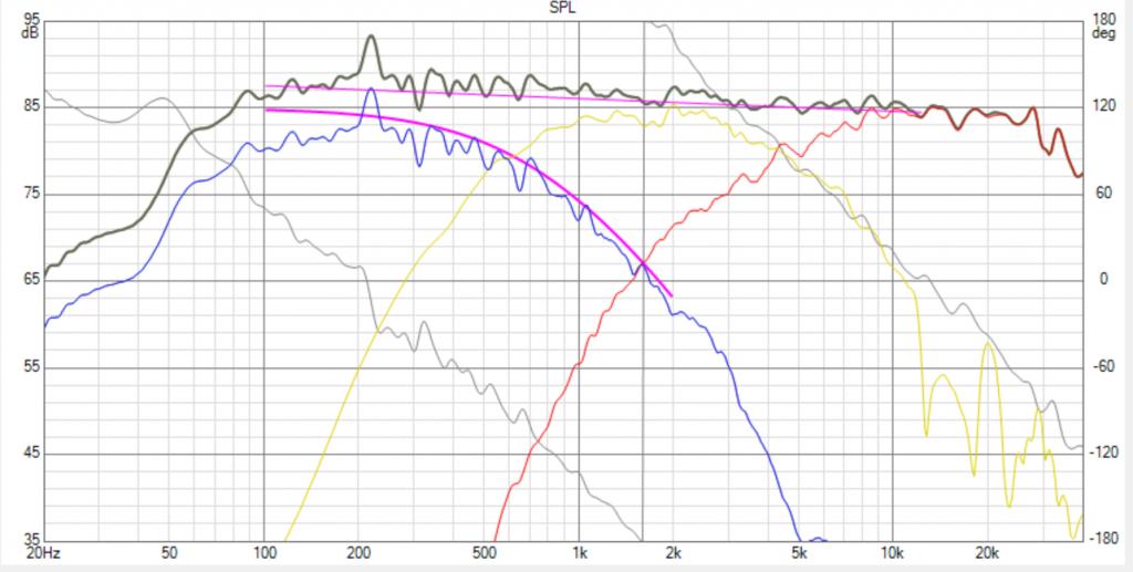

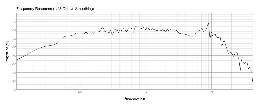

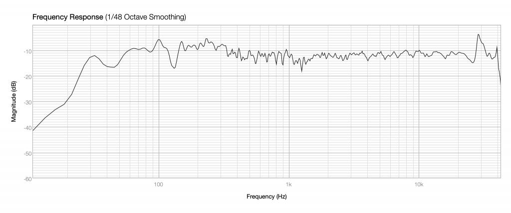

                                        At the risk of a force-choke.. :P

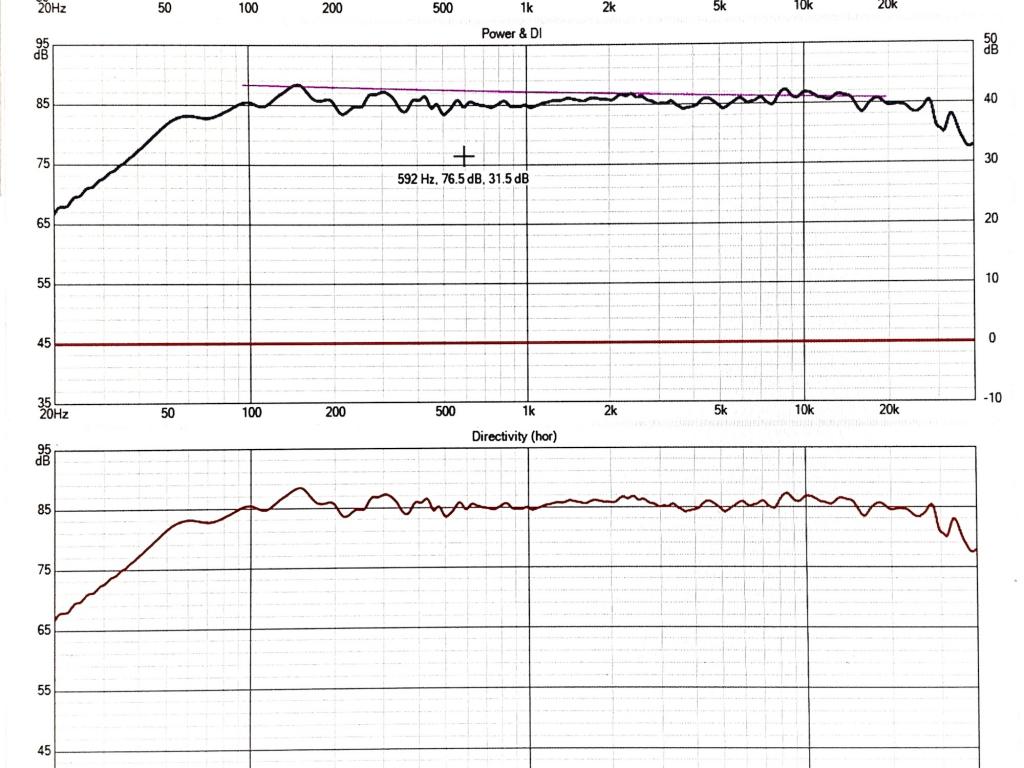

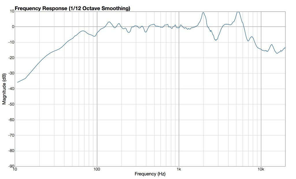

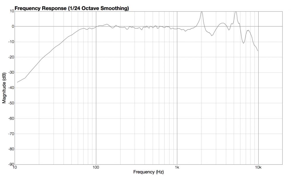

                                        This looks a bit "forward" to me (..say 1.2 to 2.7 elevation from the average):
                                        [ATTACH=CONFIG]30805[/ATTACH]
                                        ..whereas this looks better (..though I personally wouldn't have a problem with the treble being *elevated a little from this a'la Spica):
                                        [ATTACH=CONFIG]30531[/ATTACH]
                                        *to help with some of the pressure loss off-axis at higher freq.s. and the in-room result.
                                        -of course there is modeling an then there are real-world results..

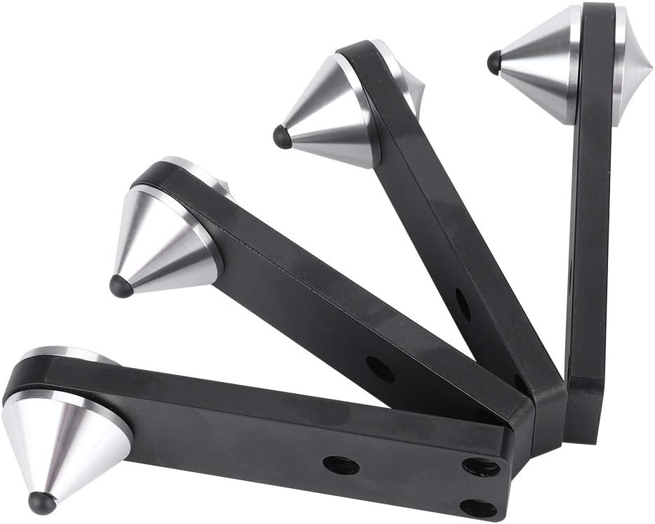

                                          I'll leave to the Master to answer questions on the voicing, but since I was lucky enough to provide him with the location of these feet, here ya go. https://www.amazon.com/dp/B07SNSMW7D/?coliid=I53MFNVRNENJY&colid=1VRILJ6X65H23&psc=1&re f_=lv_ov_lig_dp_it
                                          Look around a little since I've seen several companies offer them and the prices vary considerably.

                                            Thanks, looks similar indeed, and reasonable price for sure. Funny that there are several listings for what appears to be the exact feet at different prices. Not sure what the tiny rubber foot will do, seems it would deform pretty easily for a heavy speaker. And if you use the other side, the small cone, wouldn't get thru much carpet.

                                              #247
                                              I'll leave to the Master to answer questions on the voicing, but since I was lucky enough to provide him with the location of these feet, here ya go. https://www.amazon.com/dp/B07SNSMW7D...v_ov_lig_dp_it
                                              Funny, like 3x the cost on Amazon vs. ebay! All the pix are the same, so I assume they are the same, but you never know with Chinese sellers.
                                              • bobulator
                                                • Apr 2007
                                                • 11
                                                #248
                                                Oops, nevermind, that was for a single leg! But they are cheaper on fleabay, here's a set of 8 for $88:
                                                https://www.ebay.com/itm/8x-High-Qua....c100005.m1851
                                                  #249
                                                  Very reasonable comments- keep in mind that this curve is simulated, based on adjusting data, and small additional changes can be easily made.
                                                  I am torn between the concept of building in the voicing compensation curve, and simply designing the speaker as flat as possible with a wide dispersion profile, and doing the voicing inline as has been shown in the thread on that topic, with a balanced XLR device in the signal path between preamp and power amp.
                                                  Forward progress is at a glacial pace due to the press of current Imperial activities (training Sith apprentices... I don't know where they find these candidates, it's not like the old days...), and support for the Outer Rim relocation- the Imperial activities will be complete on December 18...
                                                  However, the progress to date is encouraging that the final result may be satisfactory...
                                                  Even today I spent a small amount of time setting up for building the second midrange crossover and making the required minor modification to the first...

                                                    This post is just to inform of some of the results for the second speaker, both measured and after some listening in mono using the measurement system, which currently incorporates a Moto M4 interface, a Benchmark HPA4 preamplifier, a Cambridge Audio 840W power amplifier, and a MacBook Pro for the test source, using VOX for music playback samples.
                                                    The location of the test speaker is in the dining/living room of the new home, about 5 ft from the back wall.
Name:	Ardent D TA-2 SS.jpg
                                                    Impedance measurements agree very closely with both Unibox and VituixCAD simulations, confirming expectations that the crossovers were built correctly. They also confirm the correct low frequency tuning, with maximum PR loading at about 28Hz, and show the efficacy of variable density damping at preventing any column resonances that might be observed in the impedance curves, as was the case for the very first generation Ardent in a ported configuration.
Name:	Ardent D TA-2 Z Graph 3-19-2021.jpg
                                                    A number of measurements were made, with minimal smoothing but using Half Hamming windowing and a 150msec window, which reduces the measured low frequency response. However, with a rectangular window it can be seen that apart from the room modes, the response reaches about 30Hz at the -3dB point. The result was adequately in synchronization with the design target. The dips in the 40-50Hz region and 130 Hz are due to room modes, and native response was verified with close miking. The midrange and high frequencies were very clear on the test sweeps, but not drawing attention to themselves in any particular area. The polar response changes little up to 45-50 degrees off axis until above 10kHz due to the behavior of both the dome midrange and the DA25 tweeter
Name:	TA2 CheckPlot2.jpg
                                                    A variety of program material was auditioned using the stored FLAC files and the VOX player- this included a high definition SACD rip of Gaia, by James Taylor, "What I am" by Edie Brickell, "East River Blue" by Spyro Gyra, "Ectopia" by Oregon, "Rich Woman" by Allison Kraus and Robert Plant, "The Lighthouse Tale" by Nickel Creek from an SACD HD rip, "Gaucho" from an HD SACD rip, "No one is to blame" by Howard Jones, the live version of "Chrale No. 1 "Sleeper" by the Jacque Loussier Trio, "Against the Wind" by Marie Brennan, "Dark Alan" by Karen Matheson from Rob Roy, several Poor Claires cuts, "Chant" by Fourplay, "Corner Pocket" by Harry James & His Big Band, and "Spiral" by Hiromi. Of course, this was just one channel.
                                                    The most interesting impression was how neutral sounding the experience was, but particularly how the pitch definition in the low frequency instruments (such as standup bass, bass guitar) did not seem to have a specific warmth or range emphasis, but rather was very revealing of pitch definition and clarity up and down the scale. This was very evident even in pop pieces like Gaia, where the percussion break at the final verse break was reproduced very evenly but with increasing power as the pitch of the drums struck were lower and lower. No bloat, but high impact. At the listening distance of 10 ft, there were more midrange and HF room reflections, but the low midrange and mid bass measured flatter, so I would not consider changing things until a number of additional listening tests and measurements have been made. At this point, I tend to trust the power response profile of the VituixCAD simulations, and what I am hearing subjectively resembles that closely at the listening position.
                                                    Live pieces like the Jacque Loussier Chorale were particularly satisfying to me.
                                                    Overall, the results justify returning to the TA1 cabinet (Test Article 1) and updating the resistor configurations in the midrange and tweeter crossovers- as well as replacing a midrange driver damaged in warp turbulence during one of the shuttle runs. That is underway since this morning...

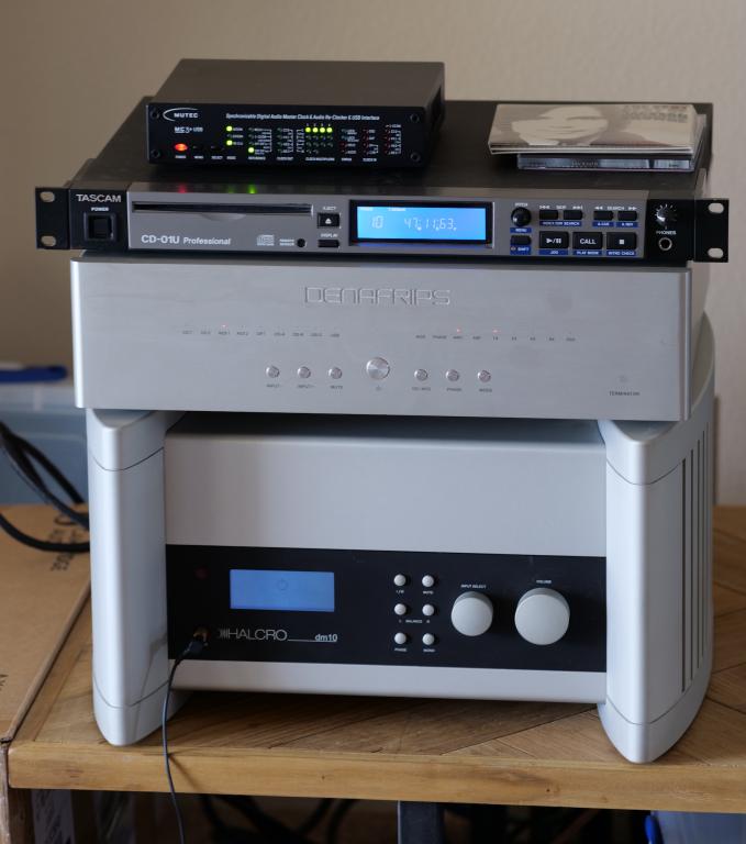

                                                    Following this, a different system setup will be used for further auditions, with much of the same program material.
                                                    The latest Cambridge XD class amplifier, the Edge W, will be used to drive the Ardents. This is essentially the grandson of the 840W amplifier which has been used for years in the measurement test system. It is expected that these listening evaluations can be completed tomorrow.

                                                          The original TA-1 crossover boards have been modified and will be installed after a meal break.
                                                          The interesting thing about this may not be the Duelund crossover, though I believe it has considerable merit, but the electroacoustic properties of the AS168 in combination with the RSS265PR. Accuton made a huge investment in the development of this newer generation of drivers- the original Kurosawa system is awaiting time to complete it's developmental construction, and this whets my appetite for that effort even more... it will be interesting to contrast the performance of the AS190 and AS168. It is easy to imagine from this how the Vimberg Mino creates it's appeal, yet I also think that the combination of the RSS265PR's with the AS168 is a most serendipitous arrangement for a smaller system.
                                                          Do note that the measured balance shifts at the listening position, but the changes fully justify what is observed at 1 meter.

                                                            Finally ready for listening evaluations
                                                            There must have been a disturbance in the Force, because additional updates to the first crossover board were overlooked, and had to be implemented. But now matters are proceeding according to the plan...

                                                                            WIP update
                                                                            OK, just a bit of a WIP (Work In Progress) update, partly feeling guilty because though I was initially considering posting a list of cuts and detailing my perceptions of each one, I realized THAT would be rather a time sink to generate AT THIS POINT in comparison to the relative worth- so for now that will be deferred.
                                                                            Also, I've had some extra work to do, because the two cabinets, named TA1 and TA2 (Test Article 1 & 2) have had some differences in execution which now need to be normalized, TA2 naturally enough being the later version. And I've found that attention to some relatively small details is required to achieve intended results...
                                                                            • The stuffing technique for the upper cabinet region in TA2 was chosen using a higher density approach, with the fiberglass typically used for wrapping pipes, instead of Acoustastuff. By testing, this is now chosen to be the preferred configuration.
                                                                            • The padding for the midrange and tweeter are going to be altered once more, raising their levels slightly.
                                                                            • The phase centers for the 180 degree transition are being better aligned (I think!) by some crossover updates as well as build updates.
                                                                            • For the tweeter crossover, the cacluated value of C7 is 2.4uF, while I was using a standard 2.2uF Jantzen. Not goodly- need to add in 0.22 uF to bring it to target value.
                                                                            • C12 is also being updated, mainly for aligning the phase, as it has impact on roll off only below -12 dB.
                                                                            • The pole stop resistor R12 in the woofer network is being changed from 5.1 ohms to 10 ohms. Again, primariliiy for adjusting the phase response.
                                                                            As previously built, the speakers are very pleasant to listen to, and the AS168 + RSS265PR combination shines in the very, very stiff cabinet. The LF pitch definition, articulation, and extension are all very pleasing, on cuts ranging from Stanley Clarke's "School Days" (from the Bass-ic collection, the named album of the same title is a very poor CD master) and Wild Dog, to "Gaia" (James Taylor SACD) to Lorde's "Royals". The percussion roll through in the opening of "Wild Dogs' is a particular example of all of those characteristics.
                                                                            But I feel like there is a little more focus overall to be obtained, and that's what's driving the updates. Parts ordered, with expedited shipping.
                                                                            I think Accuton has definitely scored an important technology development with the AS series cell woofers. They have some rather unusual characteristics, and have been clearly engineered for a fairly specific application approach. This 1 meter plot in a small sealed test enclosure for the AS190 exhibits the key characteristic I've seen in all the cell woofers...
                                                                            This is not an infinite baffle measurement, but a 12" wide test enclosure... yet there is no baffle step fall off, because there is a counter vailing property built in to the driver, perhaps as a consequence of the effort to create an acoustic origin at the mounting plane?
                                                                            But this has significant implications with the crossover design for a conventional cabinet, as a large value inductor to create the BSC pole around 250-300Hz isn't needed, and the crossover network looks more like a classic filter, due to the flat impedance curve and lack of BSC compensation. This can cut the initial inductor value in half, and reduce DCR. For this crossover implementation, DCR was minimized by using Jantzen parts with AWG13 wire, and creating a custom 600uH inductor by unwinding a 1mH AWG13 part. (That was done because the 0.68mH part was out of stock at the time!) (this was the cost effective approach- the rabid approach would be to take the 3.6 mH parts and unwind them, which use the larger core, but cost more. Lower net DCR. )
                                                                            It also reduces the interaction of the LF filter with the overall driver impedance variations, which can be often be seen in the upper bass in the actual filter plot in the design program, typically with a bump of a few dB in the 100Hz region. This is eliminated with the cell woofers, and this characteristics is common to the AS168, the AS190, and the AS250, based on my direct experience.
                                                                            Last edited by theSven; 12 August 2023, 19:36 Saturday. Reason: Update image location

                                                                              Jon thanks for the update post. The ”built-in baffle step compensation" is really impressive.
                                                                              It also make the ”spec sensitivity” of the woofer more close to the finished loudspeaker.
