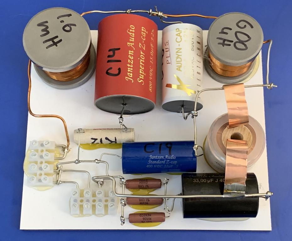

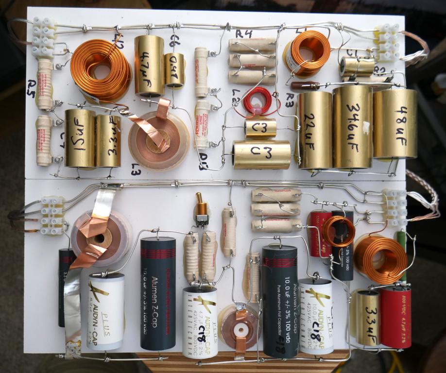

                note the construction of the recently completed 1st article tweeter crossover board.
Name:	Tweeter Xover First Article build.jpg
                Also, note that this board does not particularly reflect an overall cost optimized build approach, as in some cases more expensive components than necessary were simply used because they were on hand, such as in Fs Zobel impedance control networks. The complexity is due to having an LCR impedance zobel network, an LCR ultrasonic notch filter, and a lower frequency LCR EQ filter, plus having a network concept for which the ultimate slope is 4th order, but only realized over a wide frequency spread with a very controlled increase in attentuation.
                Duelund crossovers are not for the faint of heart or weak of pocket book.

                  I like that expression dueland is not for the faint of heart or week pocket book. But I’m excited to see a CC coming. It all goes back to your earlier post to under promise and over deliver.

                      I can but offer this pitiful example of one of the wired up low frequency crossover boards...
                      LOL, yes that is absolutely hideous Jon. Why is it that your pitiful examples look better than my best efforts...:cry:

                        Yeah. That's why I keep asking for tips....

                          But then you should examine Steve Manning's work- had I the time, and if he had the time, I would hire him to build my crossovers....

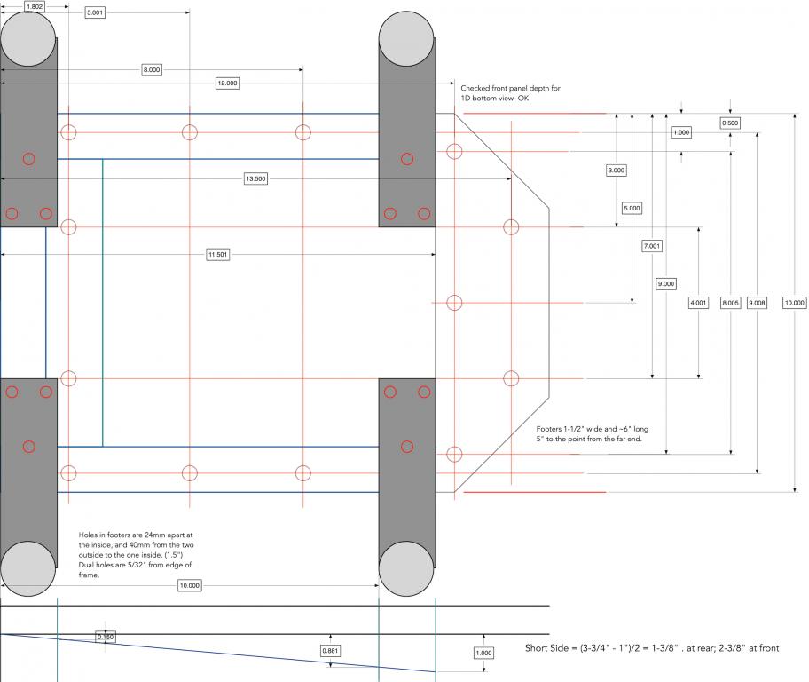

                              • The first midrange test article crossover assembly is nearly complete and should be finished today...
                              The base plate layout with spacing for the rise and footer assemblies:

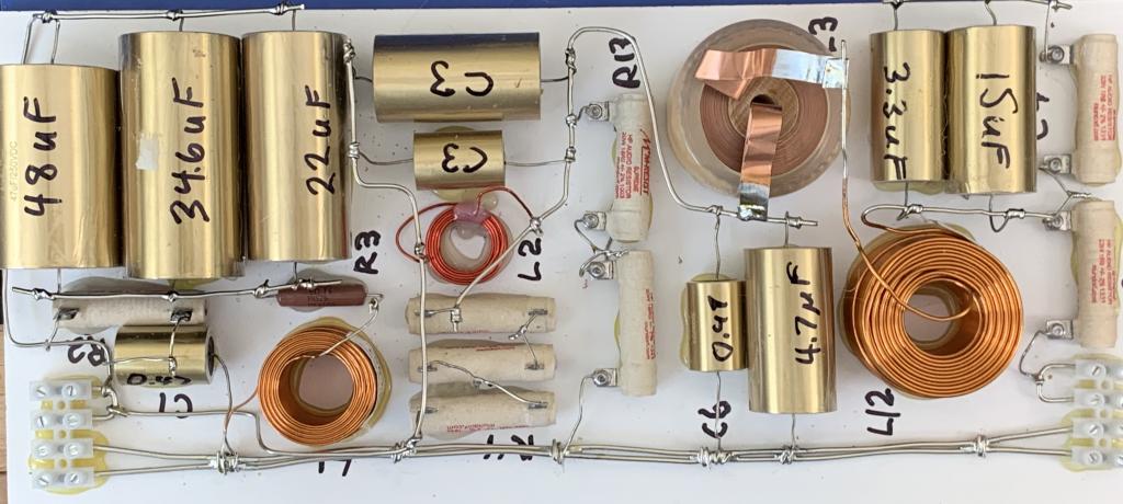

                                Midrange crossover TA1 completed
                                As foreseen, midrange crossover is now wired up.
                                NOTE: This board has one wiring error- do not use it as an assembly guide. Remember this is a work in progress- issue found with testing on July 7
Name:	Midrange Crossover wired.jpg
                                Not the prettiest job, and it could be much more compact and less expensive than shown here. I anticipate a combined midrange/tweeter crossover PCB in the future, should this design study turn out as hoped.

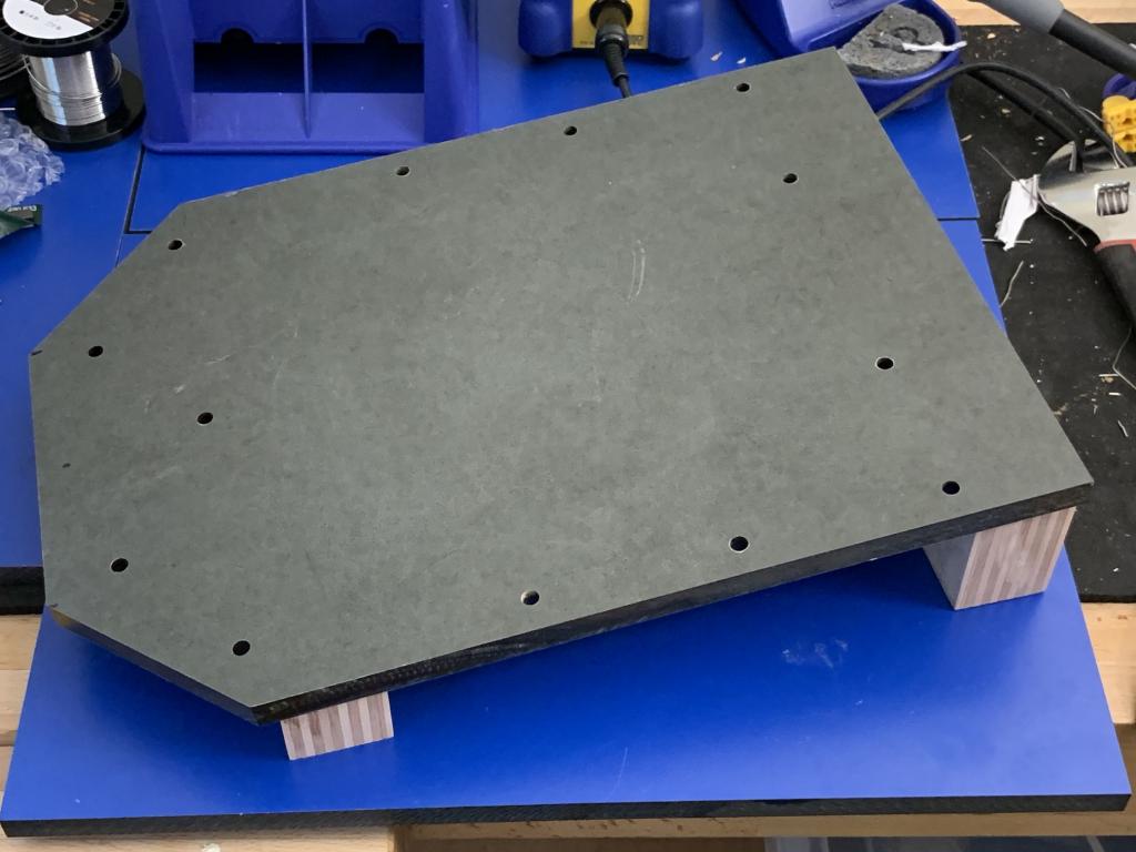

                                  It is said that a picture is worth a thousand words- how convenient to avoid writing, unless a true build guide is necessary in the future.

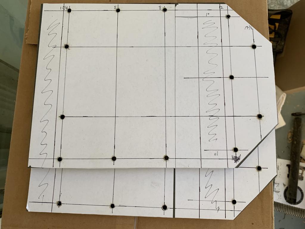

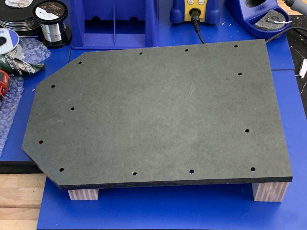

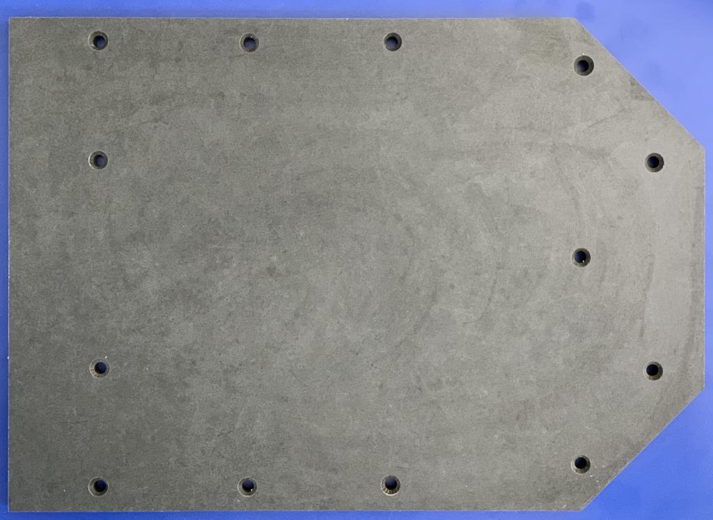

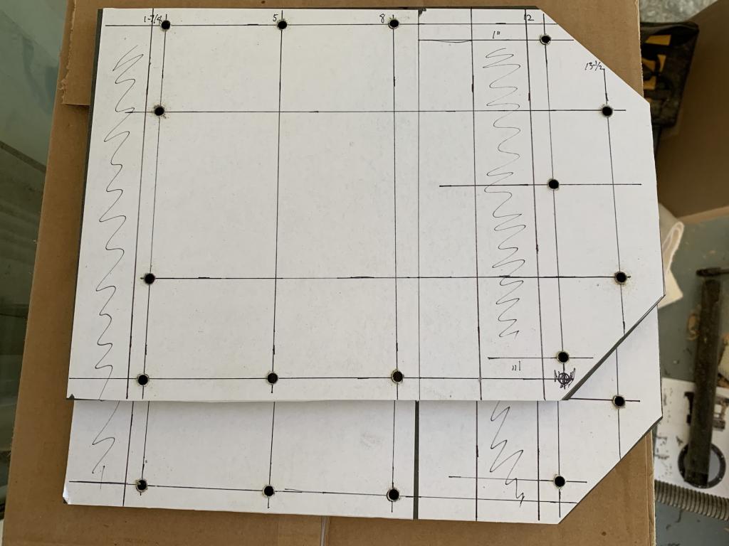

                                  Milcoast adhesive backed paper was used to draw the layout and drilling guide on the baseplate pieces.
Name:	Baseplate with drill guide_1.jpg
                                  This shows one of the baseplates after drilling and countersink operations were completed, and the adhesive paper was removed using a Veritas flush plane.
                                  Here, we see the baseplates glued to the riser blocks (using marine epoxy- which has very high adhesive properties with a wide range of materials) fabricated from the left over piano pin block pieces- the purpose is to introduce a 5 degree tile in the base, so that the front panel angle is reduced from 10 degrees from the vertical to 5 degrees.
Name:	Baseplate + Risers_3.jpg

                                  The outrigger bars will be attached to the riser pieces as outlined in the drawing above.

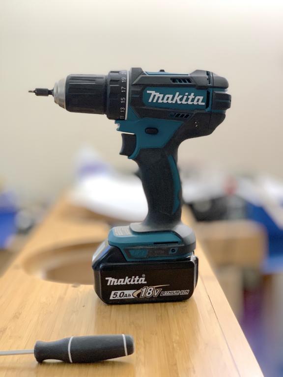

                                    The Makita LXT drill was acquired as a new tool for this project due to it's compact dimensions and high torque and adjustable clutch design.

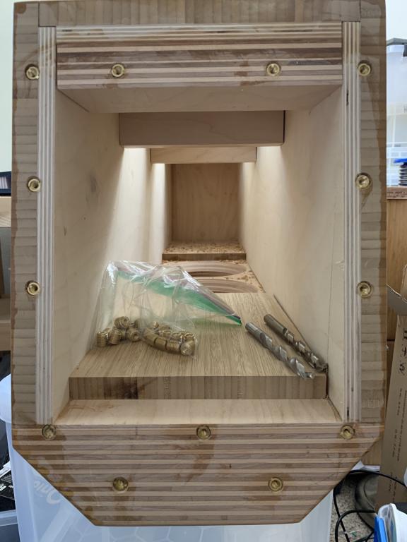

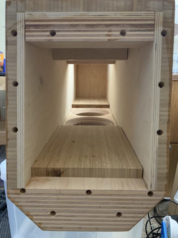

                                    This view is of the back panel, showing the installation of 10-24 inserts for one of the passive radiator holes.
                                    It should be noted that after the initial insert hole was drilled with the EZ-LOK tool set, a 1/32" larger bit was used to increase the dimensioning of the holes slightly more, to realistically accommodate the inserts working with dense wood materials compared with the normal "target" materials.
Name:	PR Hole_002.jpg

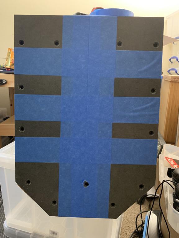

                                    This view shows a baseplate assembly taped up to the bottom of one of the cabinets, in preparation for creating marking "dimples" using a 1/4" bit. The pass holes for the baseplate are #12 holes/1/4" in order to accommodate potential "imprecision" in the final location of the holes for assembly. With CNC instead of manual operations, this would not be necessary or advised.
Name:	Baseplate Hole Template_01.jpg
                                    This shows the bottom of the cabinet after installing the insert holes have been drilled.
Name:	Cabient Base with holes_02.jpg

                                      Last, we have the base of the cabinet with the inserts installed. The Makita drill's controllability and accuracy and torque almost made Force Sense abilities of no great import...
                                      It should be noted that the inside of each hole was "painted" with a low drip epoxy prior to installing the inserts.

                                        ..The Makita drill's controllability and accuracy and torque almost made Force Sense abilities of no great import...
                                        Additions for screws:
                                        https://www.homedepot.com/p/Makita-I...5097/203696915
                                        https://www.homedepot.com/p/Makita-I...5383/305513416
                                        (..I use this with my Worx "Switchdriver" - makes a one-tool one-person job far easier with pre-drill and screw. I do wish the Worx was of the "impact" variety though, but wouldn't give-up the single-tool capability of the Switchdriver for it.)

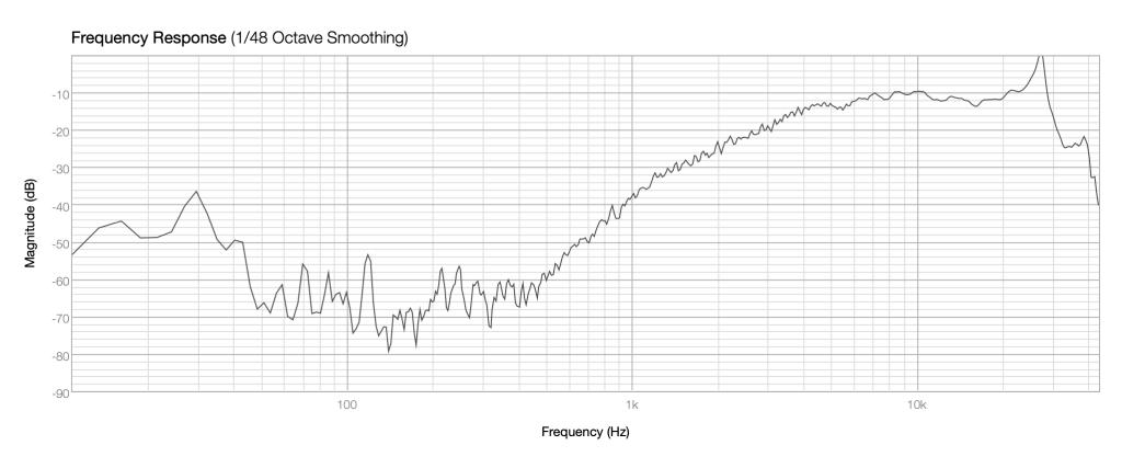

                                          Now, I will reveal how messy a "Design Study" is, compared with a final stage only reveal of a new DIY project speaker...

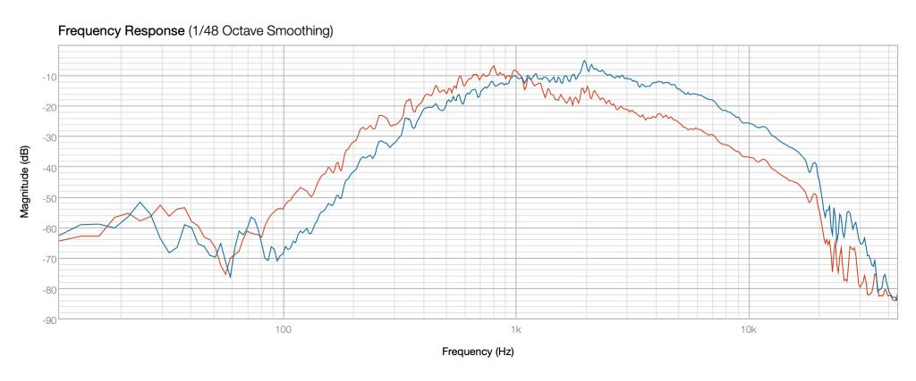

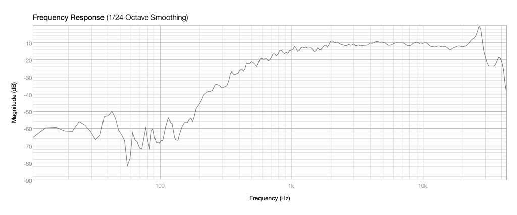

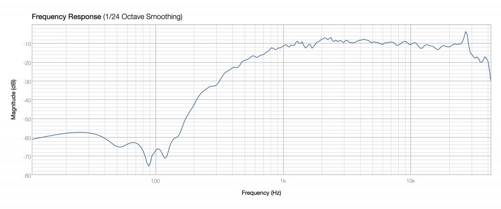

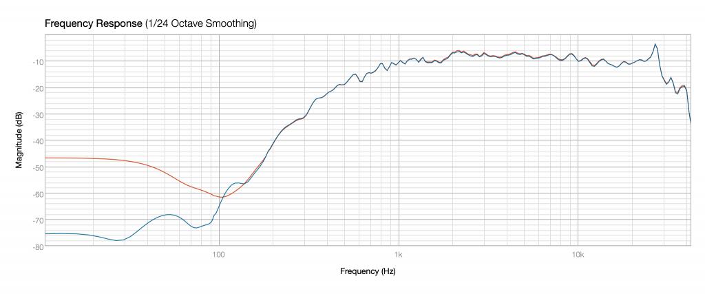

                                          Yesterday's investigation was checking the newly built midrange and tweeter crossovers with drivers in one of the test article cabinets... sometimes testing is completed flawlessly, other times, certain "discrepancies" are discovered. The latter was the case yesterday, though they were quickly identified and resolved.
                                          One of these is with one wiring error, one is with the wiring error corrected, for the midrange. I leave it to the readers to figure out which is which, based on the posted simulations.
                                          Now, the tweeter crossover was built correctly, but the "improved" notch filter, using the classic configuration of parallel RLC, seems to have more sensitivity to tuning and Q than that I used for the Calliope design.
Name:	Tweeter Check.jpg
                                          Otherwise, the profile is exactly as I have foreseen... new parts were ordered, simulations rechecked, and the notch filters should be rebuilt by the end of the week.
                                          The combined response meets expectations, aligning well with the VituixCAD simulations.
Name:	Mid+Tweeter Combined.jpg
                                          With the circuit updates in progress (2nd day air still works, some of the time) I expect these boards and the build for the 2nd pair will be ready soon- but both will be tested before installation.

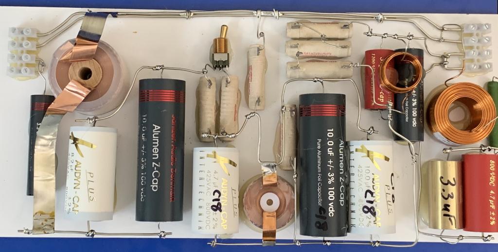

                                            Crossover boards- midrange corrected, tweeter to be updated.
                                            It should be noted that while Steen Duelund was very dedicated to the crossover concept he pioneered and it's acoustic results, he acknowledged that it was complicated and expensive to build with real world drivers, to get the necessary SPL and phase control over a wide range.
Name:	Crossover Resizejpeg.jpg
                                            • Norm
                                              • Mar 2011
                                              • 62
                                              #202
                                              Holy crap! Above is why one does not find the Duelund crossover in too many commercial designs. I know of only Gryphon who can suffer that level of hit on the bill of materials cost times the markup.

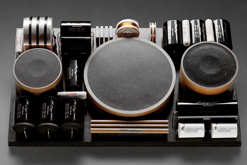

                                                #203
                                                Well, this set is done with parts either on hand or readily available. Check out the NeoD CC design I did years ago- doesn’t look nearly as scary, and the focus was on HT. OTOH, it doesn’t have the same precision or some of the upper breakup mode filters or Fs Zobels. This is more of a perfectionist version. Steve asked me to come up with an HT version, so to speak, and that is in the works. Fewer parts, smaller less expensive parts.
                                                You don’t want to look at the crossovers for Tidal, Vimberg, or Wilson, yah know... can take your breath away!
                                                I’ve heard a rumor that test cabinets are in process for a three way CC based on a modified version of the upper driver crossover and the same mid, but a different tweeter... ET tends to be closed mouth about that kind of stuff until he’s got a POC and some test results.

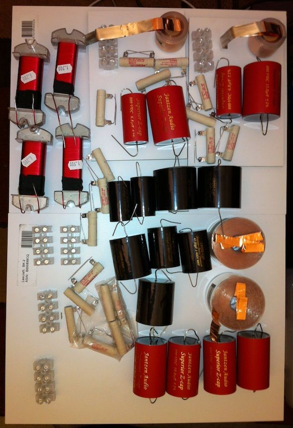

                                                    This ought to put things into perspective ..... here's a couple of pictures of Tidal's crossovers.

                                                      Yup, they use a lot more Mundorf than Dueland.
                                                      If anything, Dueland's resistors are actually a pretty good deal as far as value vs. subjective result in a signal-position.
                                                      I've found that resistors are typically the worst offender to good sound (in a passive component context for the crossover). If I can get my resistance from a good inductor for the network, then it's by FAR the better option.

                                                            I struggle to come up with an adequate term to describe the Tidal crossover construction, that doesn't indulge in sexist terminology- it goes well beyond the concept of what in one day might have been called "manly" construction.
                                                            I believe that if I proposed something similar to Steve, it would be grounds for dissolving my association with his efforts... He was just recently questioning my fondness for the 20W Mundorf resistors. And I do agree, Duelund are good value for for the price.
                                                              • 2142
                                                              #210
                                                              Hey, if the customer wants it I'm all in ..... we'll just have to provide a refrigerator dolly to move the crossovers around and a cardiac defibrillator when they find out what it's going to cost them.

                                                                Meanwhile, assembly of more crossover test boards continues...
                                                                I have an appointment tomorrow with Imperial specialists who are promising to improve my mobility and agility for any future light saber battles... pray the are able to delivery on their optimistic promises.
                                                                Meanwhile, another specialist has confirmed that black is back, and a custom order configuration with triple pickups is possible, though the delivery date will be after I should have completed my rehabilitation from the recent bionic upgrade. Still, it is something to look forward to in these difficult times...
                                                                  #212
                                                                  The 2nd tweeter crossover board is built-
                                                                  This one currently has a 29uH ultrasonic inductor, and I believe it will benefit from further tuning adjustments. However, the baseline performance seems quite satisfactory...
Name:	Udate2 Tweeter SPL.jpg
                                                                  An additional sequence of values will be investigated tomorrow before finalizing that aspect of the filter.
                                                                    • 1044
                                                                    I've played around with this in the center channel I'm working on. It seems to provide a relatively painless way to implement the downward tilt that is being discussed around here.

                                                                      the benefit of tight tolerance crossover components
                                                                      One can see advantages to selecting components with tight tolerances- 2% capacitors and resistors being common in this design study test build.
                                                                      Here is an example, with the two midrange crossover boards tested and compared- naturally, without otherwise altering the test setup, including gains and microphone position, and with the same tweeter test crossover. Literally, only the midrange crossover board was touched, swapped out for the two measurements.
                                                                      I find the result to be most satisfactory... one might even say somewhat surprising.

                                                                        There have been a few questions directed my way, about what I mean by "Design Study" (a term used specifically for several threads I have posted in the past) and why this isn't finished yet or posted as a finished design with all details available.
                                                                        The more common method for project development and posting is to work out all the details, solve the problems as they are encountered, and then, and only then, post a project summary with all the characteristics and construction plans, and a summary of the measured results and any relevant subjective listening sessions and comments.
                                                                        When I post a Design Study, matters are handled quite differently and there is no assurance of a successful or complete outcome- or that there even will be a "final solution". The difference is that from basically the start, in a Design Study I am sharing the development process and issues, as well as different considerations to weigh and balance, and how this evolves into a first prototype. In a sense, this is sharing the "behind the scenes" work which is going on in the development process- hence, the name, "Design Study".
                                                                        A classic example might be the "Three Way Evil Design Study" started in 2006, eventually resulting in the start of construction of a final test system in 2012, with first crossover prototypes in early 2013, with the first "production build" around April 2013.
                                                                        The Emperor has commanded that I undertake a new three way design study. The goal, as he put it, was a new box speaker with higher output capability (+ 6 dB) than the M8ta, but a similar overall approach. I am still puzzling over his enigmatic command to find "one rule to drive them all"; he suggested searching for
                                                                        A 3rd generation was in progress in early 2014,

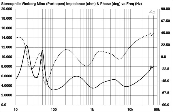

                                                                                          #224

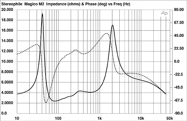

                                                                                          Originally posted by Scottg
                                                                                          Either way, I'd bet those Accuton's sound excellent for a number of reasons.. but the cost is well, IMPERIAL. :W
                                                                                          Your points are well taken....
                                                                                          On the other hand, the cost of the Accuton AS168 is far less than, say, a Vimberg or Tidal speaker system using them... $31,000 per pair, according to the recent Stereophile review. Yet, this probably represents good value, compared with, for example, an Avalon Indra.
                                                                                          I also found it most interesting to parse that review in comparison to other public and private data...
                                                                                          One interesting case is the impedance curve of the Mino...
                                                                                          Now, to those skilled in the arts, there are certain impedance signatures for specific crossover topologies that are often recognizable.
                                                                                          Take this example, for the Magico M2, which uses elliptical augmented fourth order networks...
Name:	Magico M2 ZMagM2fig1.jpg
                                                                                          If you compare the general shape and magnitude versus frequency, one might notice some resemblance to the Avalon Indra, including the impedance behavior in the mid bass and the location of other peaks and dips.
                                                                                          On the other hand, the impedance of the Mino is quite familiar to me in concept, because of it's strong resemblance to the simulated impedance curve of the Ardent D, but with the peaks and minimums at different frequencies, reflecting the key difference in midrange driver usage.

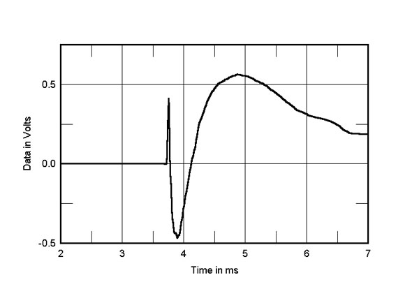

                                                                                          Another interesting comparison might be made, examining the step response.

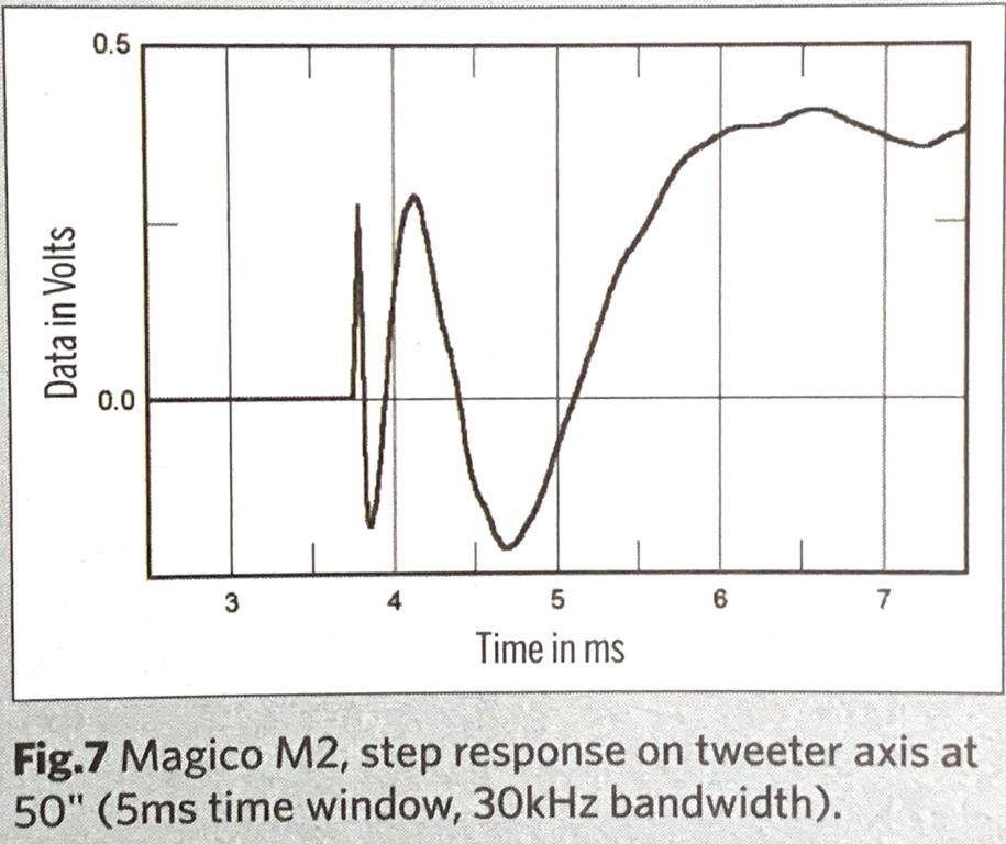

                                                                                          The Magico M2 has a rather "classic" profile observed when using high order crossovers with all drivers in the same relative (positive) polarity.
Name:	Magico M2 Step response.jpg
                                                                                          The Mino looks quite different, with the midrange out of phase, as required with a Duelund crossover.
                                                                                          Interestingly, JA's comment indicates he may understand just what it is he's likely looking at, but he does not spill the beans...
                                                                                          Turning to the time domain, the Mino's step response on the tweeter axis (fig.8) indicates that the tweeter and woofers are connected in positive acoustic polarity, the midrange unit in inverted polarity. However, the decay of the tweeter's step smoothly blends with the negative-going start of the midrange unit's step, the decay of which blends smoothly with the positive-going start of the woofers' step. This suggests optimal crossover implementation.
                                                                                          Optimal crossover implementation? For an out of phase wired midrange? Might that be the condition when all of the drivers are in the same relative phase to each other at most relevant frequencies of overlap?
                                                                                          Not at all surprisingly, this is basically what the simulation of the Ardent D looks like.
                                                                                          Based on the crossover correlation tests so far, I expect the completed speaker and the simulations to be in reasonable agreement.
                                                                                          Is there an audible difference or benefit? That remains to be seen....
