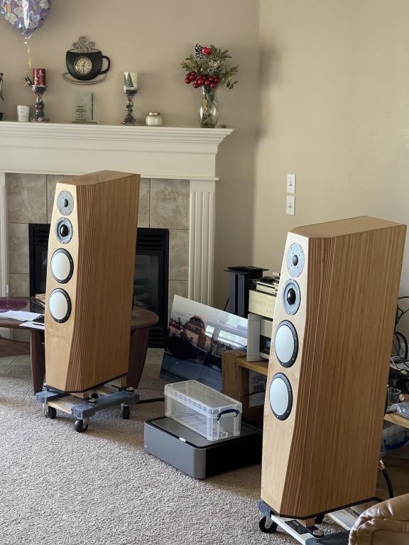

        Getting back on topic, now that our flurry of real estate activity is abating, we can get back to more mundane matters- like the Ardent D updates and evaluations.
        This is how things are looking now after a number of iterative updates- the easily removed PR's and crossover make this less painful than it would be for some of the other builds that have gone down. Famous last words, I don't think we'll be changing any thing else- I have three levels of build quality and component selection identified for Steve, but as you can see there are a bit more parts than a three way done with straight 2nd order crossovers would require, but I think the results are... interesting!
        In a sense, these kind of have three characteristics that pop out at you in different ways, as a result of the drivers and design. I'll just outline tonight, and go into details shortly.
        1. First, these are a three way speaker with all dome drivers. And if you've paid attention to the posted polar plots for individual drivers we've taken, this means the off axis response should be quite wide and uniform, and it is. Seems almost too good to be true at 60-70 degrees off axis.
        2. Next, let's just say that the more I listen to the AS168, the more I'm impressed with it's neutrality and extension and control. I know Accuton put a lot of effort into engineering speific characteristics into this part, and after working with the AS168, I am really curious to hear the AS190 in action. The tuning in this cabinet with the Dayton PR's has worked exactly as hoped and planned- I'll comment on evaluation cuts as well as the equipment setup. On some cuts the bass may almost sound too neutral- no extra fatness or warmth. But very good pitch definition. But then on other cuts, there is a combination of control and power and pitch definition which makes me hear the cut in a new light compared to past experience- this occurred on James Taylor's Gaia, for example, and Stanley Clarke's import album "The Bass-ic Collection"- for example, the first cut, "School Days", is on this album the only CD version that approaches the dynamics of the original vinyl. But the 2nd cut, "Wild Dog" really surprises on some tom-tom rolls from small to large with the presence and power and sheer musicality on display. It seems truer to me to the likely intent of the producers of the recording- and it's just a heck of a lot of fun, to boot!
        3. While the sound field all around the room is quite pleasant and well balanced, when you sit down in a classic listening position, even in this rather live and reverberant room, it's like the imaging quickly locks/snaps into place, though obviously what you get is dependent on the source characteristics. This will deserve some exploration with familiar material, but it is almost startling the way this happens as you move into the listening sweet spot- I say that even in comparison to other designs and builds I've worked on. I suspect it has much to do with the Duelund crossover behavior, which is more fully realized in this build than past efforts. (I.E., it's a bit of a b*tch to get right...)
        A lot more to come, including 8x10's with arrows and circles and paragraphs on the back...

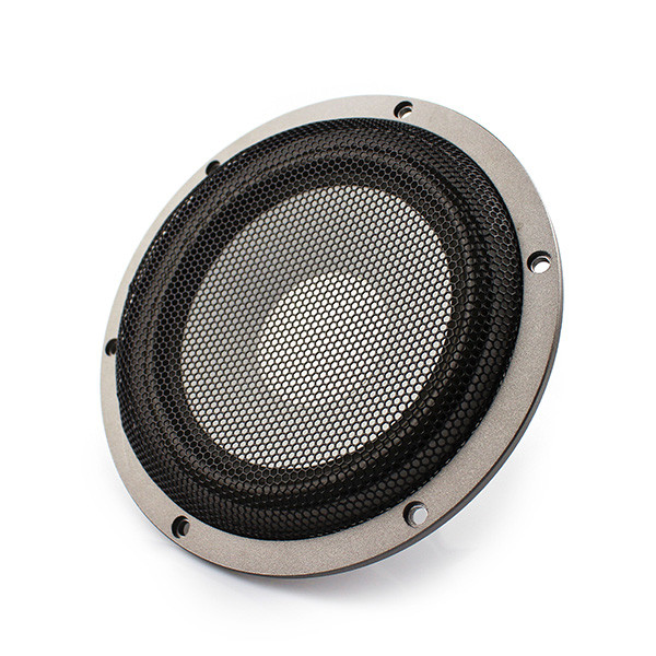

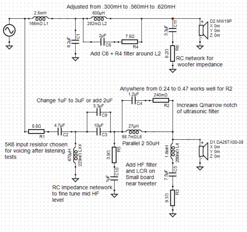

                Hi. I'm making speakers using fountek fw168k and da25tx. I would like to use same RC ultrasonic filter on da25tx like
                in this xover but there's no coil resistance listed on schematic and I don;t have an equipment to measure anything above 20kHz. JonMarsh would you be so kind and share what coil you're using ?
                BTW. If anyone wants a quality made and good sounding midwoofer I can recommend this fountek gladly .
                      I'll get the info for you from the Calliope two way I created for Steve Manning, which uses the same tweeter and technique. I've got real estate meeting with our builder most of the day, so it may not be until late, or late this week (travel for three days starting tomorrow).
                      The Fountek is a nice looking part, kind of like the FW135 I've tested, but haven't used in a design yet.

                      The actual production FW135H parts have a grille like the FW168K

                        Looking at my day, if I don't get this done right now, it won't happen until late in the week!
                        Here's the crossover schematic: Note, it takes two of the 50uH coils wired in parallel to get the target value, unless you have an LCR meter and can unwind one of them to the correct inductance.
                        PE part number is 257-798.

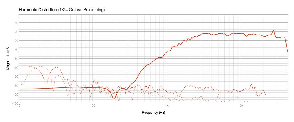

                        Here's how well this measured, including distortion. You can see it essentially completely kills the 2nd Harmonic resonance amplification distortion component.
Name:	DA25 MkII Distor.jpg
                        As you can see, the DA25, implemented properly, is a honey of a tweeter, with the maximum 2nd harmonic distortion products at 90 dB SPL at about -60dB. 3rd harmonic is 6-8 dB lower. That's pretty much world class.

                                            Well, here is a view regarding an update on the enclosure documentation, not just for "closure", but because there is a chance that a set like these may be built by Steve for an HTG member.
                                            This is part of an overall methodology which will include a more complete review of the crossover (some possible tweaks already identified, could be considered optional, but... not for me!)- this will inhabit my living room for a while once the crossover updates are completed. Updated STEP files are ready to share with Steve. And the midranges in this implementation are the set of NIB Vintage RS52AN as described above.
                                            Here, I will share a few views and a photo- the Shapr3D views are both Birds Eye and mouse eye to show how the perspective behavior in CAD drawing can be misleading, in a way, at certain angles! This was mentioned even for the early versions prepared with ViaCAD. It shows up with the upper facet bevels looking longer than the lower ones, when the reverse is actually true.
                                            Note, these images are shown with the woods used in my original build; Maple pin block for the front panel and top panel, strip bamboo with an inner wall of BB ply for the sides and back.

Name:	Aberdeen setup copy.jpg
                                              • 1577
                                              #293
                                              Still a classic design, I really like this aesthetic. I might be biased.
                                                • 16172
                                                #294
                                                We all have our preferences, of course. I do like how this turned out, and how it has a nice visual flow, a very simple finishing process, and no veneering!
                                                of course, there is a price to that, in the choice of materials- such as the strip style bamboo board from Woodworkers source, 1/2" BB ply for internal panel build ups (Woodcraft), and the use of 1.5" maple ply pin block from Piano Showcase for the front panel and top and some internal parts. You don't get any of that stuff at the big box stores, but it's fairly easy to get online!

                                                  Been a long busy day since early, many things accomplished, including installing another Vintage Mid in the 2nd enclosure, measuring it by itself, and taking a look at the full crossover design update based on this new data, plus tweaking the woofer and tweeter a bit.
                                                  But until I get the tweaks and updated midrange crossover implemented (which also means waiting for parts), I'm just going to share a raw measurement of the RS52AN vintage part in the 2nd cabinet. I didn't get around to doing that measurement in the first cabinet, because I knew the driver was basically OK based in the impedance check- and all the vintage parts have gone through that screening.
                                                  So, just a tease... I imagine the first "gold" prototype samples of the RS52AN looked a lot like this... but the 2018 and 2019 parts I got sure didn't.
Name:	RS52AN-V3 SPL-2 Disto.png

                                                      #297
                                                      Looks really promising Jon!
                                                      It's been a while, could you provide some insight on why the AS168 was chosen given the final tweeter and mid used?

                                                        Well, it would be much easier for you to just read the earlier parts of this thread than for me to write it all over again… some relevant post numbers are 5, 31, 33, 37, 39, 80, 227.
                                                        But the key point is that unlike the LR3 crossover I came up with (that is not an alignment sanctioned or described by Linkwitz; he was surprised when I explained my reasoning to him for a 3rd order mathematical equivalent at a CA DIY meet), the Z axis acoustical origins of all drivers for a Duelund crossover must be in the same plane. Additionally, having measured the AS190 at length for the Kurosawa system, I really preferred how the characteristics necessary to get the acoustic origin in the mounting plane could also create a nominal baffle step compensation built in, so that large inductors can be avoided in the crossover. The AS168-9-470 and the AS190 both like to live on 12" wide baffles.
                                                        AS190
                                                        Click image for larger version  Name:	AS190 On Axis 15cm.png Views:	0 Size:	79.3 KB ID:	956968
                                                        AS169-9-470
                                                        Click image for larger version  Name:	accuton_AS168-9-470_(Photo).png Views:	0 Size:	701.0 KB ID:	956969
                                                        AS168-9-470 12" wide vertical test enclosure, in room, not outdoors. 1/48th octave smoothing (I.E., none for all practical purposes.)
                                                        Click image for larger version  Name:	ASD168-9-470 Test box.png Views:	0 Size:	134.8 KB ID:	956970
                                                        One more thing- a polar set 0-60 degrees for the AS168-9-470:
                                                        Click image for larger version  Name:	AS168-60Deg_1-48th.jpg Views:	0 Size:	96.4 KB ID:	956971​
                                                        All of the chosen drivers have exceptional polar response throughout the operating range.
                                                        As to the DA25TX, I still maintain as ET did then, that it's the best $400 tweeter money can buy, especially at its normal price. Thats based on many comparisons with competing parts from well known name brands, with flatness, distortion, and uniformity off axis being key considerations. And by distortion I mean comparable HD2 and HD3, unlike the parts from some well known builders.

                                                          Well, at this point, getting crossover parts from Solen in Canada seems like swimming upstream against some national trends, but the parts I wanted to tweak up the DA25TX crossover have arrived yesterday. Due to internal AudioWorx Design Rules and procedures, this means building a complete new version, not modifying the original, so that the original is always available in its native state for comparisons.
                                                          Yes, I have a lot of crossovers sitting around here documenting past design stages, but I find this comes in very useful for exact checks and comparisons, and sometimes for doubling back in a sense, as is happening for the TPL75 crossover for the Saint-Säens. I'm too used to a certain kind of engineering environment at work, also with my self imposed rules.
                                                          Note, this is not an intellectual exercise, but continuing the work for a value customized version of the original build for JimS, who's working with Steve on the cabinet configuration after I sent them some updated 3D CAD files setup for the vintage RS52AN I have on hand, along with DA25TX00-8.
                                                          Here are the parts that arrived yesterday, Solen was chosen because PE was out of stock on too many parts. Hmmm....
                                                          Solen caps and inductors, with a different brand of non-inductive resisters using a film composite.
Name:	Parts is parts.jpg

                                                                  Doing a second build on the tweeter crossovers with some tweaks proved to be more of a PITA than I expected- mainly due to component availability issues at PE. So a lot of the parts came from Solen in Canada.
                                                                  A few comments may be in order:
                                                                  This drawing (created in EazyDraw) shows the relatively relaxed layout, based on using the previously available board space.
Name:	ARD HF Xover Rev Bottom Row 2-8-2025 Update.png
                                                                  Note, for example, the two 1.0 uf caps comprising C7. Do NOT substitute a 2.2 uF cap in place of these for optimum results- it's literally about 10% too much capacitance for the design. Note, the tweeter ultrasonic filter has been converted to a parallel configuration series notch. Easier to get precision than adding a small value resistance in series with L9.
                                                                  Here is a photo from the top of one of the actual builds- input connector on the left. Resistors are very low inductance parts available from Solen. PE didn't even have the right standard values in stock when I was building these months ago.
