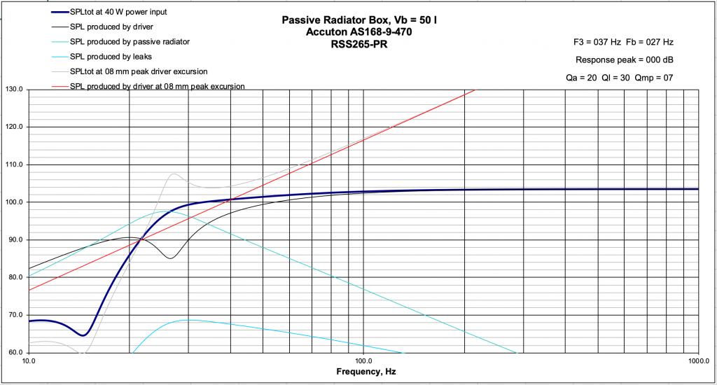

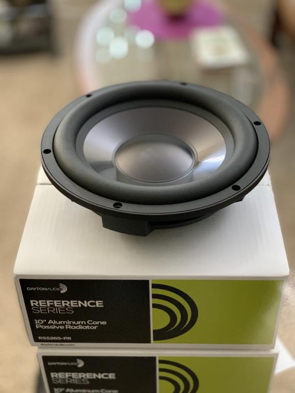

                      The test Passive radiators arrived yesterday..
                      Passive radiators are being considered to extend the low frequency output capability as regards SPL and extension, without the space and other penalties of a ported configuration, particularly a downward facing port's interference with the most convenient place to locate crossovers in the cabinet.

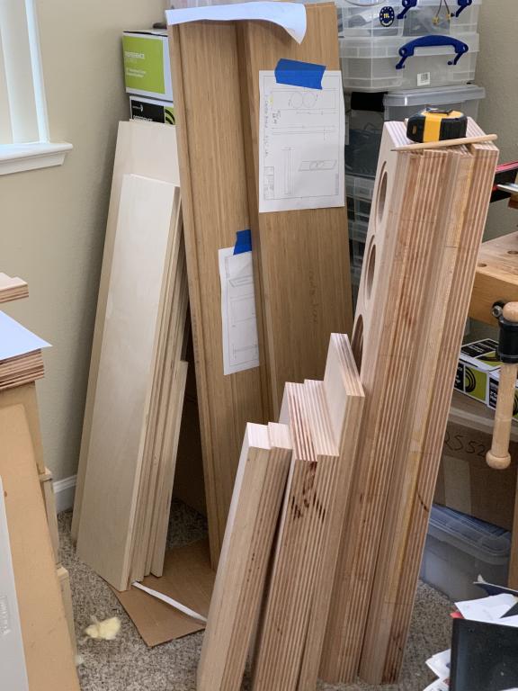

                              Ripping operations complete
                              In spite of several disturbances in the Force, some progress was made and I can now report that all piece part ripping operations are complete, and the table saw is being taken to off site storage.

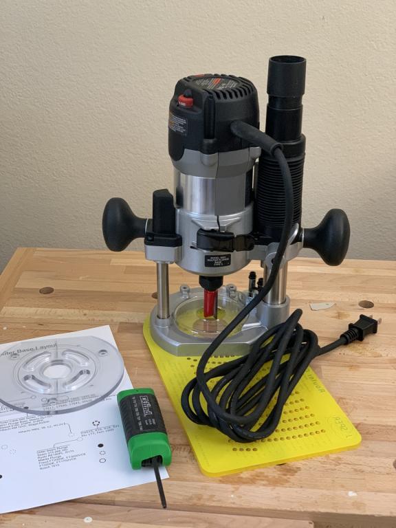

                              Additional fabrication support hardware and more tools have been obtained...
                              Events are unfolding at last as I have foreseen...

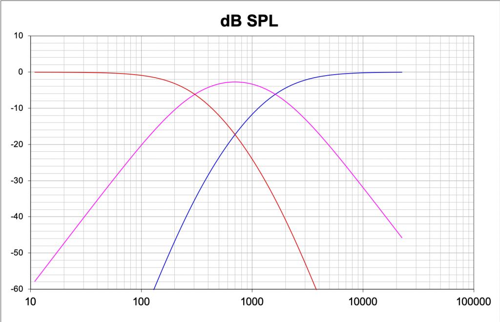

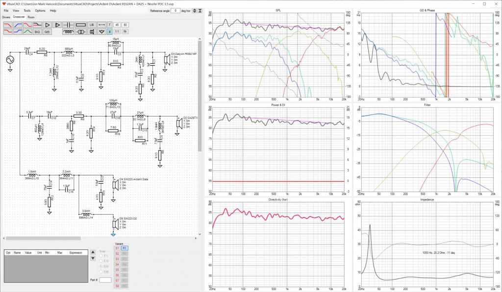

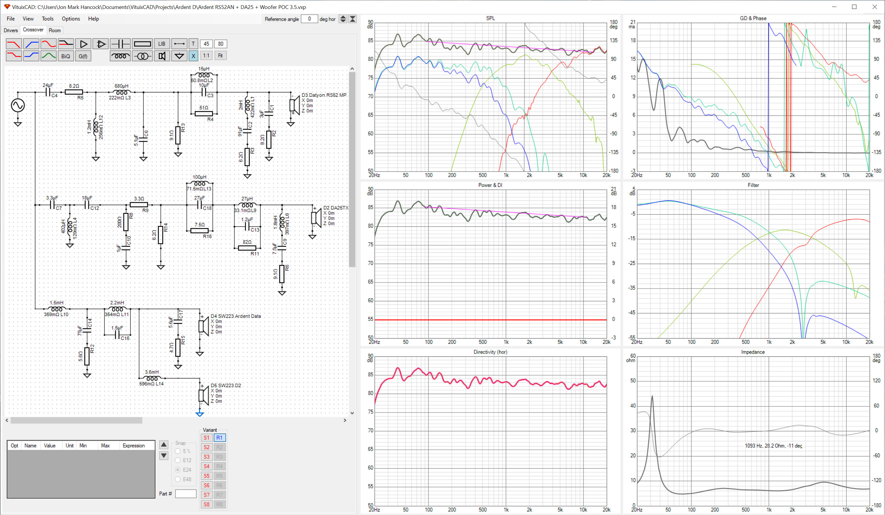

                                    The transmission incurred some unavoidable data loss...
                                      This may be illegal technology to use in this quadrant, bypassing the normal net systems, but the quality should be better...
                                      Note that this is the 3.5 way configuration with "warm" voicing...
                                          Very much appreciated! One follow-up: in a volume/baffle area/budget unconstrained galaxy, would a 2xSW223BD02 in series + a single SW233BD03 for bafflestep be interesting/viable? Asking for a Stormtrooper with bad aim.
                                          I might as well throw another follow-up into the mix (so I understand how Unibox is doing the math): would this be in a ~50L cabinet fully stuffed, or would the sim work in smaller (holding to a BW alignment)?
                                            Two caveats.
                                            One. The driver sets must be in separate acoustic spaces, as regards the rear chamber.
                                            Two. A key point behind the .5 way concept is reducing the effective CTC distance by having only one driver work all the way up to the midrange crossover frequency. By that reasoning, the one driver should run up to the midrange crossover, and the two drivers should be the 0.5 crossed lower. Getting the balance right might be tricky...

                                                  Thanks for the heads-up. Using the singleton as the "main" woofer makes sense definitely makes sense, and I hadn't drawn the right conclusion. By my math, the paired 'BD02s are about ~2dB more sensitive than the single BD03, and that's the opposite of what I'd desire from a 0.5 driver. This looks like it would work in about 35L net with about 1.75lbs of stuffing if my math isn't off. Handling the DCR on the woofers is making a big variability in my numbers.

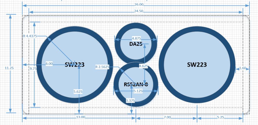

Name:	NeoD Wavecor CC Baffle Layout.jpg
                                                    Going with doubled-up walls would make this no less than 12" high. Dashed lines are individual sections of LBL, with a 3/4" roundover on all edges. As-drawn, this would be 11.25x26x11.25 (HWD). However, depth is obviously the most variable, depending upon volume needed. To that end, I'd potentially replace the 'BD03s with BD02s. Hmm.
                                                    The downside of further pedaling (before getting shelled out of the peloton and abandoning) is that several of those smaller inductor values are ... challenging. Unwinding is possible, but the combo of inductance and DCR may prove fatal to my curiosity.

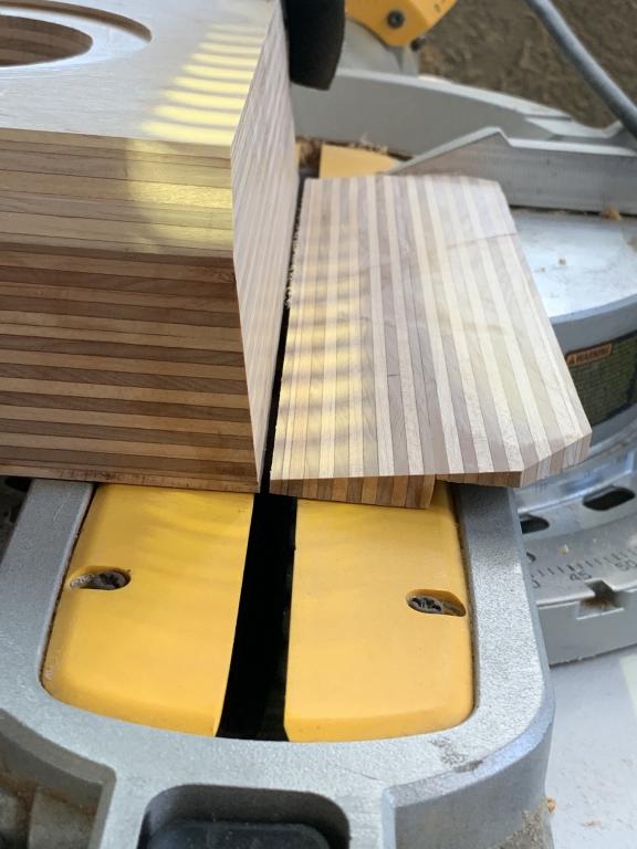

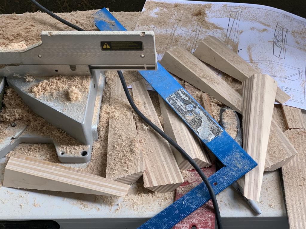

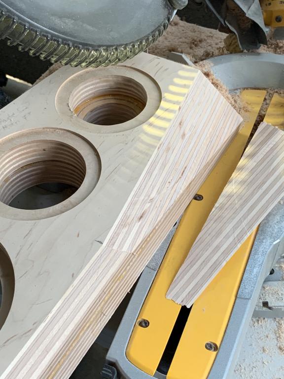

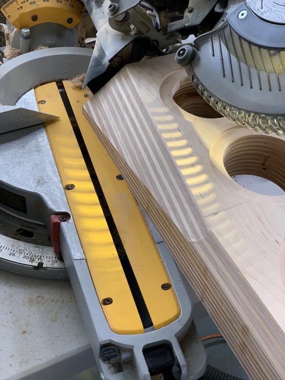

                                                                  As there will be no top bevel in this design, and to put the acoustical center of the midrange driver higher up, the positions of all drivers on the front panel have been raised. Additionally, after review of the materials and available working dimensions, the length of the front baffle and cabinet panels has been increased from 40" to 41". This was implemented in the top and bottom bevel cuts.
                                                                  The tooling was carefully checked before being employed, and square results were verified, along with the finish of the cut.

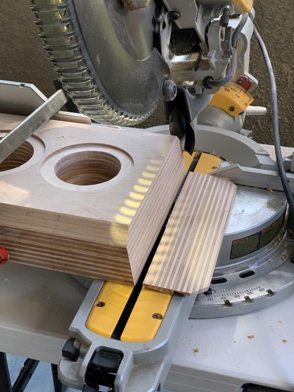

                                                                  The lead lines and dimensioning for the facet cuts were carefully transferred from the printout to the baffle, along with the angular setup, and the illuminated cutting guide used as always to assure precision results...
                                                                  On both sides.
Name:	And the other side.jpg
                                                                  It is a time consuming and expensive way to "generate sawdust".
Name:	remains of the day.jpg
                                                                    Be careful not to choke on your aspirations...

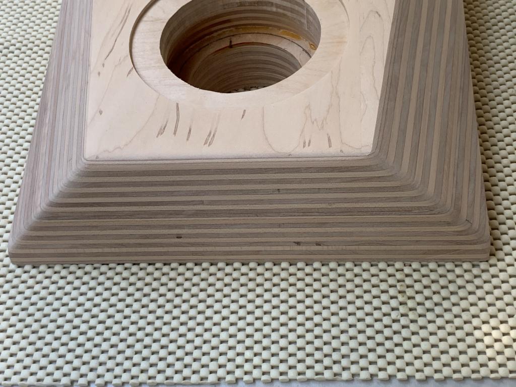

                                                                    Clearly we are making progress today... but there there is much left to do, and many opportunities for error before completion.

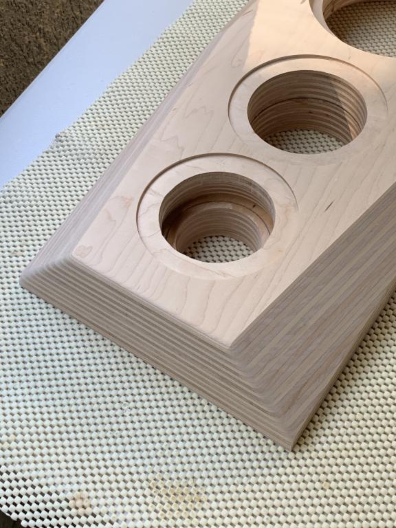

                                                                    Rough sanding and shaping the top surface is quite straightforward...
Name:	Top BevelSS.jpg
                                                                    The upper facets were cut so precisely they still had a bare trace of the pencil lead showing on the front before starting sanding...
                                                                    If my light saber had been available, that small error might not have occurred...

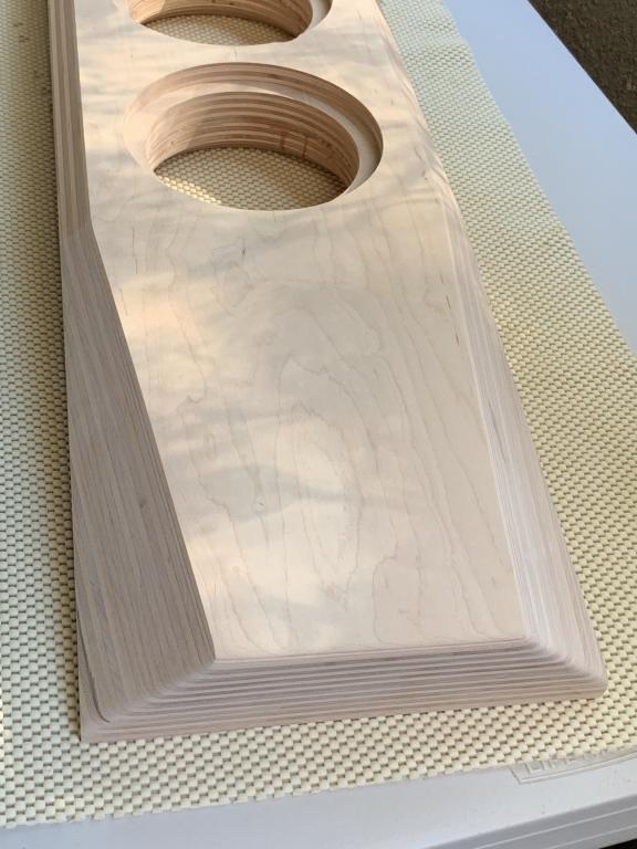

Name:	Top facetsSS.jpg
                                                                    A minimal effort was required to rough sand the bottom bevel and facets and edges, and now these front panels are complete...
Name:	Bottom FacetsSS.jpg
                                                                    completely ready for the next assembly step...
                                                                      • 698
                                                                      "It is a time consuming and expensive way to "generate sawdust"."
                                                                      Yes, but the by product of the sawdust is beautiful and very promising indeed. Now that I have a Bosch gliding miter saw I really should take up one of these tapered projects again too. When making Wavecor Ardent I did not have one yet and without it was even more time consuming.
                                                                      Btw, I'm not sure what is the combo of drivers you did cut this out for in the end?
                                                                      Waiting eagerly for further progress
                                                                        There is another...
                                                                        These test cabinets will be employing Dual Accuton AS168, RS52AN, and the DA25TX00-08. The intent is completing a stereo pair in the relative near term, so I have better music listening while still living in California.
                                                                        There is another test mule cabinet somewhat farther along (the complete rear shell is fabricated, only the front panels remain) which was created to also test cone midranges, (though RS52 can also be used) and it will be used to evaluate configurations with the A708 and the PTT6.5W04-01A. The SB15CAC was/is a candidate, but now I am also curious about the 554, and have a tentative Duelund configuration for that driver... but it would require one of the BlieSMa tweeters, in my opinion...
Name:	554 Mid Duelund 700Hz.jpg
                                                                        Additionally, both woofer and midrange test cabinets are nearing completion for doing IM distortion tests. with my Audio Precision analyzer to evaluate BL force linearity and surround behavior, as was done by HiFi Compass. The woofer test cabinets will be using the RSS265PR as planned in some of the assembled systems, and this phase will include verification of the modeled LF system response generated by Unibox and VituixCAD.
                                                                        To ensure consistency of procedures and results, all the test DUT's will be readied and tested at the same time. A complete renovation of the test hardware has been underway with an update in the audio test interface to a more modern Motu 4 using SABER DACs, also with reasonably high grade microphone preamps (which the TC Konnekt was selected for and did have) and a new MacBook Pro with Thunderbolt 3 to replace the 6 year old model with Thunderbolt 2, which had to use a dongle interface to connect to the Firewire TC Konnekt that I have been using over 10 years. I have two ACCO 1/2" calibrated microphones now, and this may open some additional testing options.
                                                                        For midrange evaluations, I propose to double or quadruple the test frequency- for example, instead of 30Hz + 255Hz for the woofers, 60 or 120Hz for the low frequency, and 510 or 1020 for the upper frequency.
                                                                        I will also attempt CSD comparisons, to develop a wider base of objective measurements for driver comparison.
                                                                        This is merely an experiment, and may not produce any definitive results... but my Force Intuition says it may be interesting... most interesting.
                                                                        • Browncoat
                                                                          • Oct 2016
                                                                          • 131
                                                                          Cross-cutting a couple inches of maple on angle without burns? Imperial technology tuned and handled with precision.
                                                                            Actually, 3" of maple ply...
                                                                            after cutting that material, as I remarked to Steve Sunday night, 3/4" LBL bamboo is like a hot knife through butter, and BB ply seems like tissue paper.
                                                                              • 1044
                                                                              The Dewalt SCMS certainly did some good work. What blade did you use?
                                                                                The blade I have been using with the DWS780 is the DEWALT 12" DW7661 80T laminate blade; this is a thin kerf version with a 12 degree tip angle and 0 degree hook, selected for the ability to produce very smooth cuts, especially in laminate or material like laminated bamboo ply, for which it was primarily purchased. It has worked very well with maple ply for the Kurosawa build and this new experiment.
                                                                                  [ATTACH=CONFIG]29950[/ATTACH]
                                                                                  Yeah, that transfer function puts a lot of stress on the tweeter. You don't think the DA32Tx could handle it? IMHO this is a very interesting Dueland alignment - I think there are a fair number of woofers/mids that could handle this if you can figure out the tweeter.
                                                                                    • 1044
                                                                                    While the measurements haven't been provided, there have been comments that the larger unit just doesn't perform to the same level as the 25mm version.
                                                                                      I do plan my own investigation of that.
                                                                                        Now, the best part of the week....
                                                                                        I love the smell of Porter Cable Routers in the morning...
                                                                                        • dwk
                                                                                          • 251
                                                                                          interesting - searching around doesn't turn up a lot on the DA32, but what is there seems to be at least tentatively positive. will be interested to see what ET measures.
                                                                                          Looking again though, that Dueland alignment doesn't seem to put any more stress on the tweeter than LR2@2k - both are -20dB at ~600Hz. There are some preliminary measurements of the DA25 and DA32 LR4@1.4Khz here http://techtalk.parts-express.com/fo...10#post1381410 and both seem to be holding up ok, if not exactly spectacularly. level is 103dB @6", or about 88dB@1m (I think). The 32 definitely is looking more comfortable between 1k and 2k, but the 25 isn't waving the white flag just yet.
                                                                                          (LR4@1.4k seems to be about as demanding as the Dueland target down to 700Hz; since we're already 20dB down, hopefully this is a relatively valid comparison)
                                                                                            This correlates well with the extensive measurements I've made for the DA25. I am primarily concerned about how difficult it will be to control the ultrasonic resonance and minimize resonance amplification of distortion products- that has been quite successful with the MT test design for Steve.
                                                                                            Thank you for the link to the other measurements- it's my usual practice to test at 90 dB and 96 dB for a tweeter like this...
