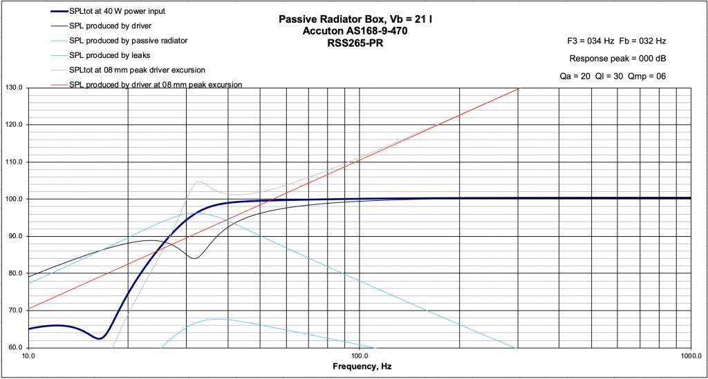

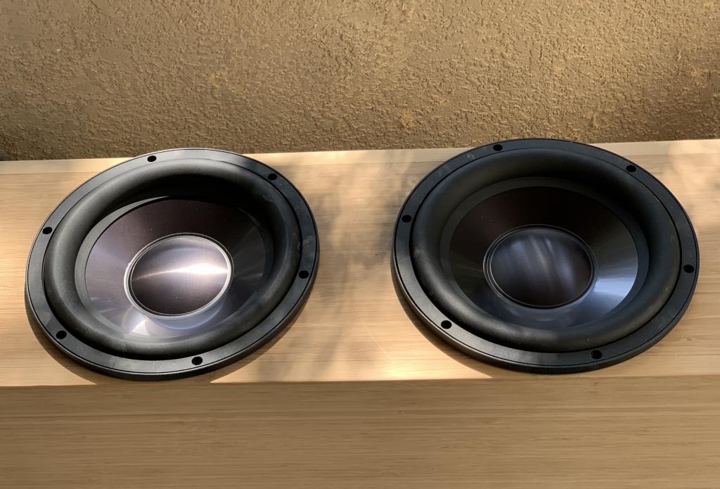

          More test cabinets in process
          LF test cabinets are being prepared...
          A design target has been set for 21L per driver... using an RSS265PR with 275 grams of mass

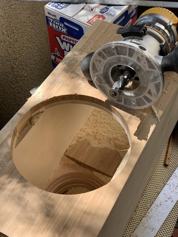

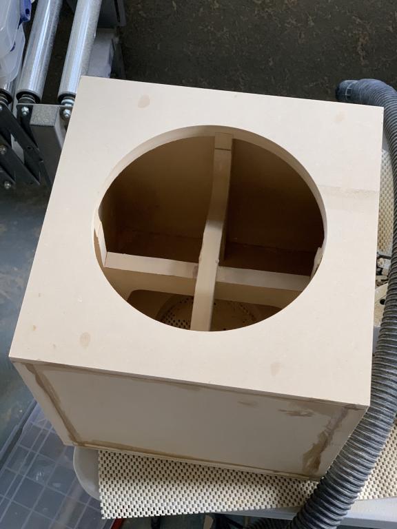

          Of course, hardware verification prior to completing a cabinet build is mandatory...

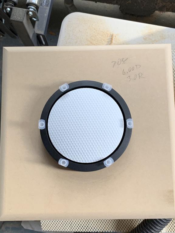

          Test cabinets were built, and holes for PR and main driver candidates (AS168, Anarchy 708) prepared this weekend....
          The modeled configuration of 21L per driver, with a 275gram weight for the PR is fairly promising- here, showing the expected response with 40W of drive power.
Name:	AS168TestCab PR-Hole.jpg

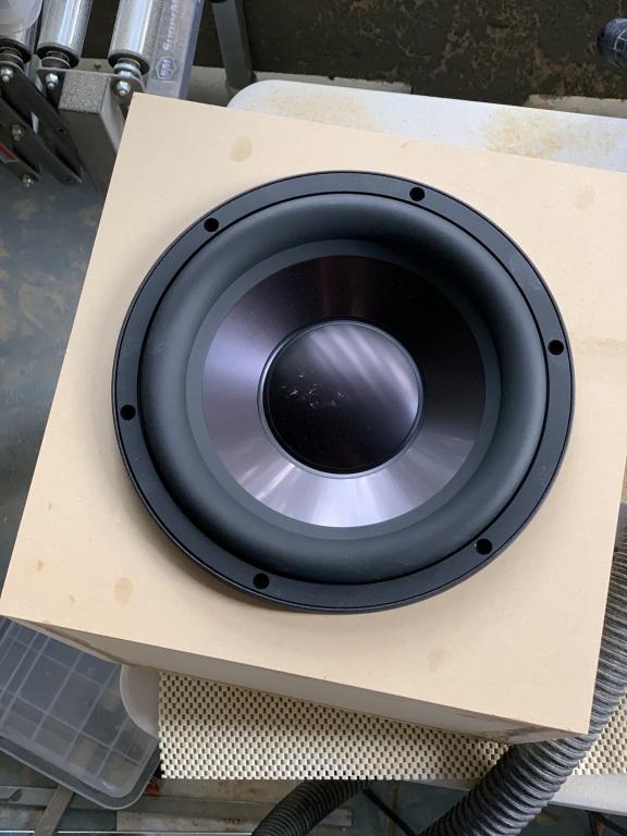

          A driver mount check for the RSS265PR...
          And quick driver mount check for the AS168

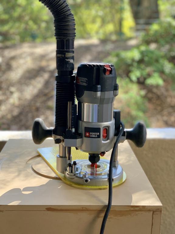

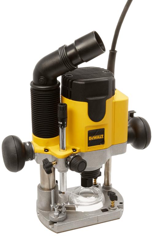

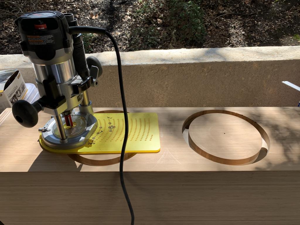

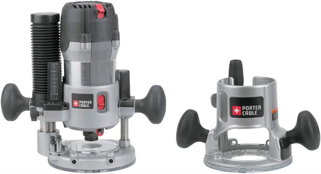

                I love the smell of Porter Cable Routers in the morning...
                New router? How does the Porter Cable compare with the Dewalt DW621?
                  #98
                  It compares very well, and may have a slight edge in dust collection. But the DW621 has a slightly smoother motor.
                  of course, there is a certain "esthetic" attraction for me...
                  Which do you think looks more at home in a Seinar Research Laboratory?

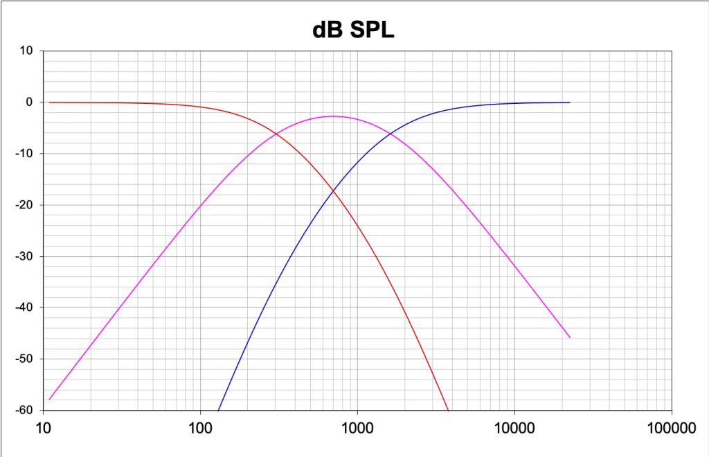

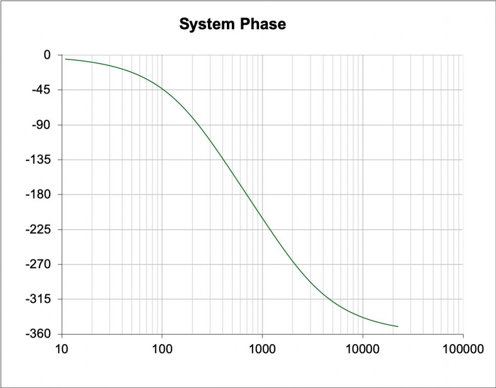

                        You are making clear progress, and if anything we have done has been a catalyst of sort, all for the better.
                        The bare DA25TX has wider and more uniform dispersion than typical of a lot of "direct tweeters", and I say this after buying and testing many tweeters in 2019... this was quite noticeable in testing the finished crossover design for the first SMJ MT, so I would suggest thinking about the tradeoffs- the SB15BAC has reasonable output capability, so reinforcing it's low end with a wider baffle is probably not really necessary- or useful. But in the end I suggest not taking my word for it one way or another, but since you have an active platform (planned? or on hand?) for concept evaluations, try it out, and go for real data using a lazy Susan setup (Woodcraft has bearing sets to build high capacity ones if you are inclined). You might want to take a look at the concept for the 554 driver- if you ponder a Duelund- the SB driver may work best with something relatively similar, not too much higher in center frequency or the off axis will suffer. However, you will have a more difficult time getting the HF phase aligned correctly, due to the difference in Z axis origins. For this, a waveguide loaded tweeter could help.
Name:	554 Mid Duelund 700Hz.jpg
Name:	554 Mid Duelund 700Hz Phase.jpg
                        Yes, there are similarities between a three way composed of two LR2 networks, but the Duelund has higher ultimate roll off rates for HP and LP, and can work with a narrower midrange band pass. If implemented correctly, the Duelund will have all drivers in the same phase at least for levels down to -12 to -18 dB. The Duelund offers ease of calculating and implementing specific targets which will achieve a desired transfer function, and with dual LR-2 and "experimenting" one might have fun, but also wander in the wilderness, so to speak, not really reaching exactly the desired result.
                        But this is DIY, and if wandering in the wilderness suits your whims, why not?

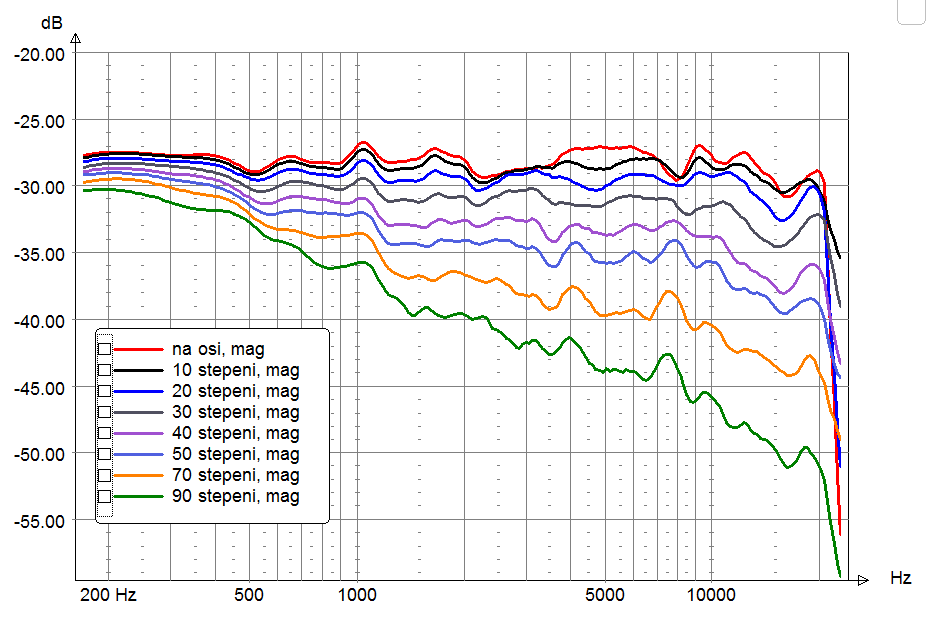

                              Getting the 'current into speaker' spectrum should be doable also with the tools I have, but I'm yet to get around to attempting that. The data it produces looks interesting though.

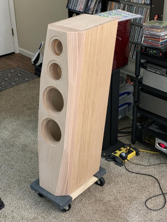

                                    To be clear- in this case the wider baffle is purely an aesthetic consideration. My design target is the SF Elipsa.
                                    This may make some of my questions/investigations a bit more sensible - will they fit in the space? how much woofer volume can I squeeze out of this form factor? Is there any detrimental impact on imaging from the wide baffle? etc. Thus the effort to create a test mule using relatively modest cost drivers to investigate (which will effectively be Troels Poor Man's Strad http://www.troelsgravesen.dk/PMS.htm)
                                    Well, maybe I have my thread title for this effort :-)

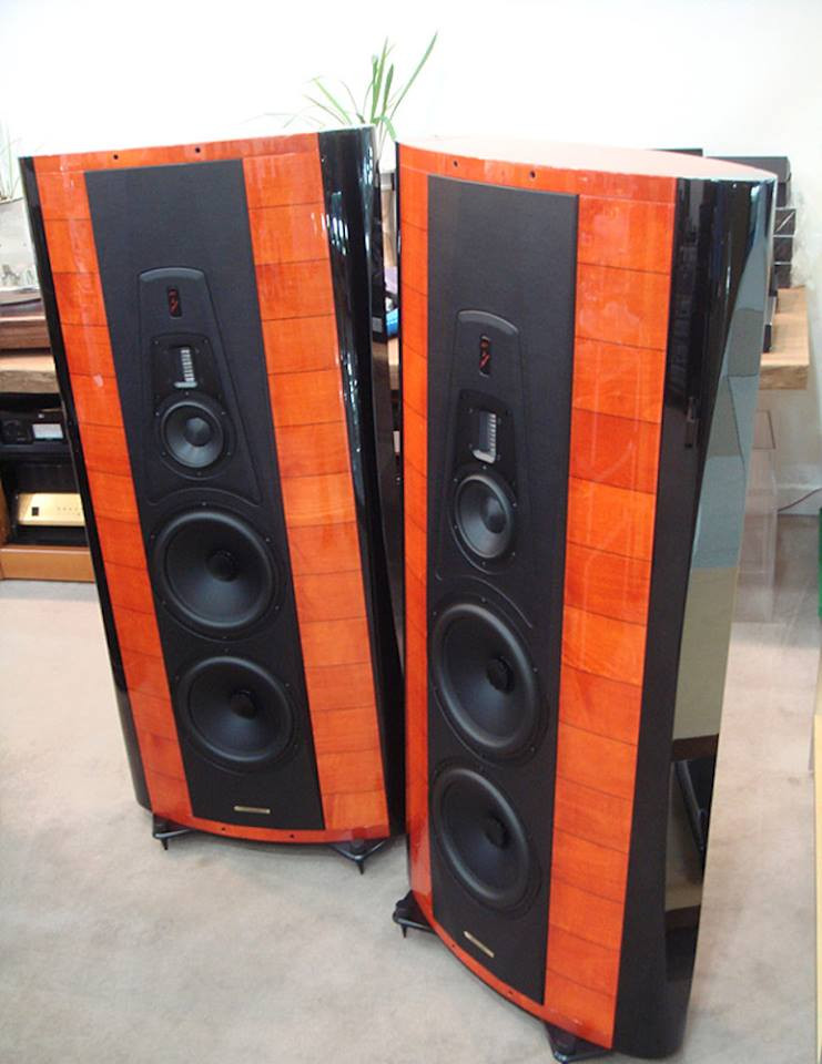

                                      Maybe you should look at these Sonus Faber Stradivari, too?
                                      Have been very popular with some folks, seems right up the same alley esthetically...
                                      Last edited by theSven; 12 August 2023, 19:26 Saturday. Reason: Update image location
                                        • 1044
                                        #109
                                        SF knows how to finish a cabinet. I keep coming back to the Strad's/Ellipsa for inspiration.
                                          #110
                                          It is rumored that they take 4 weeks just to cure the lacquer finish...
                                          • dwk
                                            • 251
                                            #111
                                            The Strad is definitely impressive, but I actually prefer the design of the Elipsa - I think the single woofer looks more balanced. The opposite of the Avalon style designs - I think they look much better as dual-woofer designs that single woofer.
                                            But both are definitely very pretty, though. The obvious potential flaw in my grand plan is that my woodworking skills may not be anywhere near good enough to do justice to the concept.
                                            There is actually a pair of Elipsa for sale 'locally', but for some reason the wife is balking. https://tmraudio.com/speakers/floors...ecial-edition/

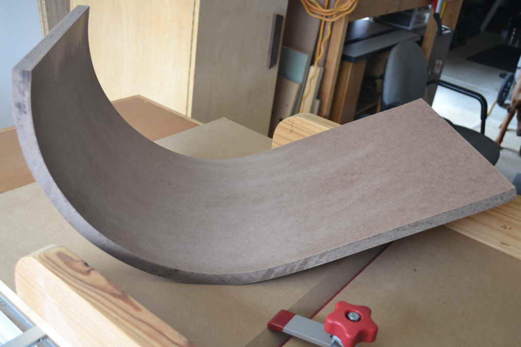

                                                          Here's an idea for you, not so much as go out and buy it, rather, the concept. https://www.curvomatic.com/
                                                          I made these out of layers of 3/16" hardboard. There very strong with very little spring back during the glue up process. Getting the profile you need shouldn't be to crazy to do. Use your CNC to cut ribs, top and bottom and away you go.
                                                          If you have a band saw, you could laminate some wood together and cut the profile on the saw.

                                                            Your feedback is welcome and seems to hit on key points... dull versus shouty can also be an indication of variation in axial response versus power response - lacking in power response off axis, but clearly showing a coloration if the level is boosted to compensate...

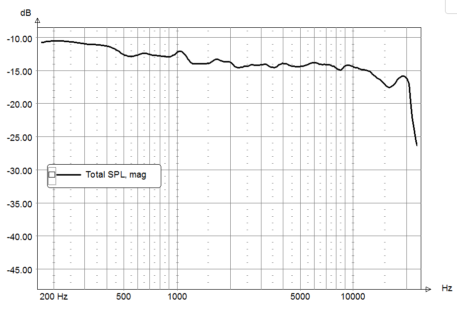

                                                            My thoughts exactly at the time. Then i did measurements 0-90 degrees and averaged them. This was the result:
                                                            Averaged:
                                                            That's when i started to look at other directions to search what may be the problem. I even wrote something about it here:
                                                            Measurements are done in factory cabinets, gated, at 1m distance mic at tweeter axis - gate is good to 250Hz. Holm-impulse, calibrated ECM8000, M-Audio Fast Track II USB interface Dell Inspiron notebook. Vertical grid is 40dB, with 1dB resolution. Link to gallery: https://postimg.cc/gallery/3dpsmrwd4/ Tweeter on axis and 30
                                                            I should take R300's back for a revision. I've found some midwoofers that could work in smallish volume in the meantime.

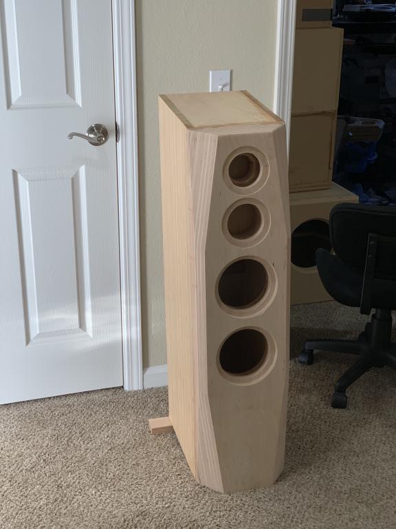

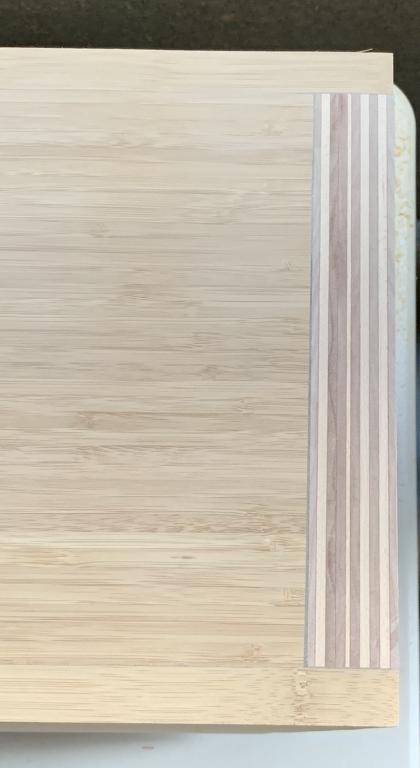

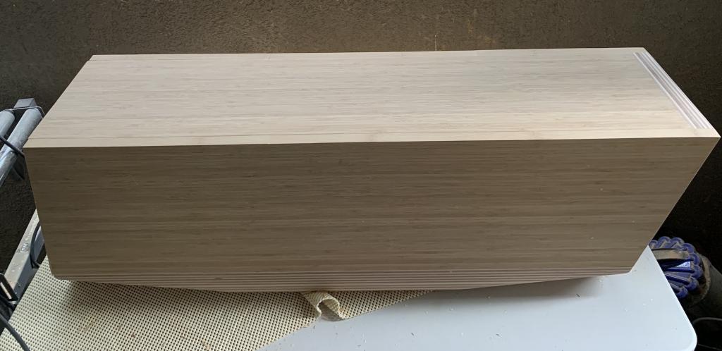

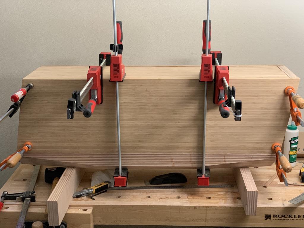

                                                              In the meantime...
                                                              This thread has languished for some time, not due to lack of activity, but due to priorities- continuing construction activities. It will be updated in detail showing the phases of efforts for those interested.

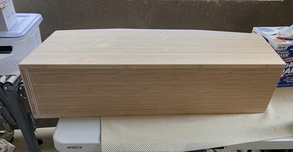

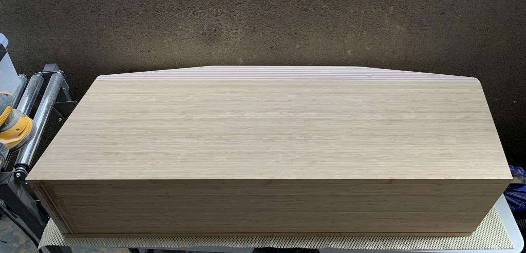

                                                              For those who enjoy a fast glance at an advanced stage of construction, this picture may be interesting...
Name:	Complete Glue UP_SS.jpg
                                                              Setup and the work steps leading to this will be posted soon in an organized fashion...

                                                                    This is the smallest Ardent style project as regards external physical dimensions, but the weight per enclosed volume seems to set a new benchmark.
                                                                    There are many additional steps before they will produce music, but it is most satisfying to see this stage realized at last.
                                                                    As expected, managing some dimensions with regards to the visual character of the design is tricky- looking at this picture, you will most likely think that the upper facet bevels are longer than the lower, because of what the driver arrangement does to the eye/brain interface, as well as perspective- but the lower facet bevels are 2" longer.

                                                                                  #130
                                                                                  Some progress is being made...
                                                                                  In a project like this, there is much detail work- at times, the hardest problem to solve is finding the time for this work when Imperial matters keep intruding...
                                                                                  But complaining does not solve problems, or build speakers.
                                                                                  Operations such as basic side wall clean up and sanding are easily completed...
Name:	1_First Side Sanded.jpg
                                                                                  The only real "trick" involved here, since no veneering is planned, is that enough material must be removed so that the surface seepage of epoxy into portions of the wood is completely removed...
Name:	2_SideSand Detail.jpg

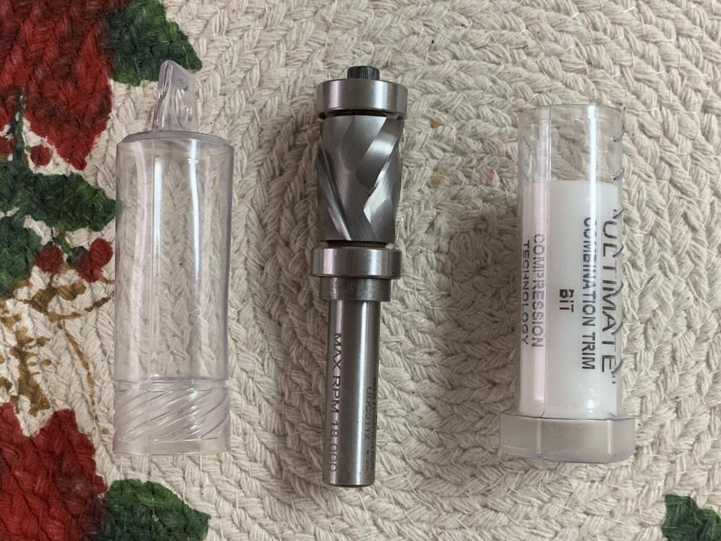

                                                                                  Specialty tools are advised for operations such as leveling the sidewalls to the rear panel...
Name:	3_Dual follower TrimBit.jpg
                                                                                  The results prove most satisfactory...
Name:	4_BackTrim & Sanded.jpg

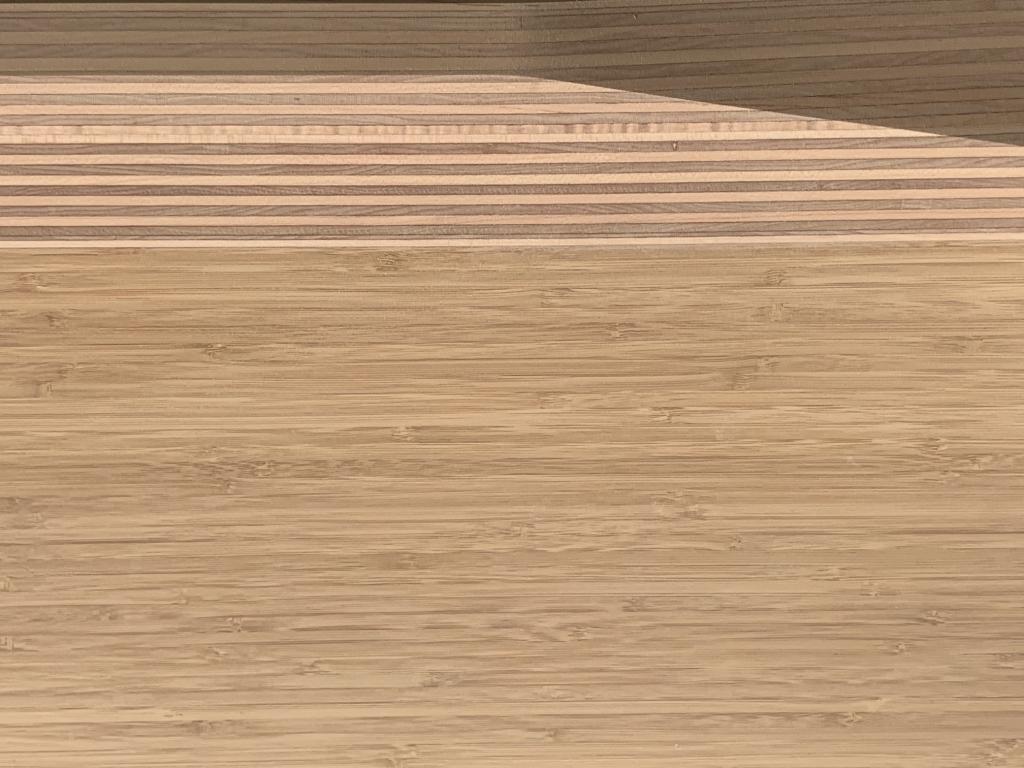

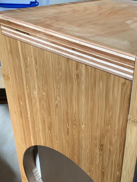

                                                                                  Whether the matching of LBL and Maple ply will be esthetically acceptable is a judgement call, but it is deemed adequate for a rarely seen part of what is essentially a design study, not a finished product.
Name:	5_TopBack Detail.jpg
                                                                                  For only two hours of work, the results are acceptable...
                                                                                    • 1044

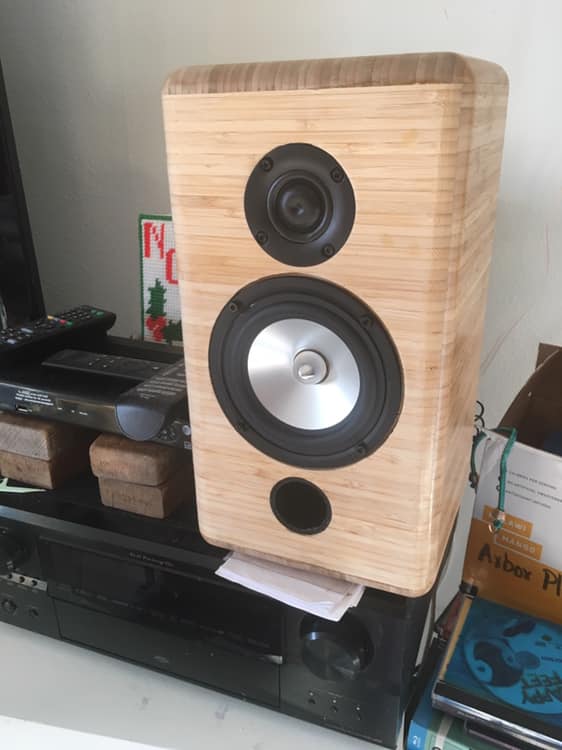

                                                                                    #131
                                                                                    If one is careful with the machining, especially roundovers, and one likes the look of the bamboo, it can be surprisingly cost-effective compared to MDF+Veneer. And one gets to stay away from MDF.
                                                                                      #132
                                                                                      More progress has been made, to the point that one cabinet is nearing completion...
                                                                                      Certain trim operations and the PR mounting holes have been completed, along with a fine sand with 120 and 240 grit Arabnet disks...
Name:	Full Length No PR.jpg
                                                                                      After completing a base trim operation and sanding to 120 grit, the PR mounting holes bracketing the back center brace must be prepared.
Name:	Routing PR holes.jpg
                                                                                      The cut depth is to the full capability of the router on the edges near the cabinets side wall, but is restricted in the center so that the disk is still supported by a small amount of the BB ply material- then this is cut with a saber saw, and the overall hole must be cleaned up with a follower bit.
Name:	PR Hole Cleanup.jpg
                                                                                      A test fit confirms the required 1mm clearance was implemented correctly...
Name:	RSS265PR Test Fit.jpg
                                                                                      After sanding to 240 grit surface, the cabinet was placed back on it's mobile work base to return to interior storage and the next steps in detail work (installing threaded inserts, etc.)
Name:	Moved In Livingroom.jpg
                                                                                      Regrettably, the pictures do not convey the solidity and surface polish that the construction now possesses....
                                                                                      Nor the remarkable strength and solidity due to the construction materials that were chosen.
                                                                                      Satisfactory... very satisfactory.

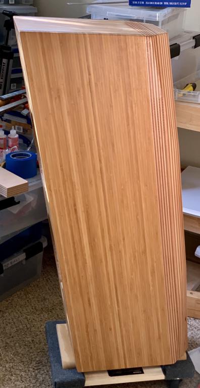

                                                                                          I have been curious to get an early impression of how the wipe on polyurethane will work with this build-
                                                                                          So after finishing the second cabinet mechanicals to the same stage as the first one above, I indulged myself slightly... by applying a fast test coat of Minwax wipe on polyurethane.
Name:	1st coat sideSS.jpg
                                                                                          While it must be remembered that the primary point of a design study is utility, it is useful if the esthetic results are not an eyesore...
Name:	1st coat backSS.jpg
                                                                                          The initial results indicate some promise, with a very simple application process... the key to productivity in a design study.
