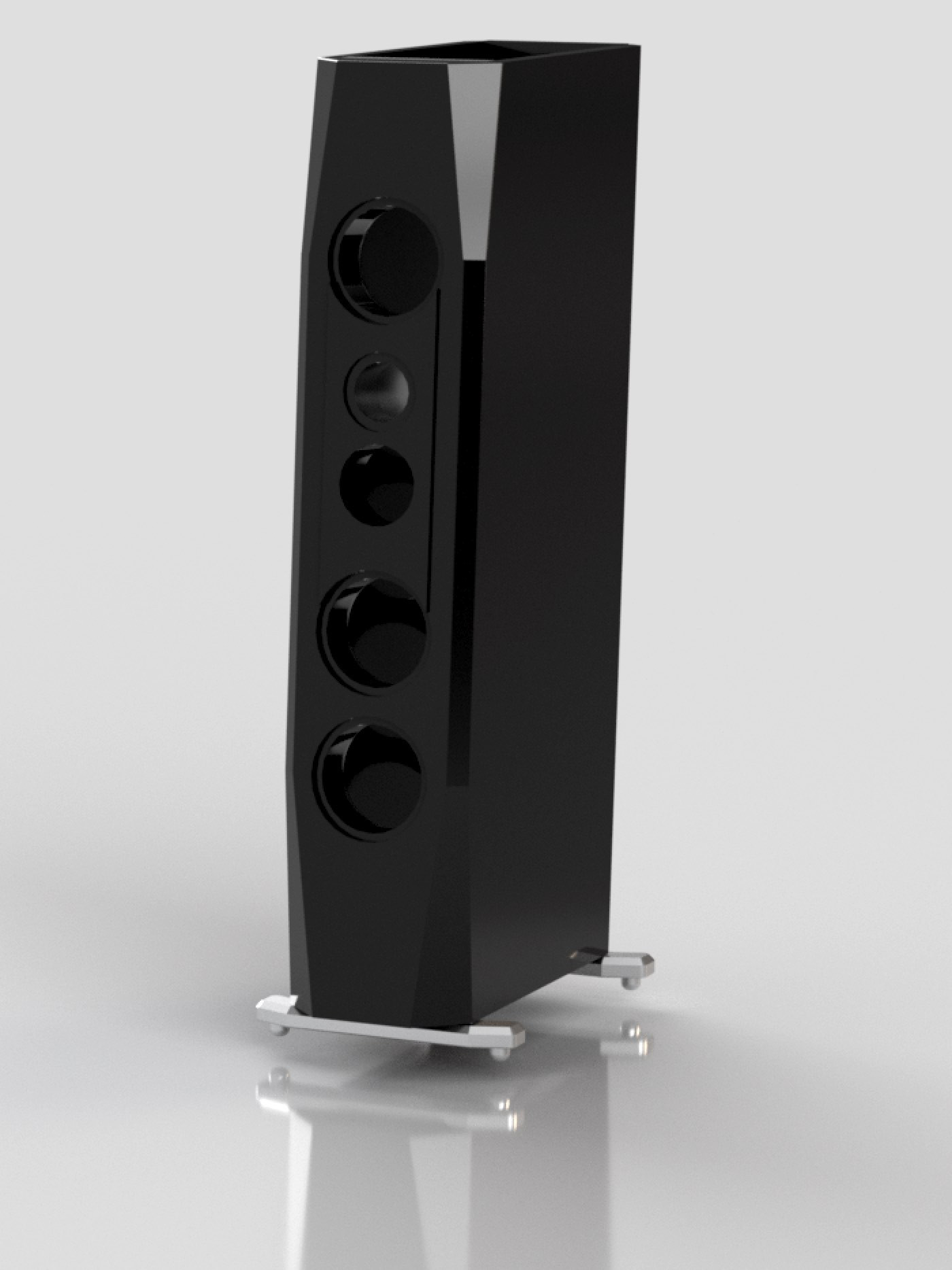

                                                              Back to the issue of sensitivity...
                                                              do you think it is possible to increase the sensitivity of Ardents by
                                                              - utilizing the acoustuic elegance woofers (that have sensitivity >94-95 dB/2.83V)
                                                              - increasing the volume to 70-80 liters?

                                                                    70 to 80L would not be enough volume increase to provide the same bass extension at high efficiency. Hoffman's iron law rules that out- sensitivity and LF bandwidth are inextricably linked to enclosure volume.
                                                                    The C79 does not have the efficiency to match up with the Acoustic Elegance drivers. For that, you need something like the C173-6-90, as used in the Avalon Isis or my own build. then you'll need a 93 dB efficient tweeter, such as the newer ScanSpeak Beryllium dome. And probably should plan on 140 to 160L. A bigger version of these.
                                                                    And you'll still have to give up 4-5 dB for baffle step compensation. True 90 dB for 2.83VRMS speakers are very rare, and usually somewhat low impedance. These will both, about 3 ohms through the bass region, with three 9 ohm woofers in parallel, with six passive radiators. All of that comes with a steep BOM cost, about $15K.
