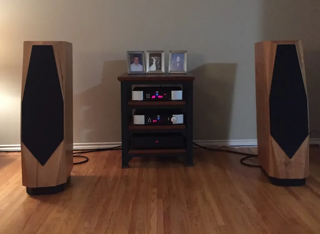

                                  Wayne and Me are planning a cruise down South on our VFR's this summer through Cali and I want to stop by and hear some other guys builds with their gear so heads up Jon and Ron and any body else close!

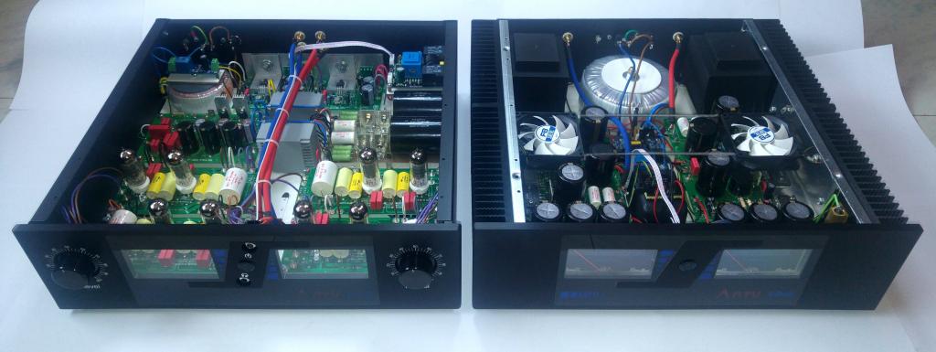

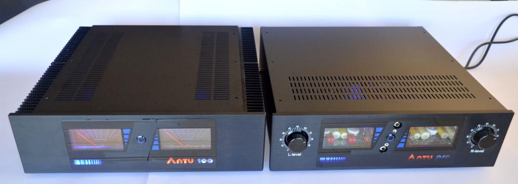

                                                                            Thanks to all for your "encouraging" replies.
                                                                            My amplifier is a particular one.
                                                                            I realized it last year. It springs from an idea and project of Bartolomeo Aloia, a true guru in Italy and Europe. He is an electronic engineer, with a very long experience in the audio industry. Now he has more than seventy years and has created a particular system, called Antu, including a tube preamplifier (Antu-pre) and a solid-state power amplifier (Antu-100). This device is underpinned by a particular philosophy; he took about 10 pages to describe it (the philosophy), in the 3 articles he published on ā€œCostruire HiFiā€.
                                                                            The main characteristics of the system are:
                                                                            • preamplifier with undistorted 20 V output (and very low impedance);
                                                                            • inductive power supply for both sections (preamplifier and power amplifier);
                                                                            • class A for the power amplifier;
                                                                            • output spectrum (from the power amplifier) similar to that of tube amplifiers (that is, monotonically decreasing);
                                                                            • 100 Watt on 8 ohm and 180 Watt on 4 ohm.
                                                                            My knowledge in speaker building is rather limited but I have a some experience in audio amplifiers (I have realized a SE 845 , a SE 300B, and a SE 6C33C… and some SS amplifier). My experience in HiFi world is long-standing but I have never heard anything that, even remotely, sounds like Antu.
                                                                            It is another world if compared with classD amplifiers. It has the sweetness of tubes and the power of a solid state.
                                                                            So, for all these reasons, I don’t want give up my amplifier system.
