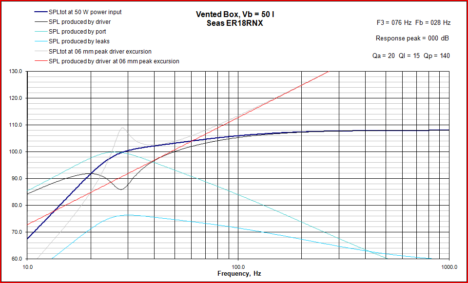

                              Ok- NOW you're making sense- 8 gauge inductors to go with 4" front panels, right?
                              You know, I have been "sweating" the inductor selection a bit... I have some stock of NorthCreek AWG 12 air core inductors, which are fairly "manly", but I've been considering some other alternatives given that the max power these guys will need or see shouldn't really be over 100W RMS (given that 50 watts in the LF region will drive levels well above 100 dB for each cabinet- see below)
                              So I am considering alternatives which may be less hernia inducing...

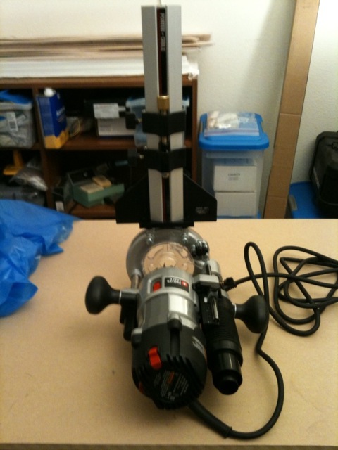

                                                                Warning- More Tool Porn
                                                                Last night I was going over the midrange enclosures, and getting setup for the center dado groove routing (13"/16") for the front and rear panels. (BTW, that's a Bosch 85457M bit- not easy to find; oversize from 3/4" for fitting a 3/4" MDF panel in edgewise; available from Amazon).
                                                                For this I'll use a Porter Cable 893 with a PC add on edge guide- it's a cool piece of gear, kind of looks like a space shuttle ready to lift off. The PC 893 comes with a plunge body that seems to copy a DW621- I.E., good dust collection in the base with port built into the plunge system, and a slick smooth plunge system- it's the best PC router I've tried so far. I like it better than a similar Bosch I have, which is why the Bosch is confined to a Freud router table with Woodpeck lift.
                                                                If I was to be ludicrously optimistic, I'd say that I'll be gluing up enclosures this weekend. The 50 minute epoxy I tried out on the midrange enclosures works very well, and has a very nice feel and set to it when hardened. Yeah, for us "psych" guys it's all about how it feels.... :B
                                                                It really comes down to a matter of finding time, but if I'm going to keep this project on schedule, I've gotta make it happen.

                                                                                    Porter Cable 893 Router set-up
                                                                                    Hey Jon,
                                                                                    How much was that Porter Cable 893 Router and edge guide? It sure looks like a quality unit. :T
                                                                                      • 16074
                                                                                      #312
                                                                                      The motor actually has the typical coarseness of PC routers, unfortunately, but it does get the job done- just sounds and feels a bit nasty doing it. :W
                                                                                      I bought it on a special sale at my Woodcraft store, don't recall the damage off the top of my head- fairly typical for a combo base router (plunge and fixed). Rockler has it in a package with that edge guide for $259.
                                                                                        #313
                                                                                        That's why I like the Bosch - the plunge setup works quite well - not perfect... but the fixed base I LOVE - best I've used. And the motor is excellent.
                                                                                        I'm not quite up to multiple routers yet, though I did finally get a drill press - since I have to do some precision drilling (one of the tuning pegs on my violin siezed and splintered to pieces so I have to replace it) I also snagged a cross-feed table. Things are getting interesting in tool-land! A band-saw away from being able to do more serious furniture work (and for that I need to sell my second car - something I've been trying to do with only nibbles, not really surprising right now)
