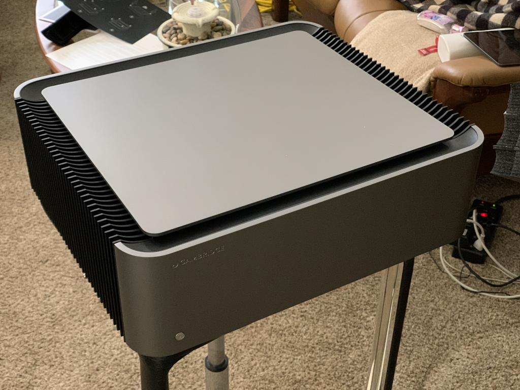

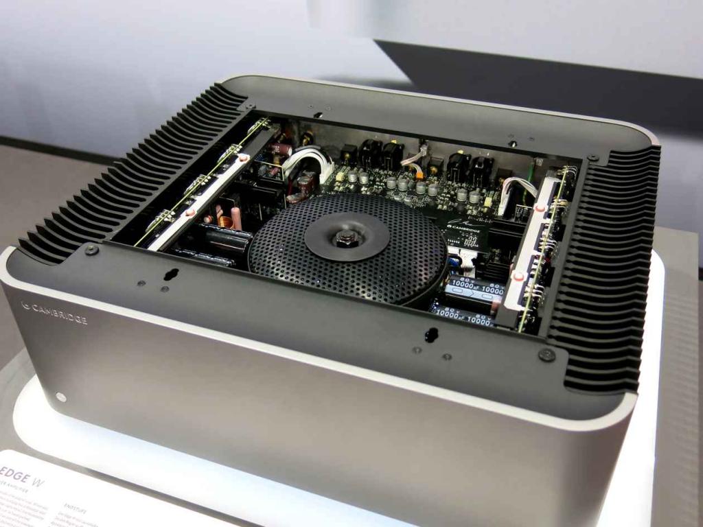

      New equipment has been obtained for outfitting the test facilities, also... this only makes the deferred gratification more frustrating...

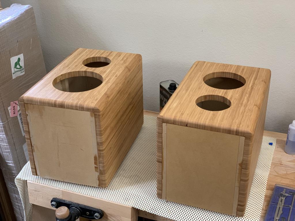

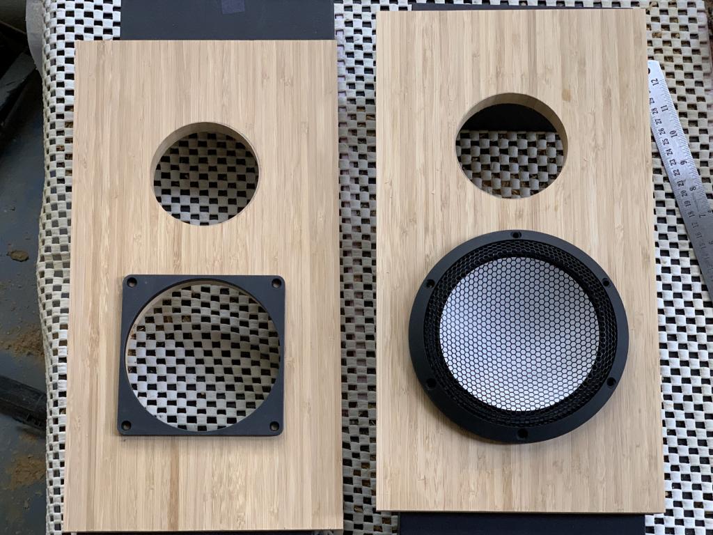

      Note that as development stands, there are likely to be several possible configurations to chose from, depending on preference, inclination and means, including versions using the Wavecor Ardent style crossover and likely two or more using a true Duelund style crossover...
      Test systems are being developed in a modular fashion with separate woofer and midrange/tweeter assemblies. One of the midrange/tweeter assembly versions is may become a mini monitor, and/or a small MTM.

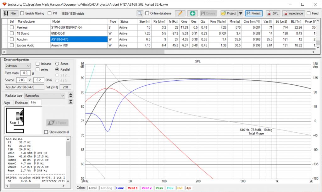

          The other woofer solution being readied for test is dual or triple Accuton AS168’s. The hemispherical cone gives advantages in off axis behavior and the Cell motor construction results in an effective acoustic origin near the mounting plane. These are all benefits for the Duelund approach. Further, they model very well with a reasonable trade off between sensitivity and extension, and have fairly desirable motor and cone parameters.
Name:	AS168 50L 32Hz.jpg
          This is modeled in a 50L enclosure for two wired in parallel. These are 9 ohm drivers, and with capable amplifiers using three in parallel is feasible, as Vimberg has shown.
          Now, consider that this is larger than the 40L used by Jonmarsh for the Wavecor woofers, but imagine if instead of a cone midrange requiring 10L or so in midrange enclosure, a suitable dome midrange were used? One capable of fulfilling requirements in a Duelund alignment with a center frequency of 1600Hz, and an aleph coefficients of 2.7? Then the net enclosure volume would essentially be identical, but we would have a base line sensitivity of nearly 90 dB before baffle step loss.
          This is not to say that the AS168 represent a benchmark level of performance, but initial parameter verification shows they are worthy of investigation.

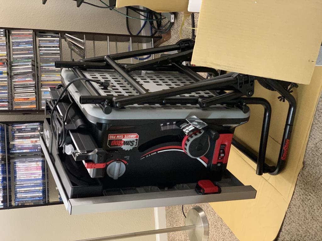

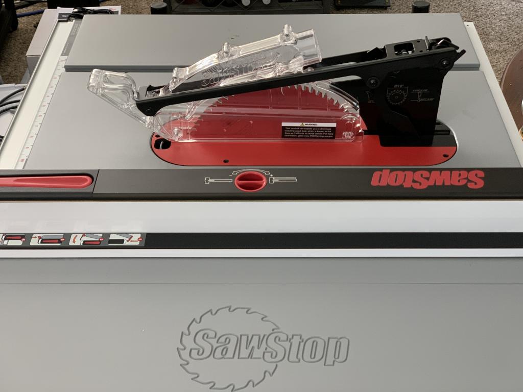

                                  And the tooling setup proceeds- I temporarily reside in what the local economic system calls a "rental condo" and it is equipped with a modest outdoor patio and storage closet- making certain circumspect construction operations feasible.
                                  Today I finished unpacking and setting up a SawStop Jobsite Pro, and installing a preferred blade (Freud), and I have to say it is in a very different design and construction category than typical job site saws.
                                  Of course, it's not in a typical price class, either.

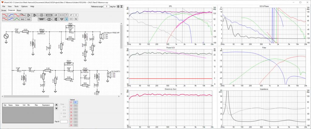

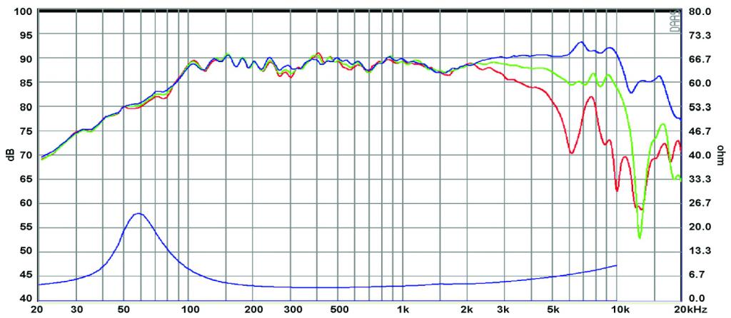

                                        My own goals have been seeking to select a midrange with an extended top range and dispersion that matches well with dome tweeters, considering the sensitivity of the ear in that span, particularly the presence range.

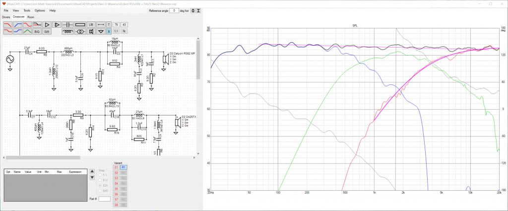

                                        Meanwhile, development of the proof of concept crossover has progressed to the point where one might mistake it for a finished version. That must await having measured driver data in an actual finalized enclosure design. However, considering the enclosures this data was captured on originally, it is unlikely to need substantial revisions.
                                        This result includes the driver time origins in modeling the crossover. The results appear at this point to be quite satisfactory... but this does not include off axis data.
                                        Given the nature of the drivers being used and the radiating area, I think this approach will be vindicated with additional measurement data.

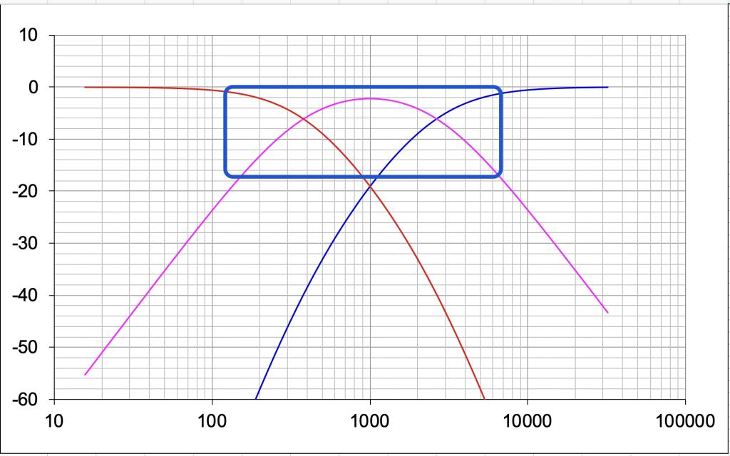

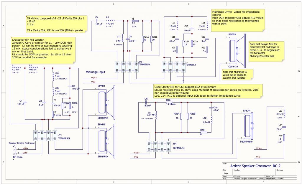

                                                      As many files as I have for the original Ardent project, you'd think I'd be able to lay my hands on that, but I only modified one cabinet to test with the Scanspeak drivers (still have the drivers) and the required updates were pretty basic-
                                                      Let's keep in mind that the first Generation Ardent was a Duelund concept design- which has some very specific amplitude and phase targets. So if one is keeping the same driver complement and center frequency and aleph for the design, than it's basically just a question of adjusting the crossover filters for the section you're changing out, and then rebalancing. with the 18WU/8747T-00 woofer, (which is one of my favorite 7" woofers, with it's underhung motor- but pricey!) that rebalancing of levels is substantial- about 4 dB padding required on the midrange and tweeter sections. My recollection is that with adjusting the impedance compensation elements slightly on the SS woofers, I could use essentially the same network, but had to add an elliptic filter to suppress the very high HF breakup modes. That was done with the second inductor in the LF network. The LF zobel was also re-tuned, as well as the impedance RC comp.
                                                      This was the calculated response target for the crossovers for either version of the design. The Duelund approach is demanding to design to, but once you get each individual section tuned correctly for the specific CF and aleph, then swapping in a different mid or woofer is easier than it might be for a conventional design where you're tweaking and playing with individual driver networks in tandem to try to get them to match up properly.
Name:	SDX Ardent Crossover Target.jpg
                                                      And in the case of this version of the Ardent, the effective driver offset changes from the cabinet were necessary to get a forward response characteristics into the listening plane with the correct time alignment of the drivers- as the C79 and the woofers have acoustic origins that are not coincident with the baffle surface.
                                                      For reference, this is the RC-2 version of the crossover, which still has the ER18RNX, but has shifted to the 6640 Be tweeter. It's a rather large crossover... remained external. My conclusions after testing with the SS woofers was that migrating to the larger Wavecor woofers with their special motor design, very clean cone, and higher output capability, along with lower price, made more sense. Using a derivative of the NatalieP crossover concept was also adopted to reduce complexity and cost.
                                                      And as they say, the rest is history.

                                                        Thank you for the detailed explanation and sorry for my late reply.
                                                        It seems relative difficult to change the ER18 to 18WU.
                                                        From the office FR curve , the 18WU has the same or even much more energy around 100~200Hz then the ER18 but the SPL of mid and mid high is smaller.
                                                        [ATTACH=CONFIG]30477[/ATTACH]
